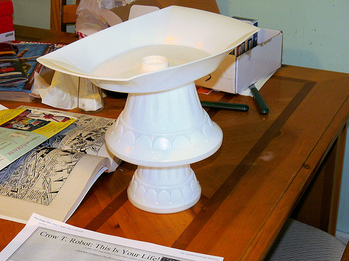

I have a couple of parts for my MST3K Crow puppet that I want to vacuumform and I would like to know what would be the easiest and relatively cheapest way to make plaster bucks out of the parts.
I heard of a way to make a cheap mold is you make a negative mold out of plaster and that you use the negative mold to create the final plaster buck; this process usually results in the destruction of the negative. What's your opinion on that?

and this tray part:

Well, to my eye, plaster doesn't look like a successful choice for the first two part. The tray should work if you cast in the plaster and make sure the buck bottom is dead flat. Otherwise the pressure of the vacuum will snap the plaster. Of the first two, the one on the left will probably destroy both positive and negative trying to get a buck of plaster out of the negative. The second one may work, however if you clay it up on the inside to the bottom of the rim. On the first, even if you did get a plaster buck, it would be rather thin at the top, and therefore, fragile. Also trying to pull vacuum formed plastic down into that one does not look good to me. The bottom of the inside would end up paper thin and probably web unpredictably in there.

Sorry, I should've clearified on the second part. Here's a pic of some bucks of the "soap dish":
I cut out the middle section, so the final part looks like this:
Thanks for the advice on the flat bottom...I'll make sure I'll do that when I mold the buck.
If I were to use a thick plastic on the tray buck, would that stop or reduce the thin plastic on top?
