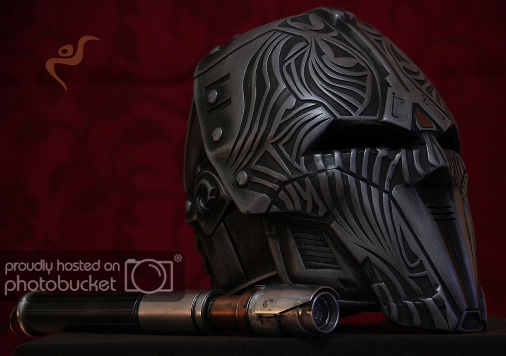

Here is an overview of the before and after.

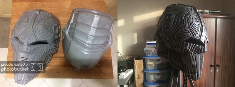

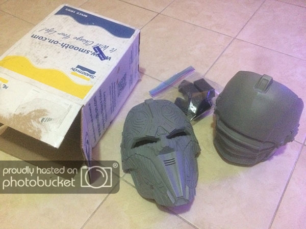

So out of the box it started to look like this, containing the two halves of the helmet and a bag containing foam, eye mesh, and magnets.

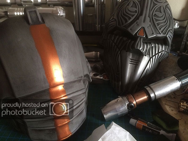

After letting the paint cure overnight I then washed it off with water and for the hell of it most of the darkening effect washed away as well, dammit! I’m getting a bit frustrated at this stage... I just proceed on adding copper paint details to match my lightsaber.

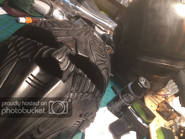

Then I went out and got myself a better stronger black acrylic paint, and then paint all the surface using a sponge.

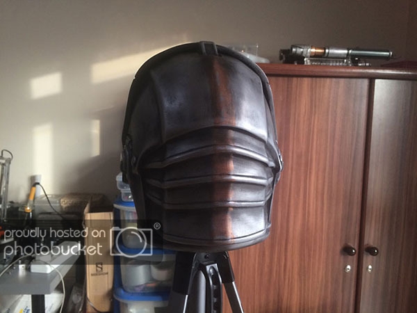

Then I did the same scratching with steel wool after drying the paint...and now we’re talking, It’s looking great! a little dirty but looks great.

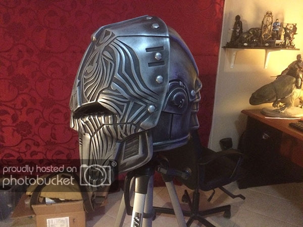

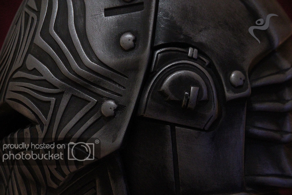

After some small retouch and clean-ups I guess I can safely say It’s done, not as perfect as I wanted but It’ll do for now and maybe later on I will revisit it and make it even better.
And some glam shots
