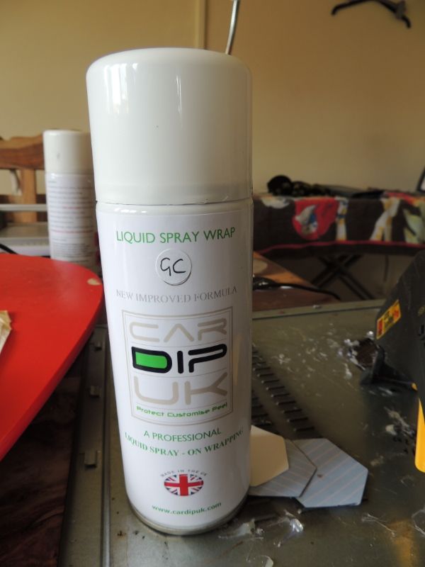

Thanks for the replies guys ok so I've had this arrive this morning its called car dip uk very similar to plastidip and apparently they can mix you any colour downside are three cans cost £43 :S and they over charged me on postage by nearly double! this is the ground coat so in going to try it out and see how it goes on some of my pieces
