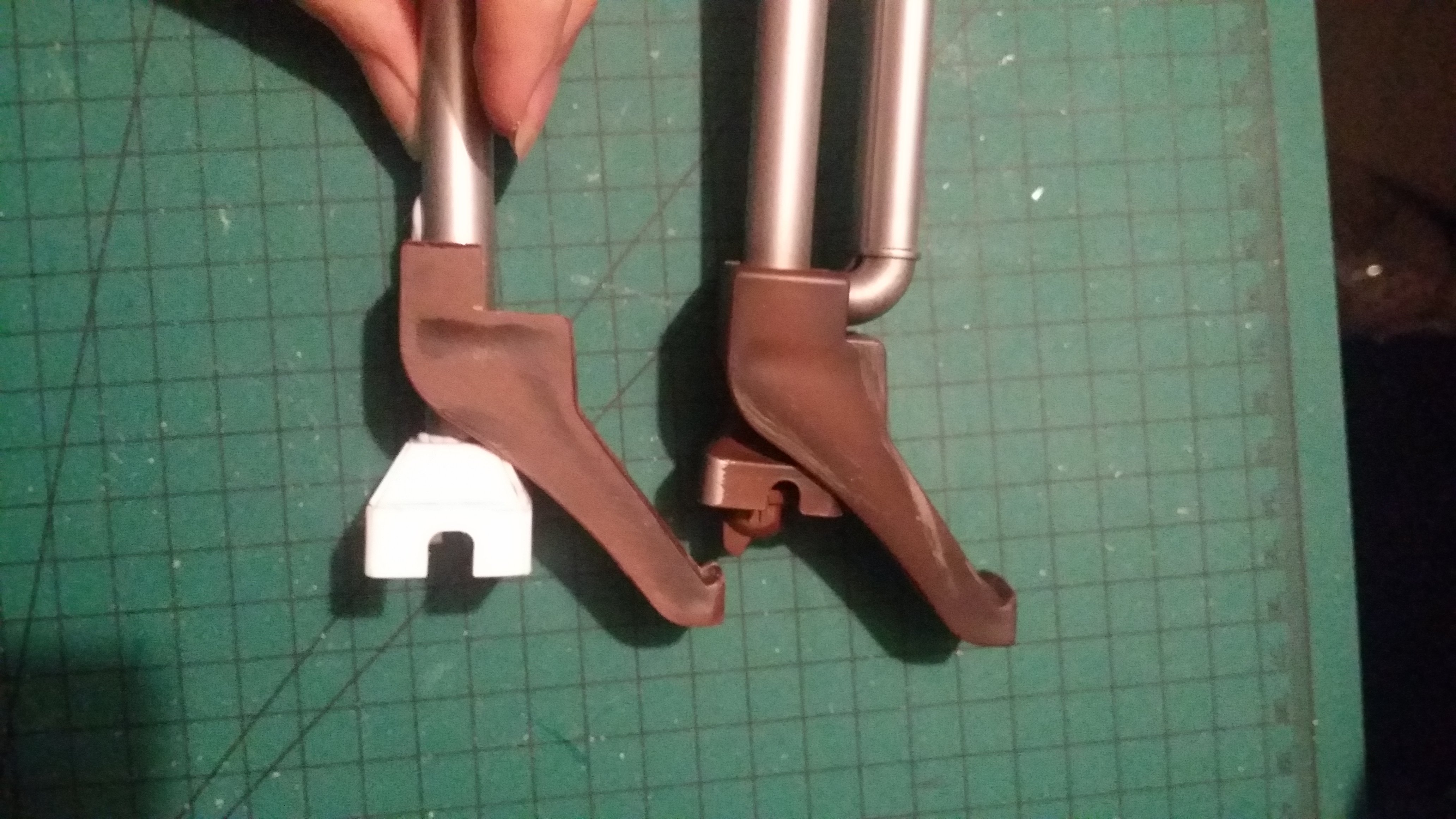

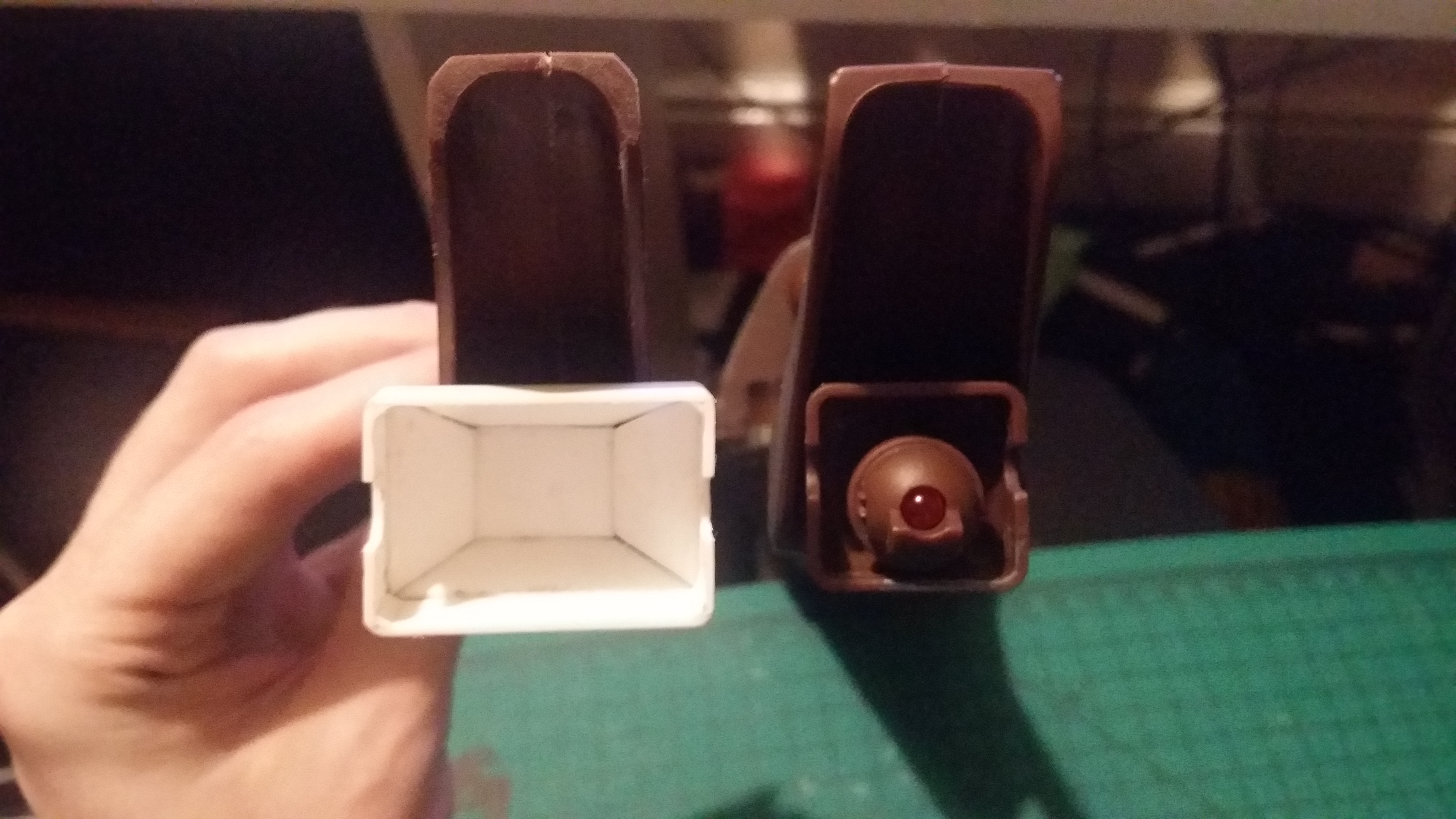

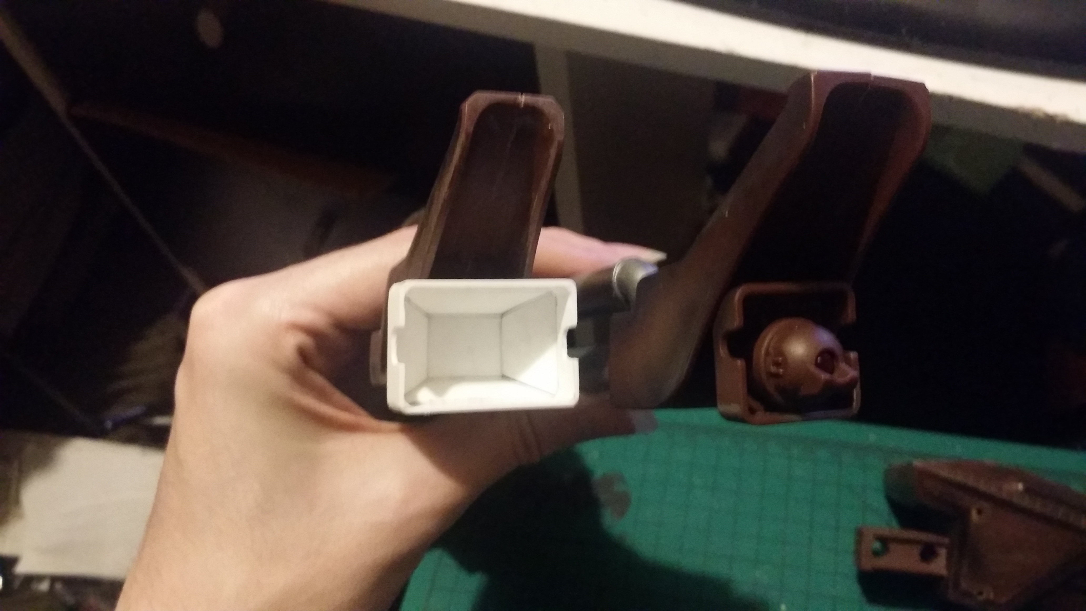

So I got myself one of the AA/DST Star Trek III Disruptors. The sounds are awful but the body shape seemed pretty accurate, but I decided to mess with it and improve it anyway. I've been comparing it to as many screenshots and photos of authentic screen used disruptors as I can. The underside of the forward section of the main body doesn't tuck in quite as far as it should where it connects to the main body but I can live with that (at the moment). The place I feel this replica falls down the most is the front emitter. The outer most piece (which I guess is a rudimentary front sight) is far to thick compared to any of the screenshots, the rear part where the upper rods join is also entirely the wrong shape. The piece that sits around the emitter has the opposite problem with being far too narrow.
I've stripped down my first disruptor. Most of it comes apart easily, other than the front which is glued down the centre, I just slowly worked an Xacto in to mine to split it apart. From there I sawed the back of these pieces down to make the shape closer. I'll have to get some new tubes but I was planning on replacing those with aluminium anyway. I then sawed good 5mm of one of the pieces before putting them back together. I re-cut a hole through this new piece as I'm planning on running a piece of tubing all the way through to strengthen the whole assembly. I've started fabricating a new piece to go around the emitter. Here's some photos comparing my new front section to the stock one.
