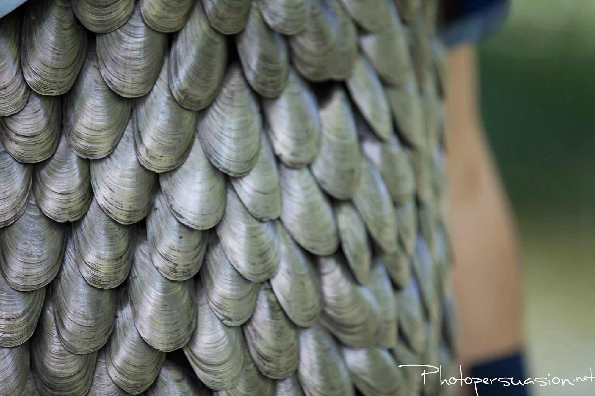

After a little while into the build, I was reading about cold casting in some of Volpin Props' projects and wanted to give it a shot. I wasn't sure initially if silicone and cold casting would capture the detail of a mussel shell. Though, luckily I was proven wrong after testing it. So I grabbed some Smoothcast 300Q and some aluminum powder and set off on a cold casting spree. 425 shells later, I finally had enough for the costume. I added a bit of ebony rub n buff to help bring out the edges and polish them up a bit. I removed any excess with steel wool. Each one had three holes drilled in to them and was hand sewn on to a shirt.
