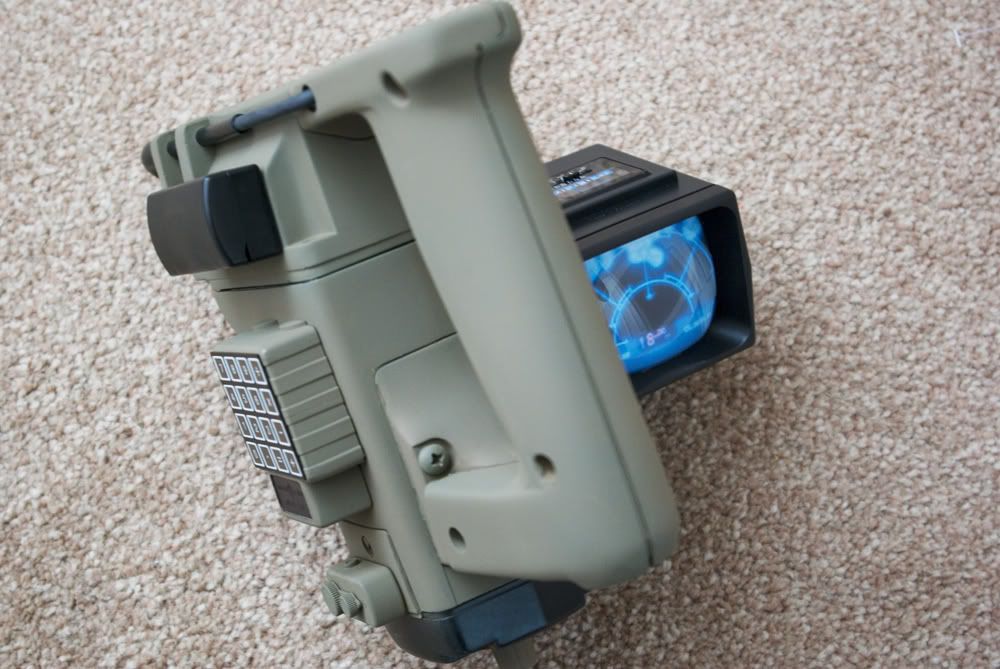

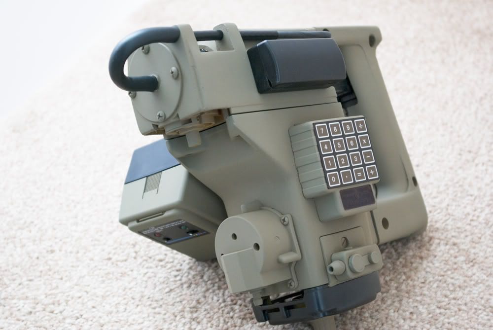

so apart from the pump part, im original to the parts - build is nearly done - im just awaitng the hama remote and jobo to arrive, some final co ax wire, and i used a photo i took from tv via the bluray, printed it out and stuck it inside the hama :) it still needs all screwing back up but until the remote release arrives im on hold - i may build a second one as whilst sourcing the parts i pretty much doubled up on everything as in the future i want a hyperdyne fully working unit it one - this one thats near completion will stay static replica only. i didnt think id be able to get all the bits - esp this day and age - more than anything the calculator find really spiced it up - due to the cheapness the other parts cost i was able to go overboard on the ebay bid to ensure i won - better than paying 360 for a master replica one financally :)
current build state:

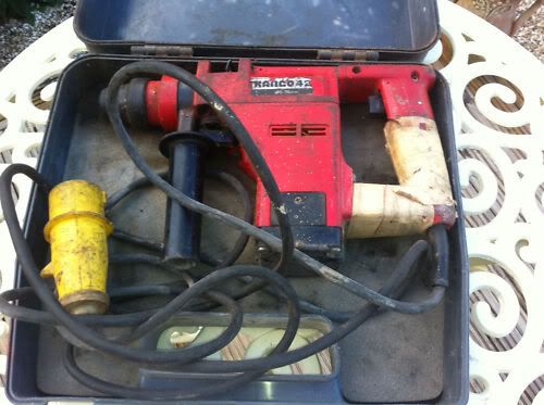

this was the state of the drill when it was won:

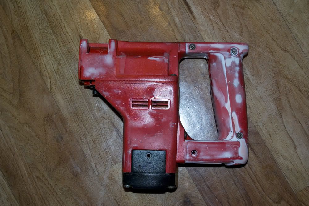

and after the repair you can see where it was cracked(clean in 2 from trigger to bottom right corner) and in a general state of dropped on the floor in its 25 year old life - alot of scratches, chunks and marks on it - all rubbed out, filled and rubbed till i bled:
uk ebay - theres always one a week usually - i had this one, another ive stripped, and theres one listed now currently on uk ebay - mine both cost me 11 uk pounds, the whole build has cost approx 100 pounds now - alot cheaper than a master replicas version. but i have sourced every part twice (except for another hama remote, jobo minilux, and casio calculator panel) so i almost have all the bits to make another tracker

i struck lucky on the kango as it was advertised as a kango 46 (due to the label being torn, and the plate was covered by masking tape)

my hama release arrived this morning from the usa so i was able to finish the build - i also went to maplins and bought a single message pcb kit from velleman - looped a motion tracking noise for 30 seconds - and recorded via the pcb onboard mic - i also decided to utilise the trigger for the leds and the pcb - so upo pulling the trigger it now lights and makes noises:

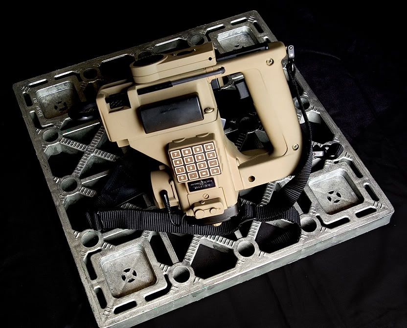

finished pic:
