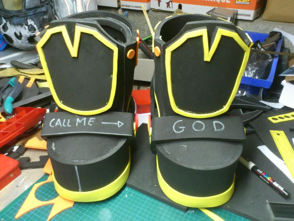

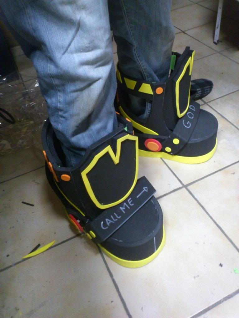

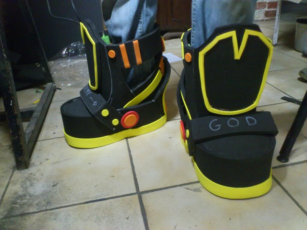

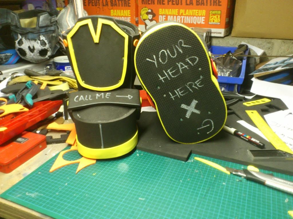

So first a simply question. Can i use resine directly on EVA foam because i want to solidify my boots ( i don't want to hit them when i will walk in nature xD )
Maybe somebody know a method to do that.

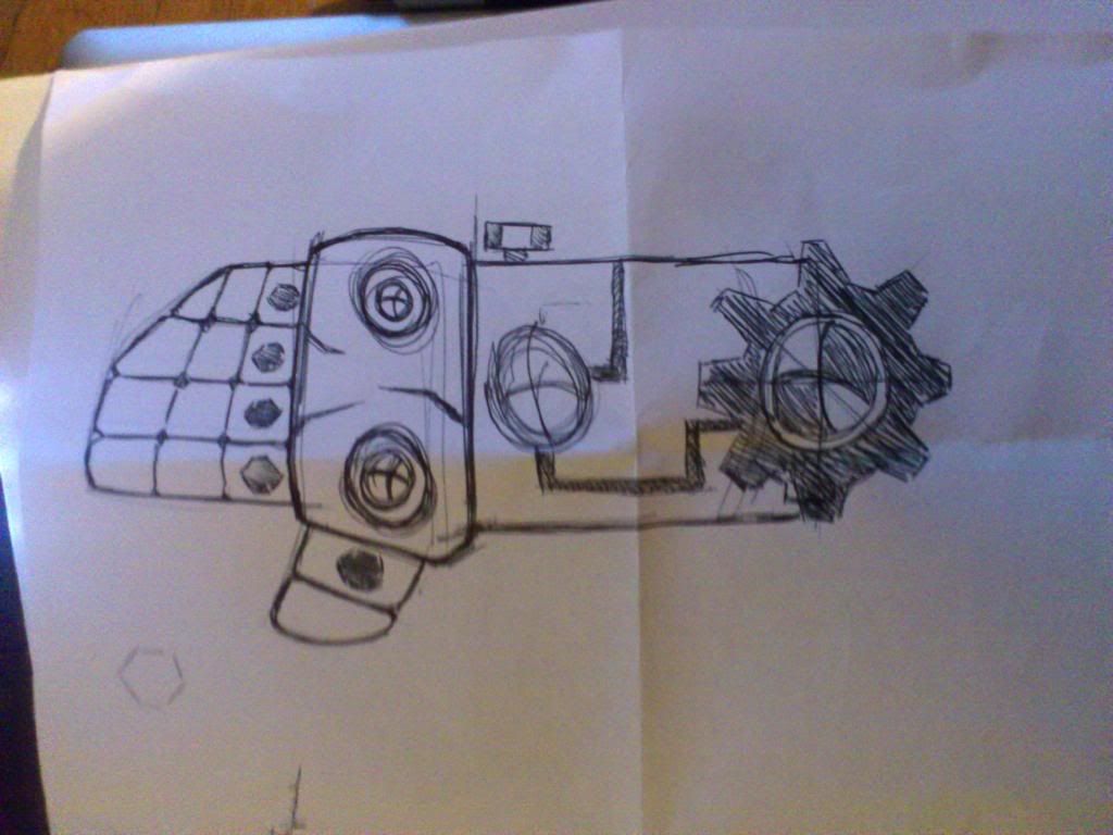

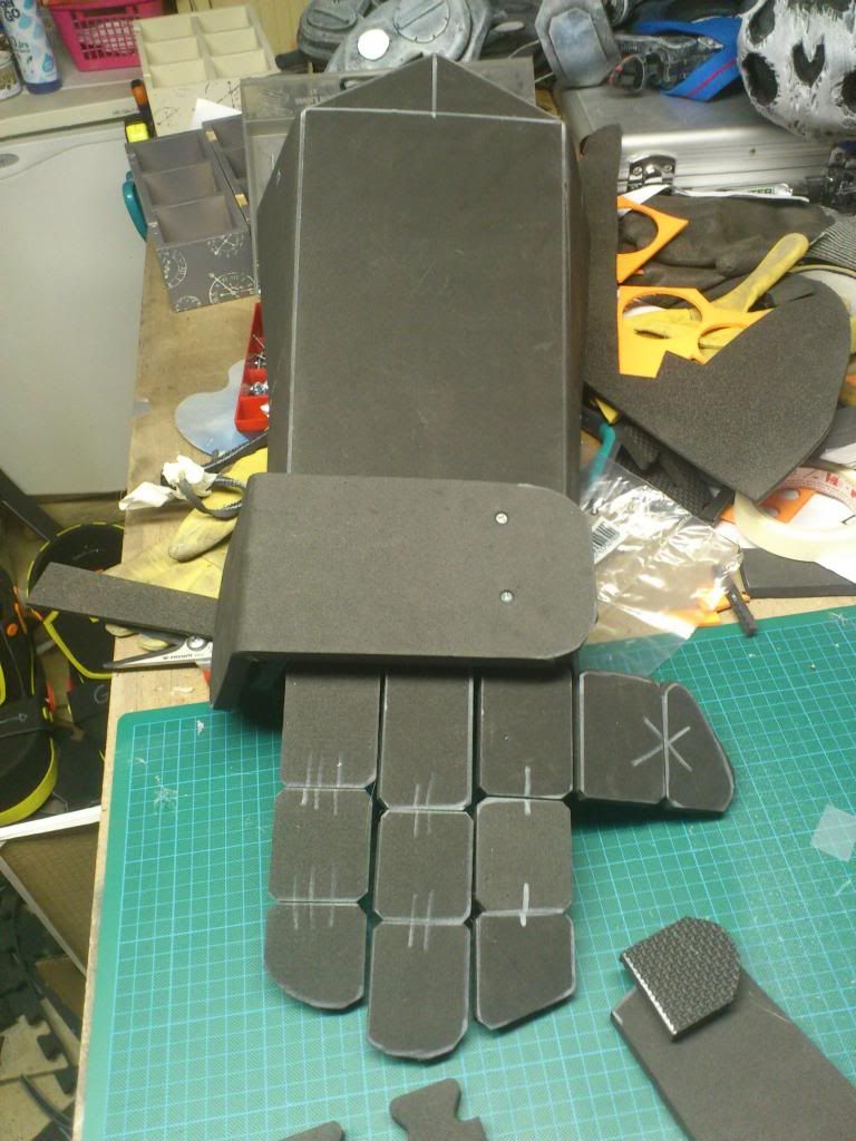

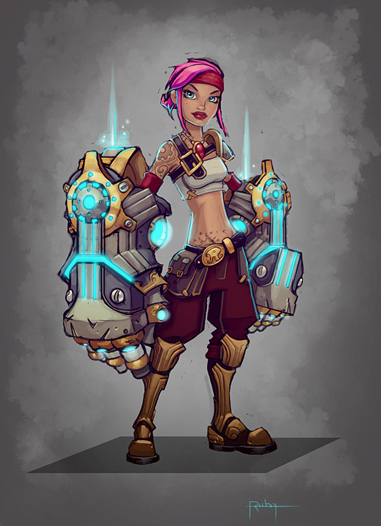

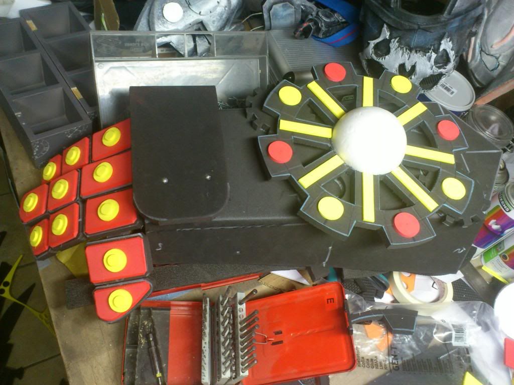

And second upgrade or new part for futur armor. I want to make a BIG HAND like Vi from League of legend see :
i've sketch that really quicly :
and i am asking how i will articulate the fingers.
Did somebody get idea ??

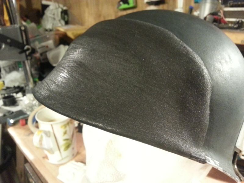

Hey bud, not dropped by in a while as I'm tied up with my little project. Your costume just gets better and better, loving all the little hexagons and details you've managed to put in to it, totally awesome :D

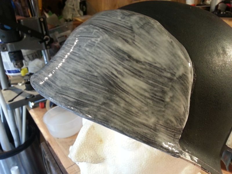

It looks like my timing couldnt be better either, ive just used resin and foam to make the lobe plate on my colonial marine helmet using XRbots technique.
Step 1. Have foam part ready
Step 2. Paint on a couple layers of PVA glue (kids glue) over the parts to be coated in resin. Allow each layer to dry fully befor applying the next. The glue acts as a sort of primer that binds the foam to resin.
Step 3. Paint on the resin in thin layers, one at a time allowing each layer to almost cure (the resin should be slightly green and pliable as this helps each layer to bond bettet). Rotocasting resin is the one of choice as it has self levelling properties and Smooth-On 65D is the most popular. Mix batches of no more than 20ml as it usually starts to turn before being able to apply it all.
Step 4. Repeat until the desired thickness is achieved
I found sandpaper didn't get me very far at all with the resin I used, but found a fresh Stanly blade a very good tool for both smoothing and shaping :thumbsup
Step 5. Prime and paint :)
http://i1225.photobucket.com/albums/ee395/Can-obi/IMG_20130501_124659.jpg
http://i1225.photobucket.com/albums/ee395/Can-obi/IMG_20130503_102641.jpg
http://i1225.photobucket.com/albums/ee395/Can-obi/IMG_20130503_102622.jpg
http://i1225.photobucket.com/albums/ee395/Can-obi/IMG_20130503_155137.jpg
http://i1225.photobucket.com/albums/ee395/Can-obi/IMG_20130503_155230.jpg
http://i1225.photobucket.com/albums/ee395/Can-obi/IMG_20130507_190836.jpg
http://i1225.photobucket.com/albums/ee395/Can-obi/IMG_20130515_003919.jpg
http://i1225.photobucket.com/albums/ee395/Can-obi/IMG_20130514_114833.jpg
Hum so resin work with eva foam !!! glad to read that. And is the result can resist to impacts and scratches ?? i think i will try your method on some foam remnant.
Thx a lot for kind words :)
Mine is a little flexible which I didn't want so filled the cavity underneath, but for armour its perfect. Not sure about scratch resistance, you will needto do some tests with the resin you have.

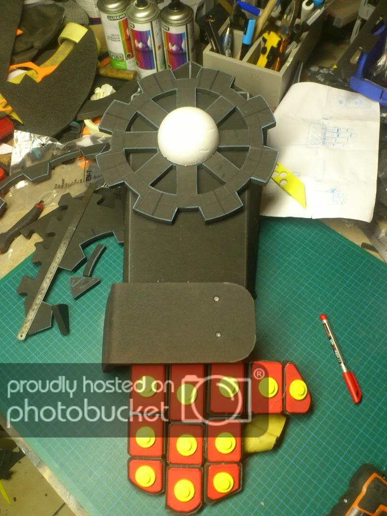

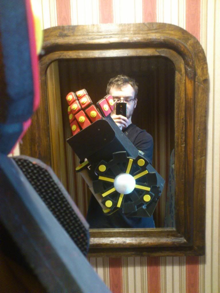

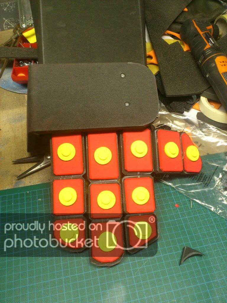

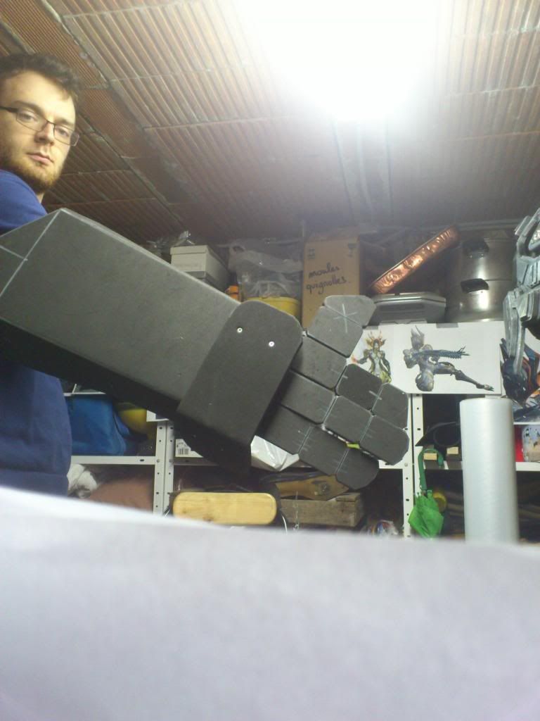

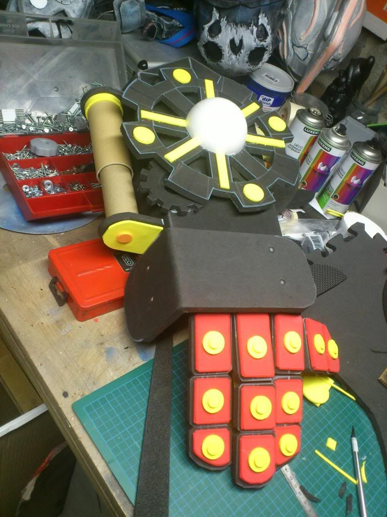

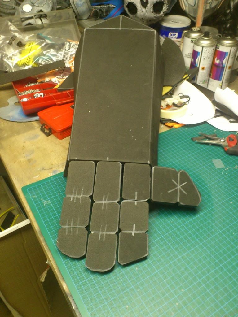

ANd here litle up, i've start my Heavy fist ( only 4 fingers xD )
i think i will try to add the last finger xD

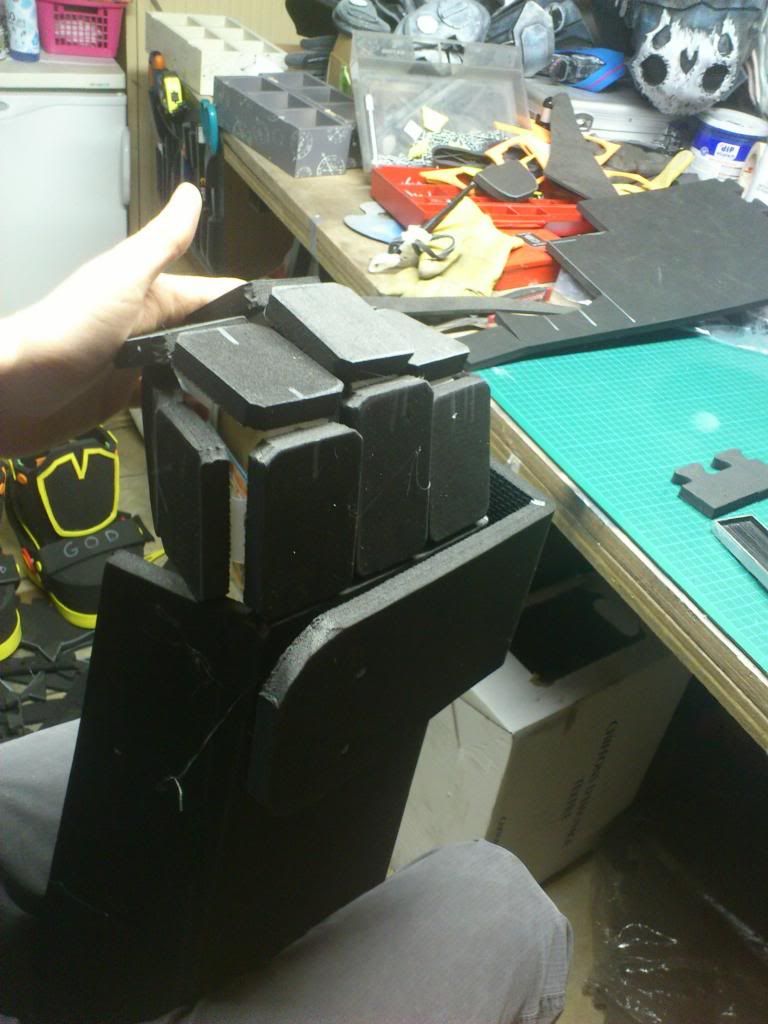

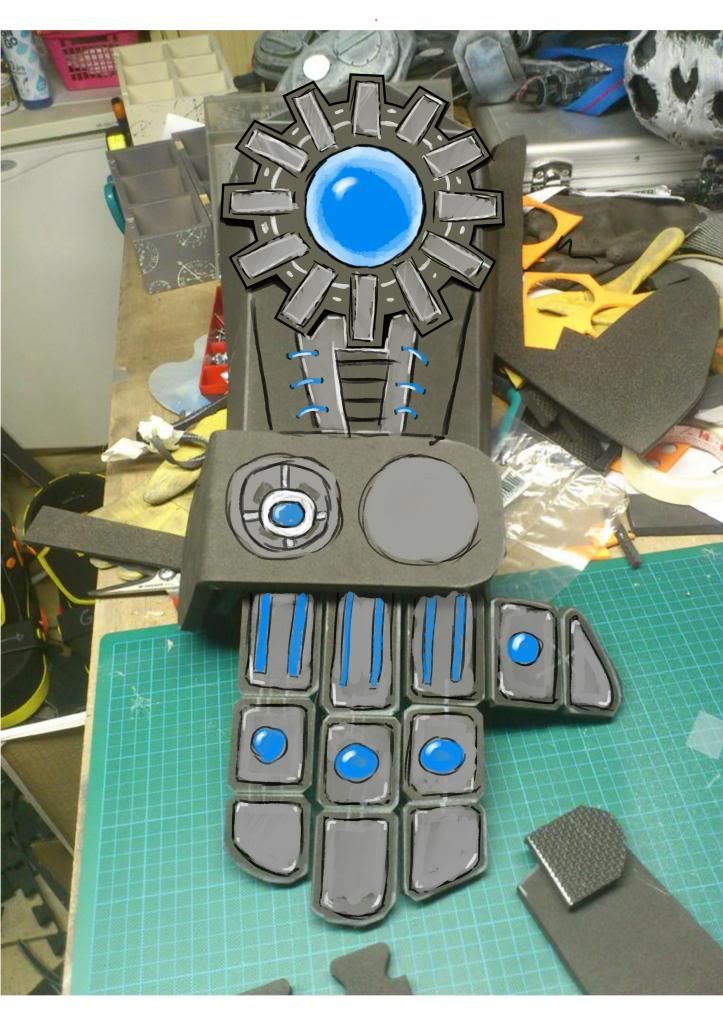

Hey guy's just done a very very very very fast sketch of my futur mecha'robotic"big hand xD
here just a quick idea :

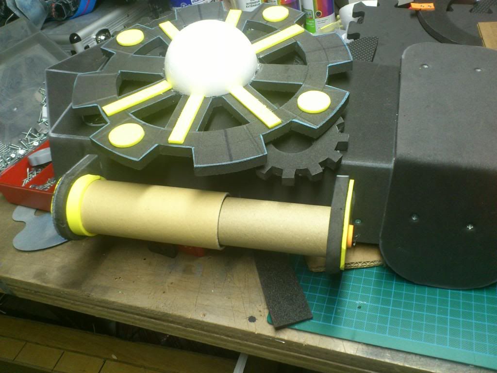

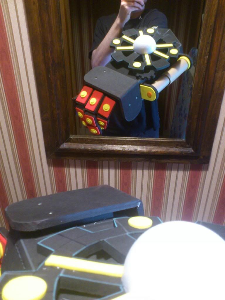

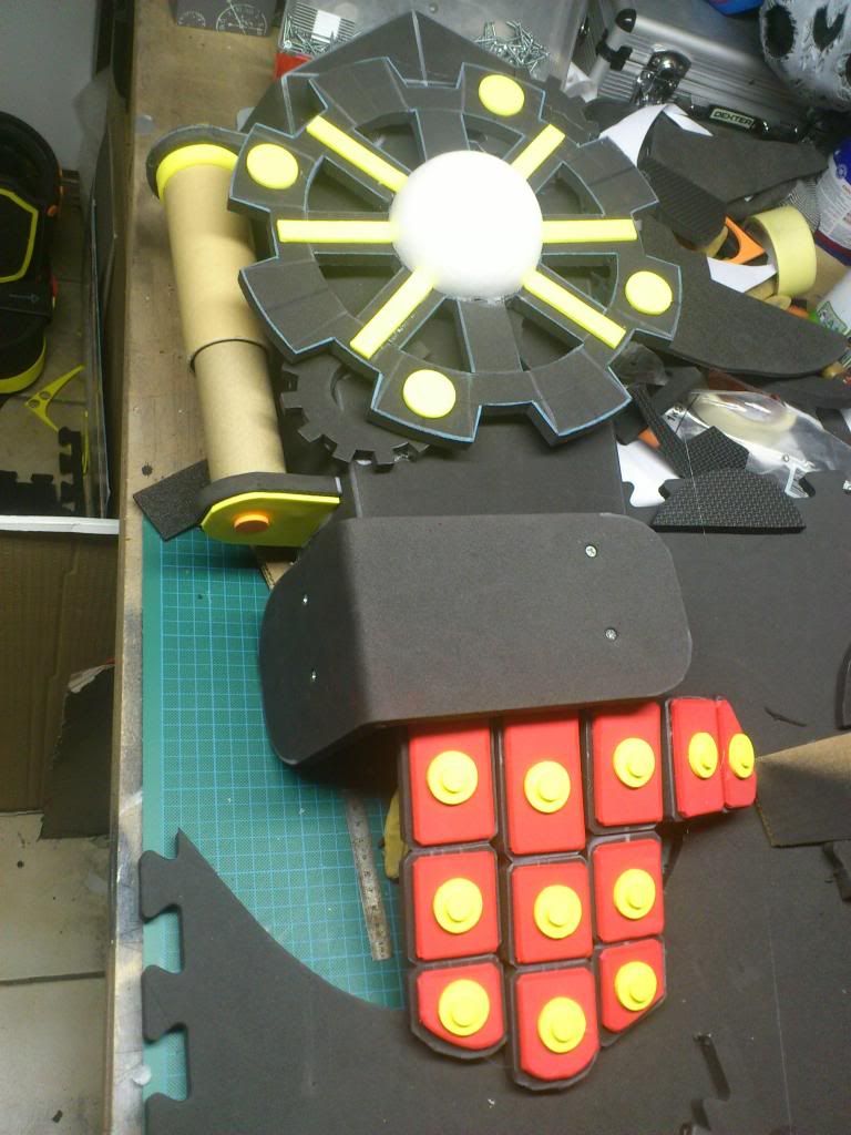

new pics ^^ starting the detail job :
and only for you a quick video of the fingers :
hope the vidéo will work :)
