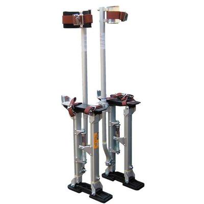

If you will be building more giant-size costumes in the future, you might want to consider picking up a $75-150 pair of Drywall Stilts. They will be more comfortable, lighter and more stable than anything you can build.
HERE is a 18"-30" set on Amazon for $82.
With the rest of the build... just remember to 'keep it light.' It might not be much weight piece-by-piece, but all added up is going to make you top-heavy and will reduce the time you can be in the costume.

Wow! Drywall stilts! They would be perfect and they articulate using springs. Being adjustable for height is perfect since I could get a better feel for high I can be before I invest too much time in making the costume to the scale I want.
Thanks for the suggestion, Indie Film Geek! :thumbsup
