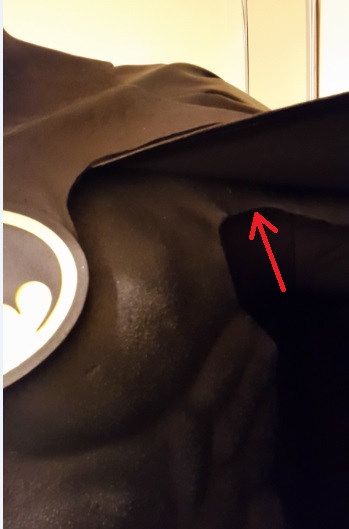

Hi all,
I havnt attached my armour pieces to the under suit yet, i think the legs will be ok, but the chest part is going to be a pain because of the shoulders. Ive loosely attached it to try on with my cape and its a nightmare, you cant lift your arms up that high to sprelad the cape and when i do, it all moves around so I was thinking of possibly cutting the shoulder parts off and gluing them on as a separate part, but obviously they will be glued on right next to the corresponding piece of armour so there shouldnt be that much of a join. but hopefully when i lift my arms it separates slightly allowing me to lift my arms higher up to show the cape off.
If i carefully cut down there im hoping it will work, unless there is some other way about this ?
Thanks,
Scott
Firstly whos 89 chest is it, if its not fitting on your shoulders snug when you lift your arms the shoulders dont move with your arm,
is there space between your shoulder and the chest piece shoulder?
before you cut it try padding your shoulders with foam then temp tape the arms around yours so the piece feels more like its part
of your own body, if this helps with movement then stick the foam inside perm, I have a few 89 chests and some are wide at the shoulders
and I get the same effect ,its the problem when its a one size fits most piece.

I will try the foam then, and taping it to my undersuit to see how moveability is exactly.

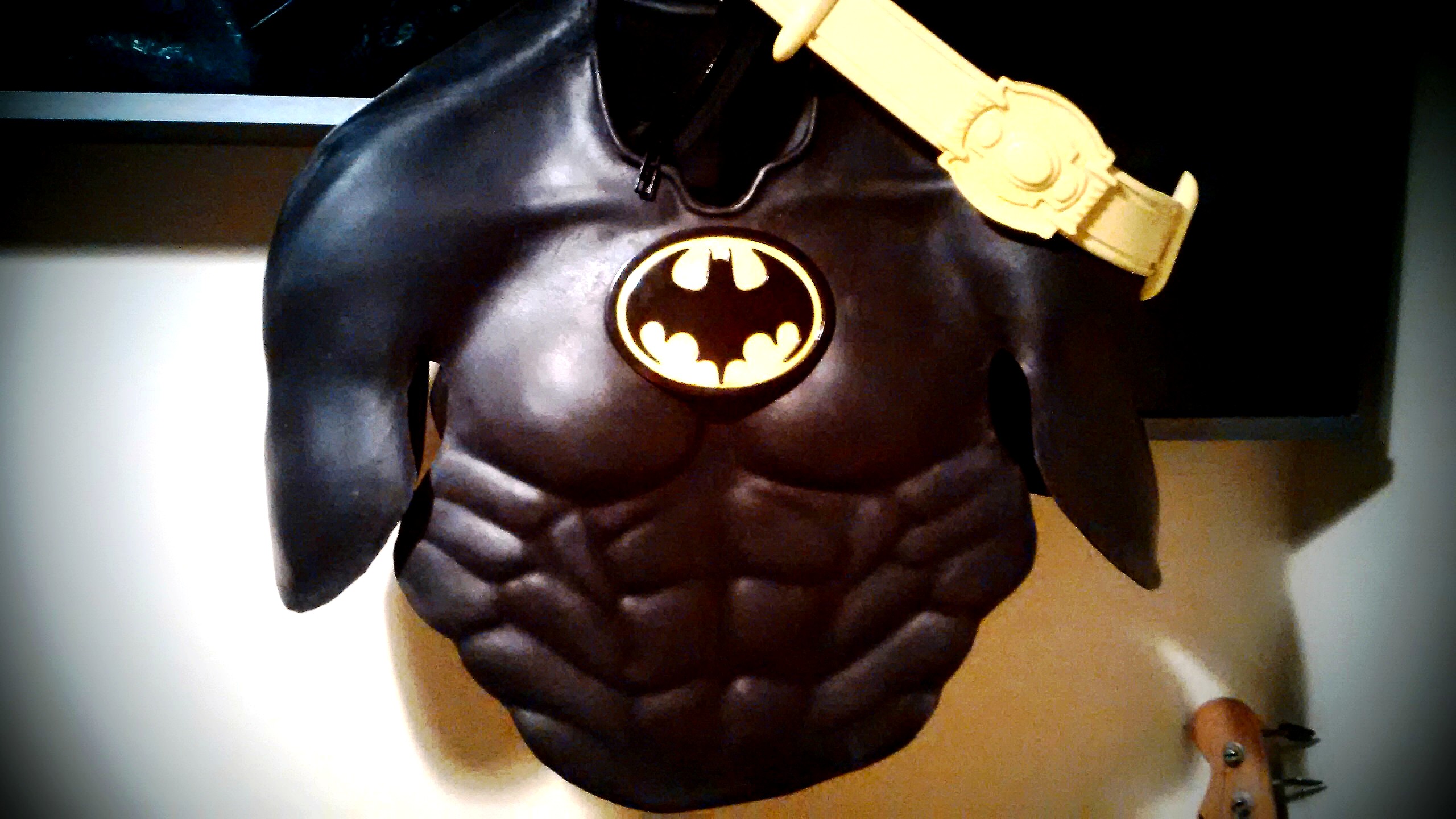

looks like a recast of a Bob Dullam sculpt, The one in my picture is a Bob Dullam as well done by Artsee1
is it very thin as you could make it much better by thickening it up, Lay it on something soft like an old duvet
old mind.... clean the surface with acetone or IPA push the muscle /abs forward ... then fill just the muscle hollows
with thickened latex until you have a nice thick layer and leave to set for as long as it takes, probably days...
you will find it keep a better shape when on without the muscle shape distorting....

Looks good man. Btw artsee1 doesn't seem to have the impression on the chest where the symbol goes?jw to see if you had his as it's most affordable and if you liked it and how it looked.
It was one he does now and then...yes it has the emblem slot, its a good thick pull, it had extra latex around the front edge that I trimmed off.
the legs are one piece wrap around and resemble the film frames if you pause in the fight scenes especially the bottom of the crutch area
but had the knees attached which I trimmed to, It needed some finishing off to look the way it does now, there are a couple of people in the
states that are selling this set, I like it better than the urethane suits as you can work on latex until your happy with it.
the only negative to the torso is it is very broad at the shoulders unless your build like an NFL player needs padding out if your not a body
builder....
will be doing my own sculpt this year using it as inspiration to get a tighter fit on the shoulders for us normal shape guys.....

MrDashBo, yeah thats the guy i got it from, so its a recast then ? urgh, well i will give it a try and see how it goes. It doesnt feel thin, its pretty weighty sitting on my chest, theres a few imperfections on it though which could be better.
has it any back to it?
My torso in the picture is probably a brother of a brother of yours along the line if you know what I mean....
at the end of the day it is what it looks like when you have finished it.
latex is my favorite to work on you can mess it up and with a bit of work it is looking good again, urethane is a bugger
to work on unless you have pro materials to use, if you try and scrimp with the I will try this on it you will mess it up.
