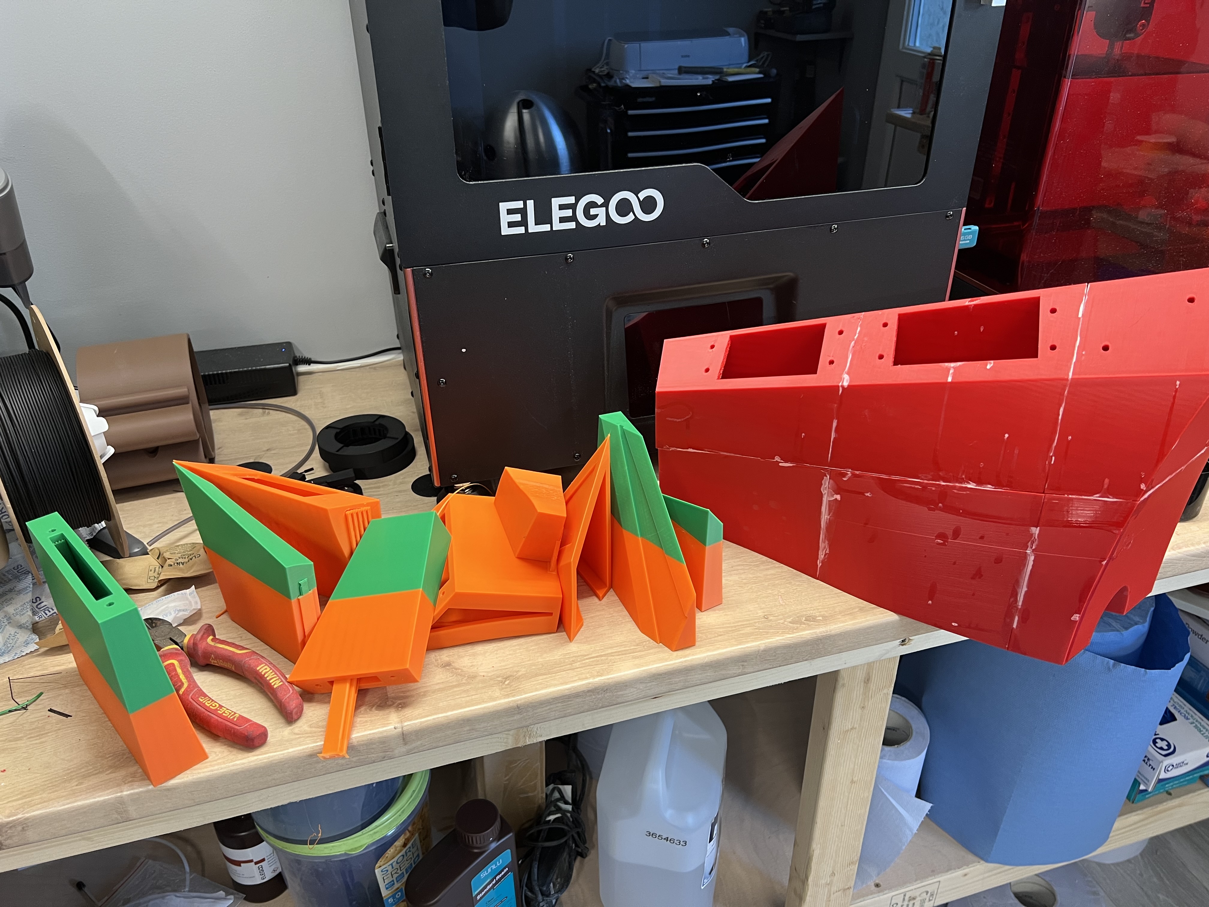

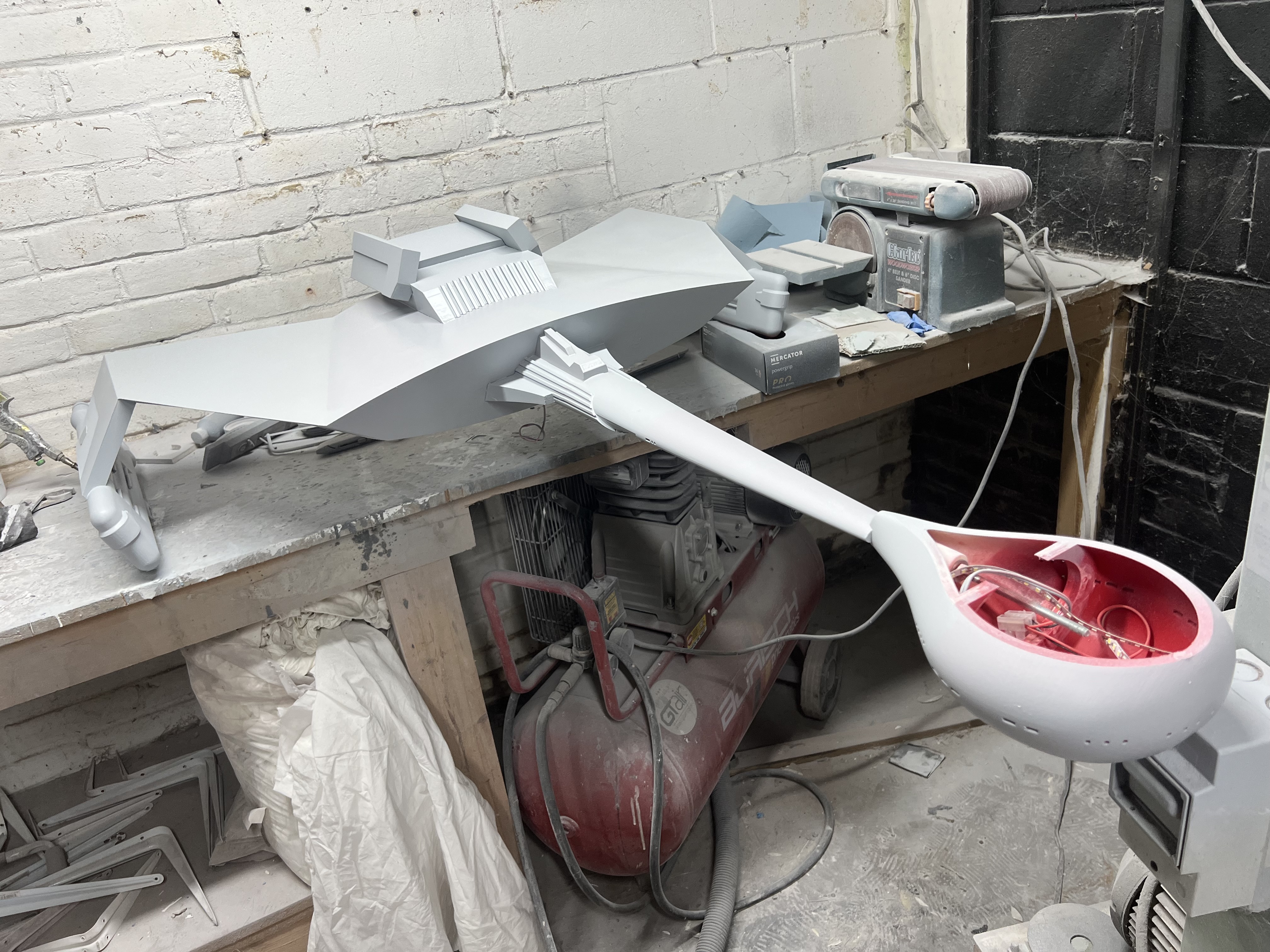

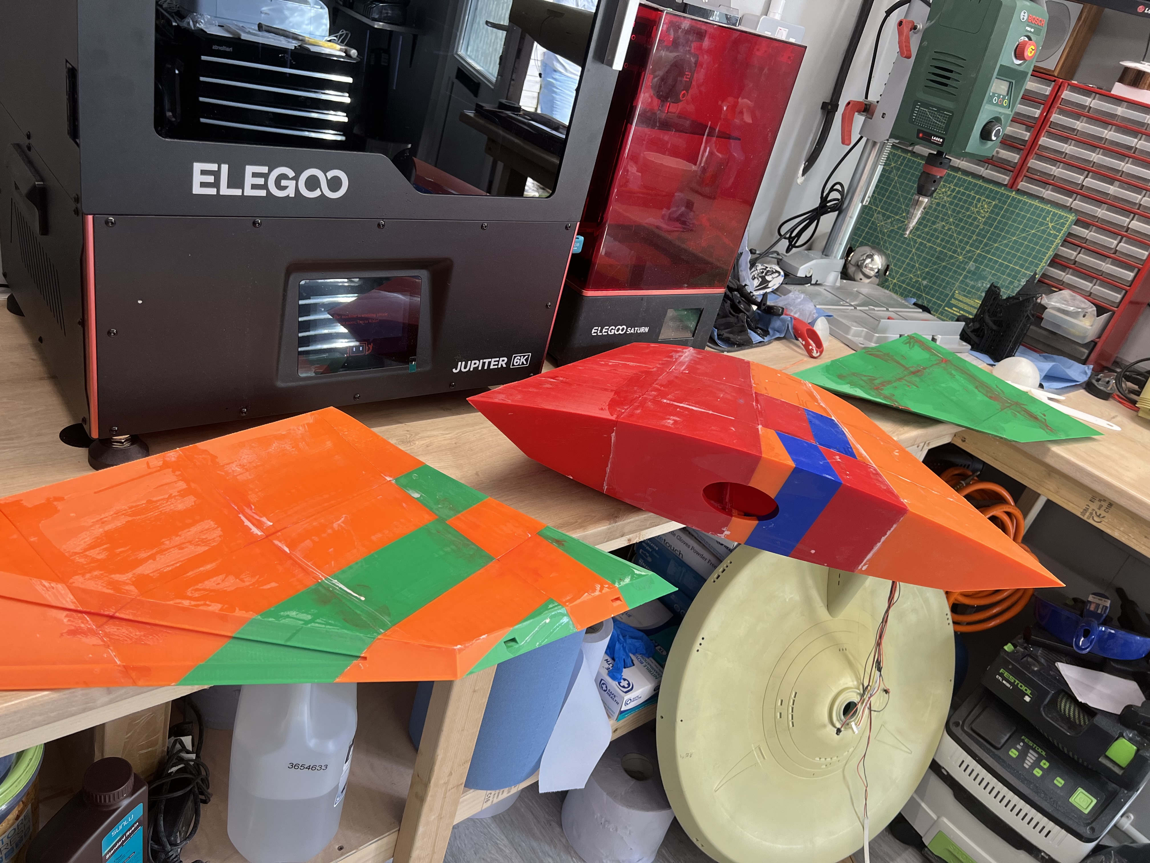

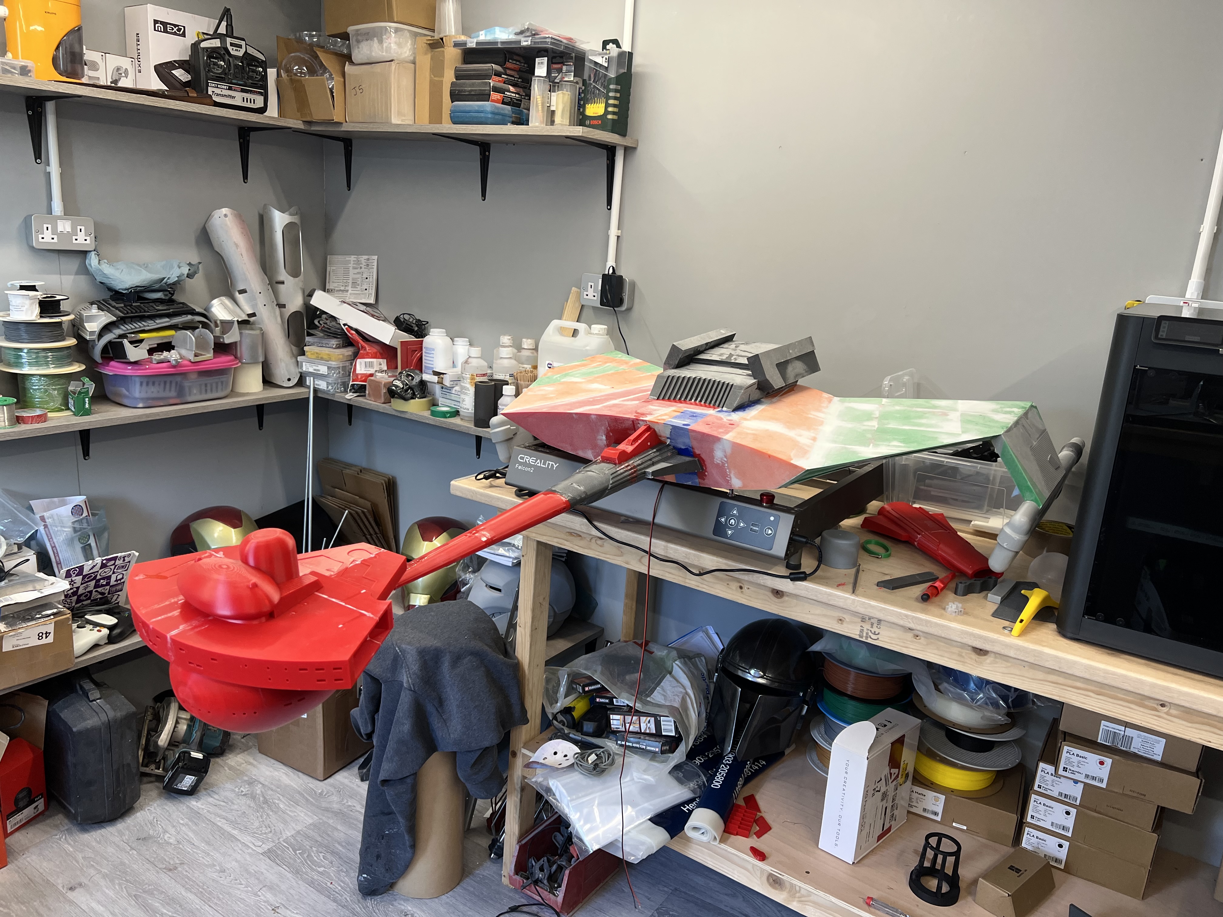

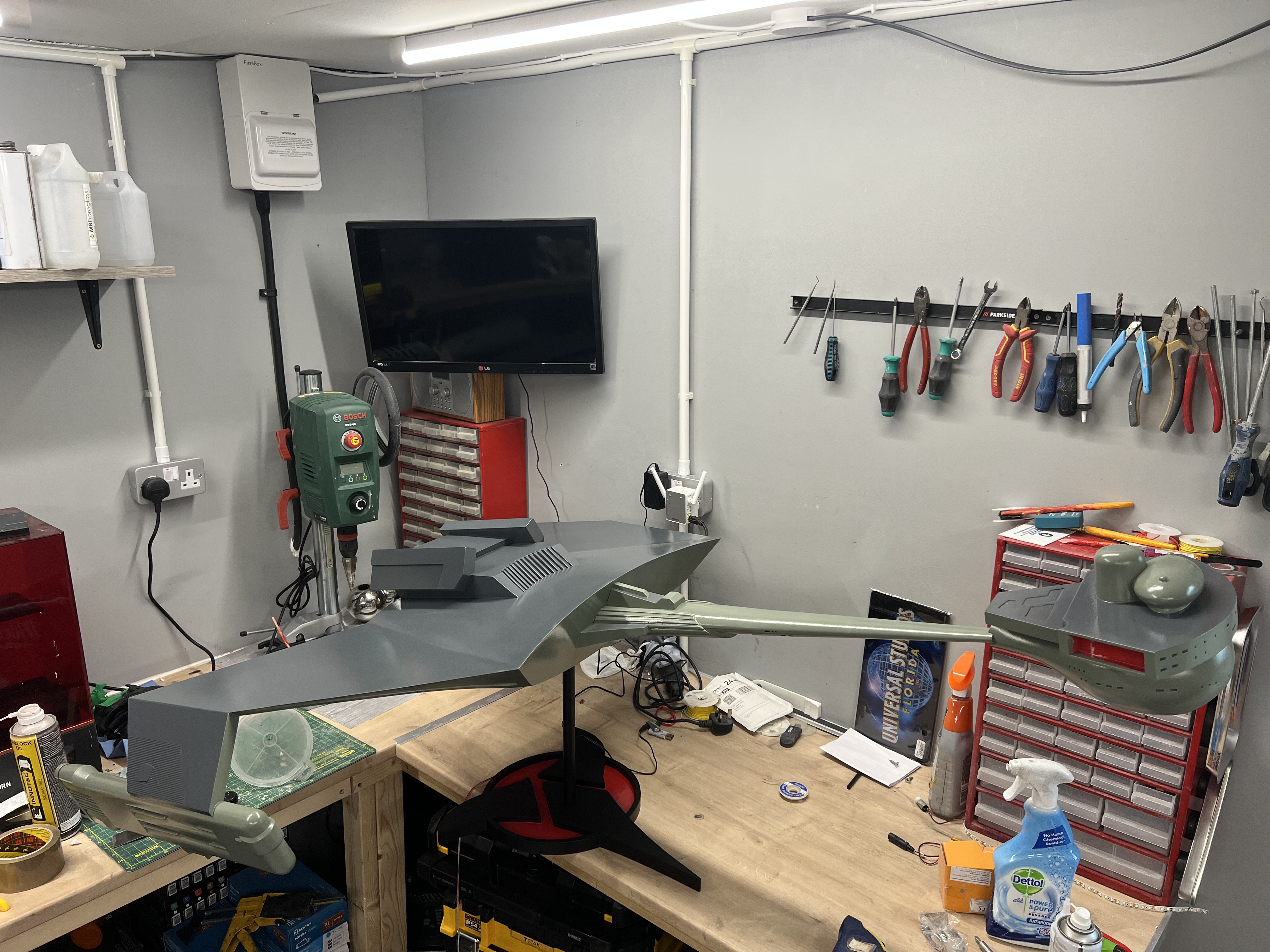

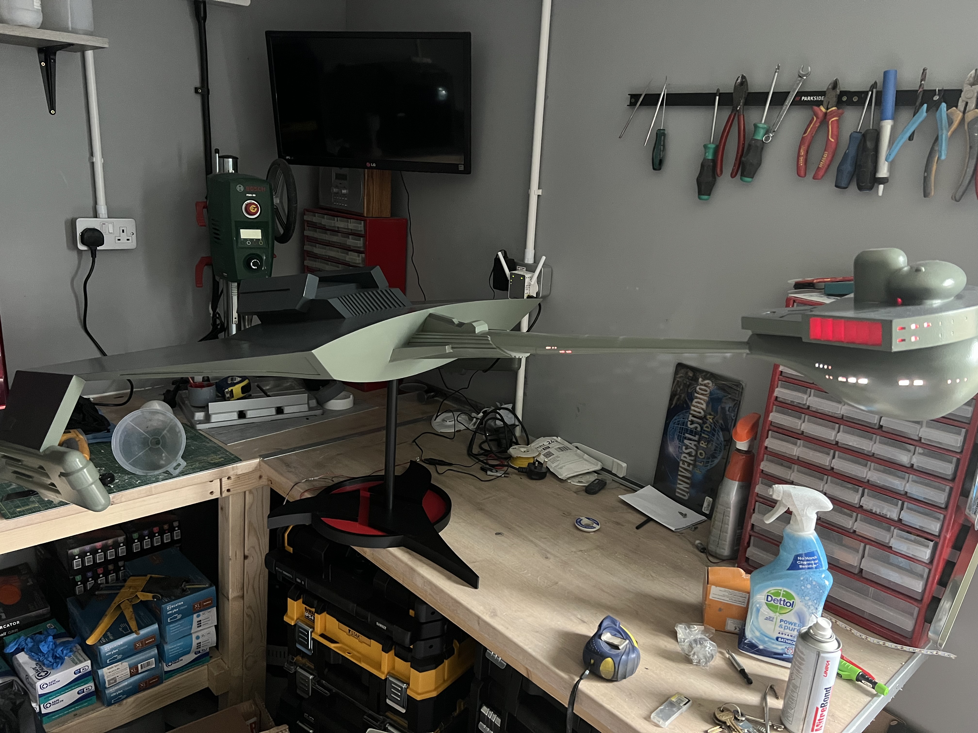

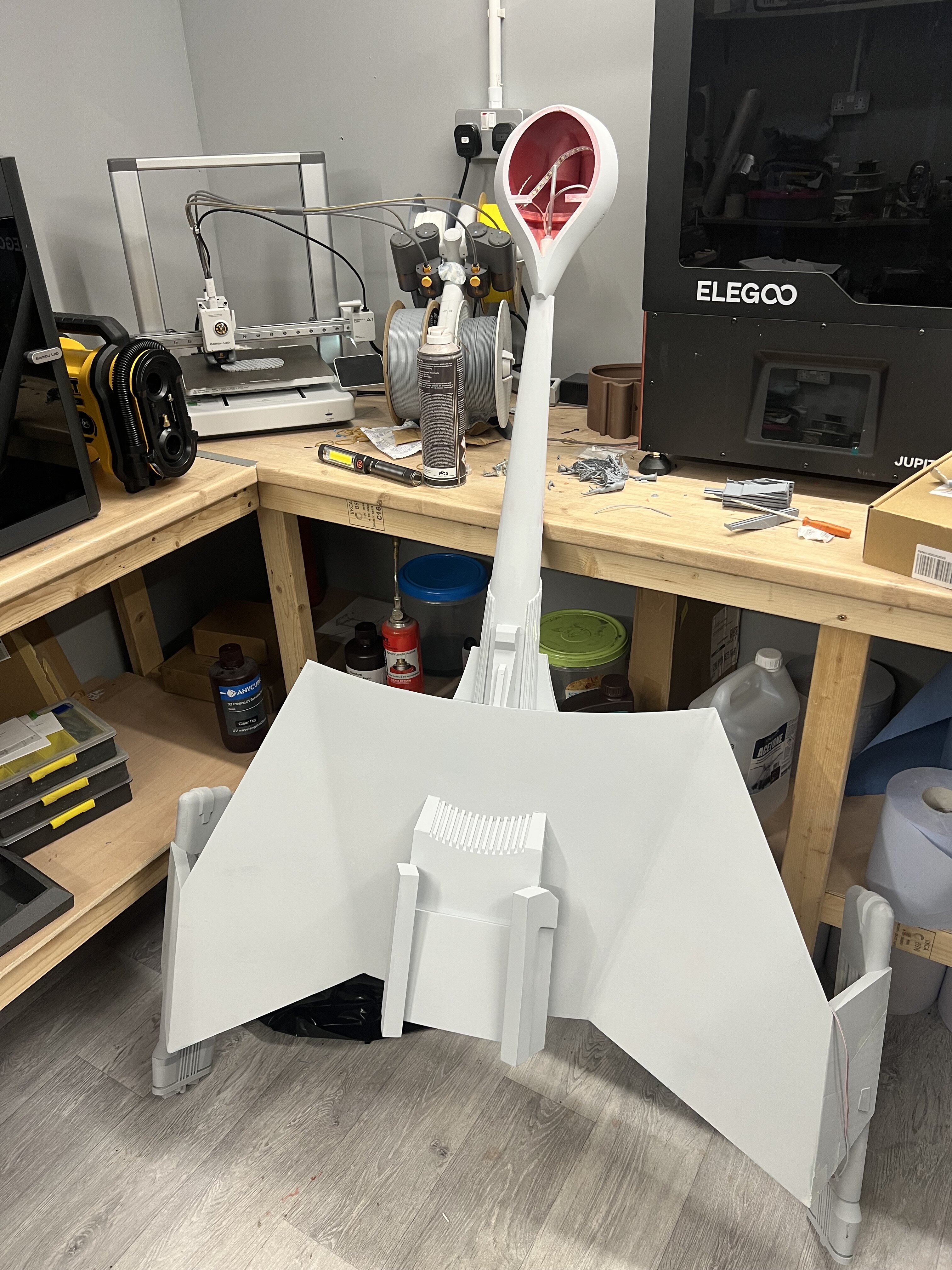

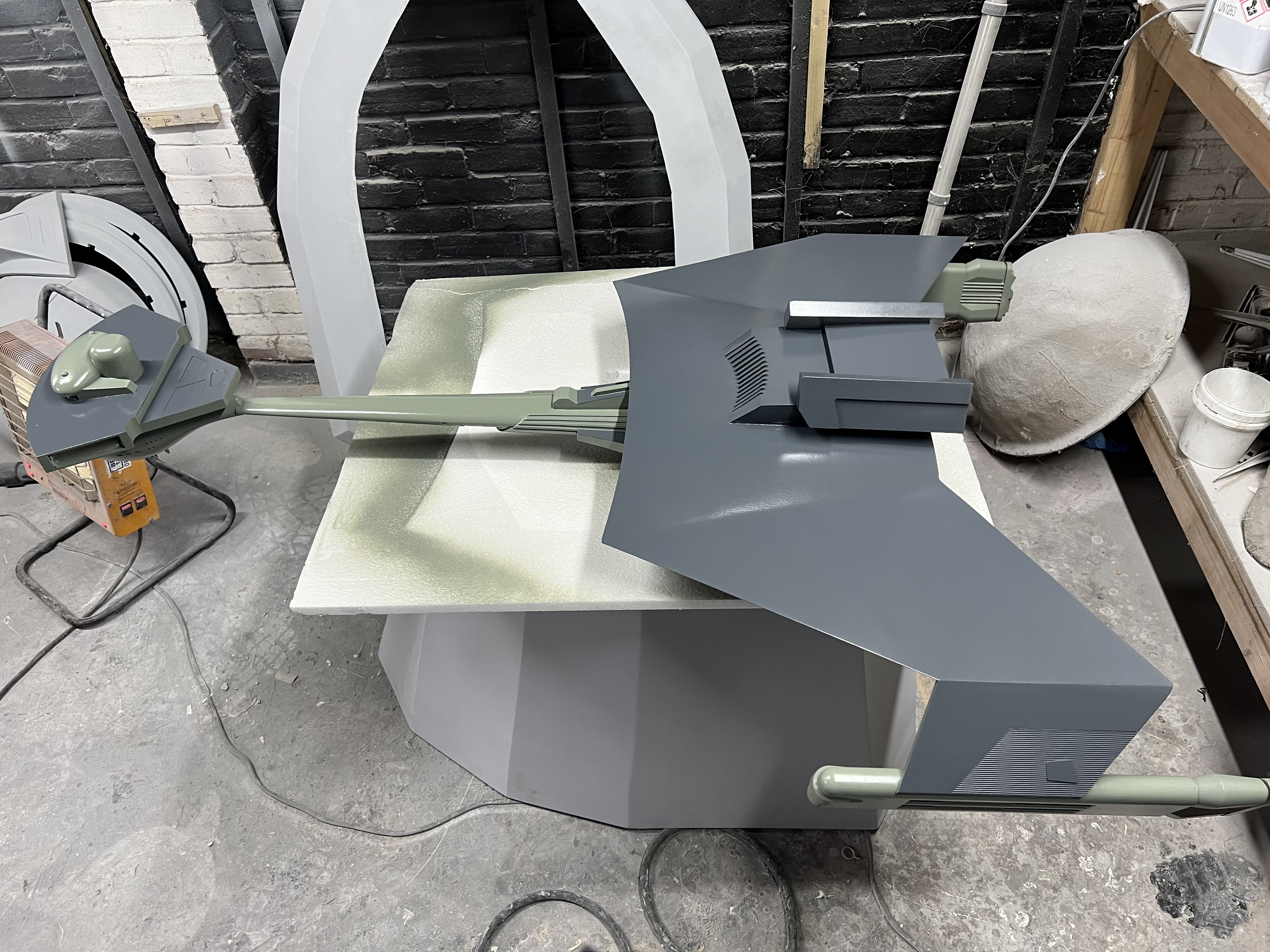

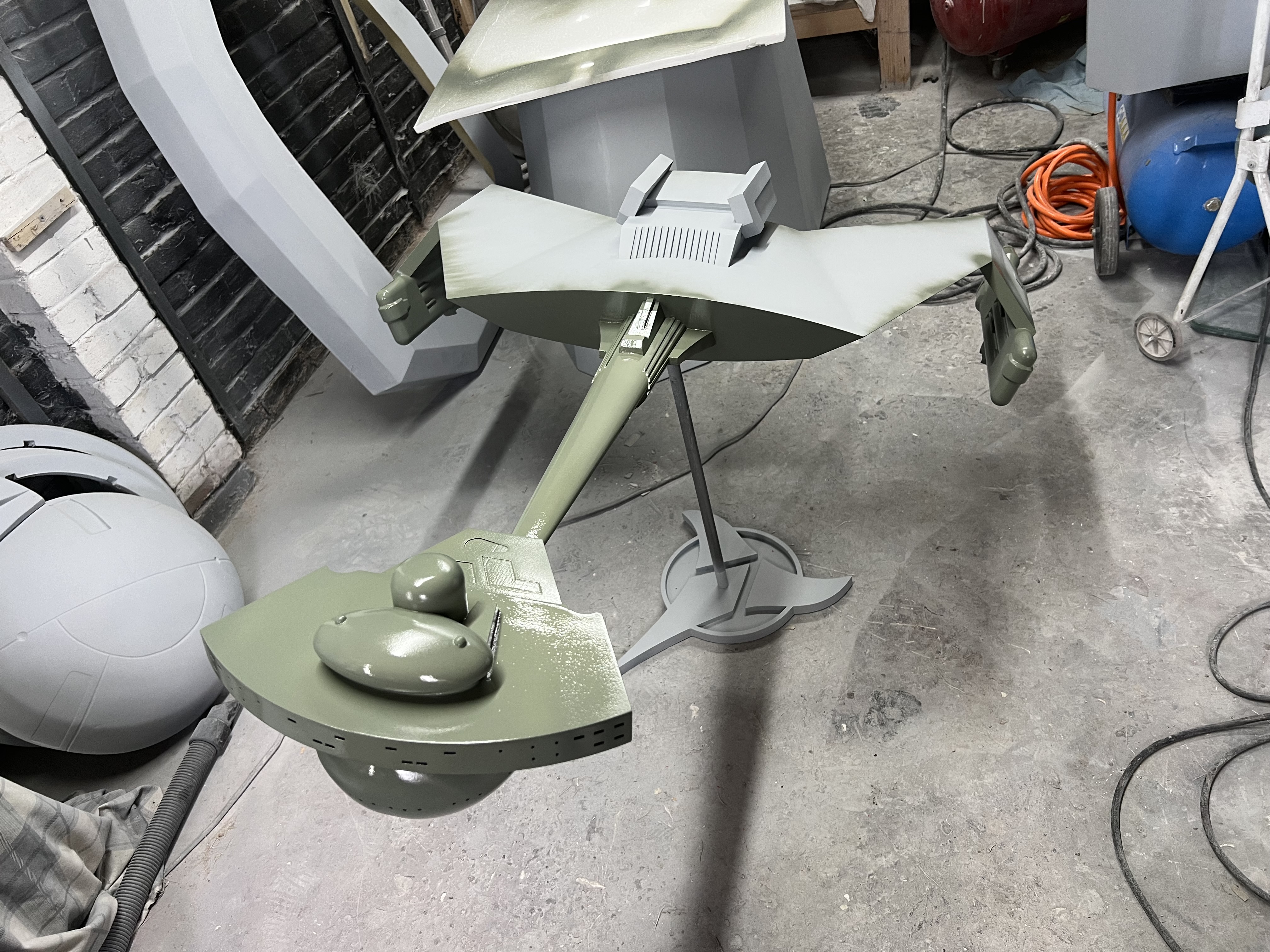

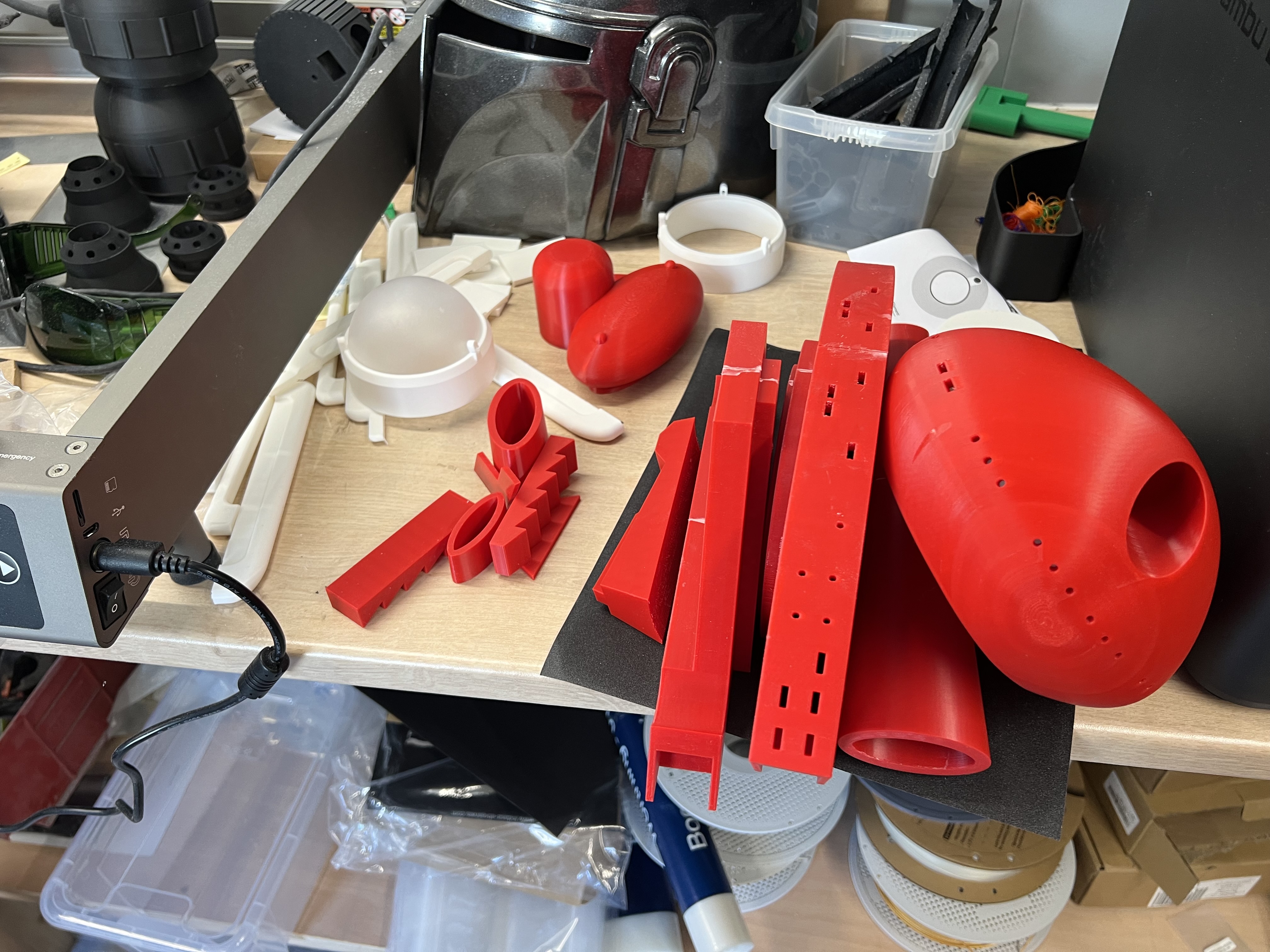

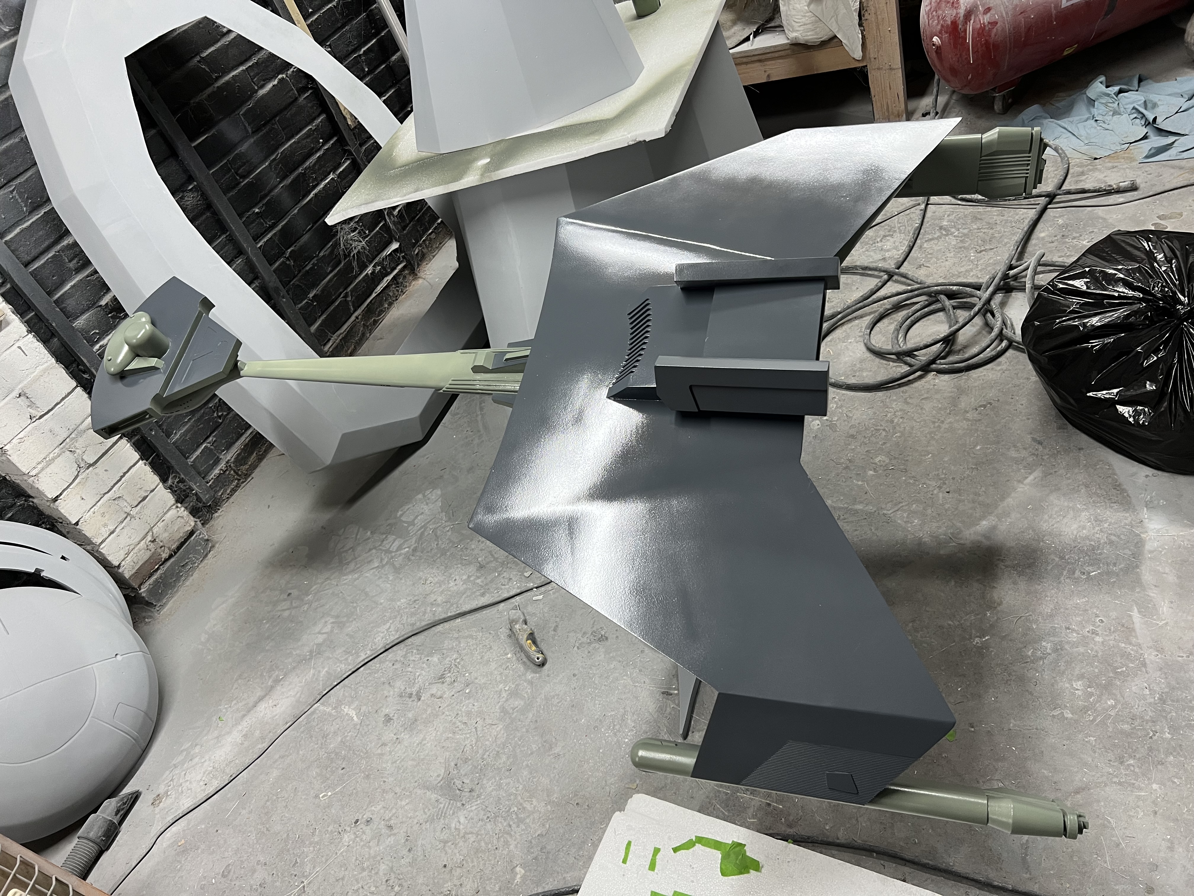

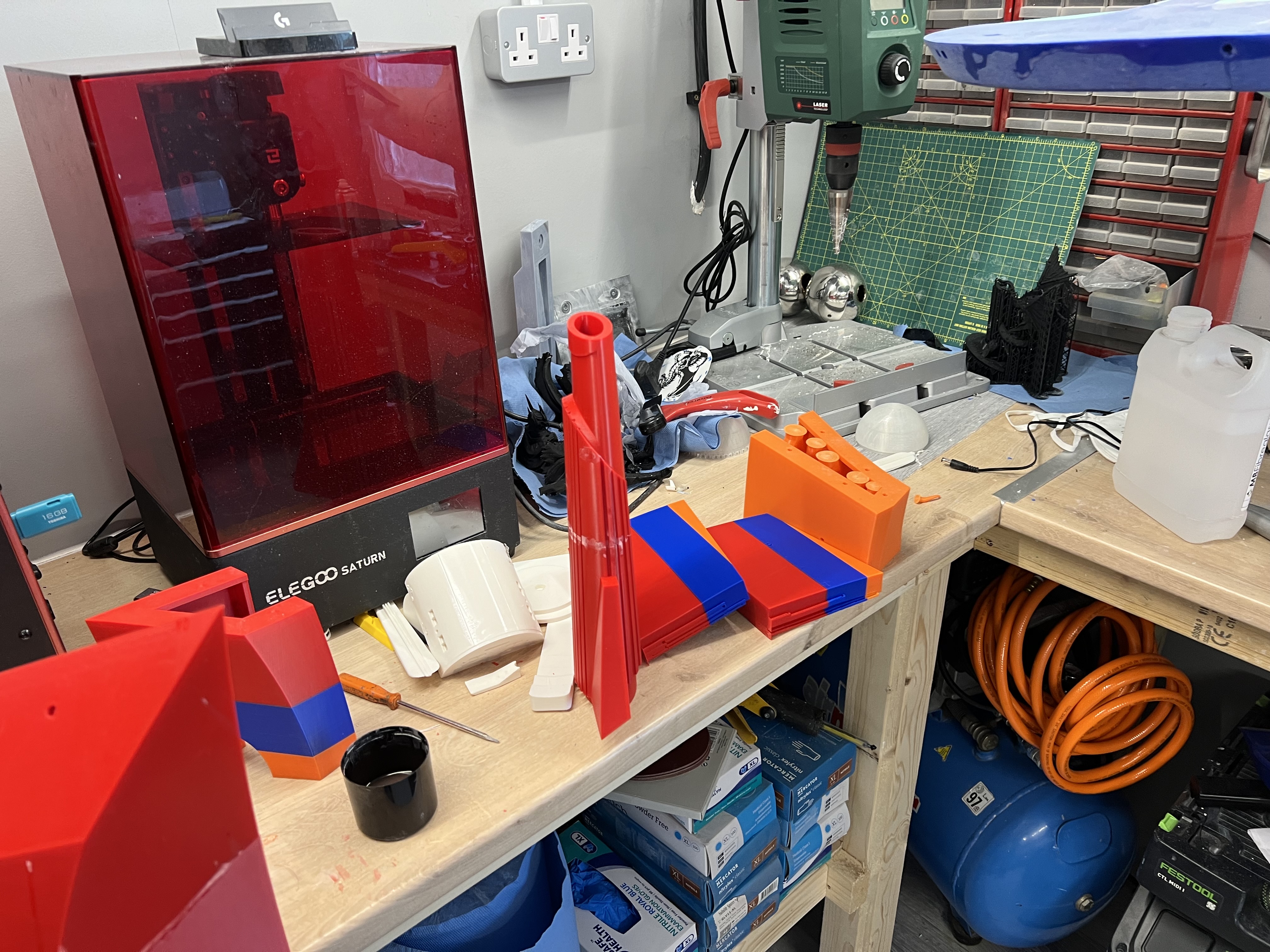

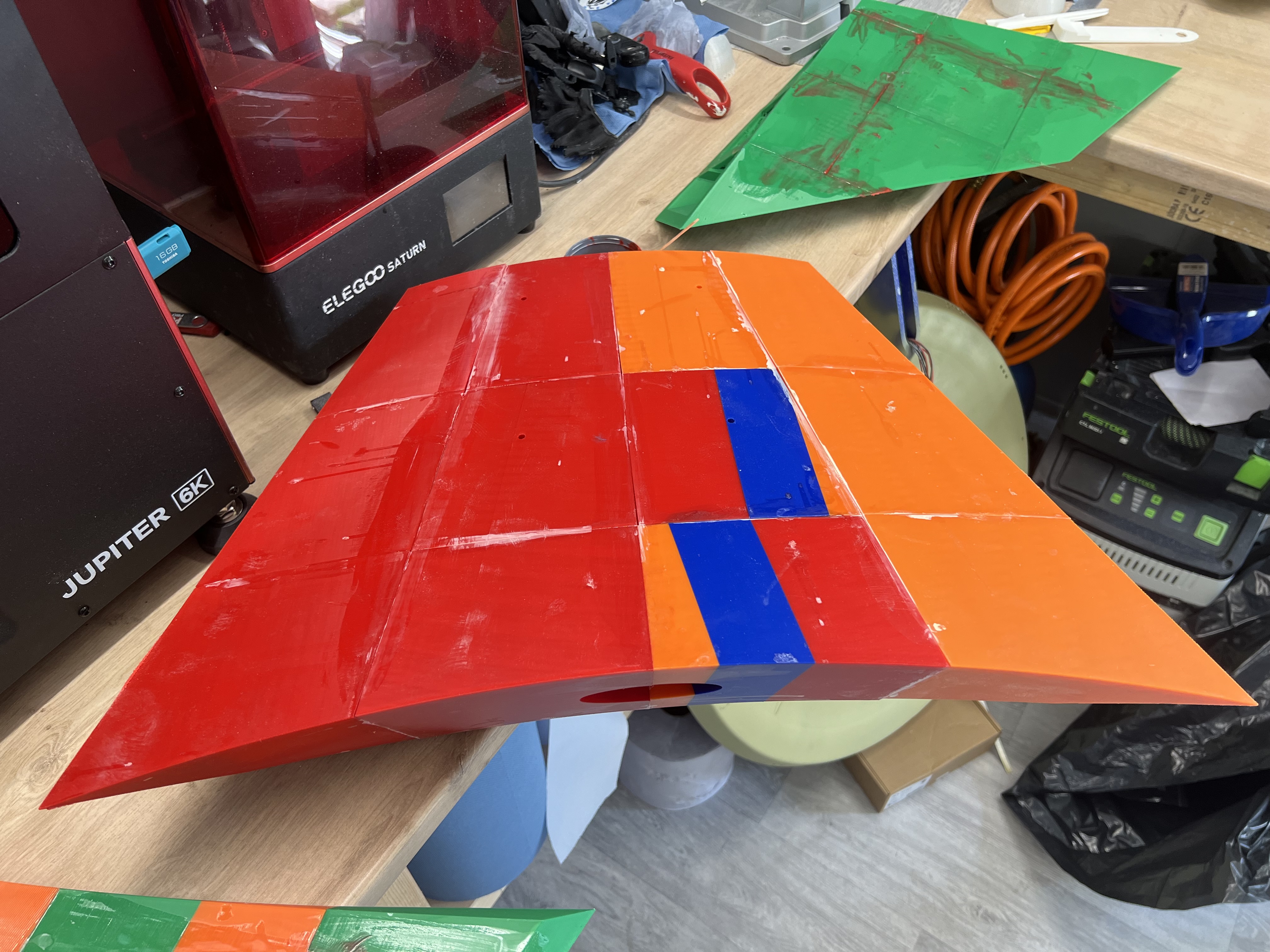

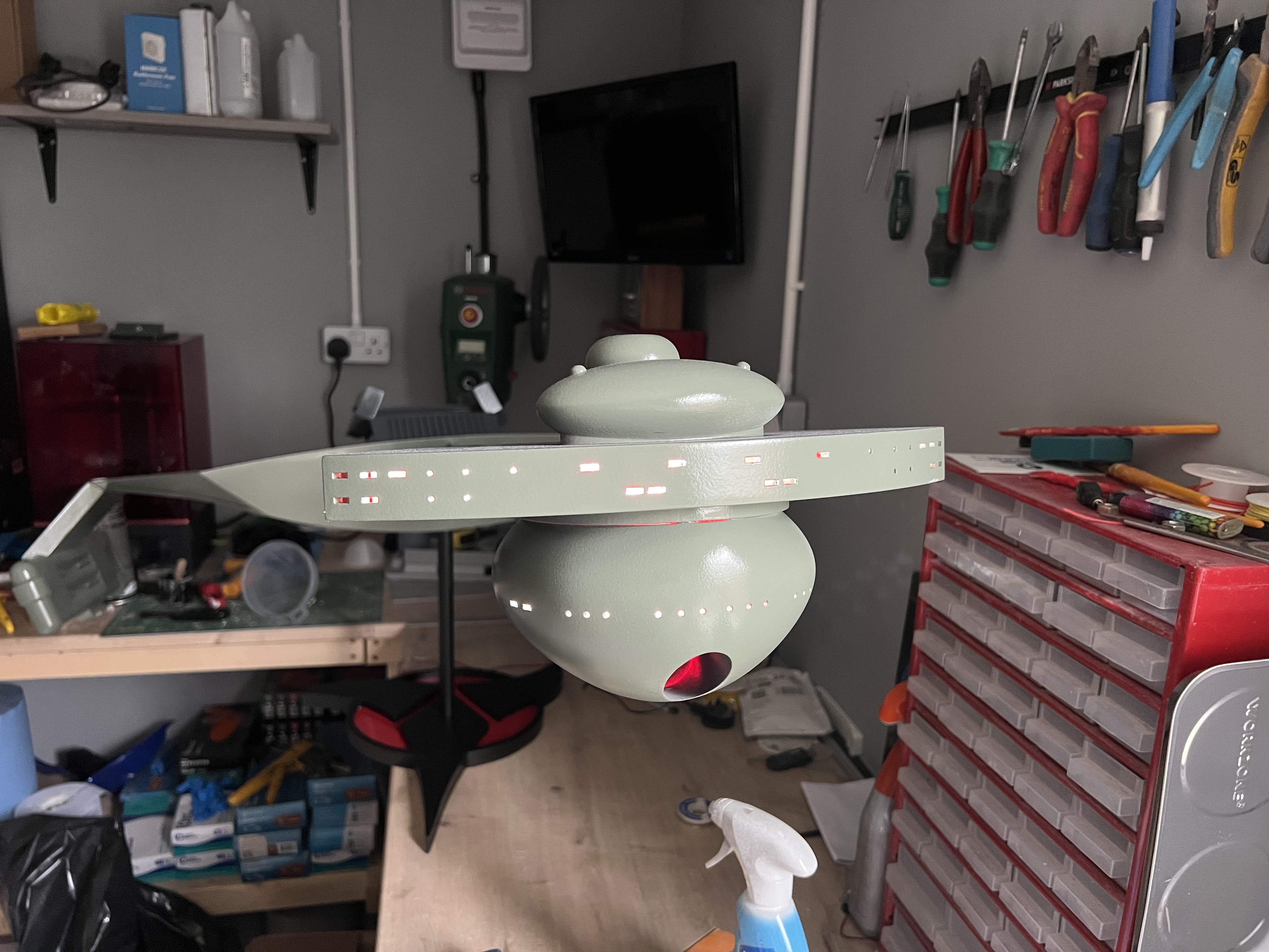

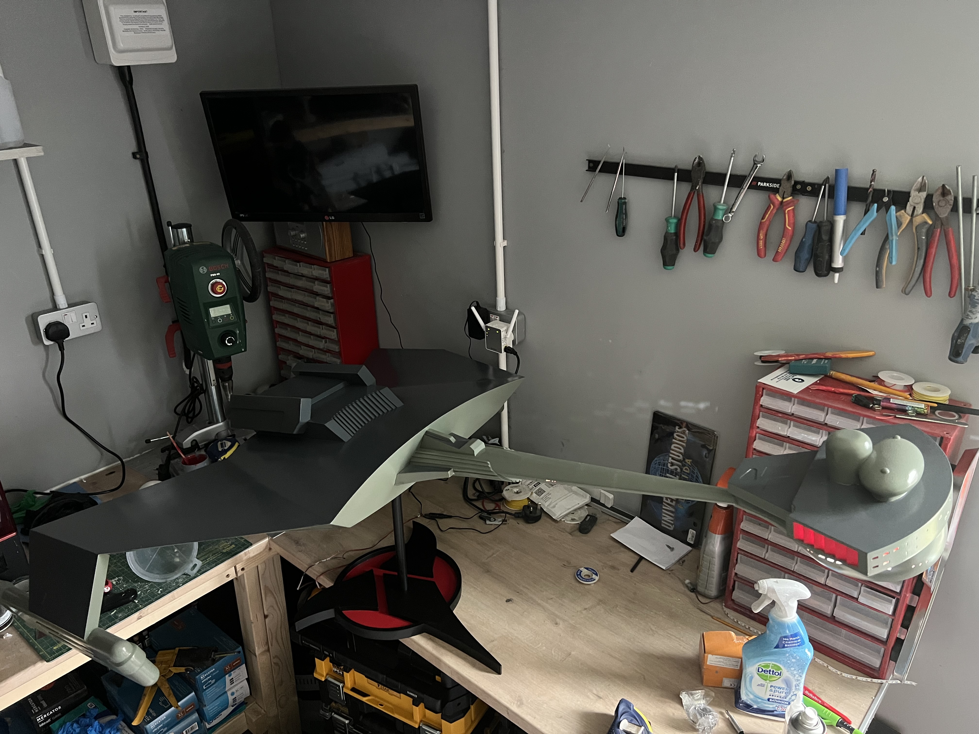

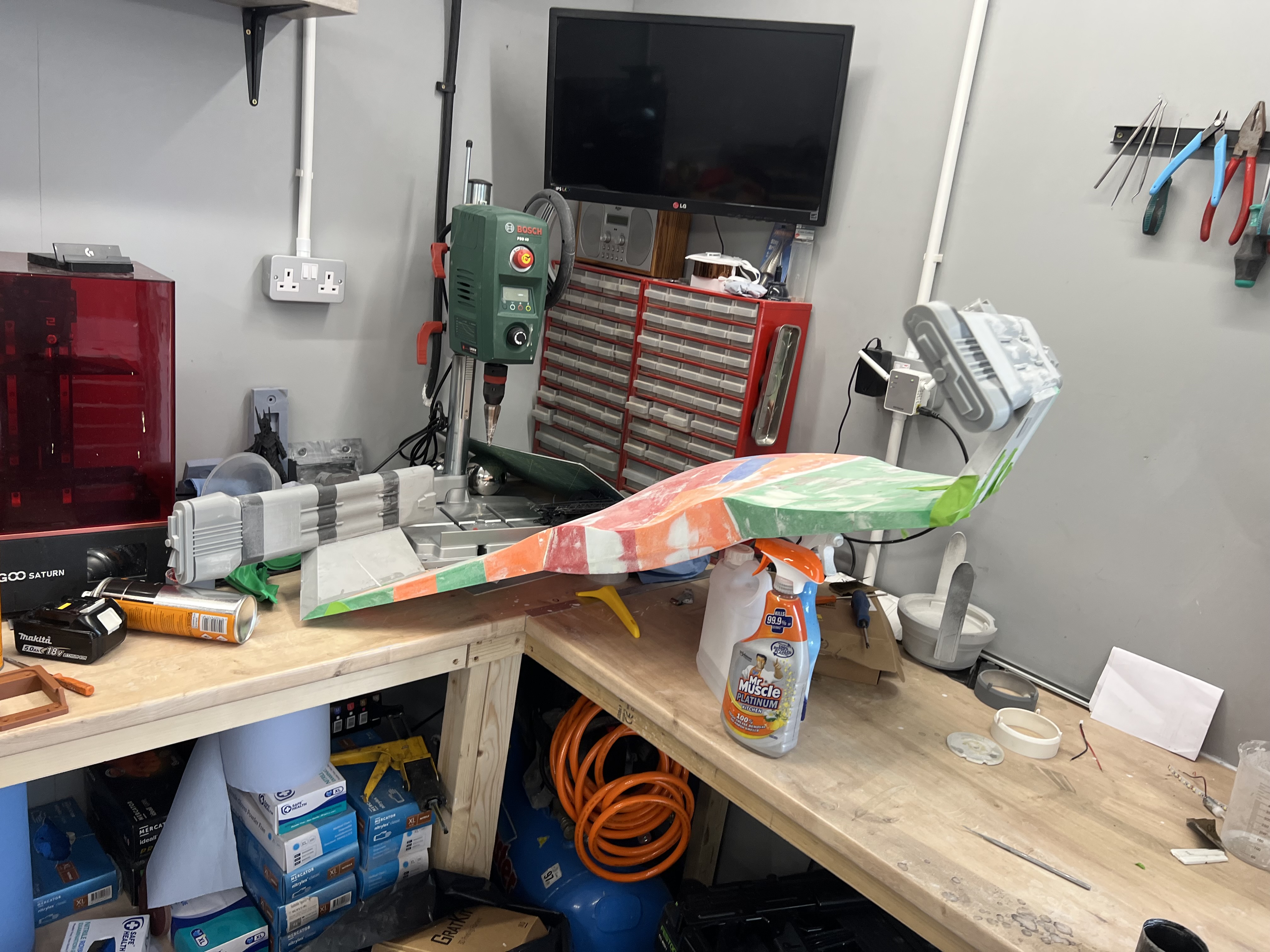

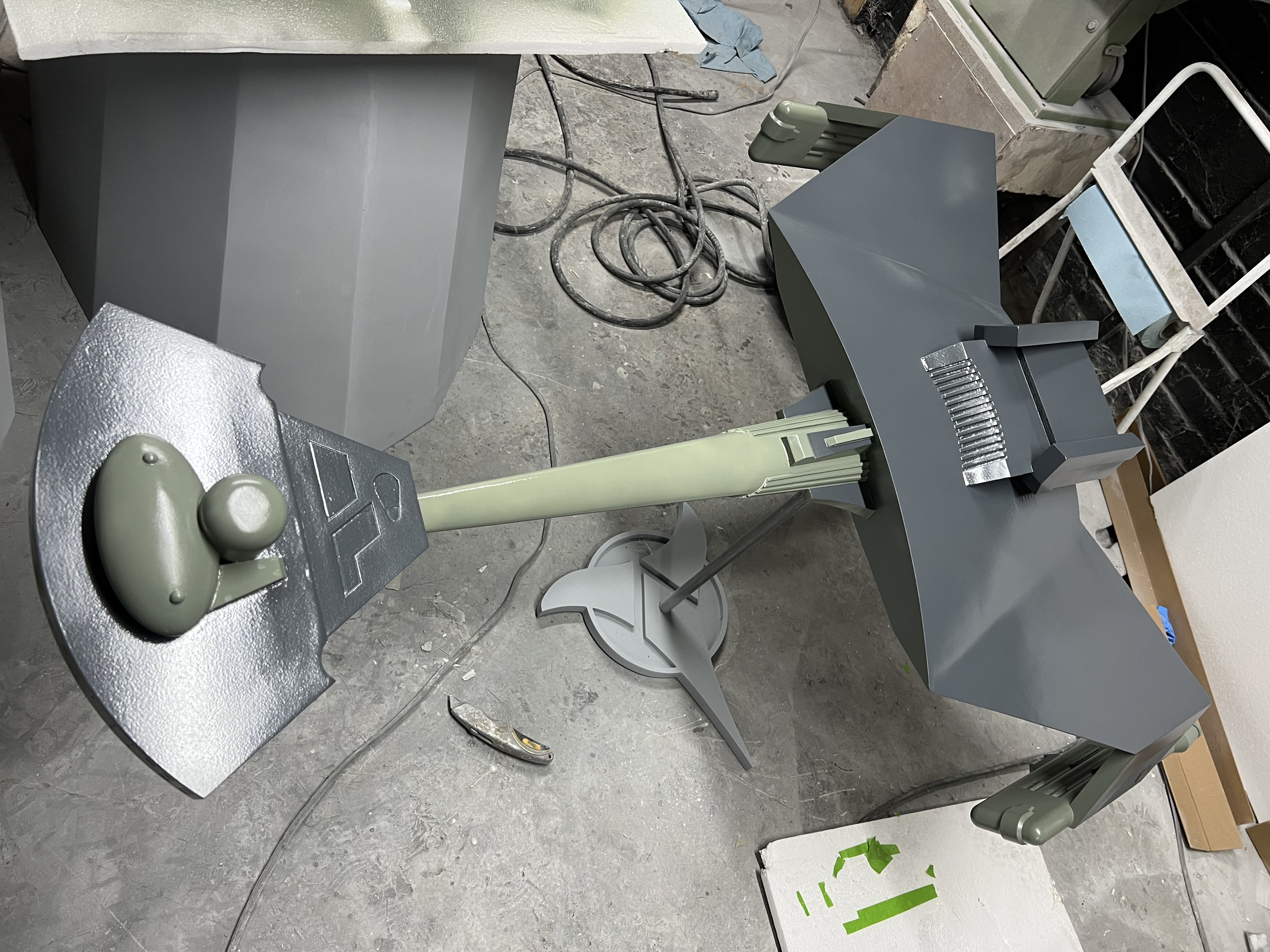

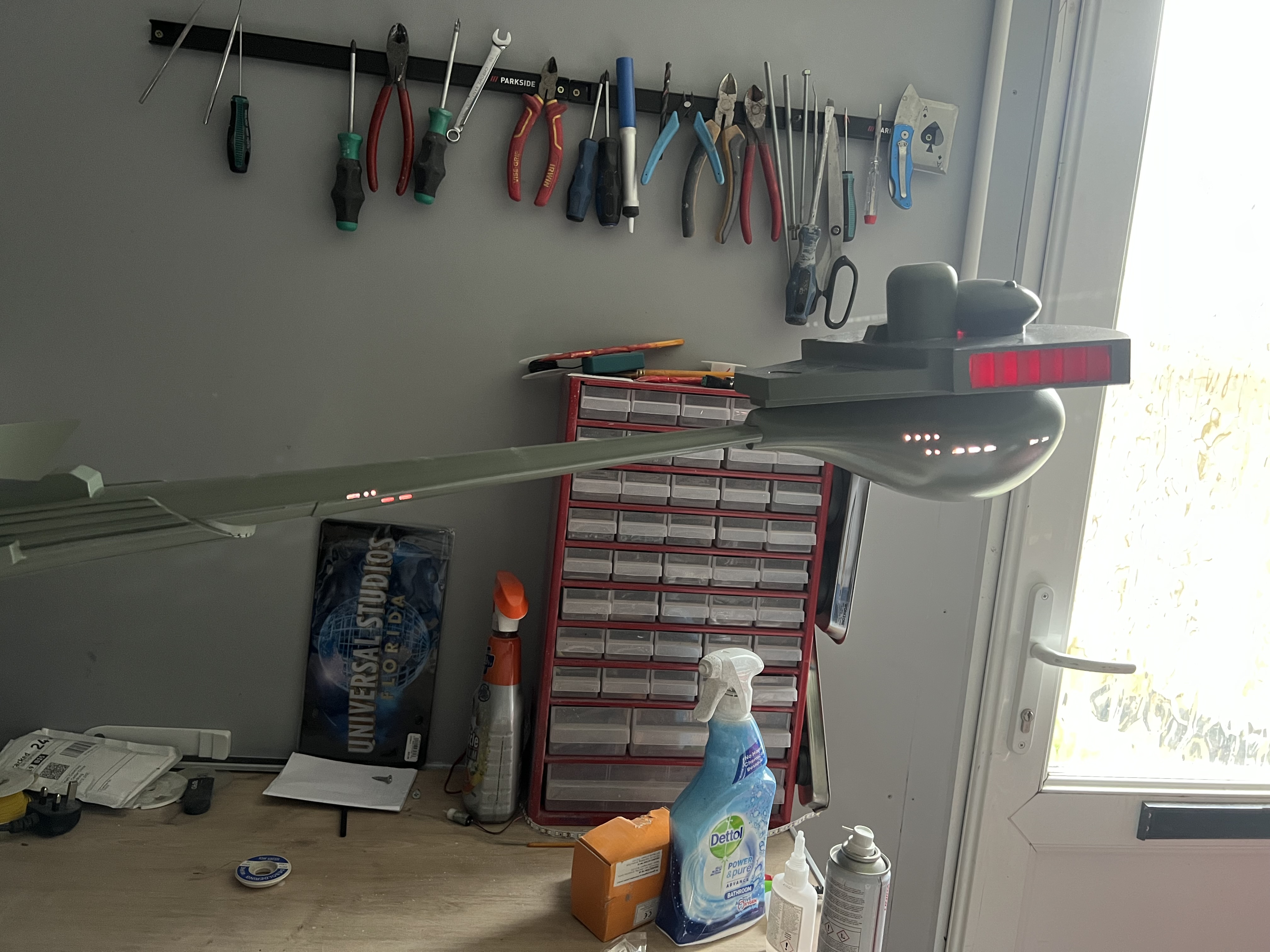

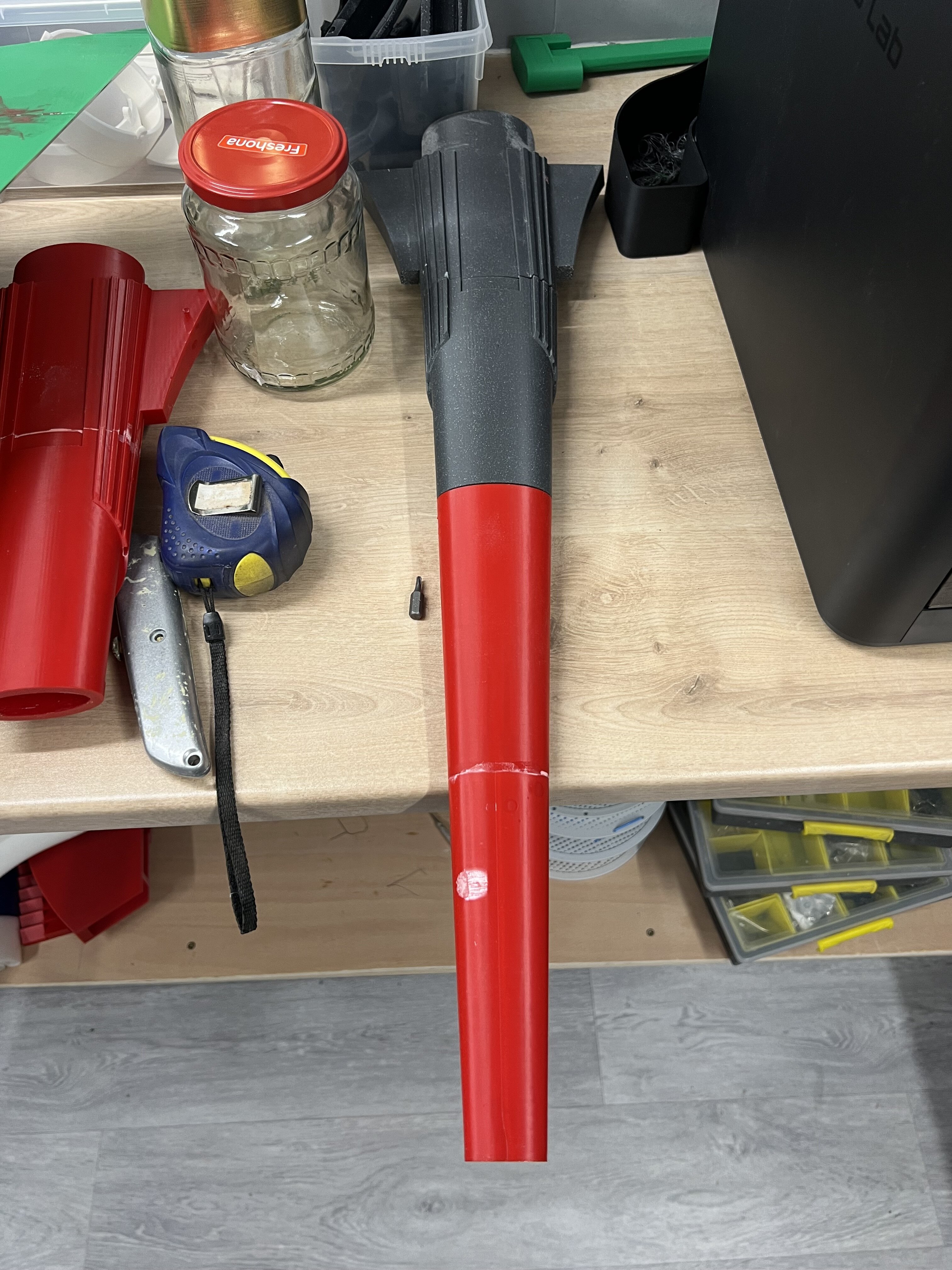

I thought I would start a thread on my Klingon D7 build.
It’s all 3d printed from Ian Hughes files from patreon. I printed it all in abs.
IMG_3387.jpegIMG_3424.jpegIMG_3425.jpegIMG_3490.jpegIMG_3489.jpeg IMG_3426.jpegIMG_3489.jpeg
I glued it together with acetone and filled gaps with acetone and abs mix.

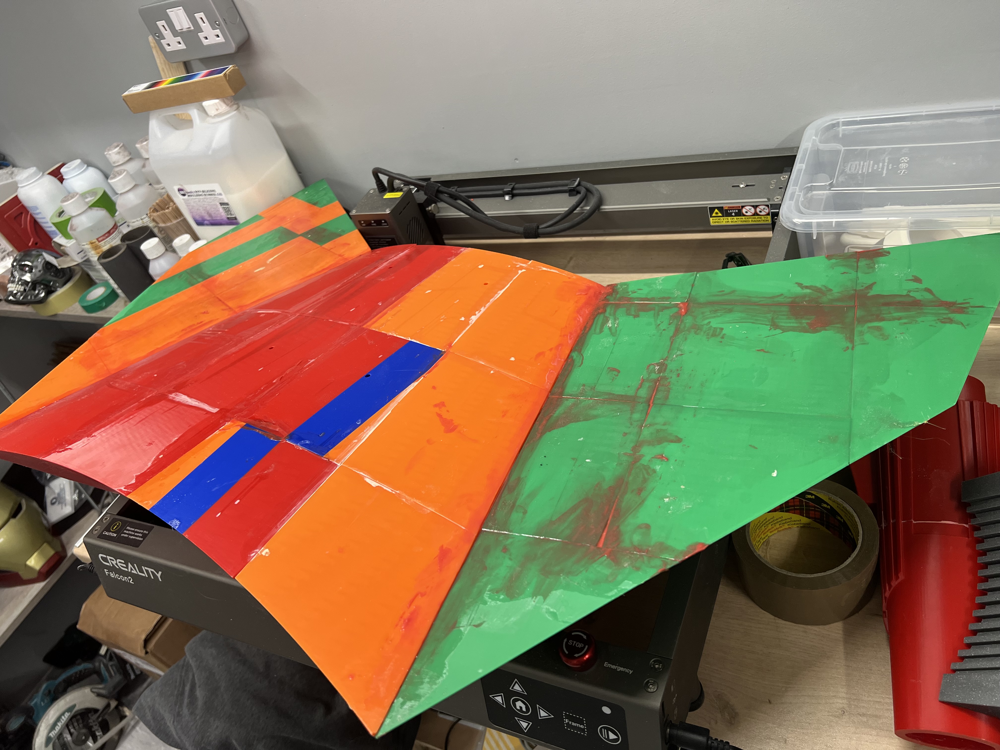

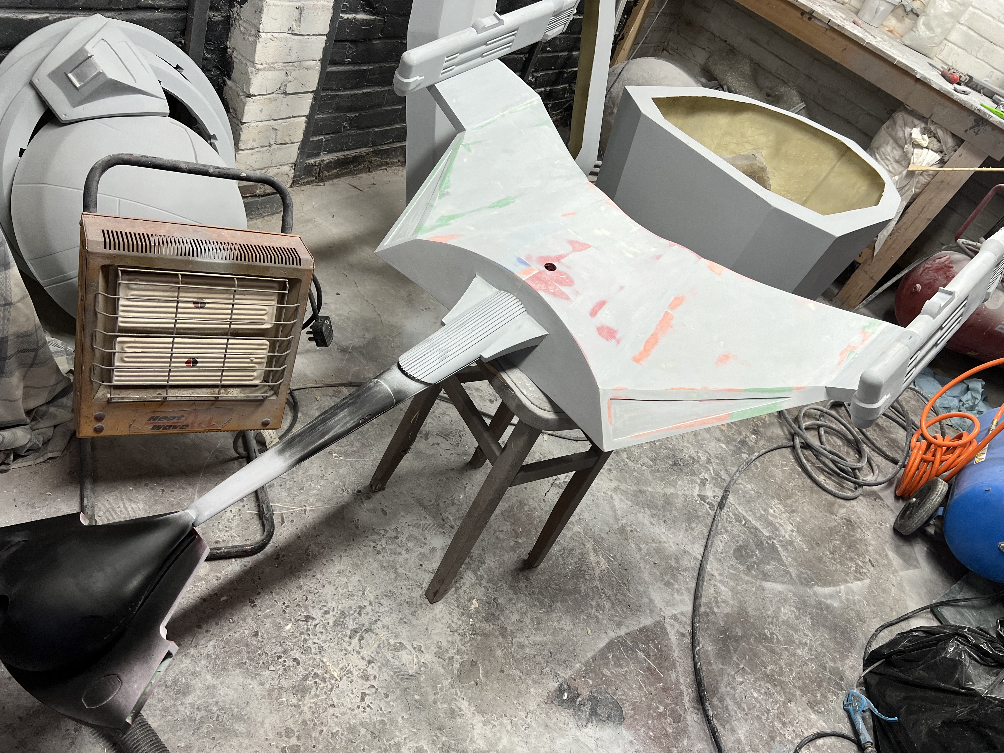

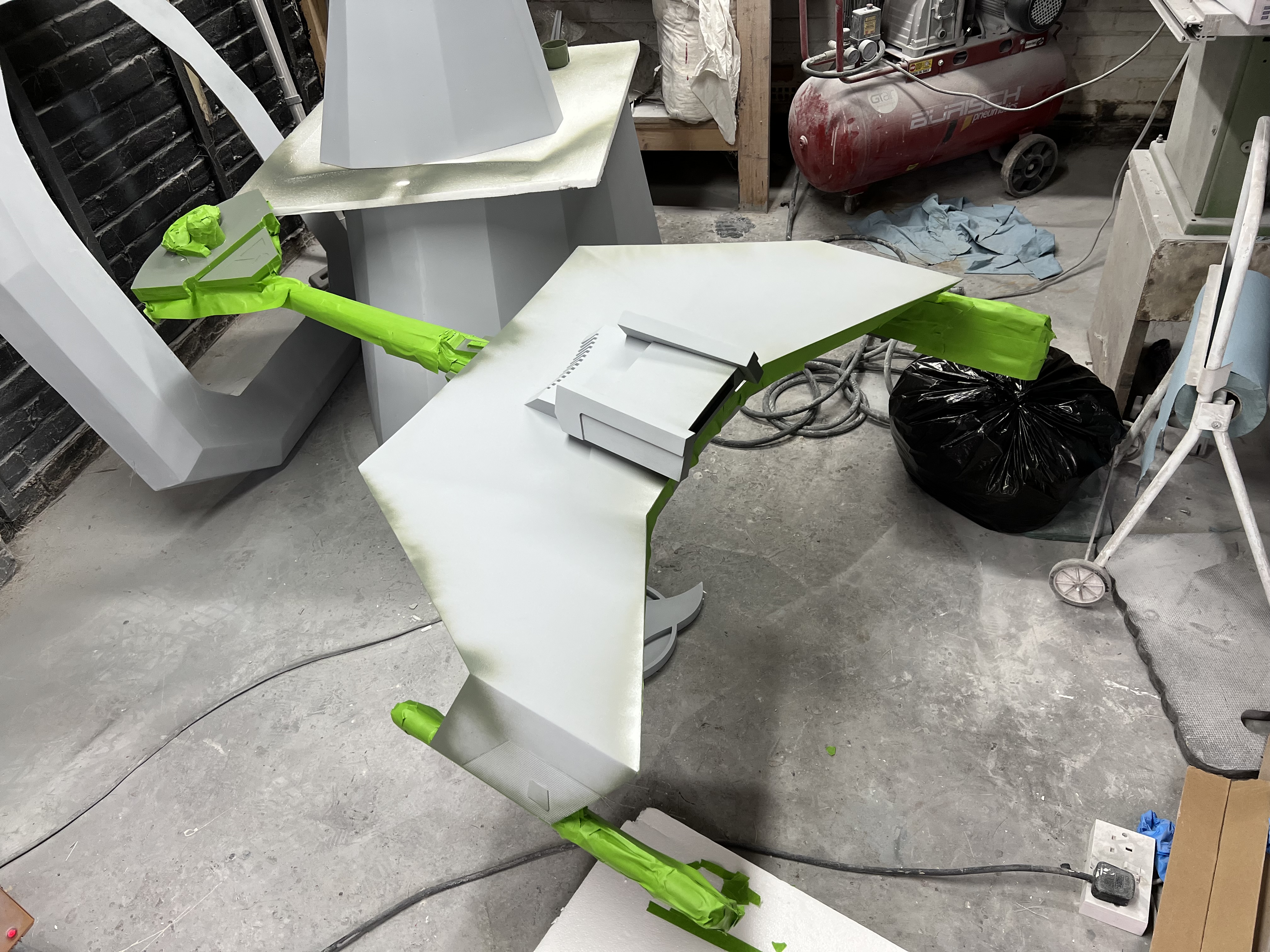

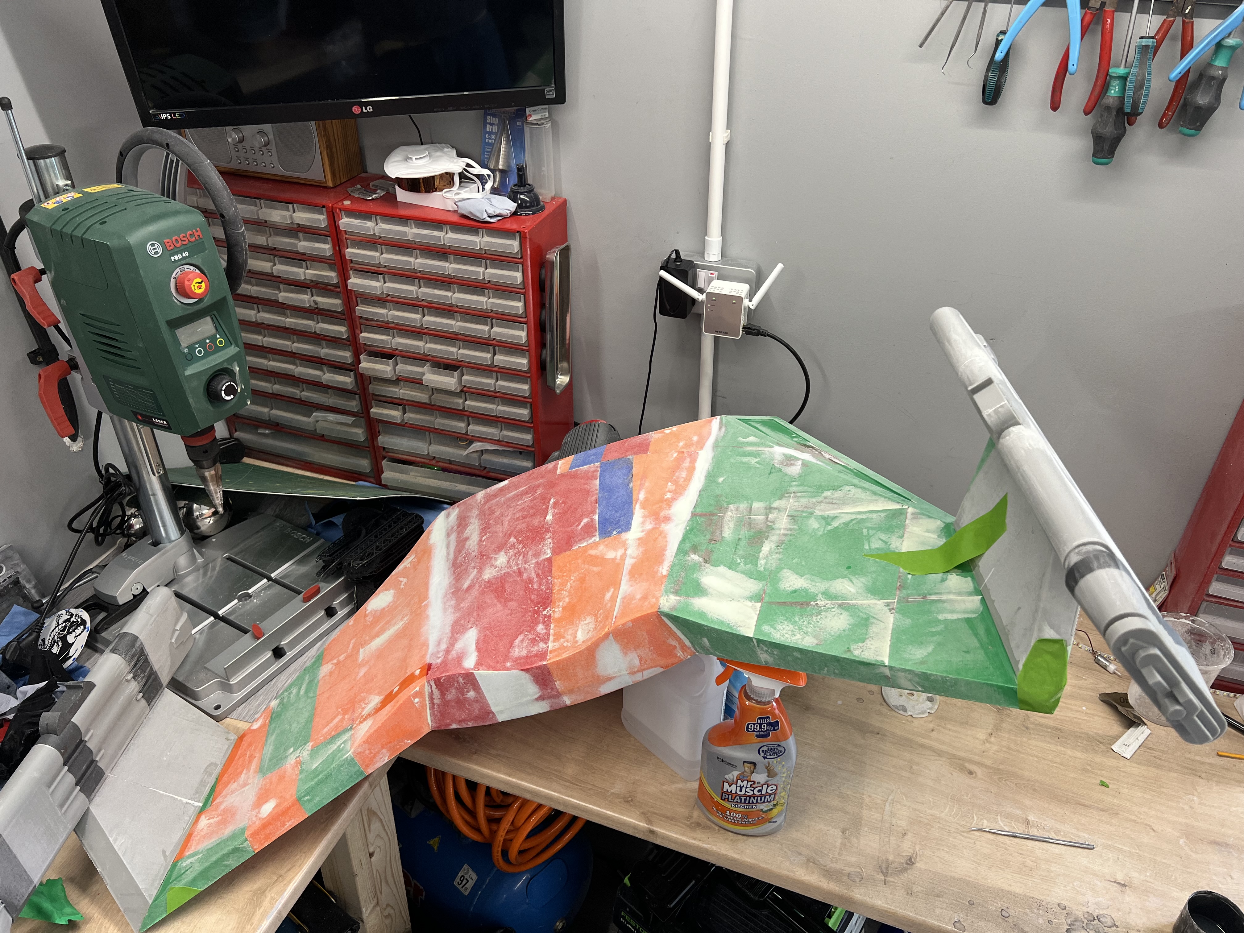

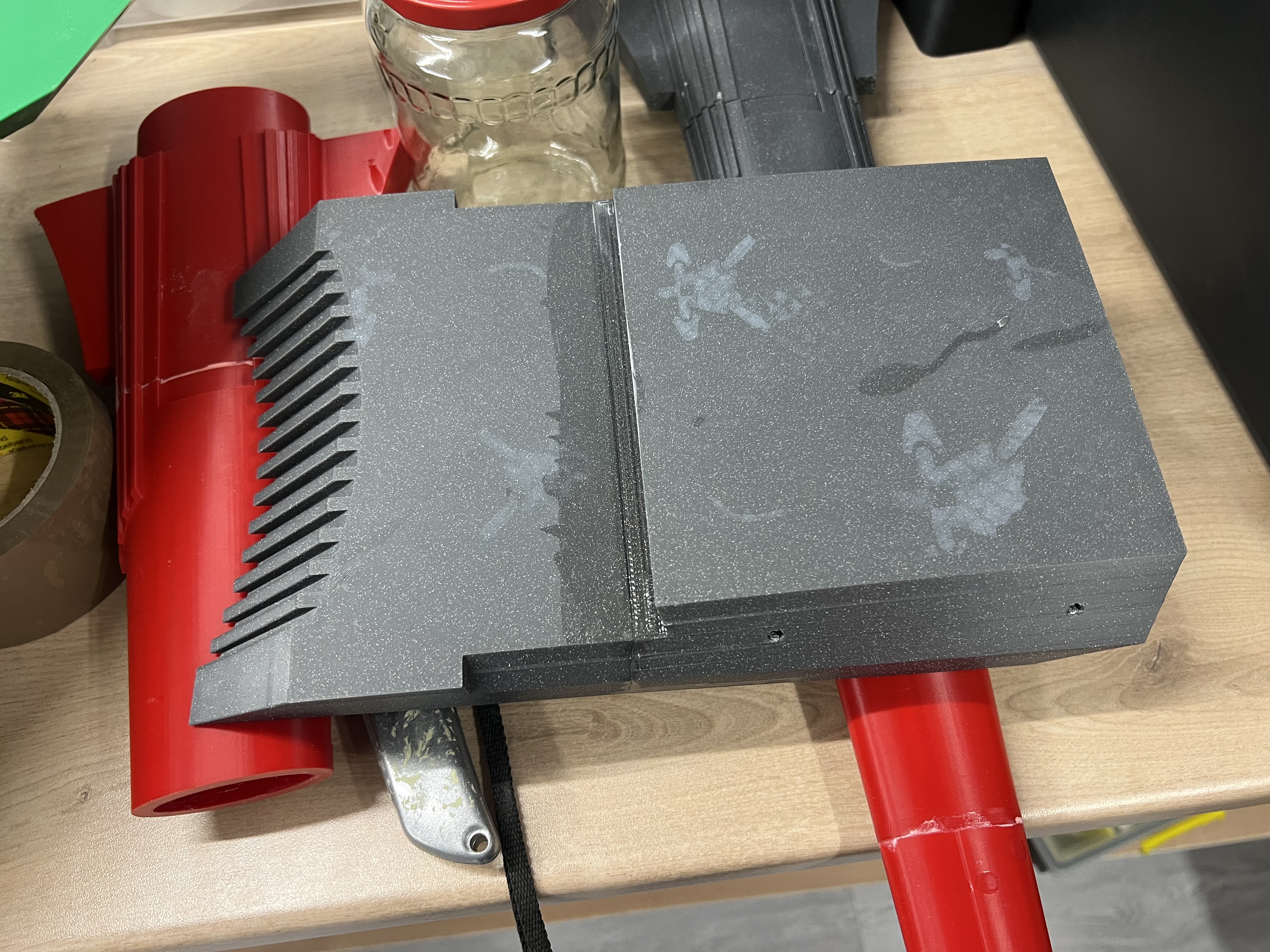

Thanks, yeah it’s all fdm. Printed on a Bambu P1S.
There’s no layer lines visible. It’s all abs.
I brushed the whole thing with acetone then loads of sanding and filling and more sanding.

I always thought that printing with ABS had it's issues. I guess not not on a Bambu P1S.
TazMan2000

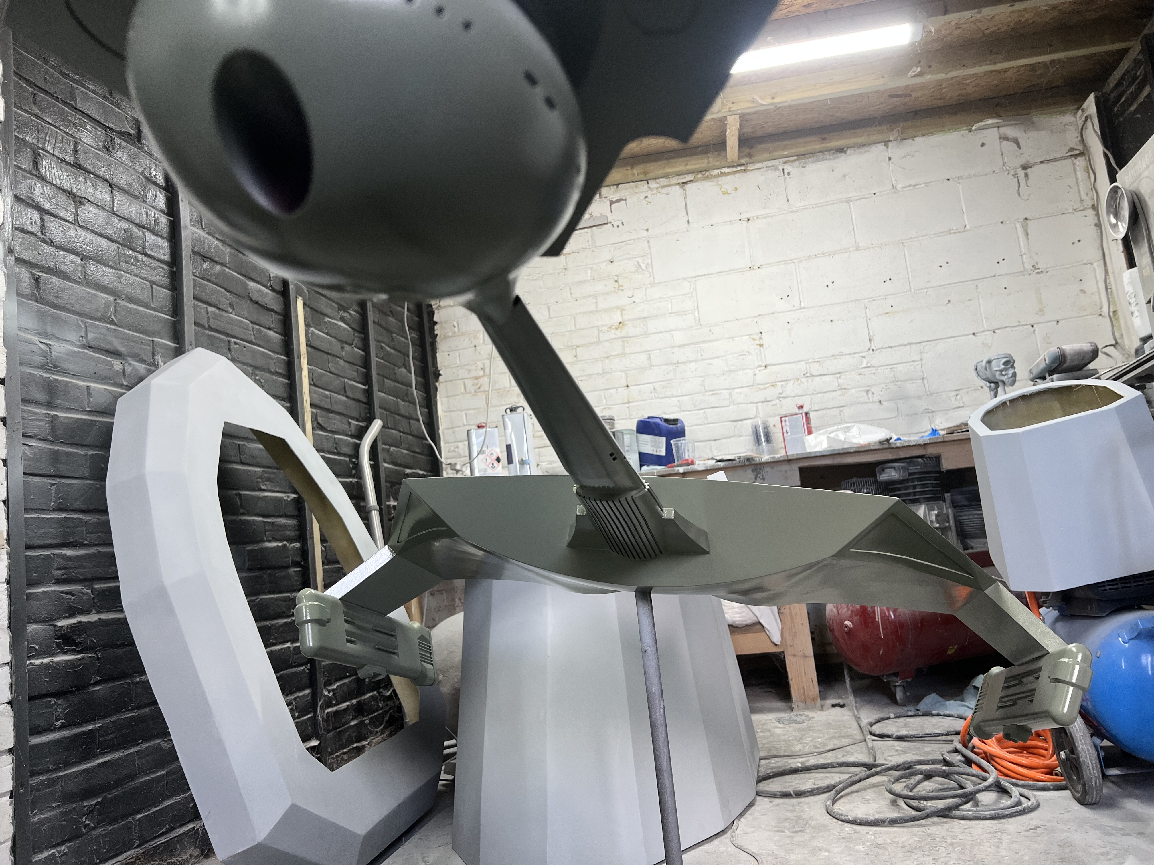

It can be tricky with warping. As long as all the cooling is turned off and the printer is enclosed it can be ok.
There was a little warping on the earlier sections before I realised an internal fan was coming on, but due to the simple ish design of the k7 it was easy enough to fill.
