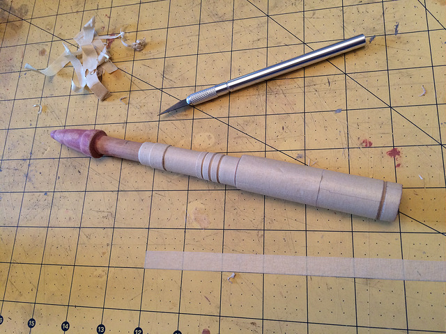

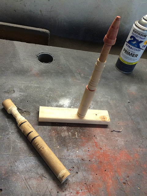

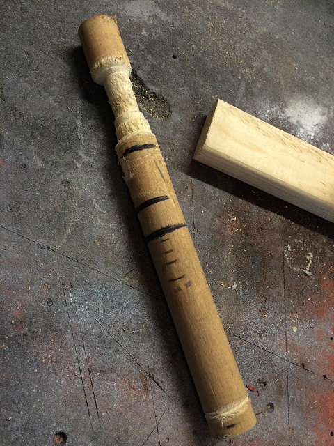

I originally tried to shape the piece on a makeshift lathe, but it wasn't precise enough. The new piece is made from a dowel wrapped in different sizes of masking tape.

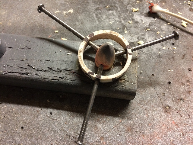

The tip is made from a small dowel shaped with sand paper and secured into a piece of PVC with penny nails.
The next step is to Dremel off the ends of the nails and secure the tip to the handle.

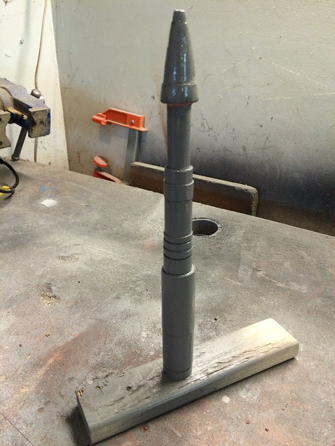

After lots of sanding, and building a new tip, I laid down several coats of gloss black.
