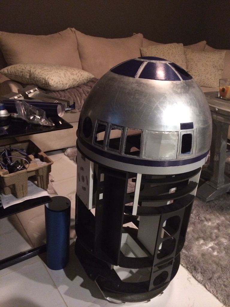

So... I am new to all this as of now all I have been up to is building 1:1 R2 droid.... but i want to start making replica armor..ect.. I have been looking at alot of stuff people are doing on here and the work is great ! However.... I have noticed that with the foam builds after they are painted there still is a look that it is foam.... has anyone used car wrap to do some work in place of painting yet? I have been experimenting with it on my droid and it looks like real " steel" or whatever you are trying to go for ... Was thinking of trying to transfer that to this armor building somehow.. any thought? :)

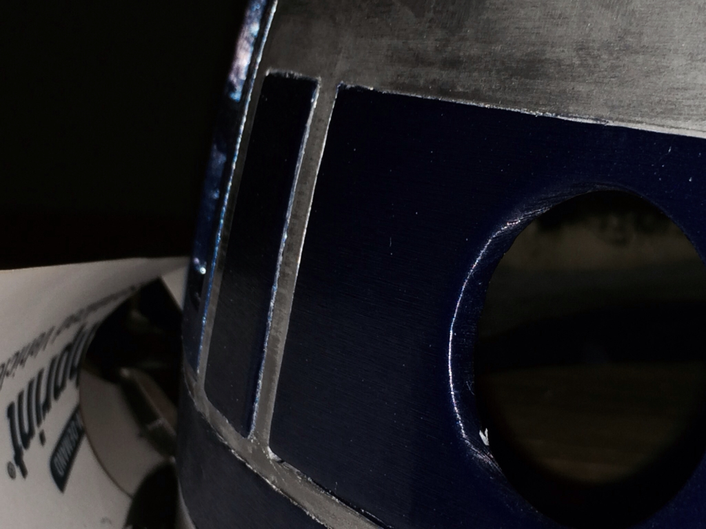

So I have been trying the car wrap from 3m ( 1080) and can't tell from pics but it looks like metal and is easy... However on domes.. Ect bit more challenging ImageUploadedByTapatalk1390481610.517558.jpgImageUploadedByTapatalk1390481640.860252.jpg

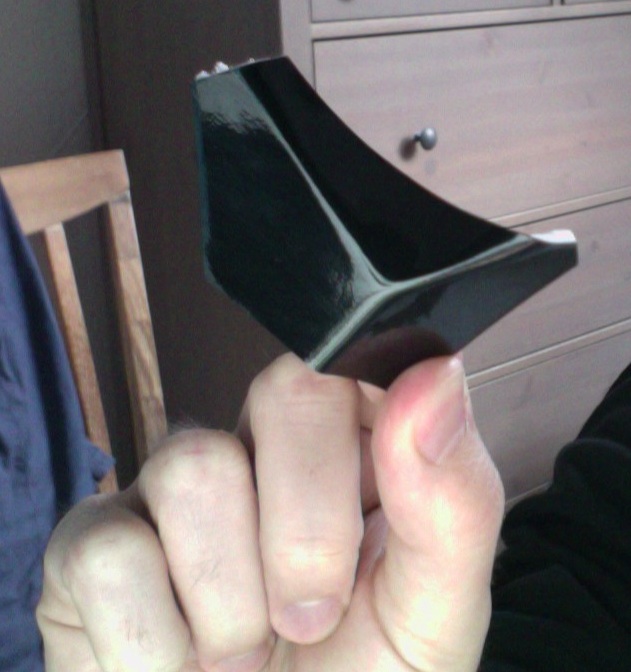

Here is a picture of one of my tries to find an alternative to plastic coating the foam suit. It does work, but:
1. The foam has to be sealed!
2. The best way is to apply it to the foam before you cut it or bend it.
3. The results are not as nice if you try to wrap a sealed, assembled piece because the foam stays flexible. Because of that you can't pull the wrap around your object like you could if it would be a rigid piece. You always run the risk of warping the foampiece.
4. If you apply the wrap on a sealed sheet of foam before you cut the templates out and assemble them there is no margin for error while glueing the pieces together. Every unclean seam will become that much more visible.

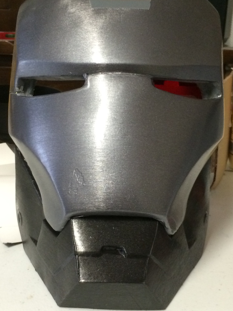

The 3M 1080 auto wrap comes in alot of colors and bends and twists very easy when you heat it, however the surface must be sanded smooth as everything will show. I have tested the brushed aluminum color and put rub & buff silver leaf on it and have to say it looks just like brushed aluminum.. I am thinking that the other colors that are available will have similar properties depending on what one is trying to do.. Amazon.com sells the 3M wrap for a decent price
