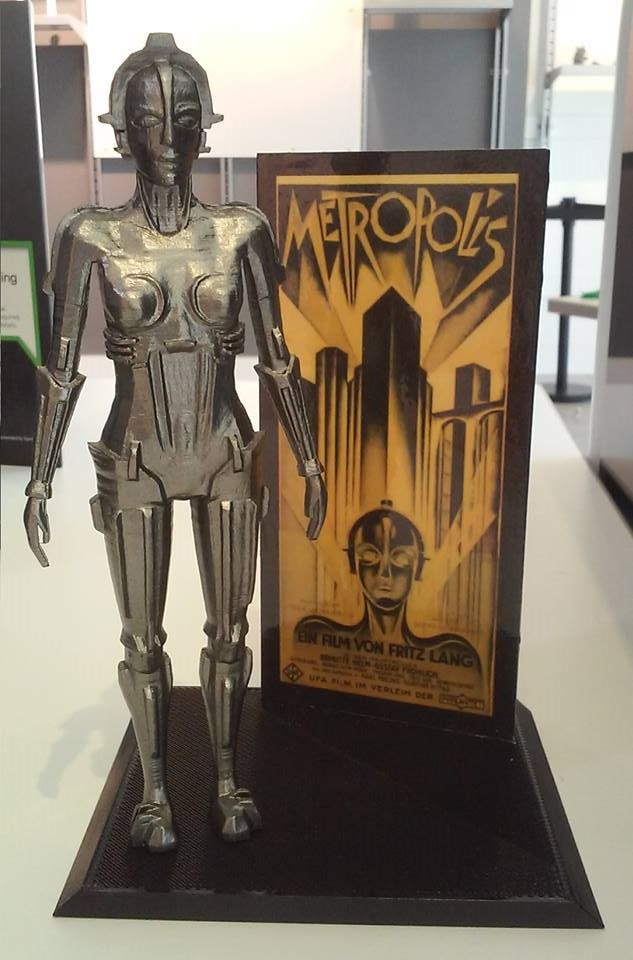

Some of the printed stuff I have done.
From a SLA master.

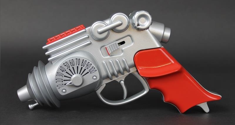

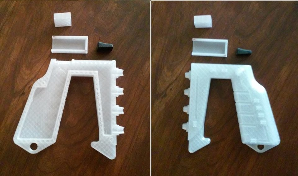

Space 1999 stungun from a file I drew.

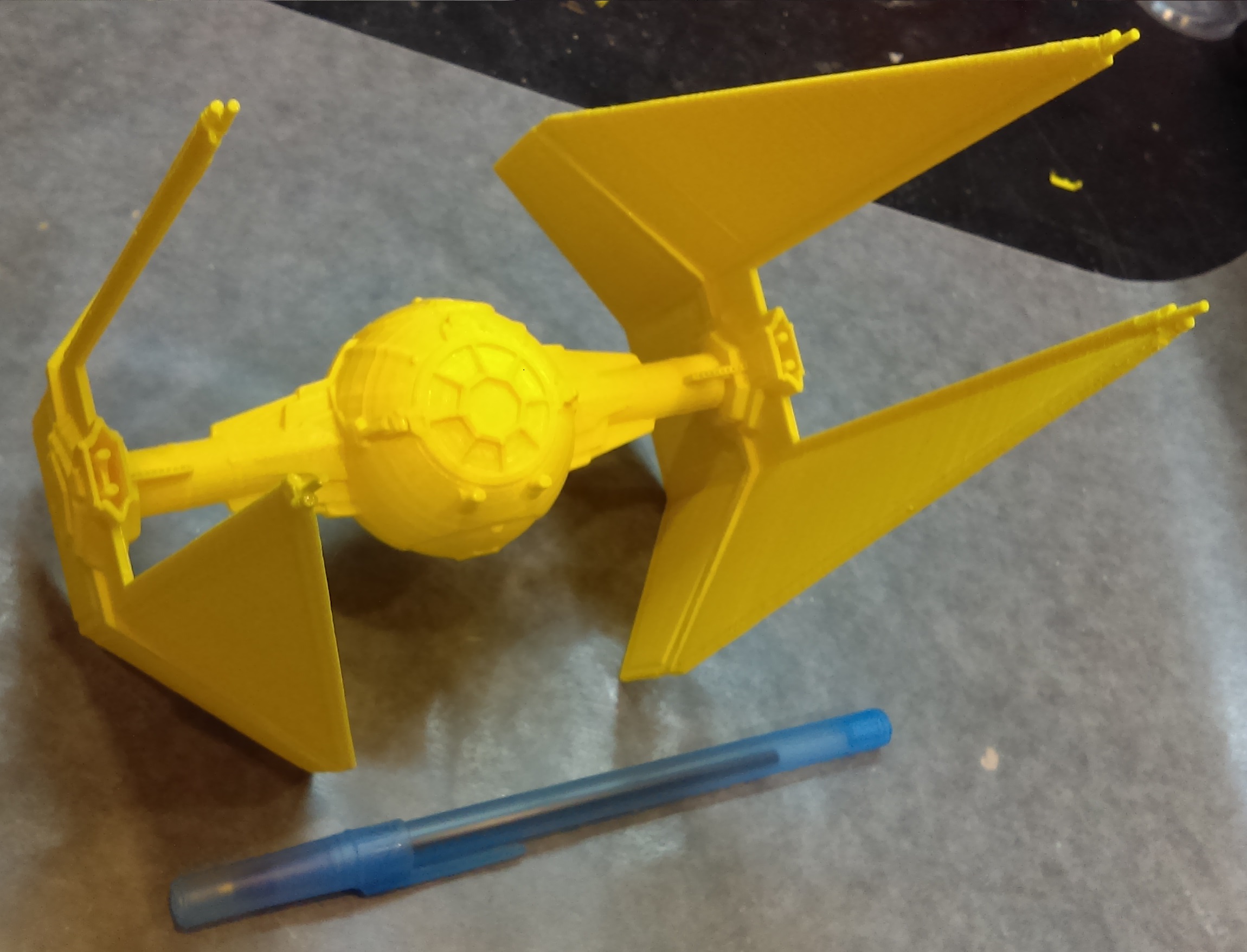

From a makerbot. Got the file off of thingaverse.
Printed on a makerbot. File from thingaverse.
