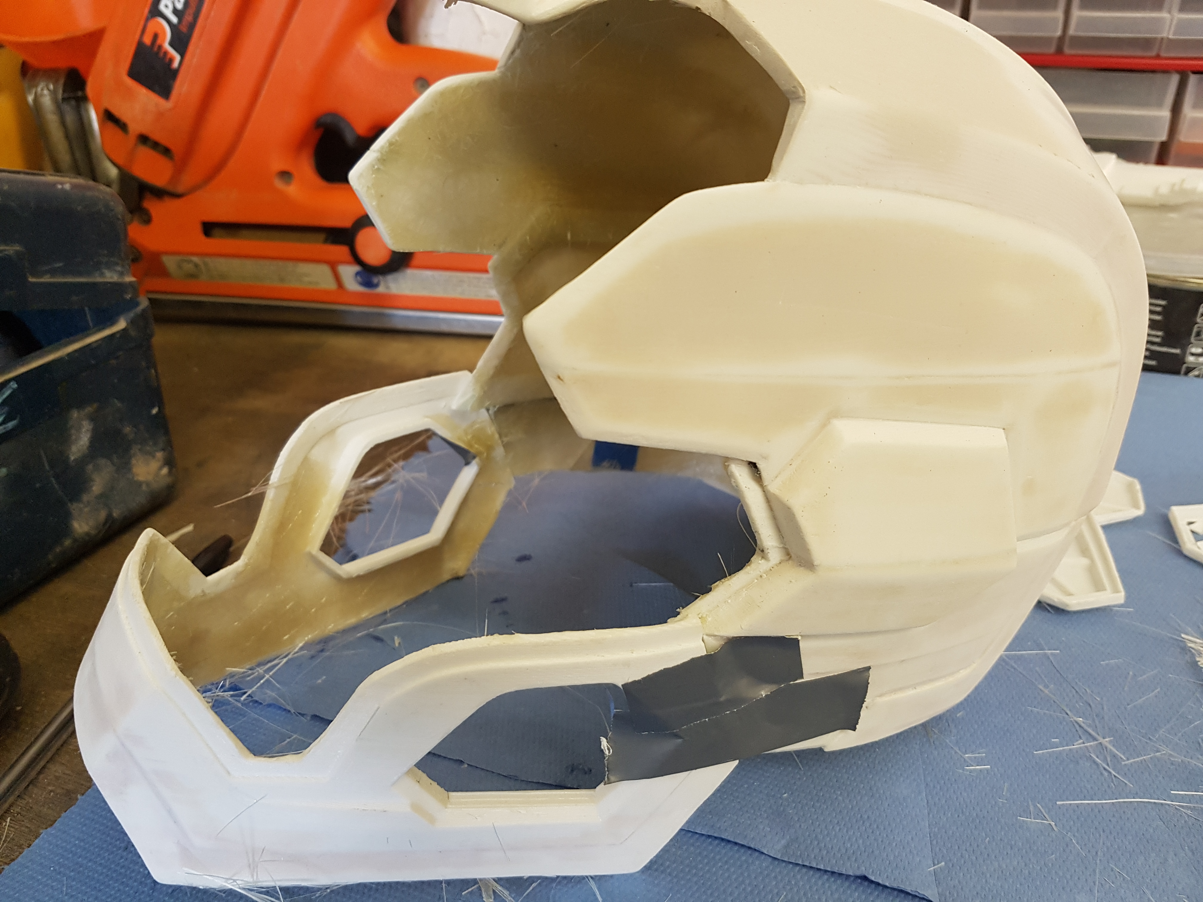

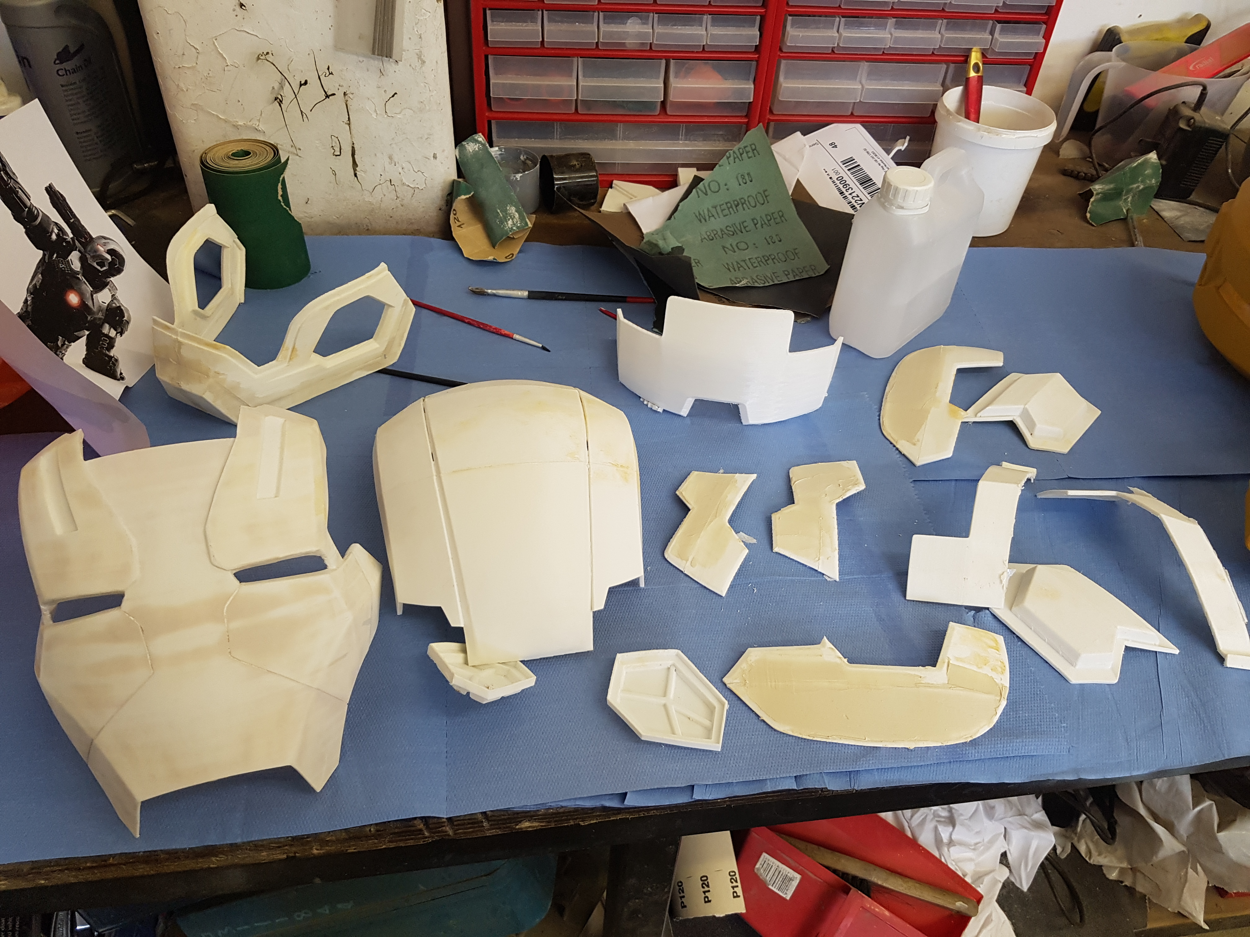

I decided to start with the helmet.
I split the pieces up and printed them.
I started sanding and filling but wasn't happy as i had lost the two grooves in the top.
Decided to reprint the whole thing.

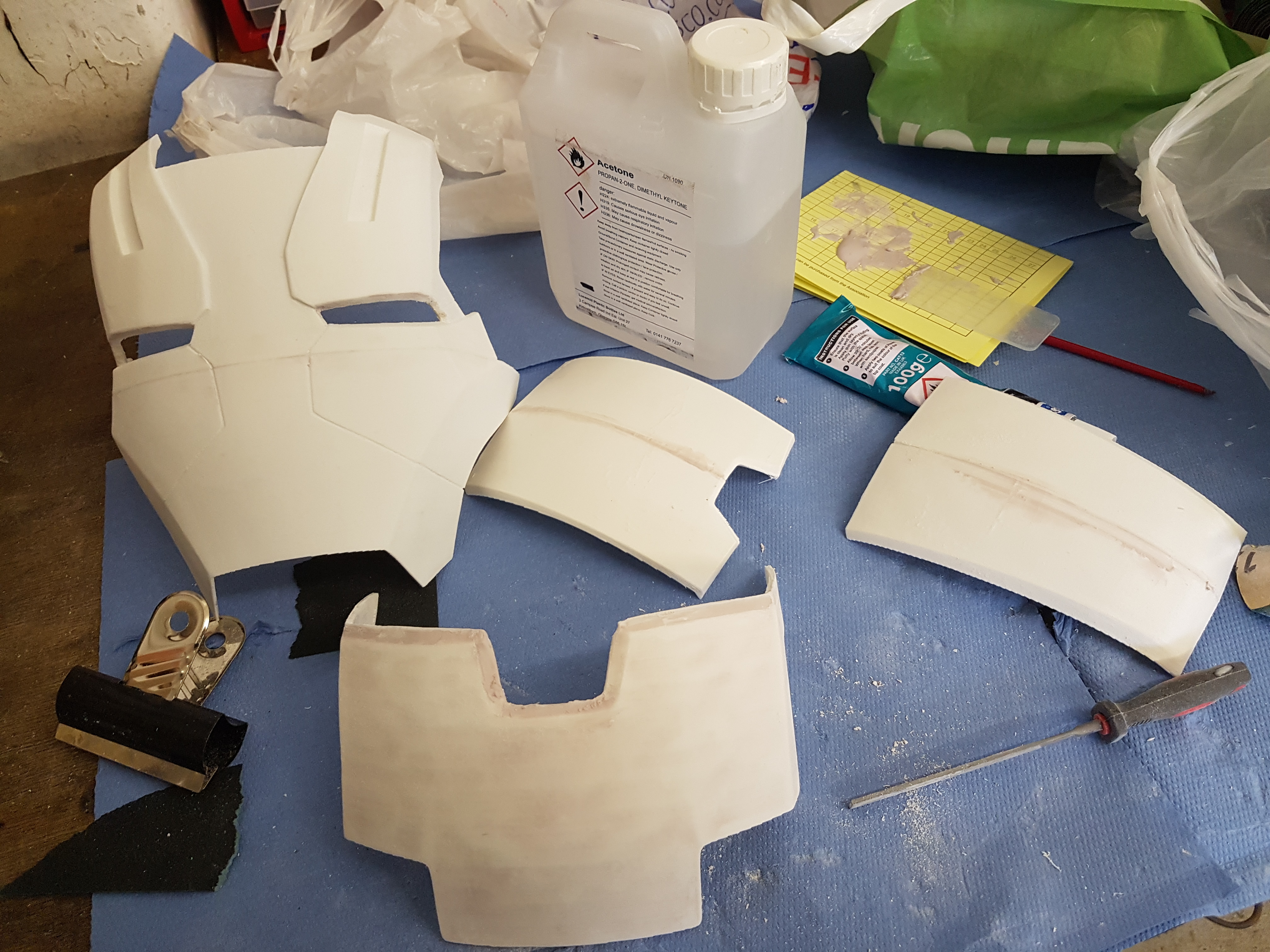

Fibreglassed the inside for strength.

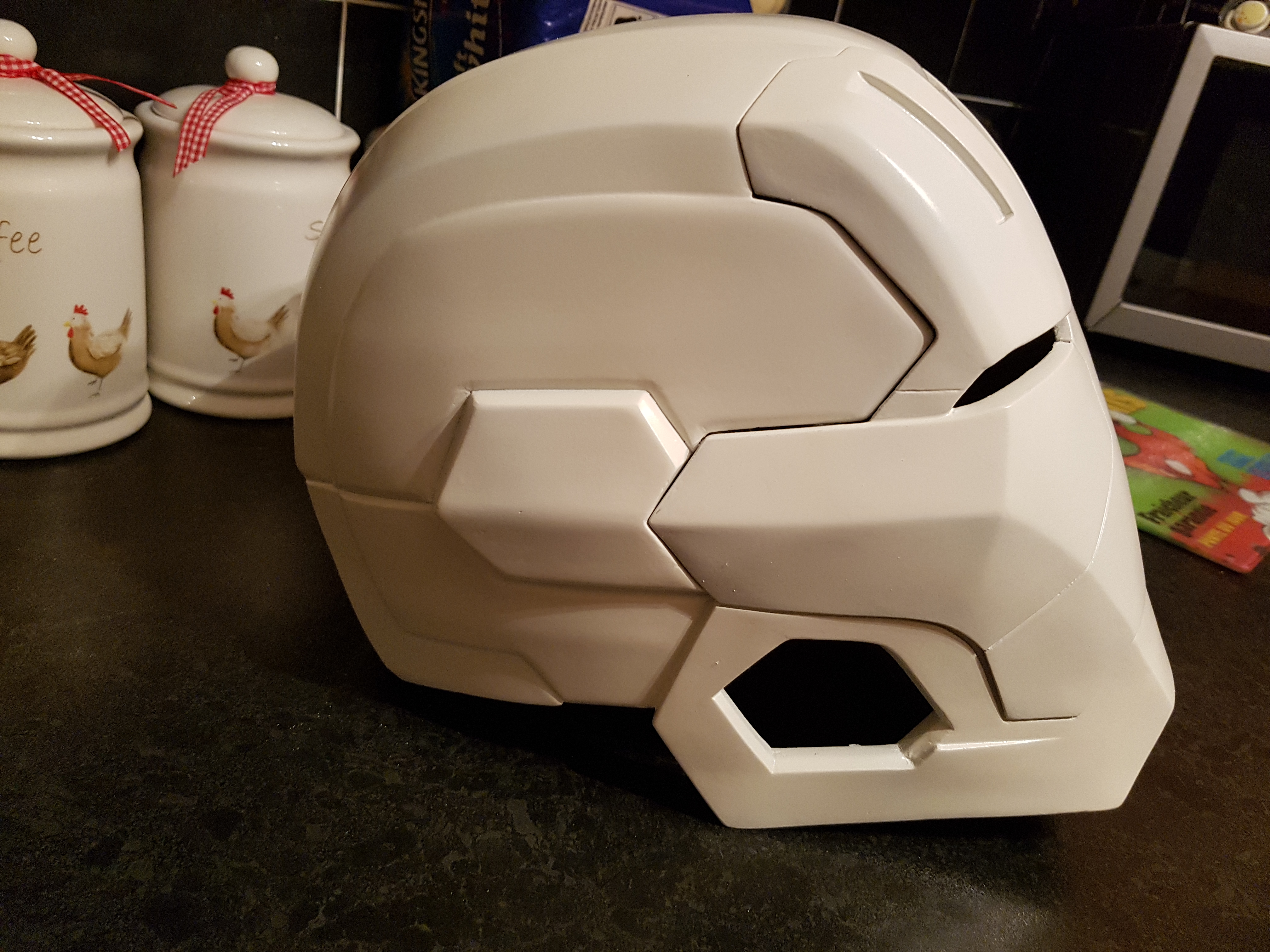

Then on to sanding and filling

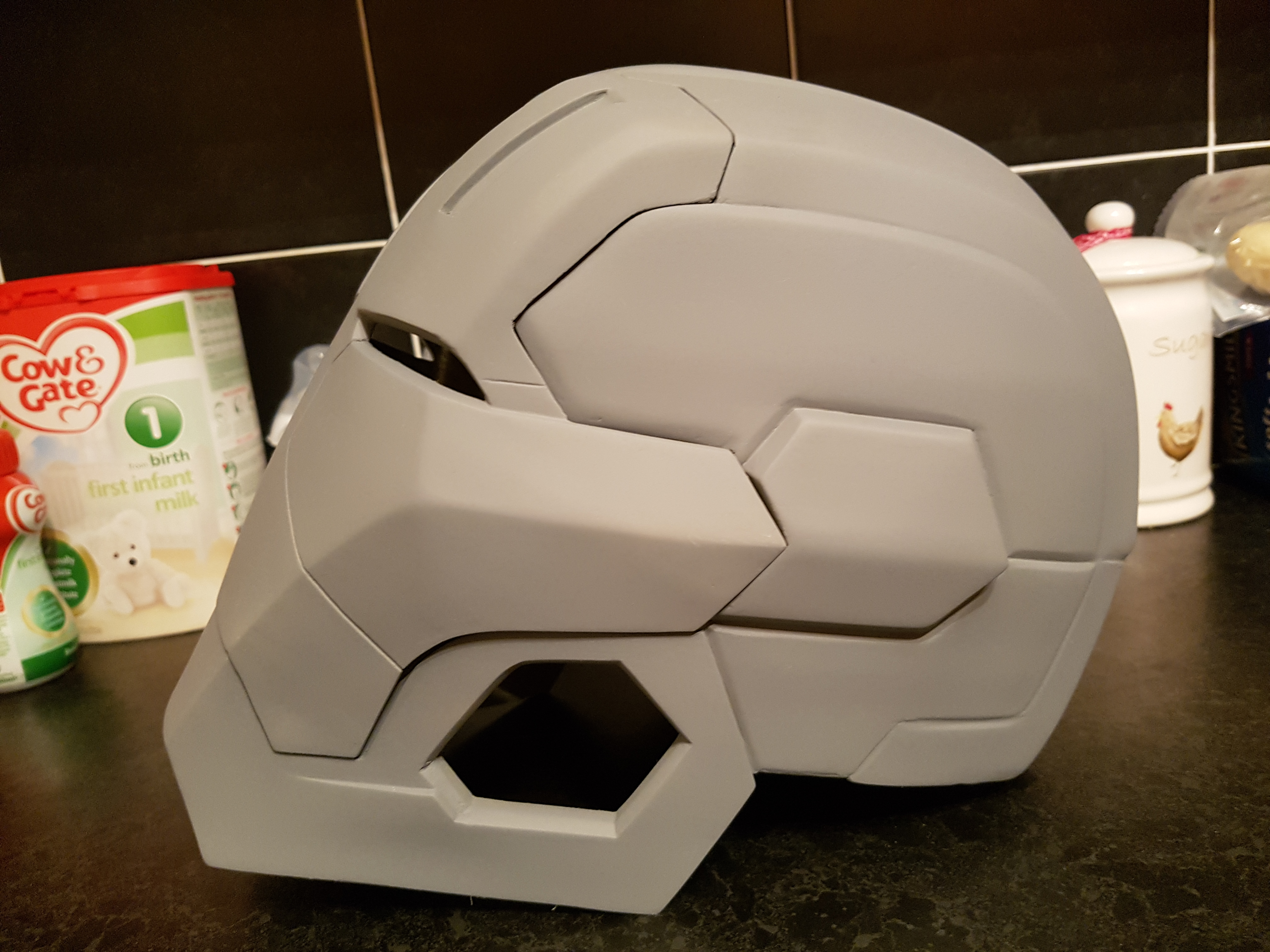

Highbuild primer, I removed the detail pieces from the cheeks. Im probably going to take a mold of this when its ready.
Done some more sanding and painting. Ive given it a couple of coats of white gloss to get it ready for molding.
I still need to sort the cheek detail pieces and the rear lower removable part.

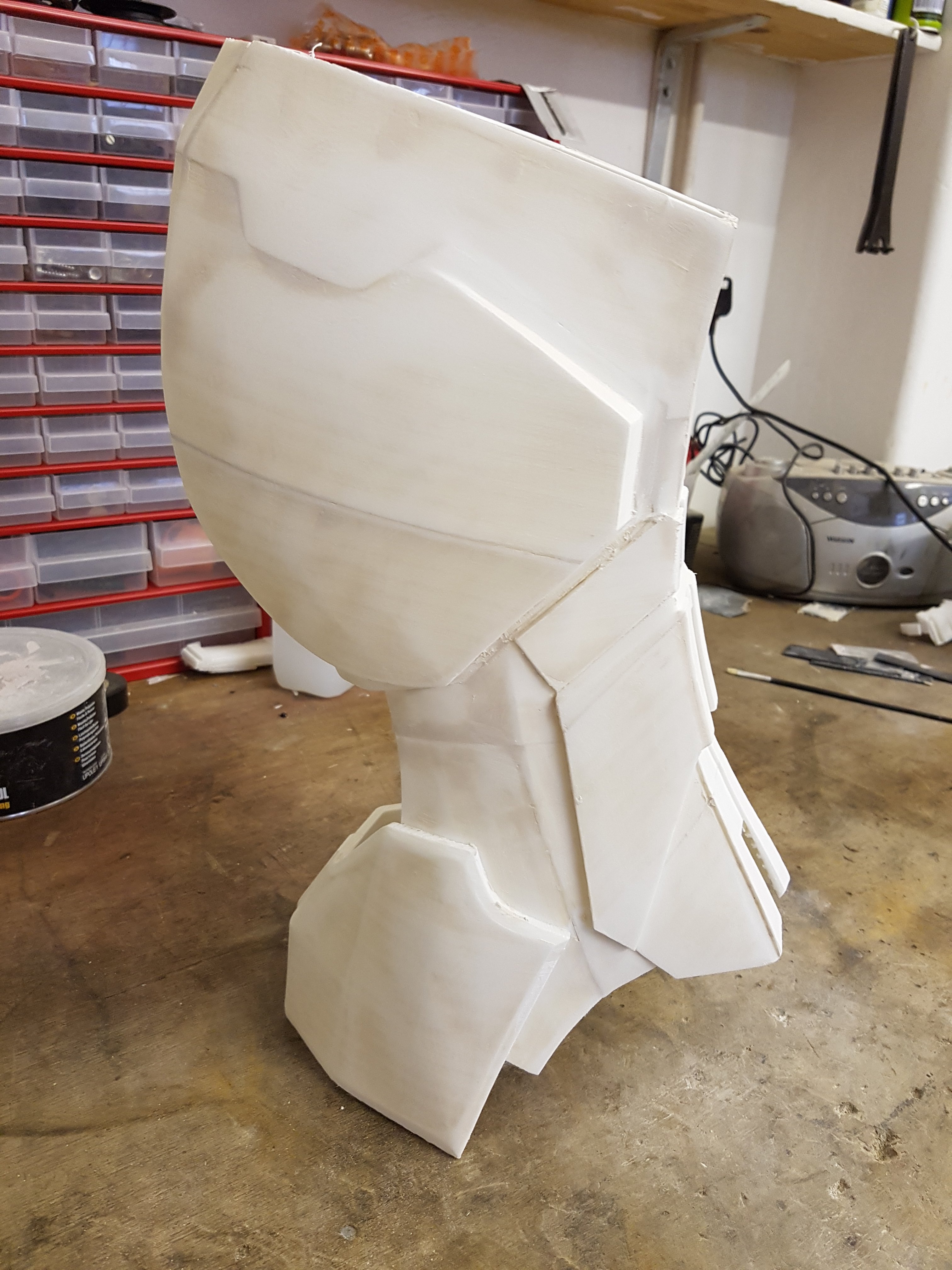

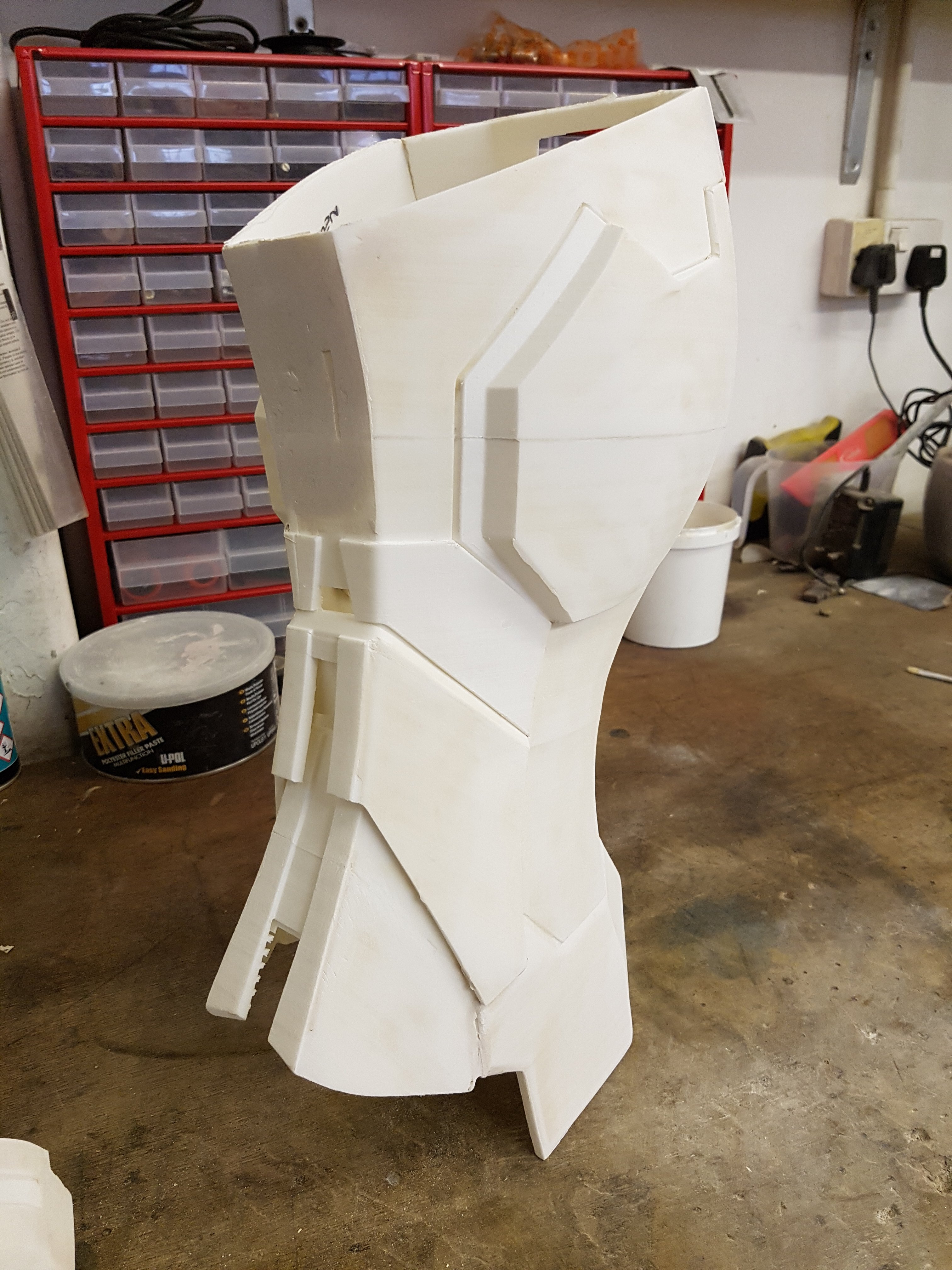

I printed all the pieces for the left lower leg.

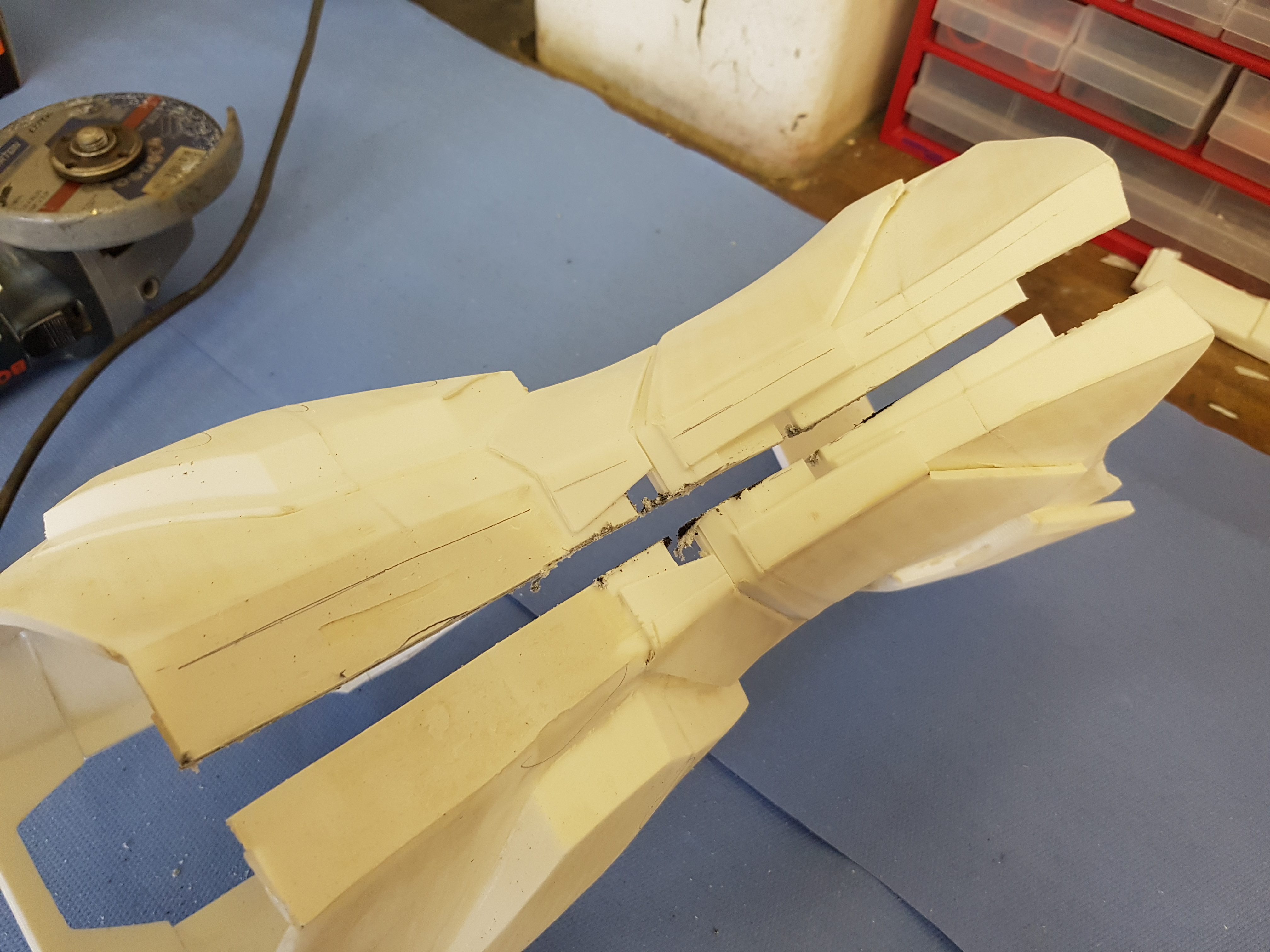

unfortunately i ran out of my usual filament. I had a roll of blue in a different make. I got a lot of warping and layer separation. Stupidly i carried on and finished the whole leg.
After trying it i decided its too tall and slightly too narrow. I've resized it and am now reprinting.

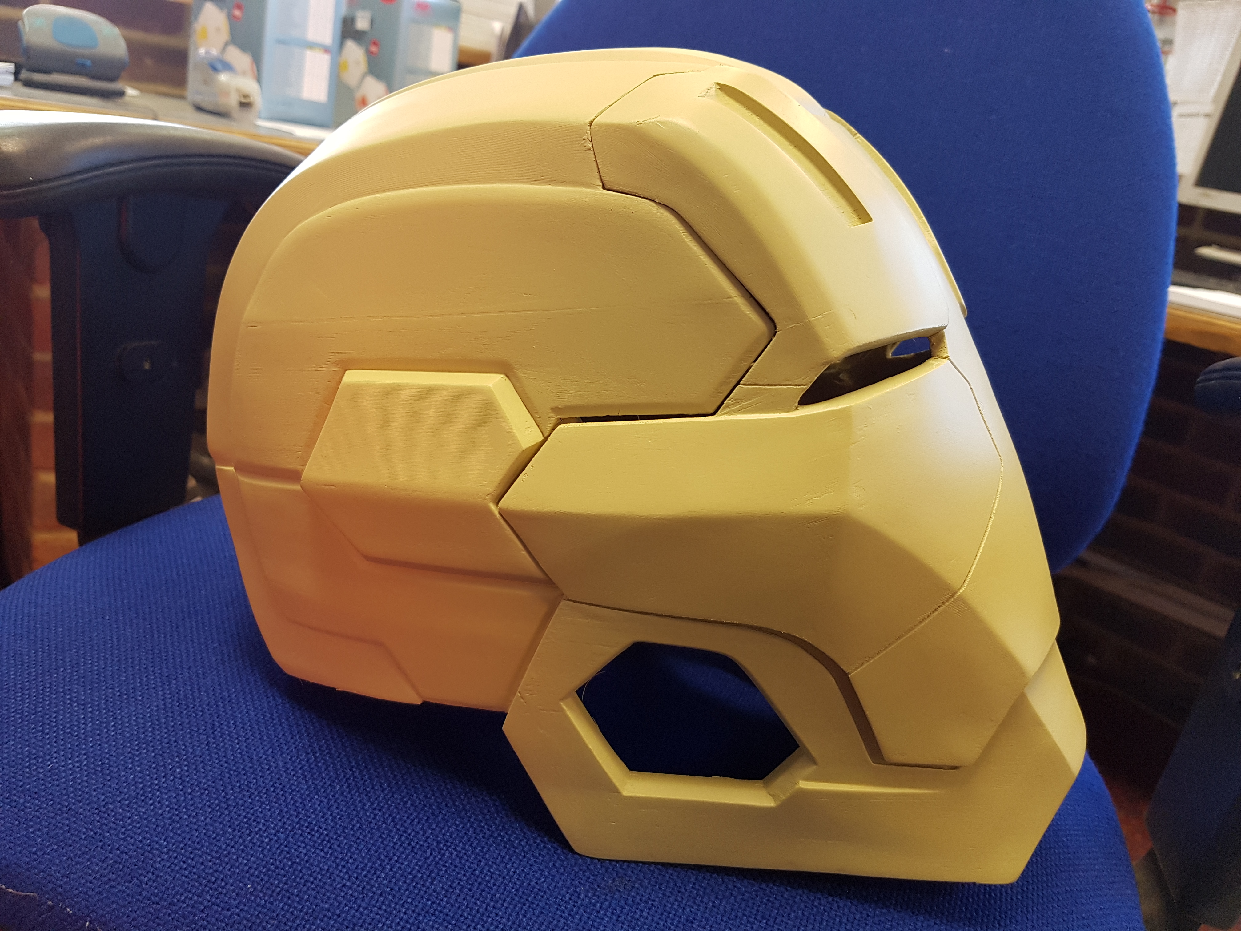

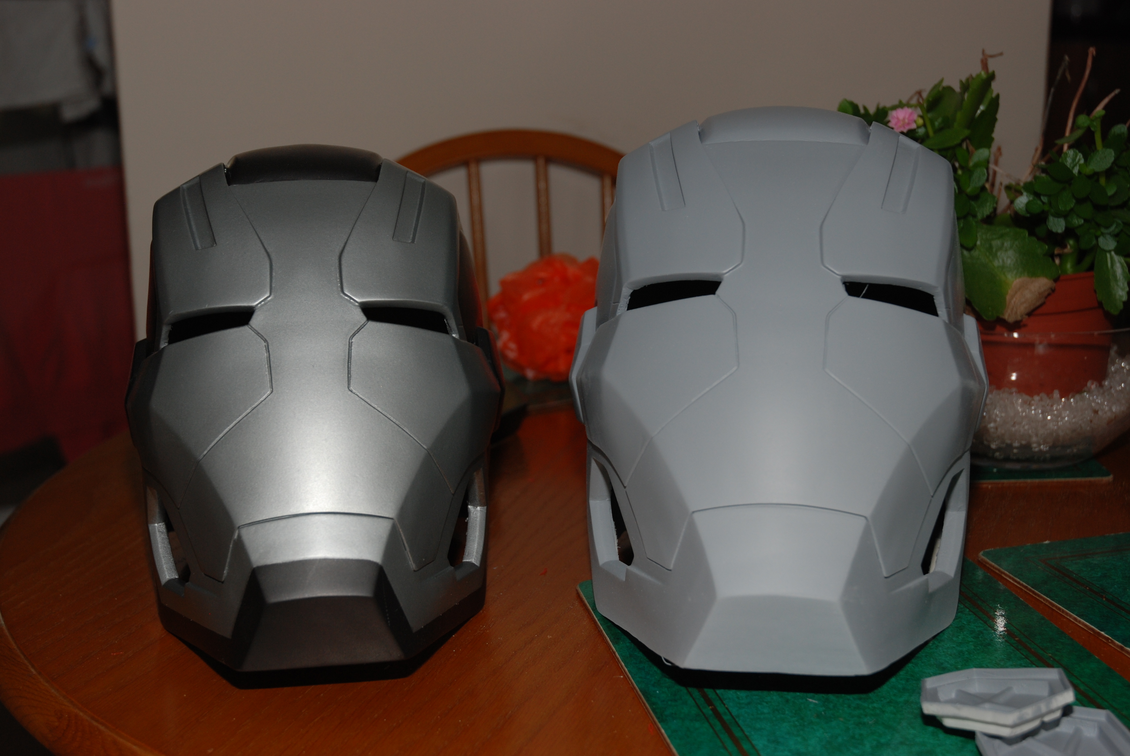

Ive decided to reprint the helmet yet again. Its a bit tight on the ears.

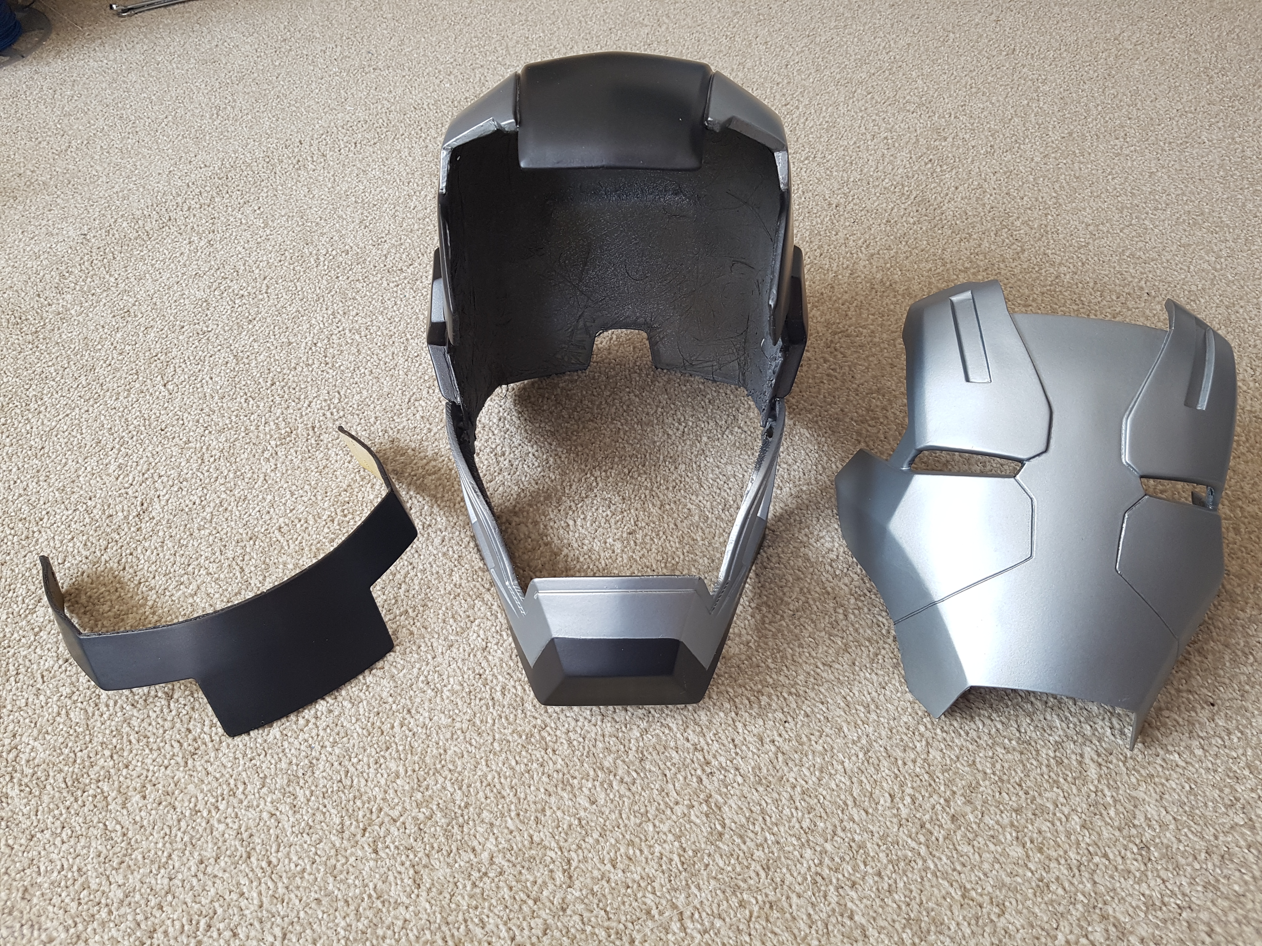

I decided to do a quick paint job on this helmet.
Looks a bit thin front on as well, not sure whats caused this. Will check this when i assemble and print the next one.

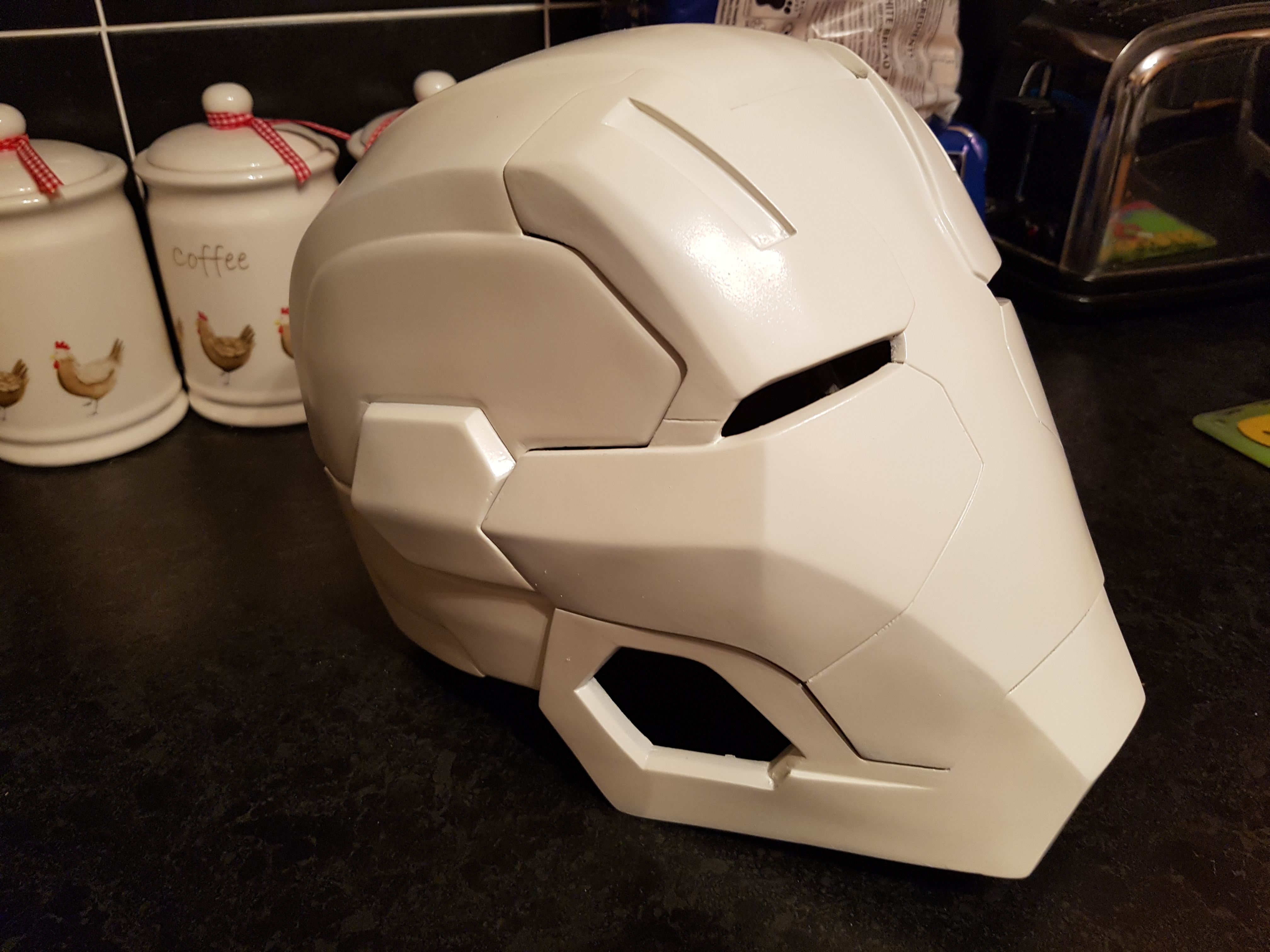

Ive reprinted the helmet slightly larger than the last. I just hope it doesn't look too big when put on with the rest of the suit. The old helmet was really tight on the sides without any padding fitted.
I've primed with 2k primer.

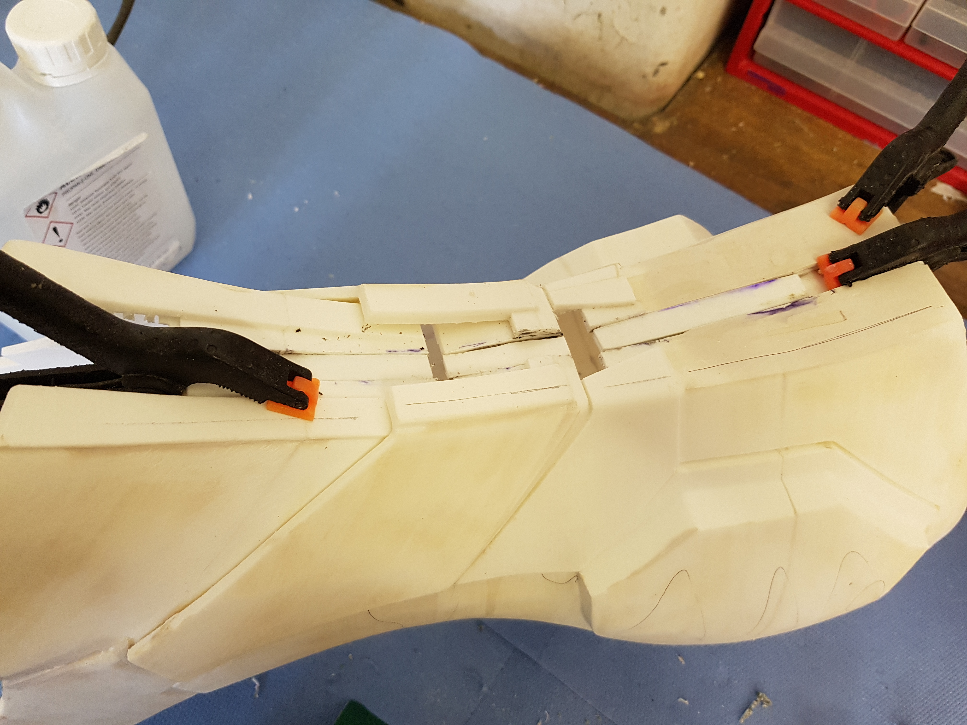

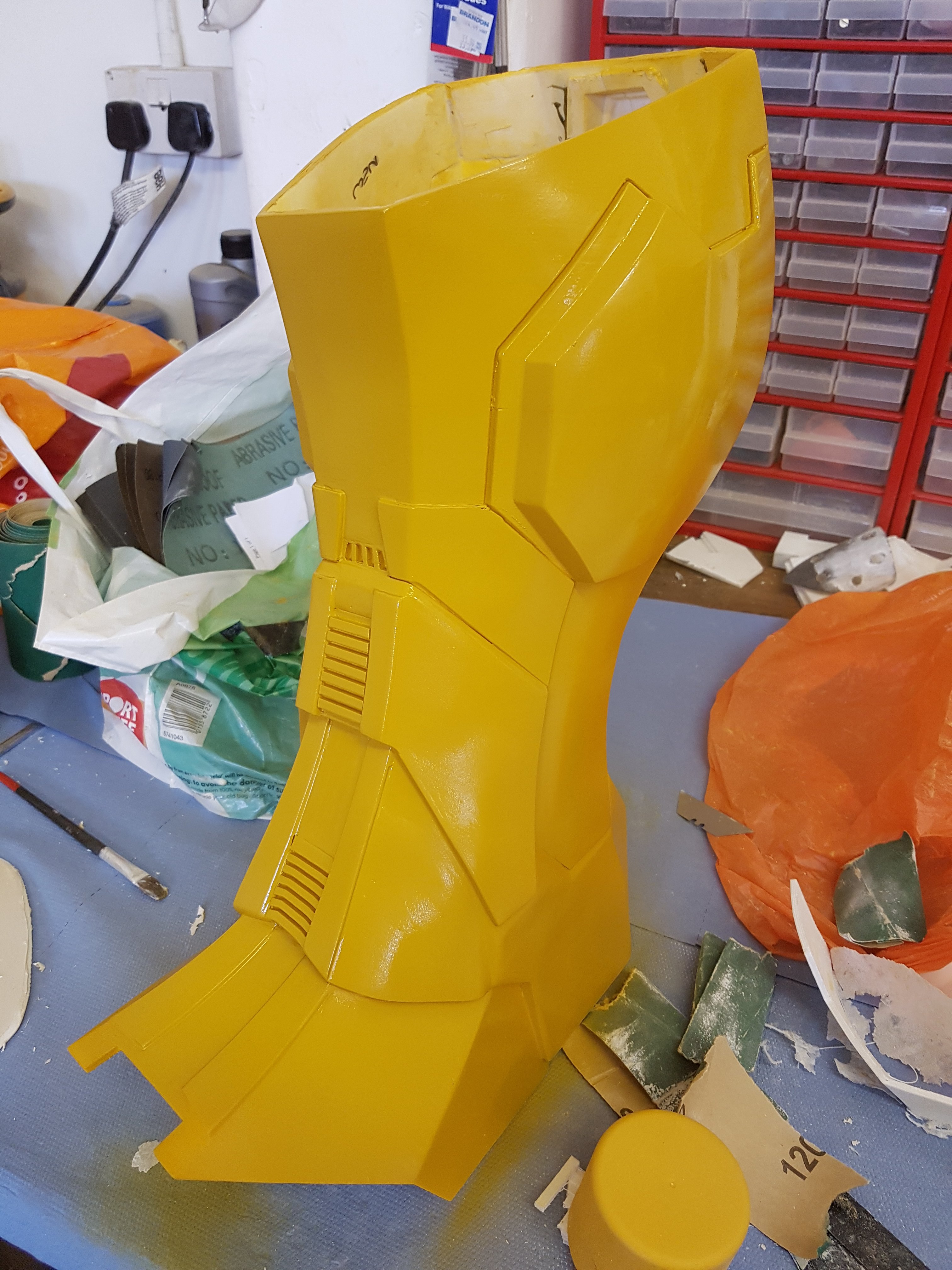

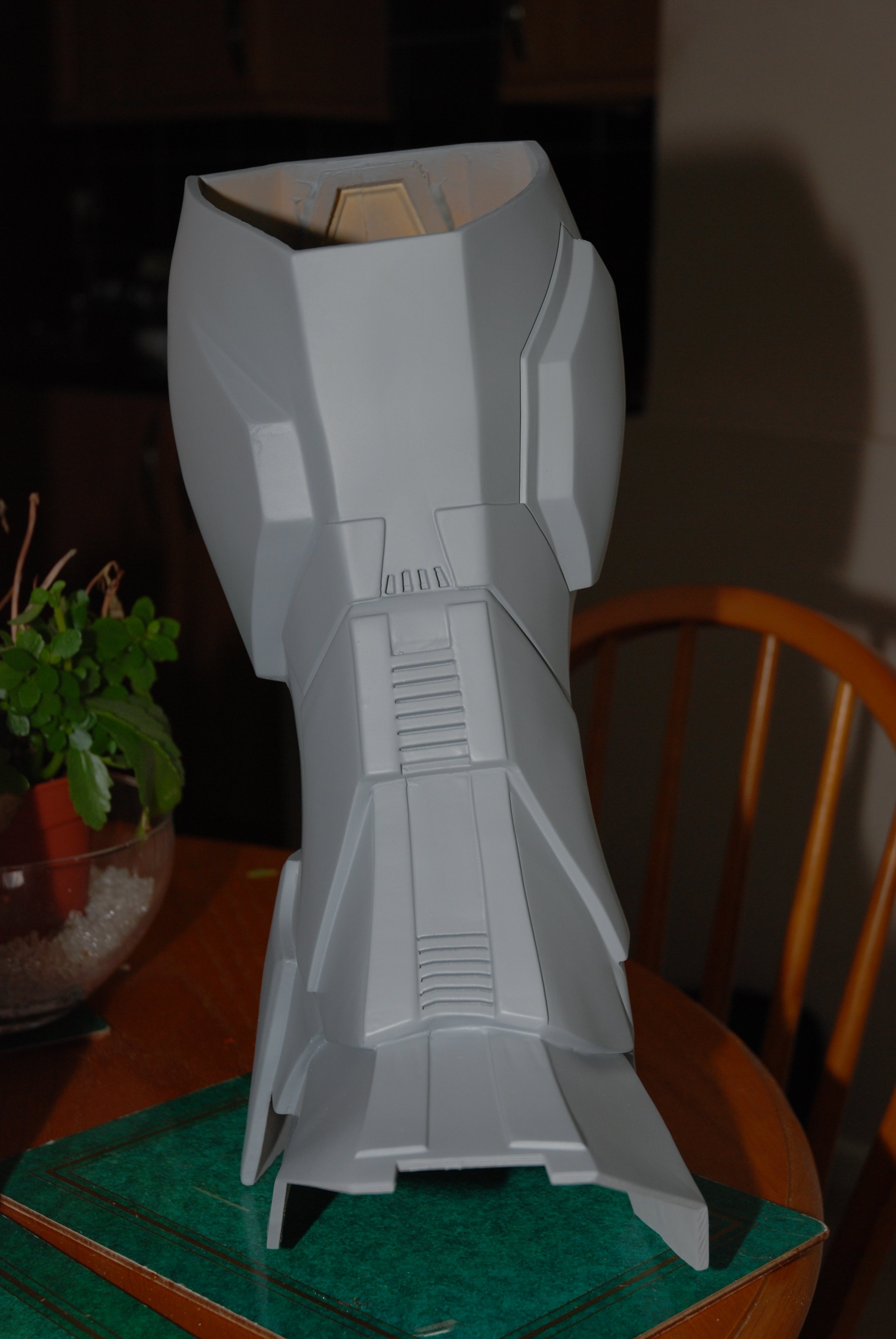

Been working on the left leg
Needed to widen it slightly
started priming
after filling and more priming
