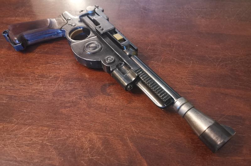

This was something I printed during last year's lockdown but then shelved (as is the case with most of my 3D prints). It's Straeker's Ultimate Mandalorian blaster file available on Thingiverse. Only after seeing Chapter 5 of The Book of Boba Fett did I decide to finally finish this. The main blaster body was FDM printed with a higher infill to give it heft, and then sanded/primed/filled. The greeblies were resin printed. The grips were also FDM printed using wood PLA. Painted primarily using spray cans with graphite rub for the metallic finish. Weathered using Tamiya and Liquitex acrylics and Tamiya weathering powder. The gold actually doesn't look that bright in person and has been muted down with weathering powder. Considering the limited resources available to me and my limited skills when it comes to finishing and weathering, I'm pretty satisfied with how this turned out.
