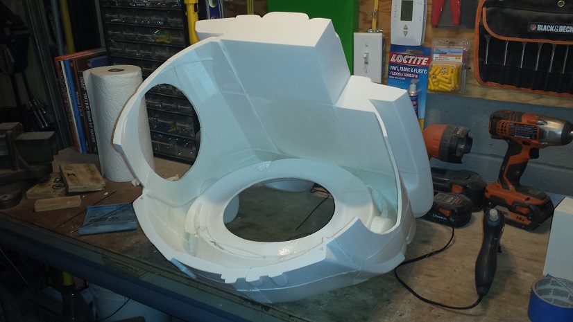

The dome was probably the hardest part of the outfit. I started with an acrylic dome:
Cut it with a dremel, and dressed up the exposed parts with Boka Car Door Edge Guards. I needed a strip of metal to better support the open and close function of the dome. The Dome is riveted to the metel and the metel is screwed into the suit.
