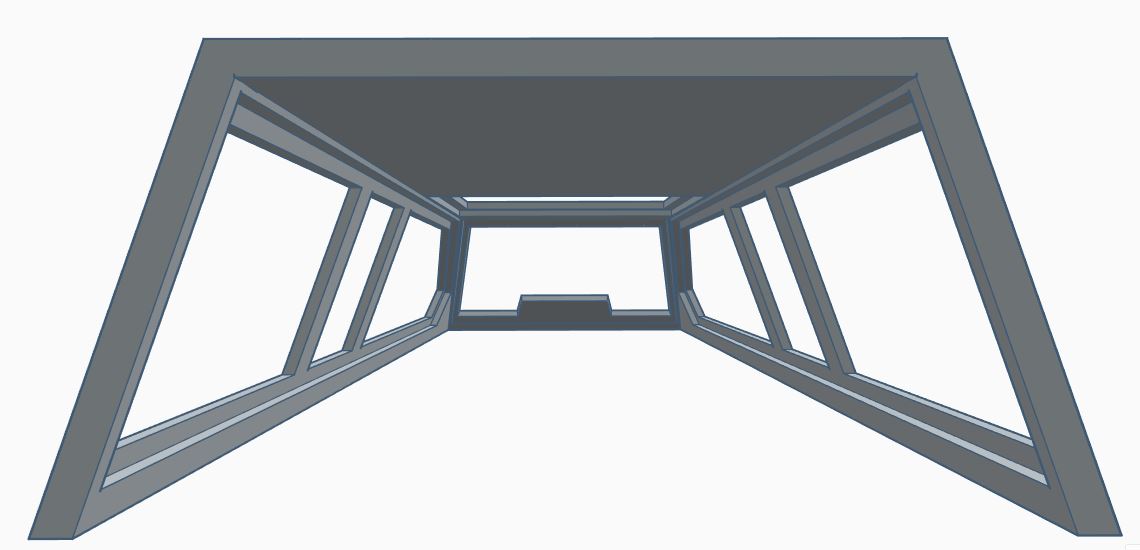

I haven't done the canopy yet. It doesn't seem too hard if I don't include all the inside greeblies. I'm wondering if it would be better to model it as an entire assembly, or in pieces where it would have to be glued together. I guess someone could always slice it up in meshmixer to ensure that their printer could handle it.
TazMan2000
The canopy was a bit more difficult to do. I used a micrometer for measurements but shrinkage when printing/curing may cause a dimensional problem, or an issue with fit. Shrinkage won't be linear.
The skin is about 3mm thick, to ensure strength. It looks a bit thick but I'm afraid to go thinner because the flimsiness could result flexing, cracking, or bending.
TazMan2000
Let me know I have various resins I could try.
Here you go. Good luck. I'm wondering if I should model the bottom part of the canopy...the stuff that ensures it fits in the grooves of the cockpit and locks in place.
*****Edit***** Hold off on downloading. Still improving design.
