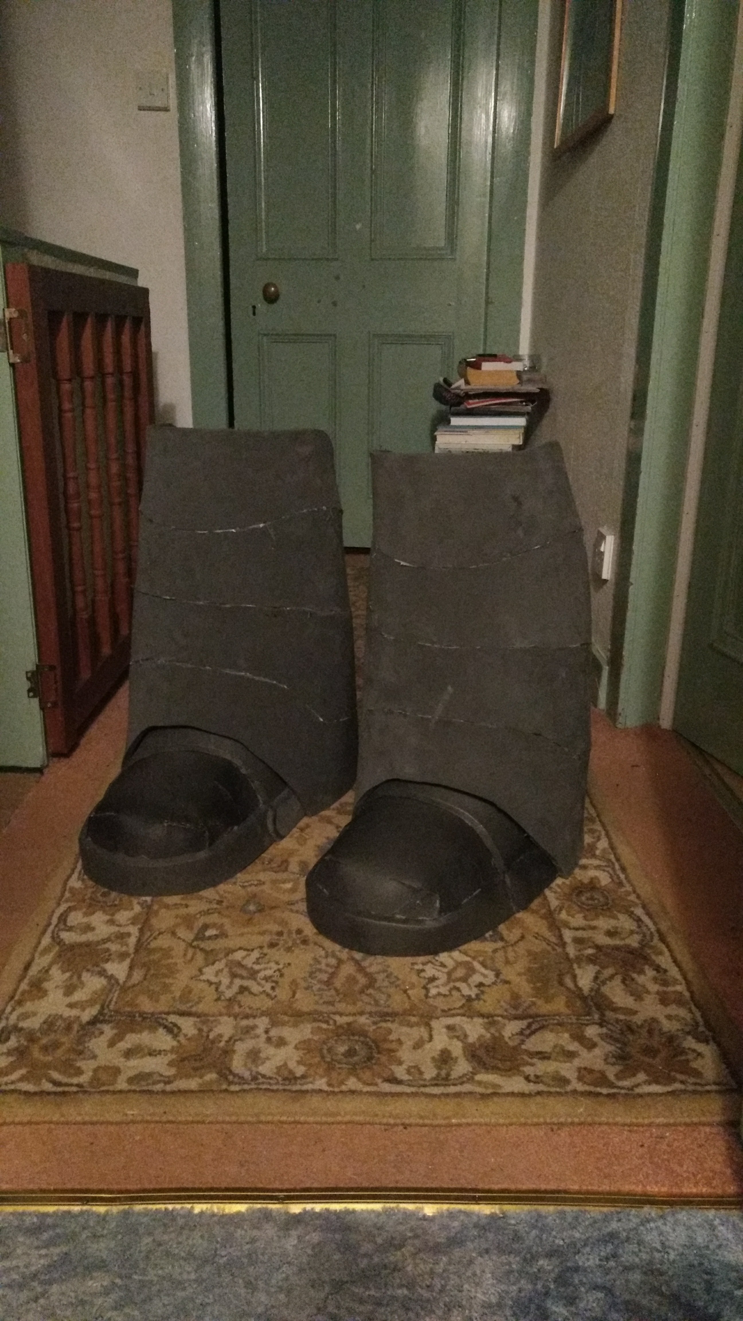

These are the legs I have created with the thighs being finished today though they are roughly finished and still require sanding and filling on the seams
Right now these parts lack detail which will be added later, they also don't look much different form MkVII legs though this should change when the knees are added which is what I'll be doing tomorrow

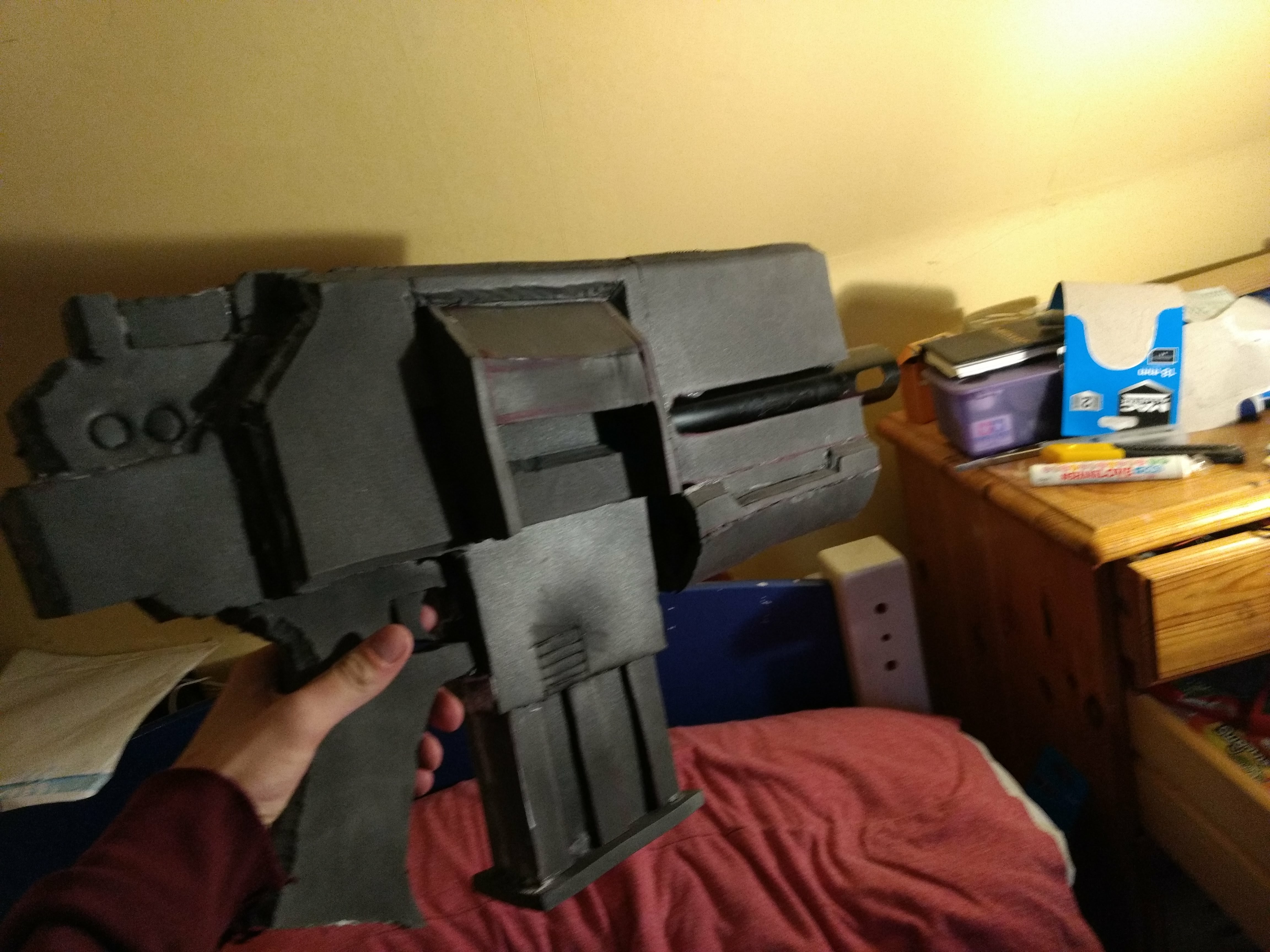

Here we have the Bolter which just needs work done on the grip and needs a top rail added the contruct of this is foam layered up with a 40mm pvc barrel and some stick out the wood inside the grip to make it less flimsy(real professional I know right?)
