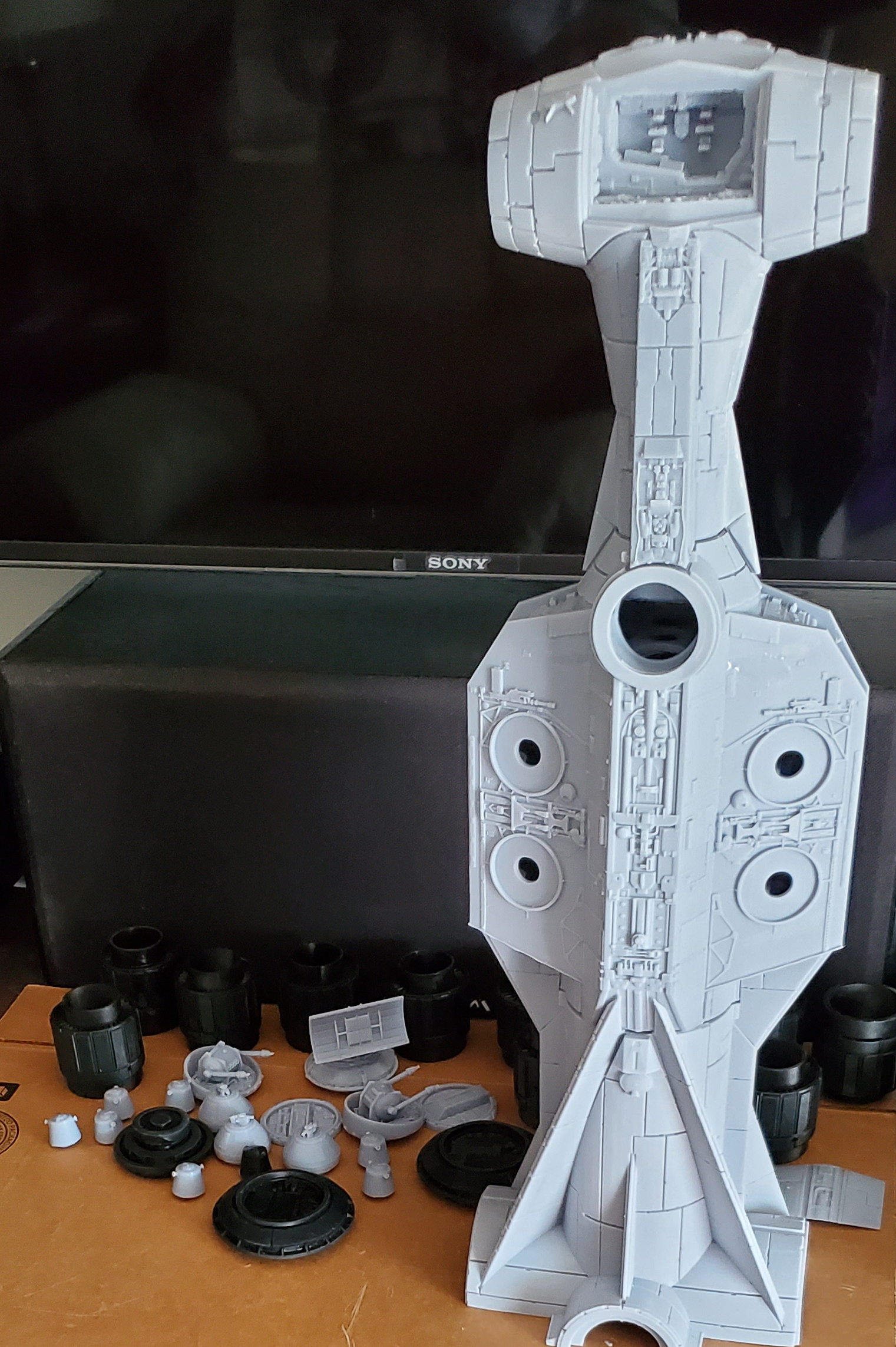

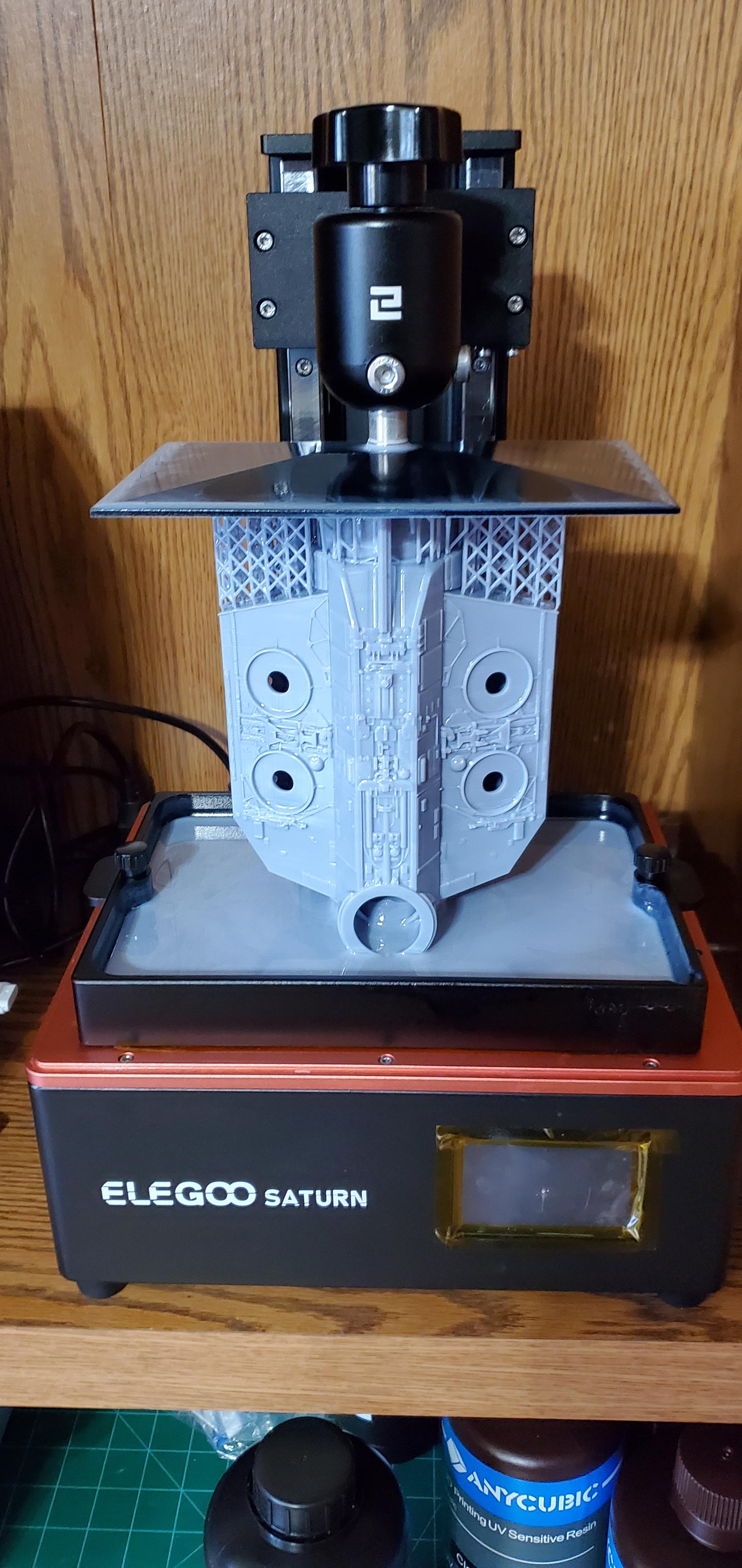

I am currently in process of printing parts to make a 30" Blockade Runner.
I have been wanting to print and build this for a while now. The Saturn printer makes this project possible along with learning how to split and support the parts.
Here is my progress so far.
The last photo shows that the main parts slot together. They are not glued together yet.

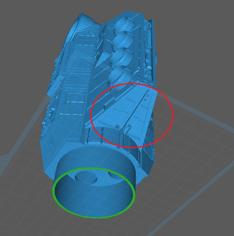

I used the pre-supported parts when I printed the two most forward parts, the middle and the top but I would not go that route again. Almost any time you have something that is flat facing towards the screen, as shown in the attached image, you can lose some resolution. Not sure exactly how to describe it but often sections like the one circled go a bit 'flat' and the print is not as sharp as it should be as kamandi called out above.
When I re-print all of this larger on my Jupiter I will support it myself and tilt it at a slight angle to avoid that. I had the same issue on the rear of the bridge section.
