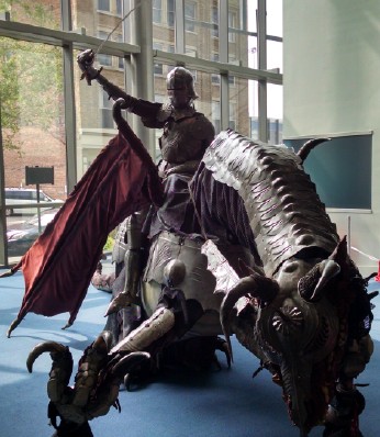

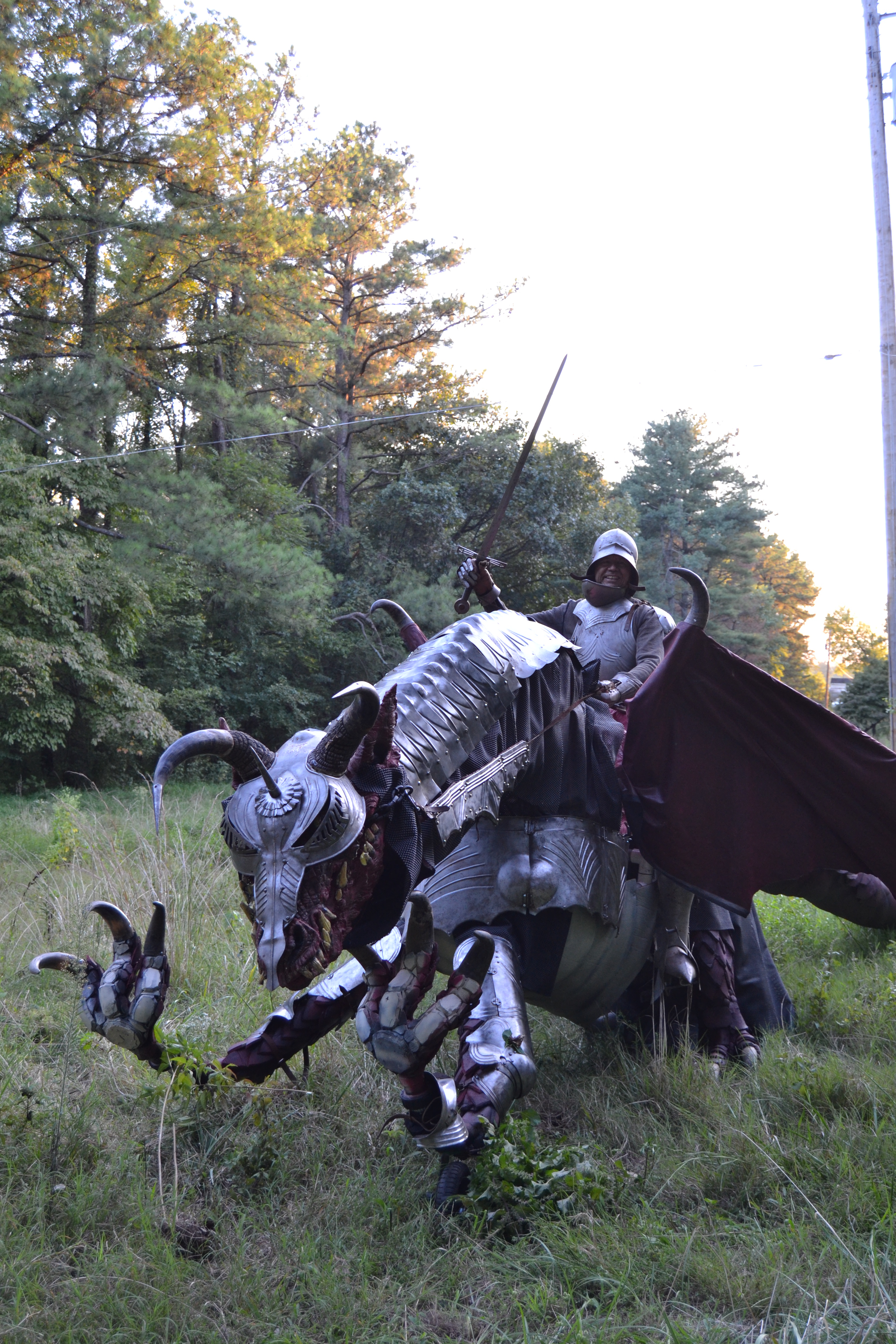

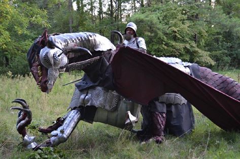

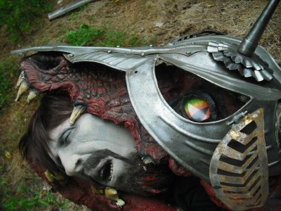

dragon build 064.jpg cincyexpo3.jpg head munching.jpg wardragon.jpg This is my latest giant walking costume/prop using and expanding on what I learned from making the 25 foot long walking Star Wars Dewback lizard some of you have already seen here. Like the dewback this creature has a pvc tubing skeleton, and scales made from army surplus foam sleeping mats. The dragon can actually walk on its own power by means of the hind legs which are actually the knight's real legs mounted on dry wall stits over which the dragon feet have been made. The knight's armored legs are simply foam covered in real steel armor and held in place by the stirrups. The dragon's head can be raised and lowered, and moved from side to side by use of the armored reins, much as one would control a real horse. Through hidden cables in the neck, the dragon's mouth can also open and snap shut. Lound roaring sound effects are now in the works. The wings can be raised an lowered through another control, and the tail can also be thrashed from side to side. The chain mail skirting hides tires which makes it possible for one person to 'walk' this gigantic prop. All of the armor is made of real steel, and based on original German Gothic armor for man and horses from the latter 15th century. All of the dragon's claws are made from real cow horns. The creature was first display at the Cincinatti Comic Expo last year, and I am planning to lead the Dragon Con parade with it in Atlanta this Summer as I have done in the past with some of my smaller dragon props/costumes in the past. Based on the new film Smaug, I am now working to mount the wings on the forearms in a more realistic 'pterosaur' configuration and will also be able to move the front feet in a walking motion.

Yes, there are wheels on the front too, though completely hidden by a 'dragging' band of chain mail. Instead of typical caster wheel, there are four 6 inch pneumatic tires to make it easier to roll, even "off road", but when not on a smooth surface, the 'rider' needs help moving this monster. Also, on a long parade having a person on each side to help pull the dragon with nearly invisible, thin steel cables is a big help so the rider won't get exhausted. The real steel armor alone weighs about 100 lbs, and the complete dragon probably another two hundred. Yes it was designed primarily for the dragon-con parade in Atlant DCparade3.jpg a which I started marching in this much smaller, 'draconian', which also incorporates real armor. This got to be a killer too, as the costume with real armor weighs over 100 pounds, and the parade is about 2 miles. As I mentioned, and inspired by the design of the new Smaug, the new design will have the front feet actually walking too, attached to wings that the rider will also move, though wheels will still be necessary to support the beast. They will be invisible though, hidden under loose folds of leathery wing membrane.
