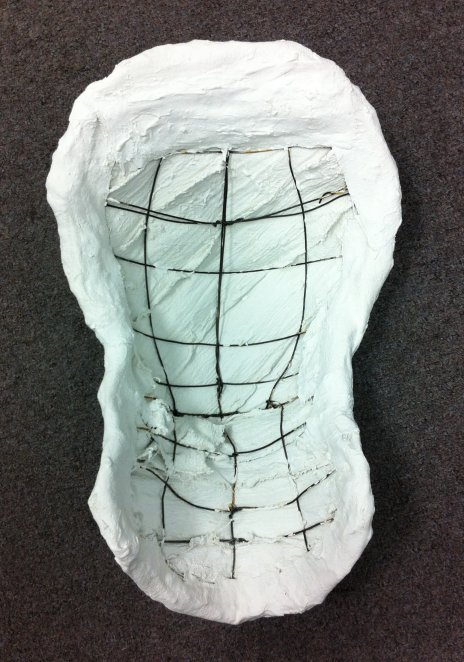

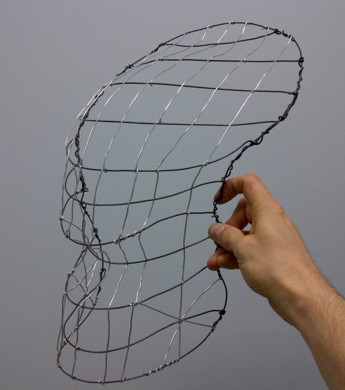

First start out with the wire armature. This was based off of the measurements from my other bio helmets.

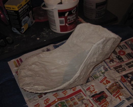

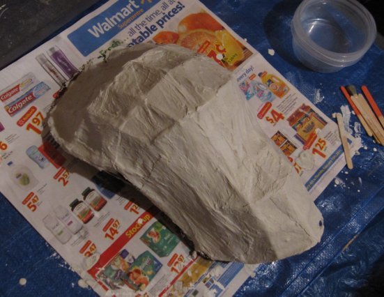

Then slap on strips of burlap dipped in plaster of paris in layers so that it becomes thick
The wire is what keeps it from collapsing, and once this hardens you'll have your armature
I also put layers on the inside just for the hell of it

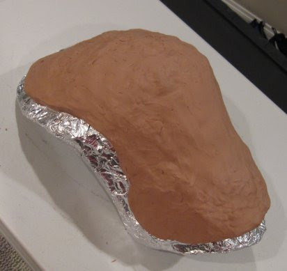

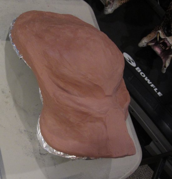

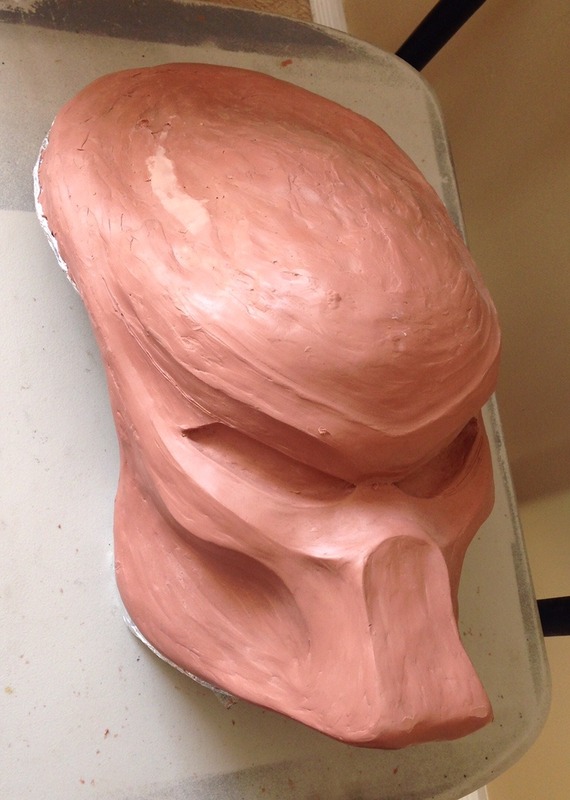

I used Chavant medium and soft clay, cut them into pieces and melted them in a crock pot. I began slapping the gooey clay onto the armature

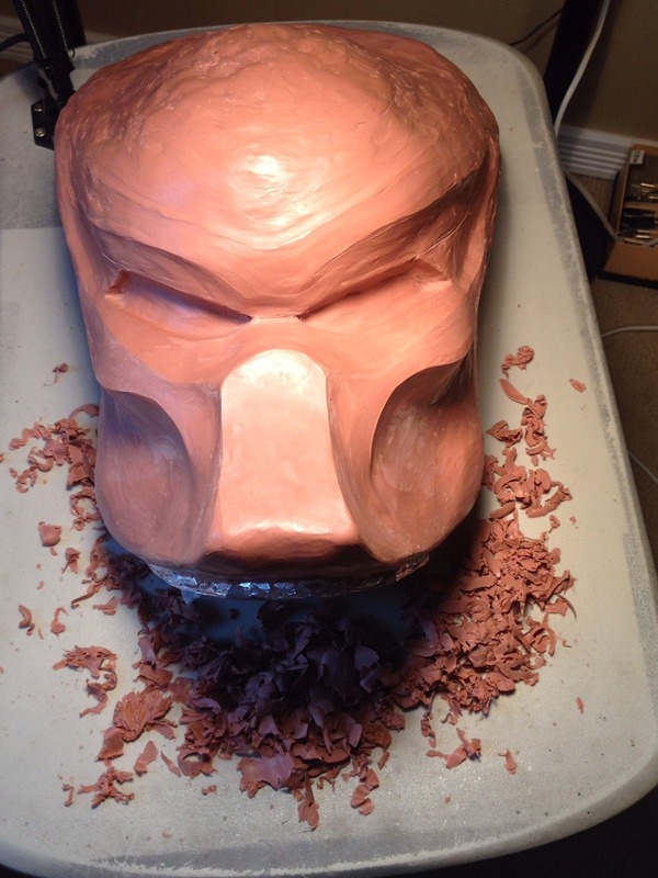

Then slowly start shaping your clay

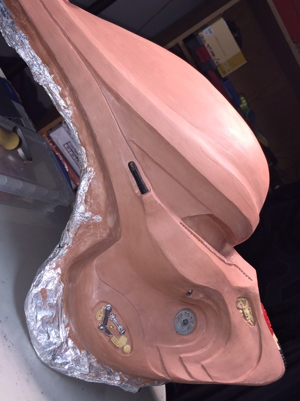

The great thing about sculpting is that you can build up more by just slapping more clay on, or you can remove chunks just using tools. Clay is very forgiving, so if you make a mistake, you can always rebuilt it!

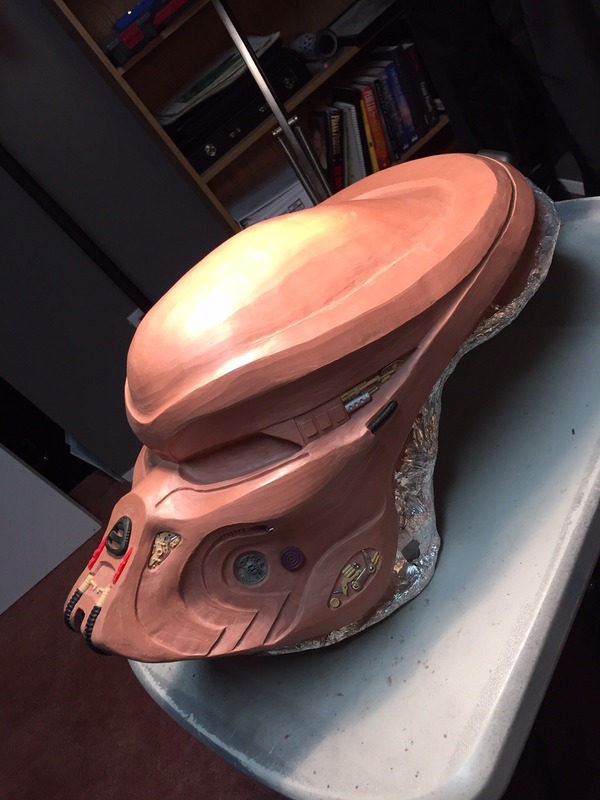

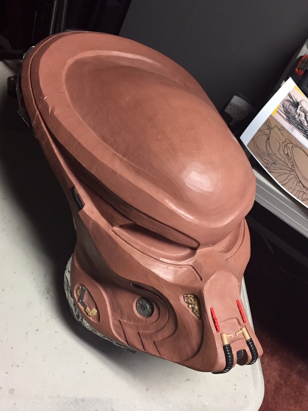

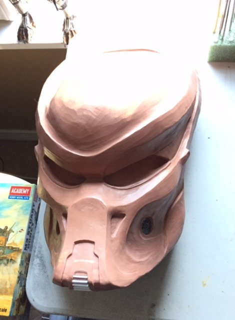

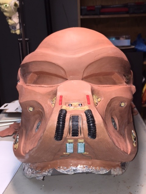

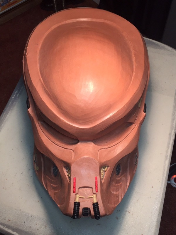

My design changed as I worked on it. You can see ribs in the lower jaw, but then I removed them

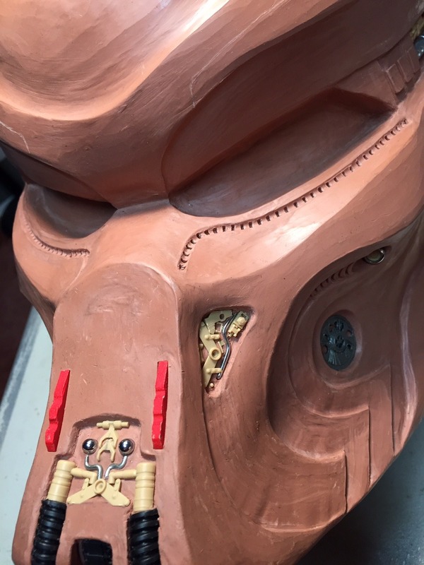

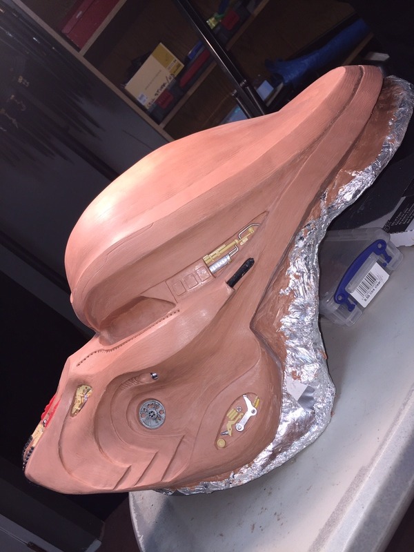

I wanted it to have a mechanical look, so I started adding some tank model parts, and bits from around the house.
