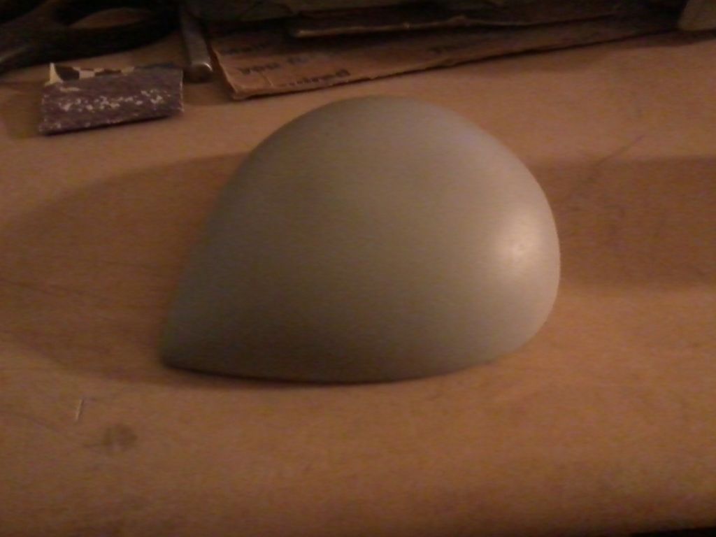

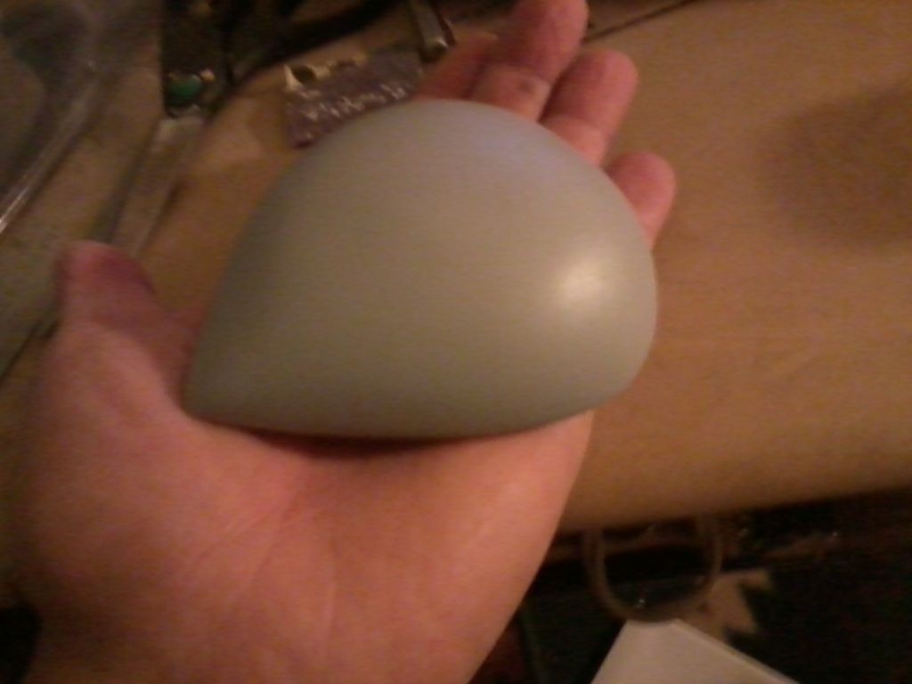

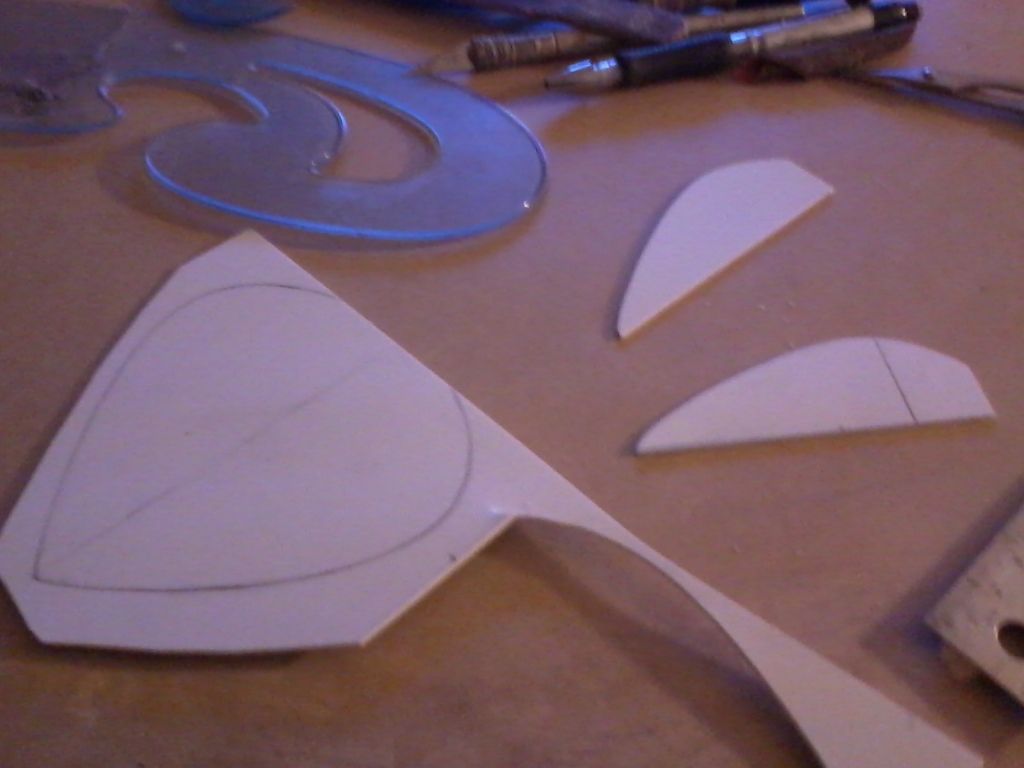

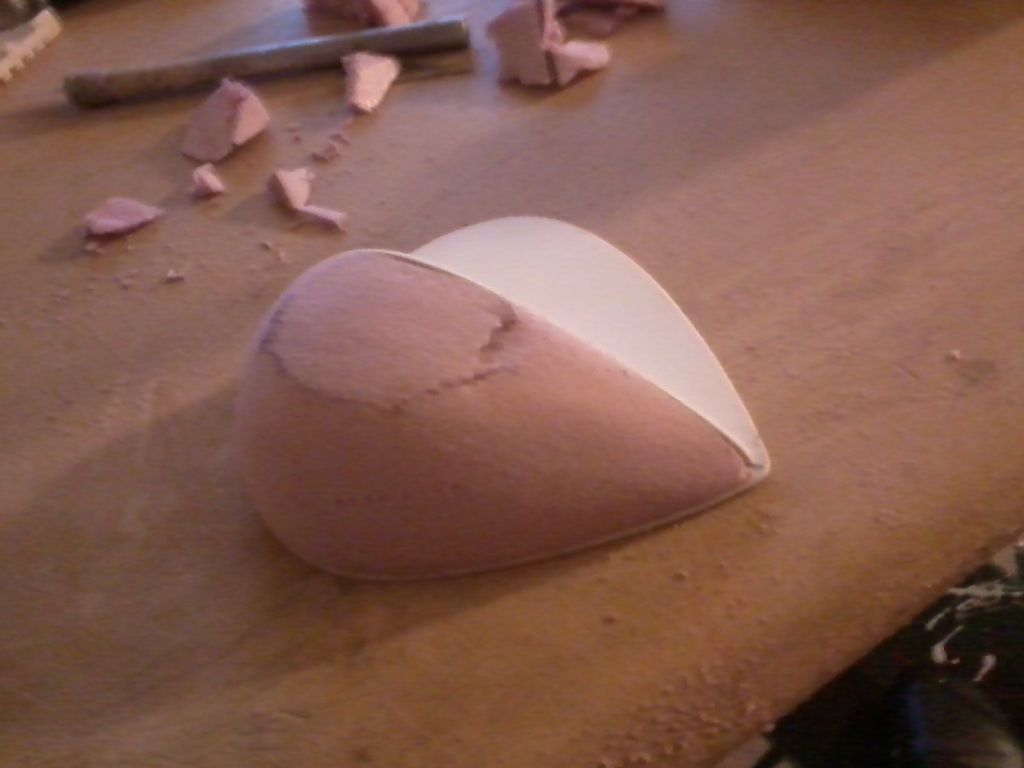

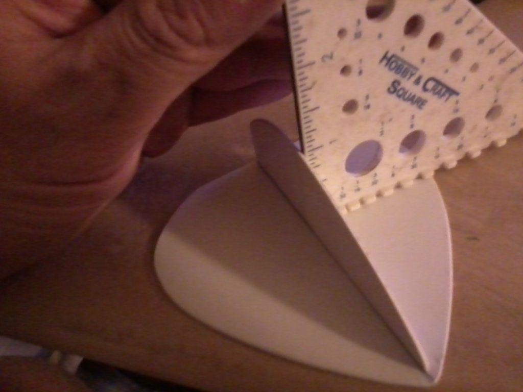

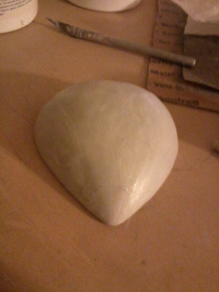

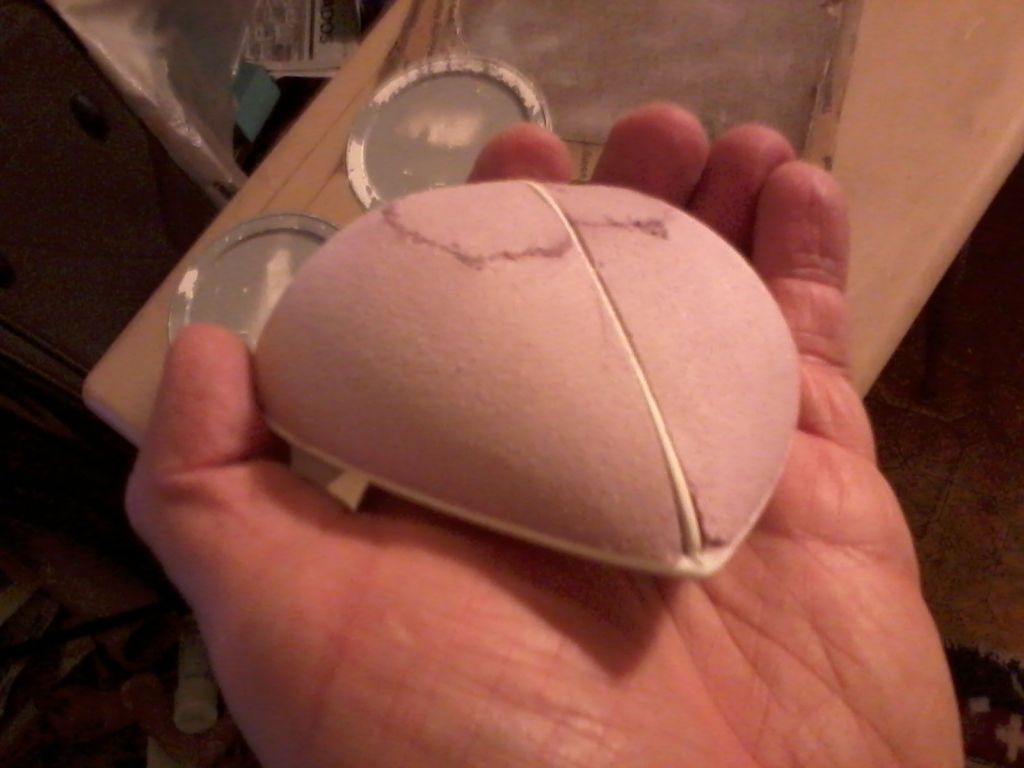

Well Happy New Year everyone! I started this yesterday afternoon I always wanted to do the Eagle remembered having the model as a kid so I got a set of prints off of Ebay they were ok so I decided to start with command module. I cut my templates from styrene and then bulked it out with some left over foam from an old project, sanded it smooth and then applied Magic Sculpt or Epoxy sculpt same crap Lol, and let it set up for about 5 hours sanding, sanding and I sanded till it was the year 2013! Lol, the last 2 pics show it smoothed out with a coat of Tamiya primer. Tomorrow I will take a quick mold to make 2 resin shells and then cut out the window sections. I'll be doing this build and my Galactica build at the same time when I need a break from one I'll work on the other, thanks for checking it out.

Thanks guys not much so far it's a start and thanks Atlanthia I will drop on by you guys thread. I just ordered some aluminum and styrene tubing to work on the spine and cages and need to get my kit orders out of the way so I can mold the Command module pattern to have 2 resin halfs to cut out the windows, you guys have a boat load of info in your thread.
