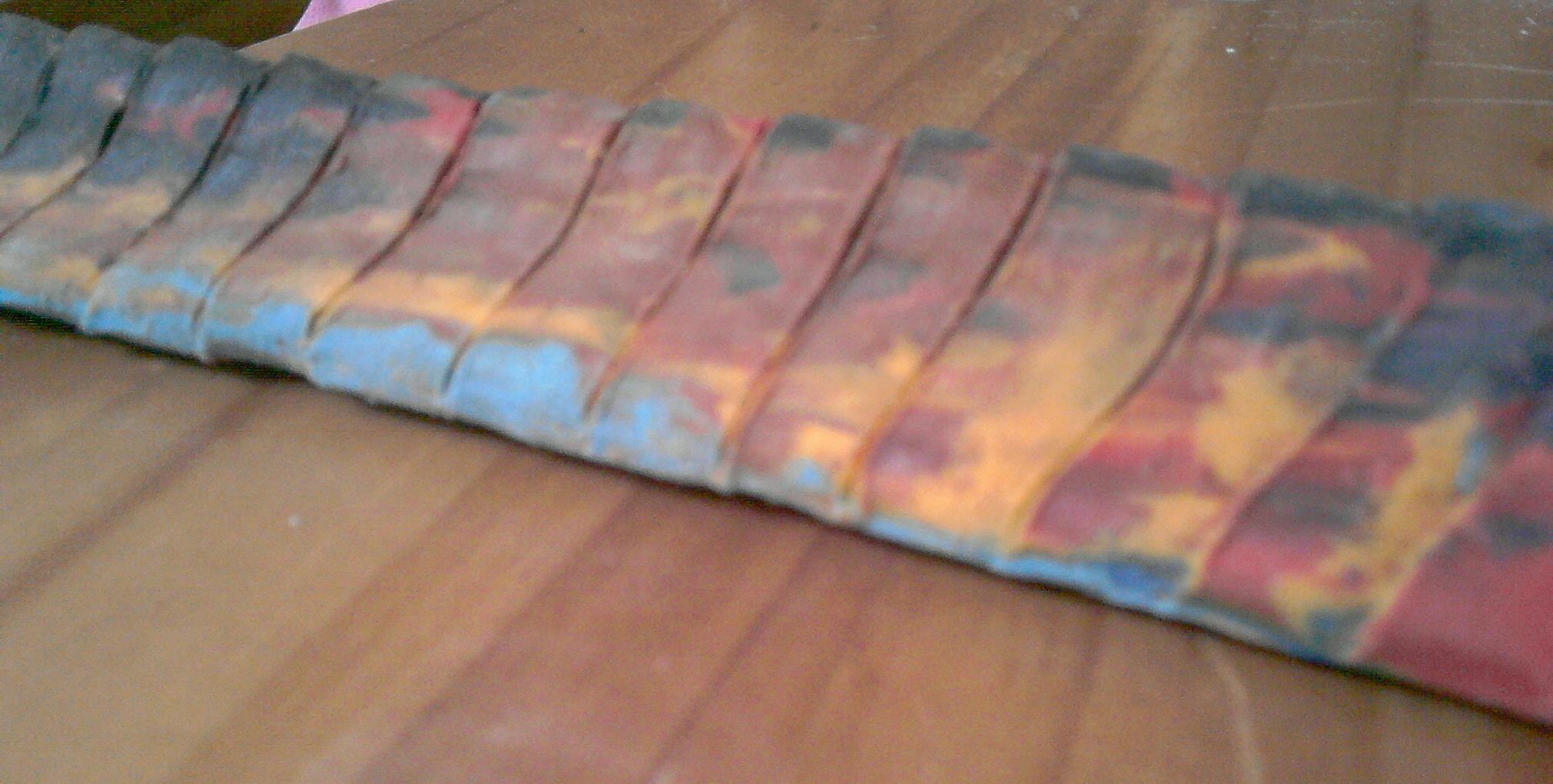

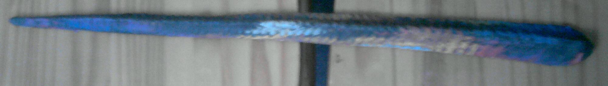

Cheers Hez. Couple of shots from my mob. Im going to make a plaster mould then cast in latex, cheap and wiggly so will behave as it should. If it comes out ok, am going to make one with a wire armature inside to make it poseable.
Any tips (to save me having to start from scratch again) greatfully recieved ;-)

crawjaw
Assuming it's a latex copy of your sculpt you're after then hez's method is spot on. You only get one stab at it as the sculpt will get wrecked when you remove the mould. If on the other hand you want a resin or plaster replica you can mould either with silicone or latex. However it would be better done in silicone as a 2 piece mould is needed and lining up multiple latex moulds isn't a great idea. You should also get a second stab at it if required, as the sculpt should survive the moulding intact.

crawjaw
As you have used oil based clay you can lightly surround the bottom half of your sculpt with water based clay. You only need to get the upper surface of the clays in close contact. Buiding a support with wooden or foam blocks will cut down on the amount of clay you need to use. Just be careful not to mark the surface of your sculpt when smoothing the water clay.

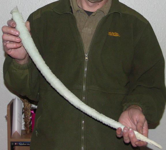

well, my first ever sculpt/mold/cast has been a bit of a learning curve.
while not a complete failure, I have some changes to make to what I did.

active84u
Thanks to those that gave enough advice to save this going in the bin. The cast is a little heavy at the end of the tail where the latex is almost solid and a couple of small thin spots that were caused by a sharp edge in the mold.
I have the body to finish sculpting and the fingers to do.
