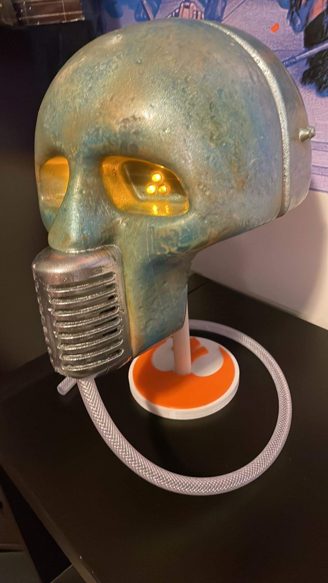

I wil have some more pictures very soon and a video on youtube. I have been working on the electronics and drive system. I can currently run the droid with a wired Wii Nunchuck. The drive system is complete and I am working on getting the electronics in the head finished.
These are a few pictures from 2009 I will put some new ones up of the current state. I have it apart currently while I work on the electronics. I am working on reinforcing the head to make it more rubust to hold up on the animatronic droid better. I also added the actual microphone part with a speaker and it will have a IR distance sensor, the eyes have RGB LED's so the color can change to whatever is programmed. Inside the neck I am adding motion detectors so he can responds when someone walks by.
