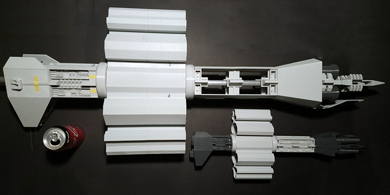

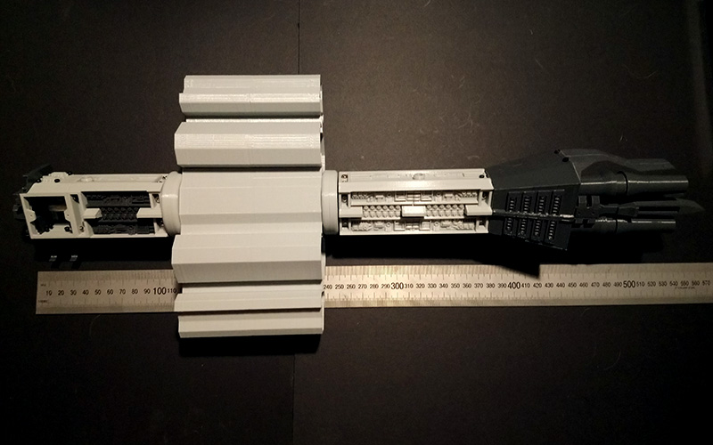

In the meantime i've also resized and printed a fair part of the main superstructure for a smaller 50cm version.
Its not as simple as just resizing 50% and hitting print, as many parts have screw holes that need to be changed, or screw clearances changed. And some parts have detail thats already at the printable limit of small details, so have had to edit a bunch of parts, either thickening or changing some detail. In some cases i'm able to simplify construction by combining some parts, in other cases i have to go from screw assembly to just glue. The blast shields at the front for example are 3 layered, and at this scale work out at 0.75mm, 0.5mm, and 0.75mm, and dont work being screwed together.

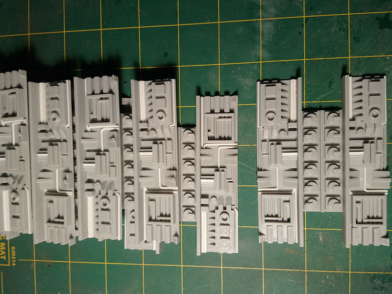

The detail panels for the rotating section had very small fine lines, am having to change those a lot.
But its getting there. This is my prototype, so as i print and assemble i'm seeing things that need changing, so the CAD model has updated parts that i havent re-printed yet.

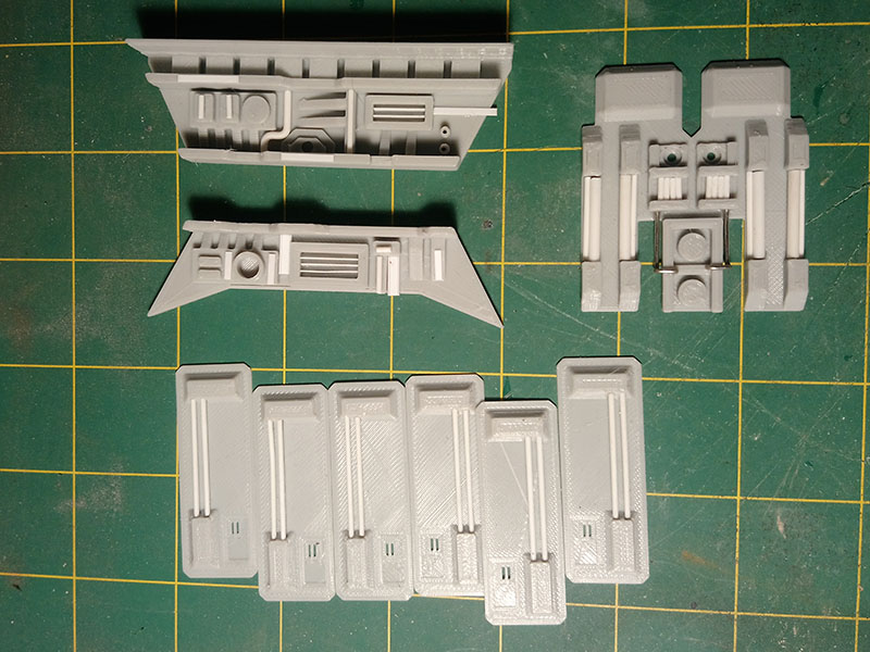

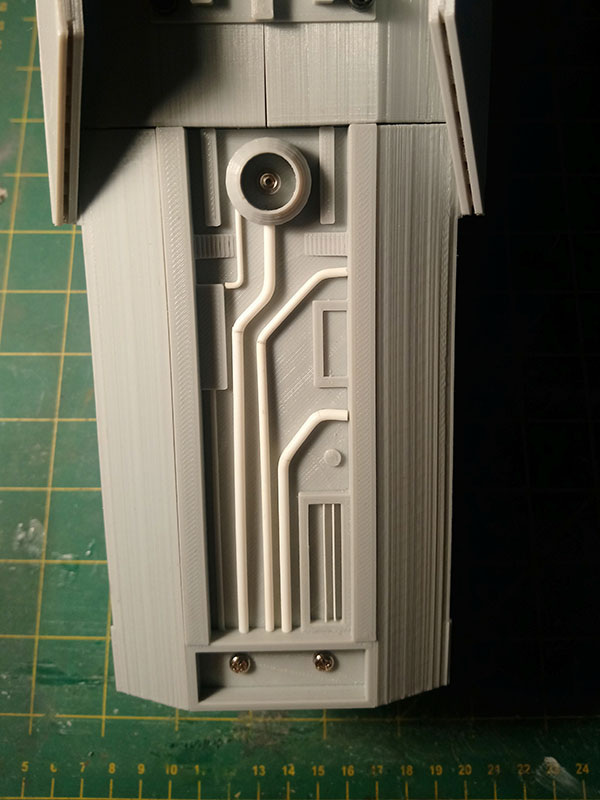

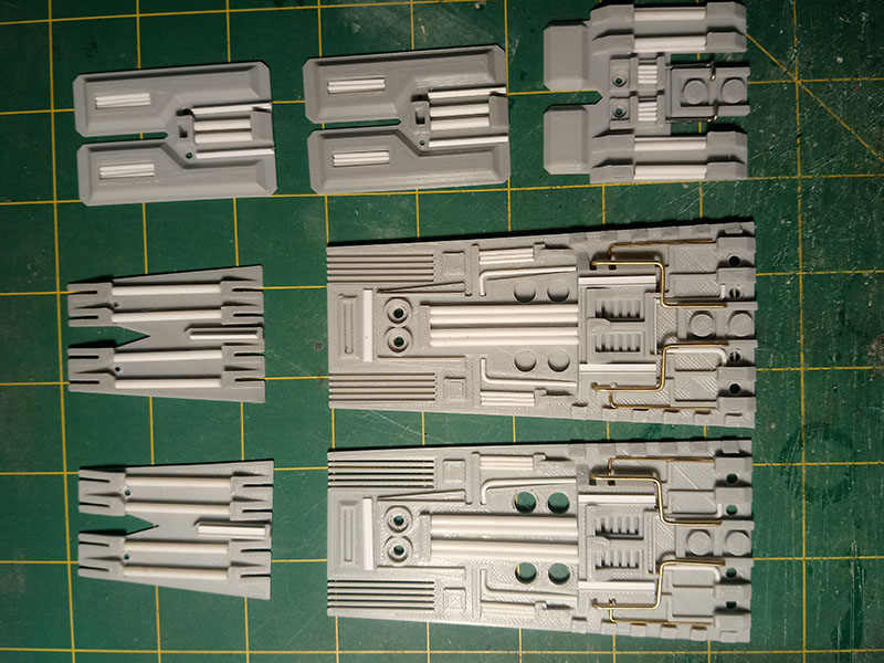

3d printing can do a lot, but it's not so great at small details, and certainly cant print the kind of detail you get from using styrene rods or wires to do things like piping on parts.
But since i designed the ship with lots of detail panels, i started adding styrene to them. Many of the panels were designed with specific details in mind, so i broke out my styrene stash and started adding it all in. In some places where i wanted complex shapes i used wire instead, but am nearly done on these parts. There are still others to do, and i'll get to them all eventually. I could go horrendously overboard given the size of the ship, but i'm trying to keep it mild.
So a few people have asked if i'm going to kit this ship, and the answer is yes :D
In fact a while ago another RPF member who happens to live near me contacted me and asked for one, and it finished printing today.

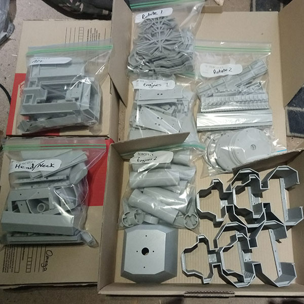

Ended up being 3312gm of plastic, and 283 hours and 24 mins of printing!
For scale, each bag in the pic below is 22x25cm.
