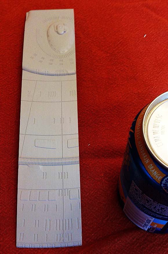

Been working on this CAD model for awhile and here's the last test print of a section of the upper saucer:
This is the straight print with no processing/cleanup other than a shot of Tamiya primer. There a few minor screw-ups-with the print but nothing a very small amount of work won't fix: The model will be 1/1000, about 26" long by 19" wide. Although this will be printed at 2 foot size, it has the detailing of the ILM 6 footer.
Pretty satisfied with this, so the saucer top will be sent to the printer sometime next month.
Thanks for looking!
Looking great, really crisp, especially the detail on the phaser array. The saucer will be quite a size when fully printed!
Thanks! The saucer will be as wide as the 1/1400 model is long...holding the test piece in my hand brings home how big the full saucer will be.

Those prints look really really clean...
What printer did you use? Doesnt look like prusa type... no grain :p

They're done on a resin printer at i.materialise. Finding a high-rez printer that can do large prints has opened up a lot of possibilities for me. They advertise 50 micron resolution but do such a good job setting up that things I've gotten from them look as good as 16 micron prints from others. Never had anything done on an FDM printer as I'm not sure the sesolution would be sufficient...too bad since I could buy a good quality FDM printer with what this will cost to have printed in resin. This model will cost in the neighborhood of $4k to print...if I could find a printer for that price that would handle parts this big, work in the resolution I need, but not require months of fiddling and adjusting in order to produce large pieces of similar qulaity to what's shown in the above images, I'd seriously considering buying it.
As you can see in the pics, this part has no grain or layering worth speaking of. There were a few glitches and some details were left out but problems were expected...i.materialise advertises minimum details of .5mm for this material, but I made this model with most fine details (window depth, phaser emitter depth, grid lines) at .2mm, assuming they allowed a margin of error that could be pushed. For the most part, it worked out.

For me, it's a question of time vs. money...when I had the pieces printed on my Reliant project, several months were spent cleaning them up to make them suitable as masters. The test pieces I've gotten back for this project would need little post-processing. IMHO, saving the time is worth the cost. That said, I've been looking into 3D printers again and am surprised how far FDM has come...seen one advertised that would suit my needs; large enough prints at 50 micron layering. But I can't find pics of any actual large pieces printed at that rez to judge quality. More research....
