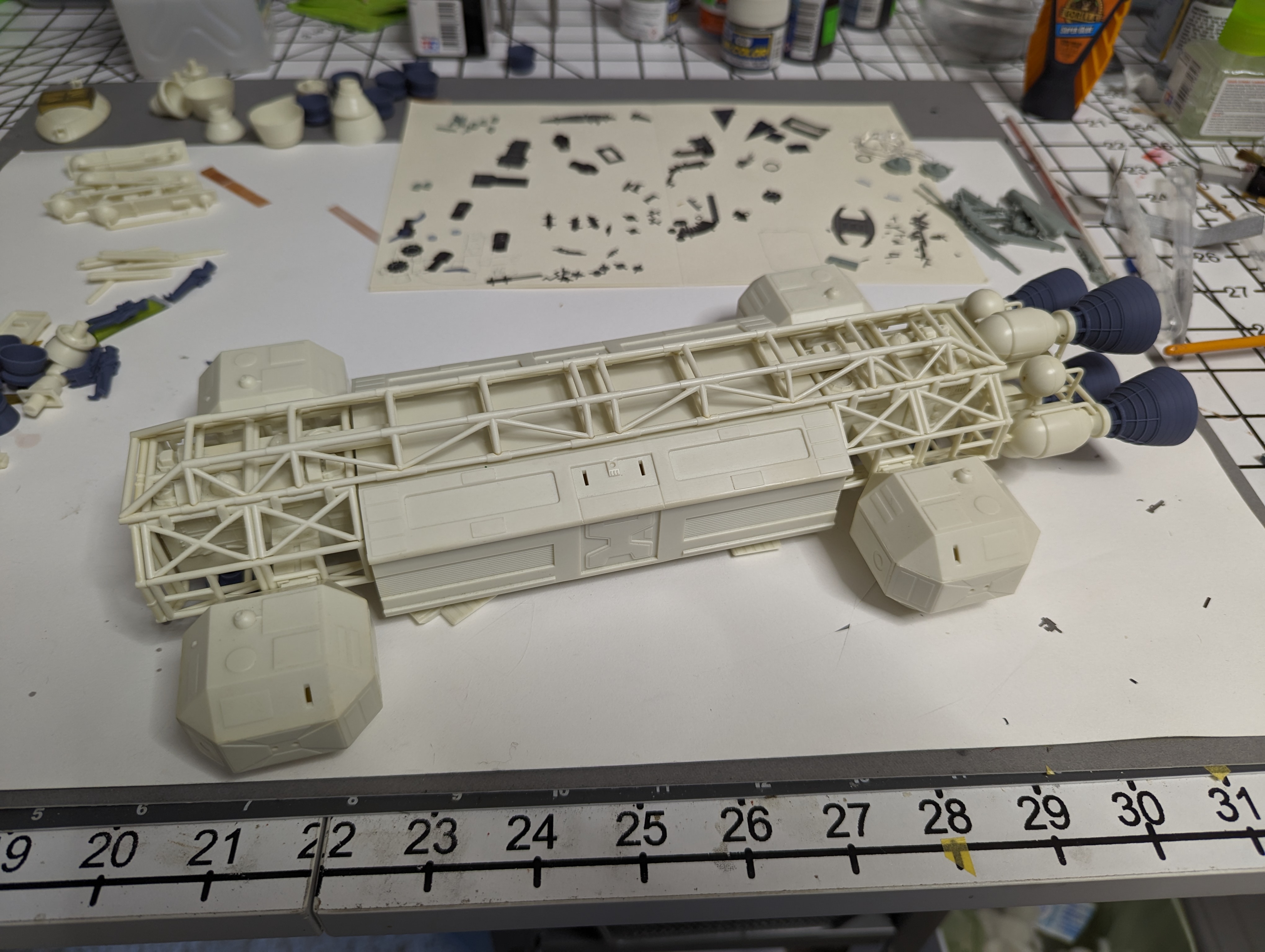

1/72 MPC Eagle Transporter + Resin + PE super detail *WIP*

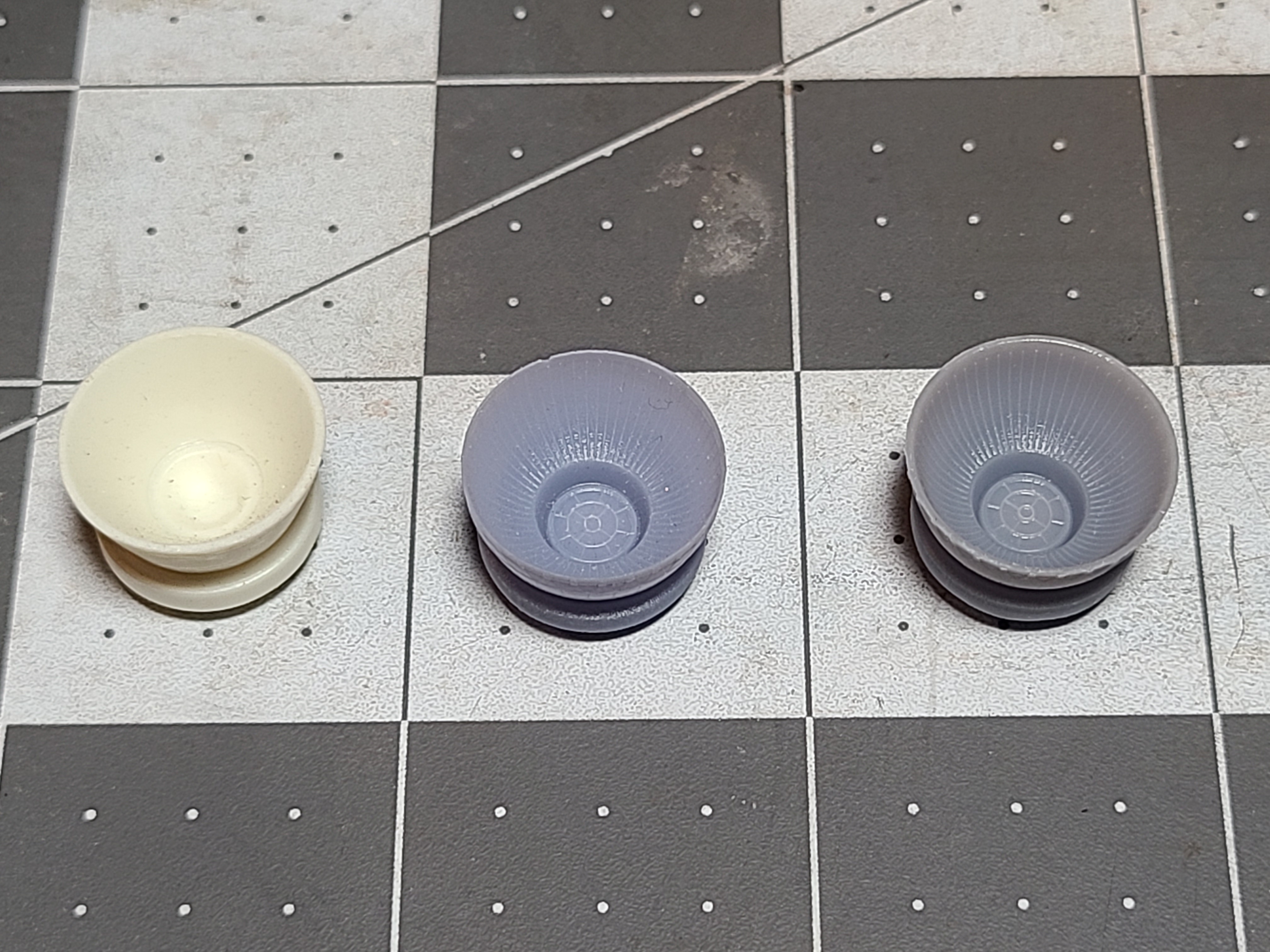

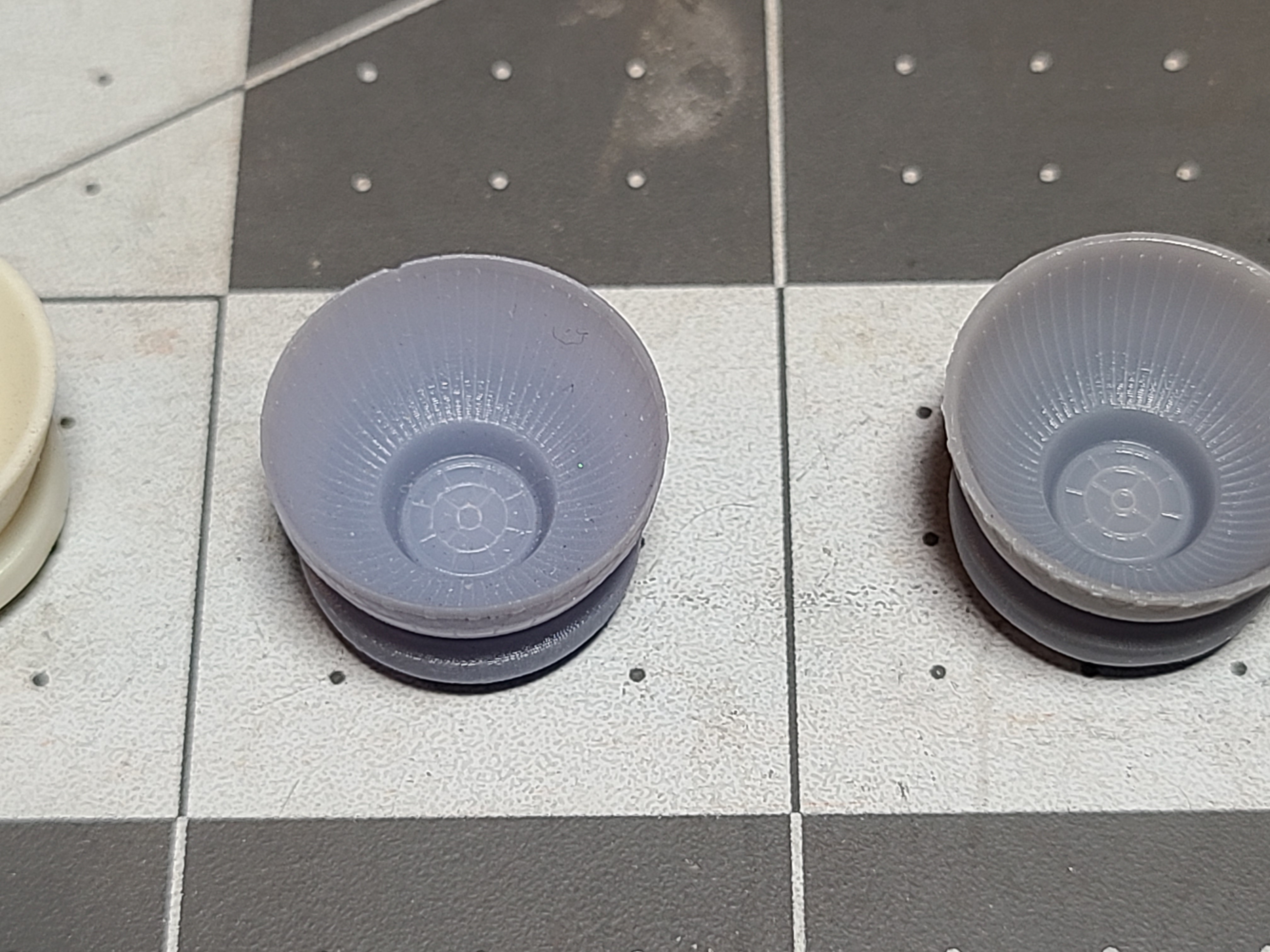

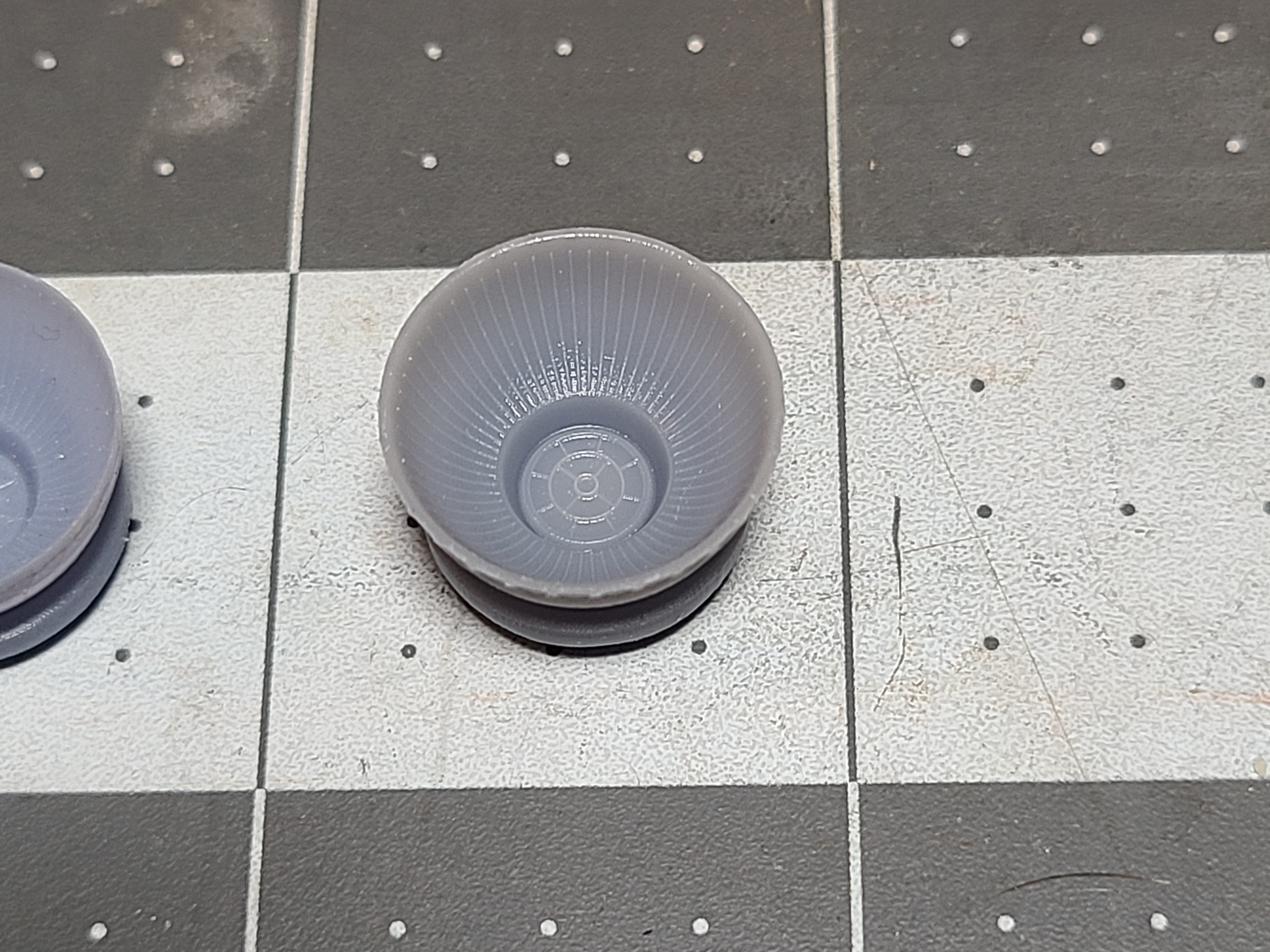

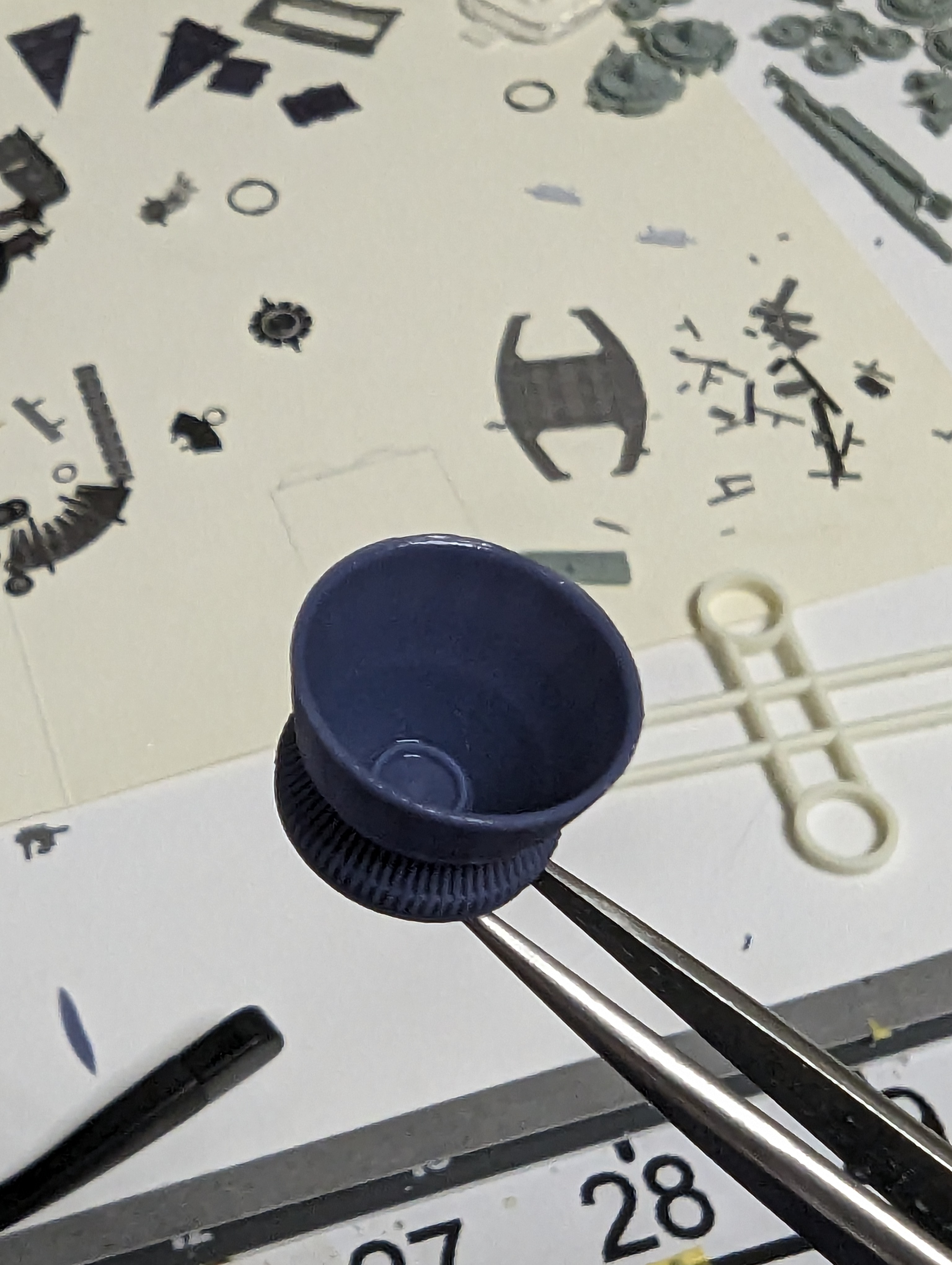

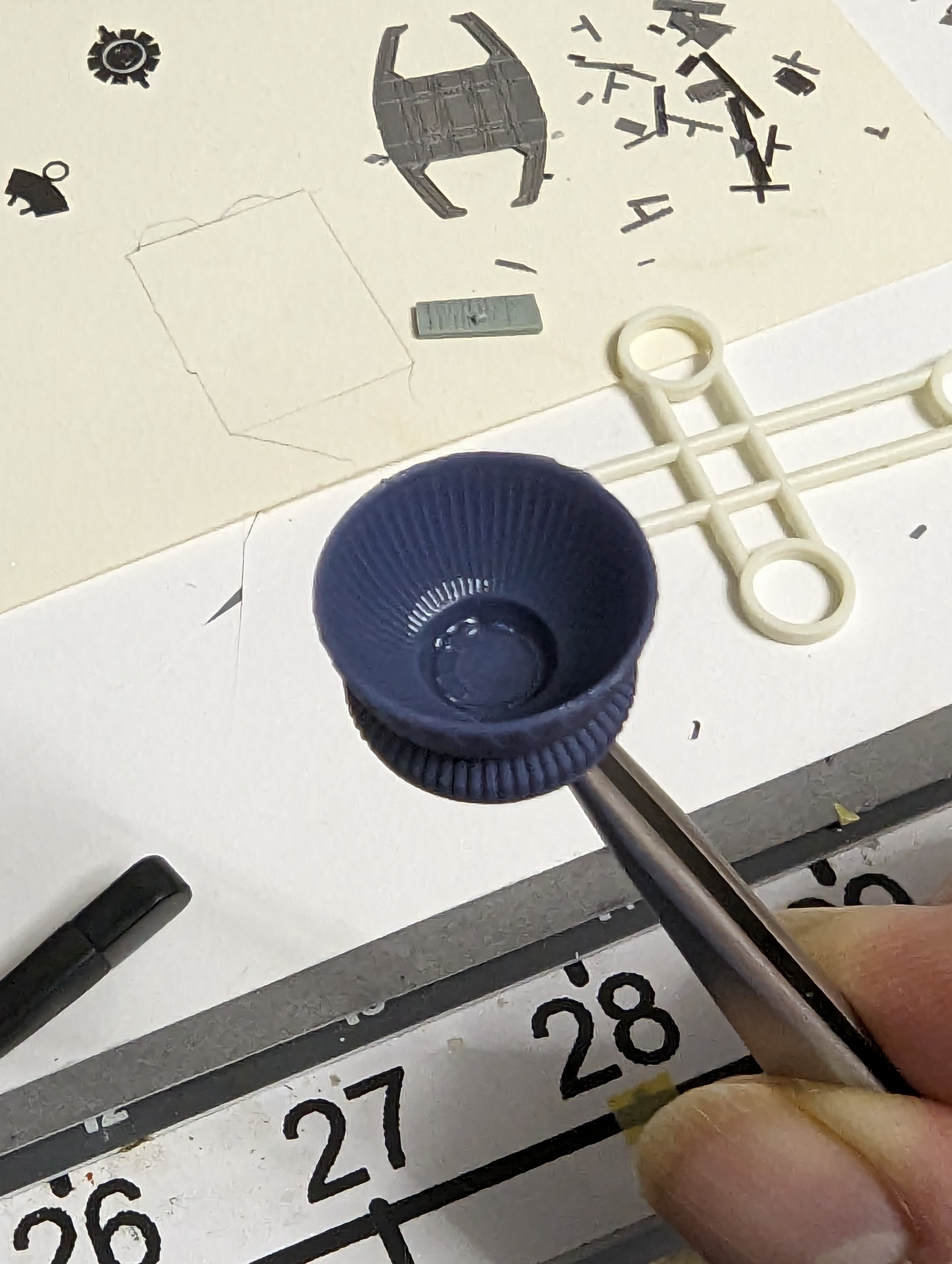

Here are the VTOL engine parts. Other than figuring out the anti-aliasing and cleaning up the back sides, I think these are good to go.
v1: The bell edges are very delicate before curing and the details were tough to make out.
v2: the details are much more crisp and visible. Other than sorting out the AA, I think it's good.

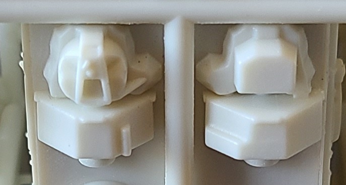

Yep, I noticed that when I was taking a close look deciding where to add detail. :) At some point I want to go over pics of the filming model and see if it's a specific kit part (I'm assuming it is).
Airfix. They had the 1/144 Saturn and the 1/72 LEM, one being half the size of the other so perfect for the 22in and 44in Eagles. The Revell Gemini kits were also in complimentary scales 1/48 and 1/24.

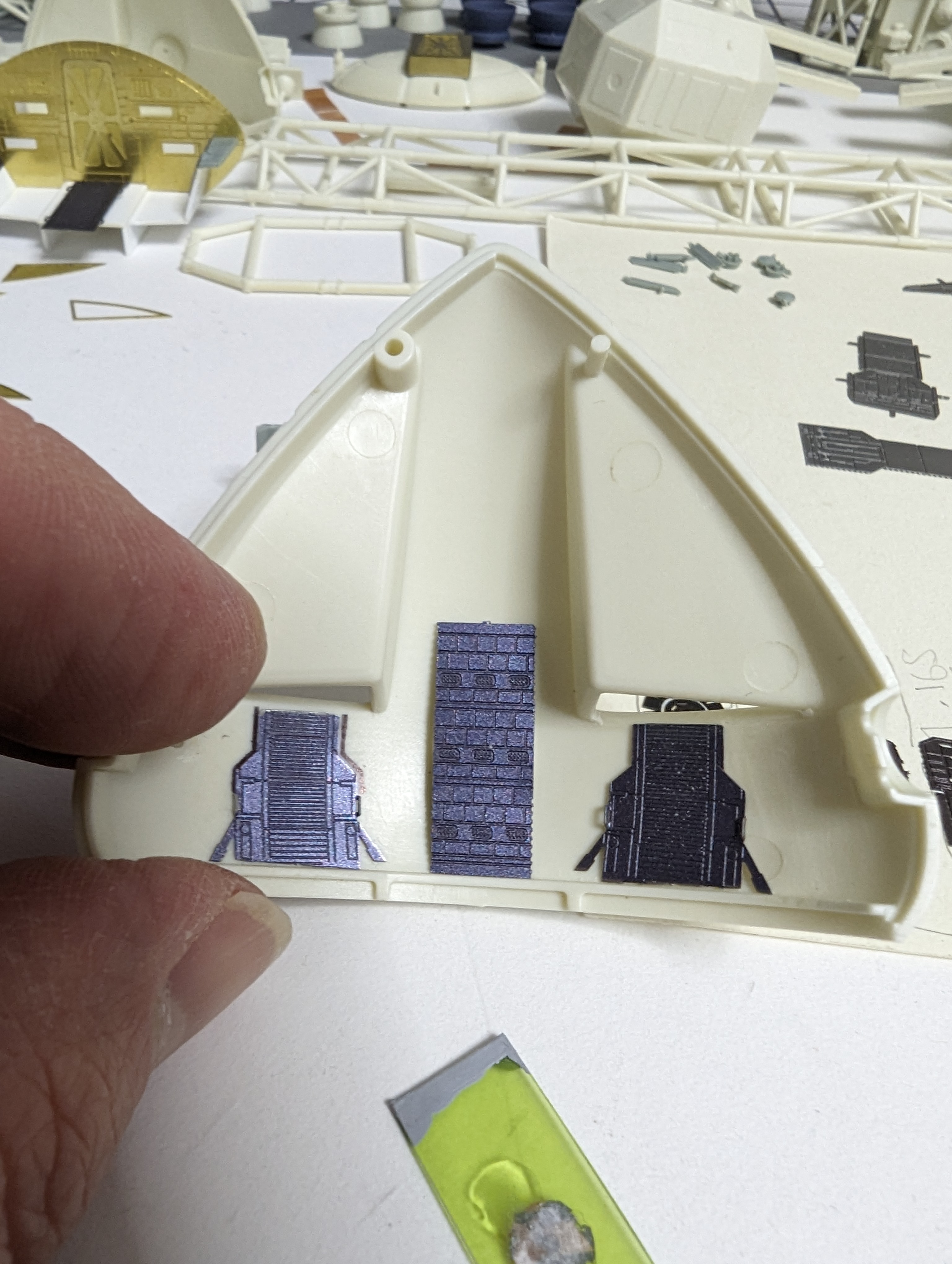

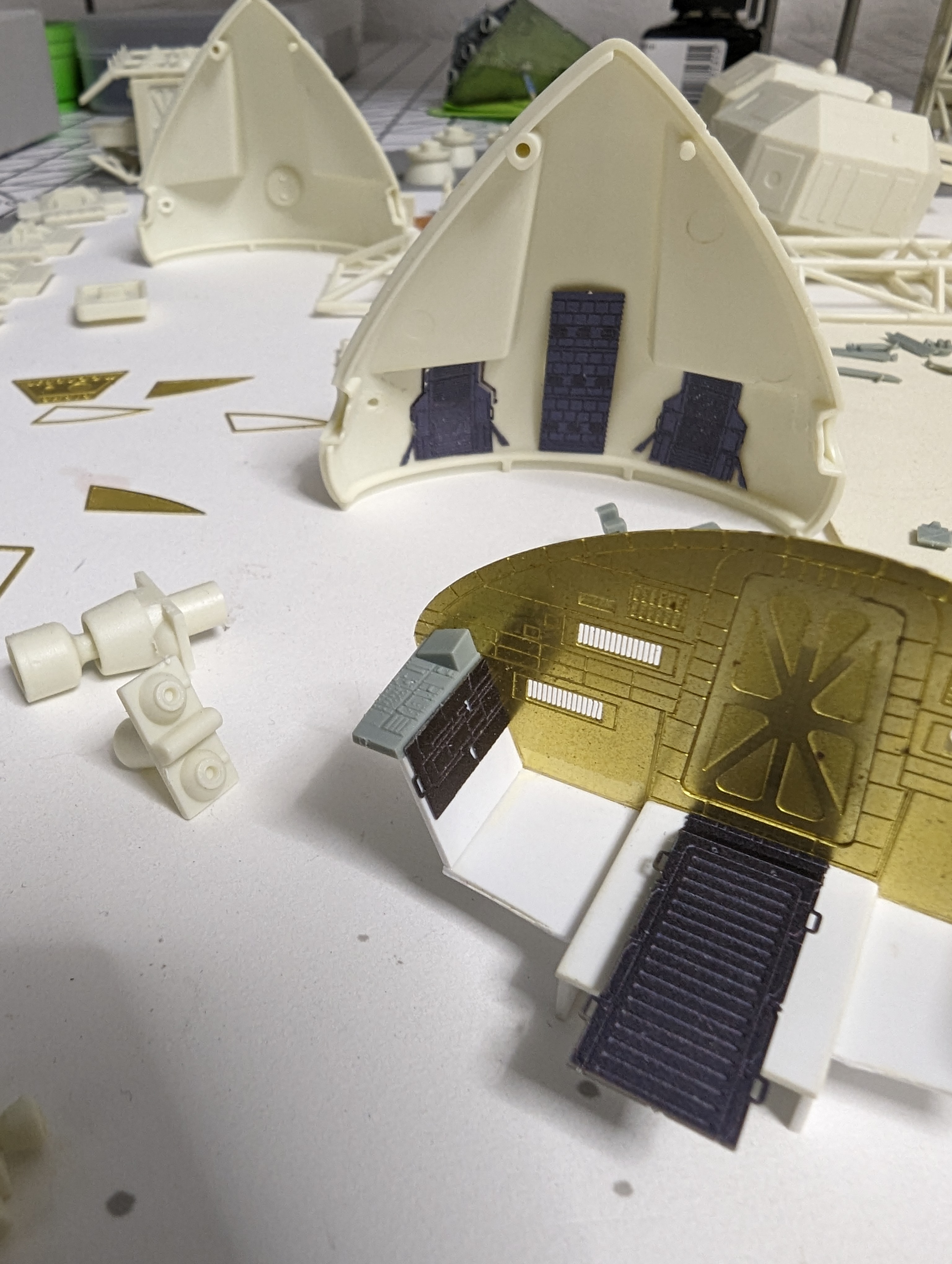

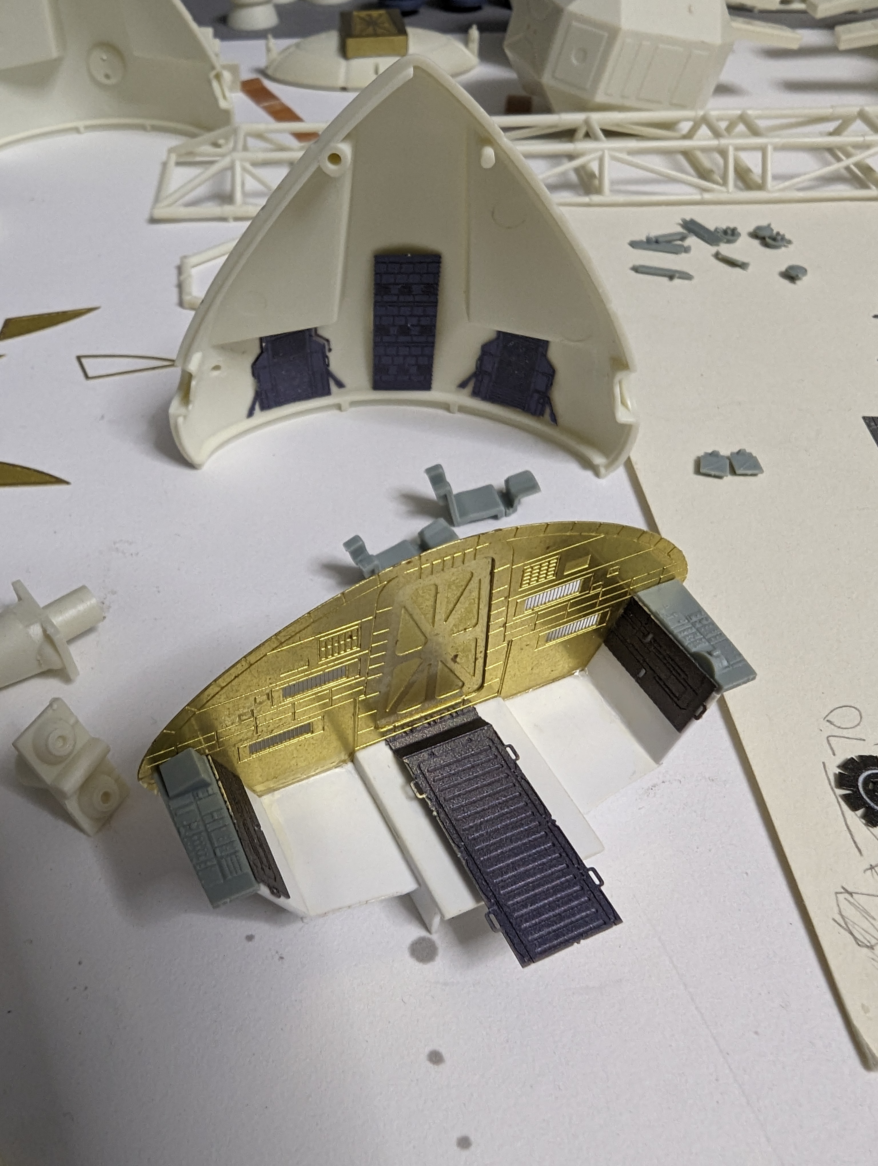

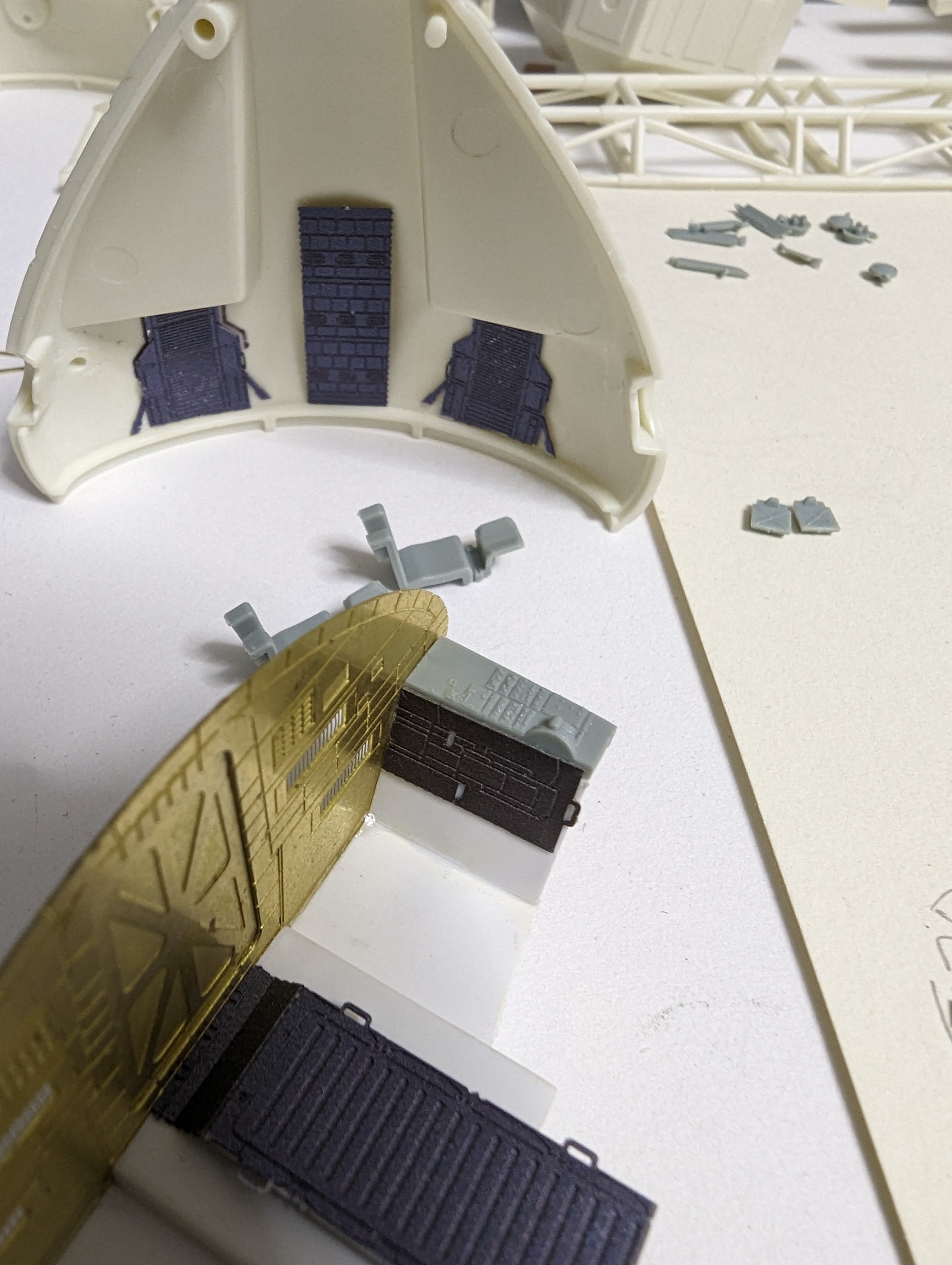

The cockpit is coming along nicely. I added two of the D model side instrument panels from my F-14 (built as an A) and some unused PE from my Metal Earth Razor Crest. It's still going to be tough to see, but it should give it a little interest. I also cleaned up the window openings and put in a nice bevel on the interior. I also have the D seat backs from the F-14, I'll need to scratch some sides for them, but they should work nicely to give the pilots a place to sit.
I used more of the PE for some ceiling detail. They're just tacked on and I'll fill in the gaps in the center panel with some evergreen.

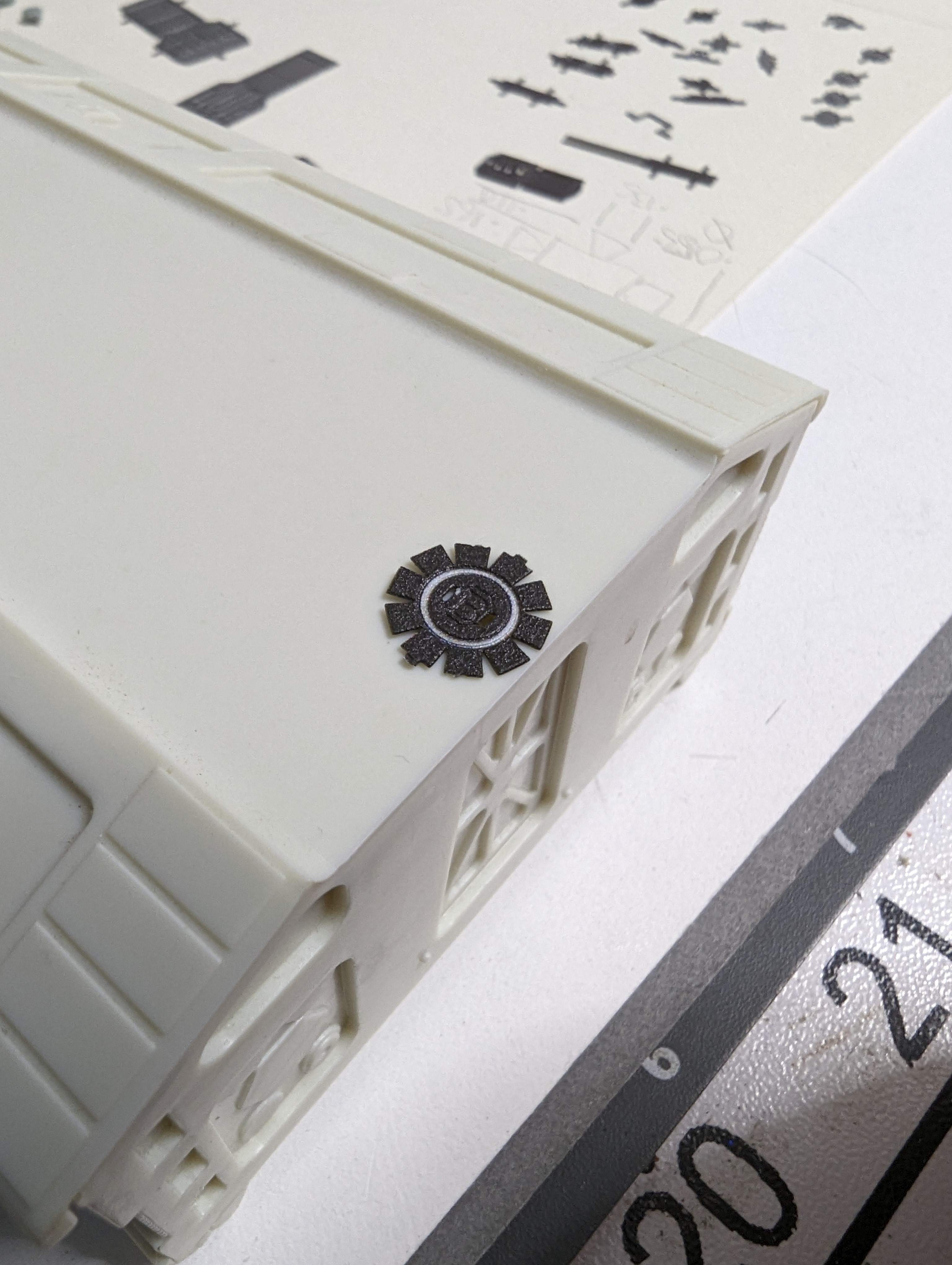

More PE from the Razor Crest to cover where the screw slots are on the spine. The passenger module attachment magnets will go here and they will hide them nicely.

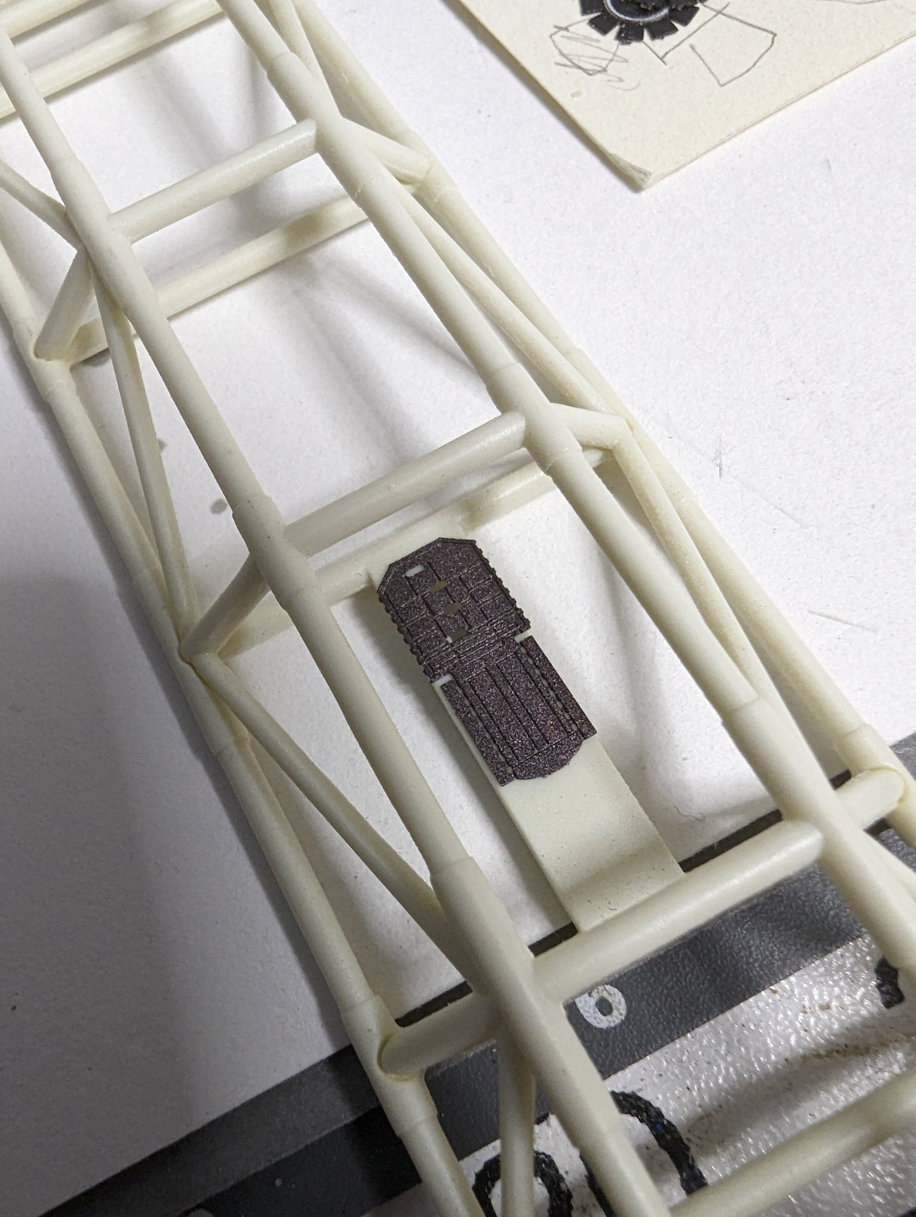

Another piece of PE to cover the magnets in the passenger pod. It kind of looks like a docking clamp greeblie and I think it fits the bill nicely.

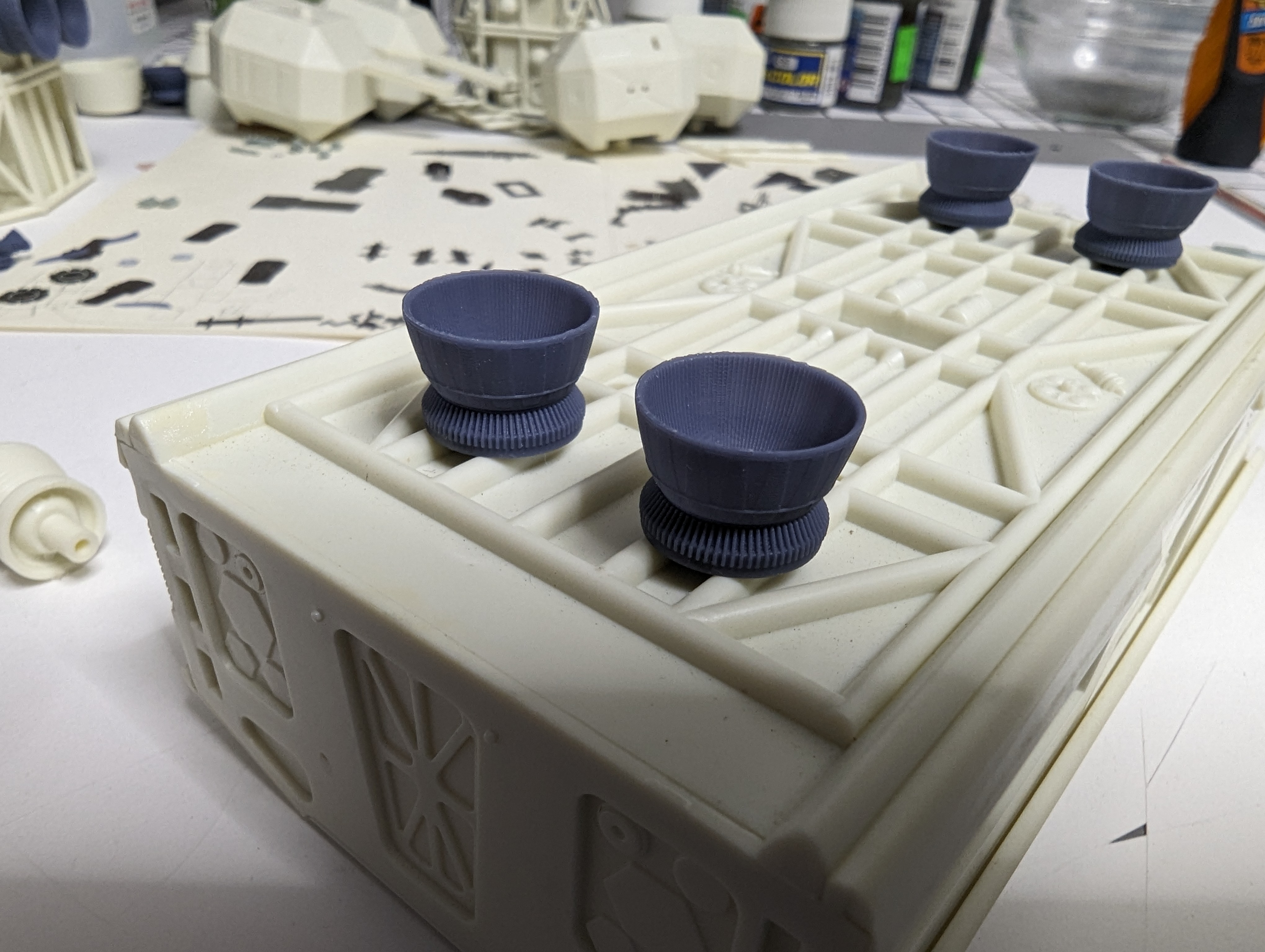

Before we moved to Texas, I printed some of the VTOL thrusters in Siraya Tech Fast Navy Grey. I really like how they came out. Now I just need to get back to modeling the rest of the engine bells.

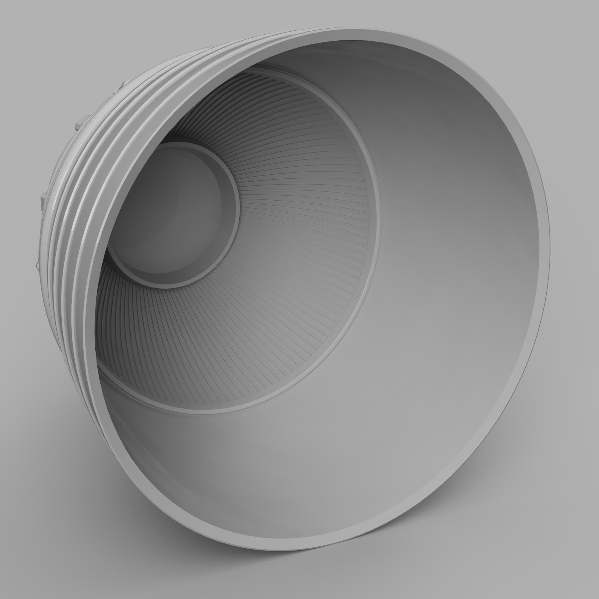

I fired up Fusion again and made great progress on the main engines. I've never been a fan of the plate with 5 holes of the filming miniature, so I made a pretty big departure from them. I melded some of my favorite aspects of the F-1 and RS-25 and threw in a touch of my own mojo for good measure. I still need to work on detailing the injector plate in the combustion chamber and I'll probably throw in some additional small details here and there, but I'm really happy with how it's looking. I'll need to set my printer back up and see how they come out before I do too much more though.

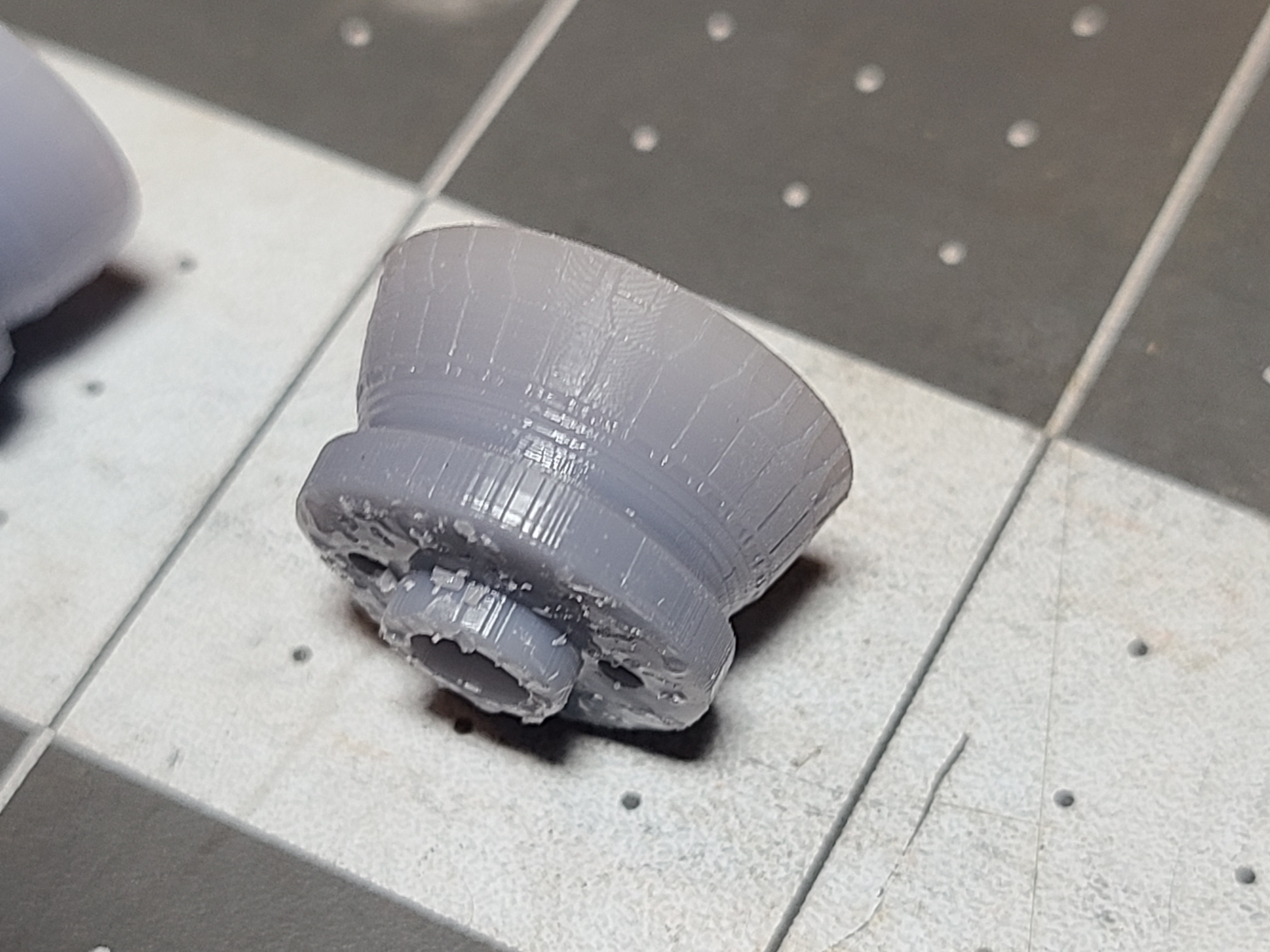

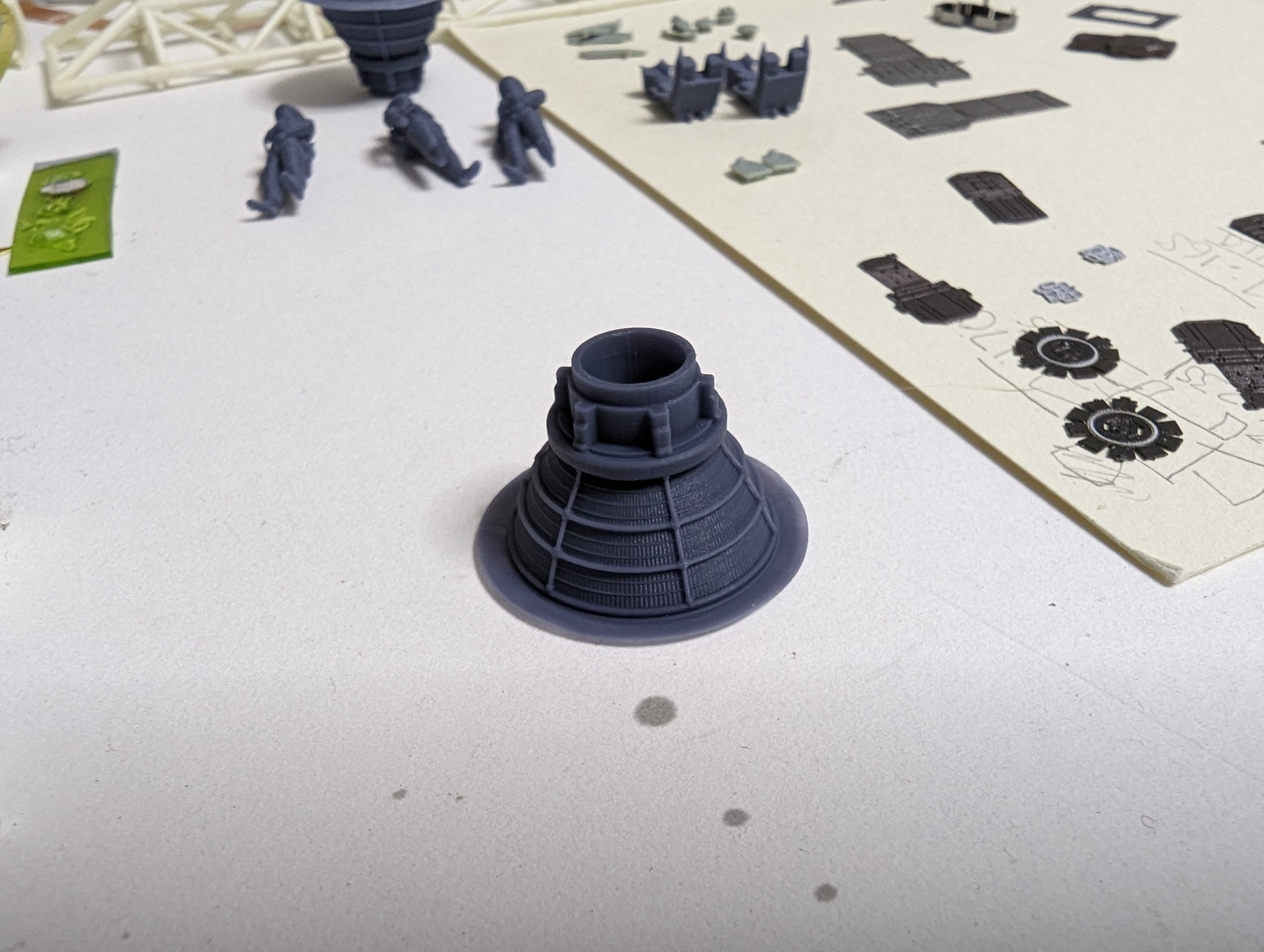

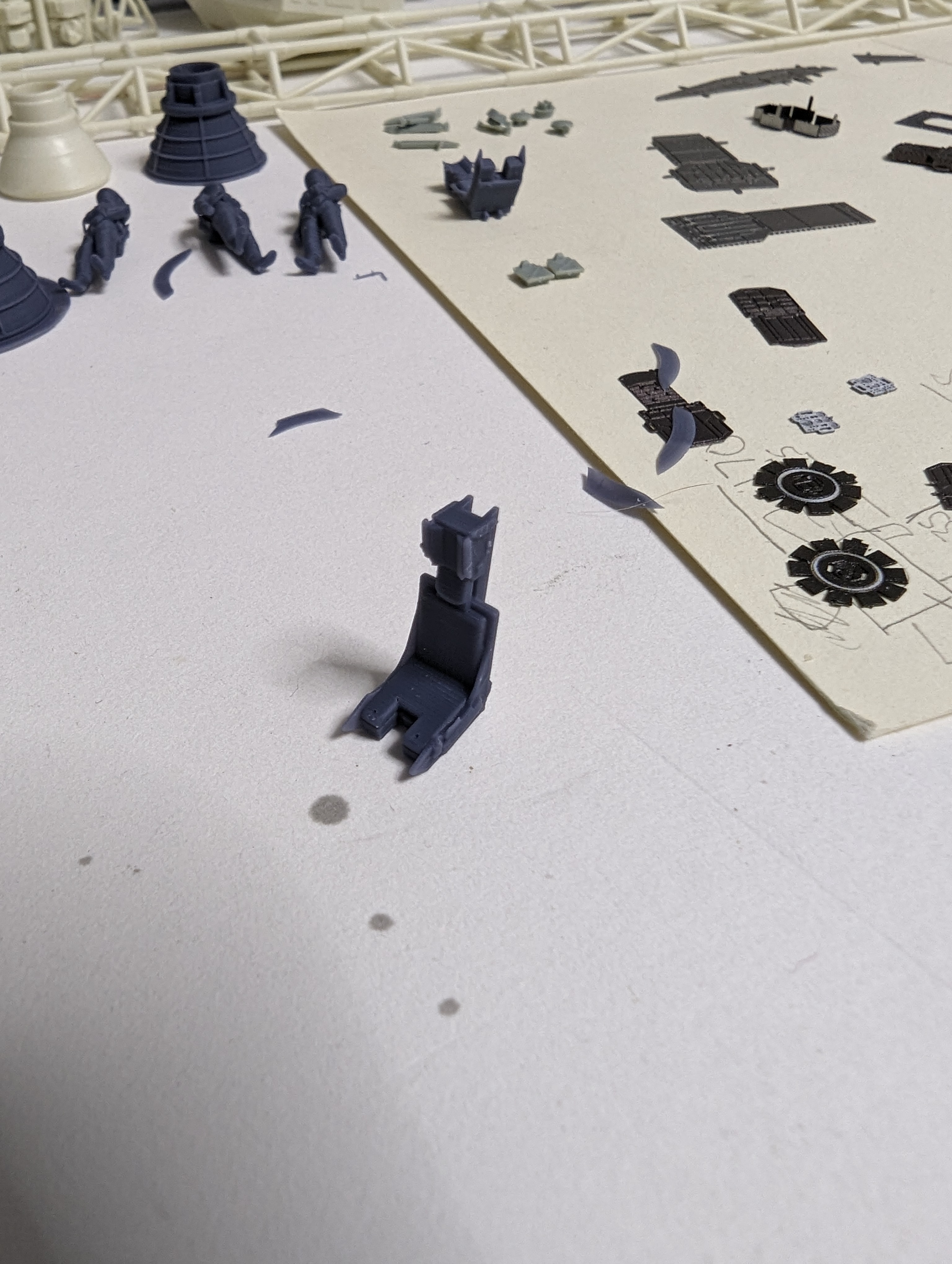

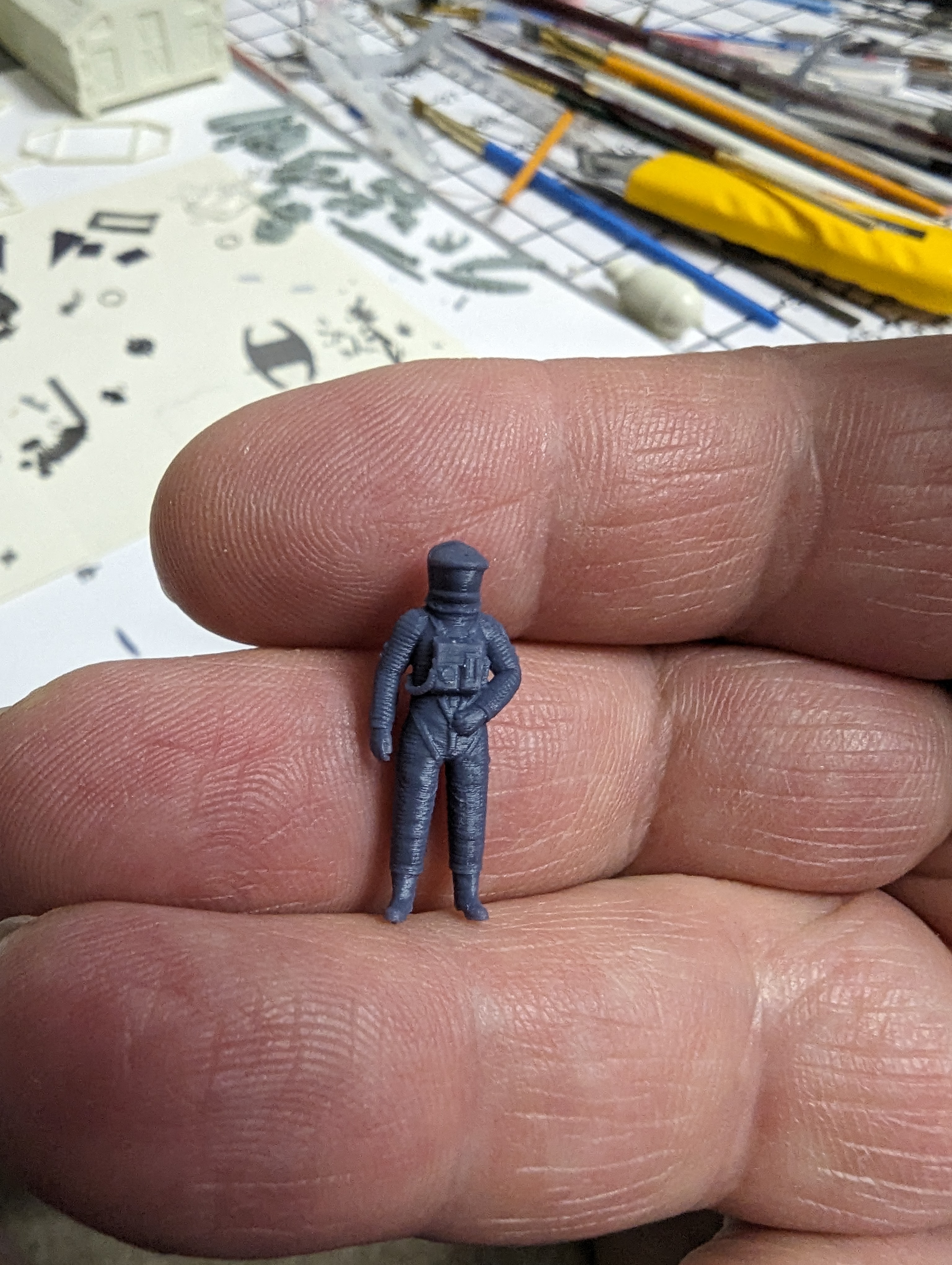

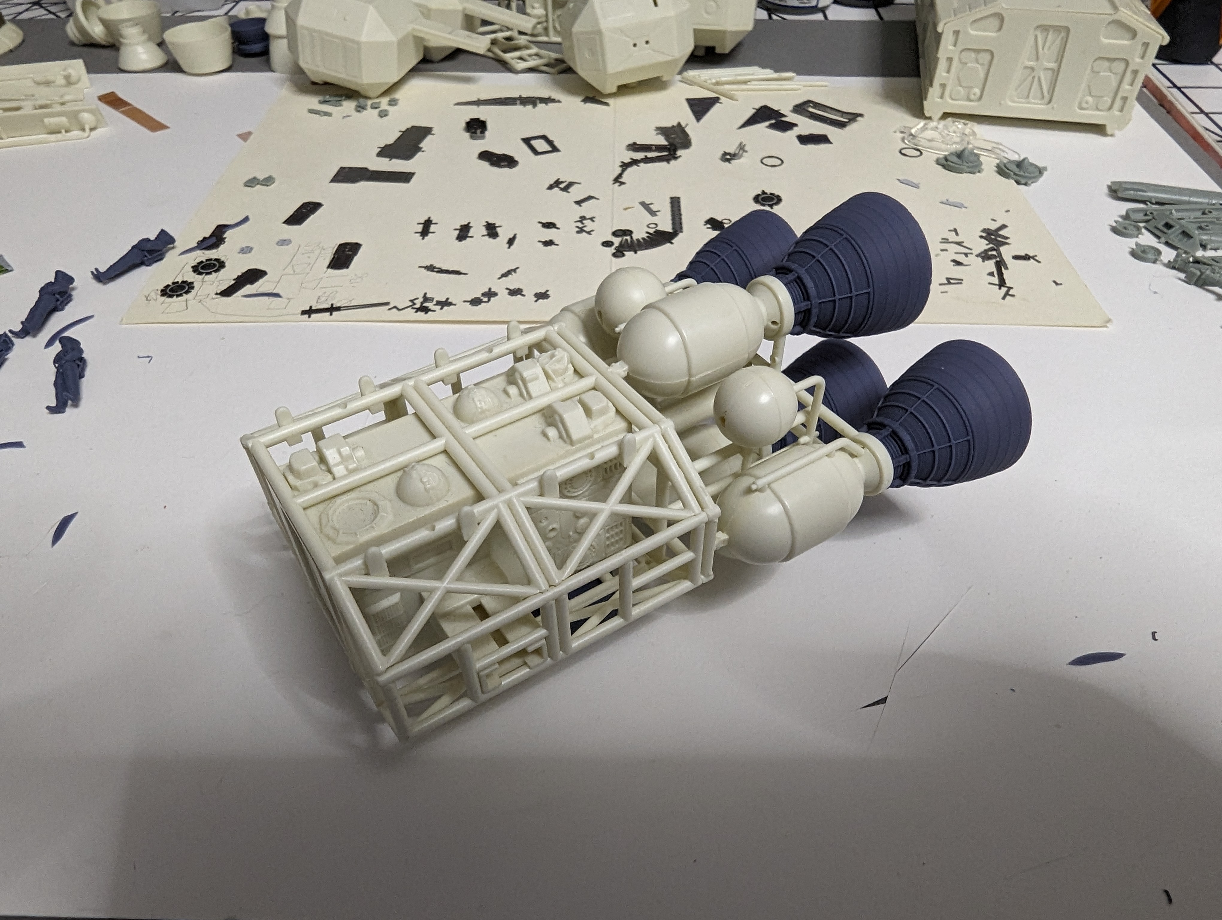

I got my Saturn dialed back in and ran a test print of the main engines. The part I was worried about was OK, the fine tube detail on the upper half printed without issues. And it failed where I didn't expect it to, the smoother lower half didn't print at all. I tried a novel approach to support, and I think it needs some tweaking. The good news is that the interface to the structure is pretty good and fits without any issues. I also printed some seats and pilot figures (I'll need to do major surgery to move them into seated positions).

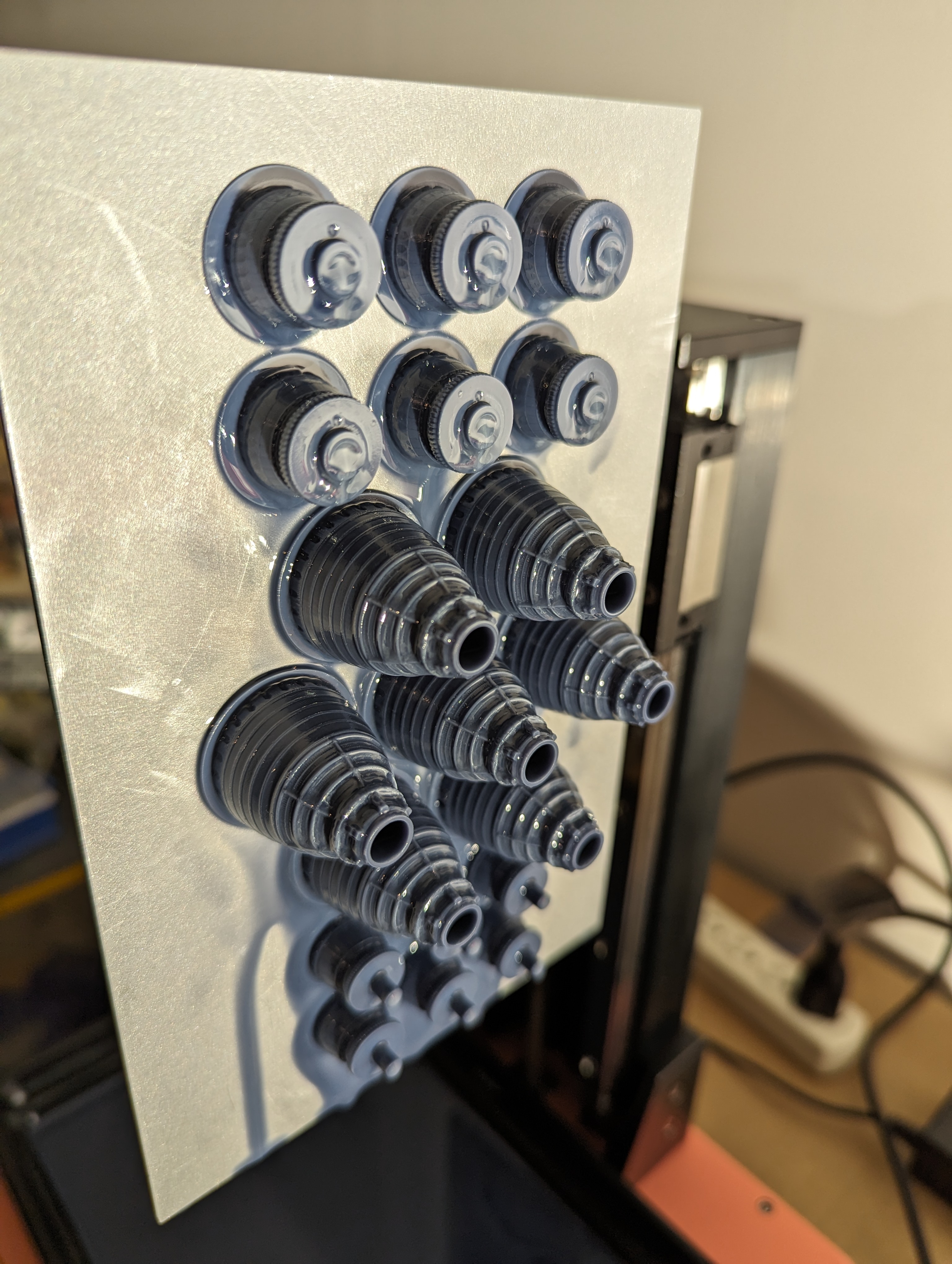

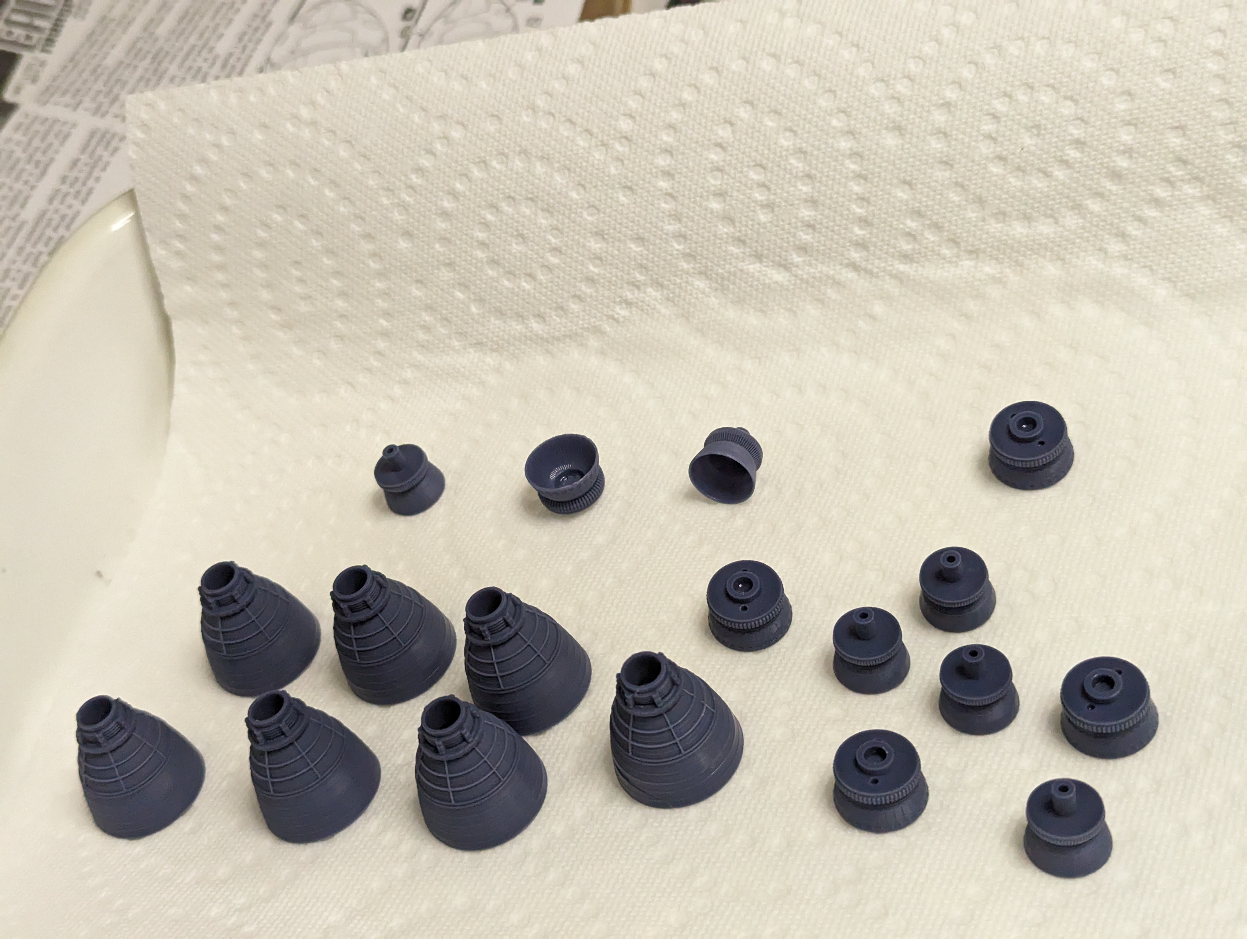

After several rounds of tweaks I think I have a useable set of engine nozzles. They're drying after a primary and secondary wash in 99% IPA and then I'll post cure to see how they really came out. I broke at least two of the main engine bells taking them off the supports, but I printed extra, so no big deal. It looks like I'll also need to do some light sanding on the edges of most of them to smooth out the edges of the continuous supports I used, but they should come out nicely.
On the plate letting the excess resin drip off. The last run I ended up with only the supports on the plate.
Removed from the supports and washed in IPA.

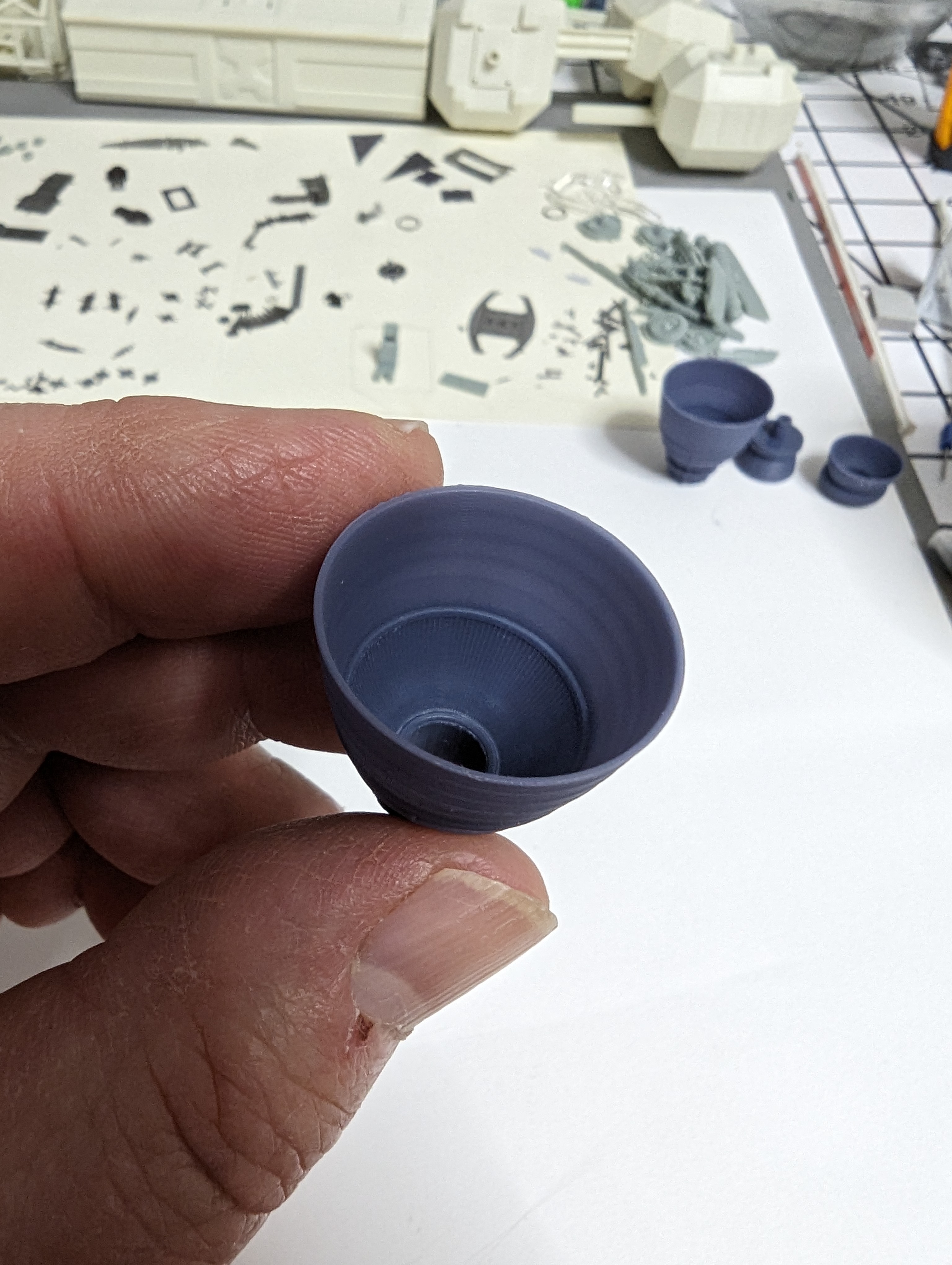

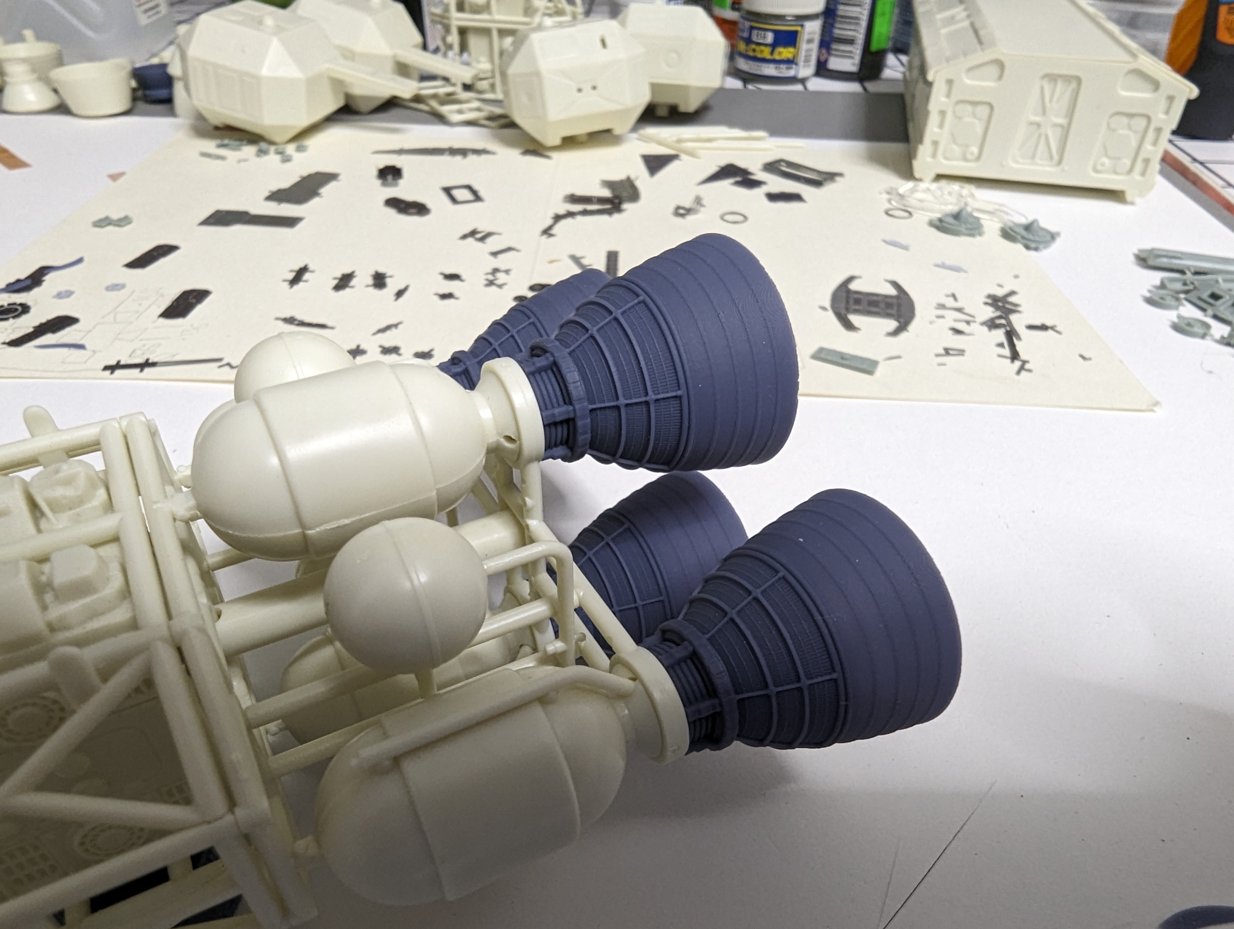

Main Engine. I'm super happy with how it's looking at this point.

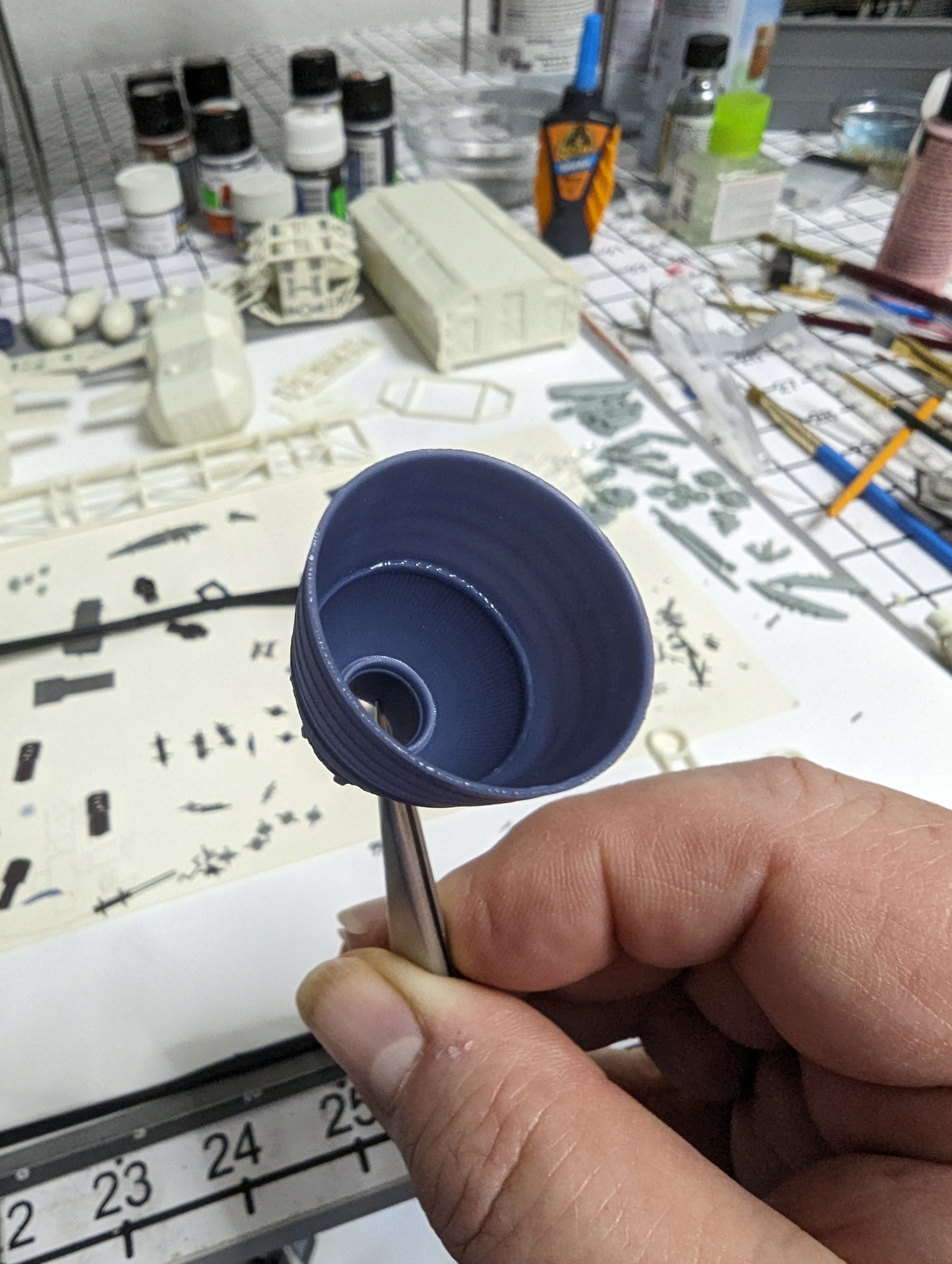

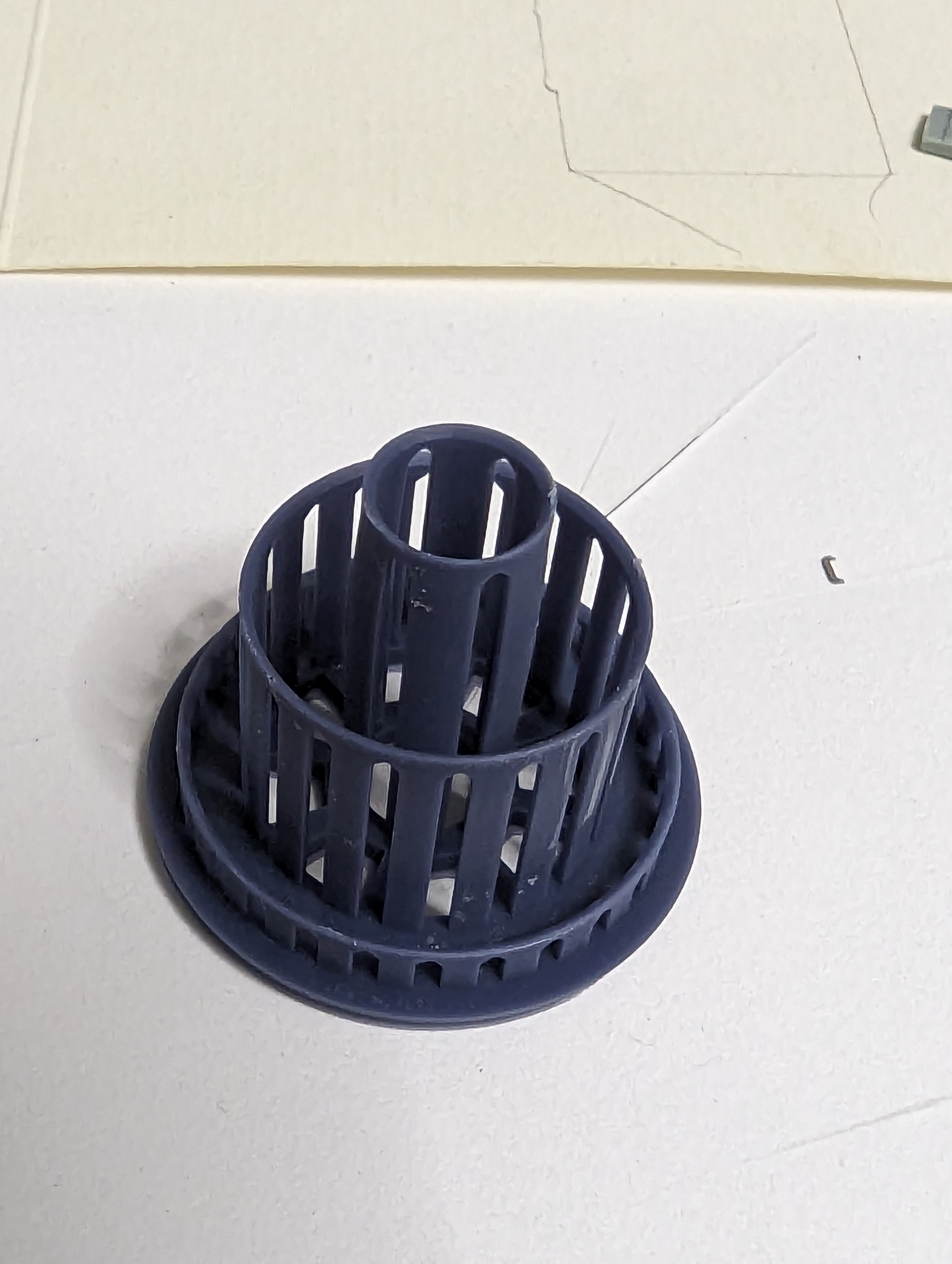

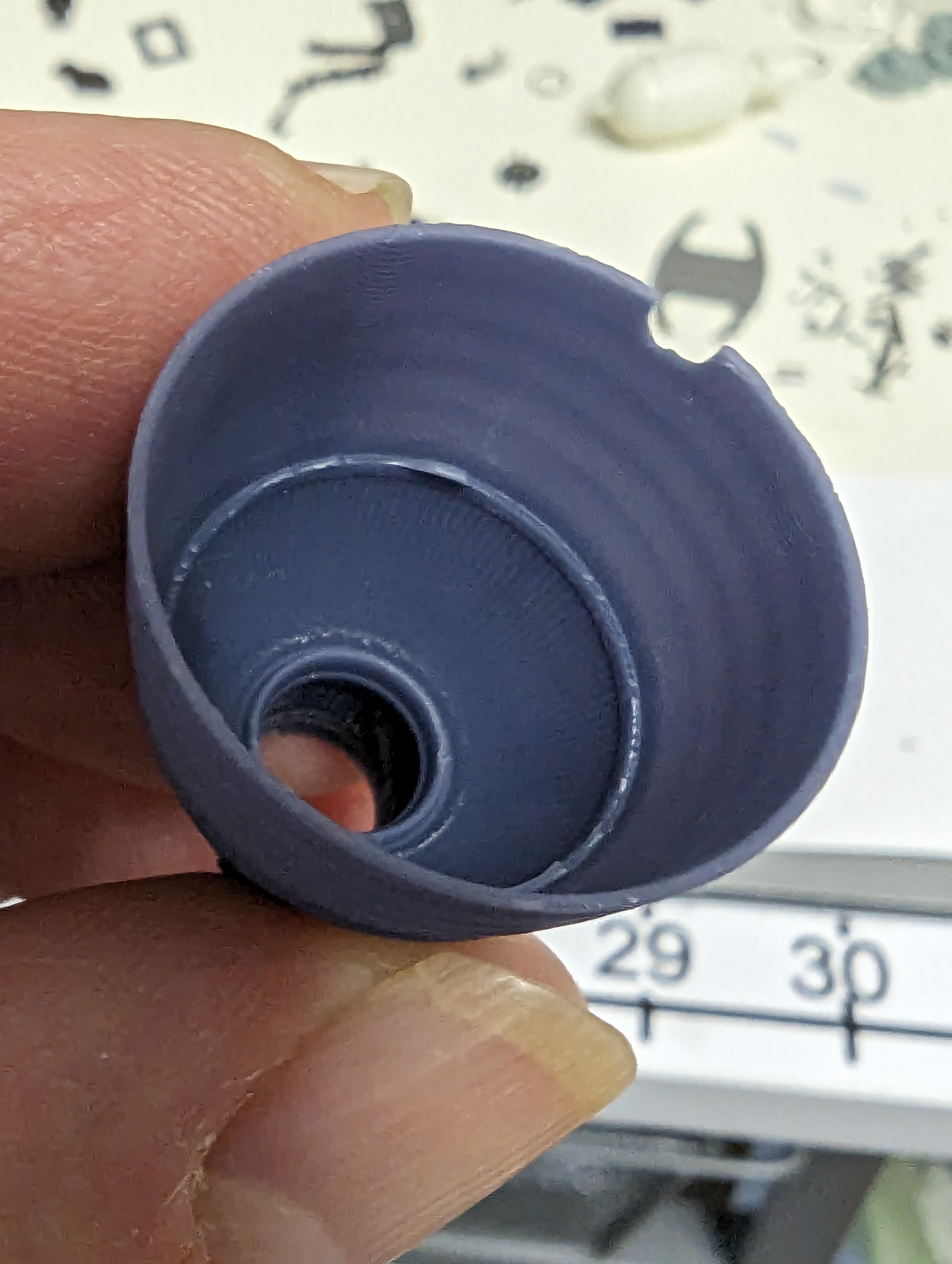

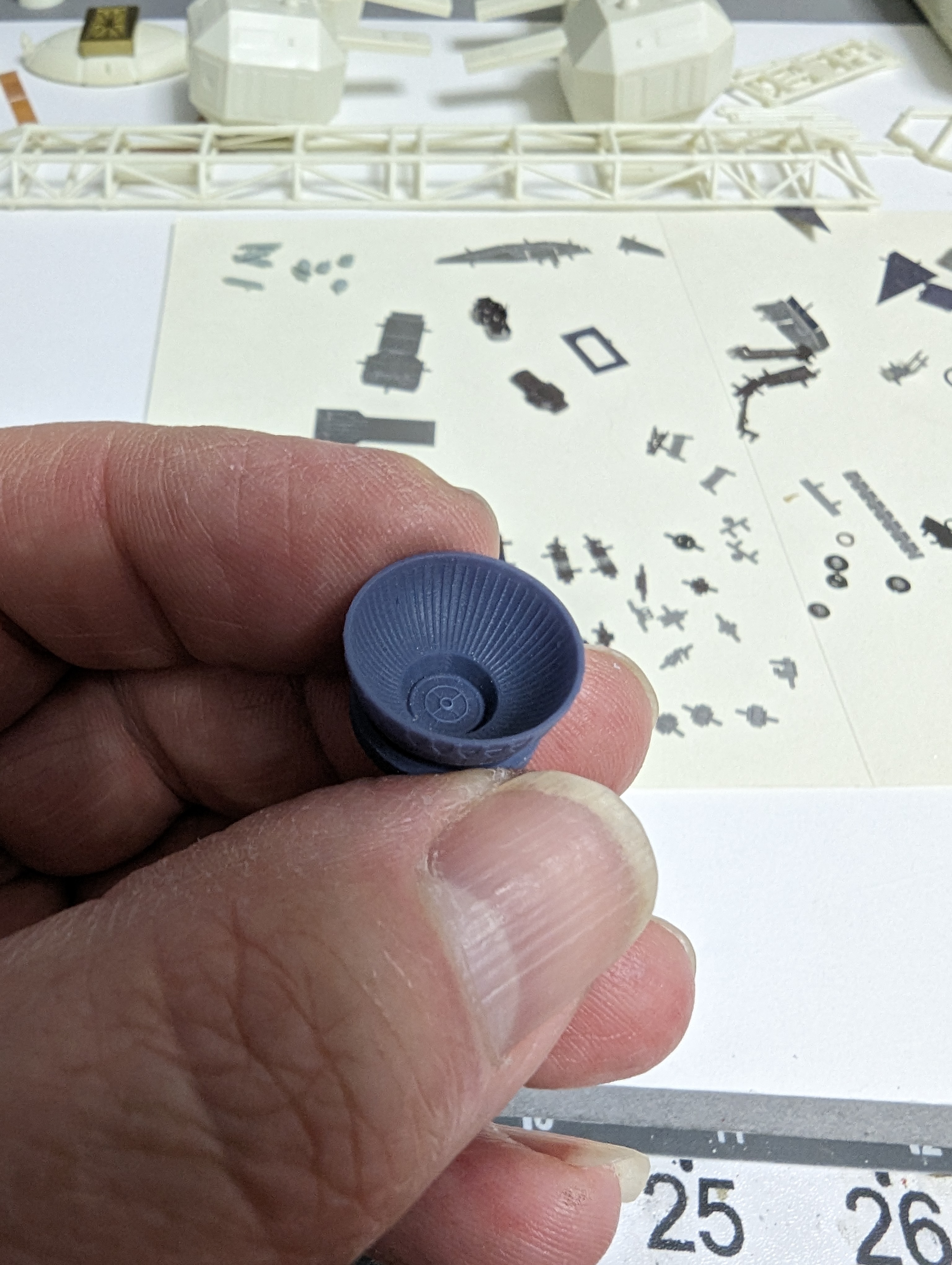

Inside of one of the main engines. I left the center open for LED lighting.

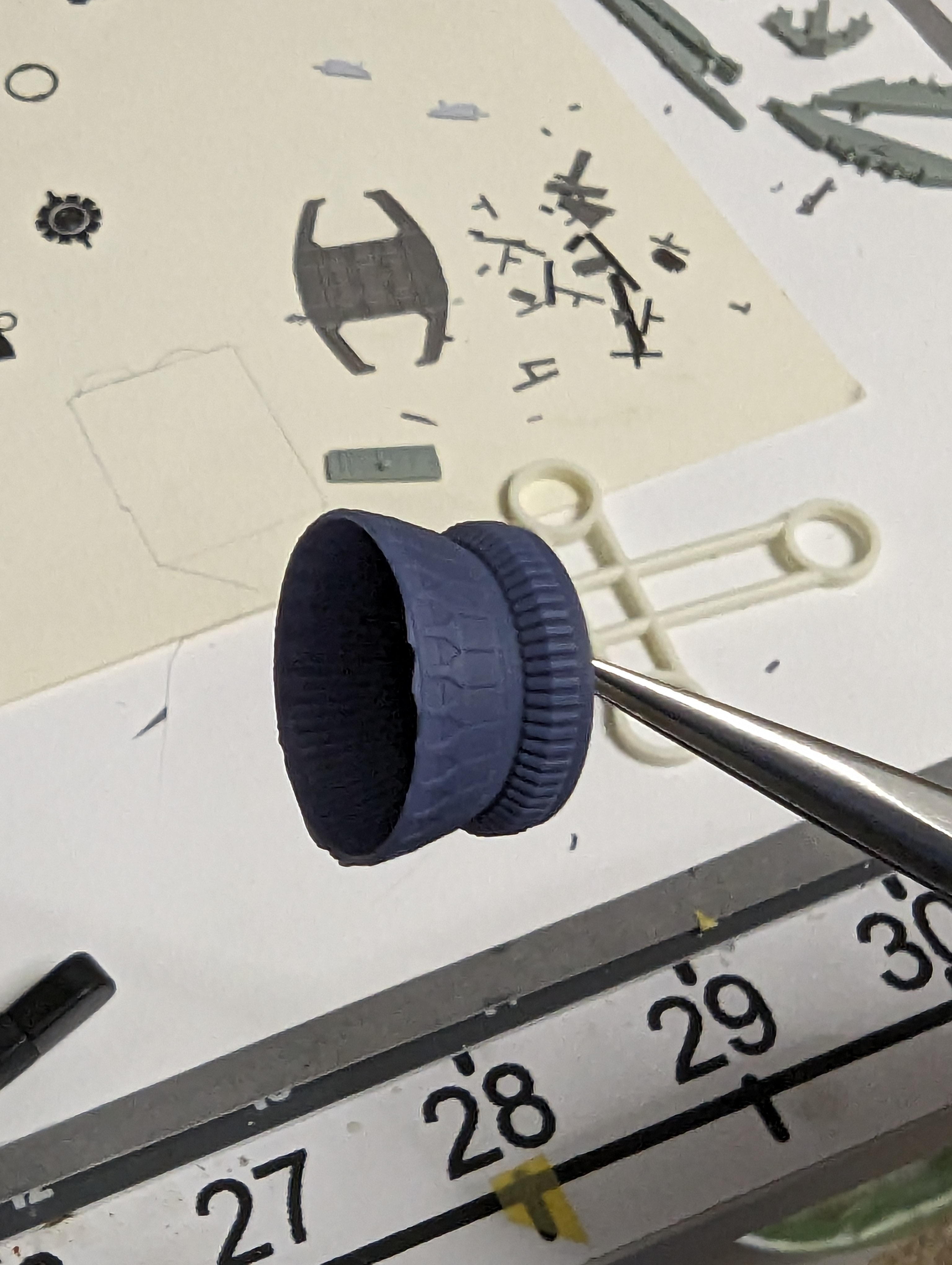

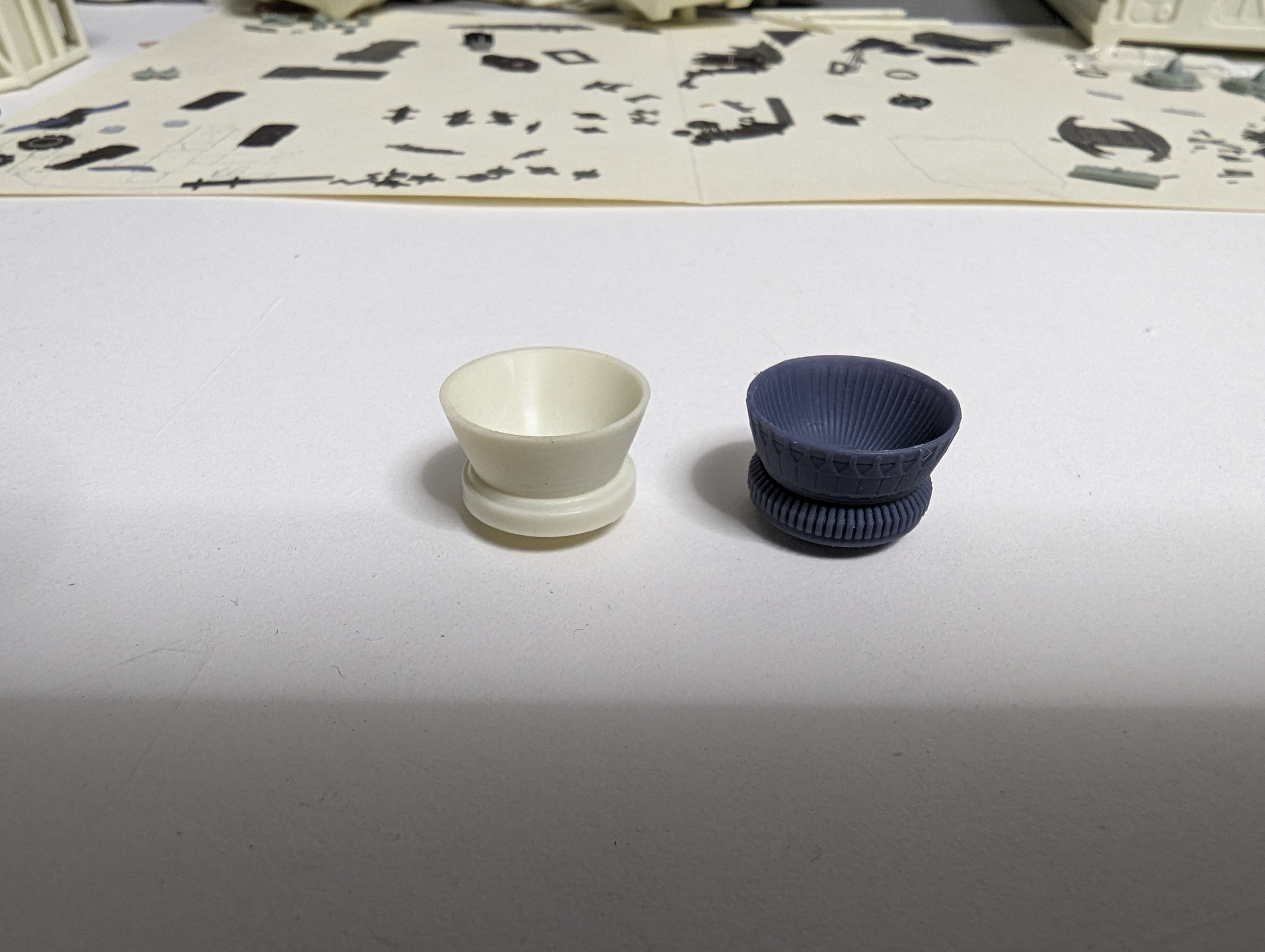

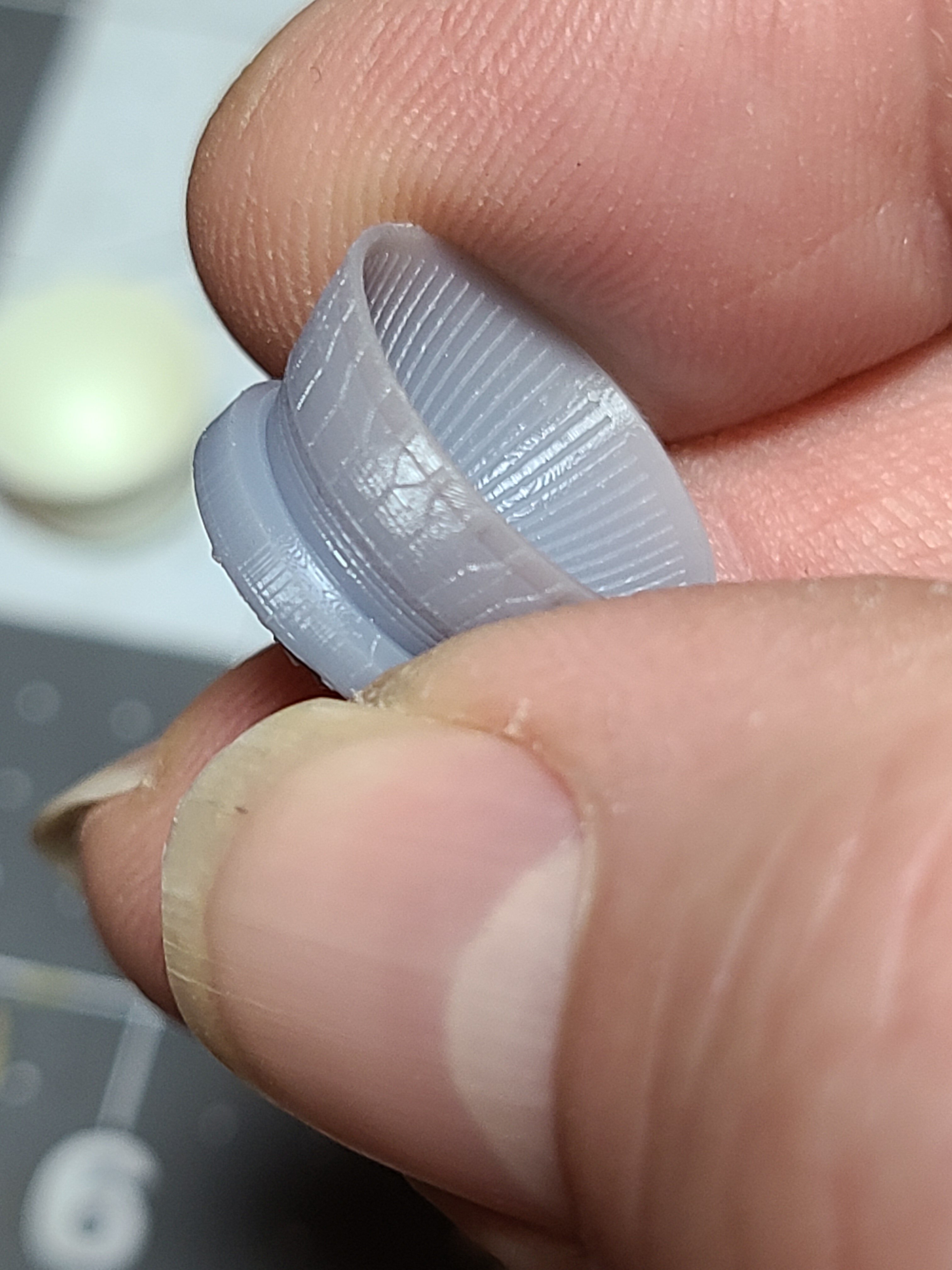

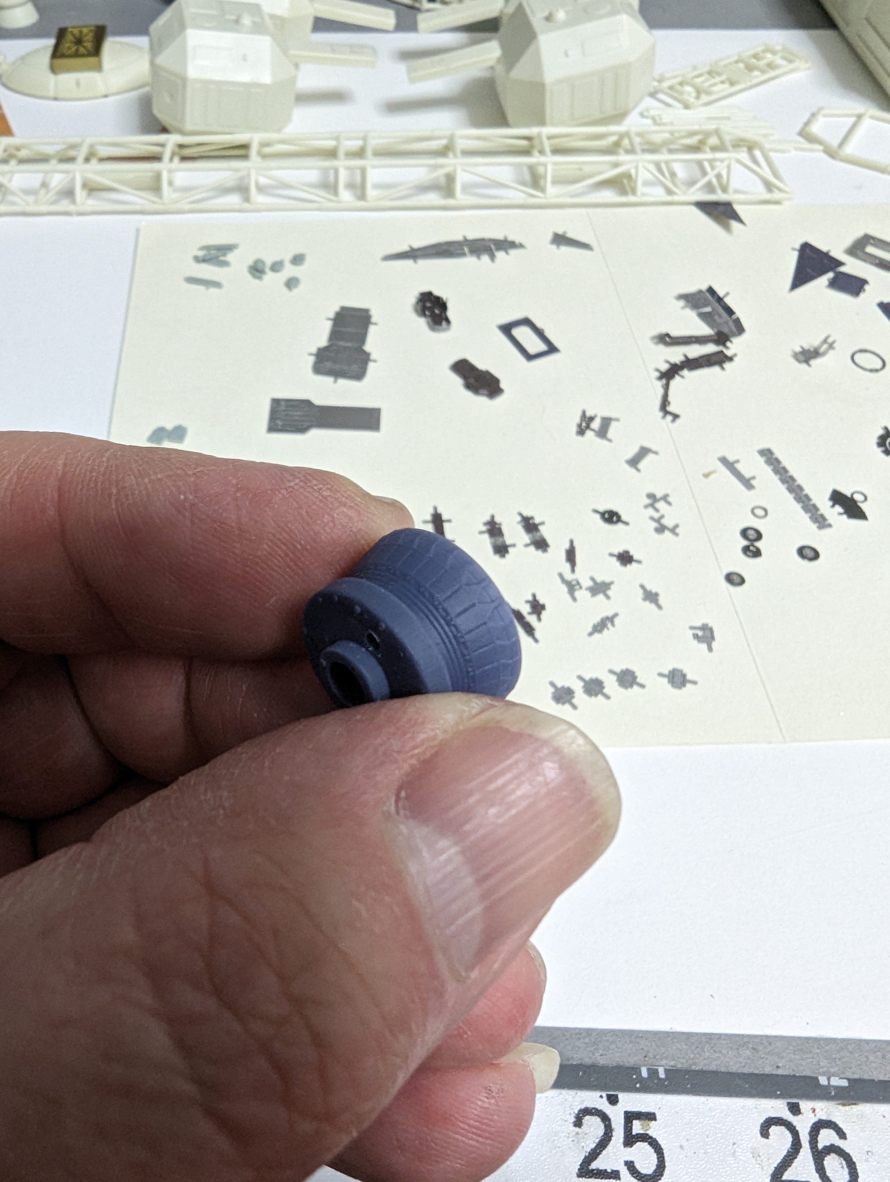

Main VTOL engine. The edge of the bell will need some sanding, but otherwise they look great.
Passenger pod VTOL.

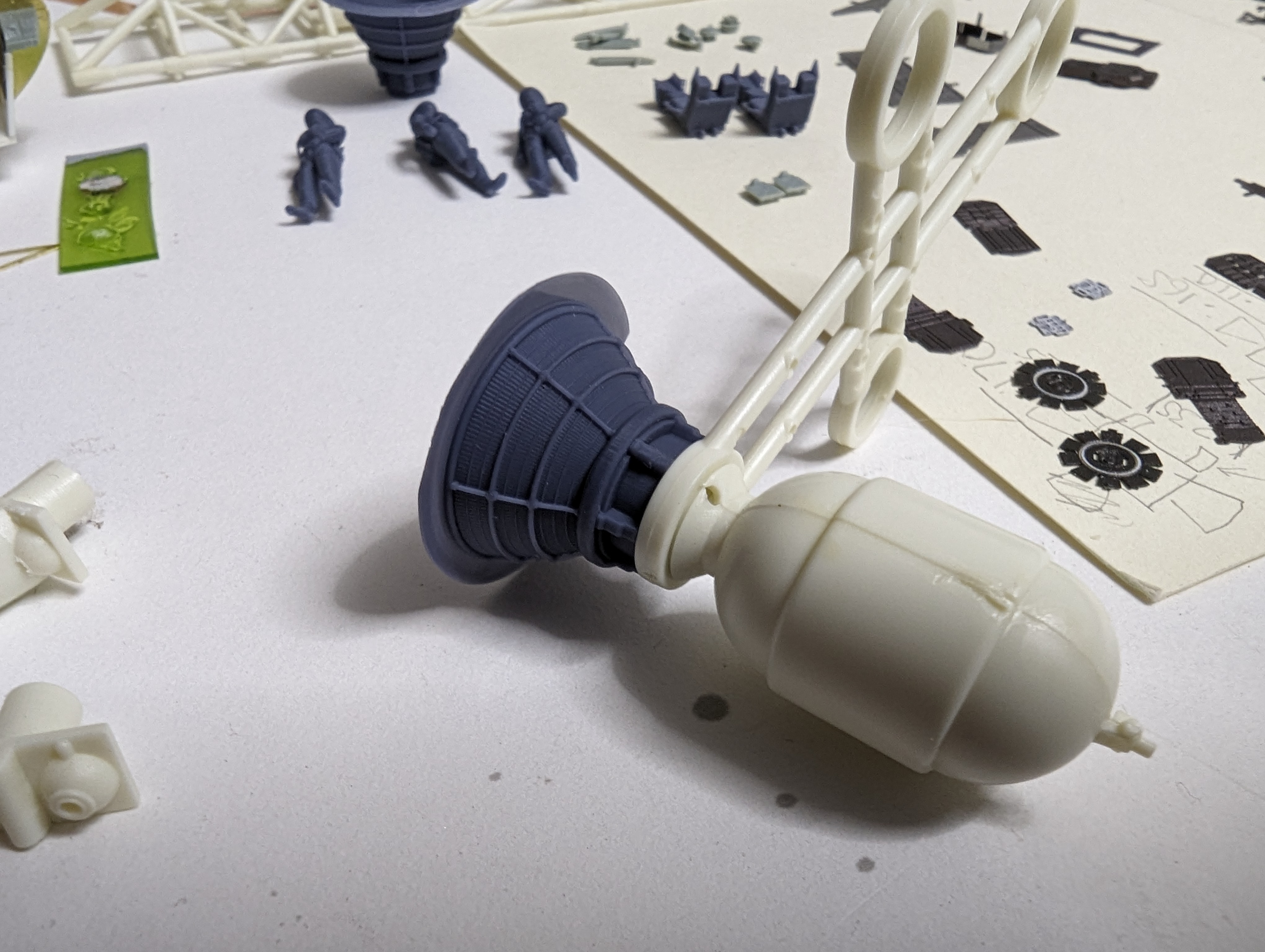

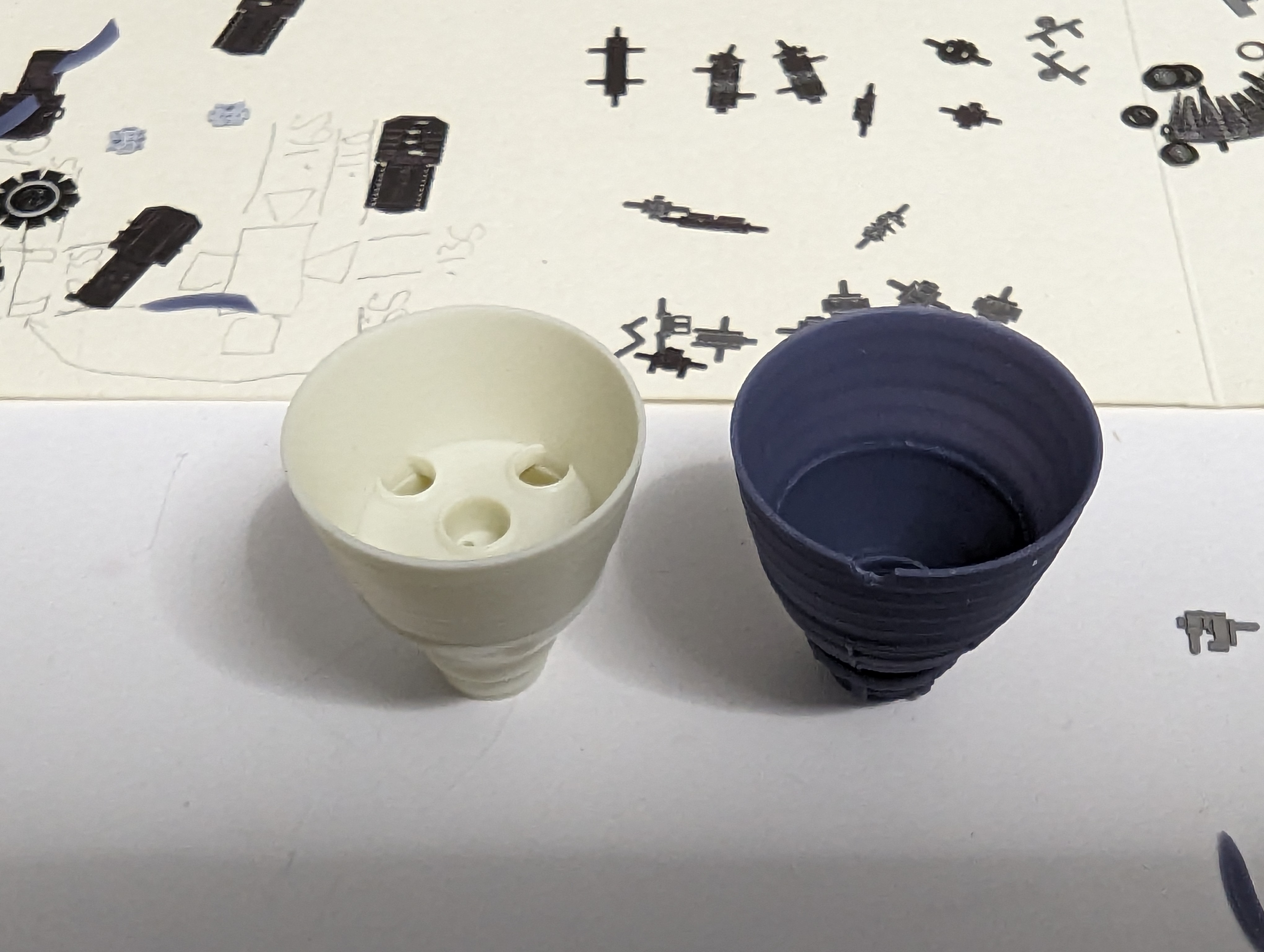

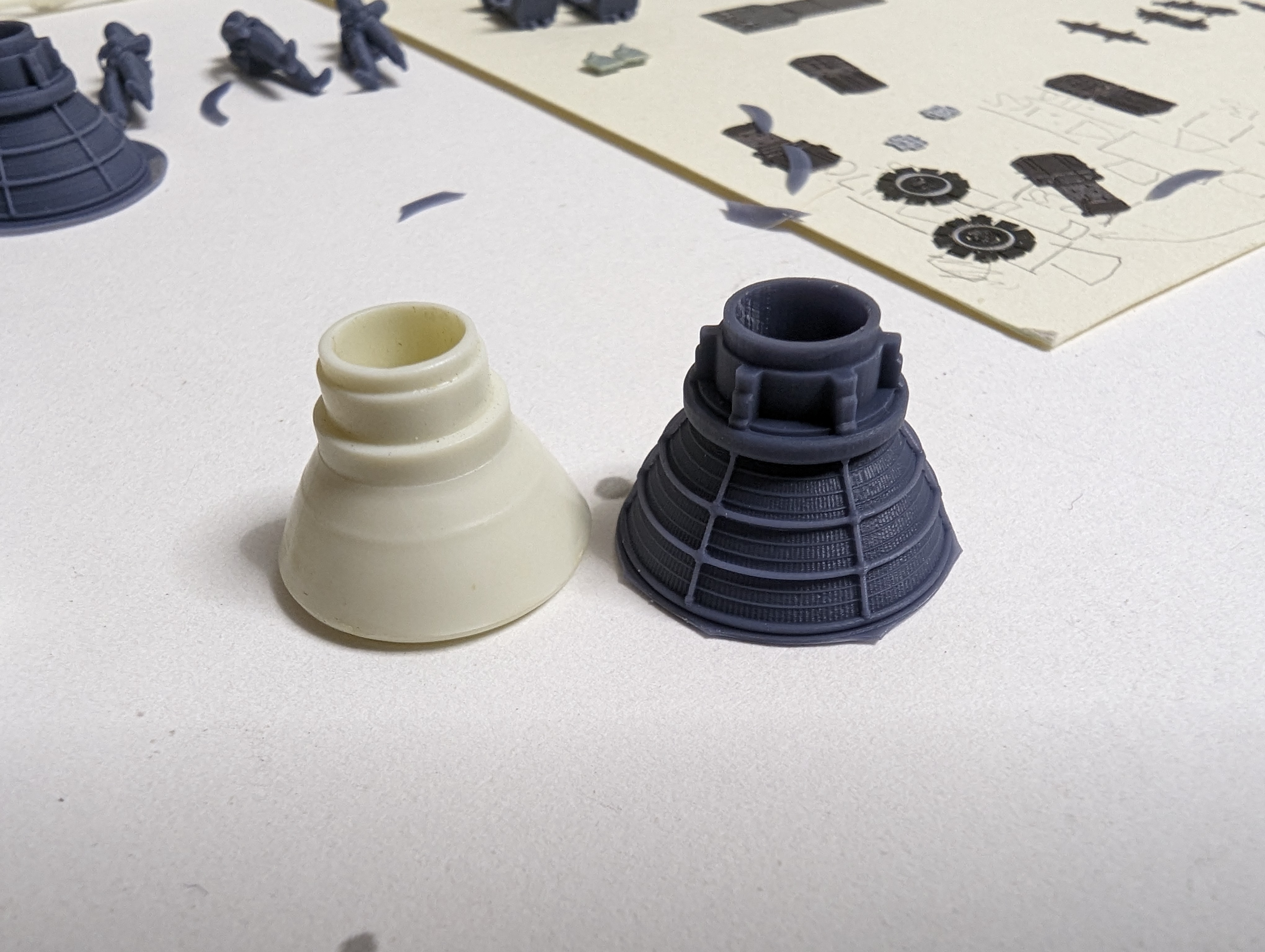

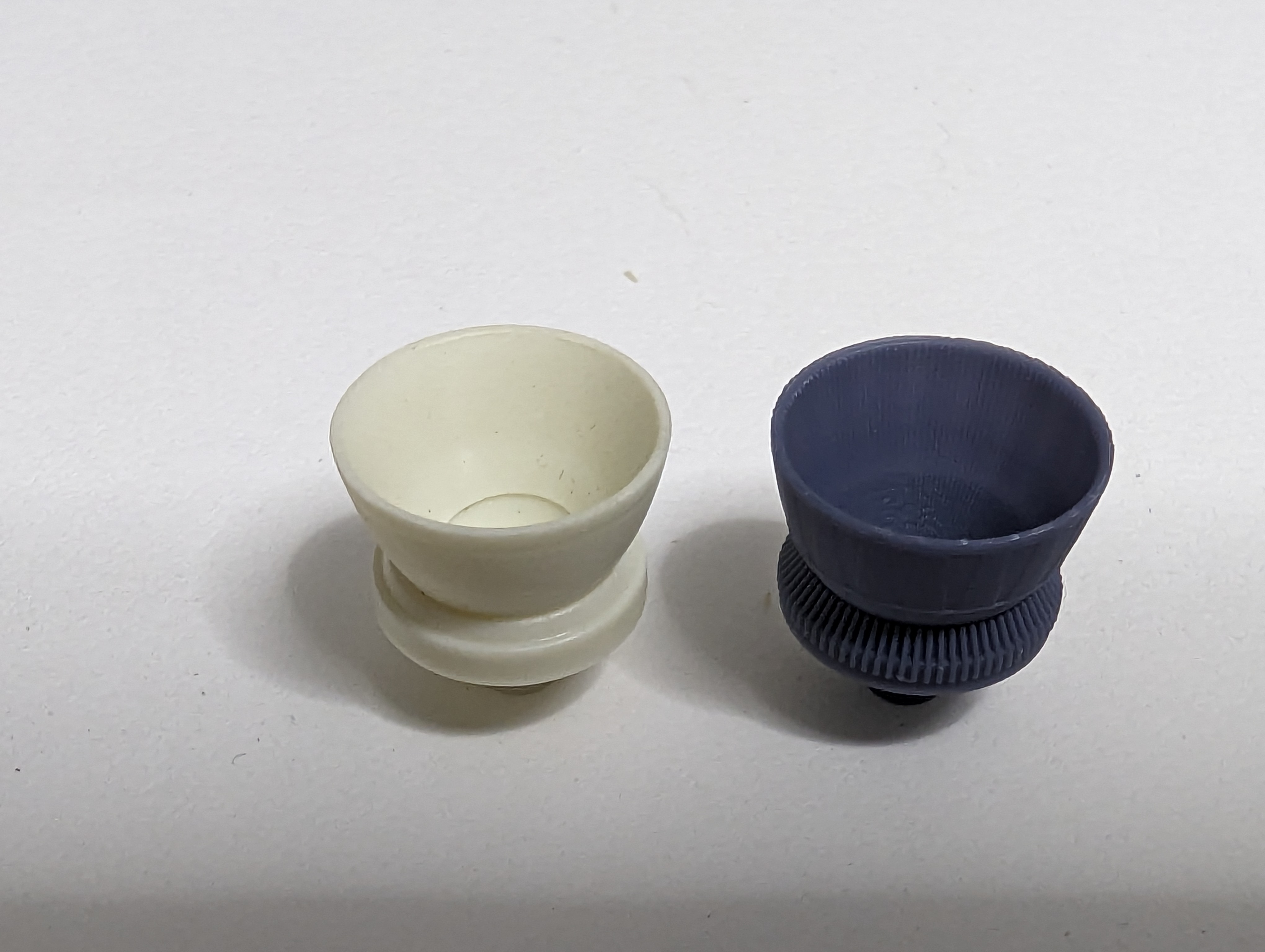

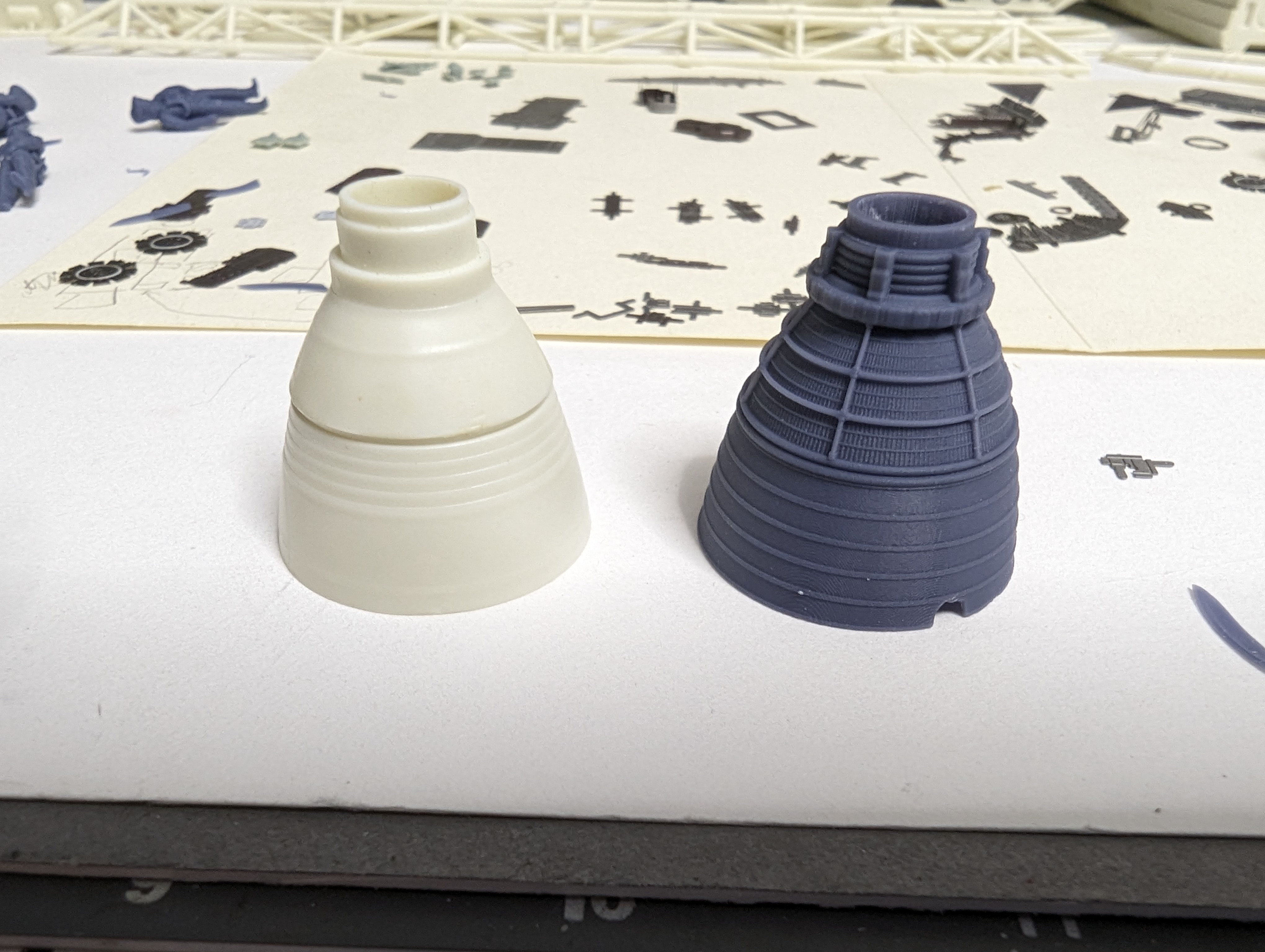

New engine next to the kit version.
I was never a fan of the combustion chamber design of the original. It just doesn't make sense from a physics standpoint.

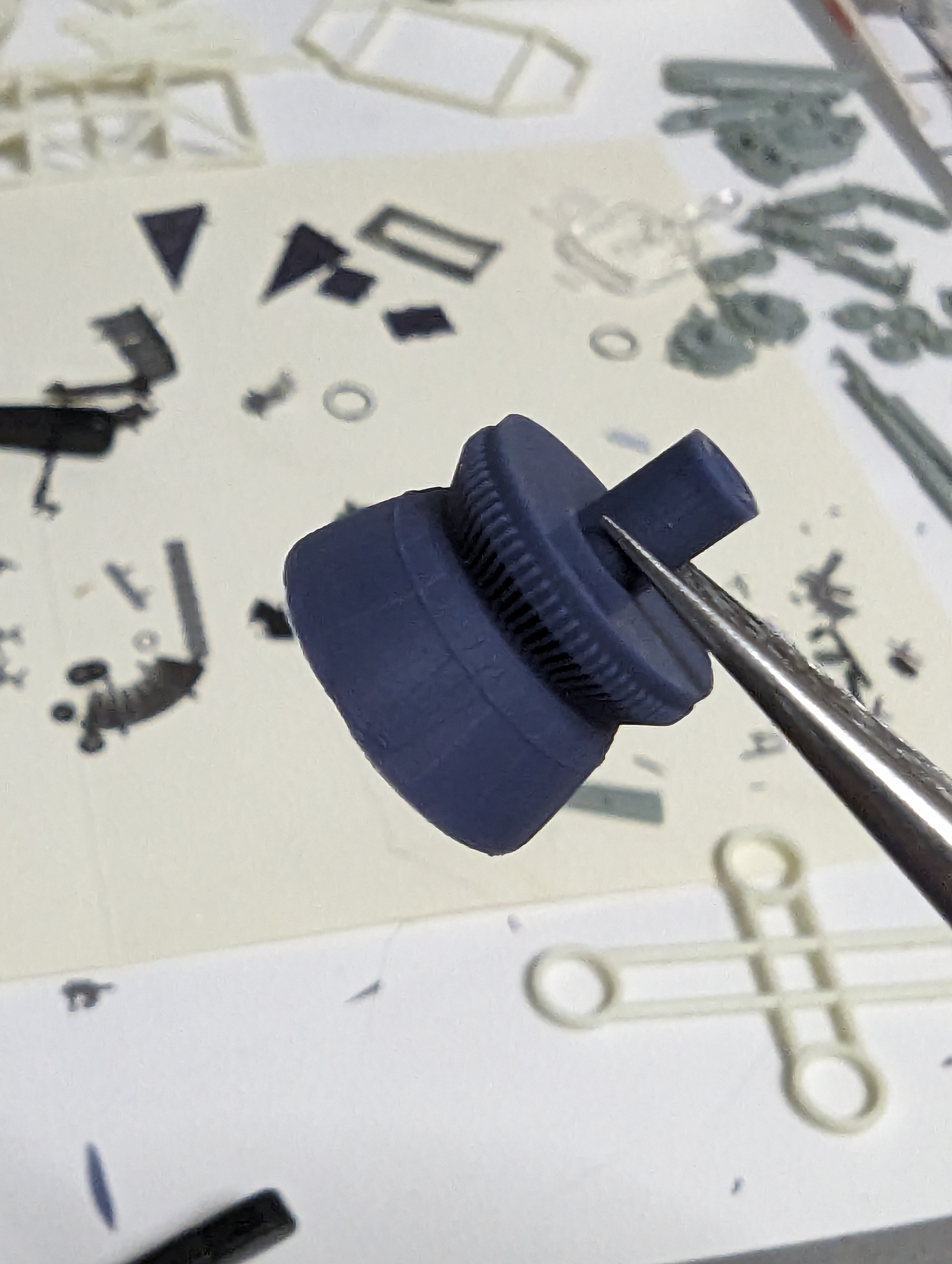

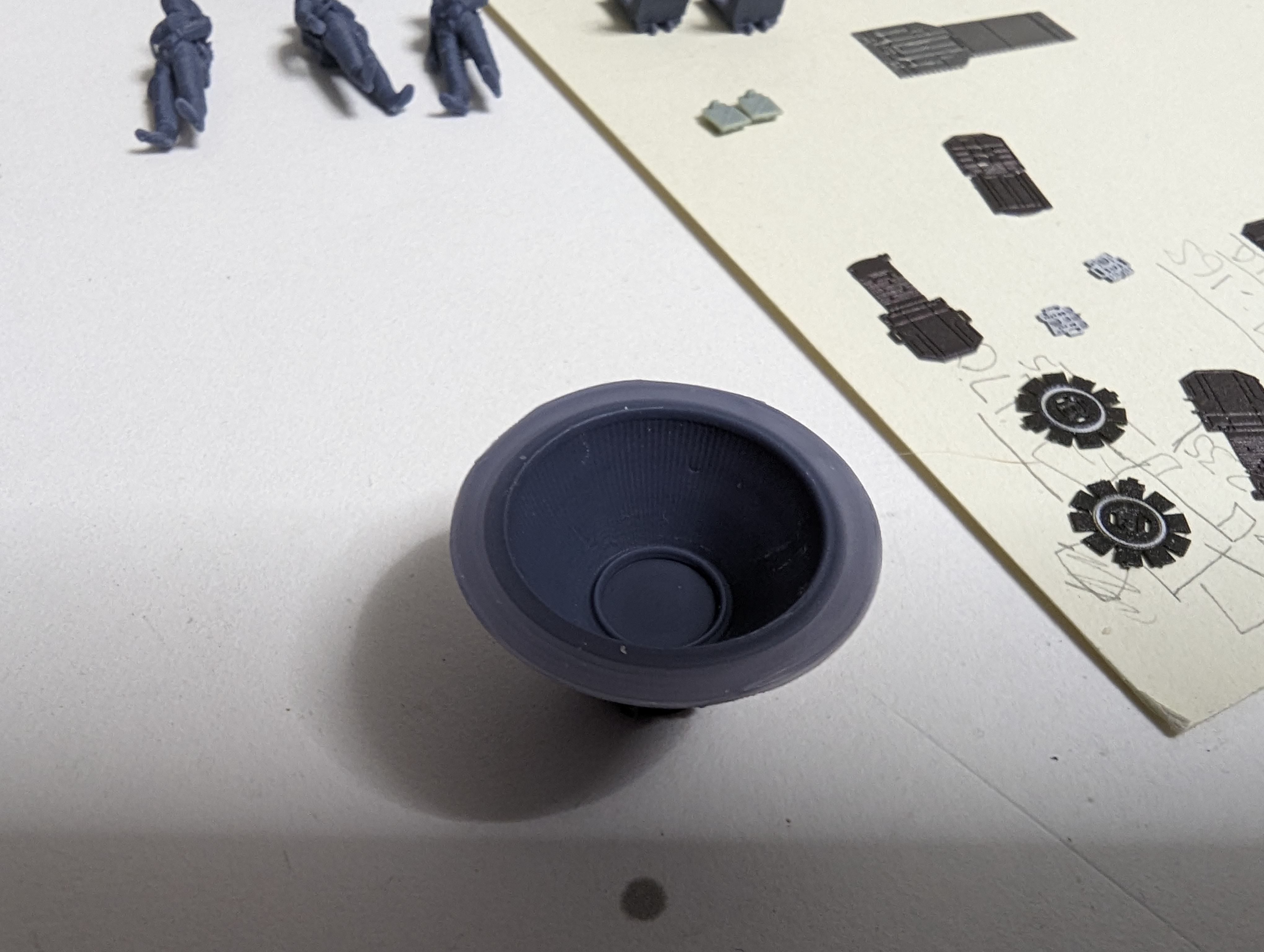

The inner ring detail needs some work. Hopefully I can reduce the size of the support contact to help clean it up. I may also beef up the ribbing detail on the inner portion, it doesn't read very well right now.
The support structure looks kind of cool all on its own. :)

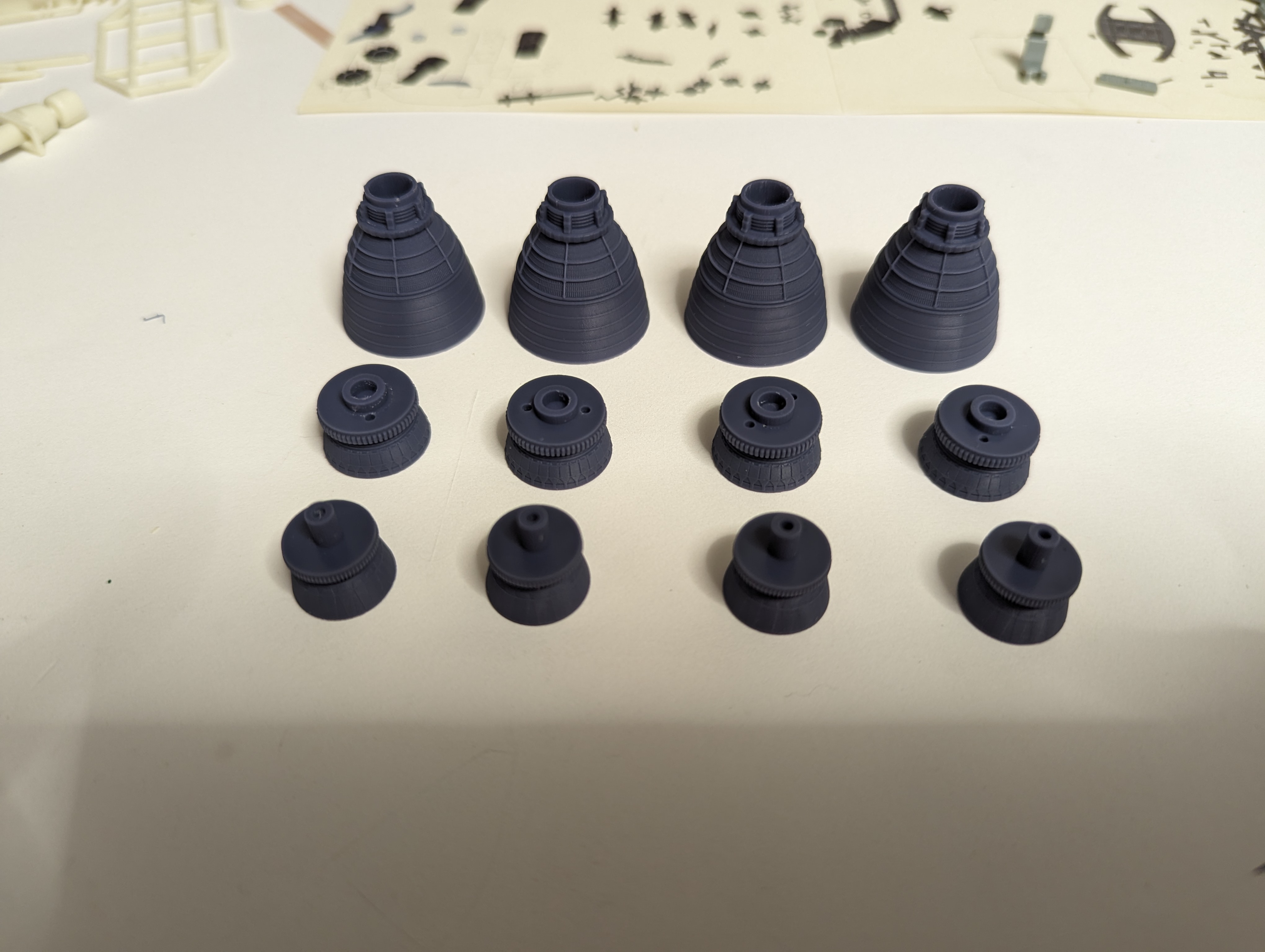

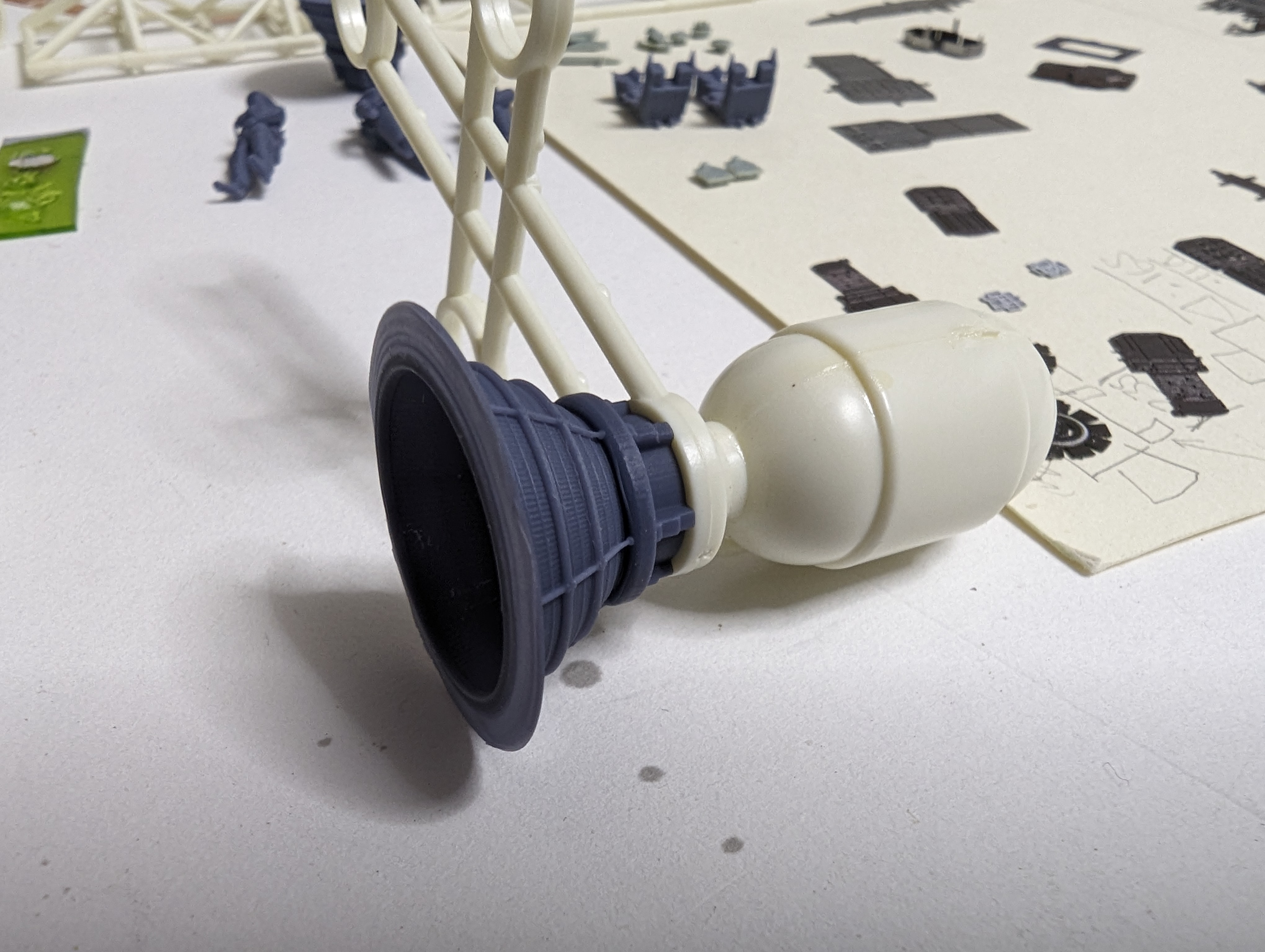

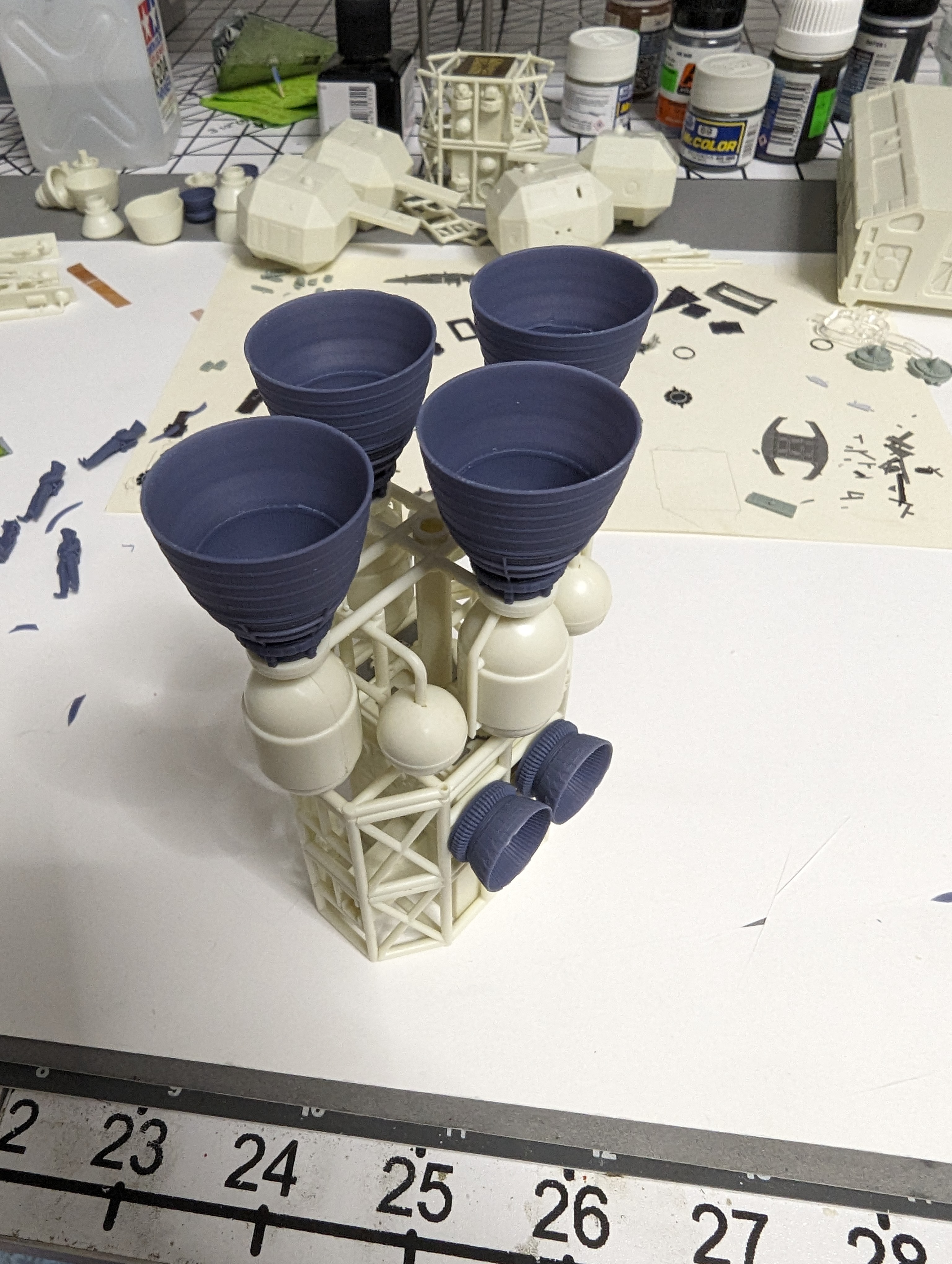

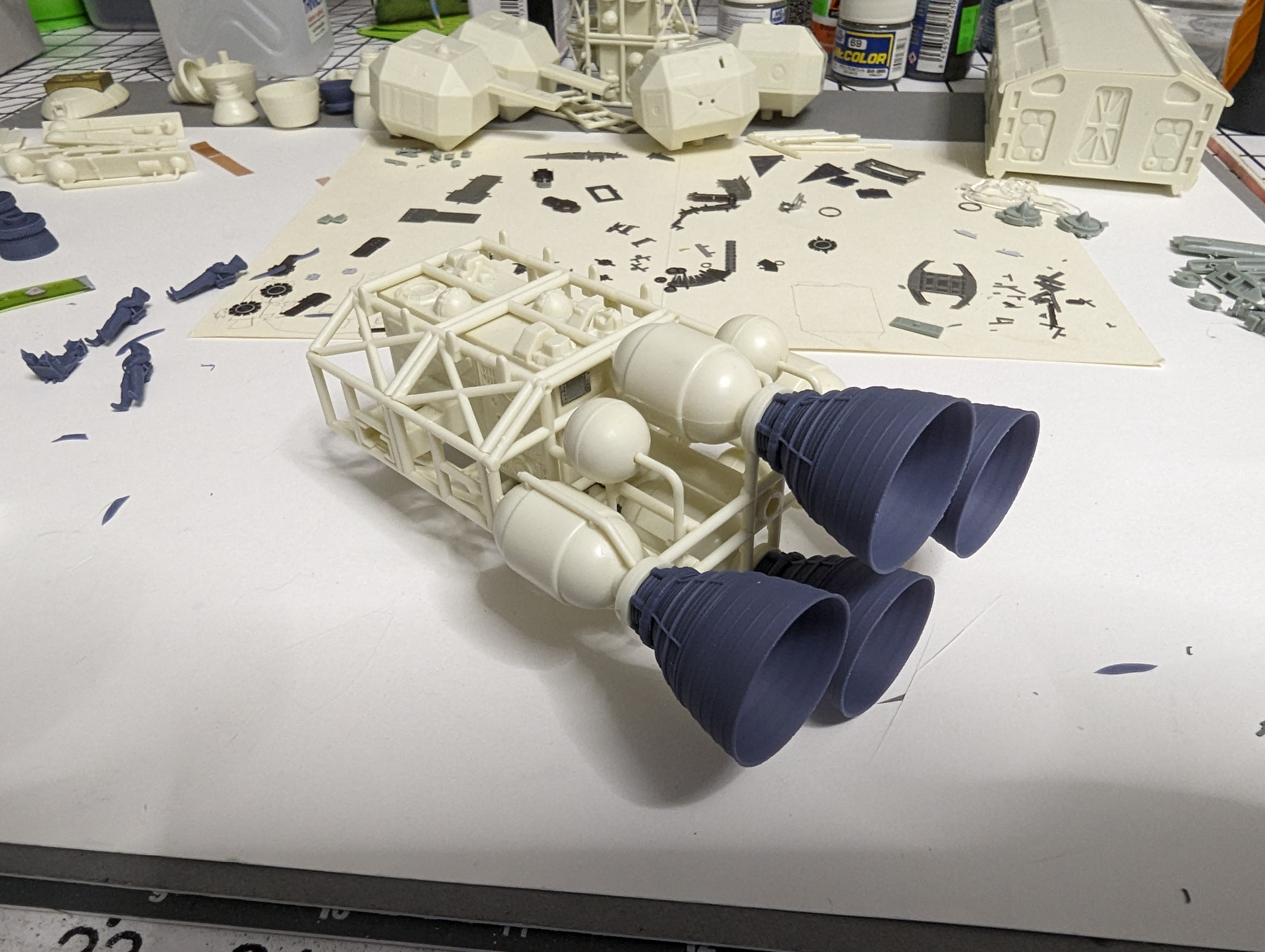

The engines are cured and I did a test fit. I think I need one more iteration to finesse some of the details, but I'm exceedingly happy with how it's progressing. I think it's all looking spectacular, especially the main engines. I'm just kind of worried that I may need to upgrade the rest of the machinery to match.

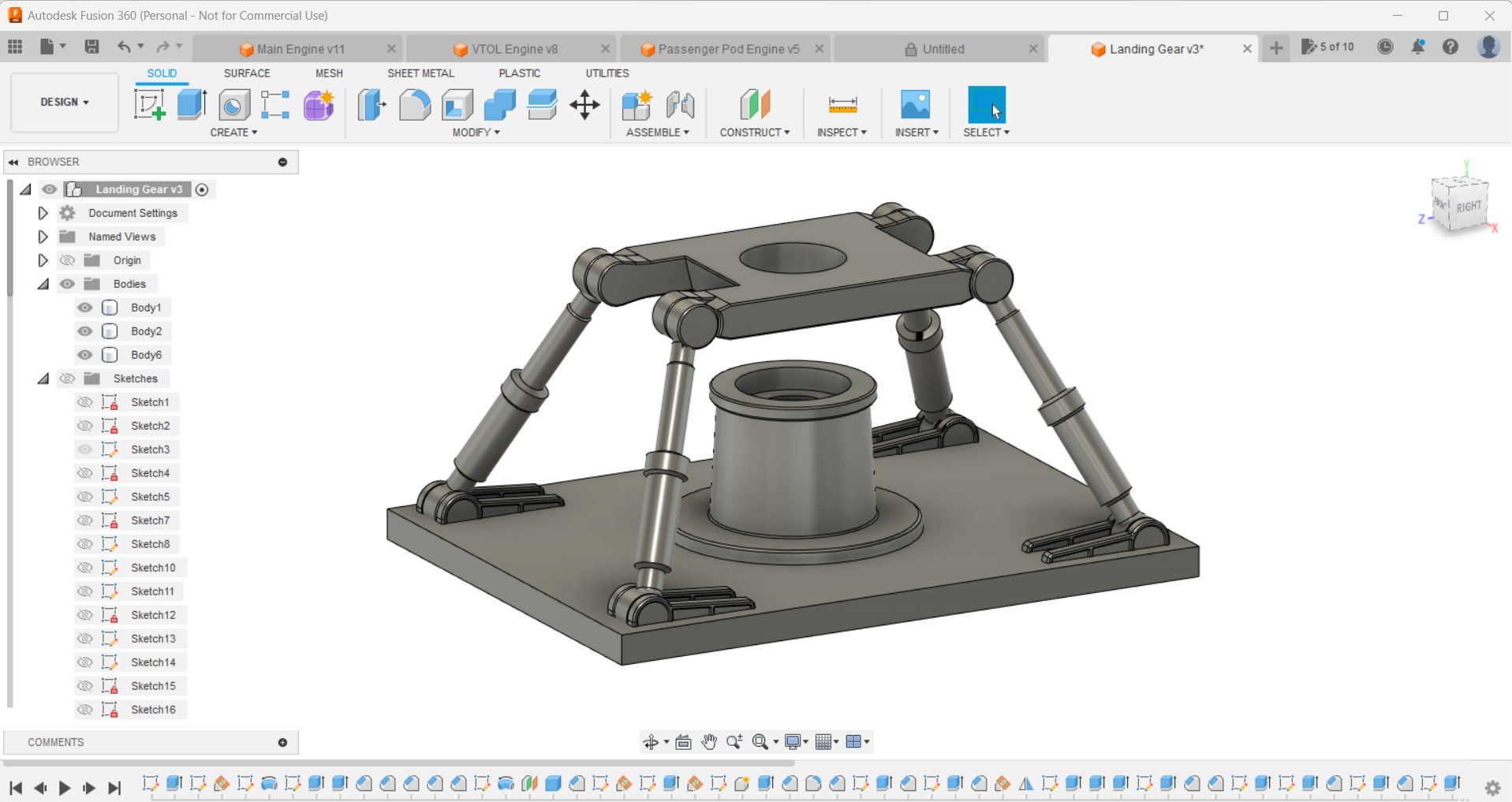

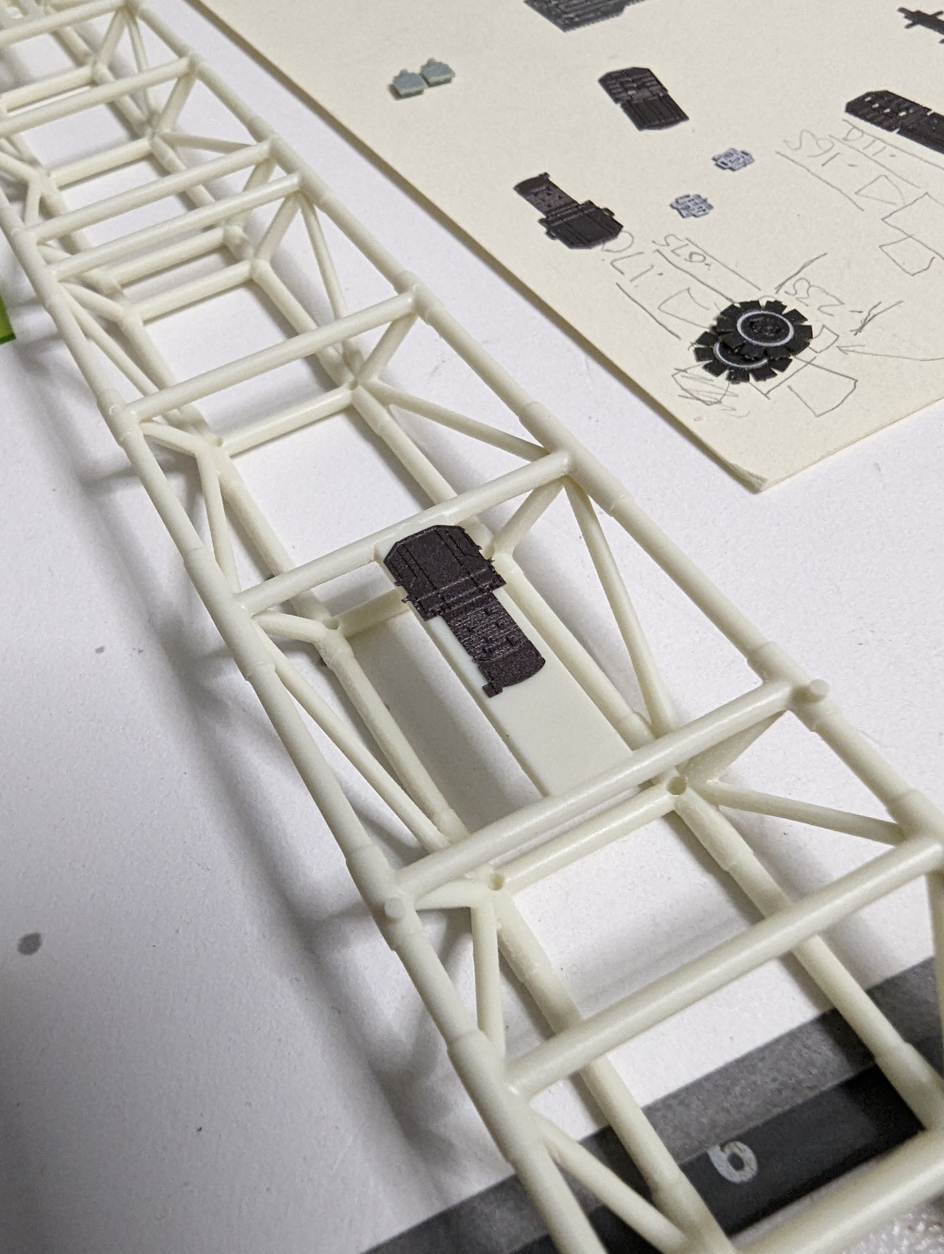

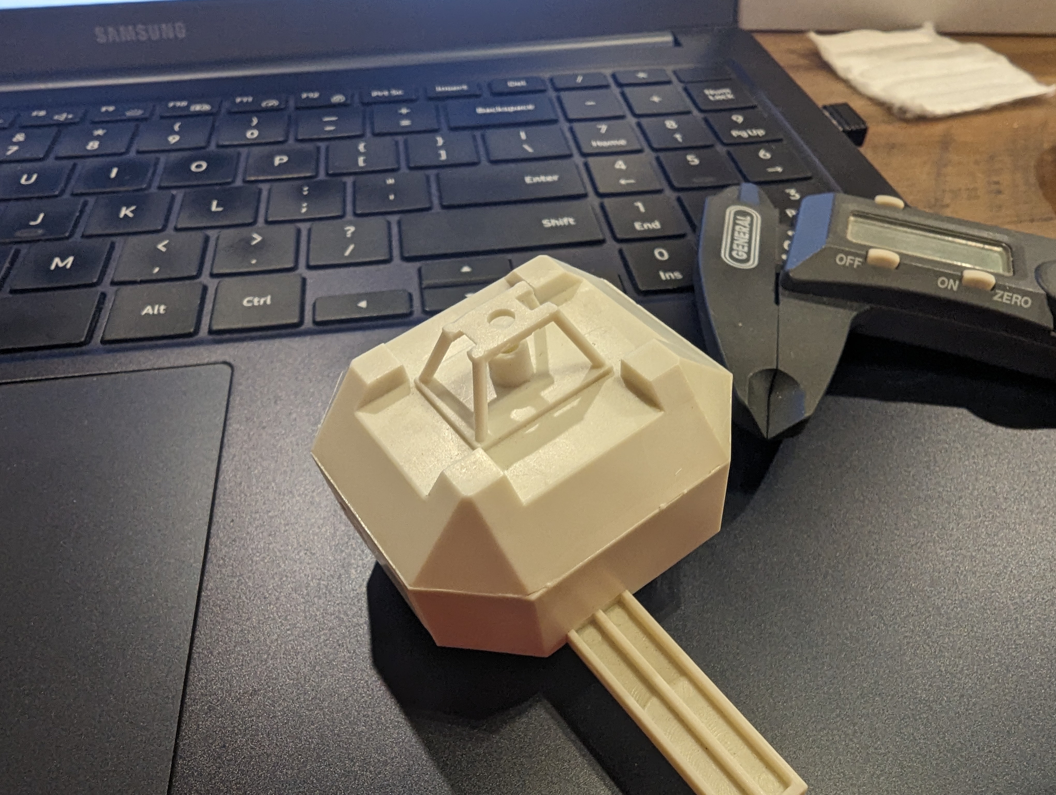

I finished tweaking the engine bells, and I'm really happy with how they came out. I got a full set that passes muster. And I ran into the problem that I was afraid of, A lot of the other bits have started to look very toy-like in comparison. So... It's time to jump back into Fusion 360 and get to modeling. I think I'm going to replace just about everything except the main hull components, outriggers, and the truss structure. Here is a little taste of the next bit I'm working on. I'm going to have to shave off the landing gear mounting points on the outrigger pods, but I think it will be worth the extra work.
And I also ordered a small set of inductive LEDs to experiment with my lighting ideas. If it pans out, I'll get some more LEDs and a larger and/or more induction rings to put in the base to make sure I have coverage for the whole model (the set I bought only comes with an 80mm wide ring).
I've still got a bunch of work to do on the landing gear bits, and I ordered some 2mm stainless steel rod to use as support for the main gear struts since I don't think full resin gear will bear the weight.

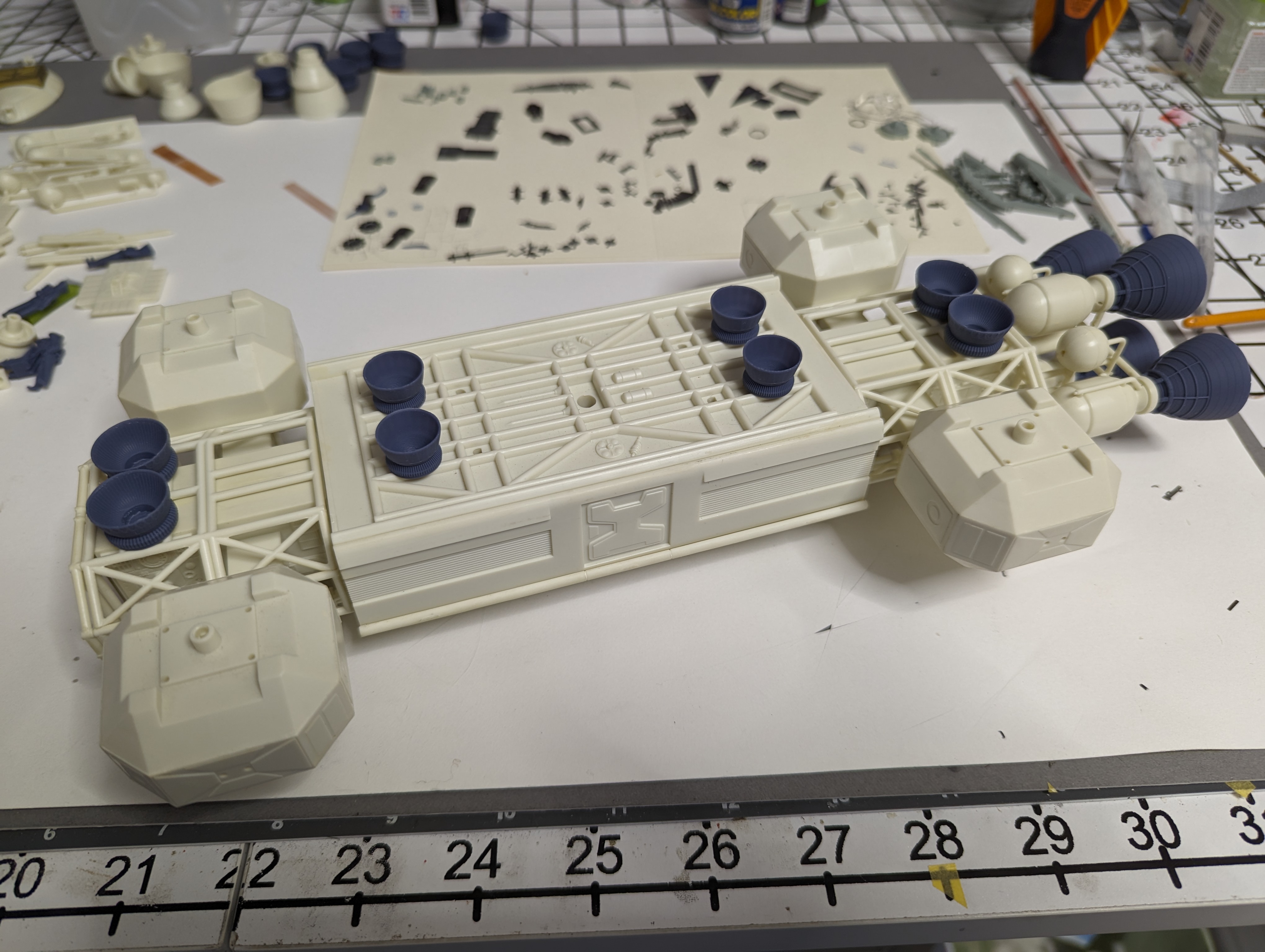

Full set of engines. I've got a bunch of extras too and will probably start experimenting with paint on them.
I love how crisp the interior of the main engine bells came out with some tweaking of the supports. I really like the continuous support method I came up with, there's no dimples or warping.
