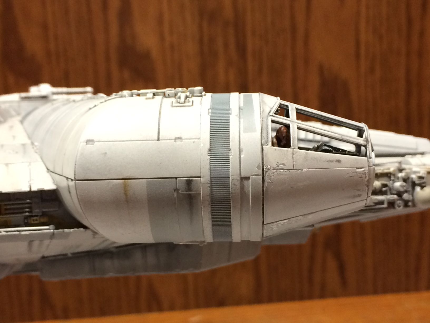

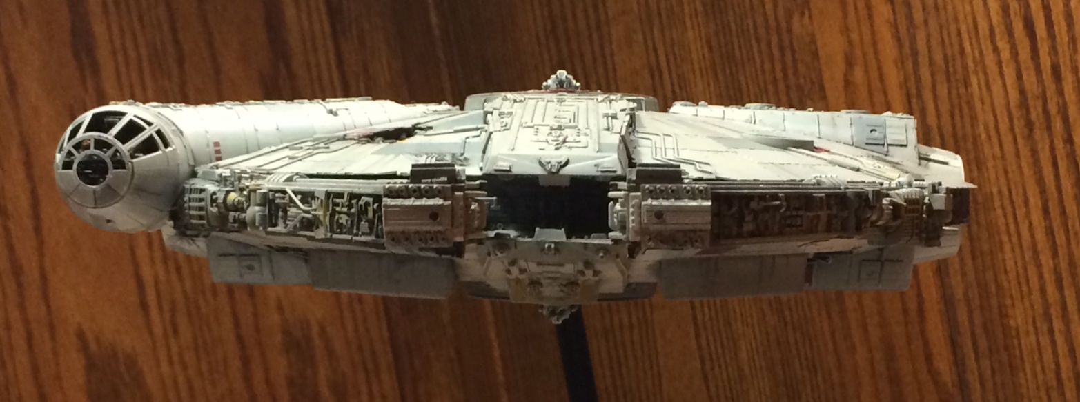

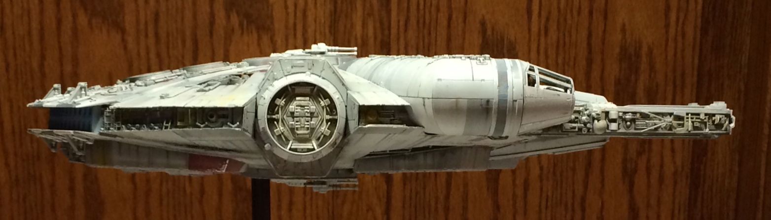

A few more. Here you can see more of the hull curve and some of the hybrid details. I also shorted the cockpit tube and the cockpit cone. The bow headlight pieces are modified from the MPC Falcon to match the 5-footer. HunkajunkFM4.jpgHunkajunkFM5.jpgHunkajunkFM6.jpgHunkajunkFM7.jpg

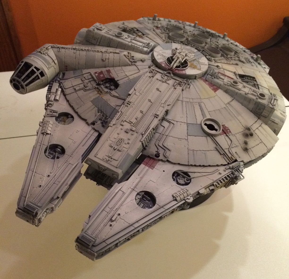

And more. The model is lit with TESB headlights, cockpit lights and blue/teal engine lights to mimic the look from the Force Awakens trailer (though it's hard to see in the photos). Obviously, I'm still working on the dish. Thinking about scratching the new rectangular one. HunkajunkFM7.jpgHunkajunkFM8.jpgHunkajunkFM9.jpgHunkajunkFM10.jpg
Okay, here's mine. It's a work in progress. Still adding details and painting. My main goal was the hull curvature. I like me a FAT Falcon. View attachment 434929View attachment 434930View attachment 434931
