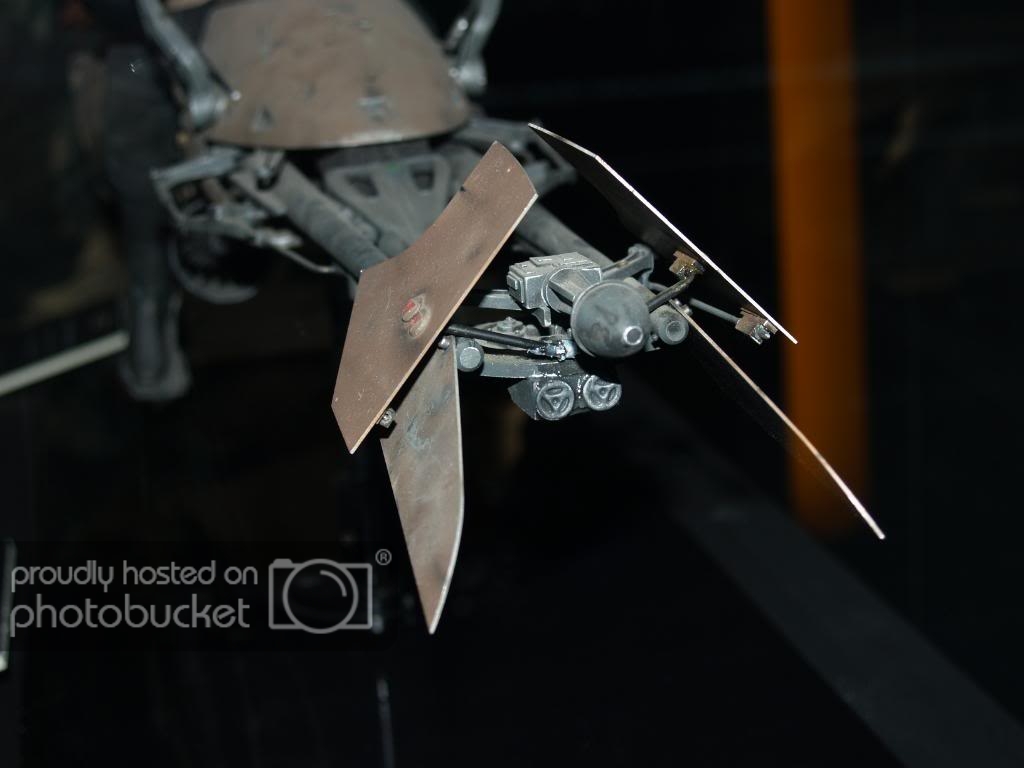

Like most of the ROTJ models, they used less kitparts and they scratchbuilt most of the parts !
Although, they build a proto model of the spiderbike using a 312T body (front and side), flak38 shields for the bacl flaps and back side were made from F-15 E parts (I think does are additional fuel tanks in both side of the intakes on the real bird).

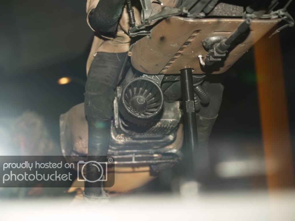

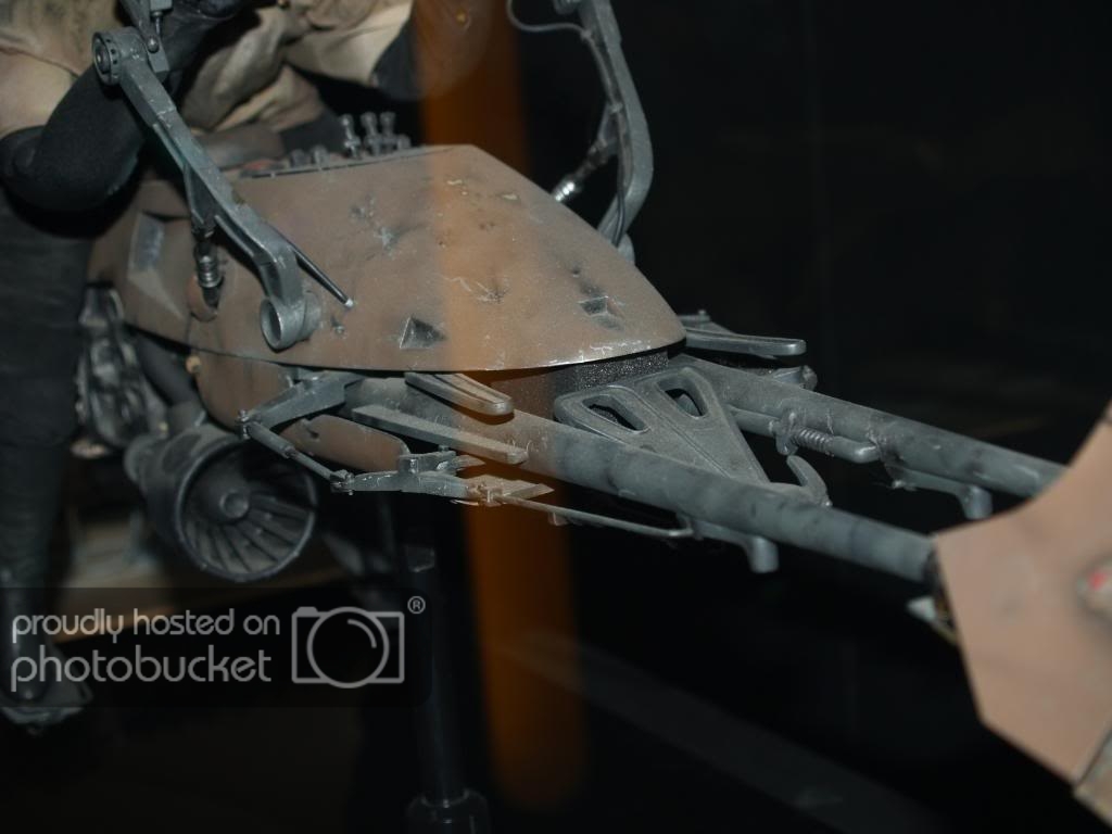

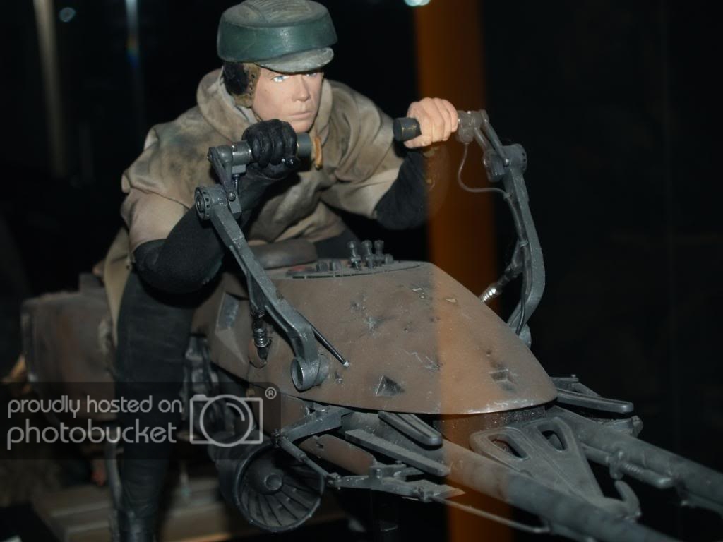

Here's some pics of the ILM speederbike (Luke's) I took in Belgium :

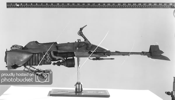

And here a pic took by ILM, it's 32" !
