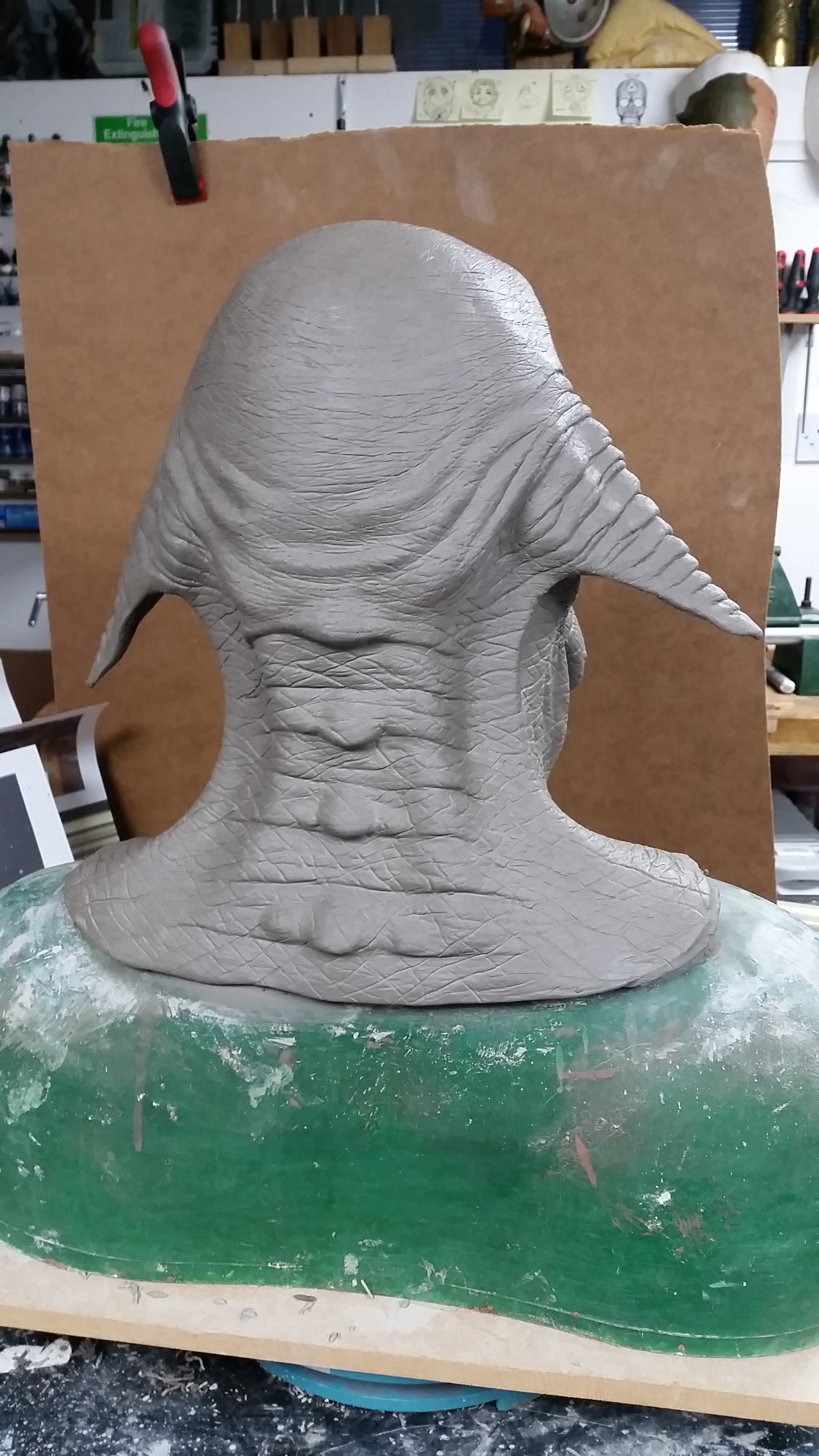

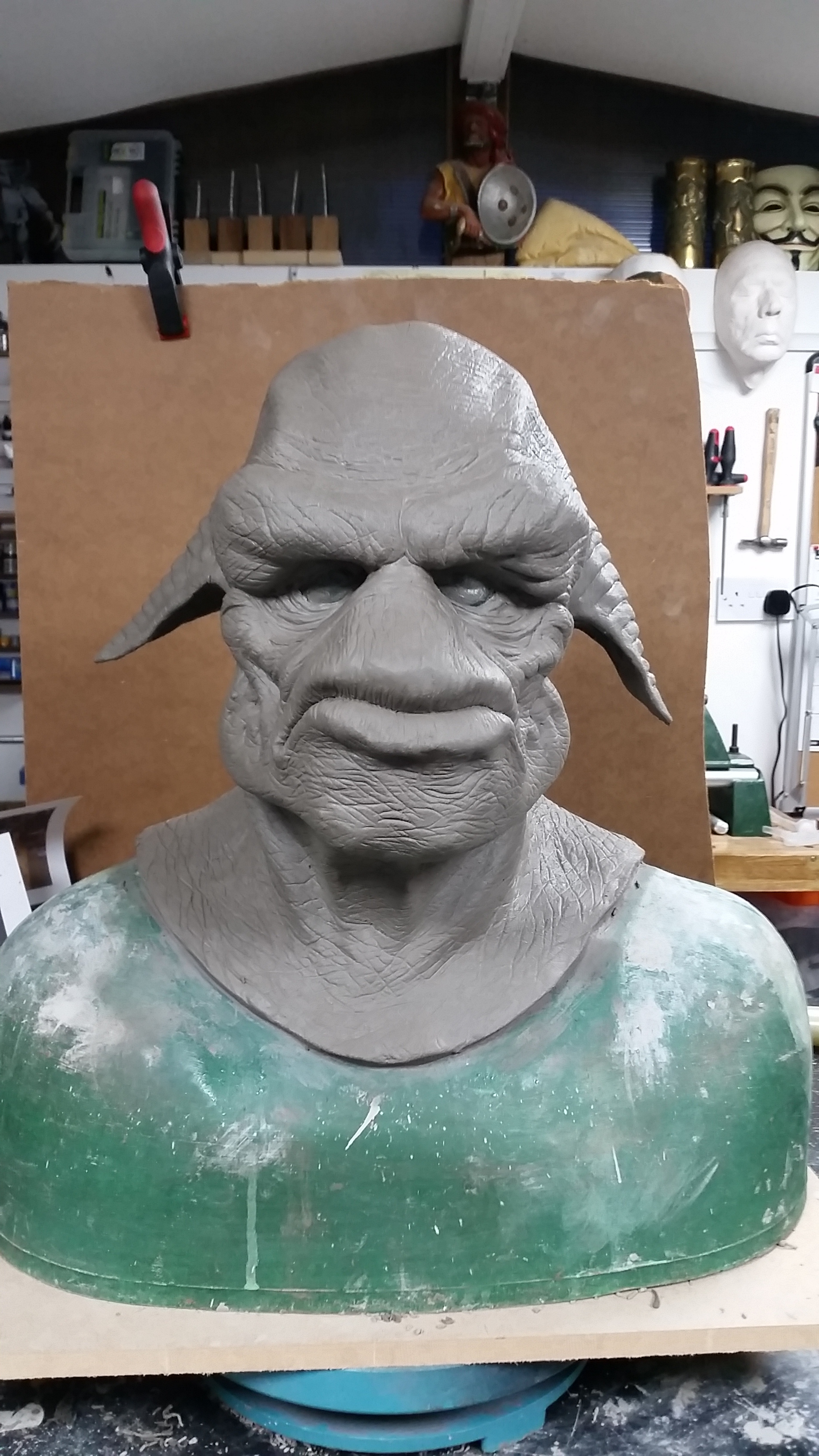

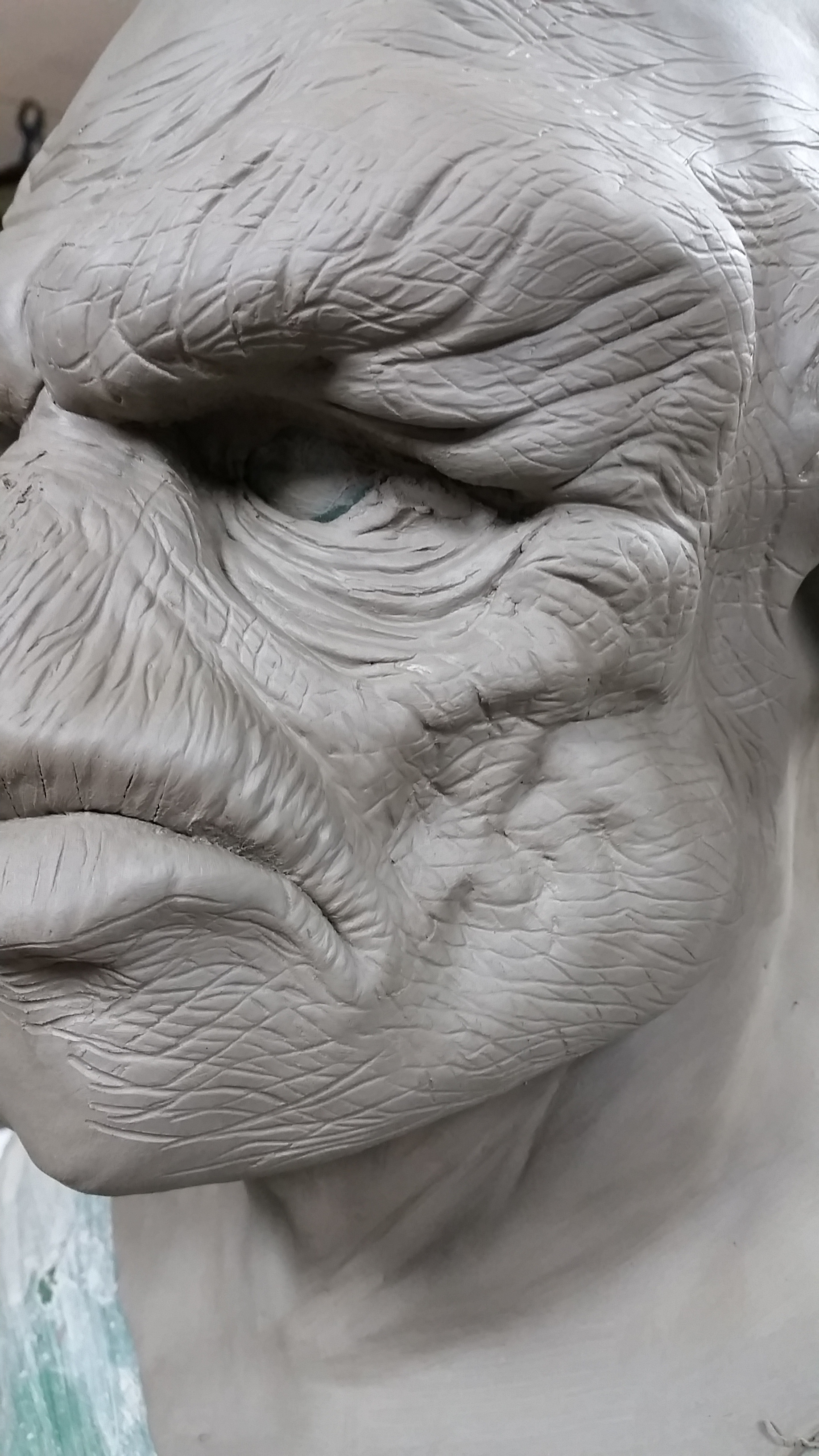

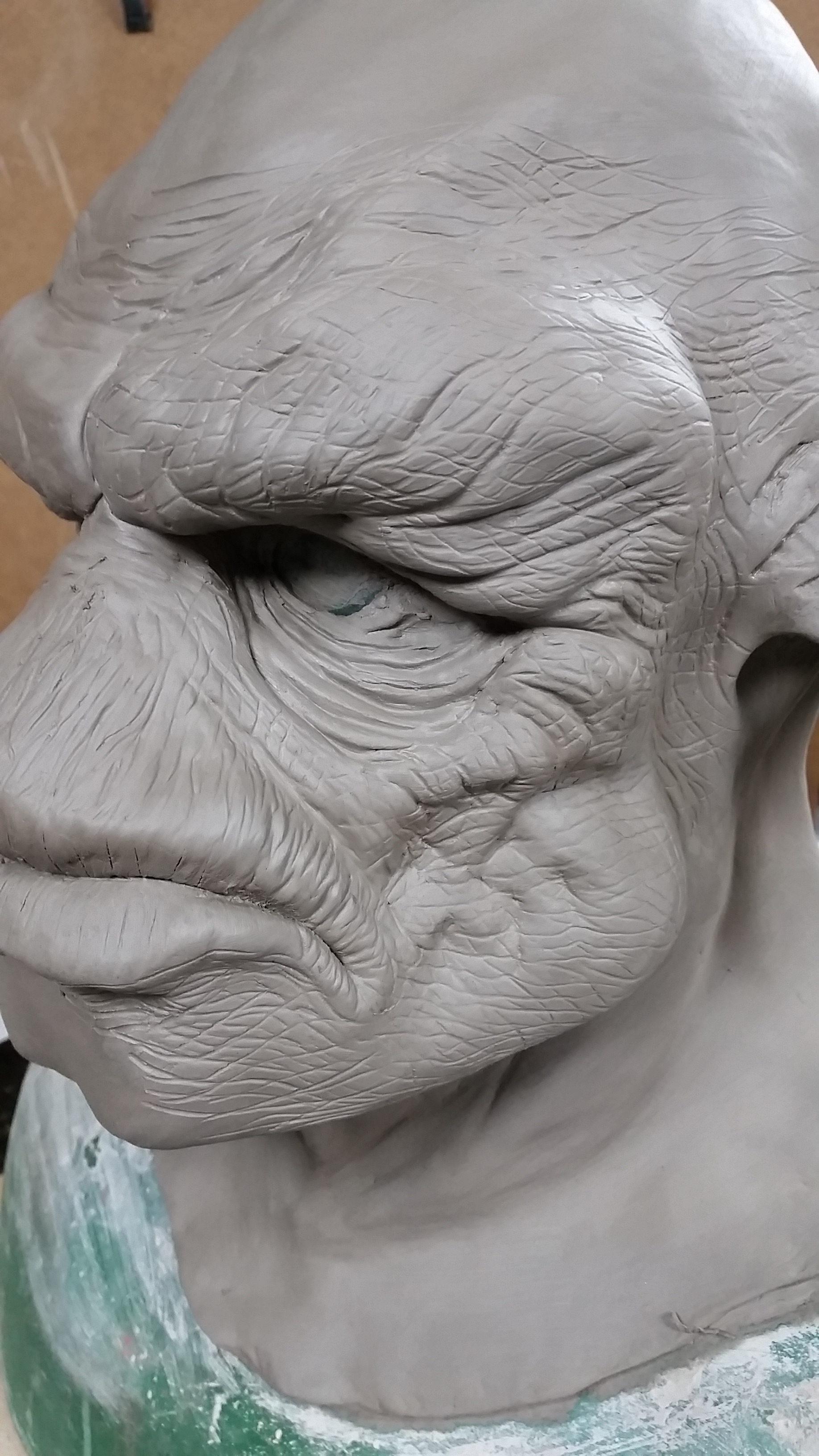

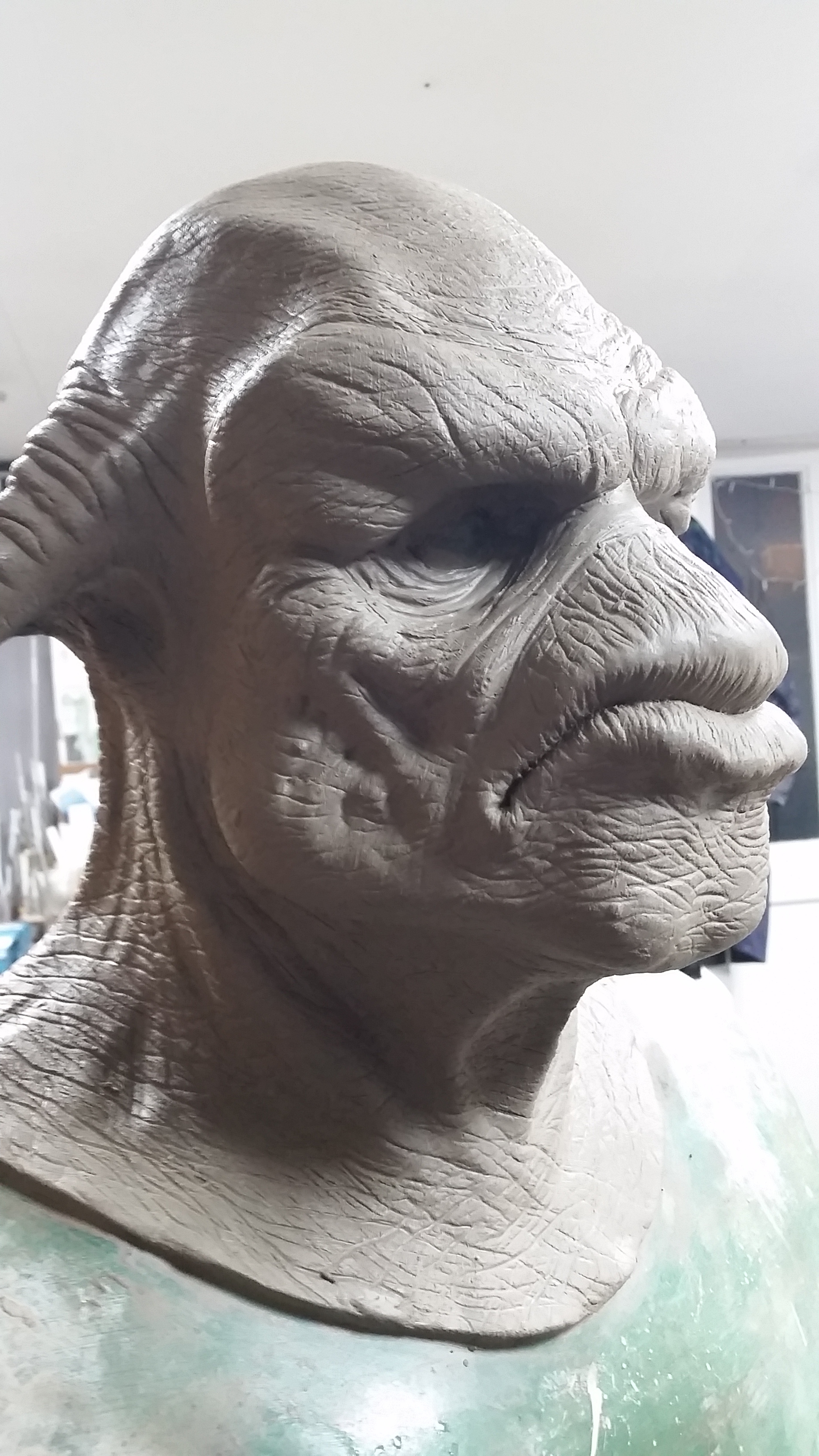

    just wanted to share updates here of my sculpt I am working on, its a Mangalore from the Fifth Element. My plan is to make a latex mask from this once it it is finished and molded.
    I will be updating this thread as often as I can, I'm slowly chipping away at the sculpt in the evenings, hope you enjoy!
    (oh, its water based clay btw)
    20180620_220048.jpg 20180620_221806.jpg 20180620_221830.jpg 20180620_221854.jpg 20180620_221910.jpg

    Wow that's amazing!
  3. Hannoc
    Hannoc New Member
    Trophy Points:
    3
    That's awesome, can'y wait to see how it turns out.
  4. Buliwif
    Buliwif Active Member
    Trophy Points:
    262
    Looks fantastic. excellent likeness.

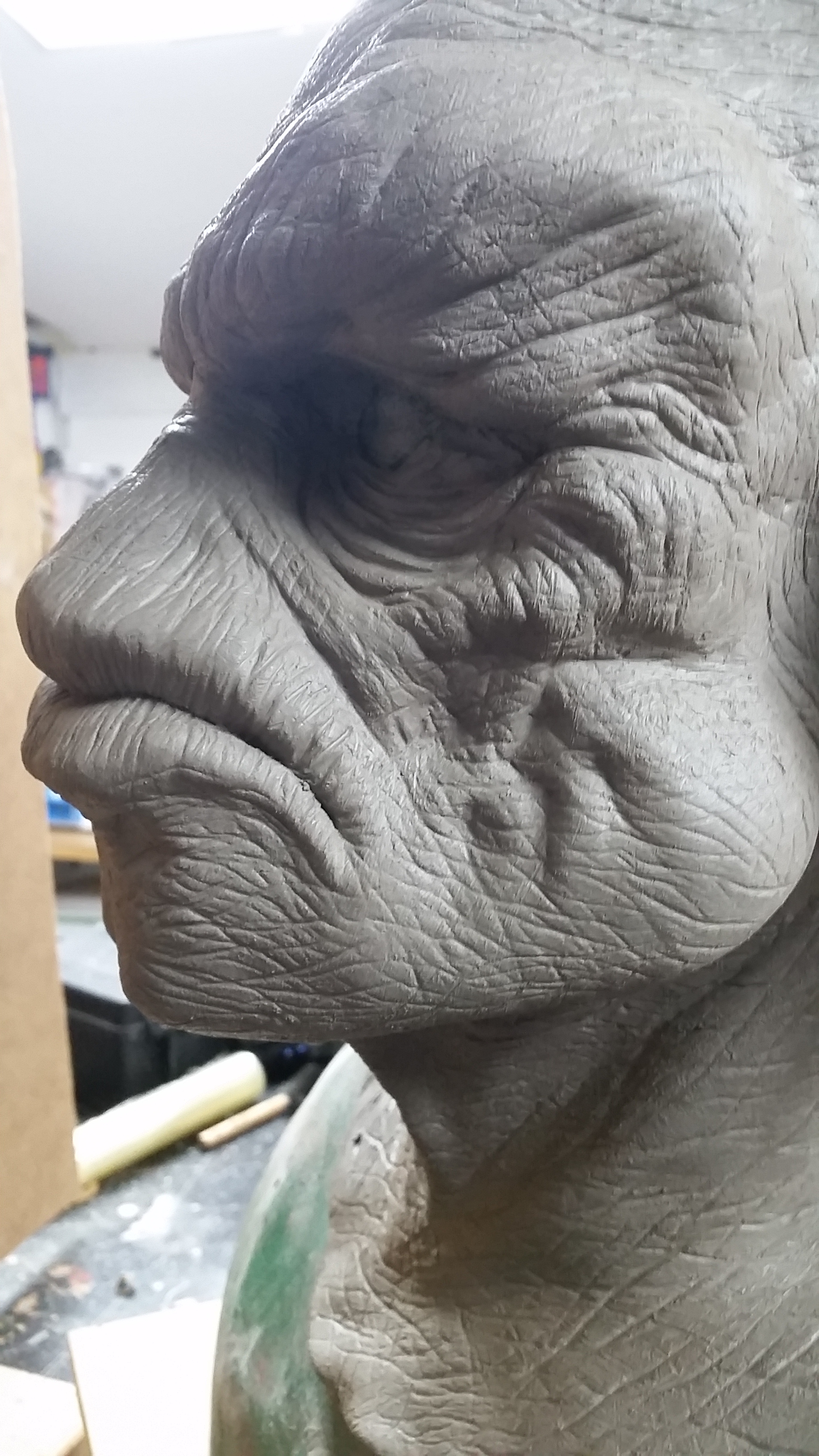

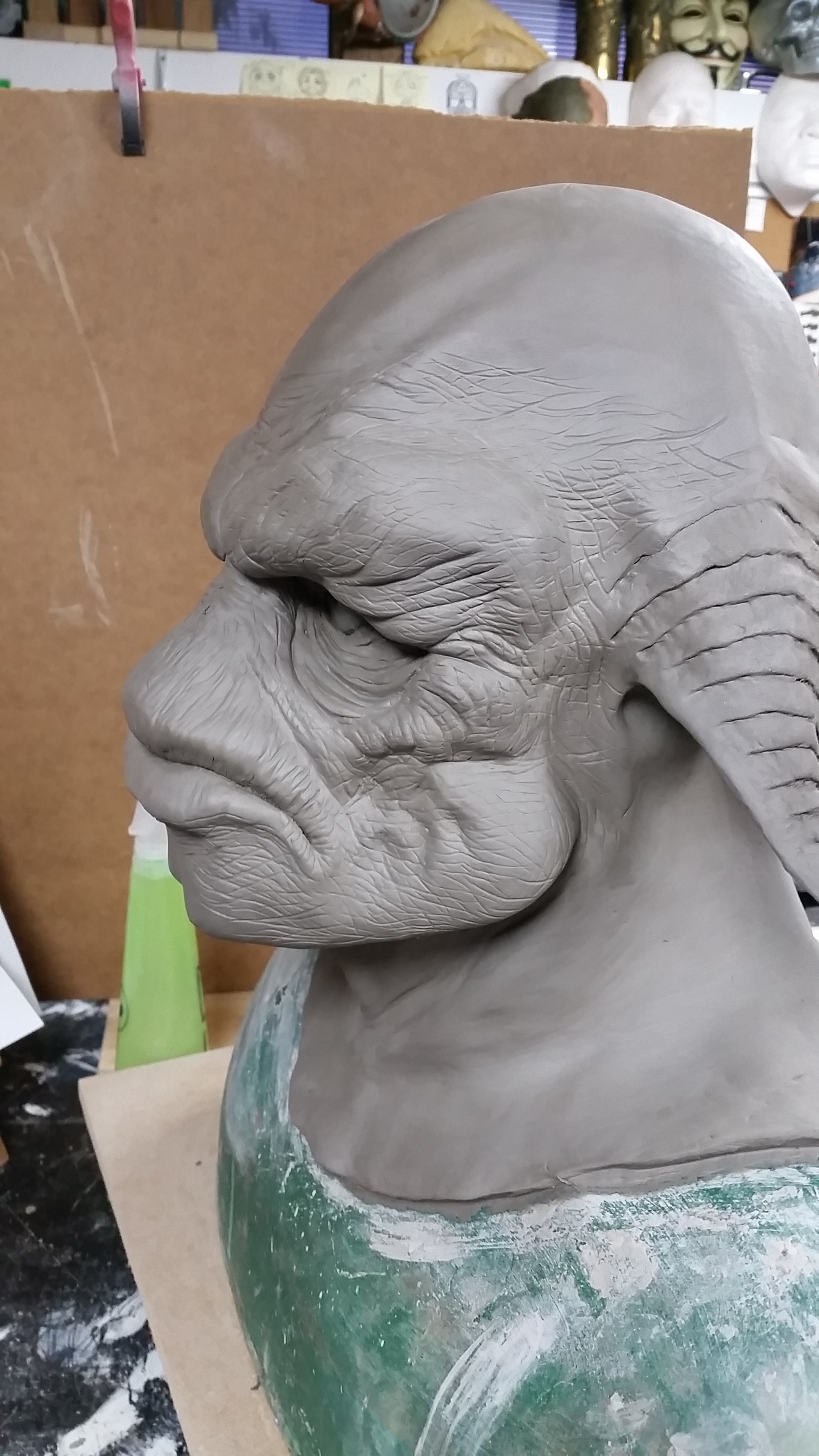

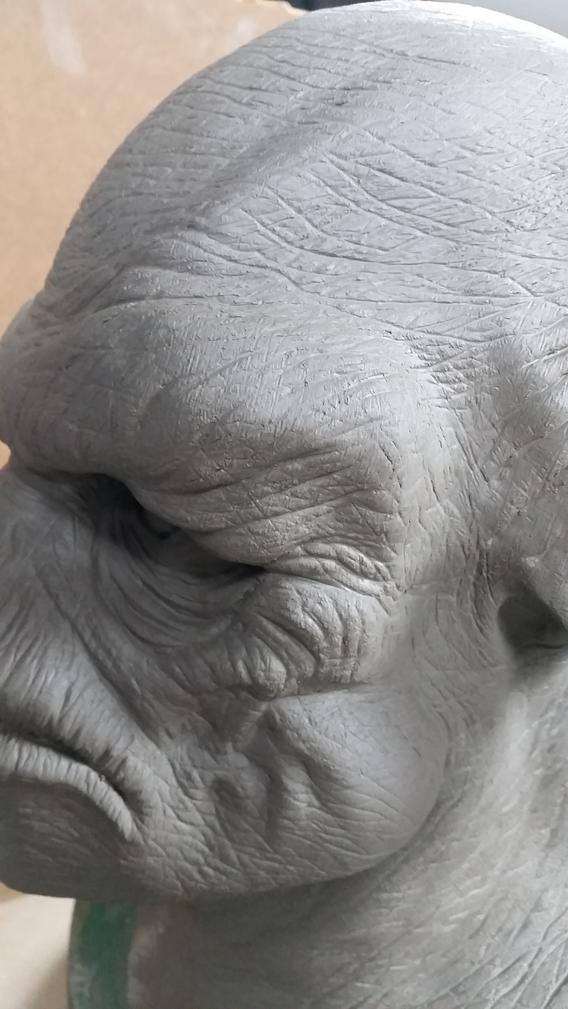

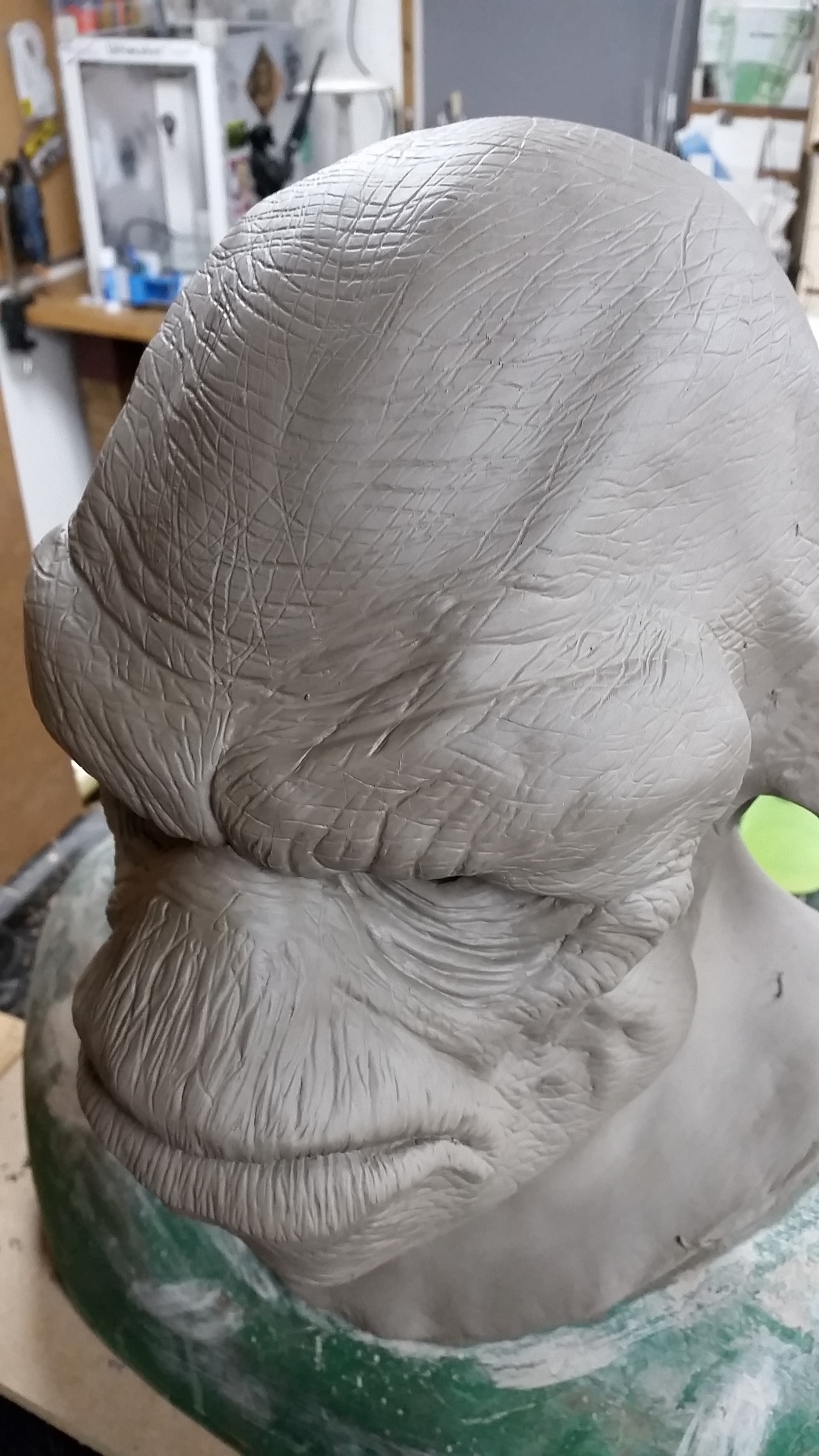

    I did some more on this last night, spreading the texture across the head. I plan on going over this texture with a finer level of detail once this first pass is done.

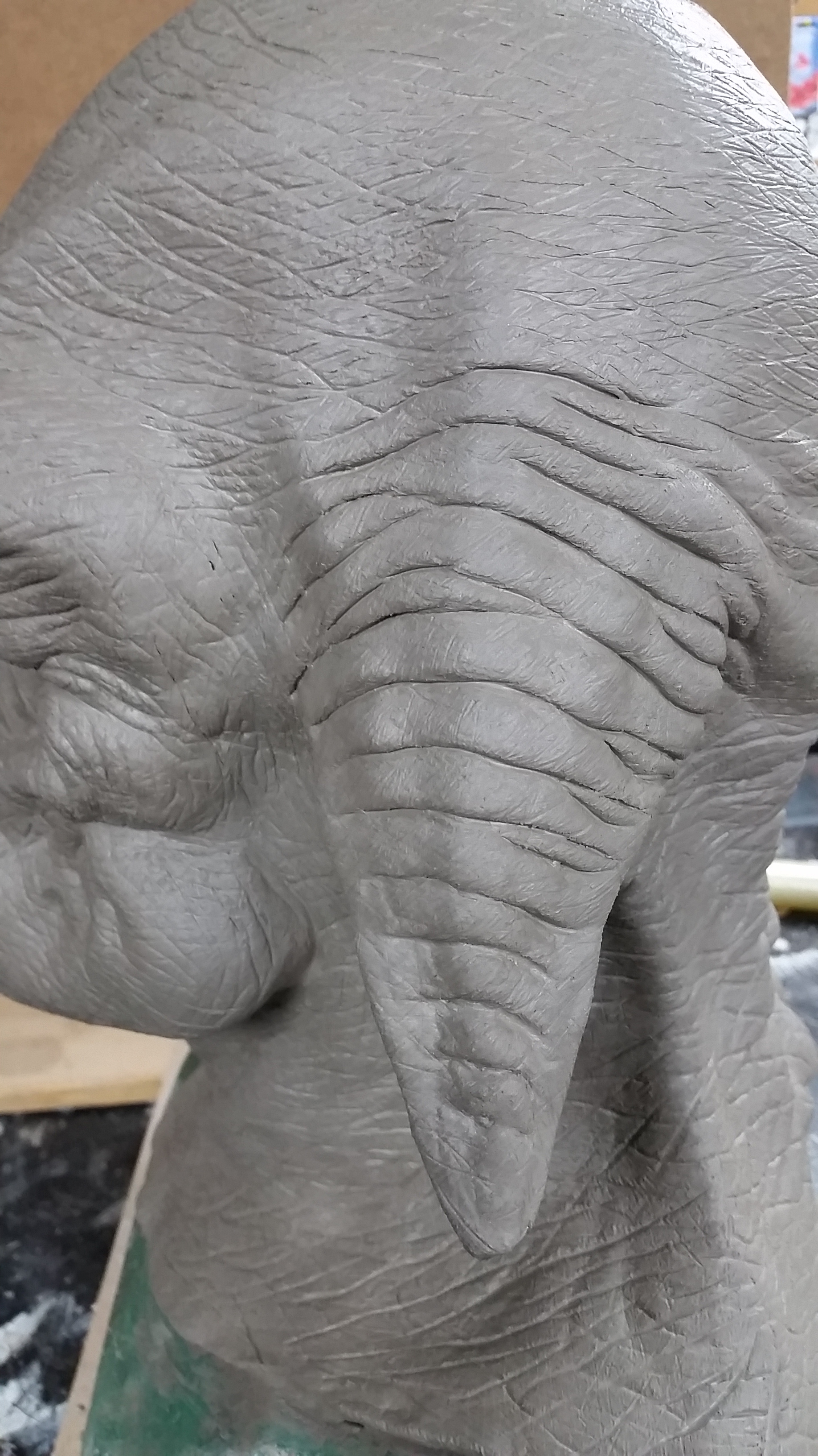

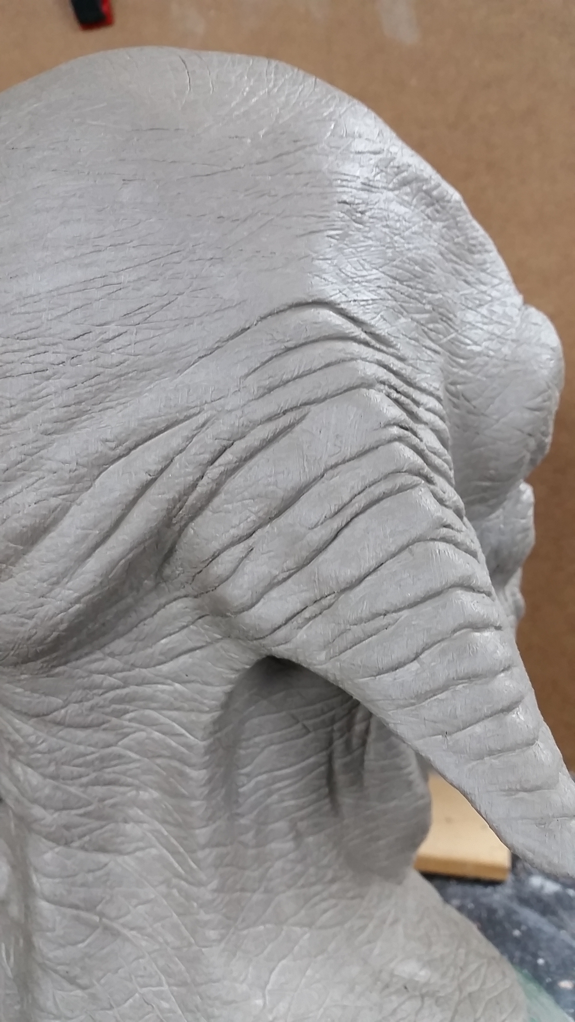

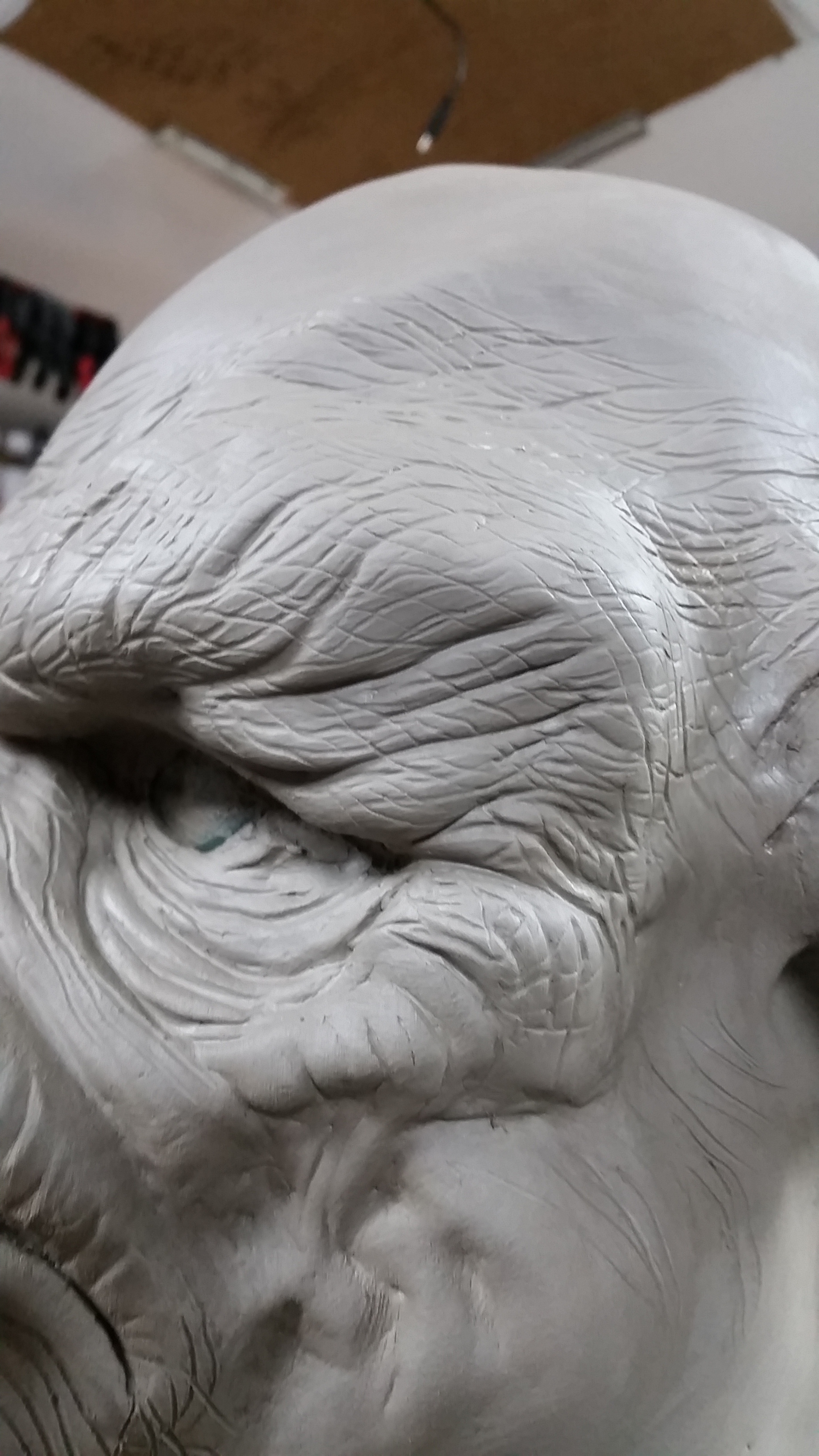

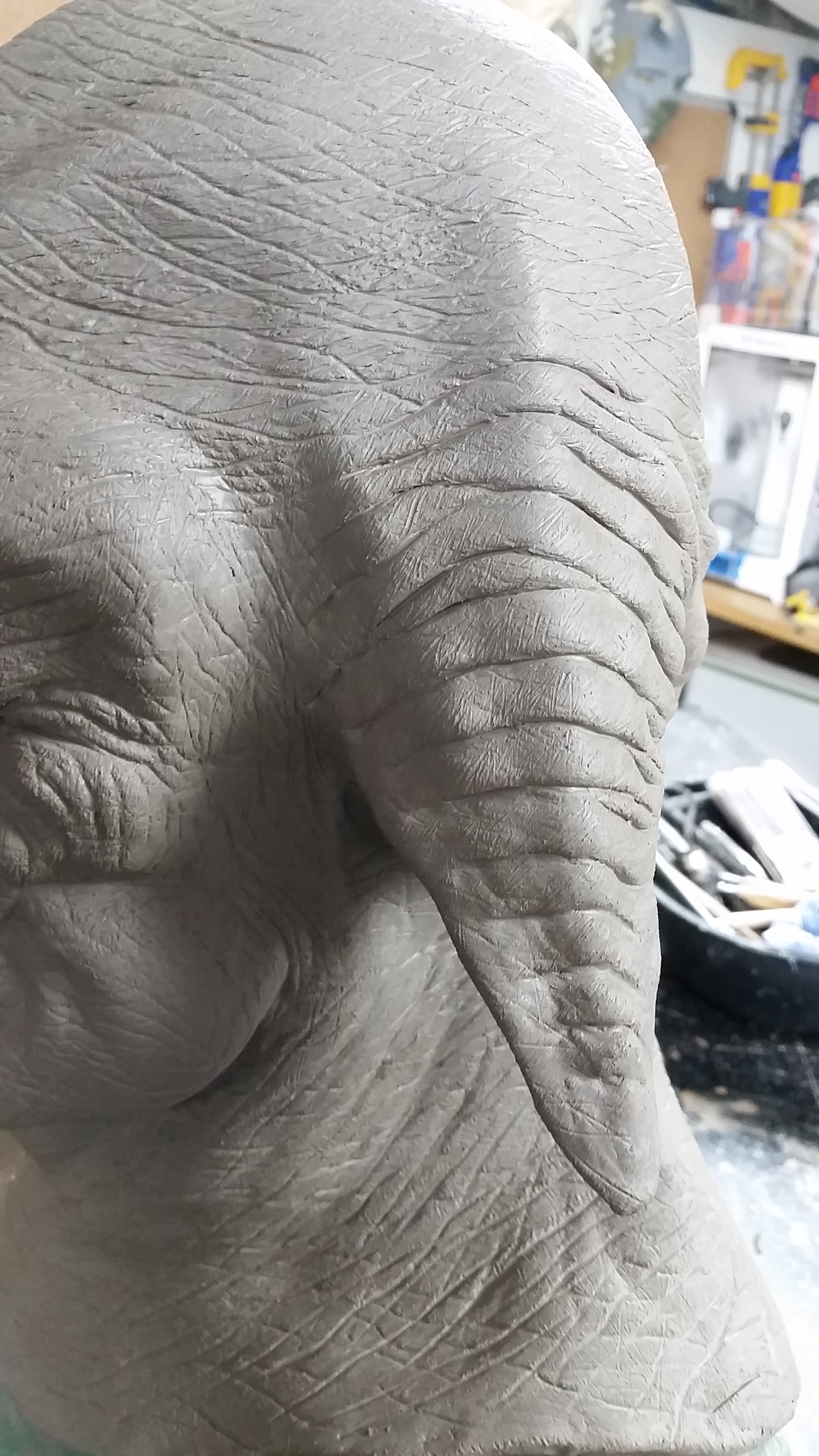

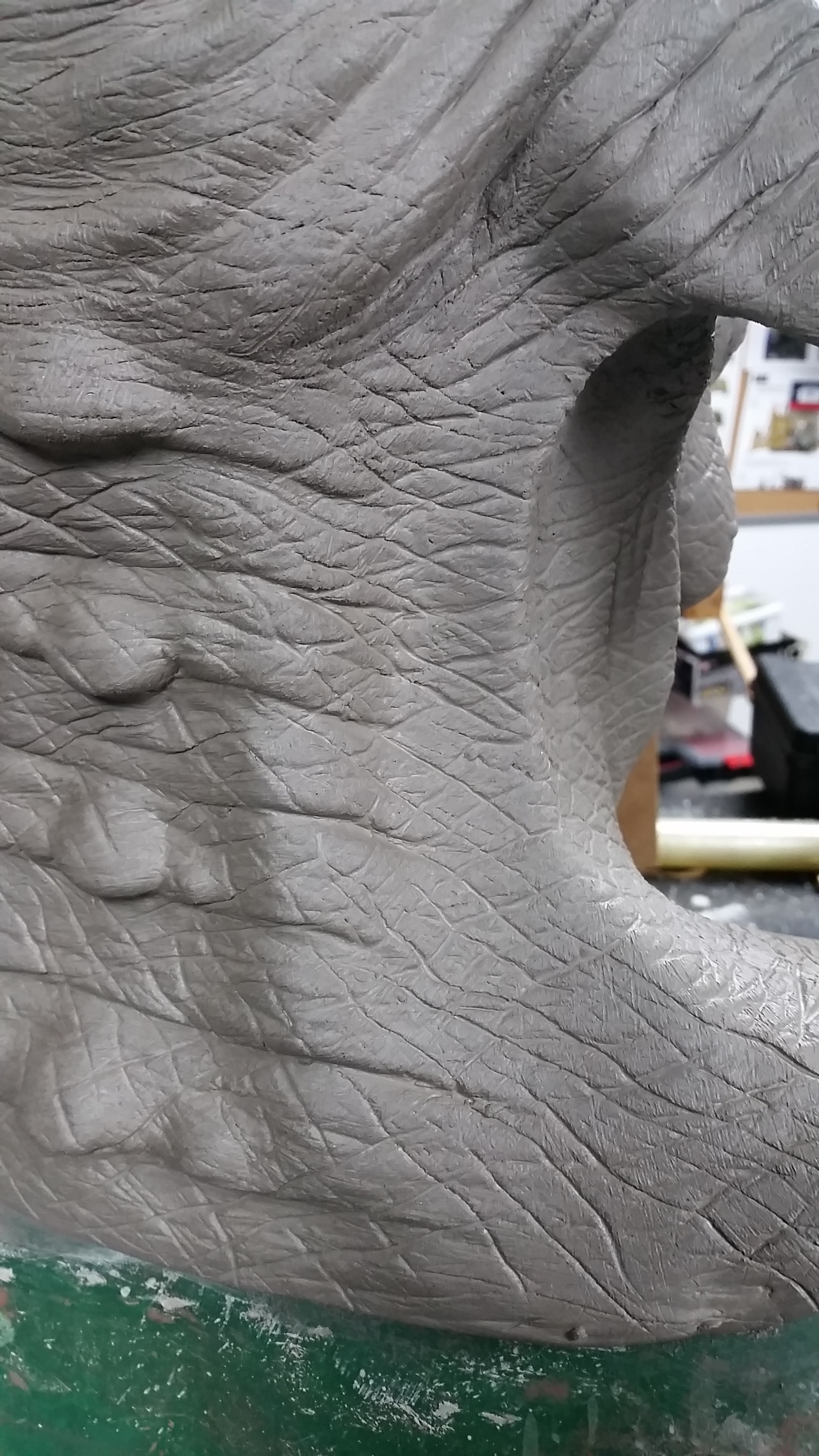

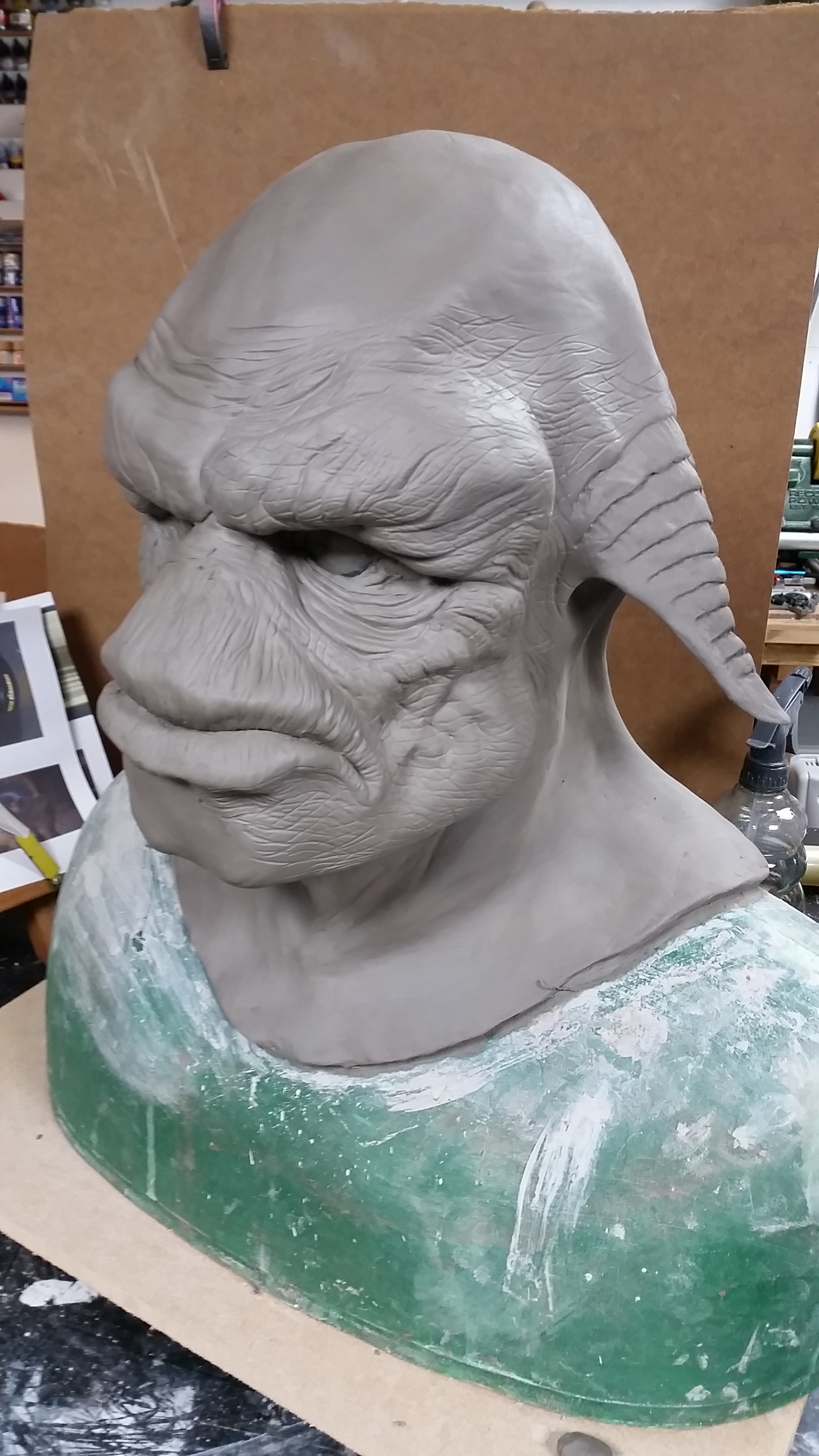

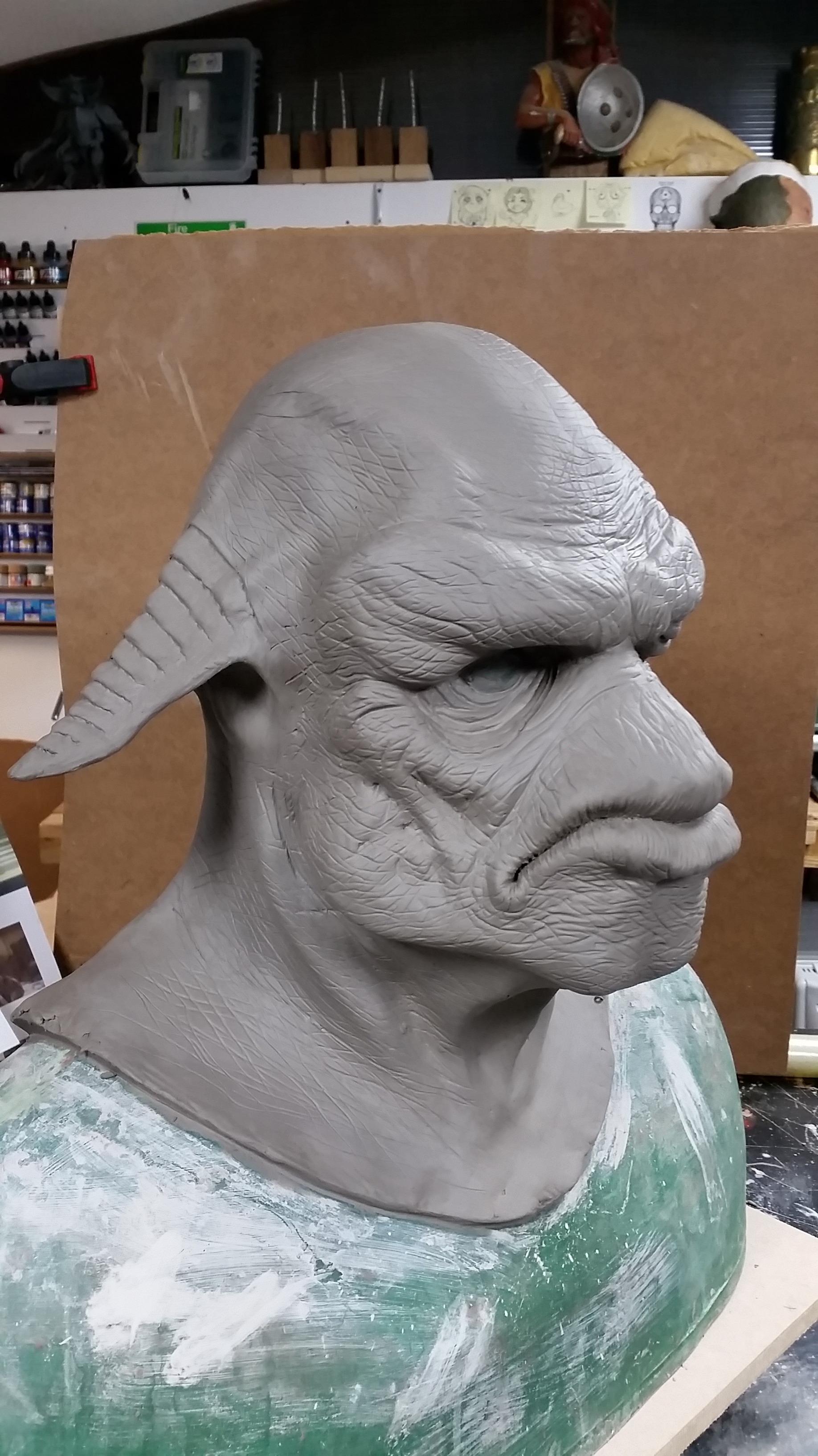

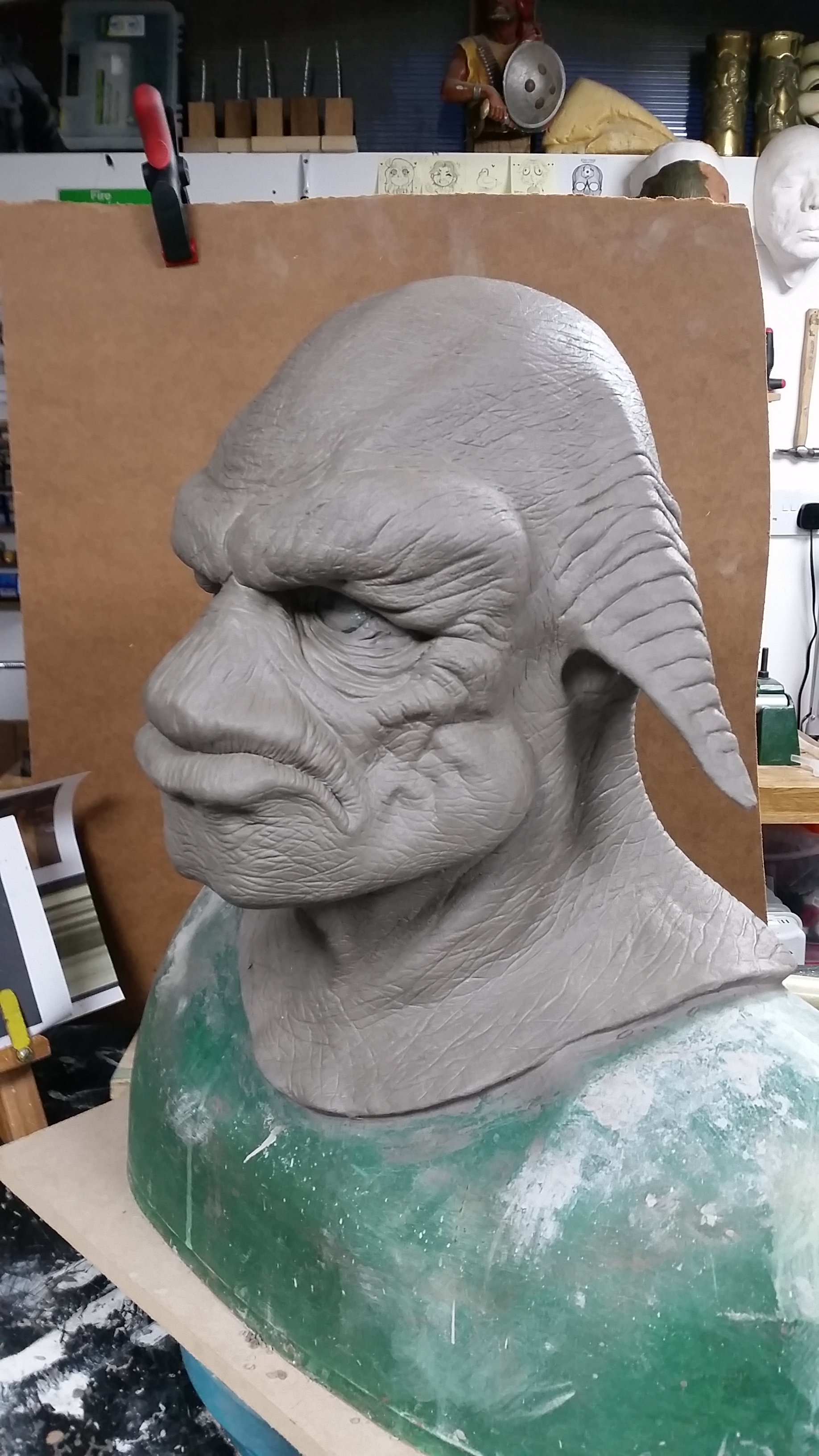

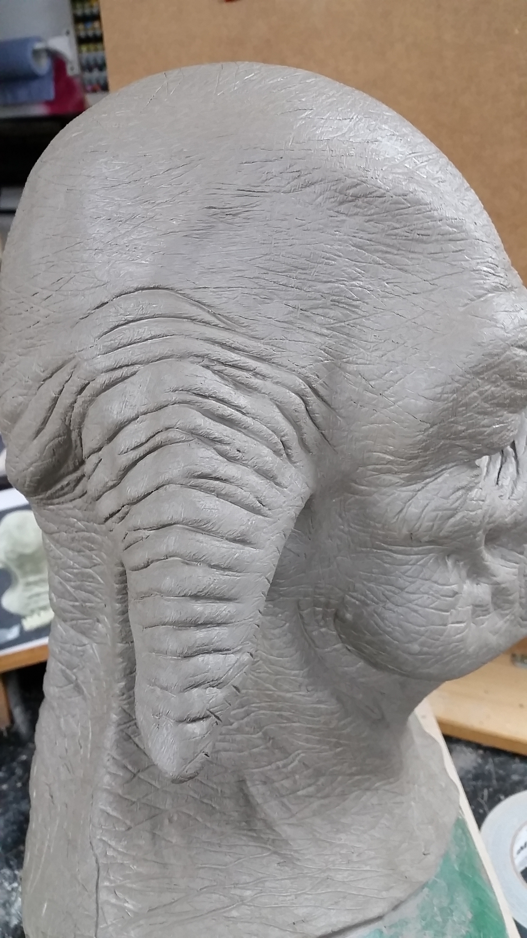

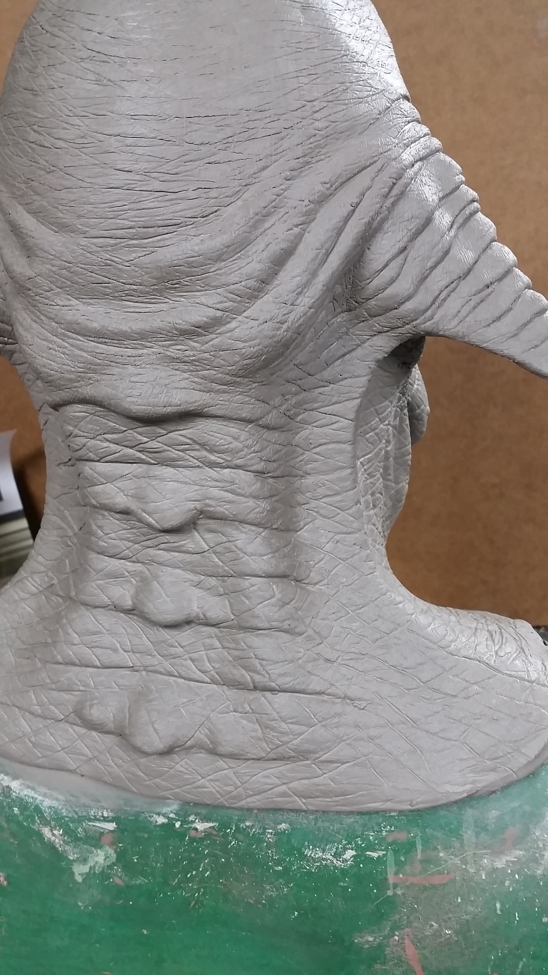

    Some more updates on the mask sculpt- I've been working on the ears and the skin textures. Still more to do before I start making a mould of this, Hopefully by the weekend.
    20180626_225049.jpg 20180626_224819.jpg 20180626_225010.jpg 20180626_225015.jpg 20180626_225106.jpg 20180626_224923.jpg 20180626_224945.jpg 20180626_224802.jpg 20180626_224723.jpg 20180626_224718.jpg 20180626_225026.jpg 20180626_225022.jpg 20180626_224905.jpg

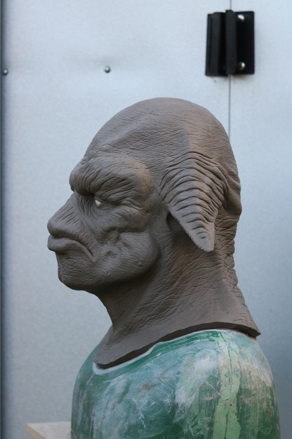

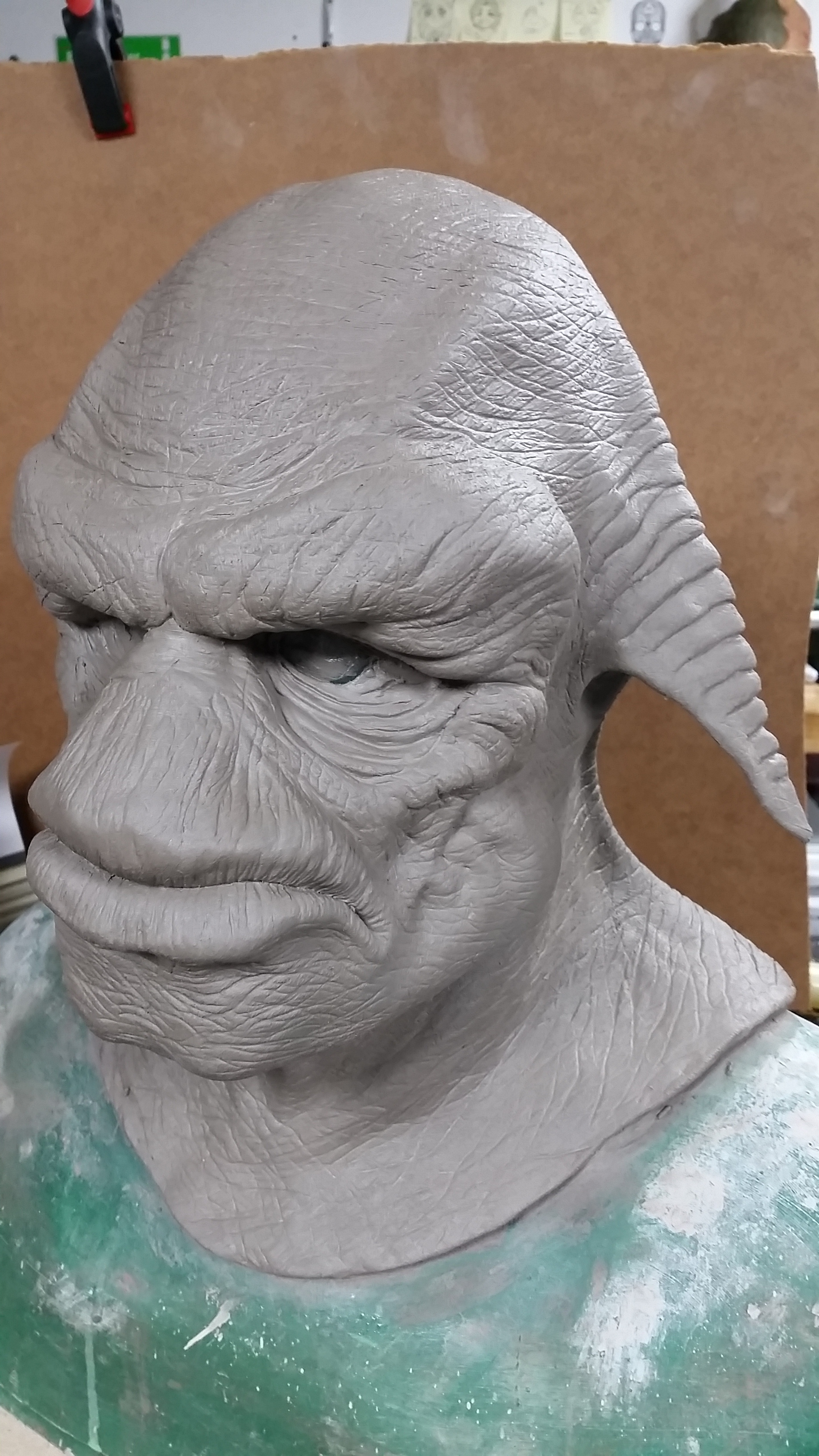

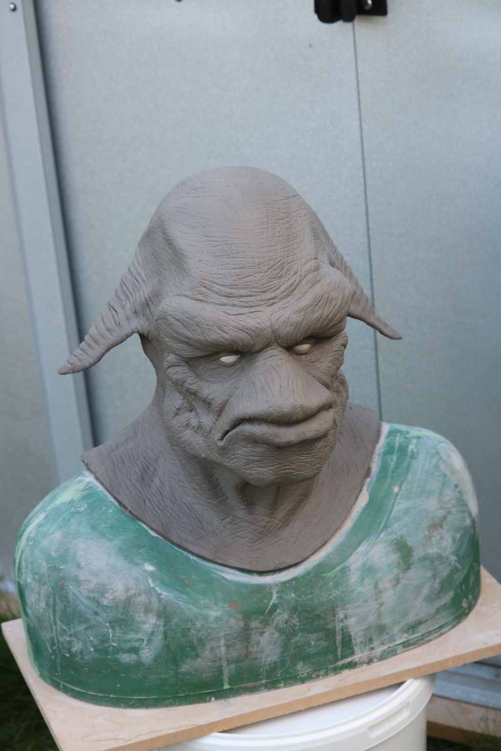

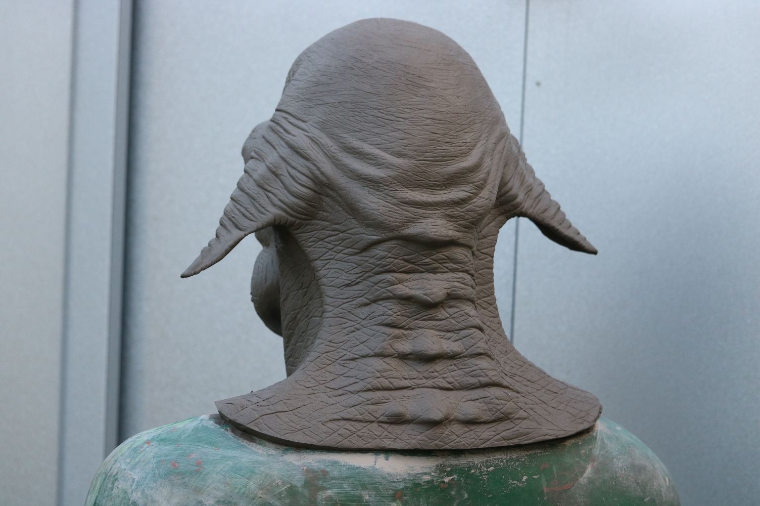

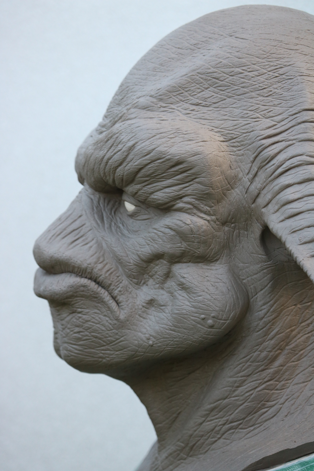

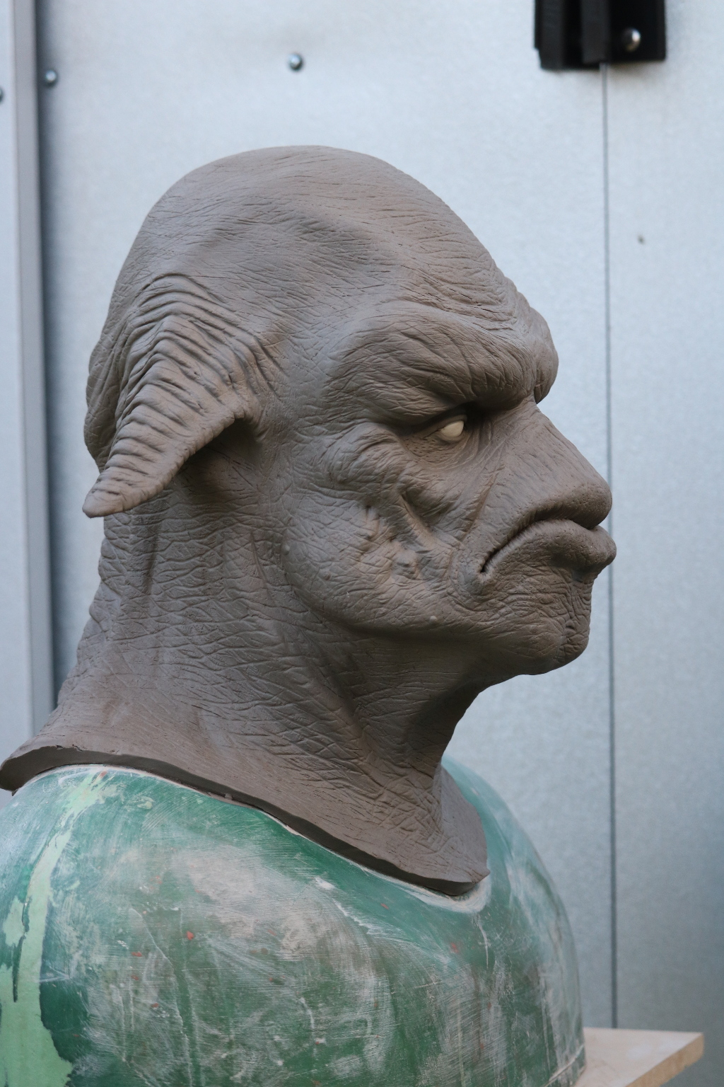

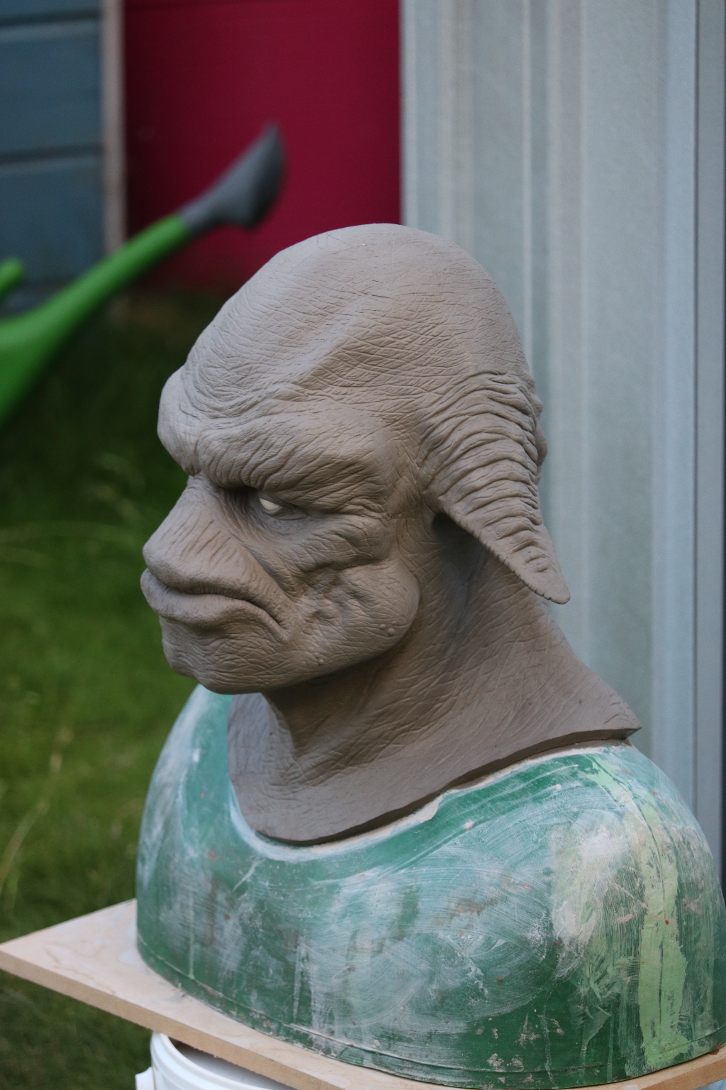

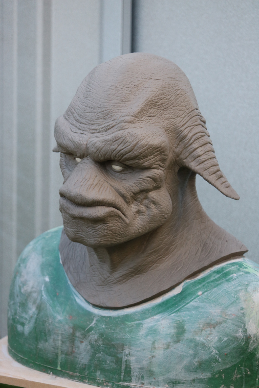

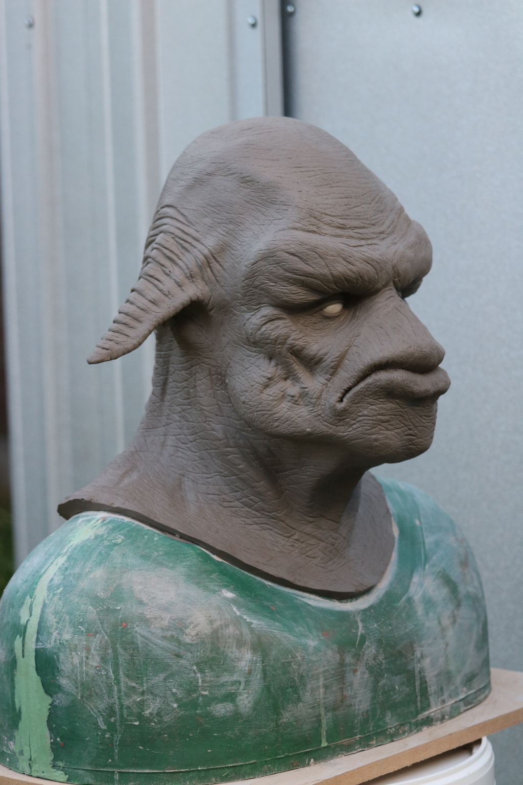

    Finished sculpt, Going to start moulding this guy today.
    I added eyes so that I can make a static dummy as well as a mask.
    Image01.JPG Image02.JPG Image03.JPG Image04.JPG Image05.JPG Image06.JPG Image07.JPG Image08.JPG

    Looks great!!
  11. postmanpat
    postmanpat Well-Known Member
    Trophy Points:
    866
    Fantastic sculpt!! Look forward to seeing it finished.

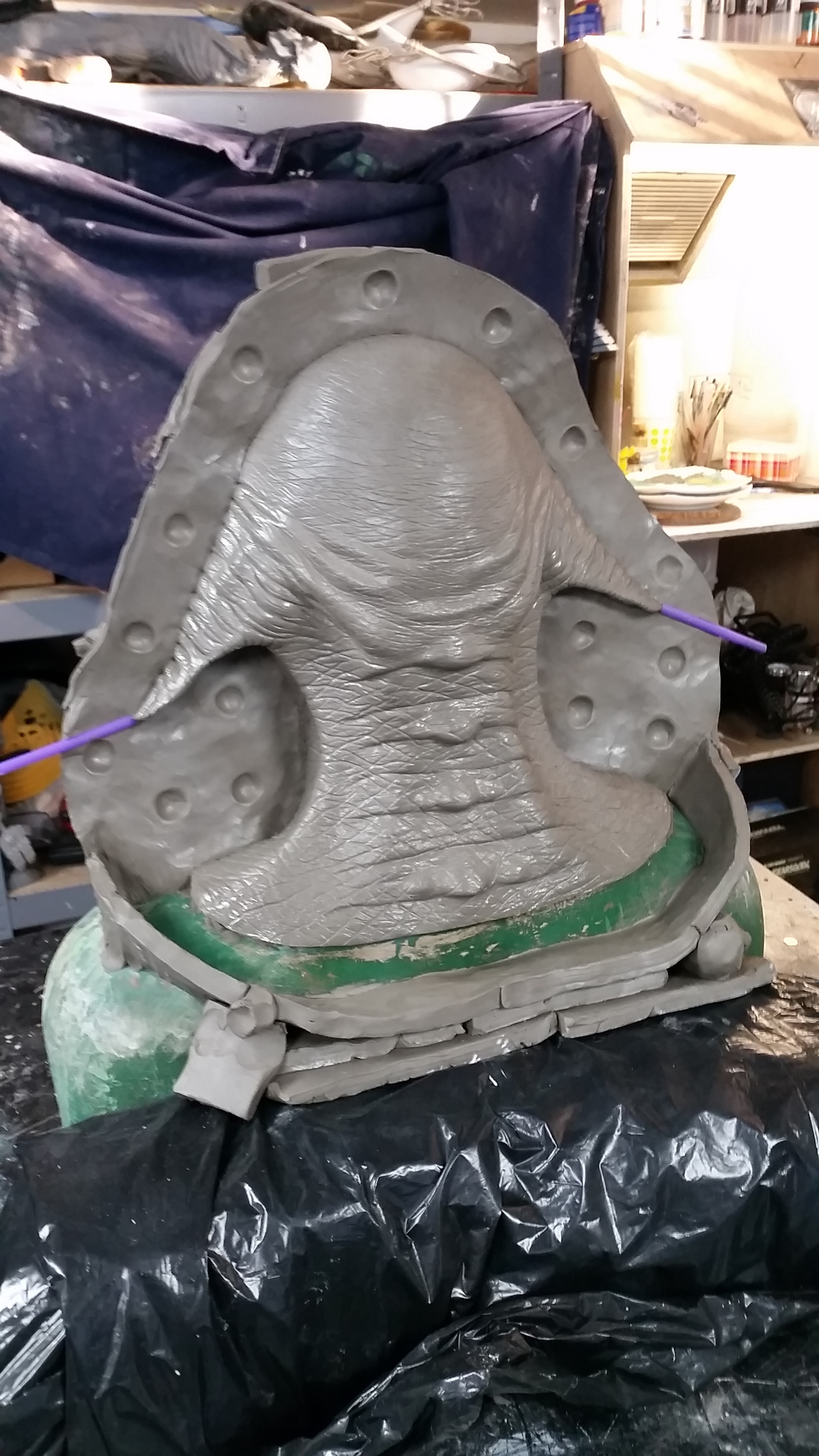

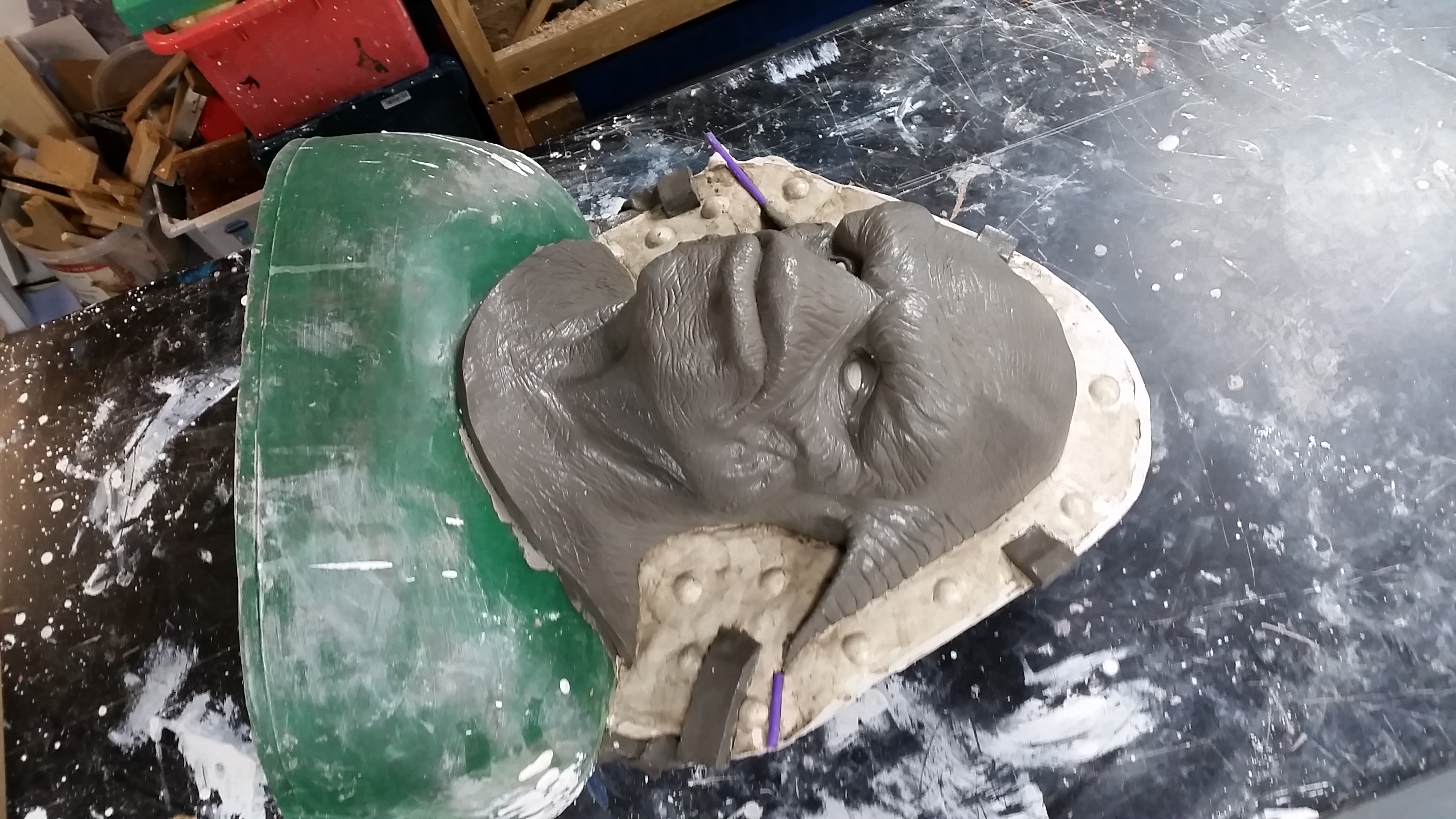

    Just a quick update today, I stayed up till nearly 2am moulding this guy. Did multiple coats of plaster to build up each side, waiting for the plaster to cure after mixing takes so long. I will be opening up the two halves this evening, fingers crossed it all worked out!
    More pics in next post!

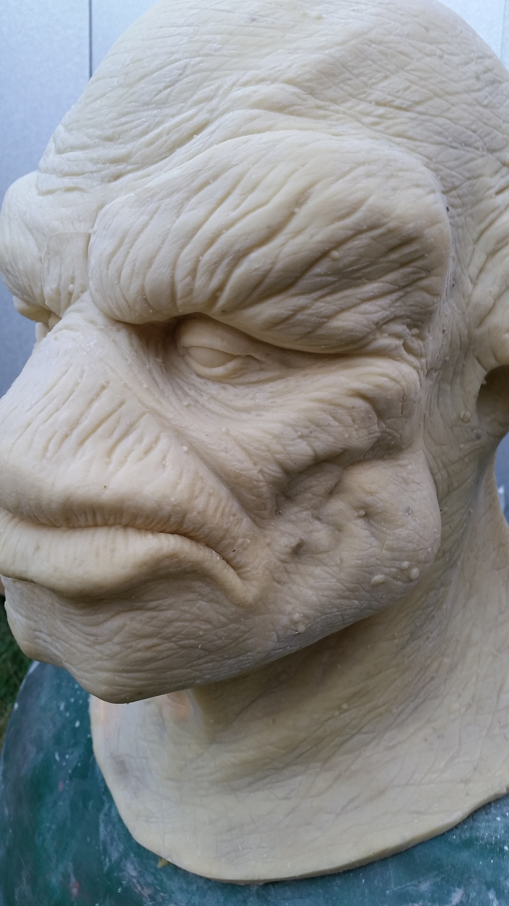

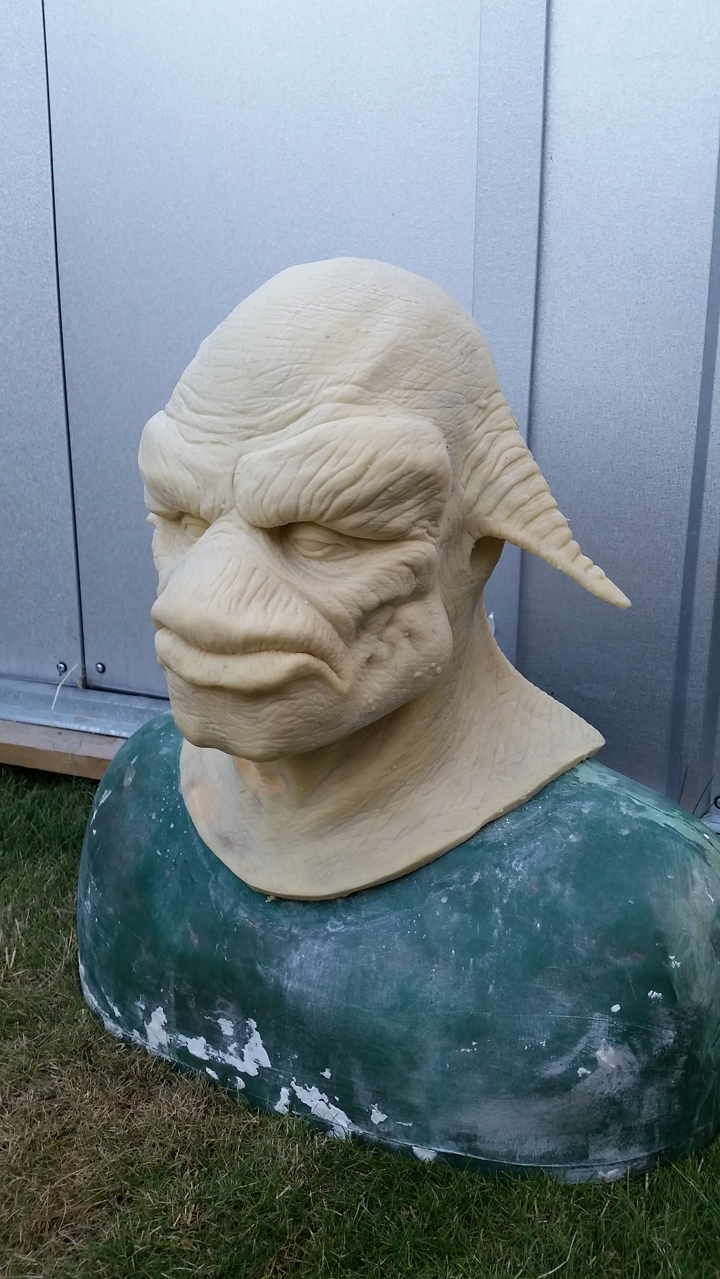

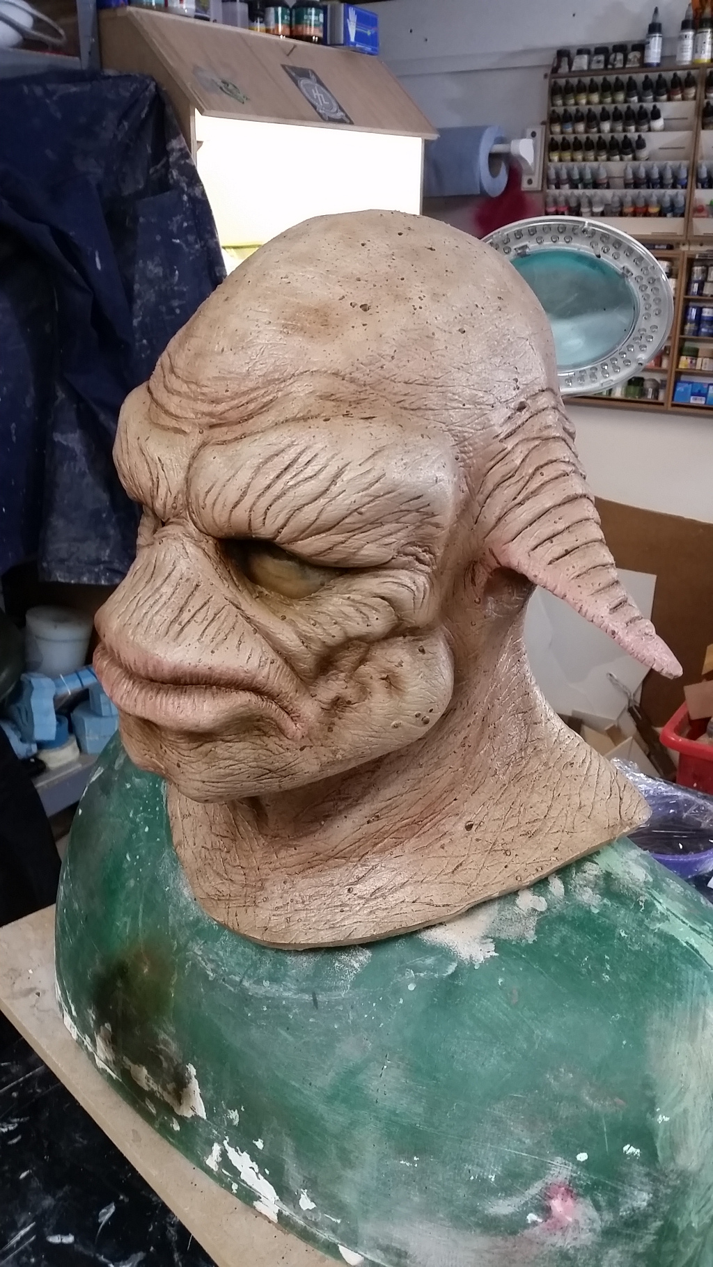

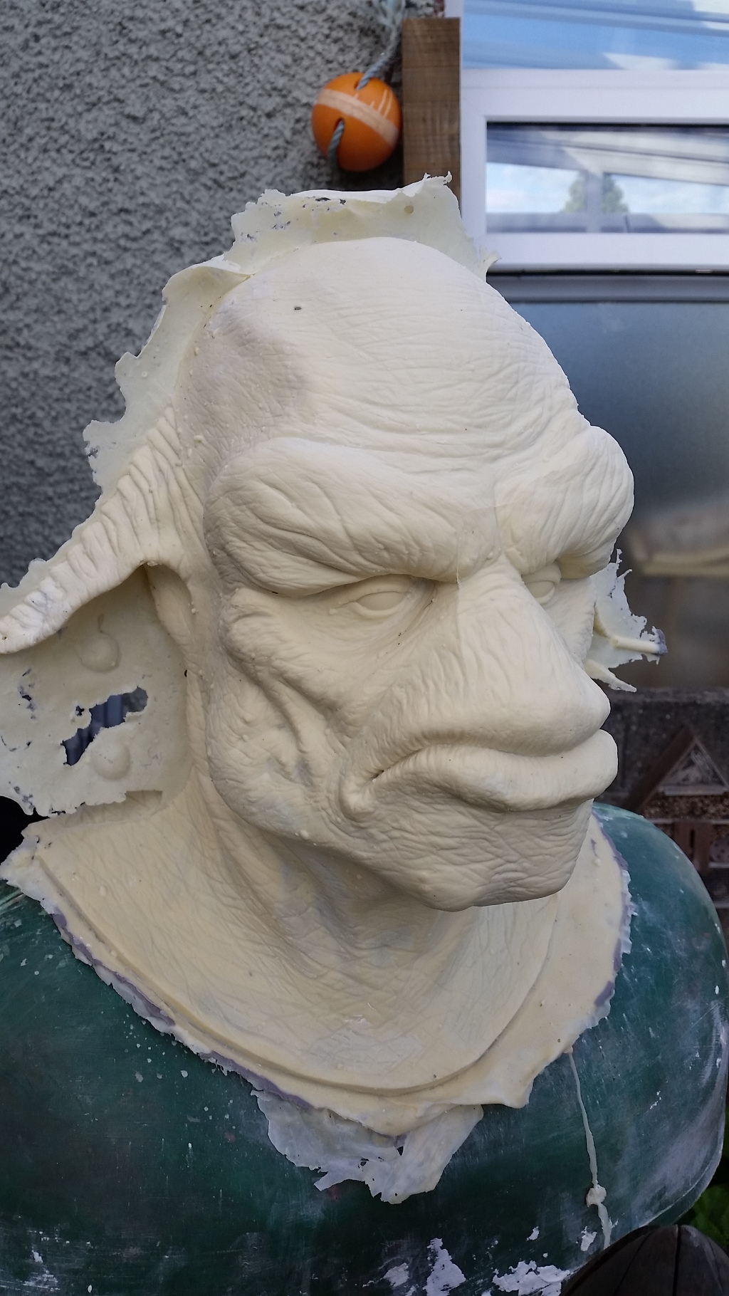

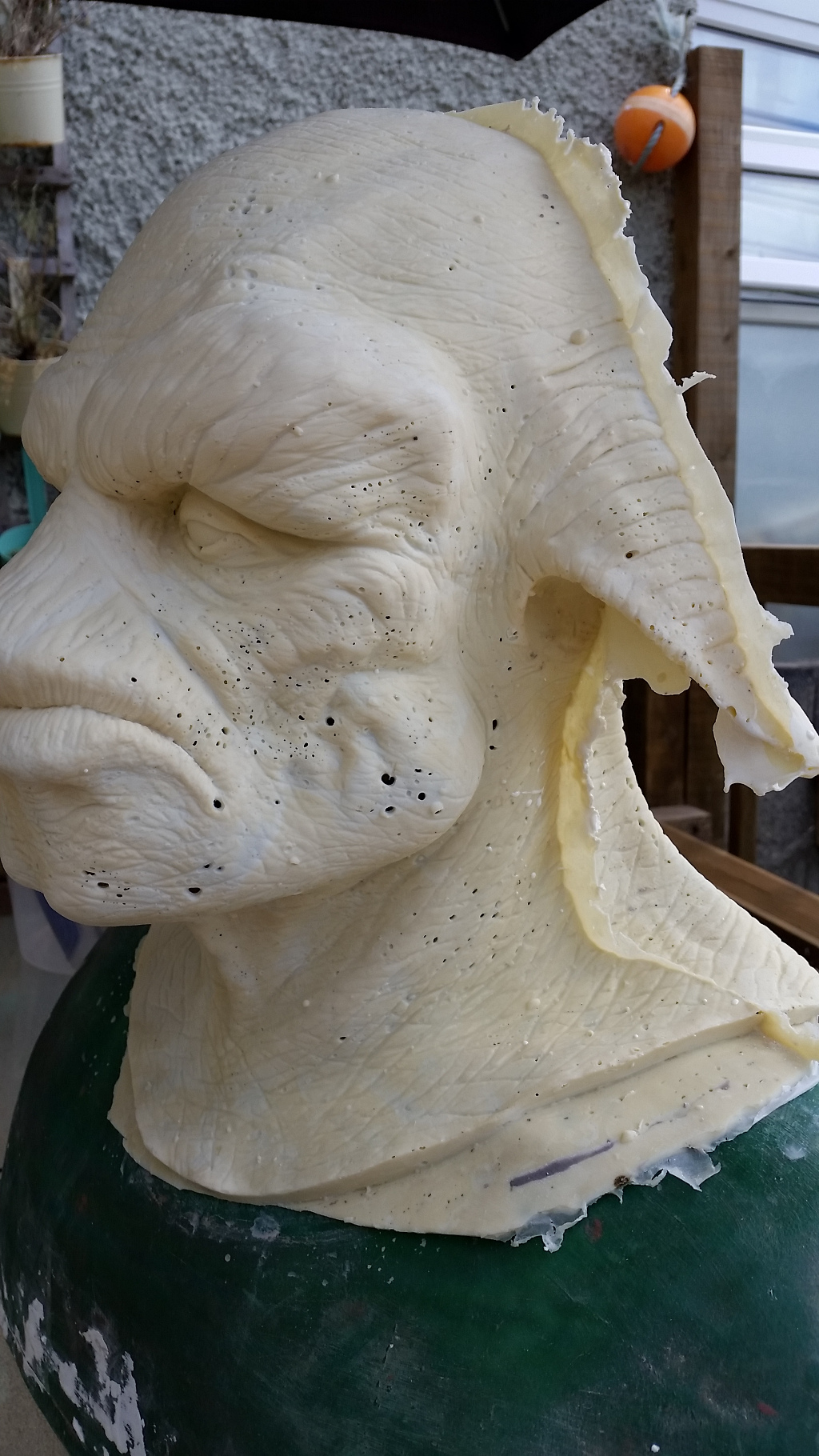

    Had some difficulty last week with casting out a mask, I stupidly forgot to talc down the sculpture before covering it in plaster, which lead to lots of mini airbubbles being trapped in the plaster. Most of them would be easy to snip off the latex, but I was annoyed that I missed that step. The big issue was when I pulled the first cast from the mould and found it was as watertight as a net, with huge airbubbles in the latex as you can see here.
    I contacted a friend/mentor to troubleshoot the issue, and it looks like some of the oil based mould release was still on the inside of the plaster mould, causing airbubbles. So i scrubbed the plaster with a chip brush and some lemon juice (citric acid) and then before pouring latex the next time I misted the plaster with water and then used a damp chip brush to brush on a first layer of latex before filling the mould. This turned out much more successful as you can see here.
    Here is the mask before trimming the seams.
    Most of the problem areas trimmed, still some cleanup to do.
    I can use the failed mask pull as a tester for paint etc, hopefully will have an update for you later in the week.
    Thanks again!

    Teenage mangalore with acne!!! YOU ARE A WIZARD!!!
    EDIT : seriously, you might consider it a flaw, but I think it makes the sculpt look more legit.

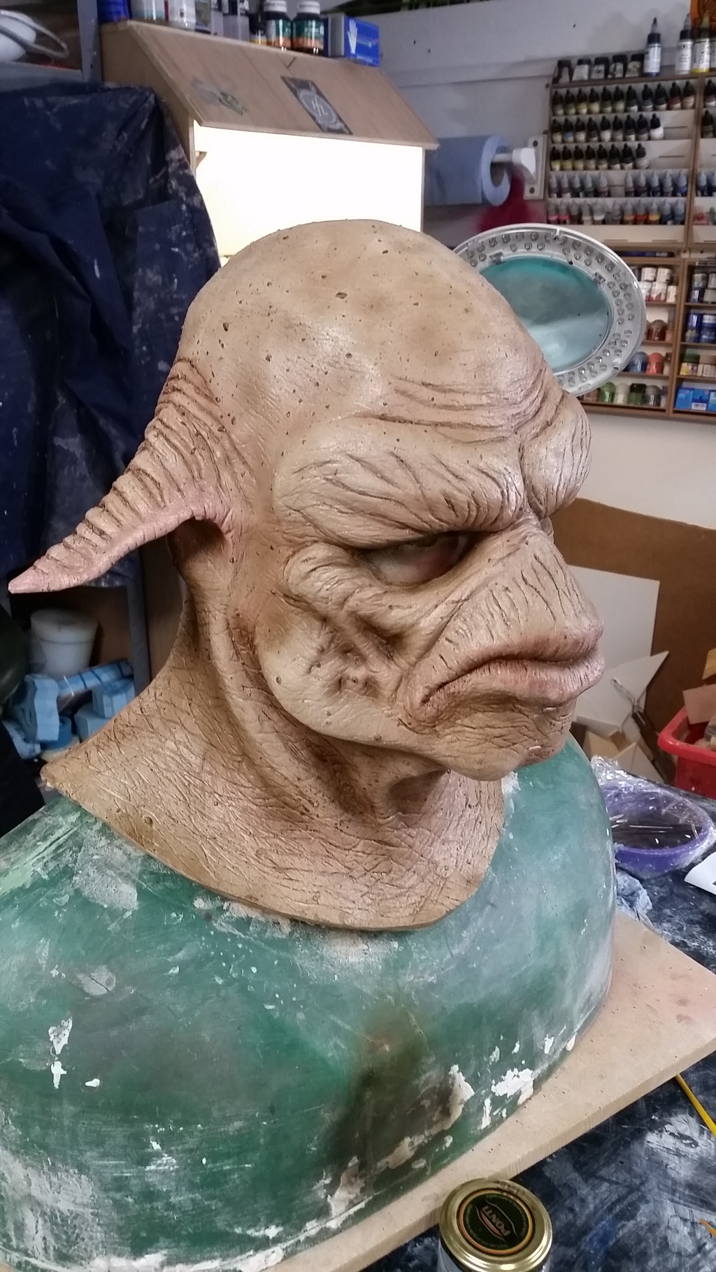

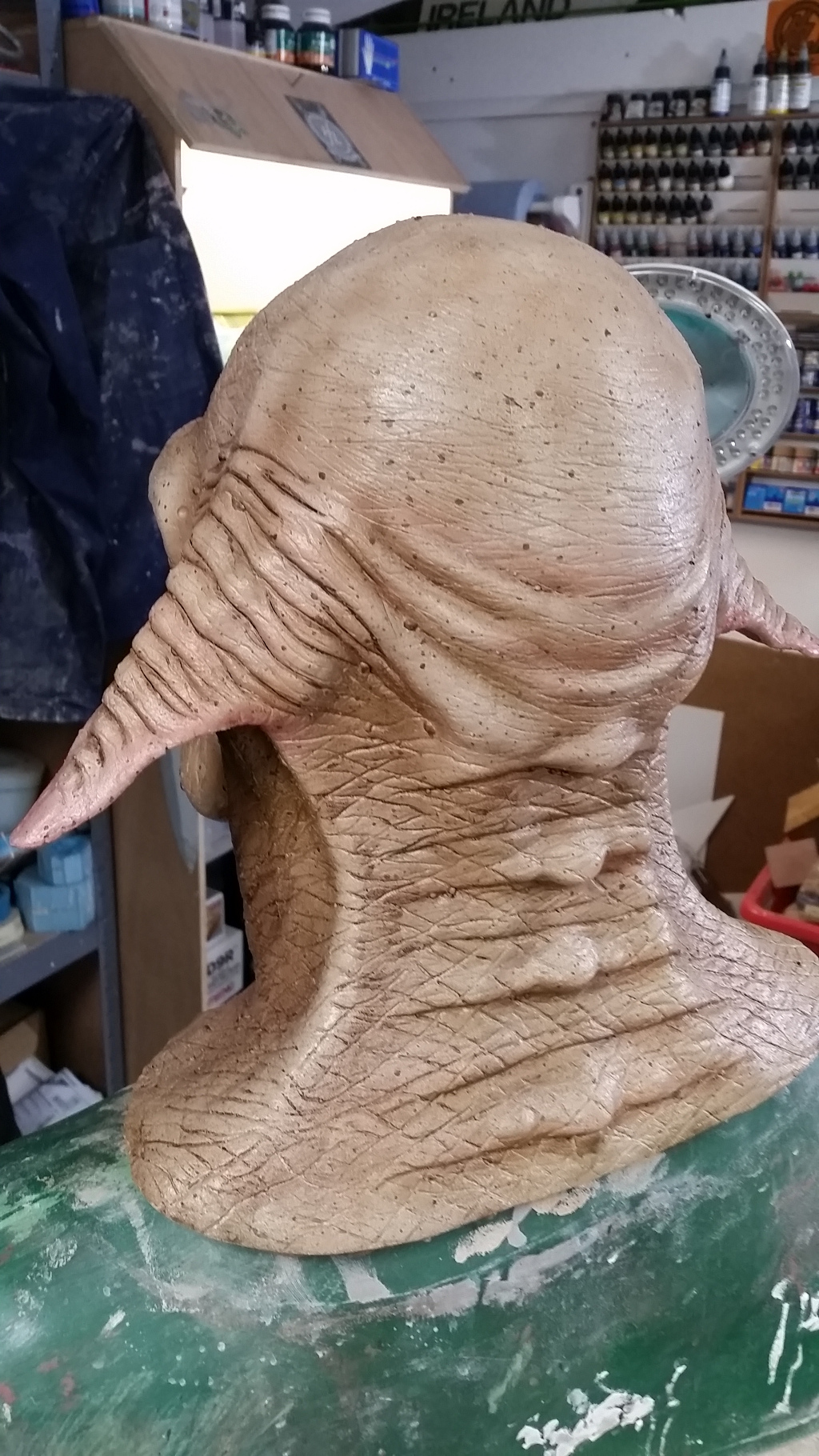

    hey folks,
    quick update on this project, here's some images of the paint progress on the mask, image quality is not too great, I will be taking some better photos with the big camera later in the week and will share them.
    Its been a long time since I've painted a mask, so I am learning a lot in the process. The paint has really highlighted a lot of the micro airbubbles on the skin from the mould, most of them are not noticeable, and some I have highlighted as 'moles' on the skin surface.
    Hope you all like!
