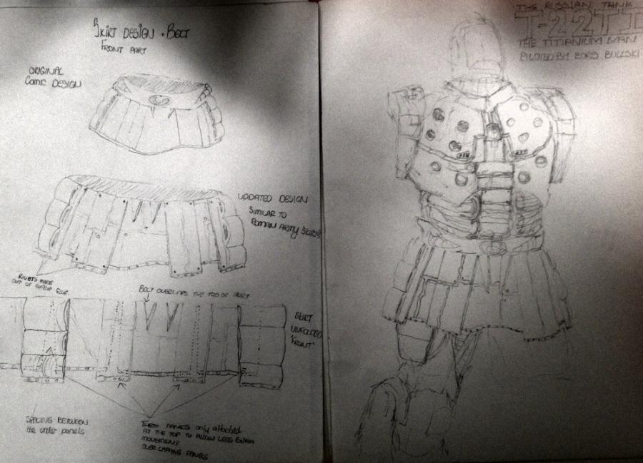

Some rough designs of parts of the suit
Yup I'm a fan.

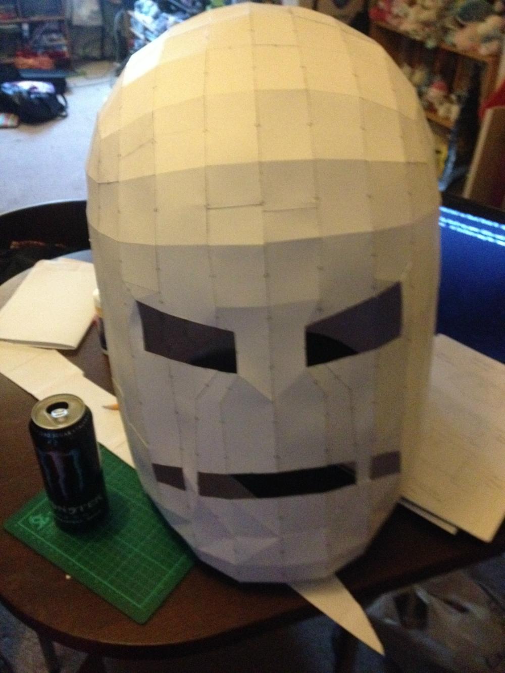

First up was the basic helmet shell, made from MK1 Iron Man files from EyeofSauron, extra detail including the 'screen face will be made from Plexiglas, I'll go into the finer details when i start adding all the extra stuff, this included the articulation and weight.
Yeah it's really huge, a can of Monster for scaling lol
