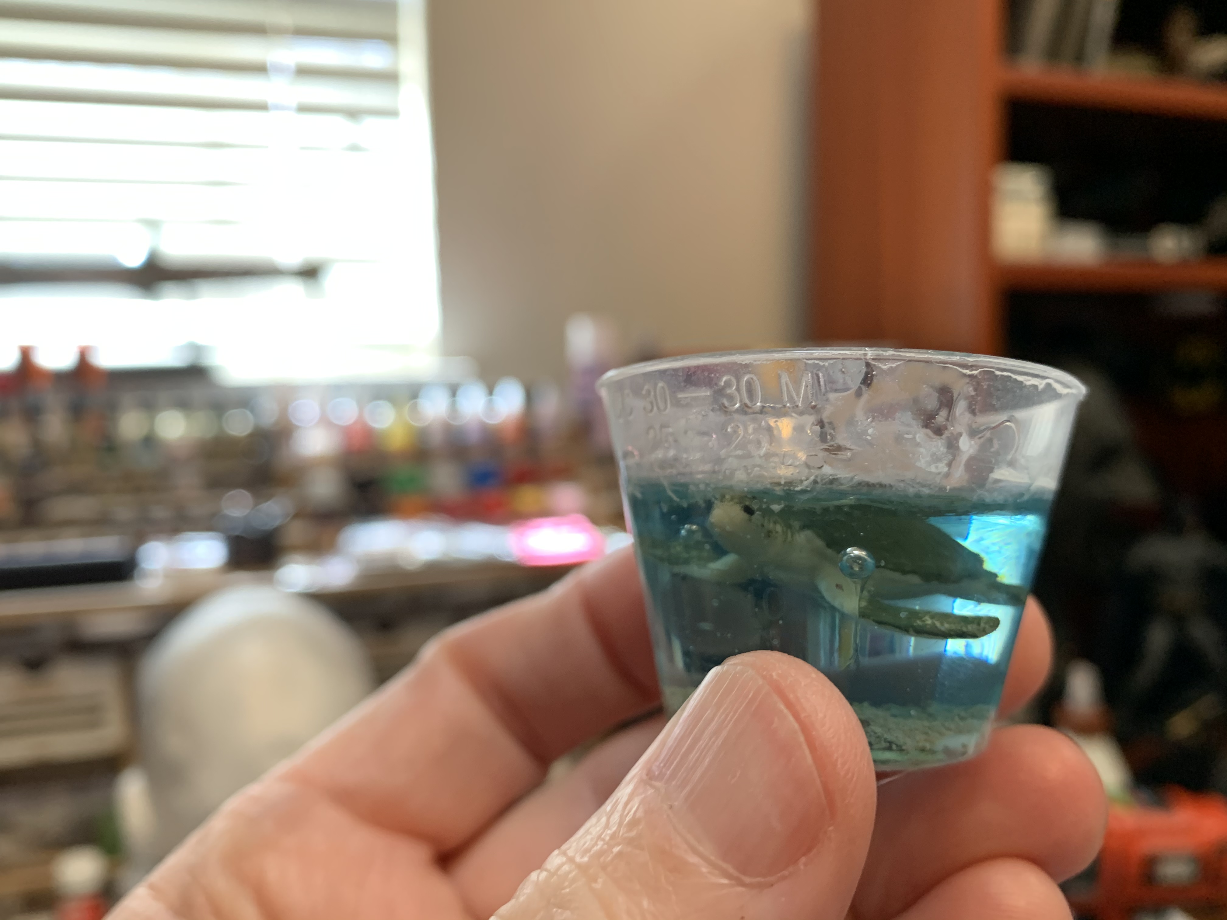

Pauleysolo
I actually did do a test with the sand glued to a piece of styrene in resin and it all went well— see picture
TazMan2000
Very odd. Perhaps the resin was contaminated somehow or the exothermic reaction was just generated too much heat. In either case, smaller pours would probably be the solution as others have suggested.
