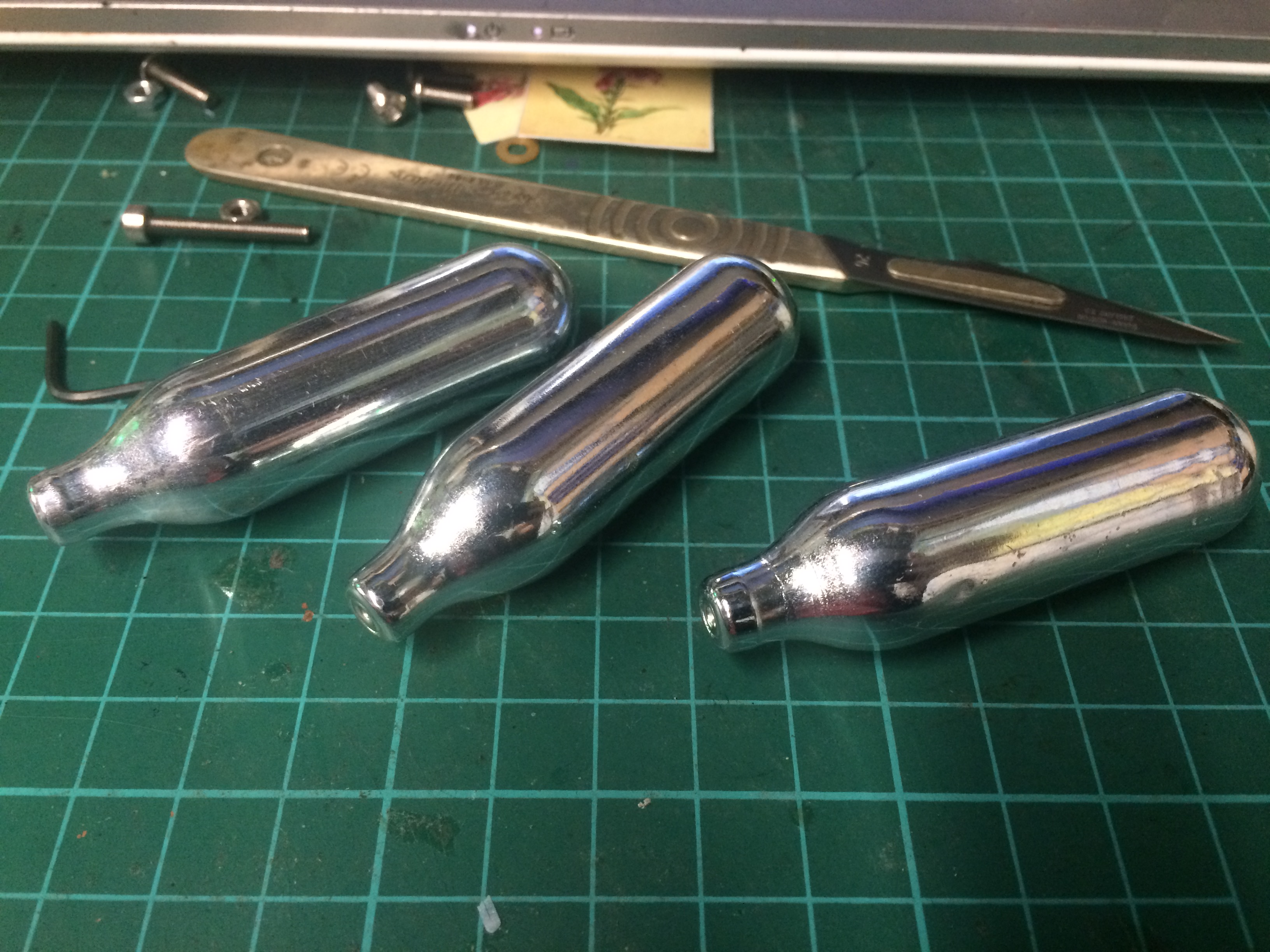

I'm embarking on a mini project to make up a rebreather from 007's outing in Thunderball. I'm basing it on finding some of the cylinders discarded by the local 'yoof' who seem to have a fascination for making whipped cream late at night in car parks :rolleyes:

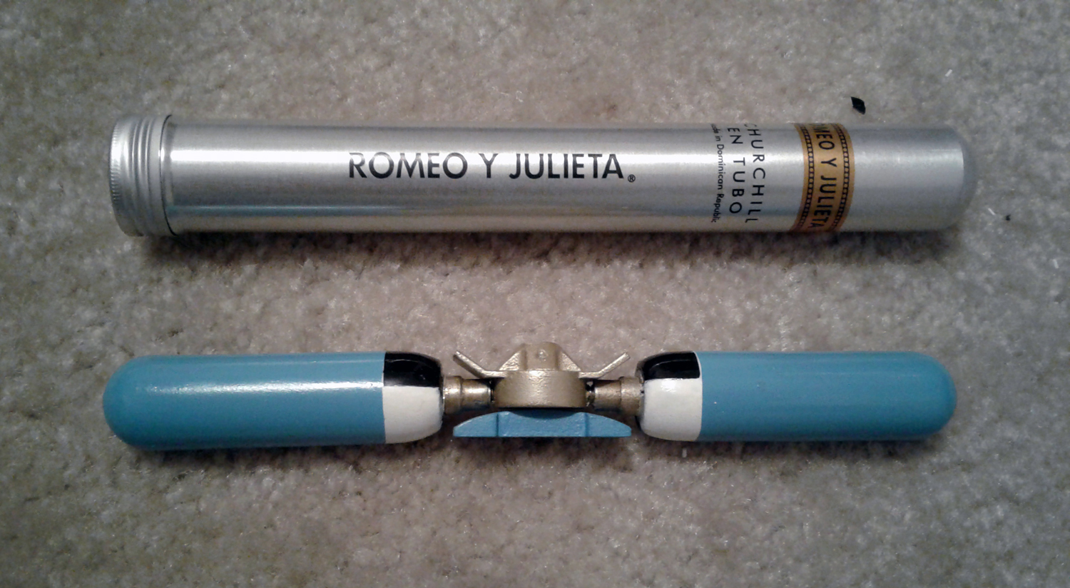

Nice. Good luck with this. I did one a few years back as a gift for a friend who is a huge 007 fan. What the renders above do not show is the white 'checkered' section of the top of the cylinders. Your images show only the black when in actuality they are black and white alternating at 90 degrees. A quick google image search will show what I mean.
I had to guess at the sizes for mine and extrapolate the dimensions so it would fit inside the cigar tube and drew everything in Sketchup for STL output and 3d printing of the parts in the middle. After painting, I had to repaint it since my source images were a bit off in color. More a gray color than a blue.
Here is a pic of mine. Happy re-breathing.

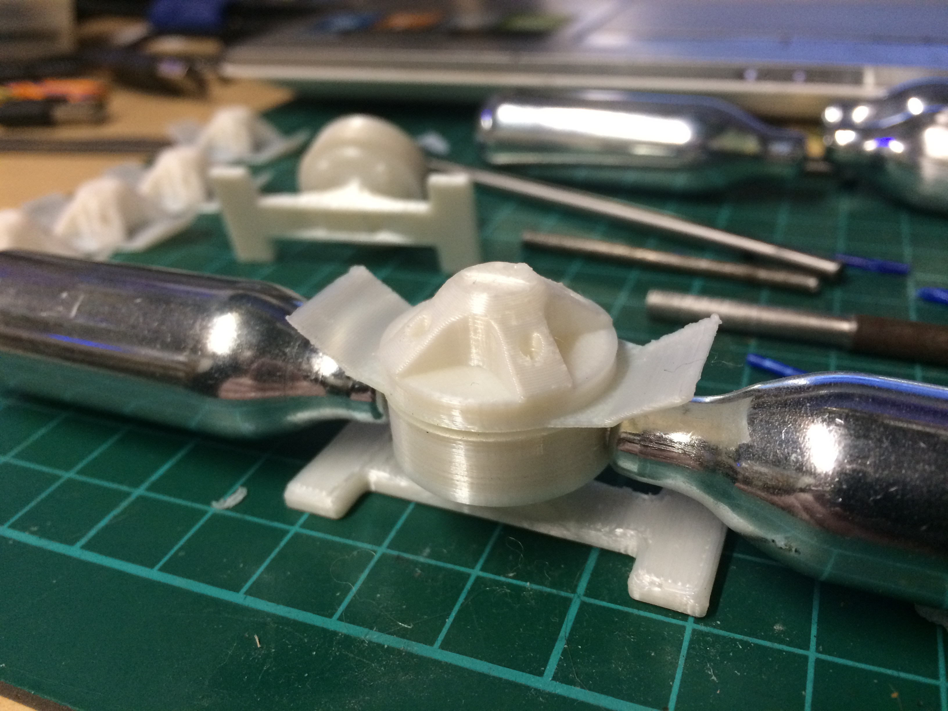

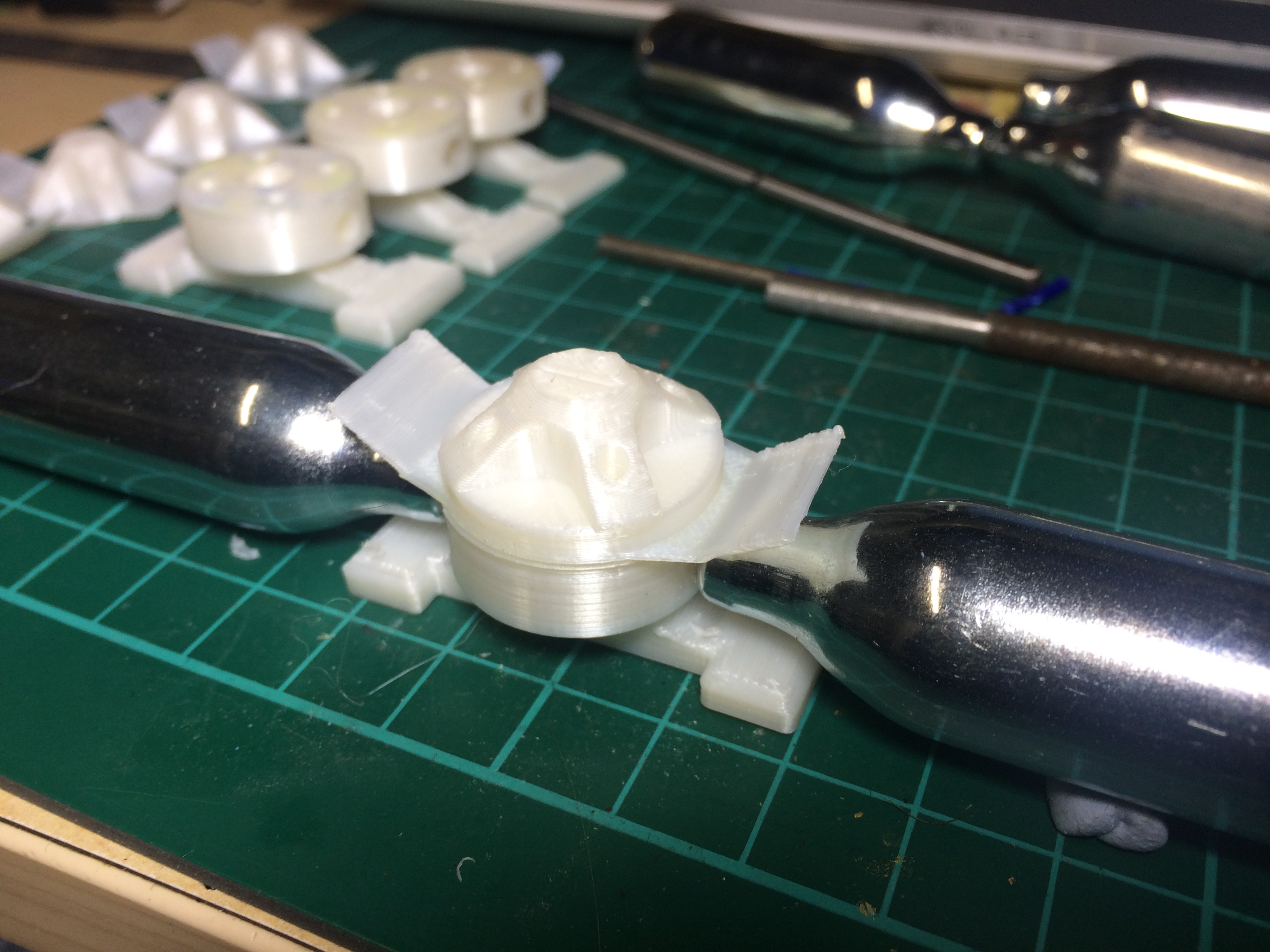

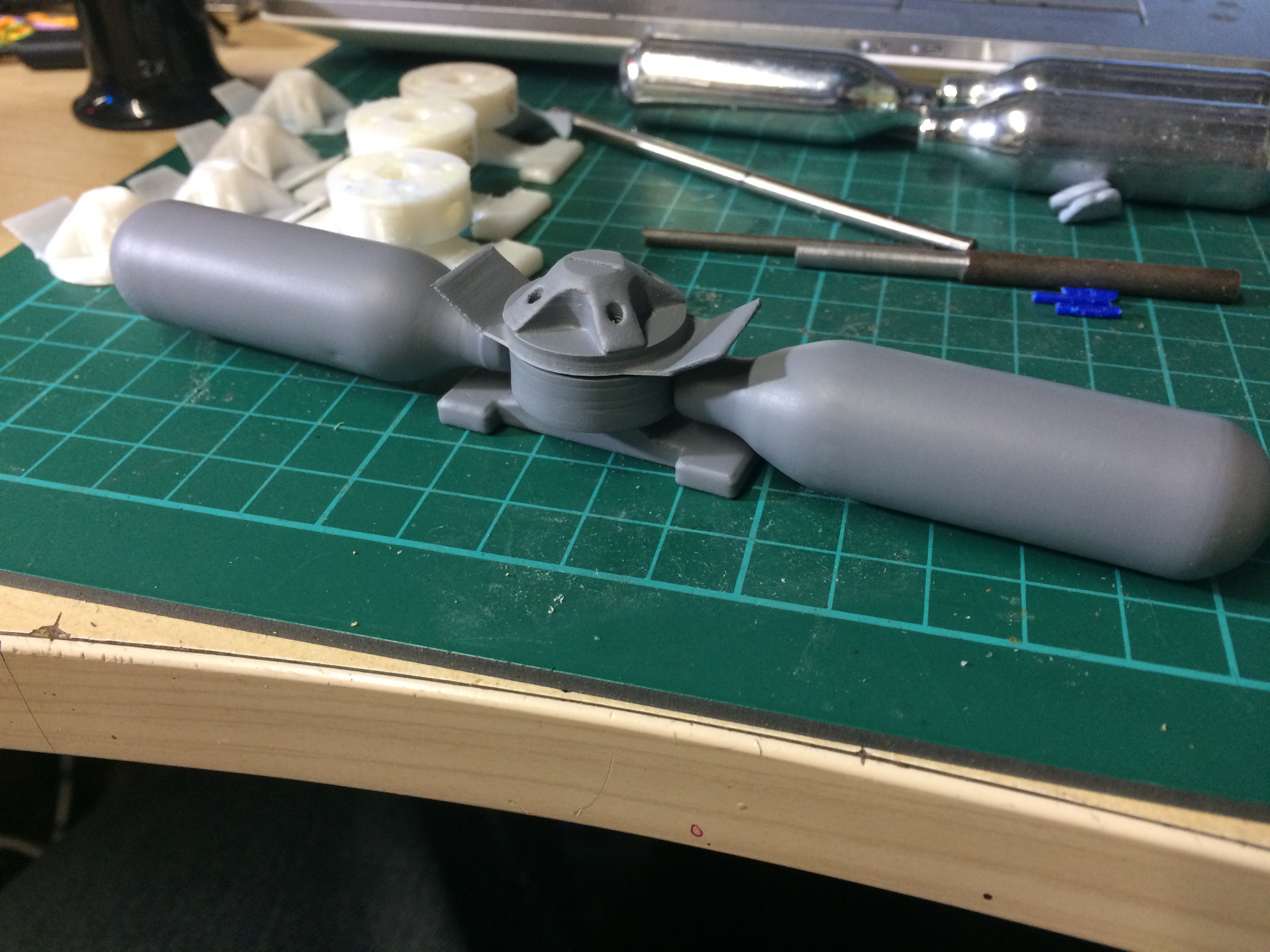

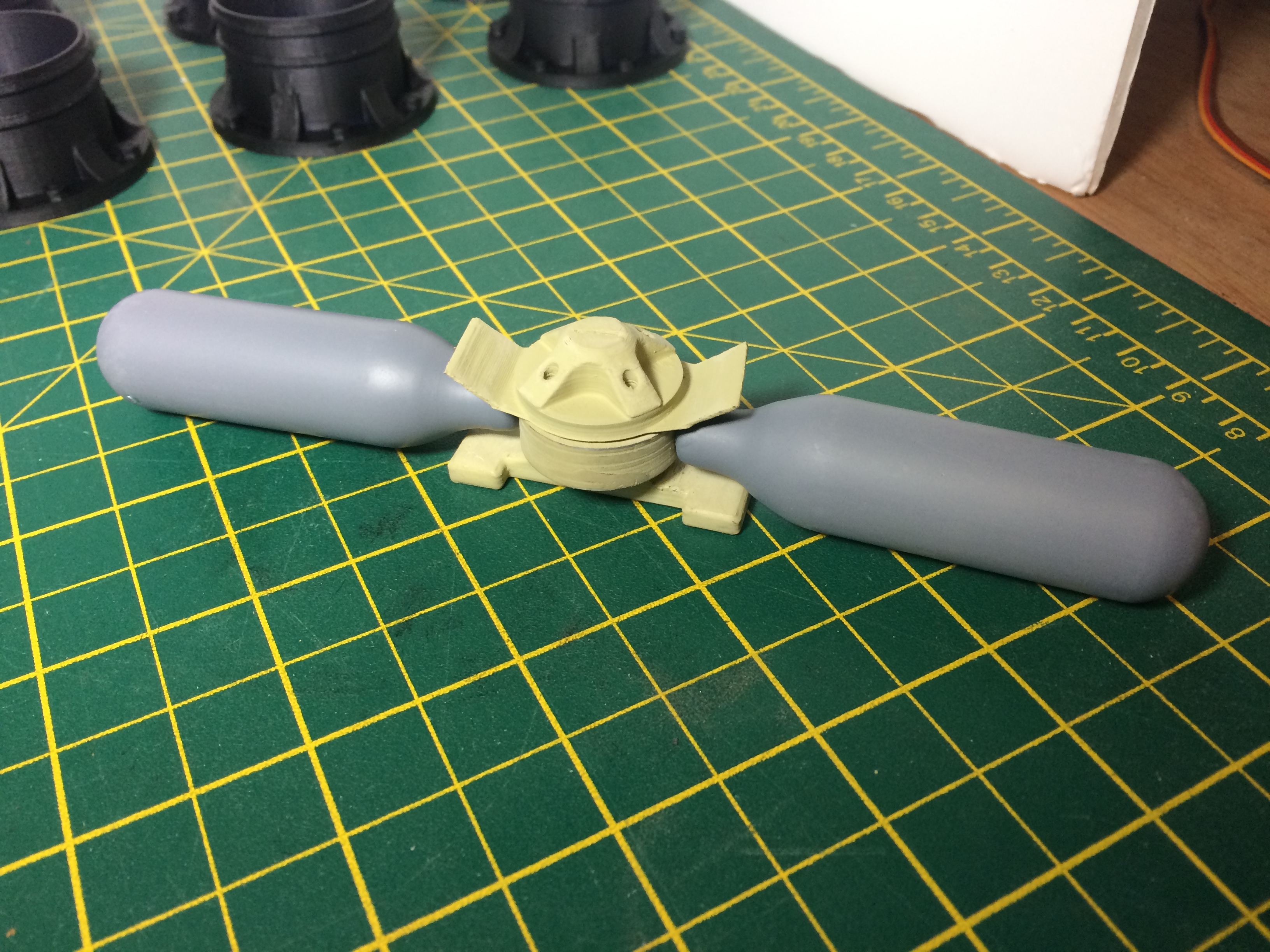

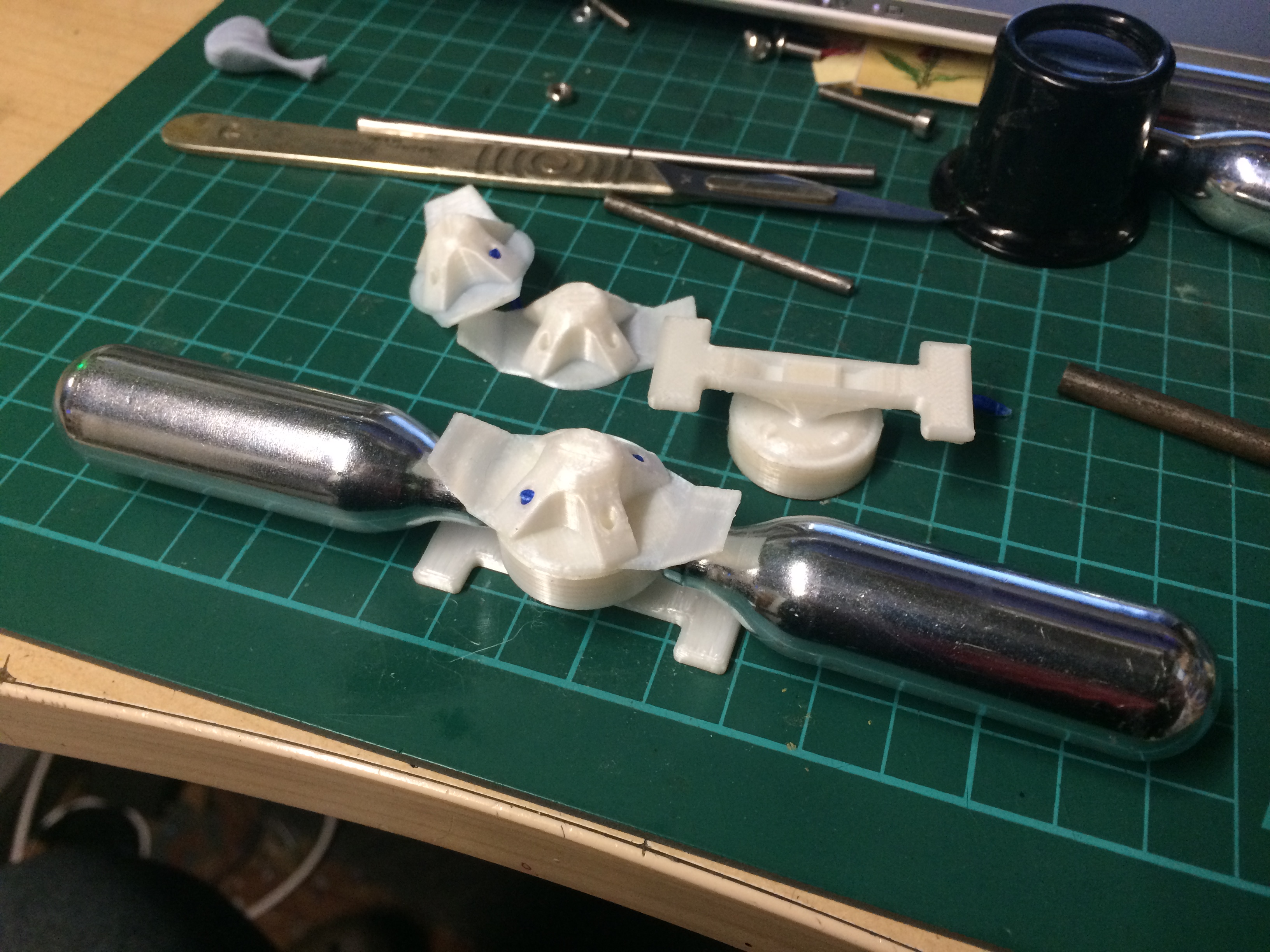

Reworked the base and mouthpiece now as well, looks a bit more to scale and approaching more the movie version. Will be priming, filling and sanding and having second thoughts now about making some cylinders (defeating the original idea of using some found ones)
Next step is to give this a bit of a file and a sanding and then primer. i used to use the normal halfords filler primer, but it never really worked well for me, but I'm now using another brand of theirs called high build primer. It works a lot better and dries a lot quicker as well.
A bit of light sanding on this with some 800 grit and 1500 and then a final coat of primer and sanding again with 1500

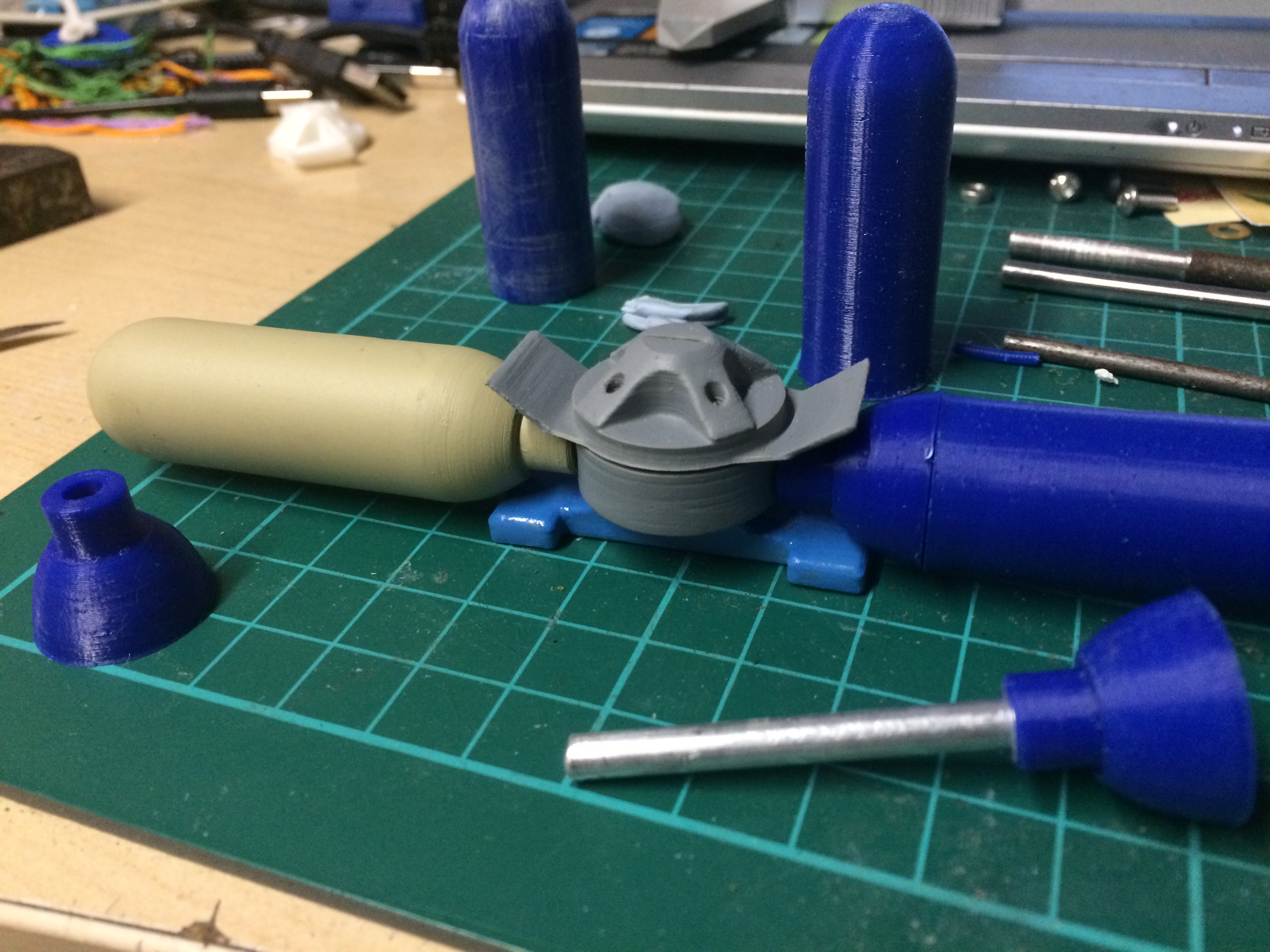

So in the end I went with sketching up some tanks as well and printed them off in ABS as the hatchbox i have takes a sanding quite well.
For some reason the internal bracing was showing through, so i had to print those seperate and glue them in. Also had to set the seam to random so as not to get vertical seam lines as well.

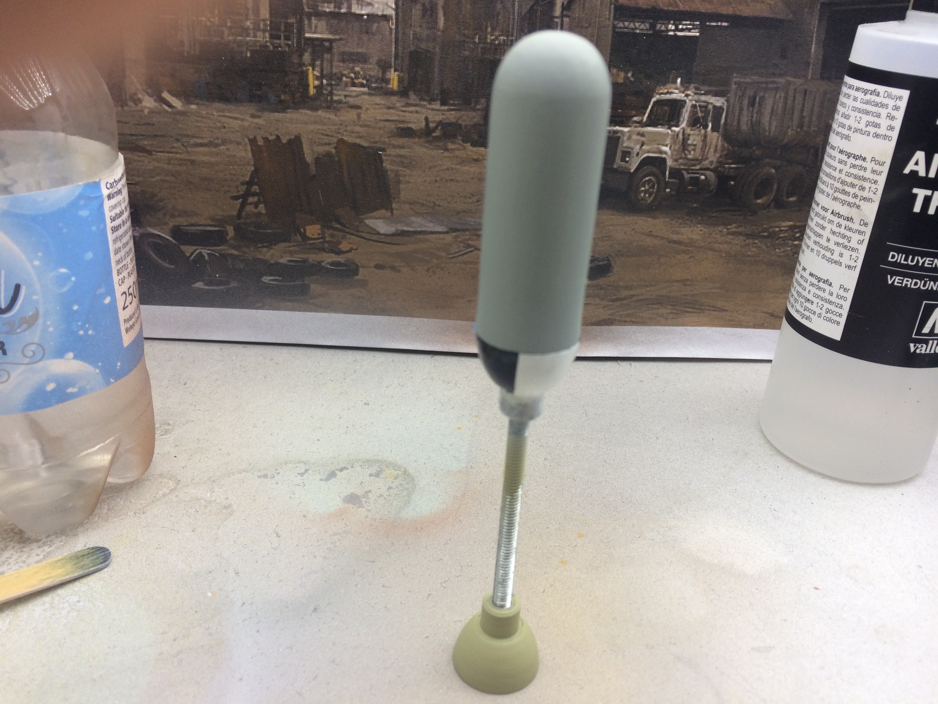

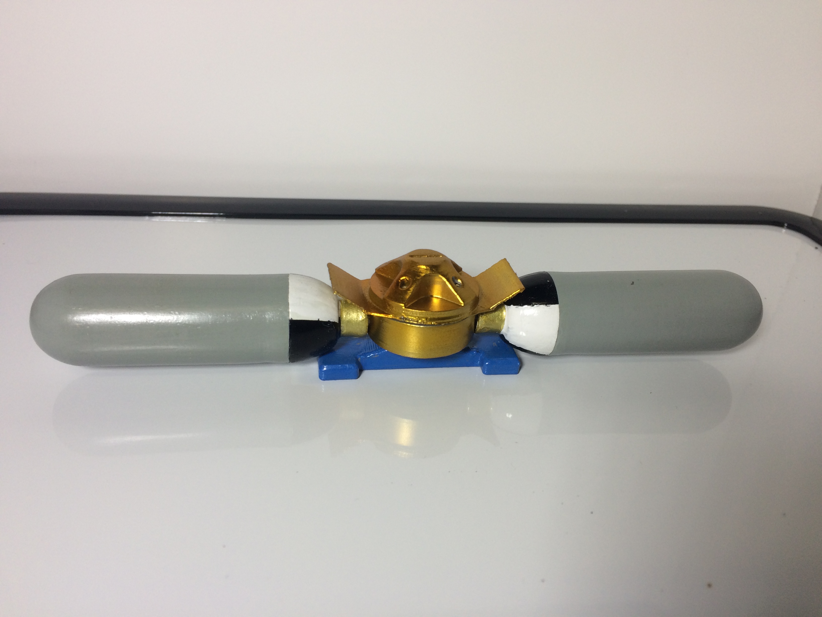

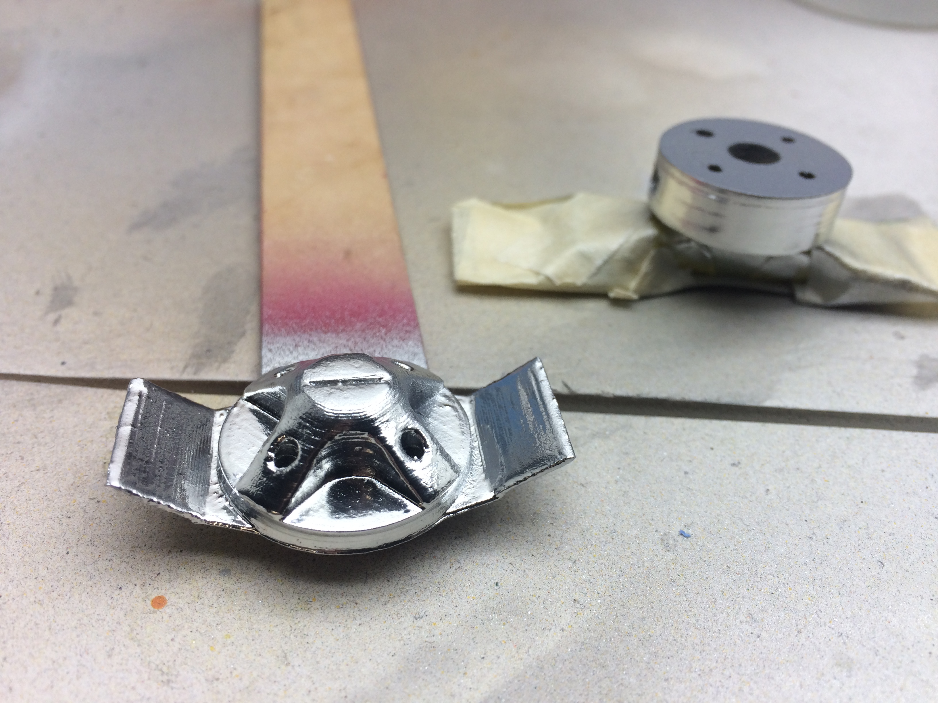

Started to put some paint on, Molotow chrome onto the valve assembly and then will spray over that with Tamiya clear orange once it dries , and the cylinders have their black/white tops
