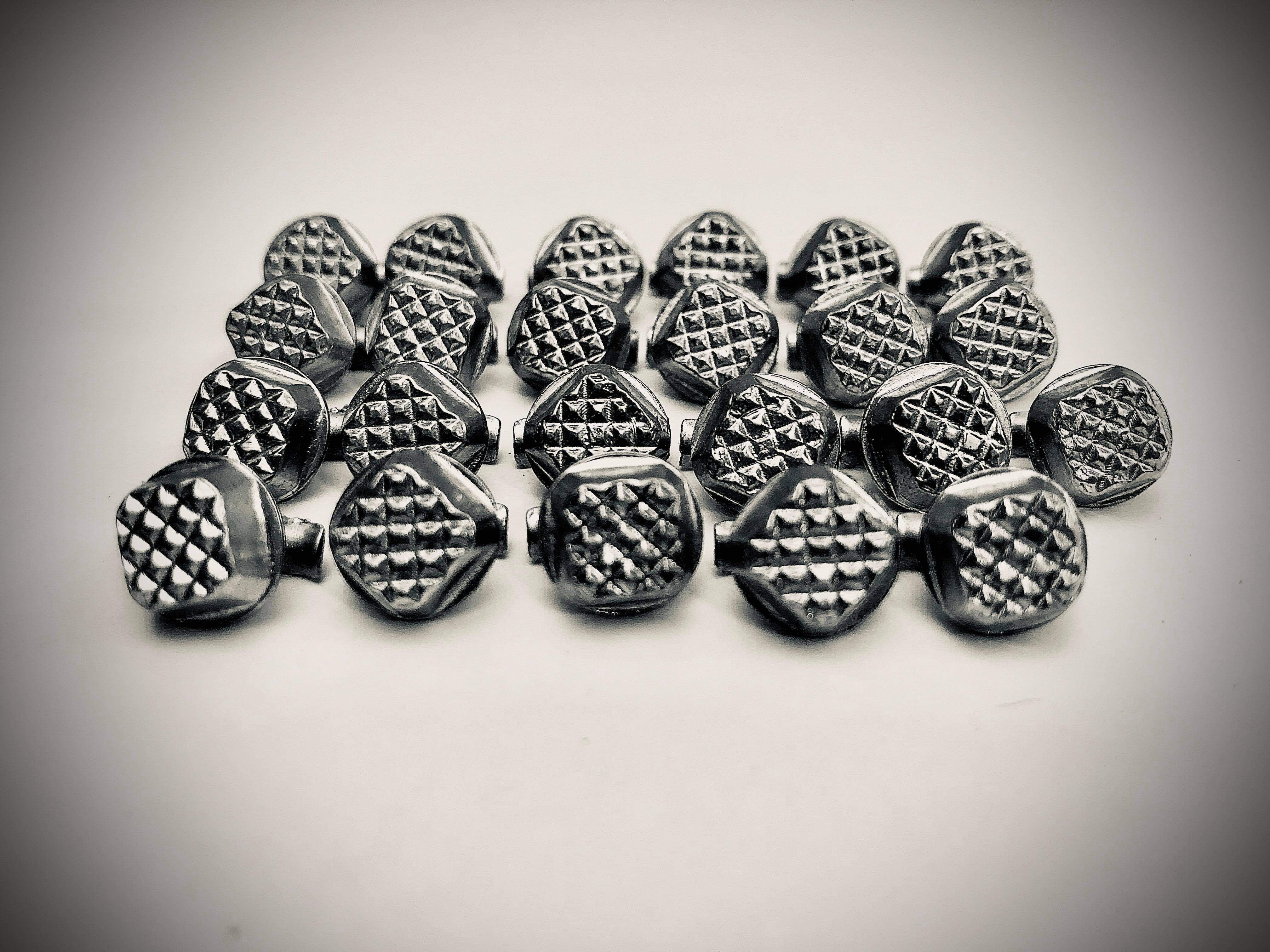

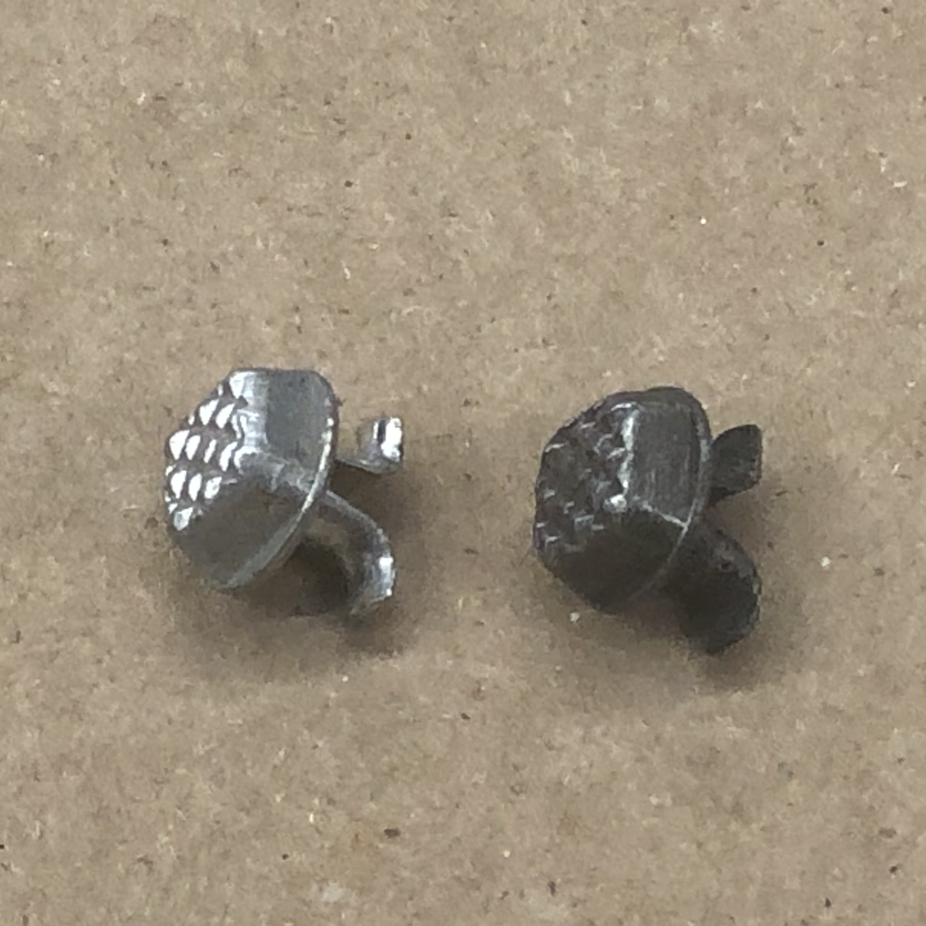

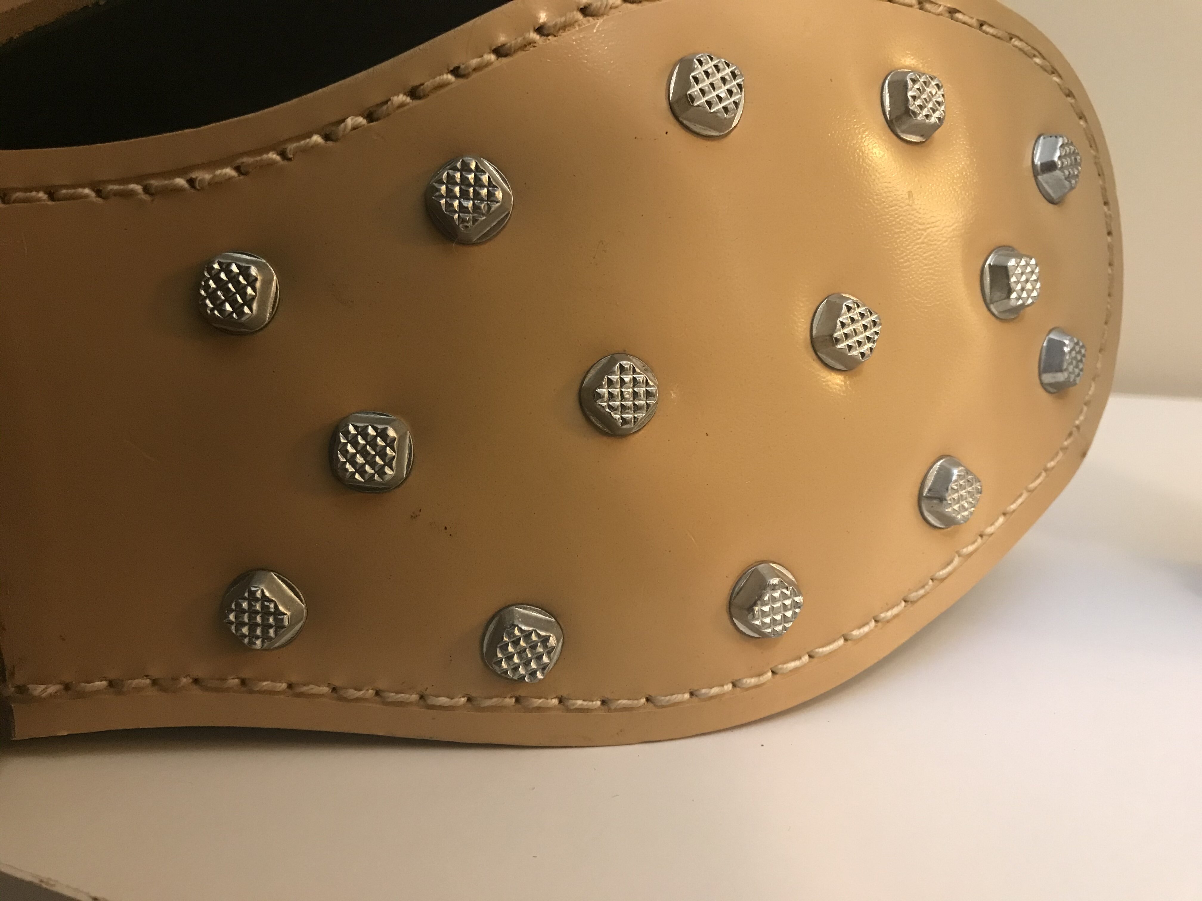

Another thing I’m trying to figure (and I’ll let everyone know how it goes) is to pull the studs and refurbish them with modern ones.

The second I am considering is to show how to burn the zinc off the stud safely and reveal the raw carbon steel underneath for darkening or otherwise
If you want to remove zinc, or basically any other plated metal from steel use muriatic acid. It can be bought at home depot as PH down, for pools. Have some in a glass container (like a mason jar) and then dip the chunk in there with some tongs or wire. It will strip the zinc without damaging the steel. You can try it on galvanized steel wire which is everywhere if you want to see how well it works. You should only have to dip it for a few seconds. After that you can boil the part in baking soda and water for a few minutes to neutralize whatever acid is left, and then wire brush to clean them up. Make sure not to do the muriatic acid inside, as its somewhat noxious and can rust metal tools if you're in a workshop. I used to keep an orange home depot bucket outside of the forge for cleaning things so that it wouldn't rust anything inside.
It's a gloves only sort of acid, but it works so well for cleaning of zinc coatings that I always have it around. Especially if you're going to be doing welding or something, a quick dip can save you all of the zinc poisoning. Hope that helps!
Thanks for that, I’ll have to try it!
Most of the zinc related work I’ve done has been related to architectural ironwork, so usually the workpieces are too big to be able to dip as such.
As such, a butane or mapgas torch works well too for me. Get the steel red hot then wire brush and keep the head out of the fumes.

It seems like these bright ones can be super blued without removing the coating? Wasn’t aware zinc could be blued!
before and after bluing
