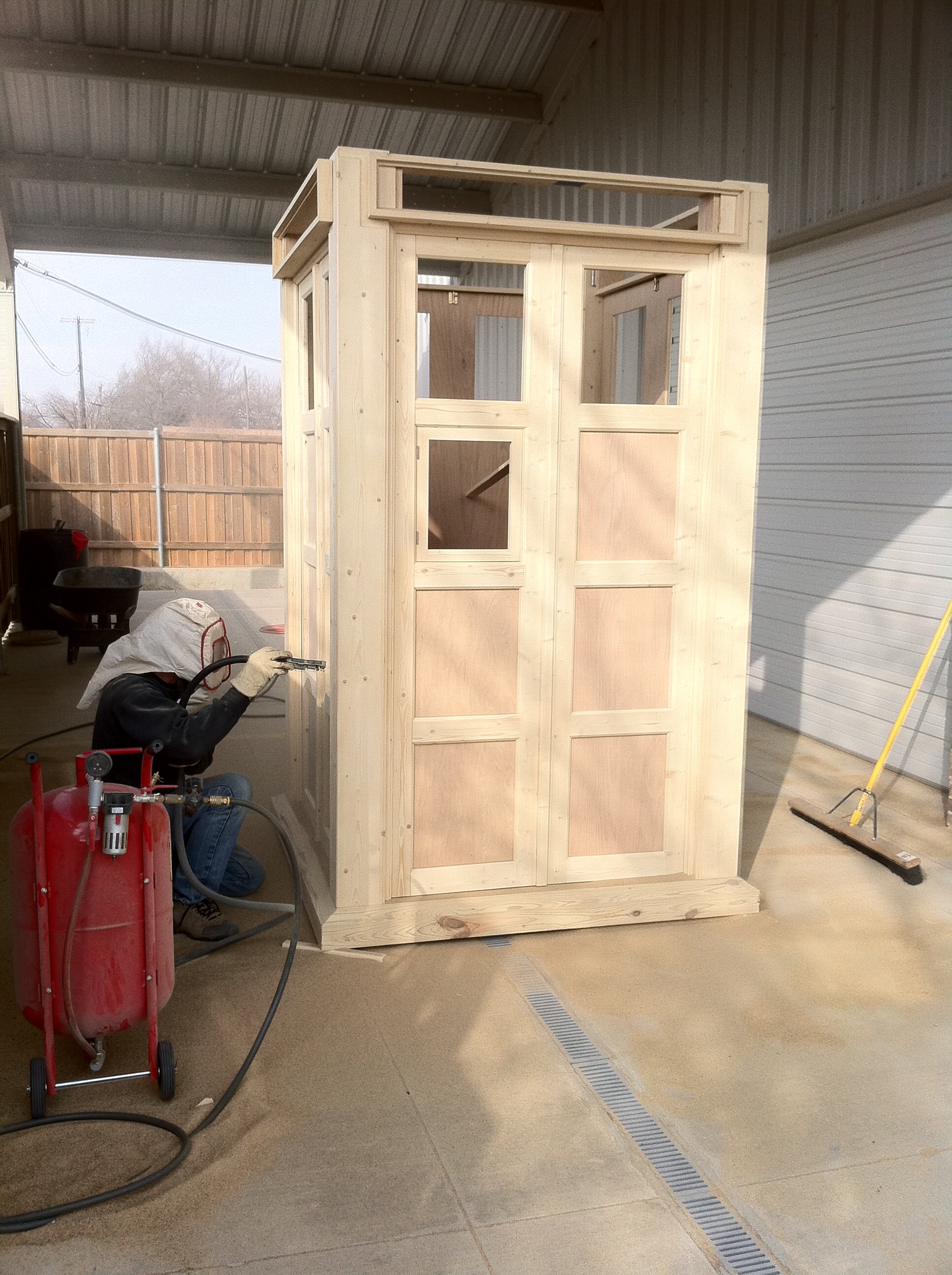

I'm happy to say that I tested sandblasting today with an outdoor rig and it worked great. If all goes well, I'll be disassembling the entire tardis tomorrow, setting it up outside, and blasting all of the outside wood.

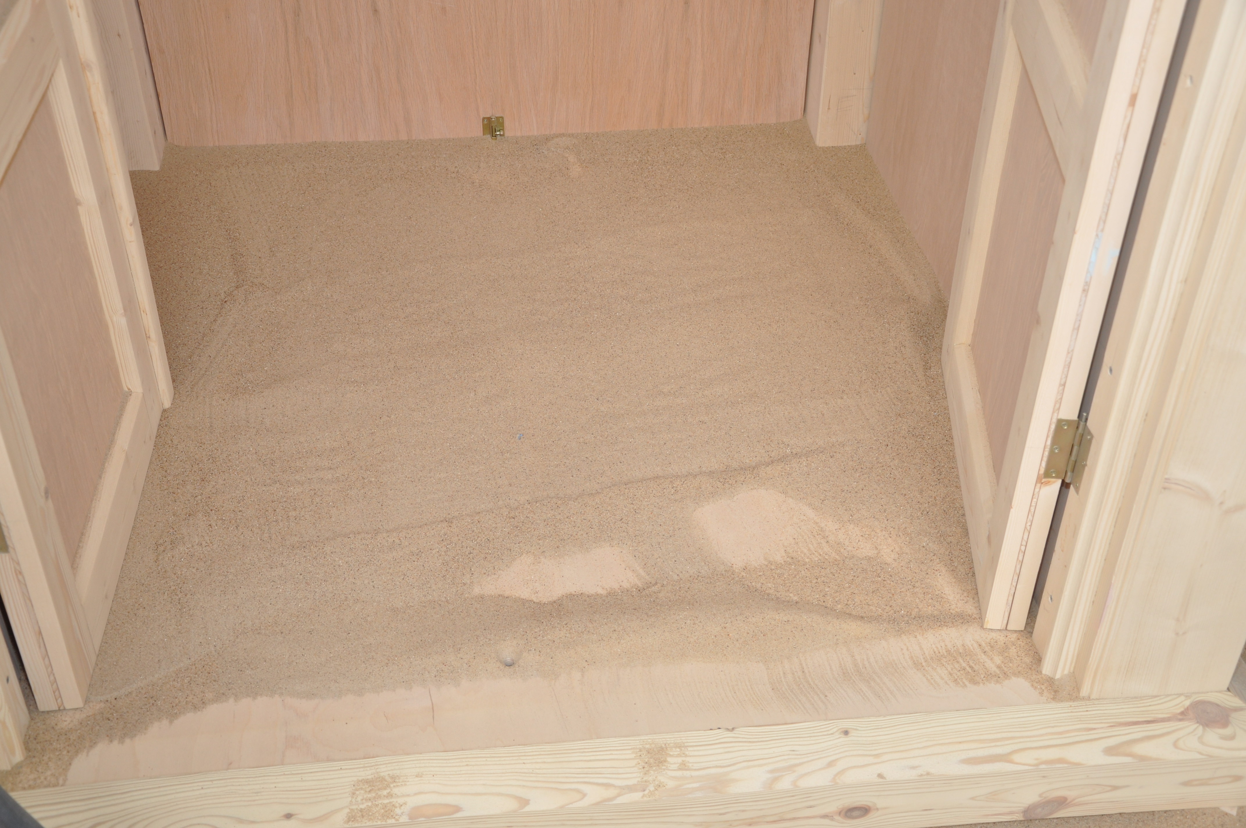

Sandblasting did happen today. It was more work than I had expected. Even with two of us we were busy all day, and still didn't get to the top.
The effect is good and it achieves the weathered look very nicely.
A lot of time is spent sweeping up the sand, sifting it, charging the tank and then the actual blasting. We both wore respirators, which gets annoying as well, but necessary.
We had several spots in the wood where the color was dark brown and when we hit it with the sand it blew out some very soft wood and left a hollow crevice, which had to be filled with bondo.
re: My New Series Dr Who Tardis Build (image heavy)
Yes. As opposed to burning and burnishing with a brush like you can see in photos in an earlier post. Quite effective.

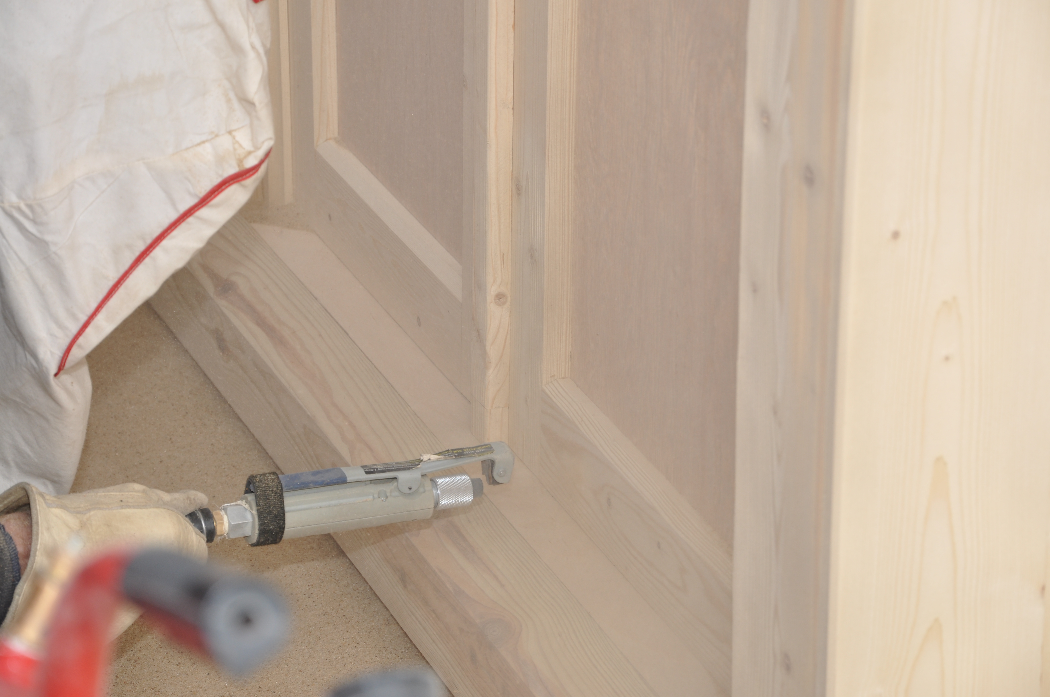

A couple more photos of the sandblasting process.
We only blasted the exterior of the Tardis. When I paint it, I think I'll only paint the weathered part blue, and the rest black.

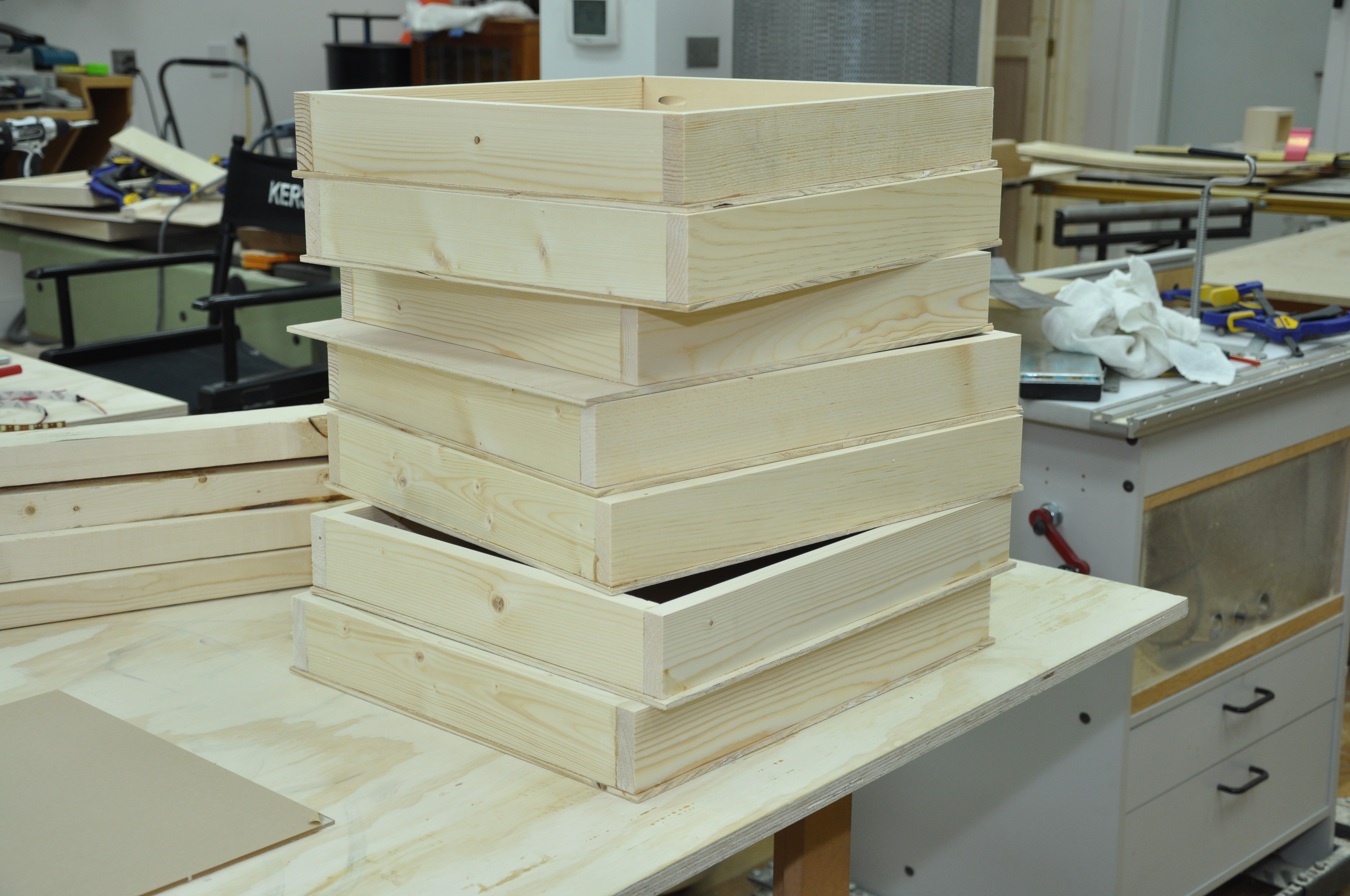

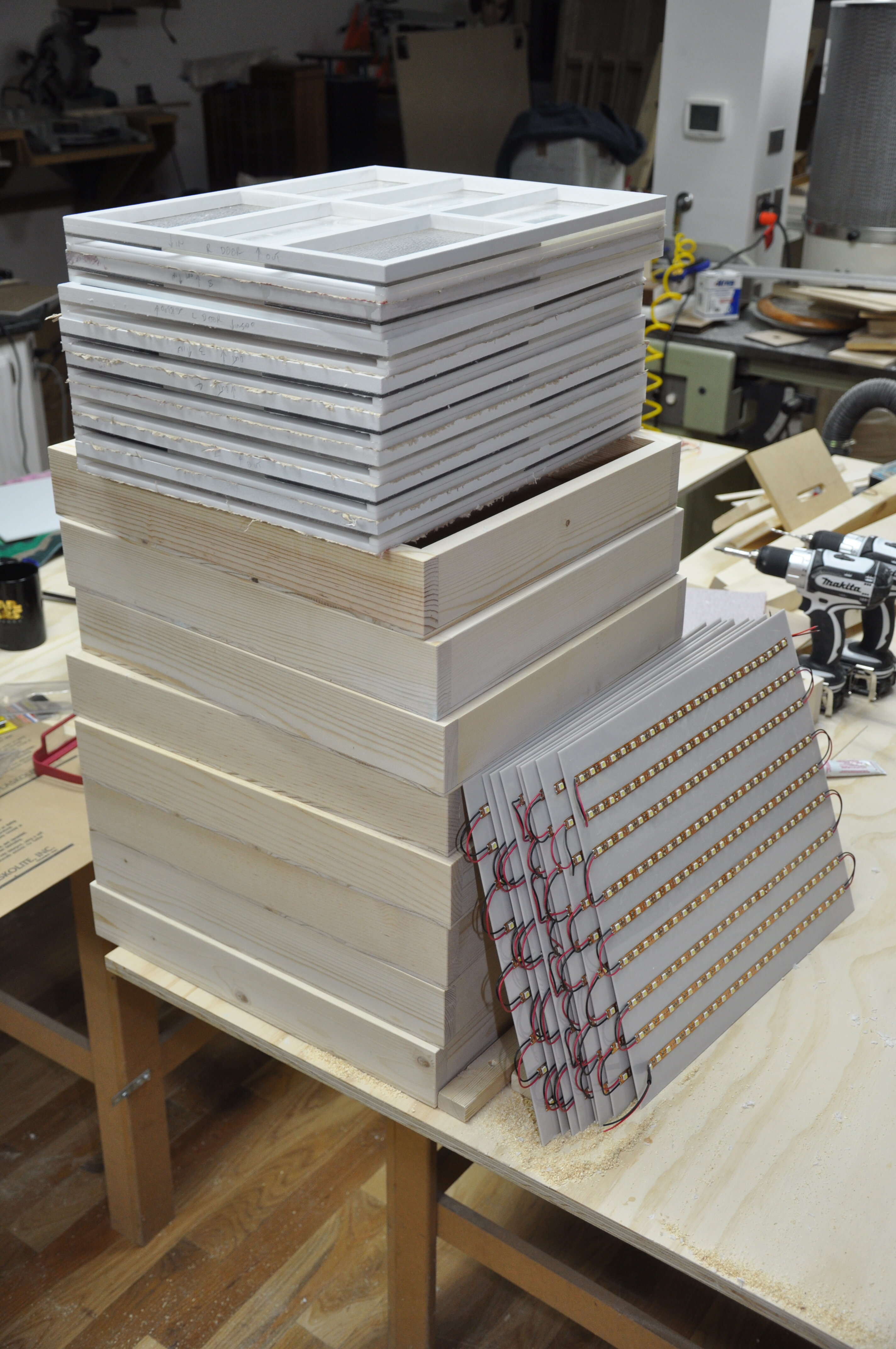

It looks like just a stack of stuff, and it is, but it's a pile of work for the windows. 8 each of the backlight boxes, window laminations and the LED lighting panels. The windows go in after the painting is done, and the light boxes still need to have cuts made to allow the inserts room to go in and then each needs to be mounted to the walls and doors with some speaker grill connectors I've sourced.
