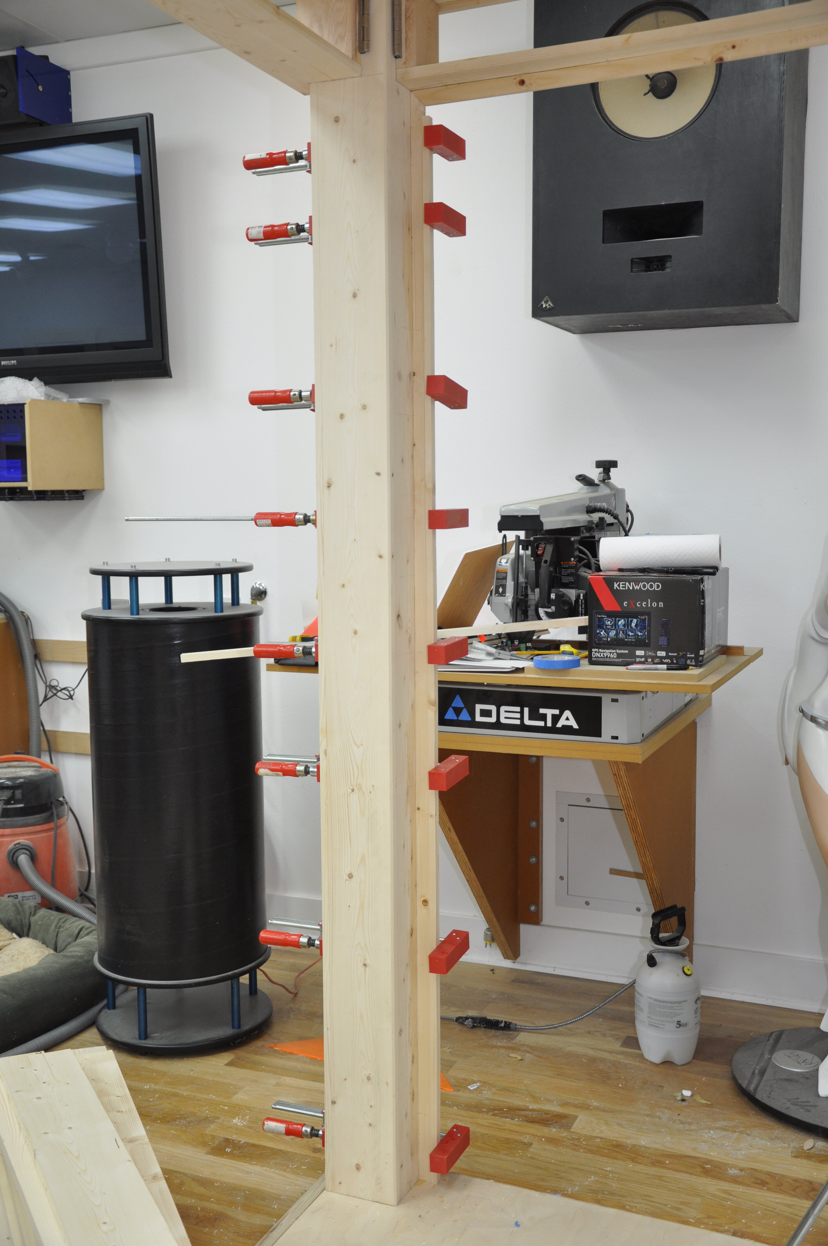

Since wood moves primarily across the grain there's not very much opportunity to see it moving any place that it would harm the build especially as the panels and doors are attached to plywood and well locked down.
The only area I have concern is the base because of the large miters on the corners so I'll see how that goes. I'd rather have done butt joints there but passed on it due to the hand work for it if I had done so. I may regret it and if so I'll make a new one.

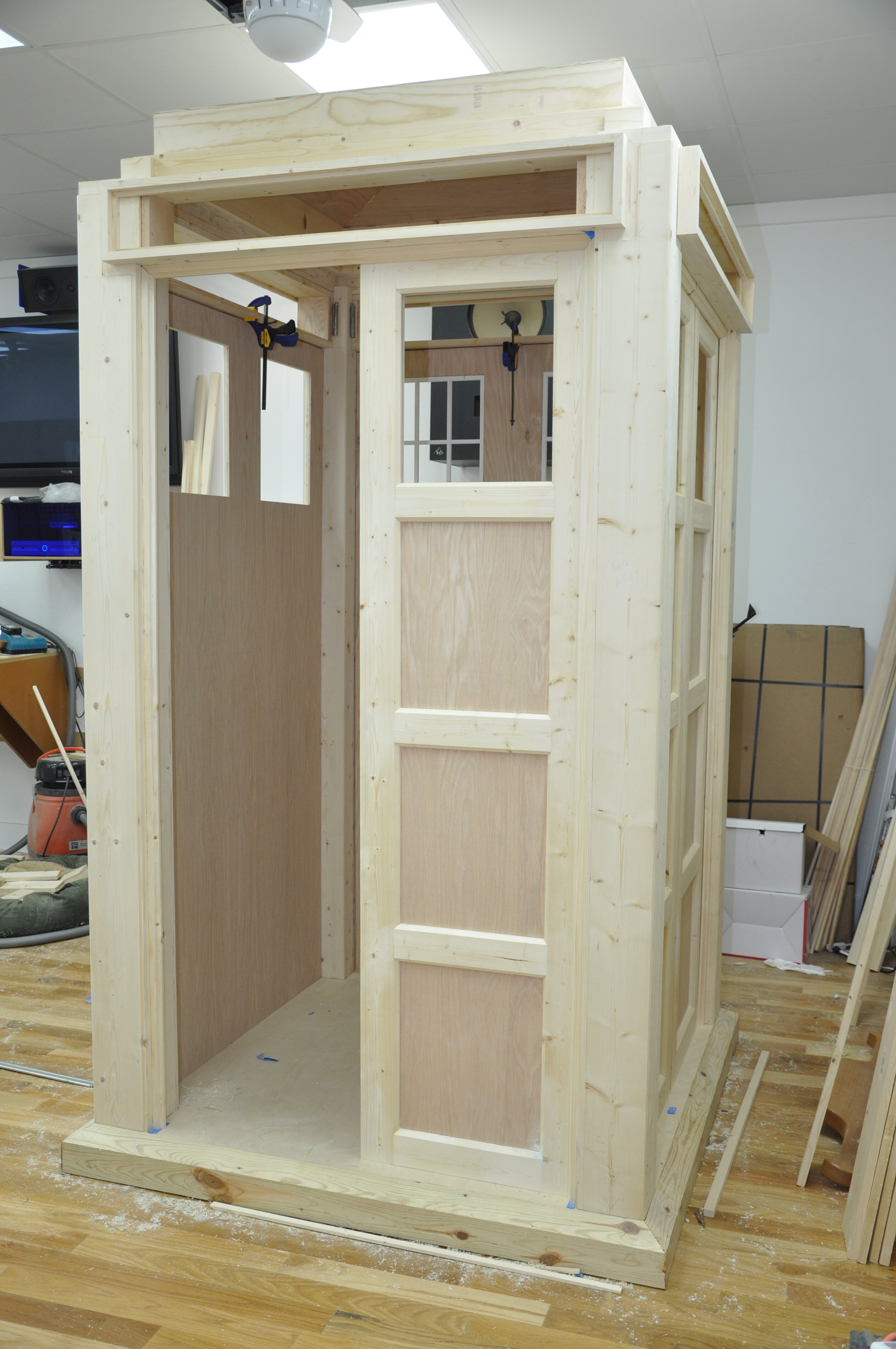

Work has been continuing but the walls and doors have gone pretty slow. It'd kind of like the doldrums of the build.

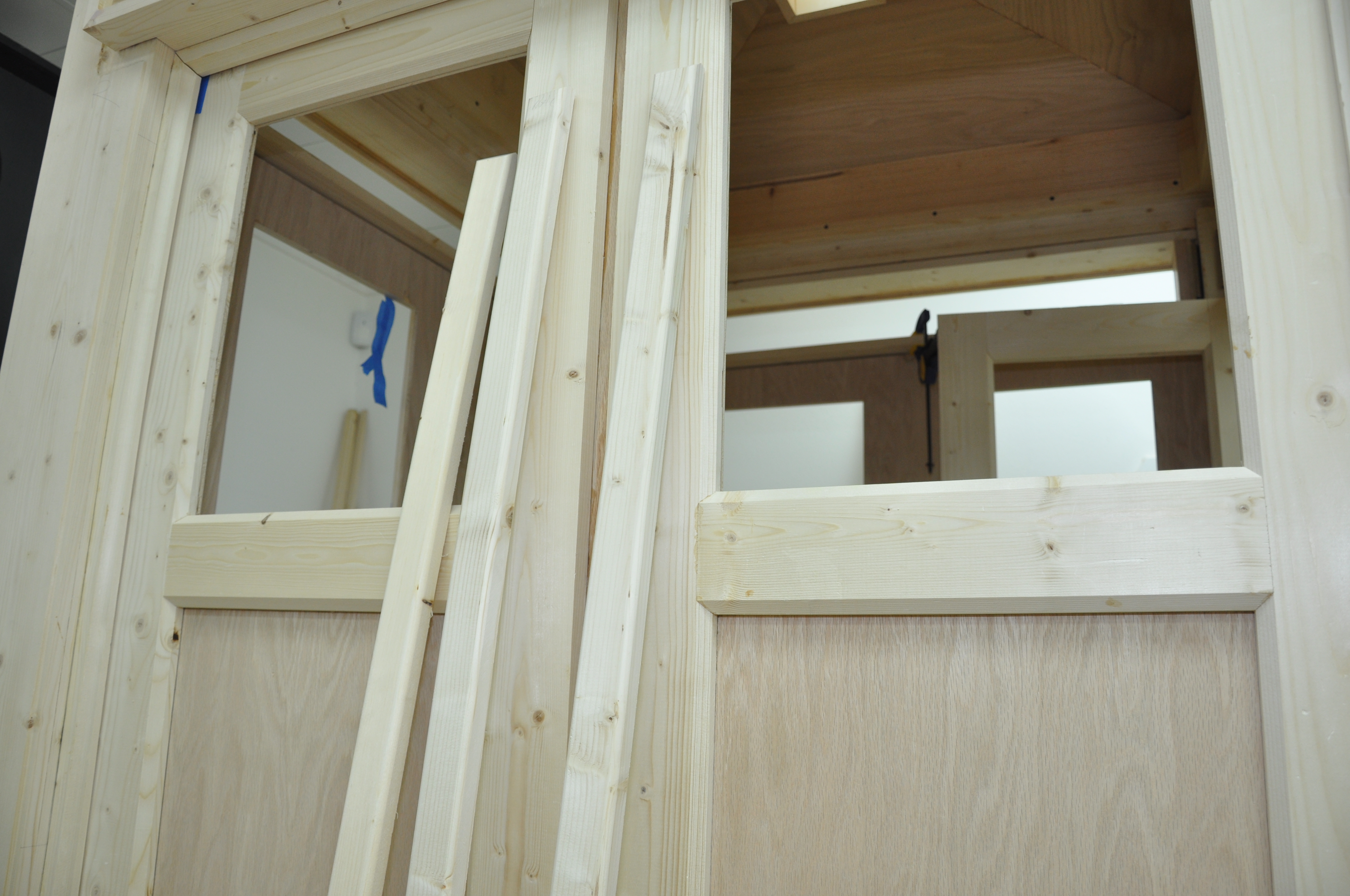

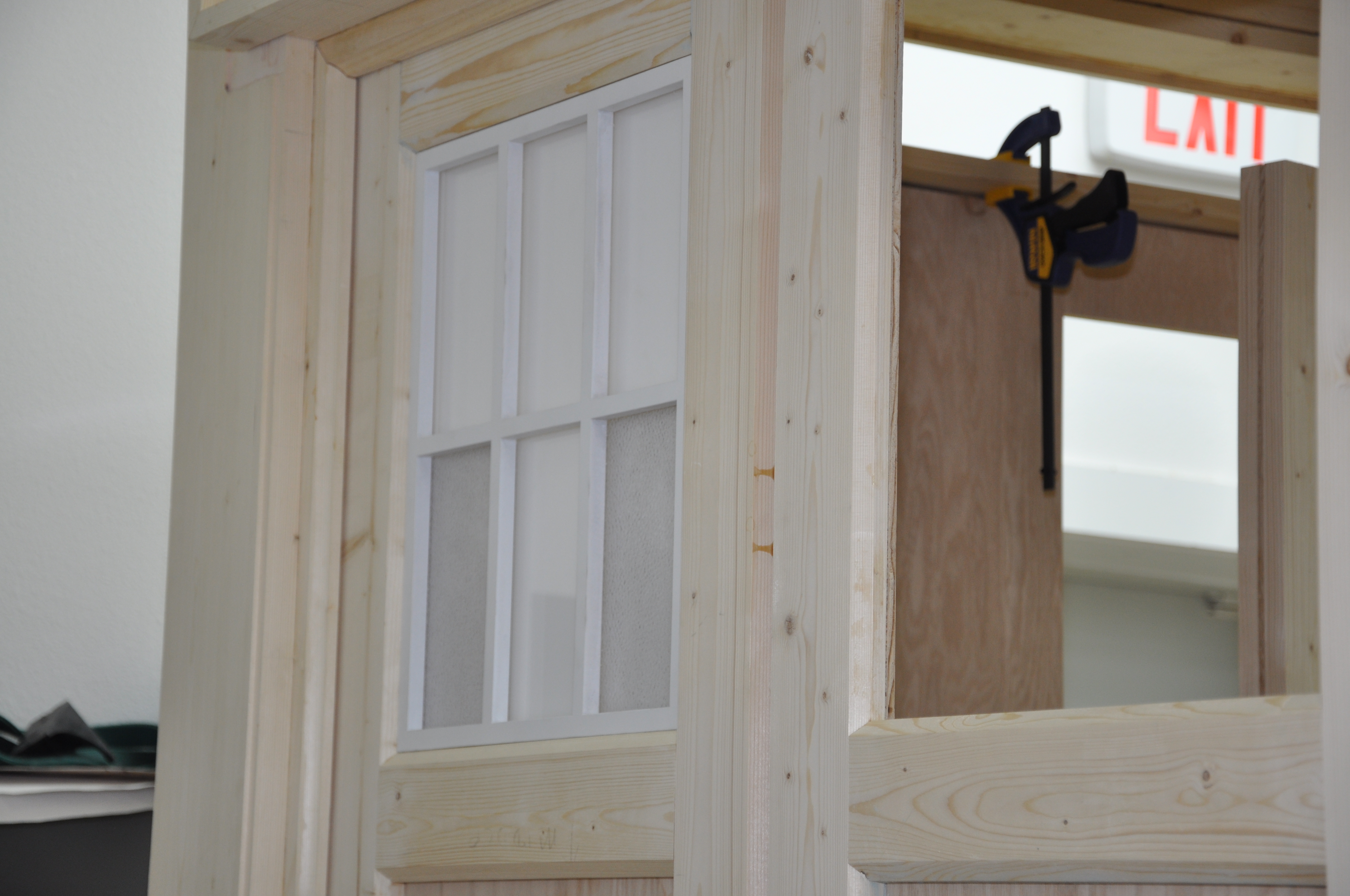

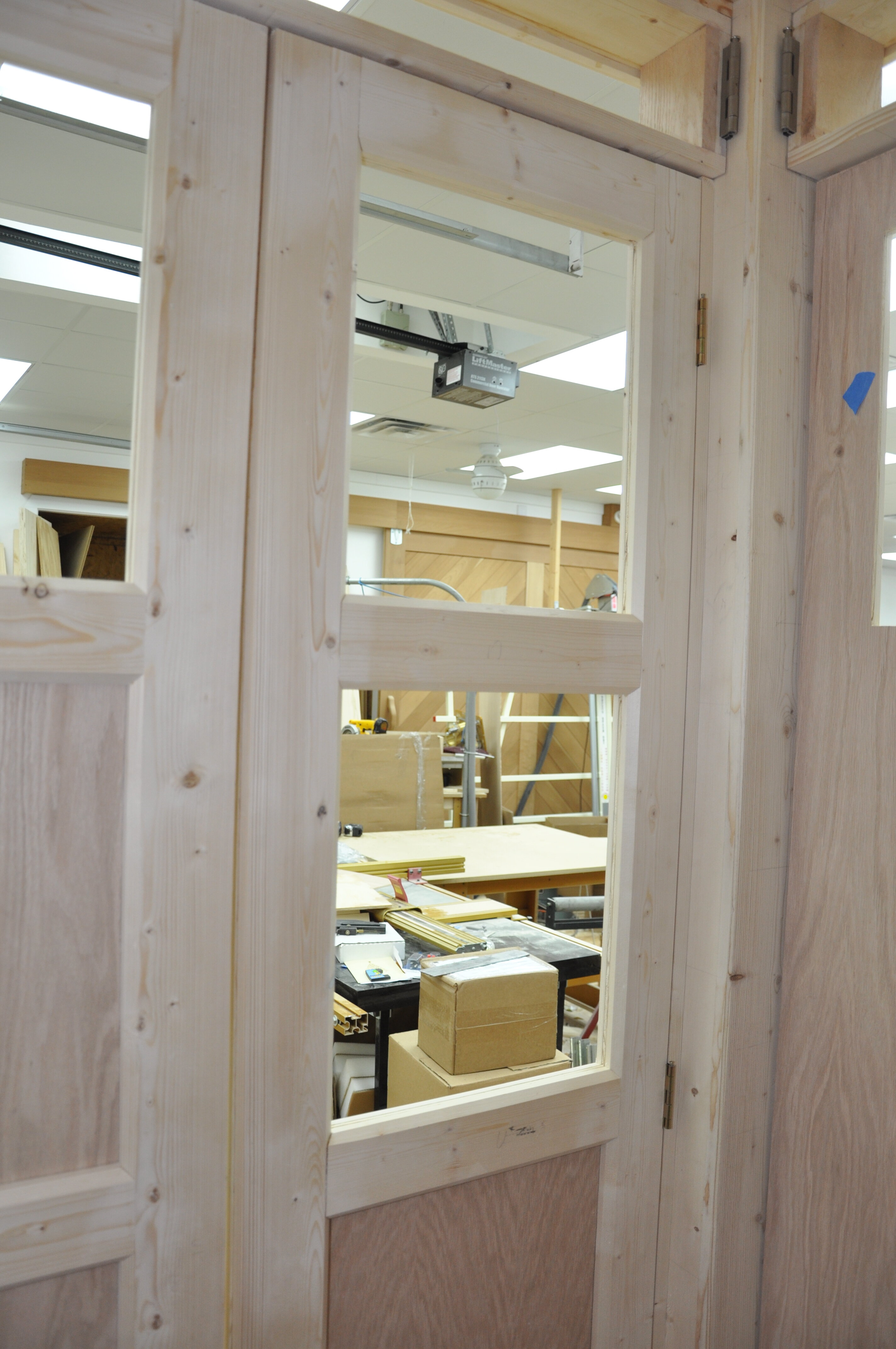

The three walls and both doors are built now. Some details on them follow below.
The walls are just clipped into place, and the door is just standing there as well. I haven't yet sorted out how I will fix the walls in place. I'm considering some sort of sliding bolts but I'm trying to avoid spending much money on them since there will be 6-8 per wall. The doors will have three hinges each, which will be pretty easy as the board they hinge to can be on the bench with the door for locating and mortising.
This is one of the door panels showing the spacer I used to exactly locate the window. Unlike on the walls, the doors have the raised panels both outside and inside, which means the inside panels have to exactly match the outside ones when there is a window. On the panels below they could misalign and you'd get away with it. Using the spacer I was able to ensure they would align without measuring and marking. On the left door there's is a second opening for the phone door, so there is another spacer board for it.

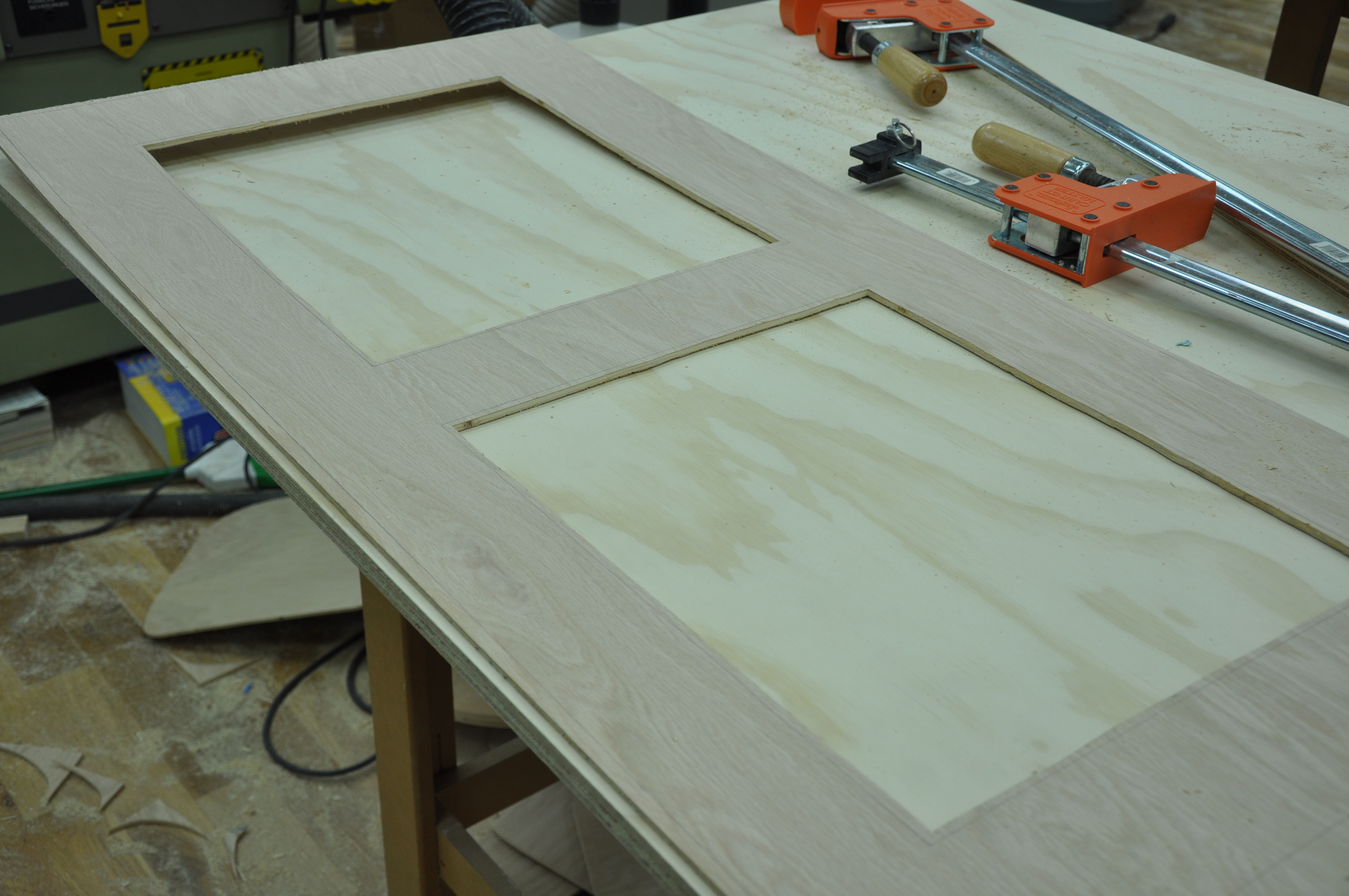

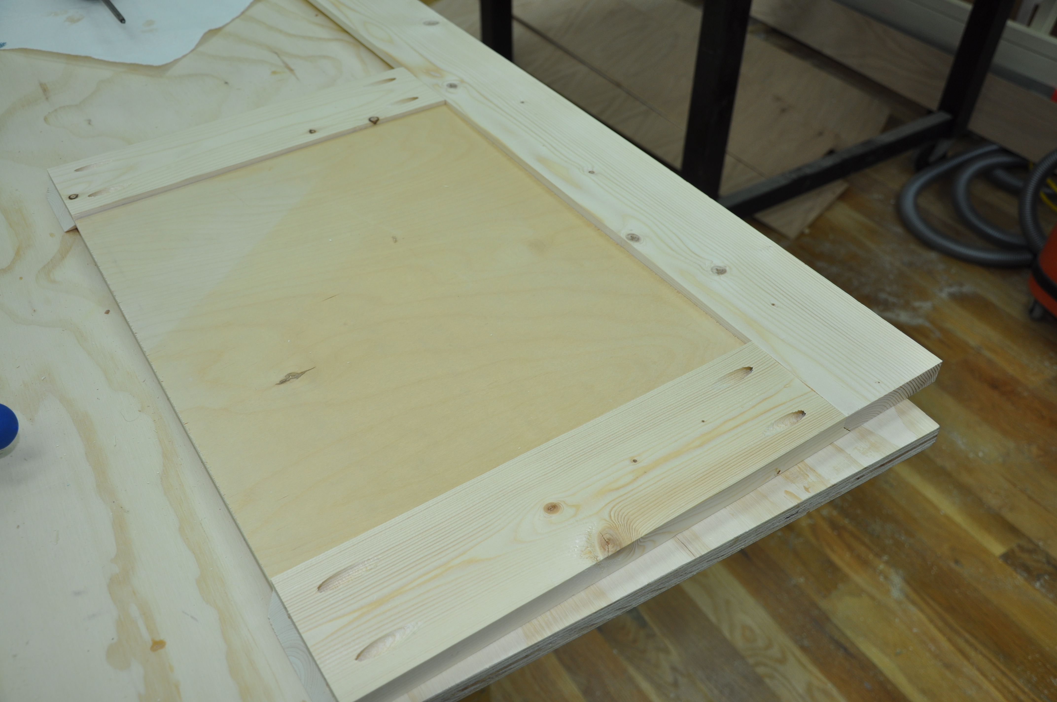

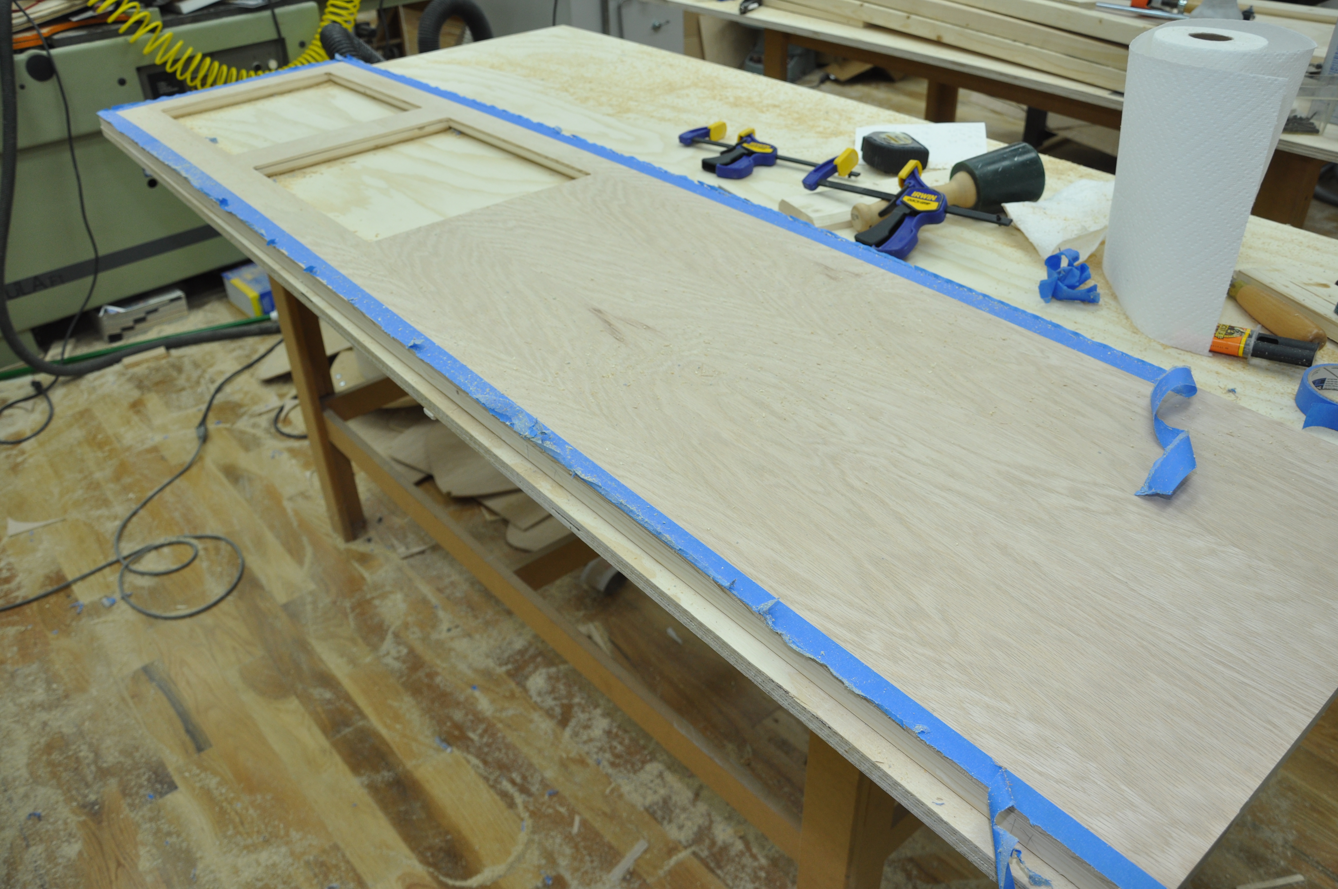

Here's the plywood for the left door with its two openings cut out.

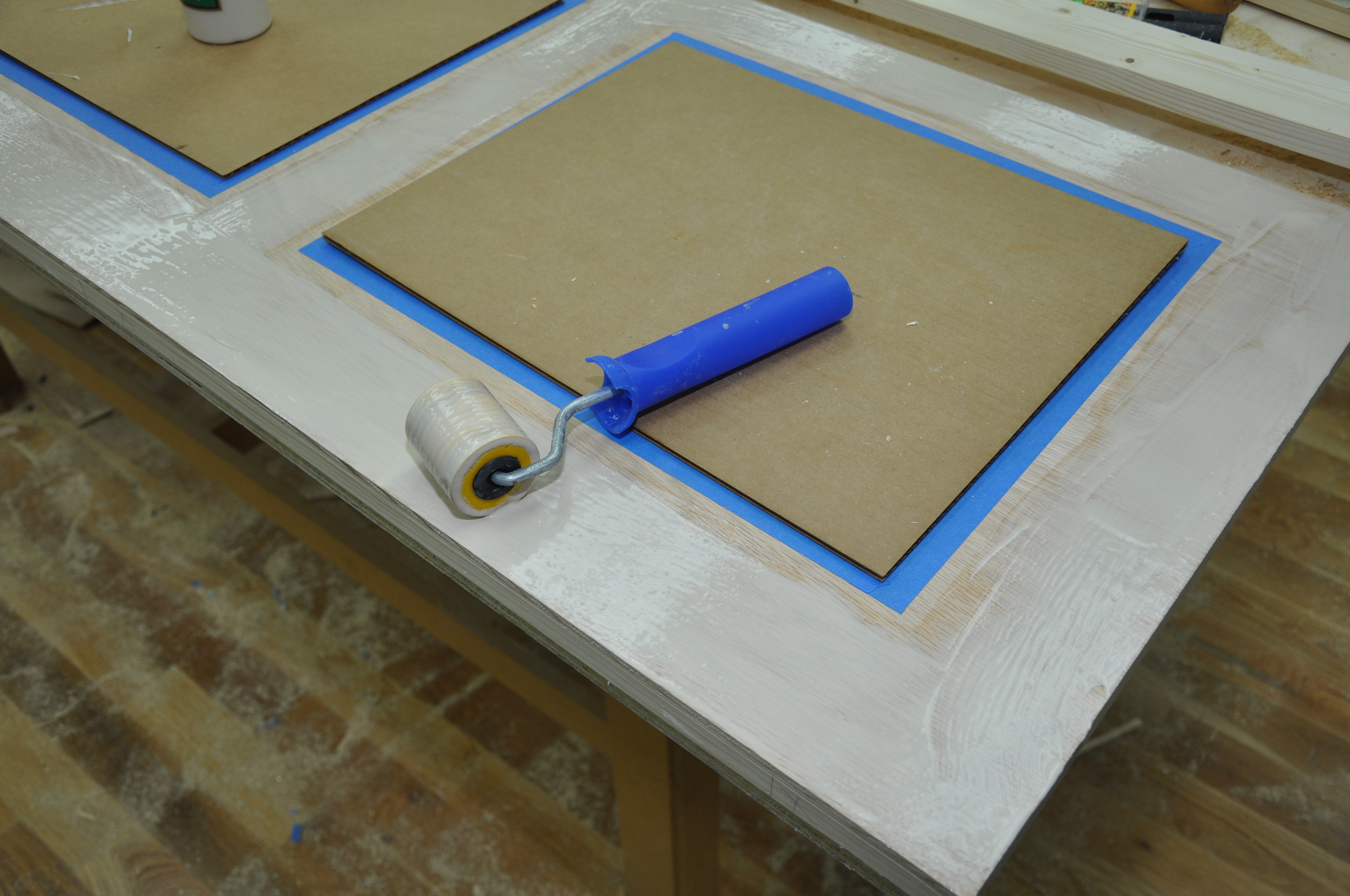

This is how I roll the Titebond III glue on. Pour it out, roll it around. The painter's tape protects the edge of the panel and the cardboard protects against drips, which I found on the first panel was necessary when I missed a drip and had to remove it later.

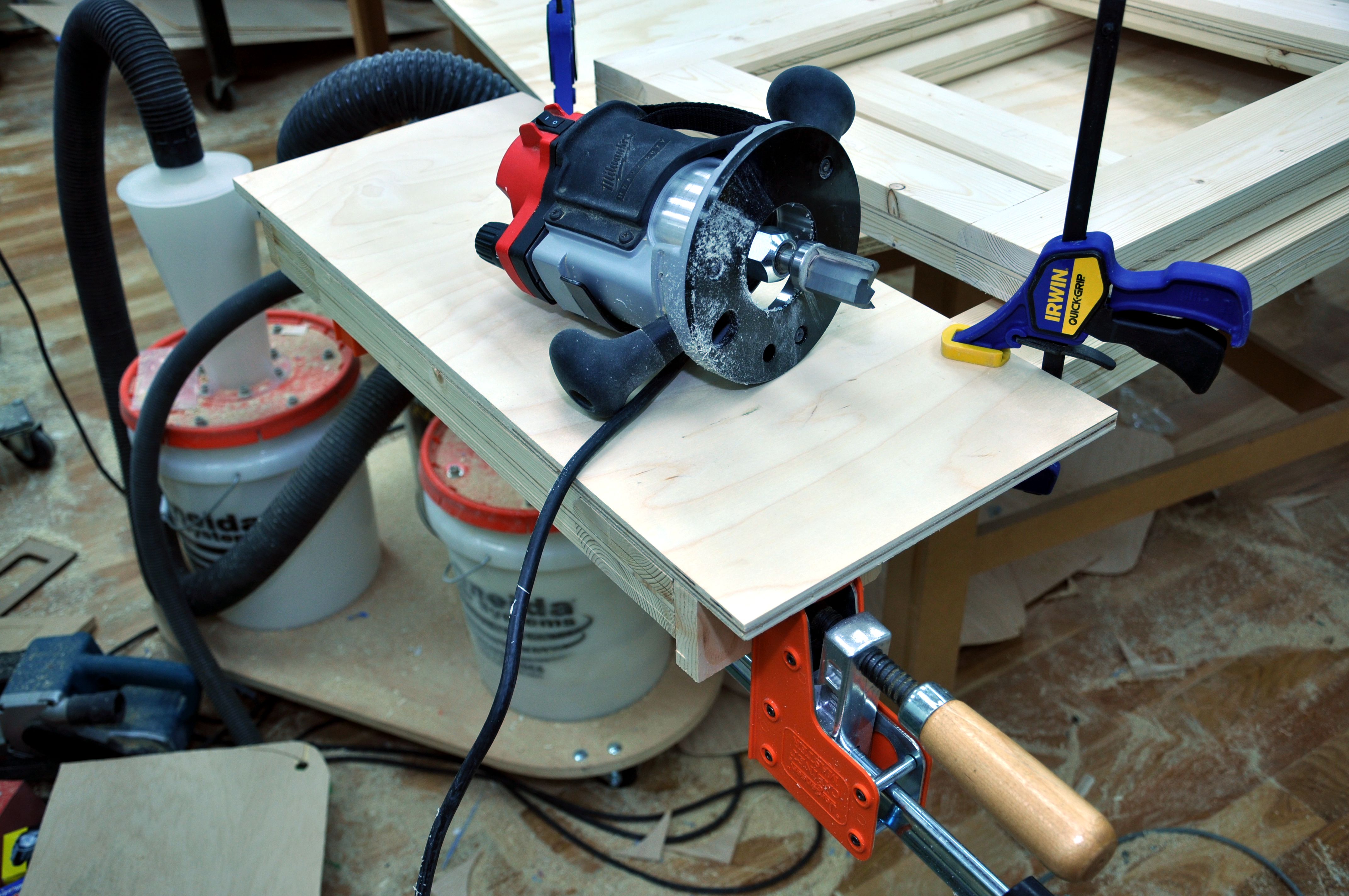

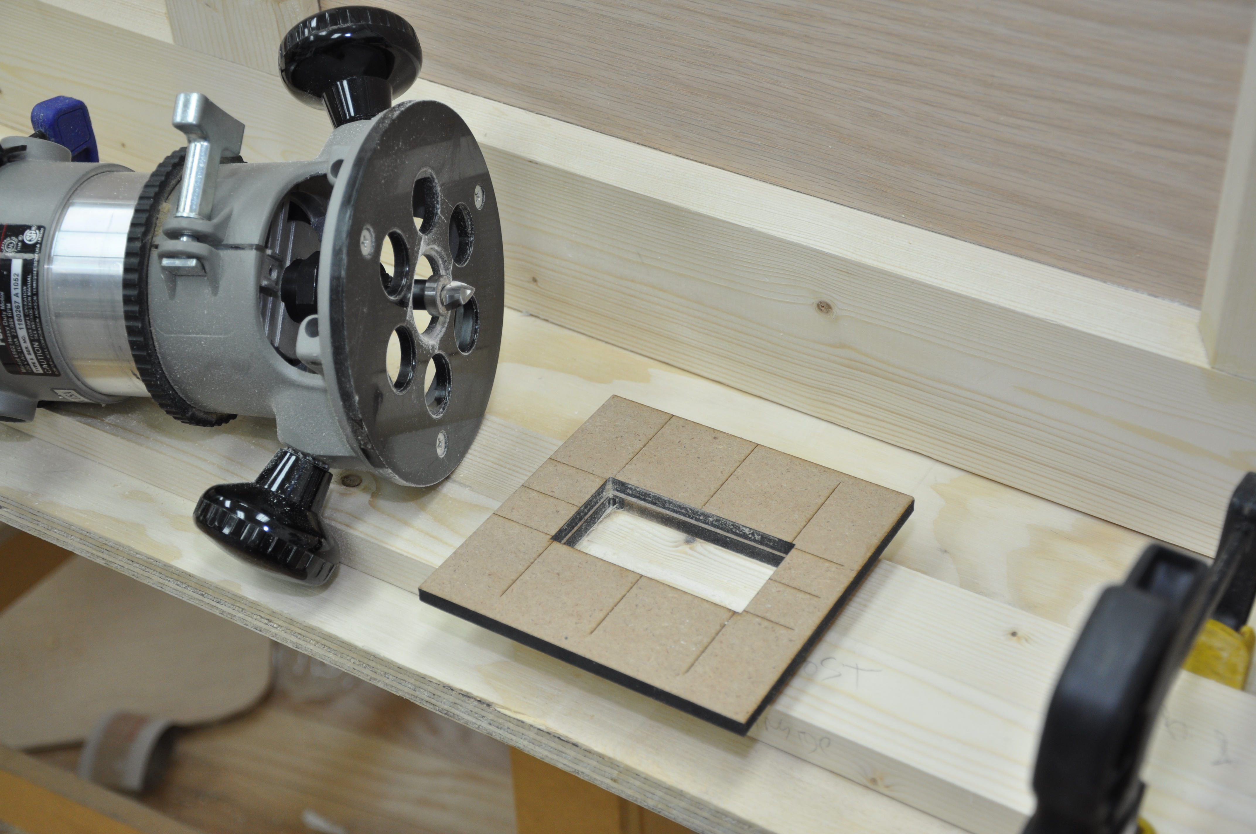

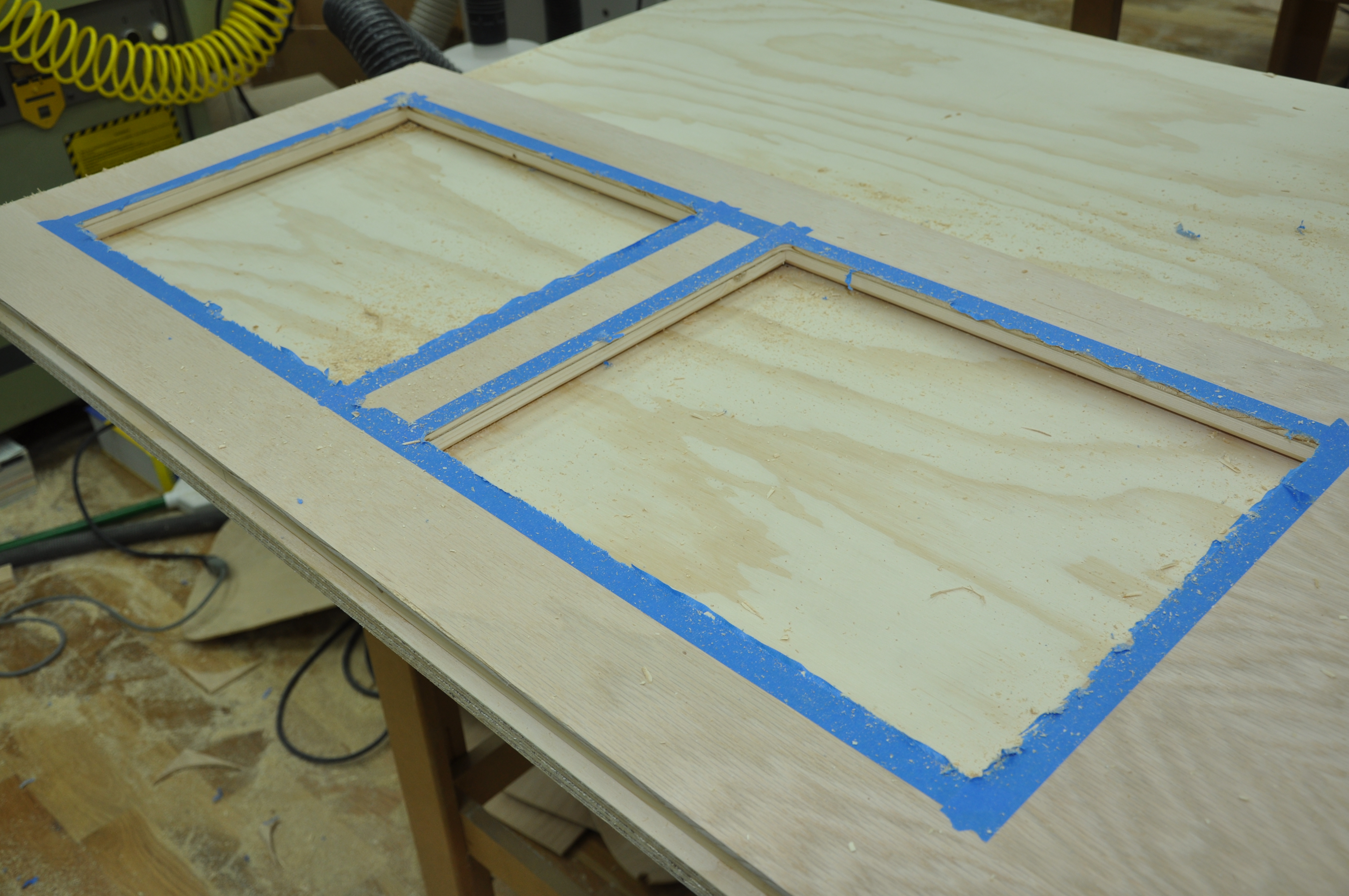

This is after using the router with its bearing guided flush cutter to cut the window openings in the plywood flush with the raised boards. I first tape it with painters tape the edges to prevent splintering, which will happen if you don't use the tape.
On the doors, I cut the plywood oversize to make it possible to use the same bearing guided cutter to trim the outside edge of the plywood flush to the raised boards. The tape is used again to prevent splintering.

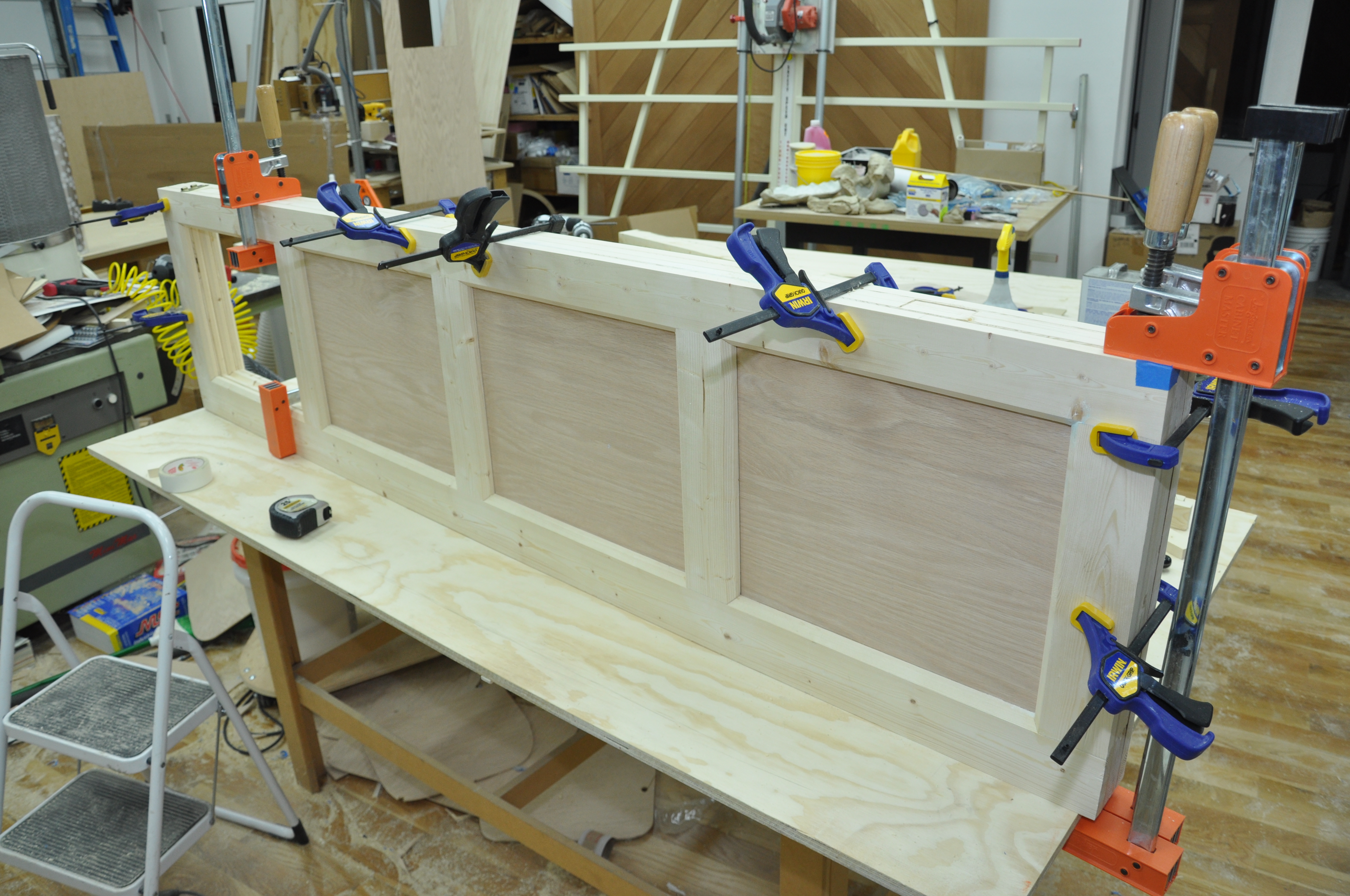

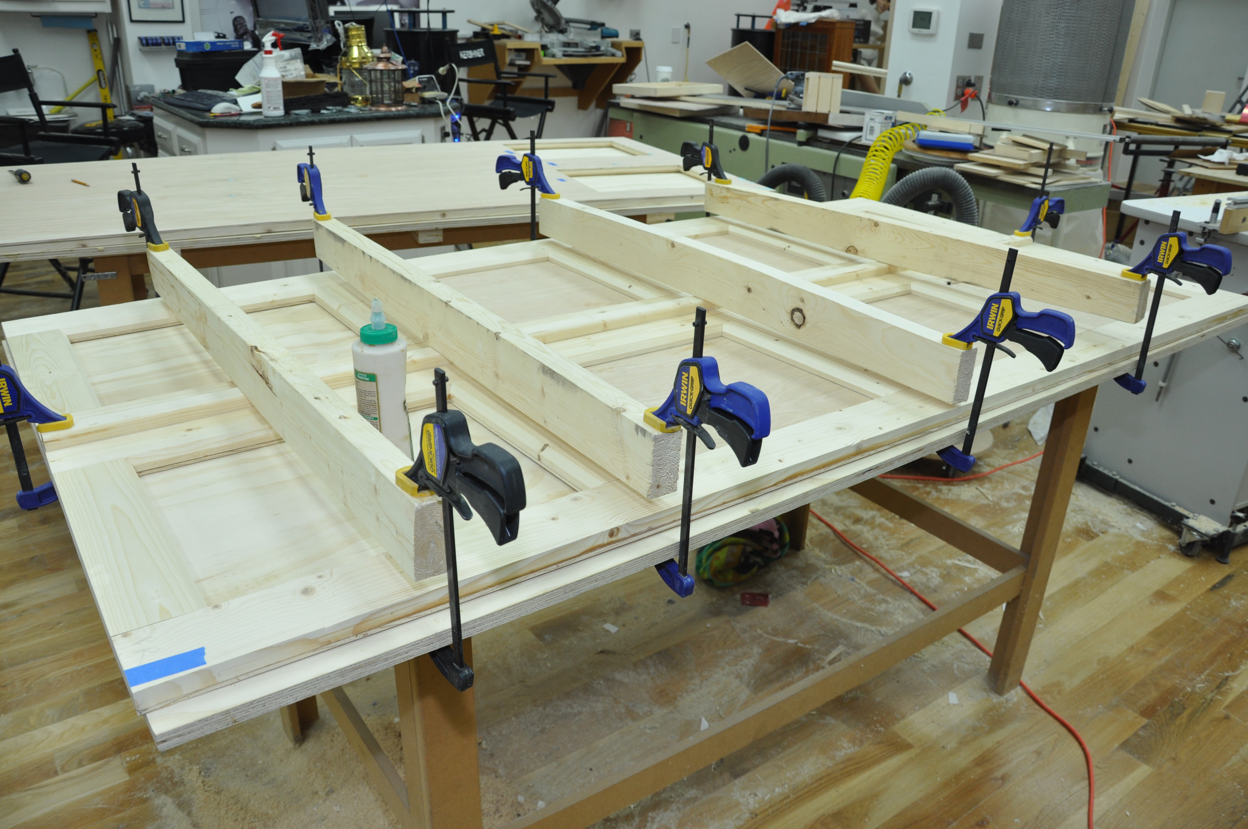

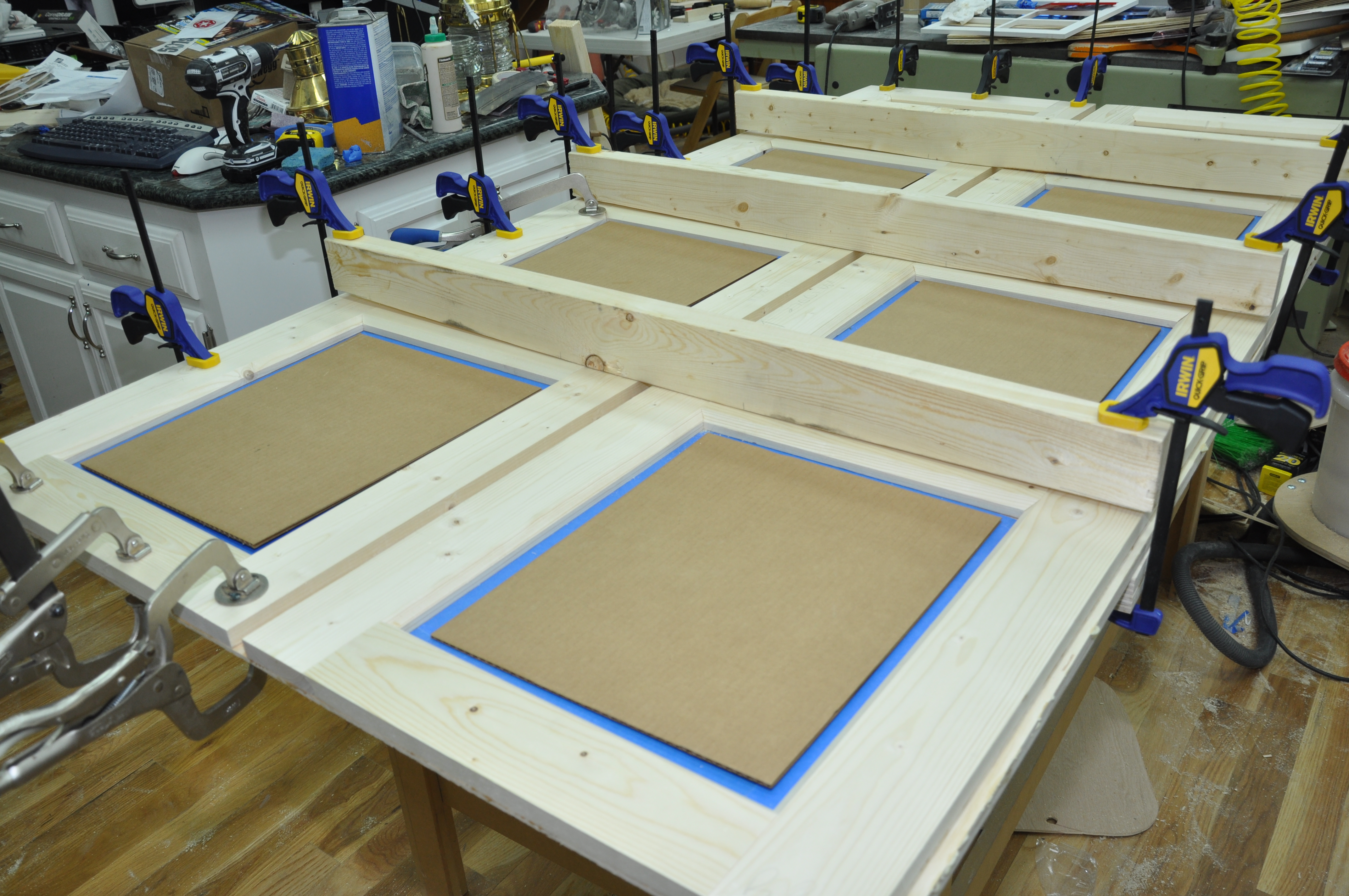

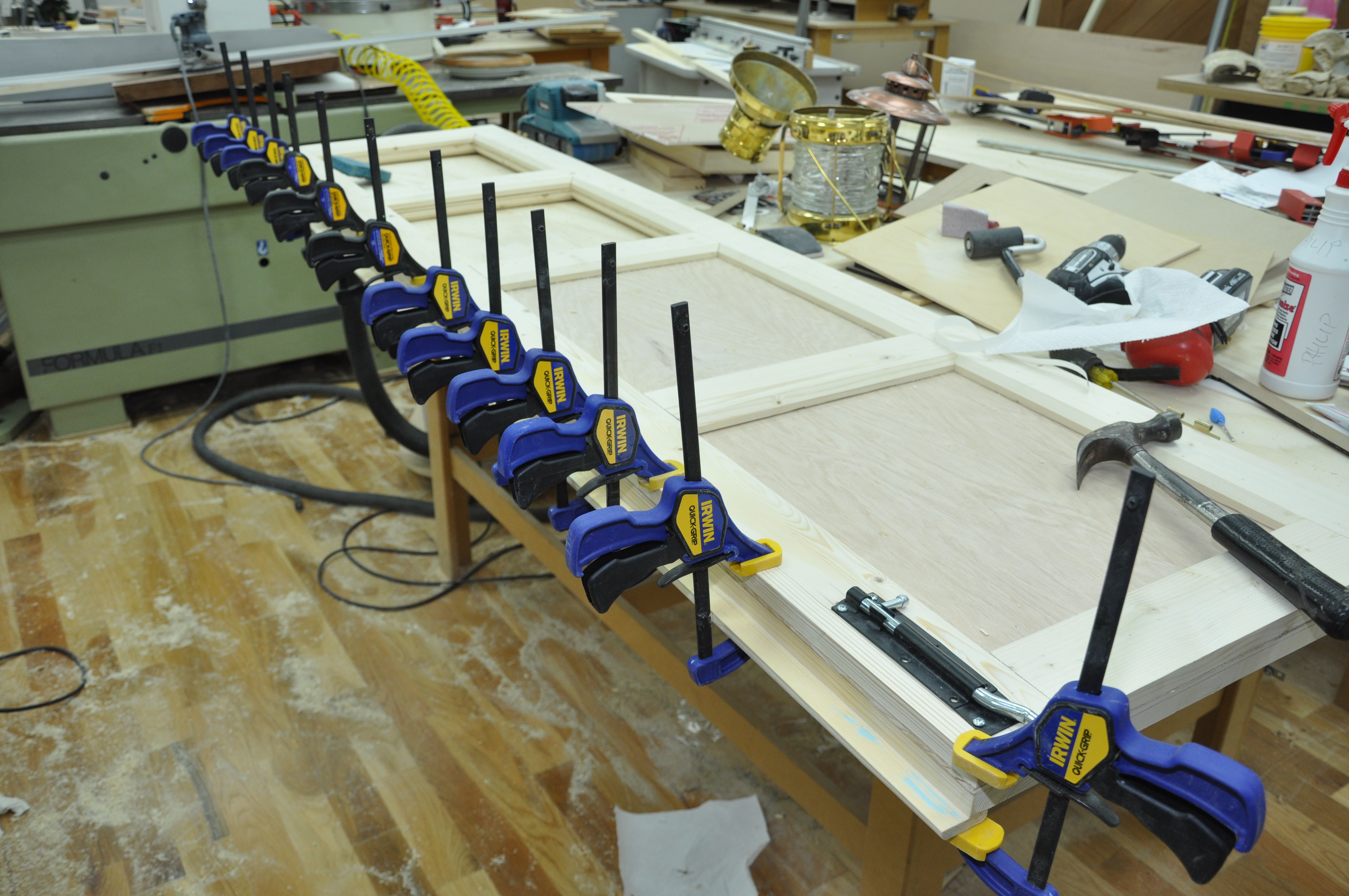

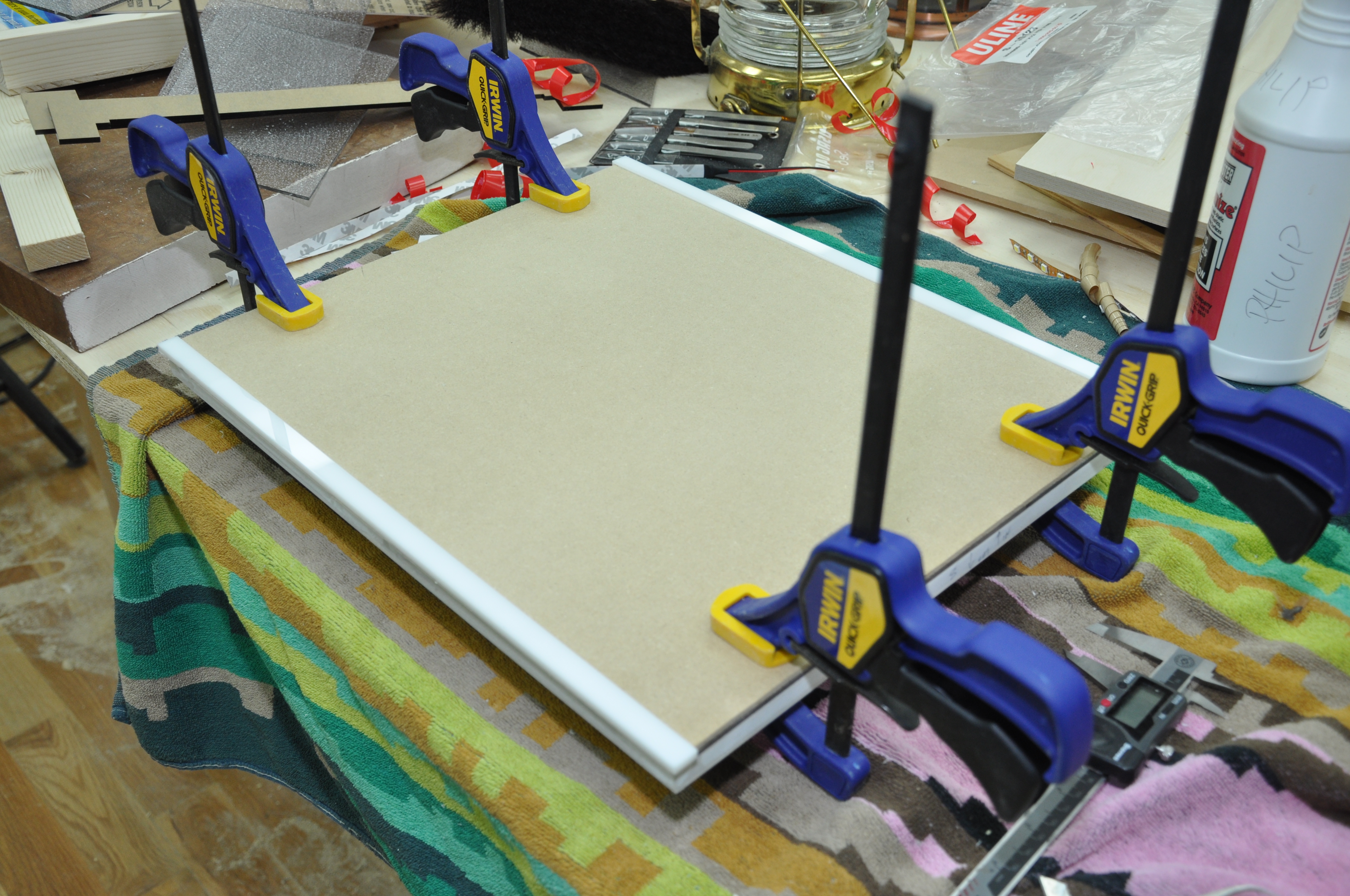

Backtracking a bit here. I realized I hadn't shown the clamping setup for attaching the raised panels to the plywood. After my first panel where I discovered they required clamping in the middle, I ended up making clamping cauls to apply the necessary pressure in the middle. You can see three of them made from 2x4s in the photo below. They are simple to make, just slicing a wedge from each end of the board, leaving the middle full width on the board. With a clamp on each end, the pressure is applied only in the middle. It can be very powerful pressure, so much that I had to further strengthen the table top I had on my benches below to prevent them from bowing.
This shows gluing down the second half of the raised panel, I did them one at a time because it would take too long to do both at once considering glue open time, even if I had enough clamps to do both at the same time.

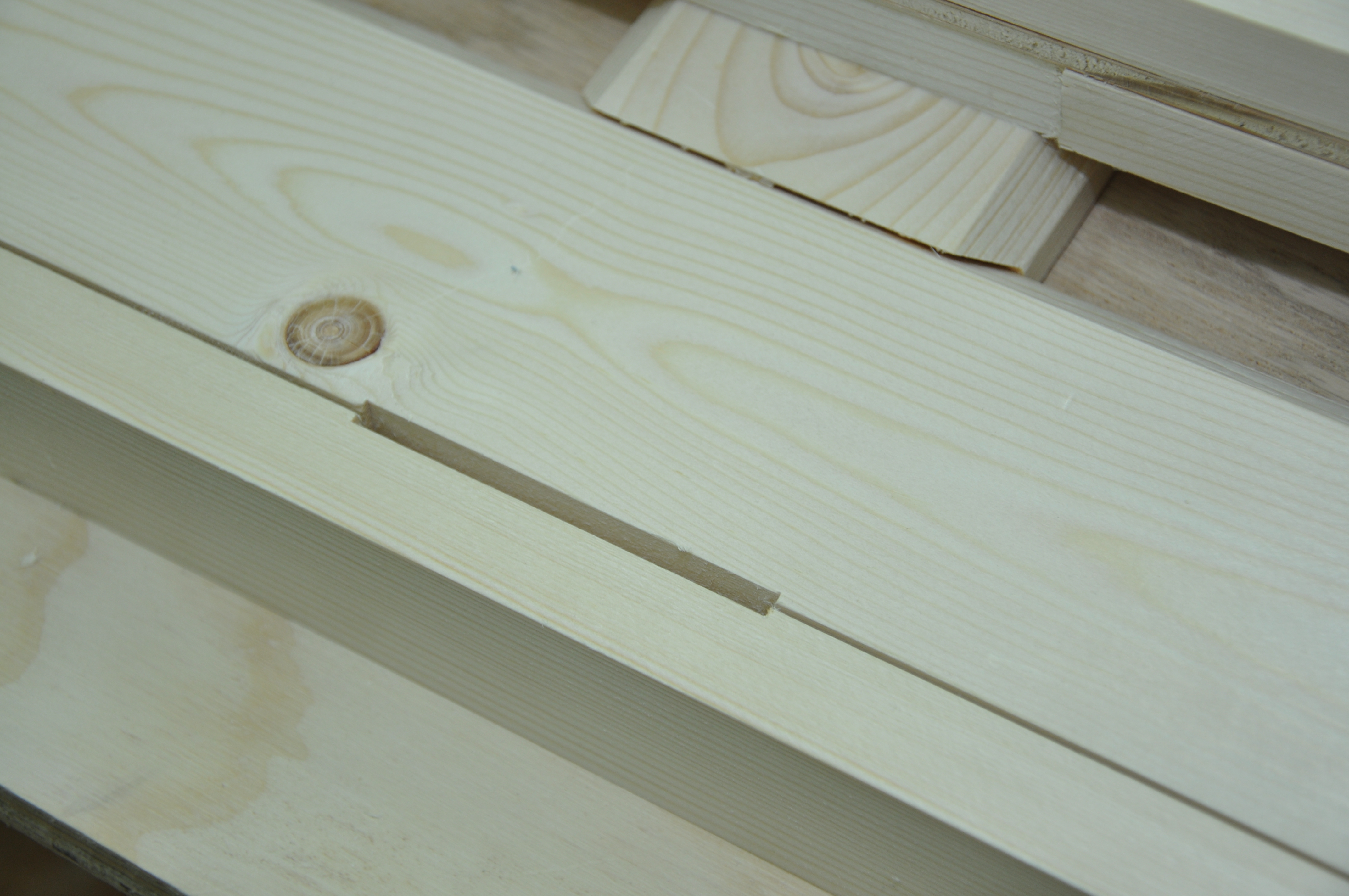

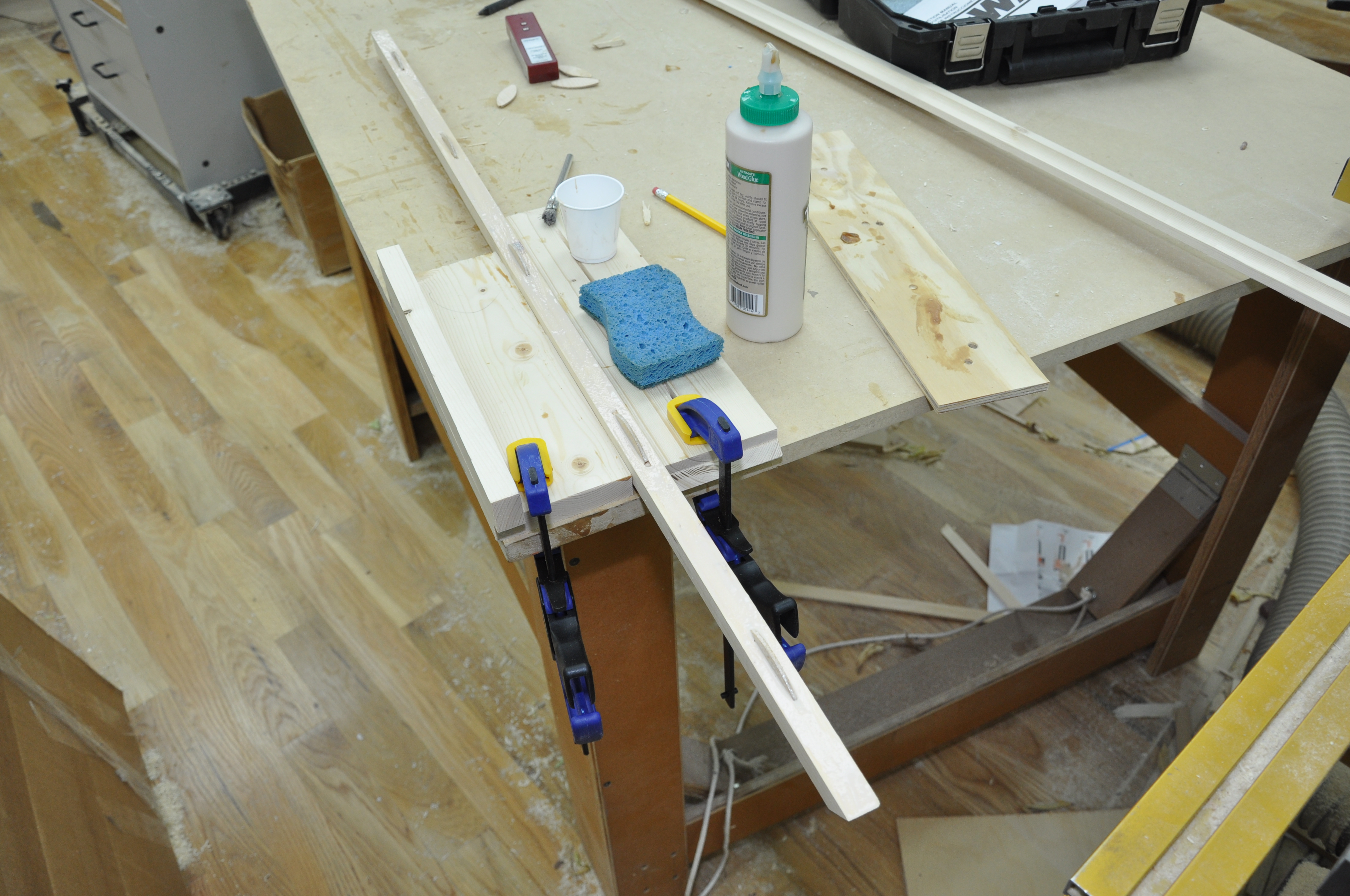

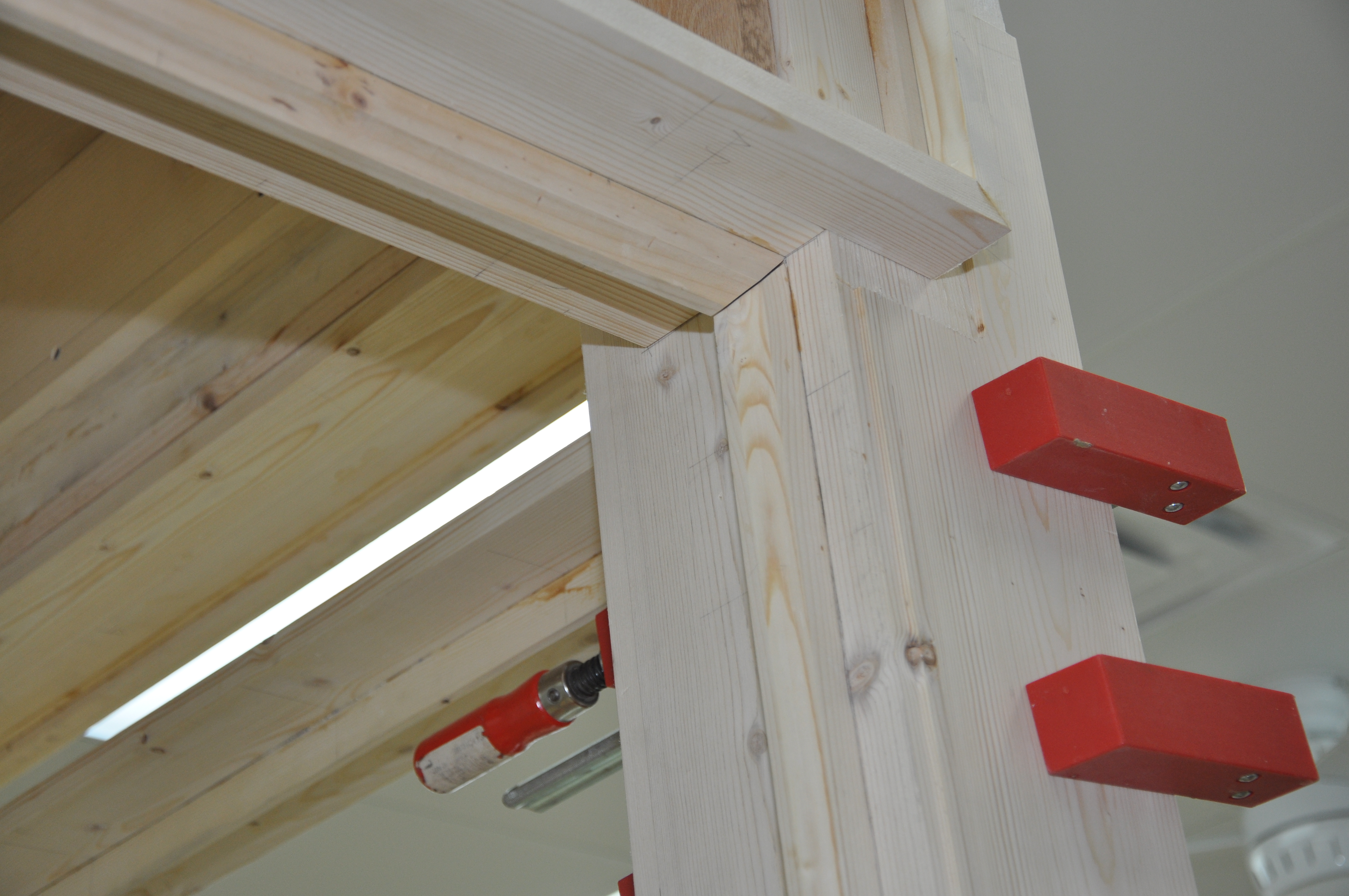

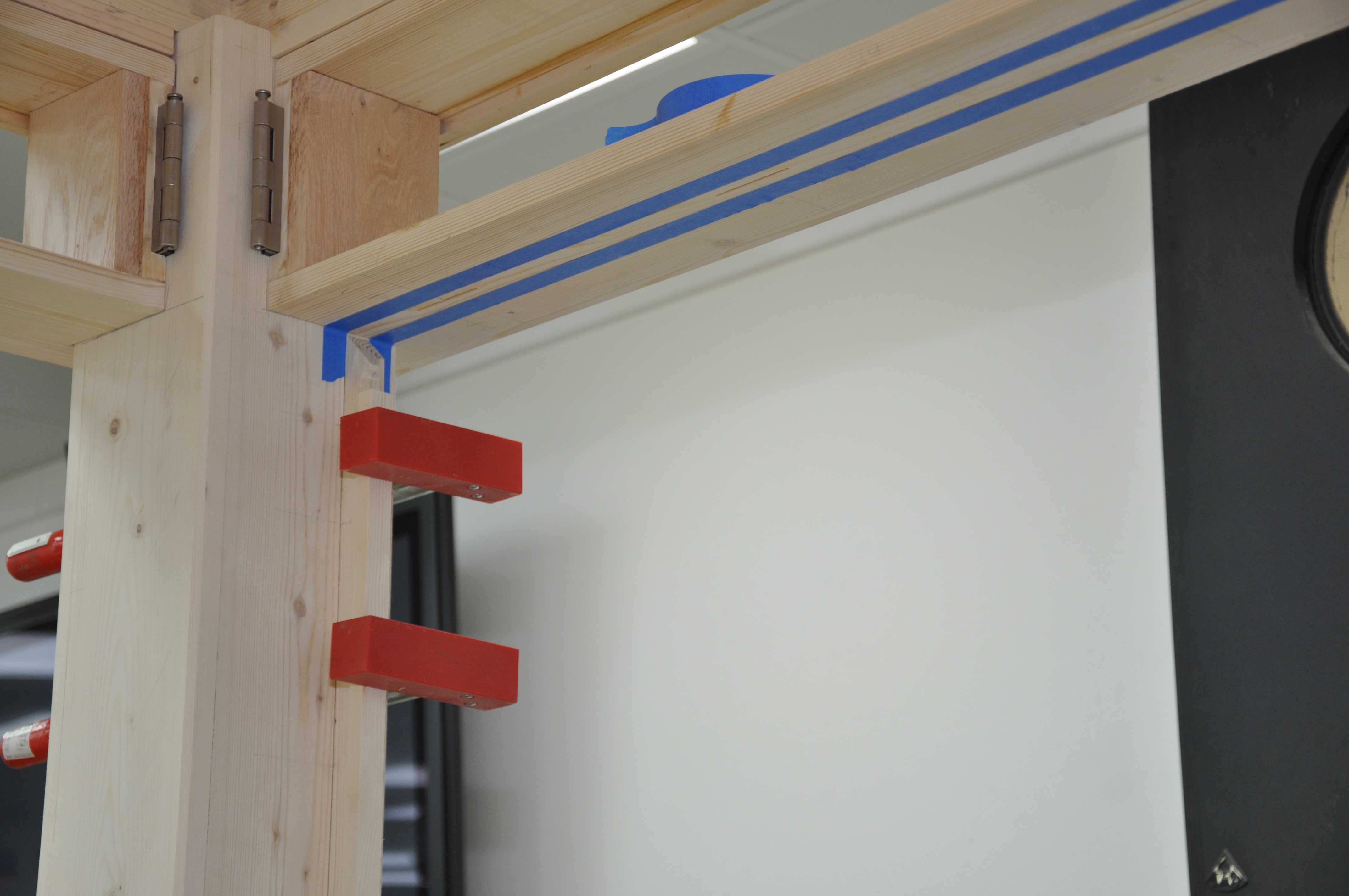

Going back here awhile. This was the process for gluing the trim boards around each wall opening. As I was using biscuits and glue only, it took a lot of clamps. With three per side, times 4 sides, there were 12 to do, with each taking 2 hours to set. It seemed to go on forever before it was done. Next time I might just glue and nail these things up and be done in a couple hours.
This shows how I first lined the glue area with painter's tape so applying the glue would be easier since I wanted it right to the edge of the boards. After clamping up with board I removed the tape and made sure there was no glue still squeezing out.
This shows the miter joint of two of the boards with a slight gap in it, which is there on purpose to make sure the assembly of the Tardis is easy to do each time. I expect if this was a tight joint there might be some difficulty getting it together and then back apart without damage.
This was my setup for applying glue to the boards and biscuits for each piece. I used a glue brush and a plastic cup to hold the glue for the process.

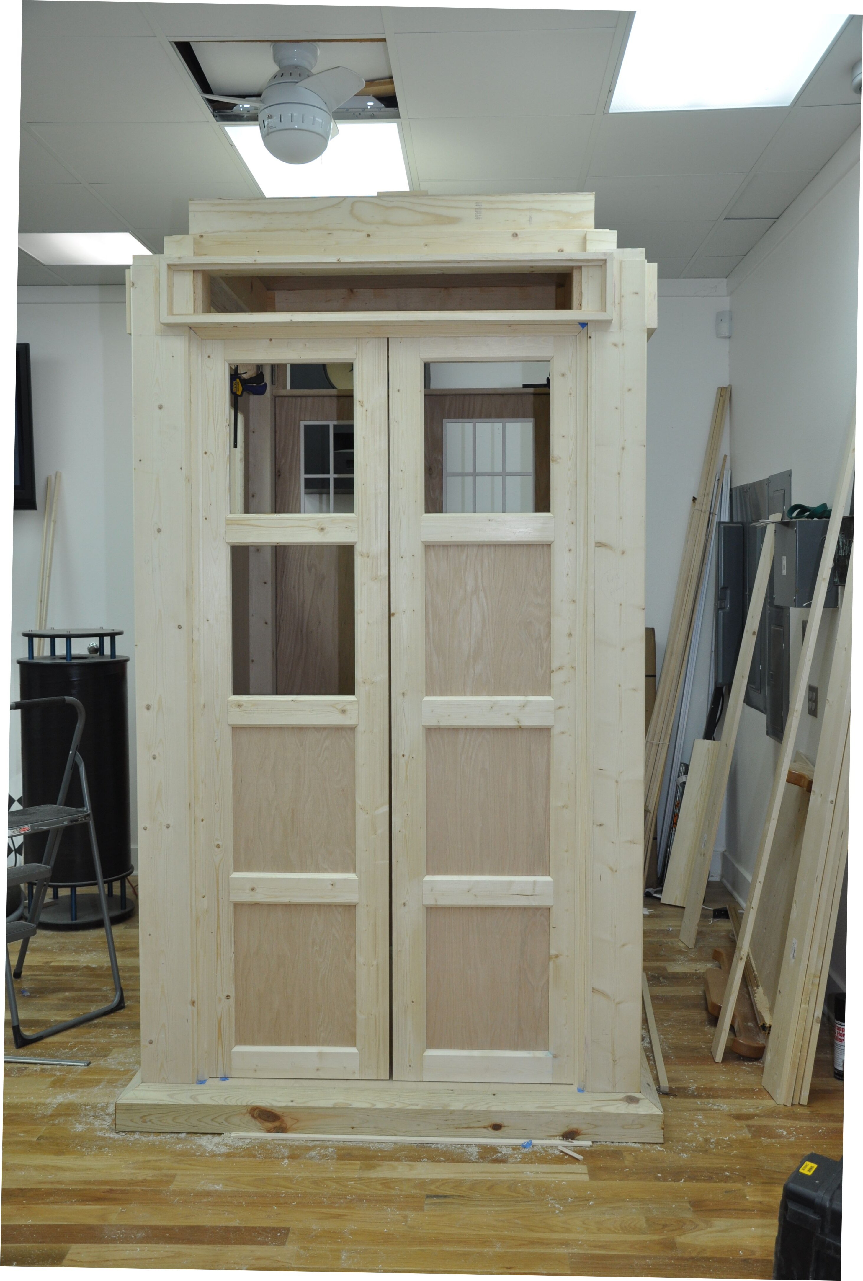

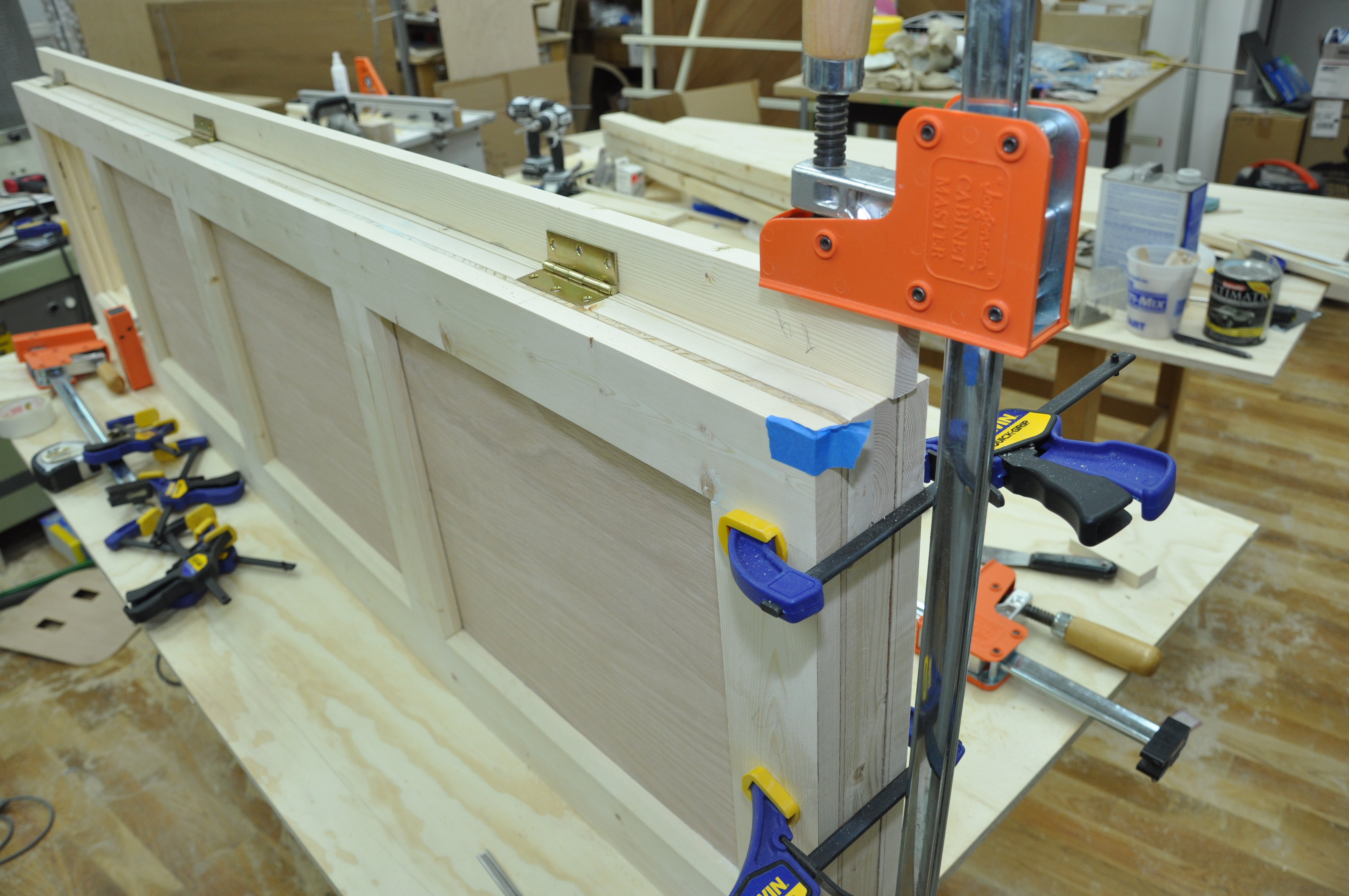

Today was all about getting the doors hung, which has been completed. Unfortunately, both of the doors are slightly bowed and misalign in the middle. I was worried about this happening, which is why I used the best boards I could get and was careful to build them on a flat table, but this wood is really unpredictable. I'm anxious to work with them tomorrow to see if I can have success removing the bow. I'd really hate to build the doors again, especially as that doesn't guarantee it won't happen again.
Anyway, here's some photos and steps to get them hung. In the photo below the gap in the middle is not parallel because the walls aren't yet attached and the entire Tardis is not yet squared up. When attached, the walls will hold the assembly square.
Here's an inside view of the doors.

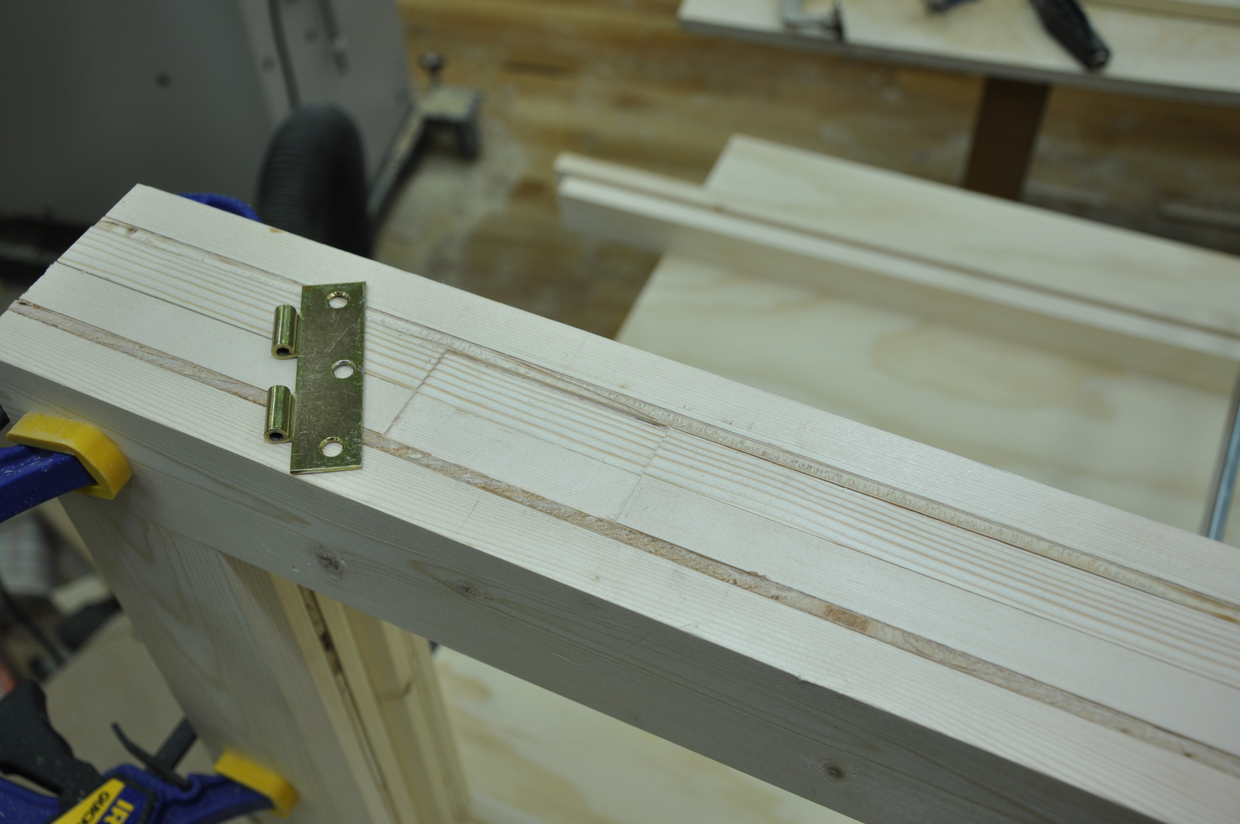

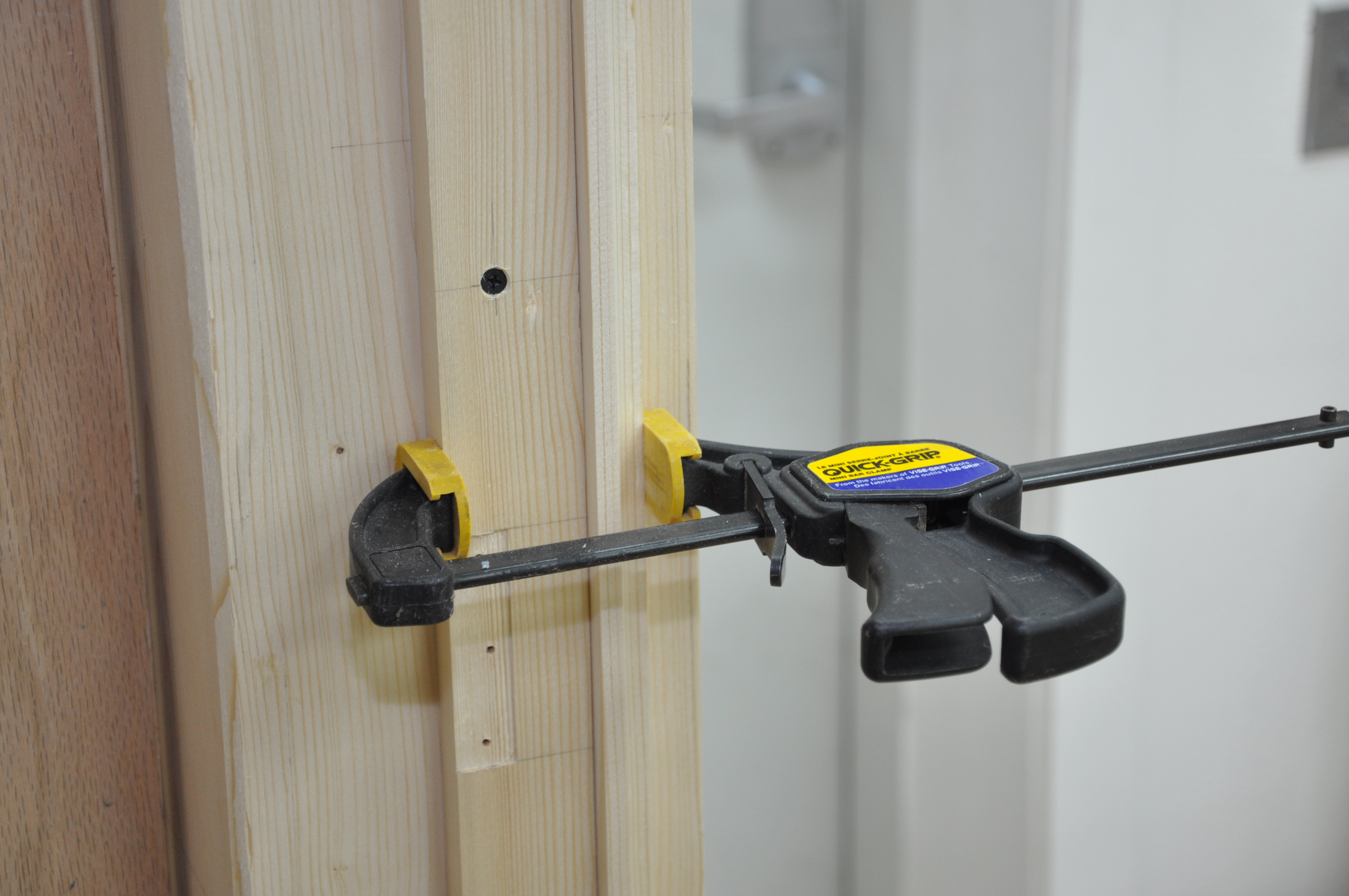

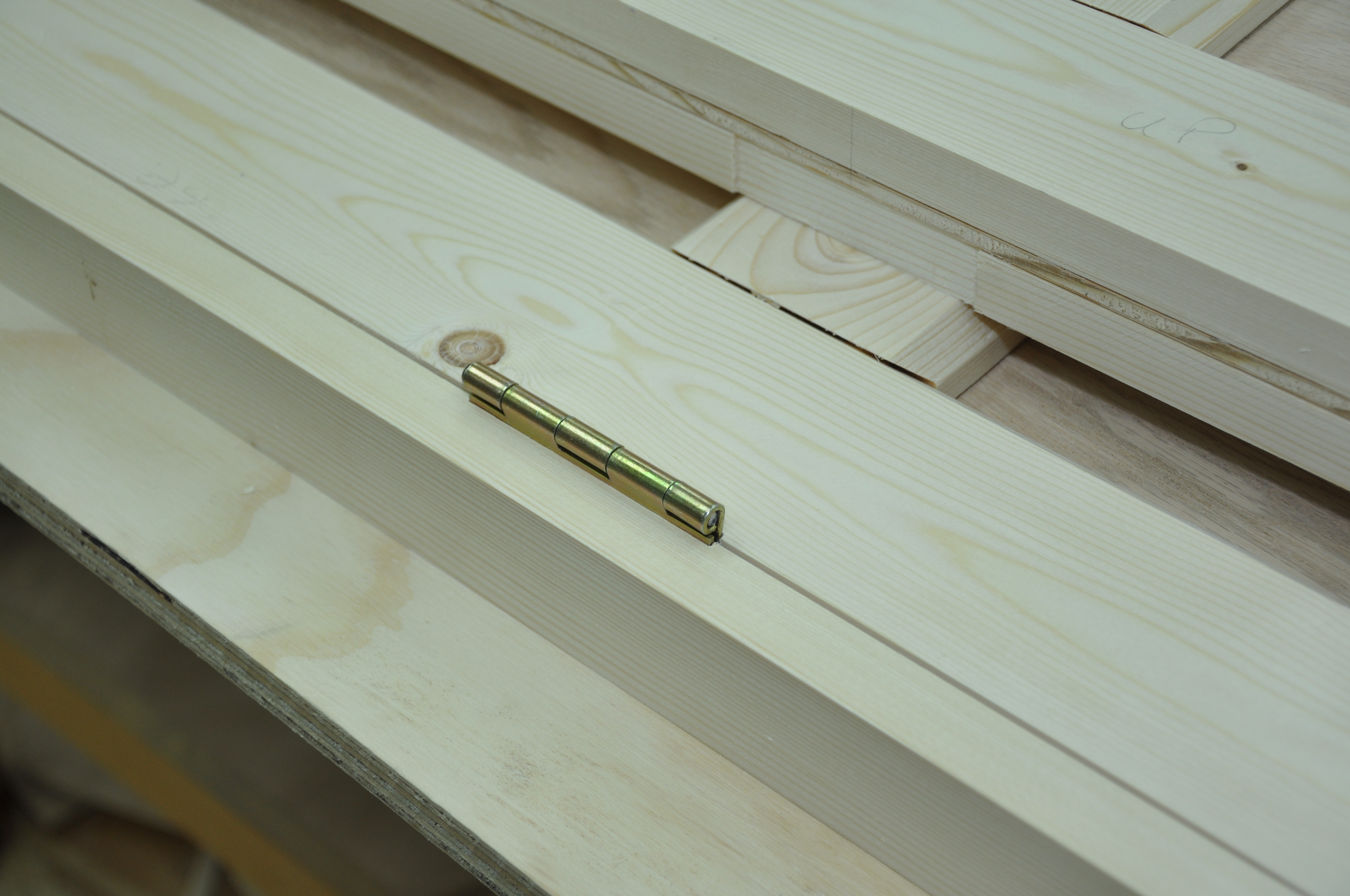

This shows how I clamped the doors together on edge to locate and mortise the hinges. Doing it this was made it possible to do both at once with a router template which assured they were in exactly the same location.
Detail of one of the mortises cut into the pair of door edges.

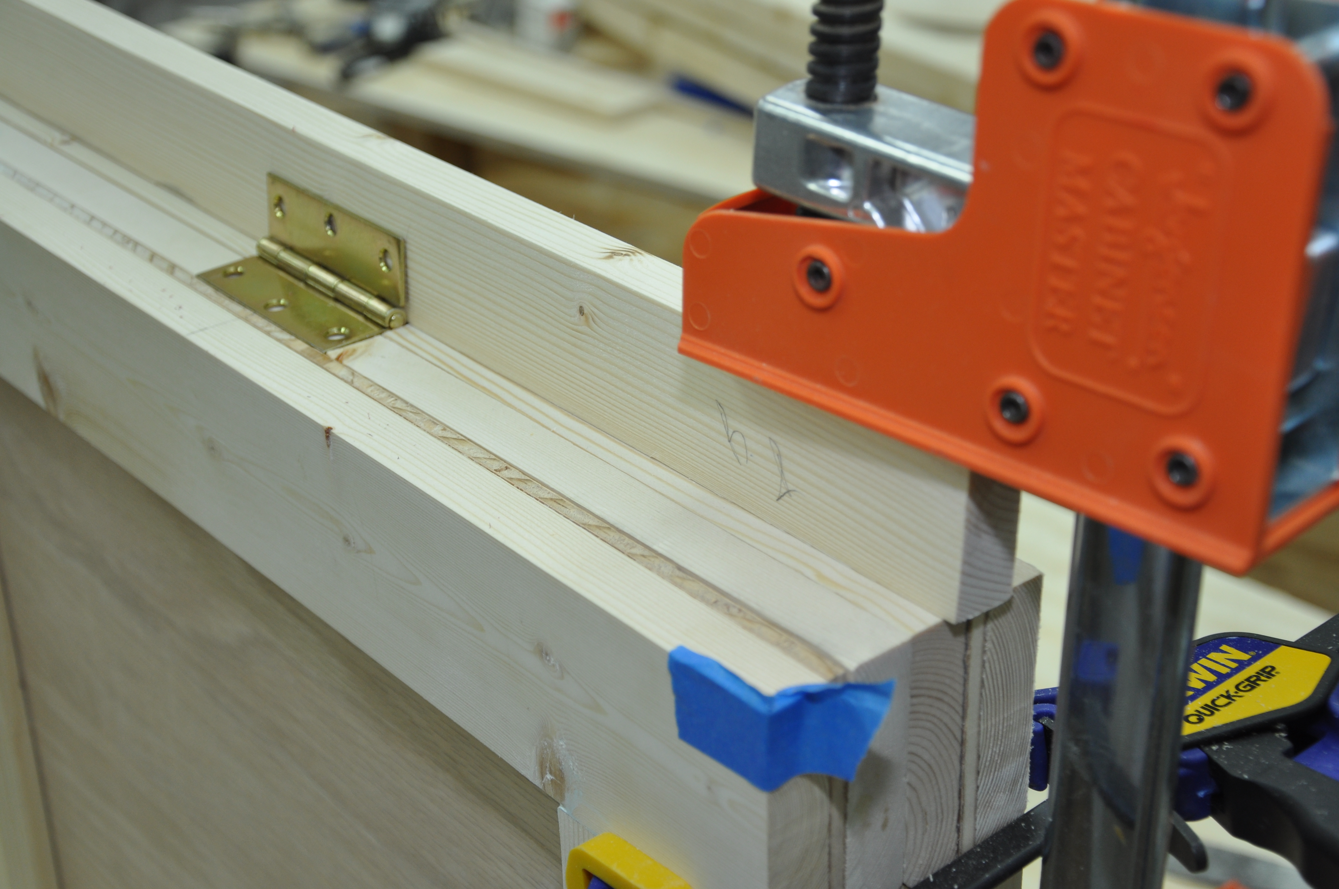

This is the setup to mark the location of the other side of the hinge that is on the door jamb. This is pretty easy compare to doing a real door since the board is a separate piece that I attached to the post later with screws.
Detail photo showing how the board is 1/8" past the bottom of the door for clearance. I set the hinge in the door mortise, raised it up against the jamb and marked with a sharp pencil.
If you've done good work on the layouts and cutting, your pair of mortises should line up like this. When all three pairs line up as well, you know your door will go on the hinges perfect.

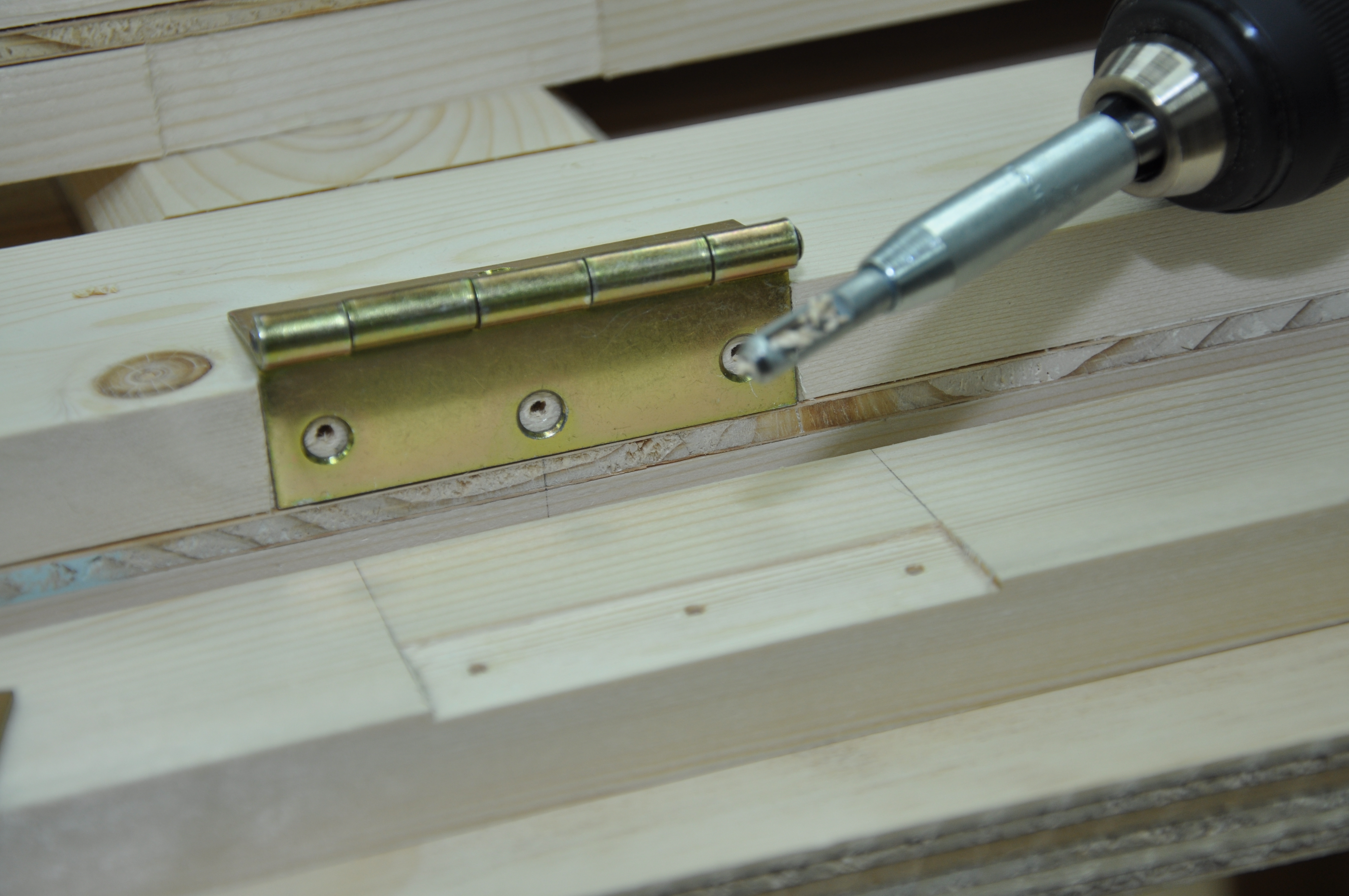

Photo with the hinge stuck down in the mortises. On these hinges, I used a grinder to take off one end of the pin and removed it so they would work as removable hinges. Unlike a regular door hinge, these pins are installed and made permanent by peening them over on the ends.
Here's the hinge mortising template I used with my hinge mortising bit, again bearing guided. This can be done with a chisel and knife, it's just more work.
This is a photo of the hinge holes after drilling. I use a little shop aid to do this called a Vlix bit, which is a self centering drill bit designed exactly for this purpose. Sorry the bit photo is out of focus.
Switching over to the door jambs. After the hinges had been fit to the door and jambs, I decided to screw the jambs to the posts on the off-chance I might see some wear on the hinge screws and wish to replace them later. As it's soft wood and the hinge screws are pretty small, any wear could be an issue. Preparing for this, I first located where I wanted holes, drilled a countersunk hole with a small drill, making sure my countersink just barely allowed the screw to sit below the surface (deeper and the soft wood crushes easily). I then drilled a very slight countersink on the back side of the board to allow room for the wood to pooch up when it enters the post. Finally, I used a larger drill to make the pilot hole larger on the board itself since I didn't want the screw to grab the jamb board on the way in. I used 1-5/8" long coarse drywall screws. It all sounds like a lot of trouble, but doing all this means good attachment and no surprises, like a broken screw.
First thing today before I began the hinge work, I trimmed the door lengths to match each other perfectly. Here's a photo showing the plywood guide, the boards clamped at the beginning and end of the cut to prevent chip out, and in this case I used a large diameter bearing guided bit.

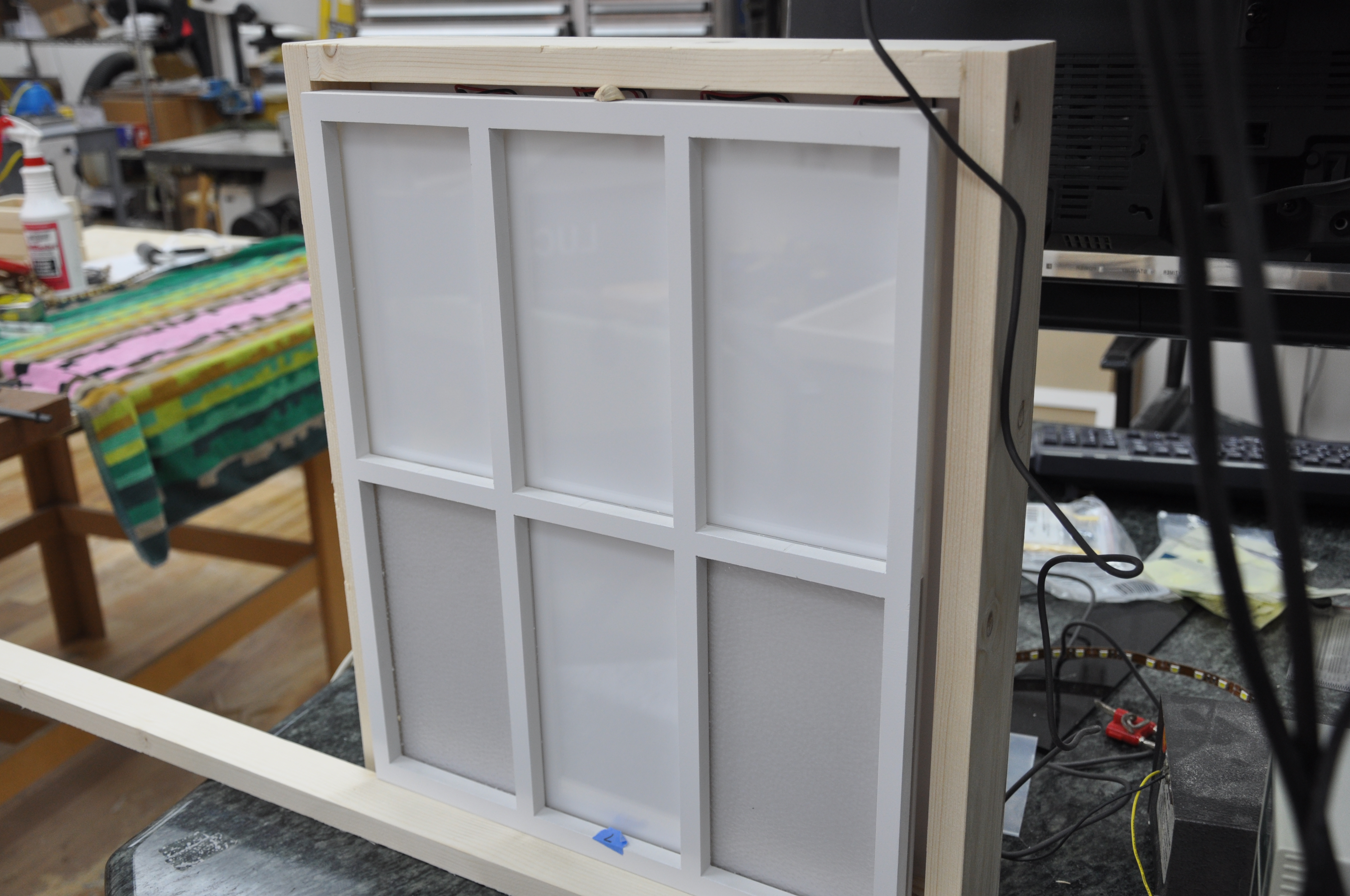

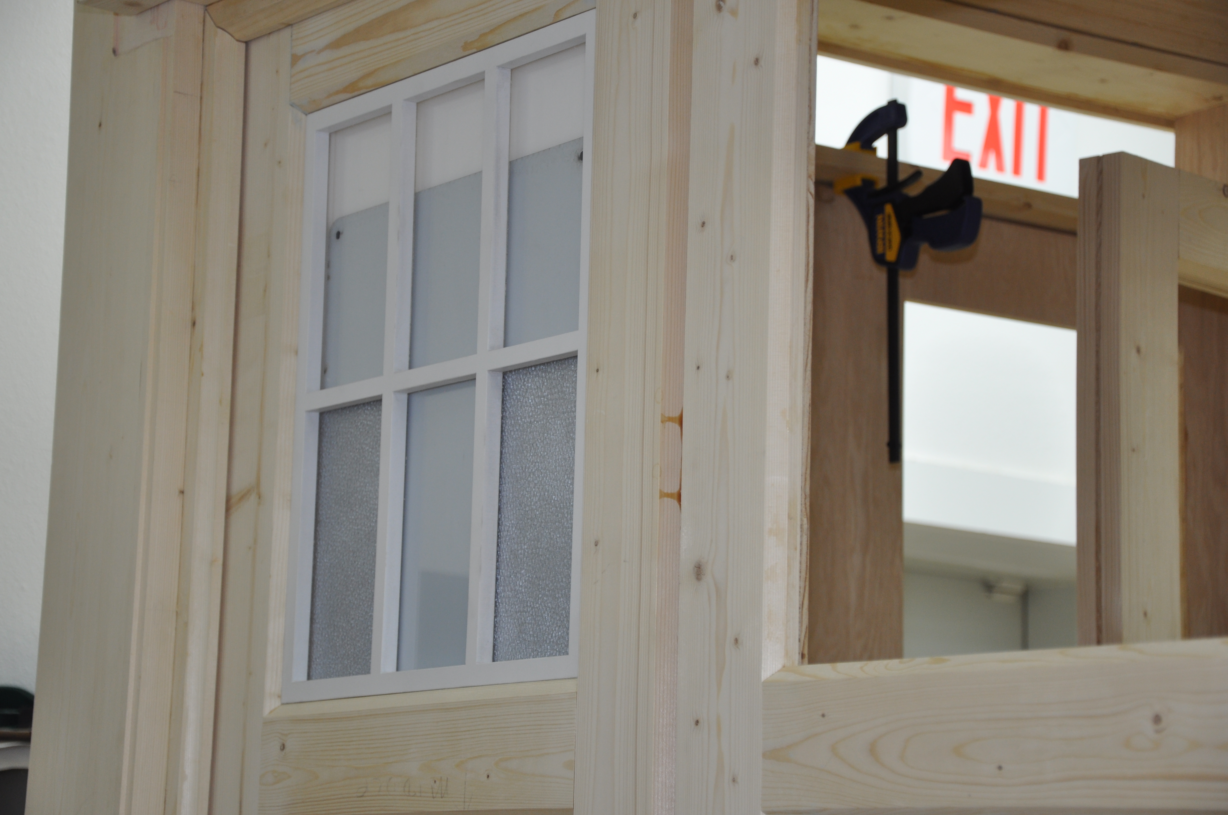

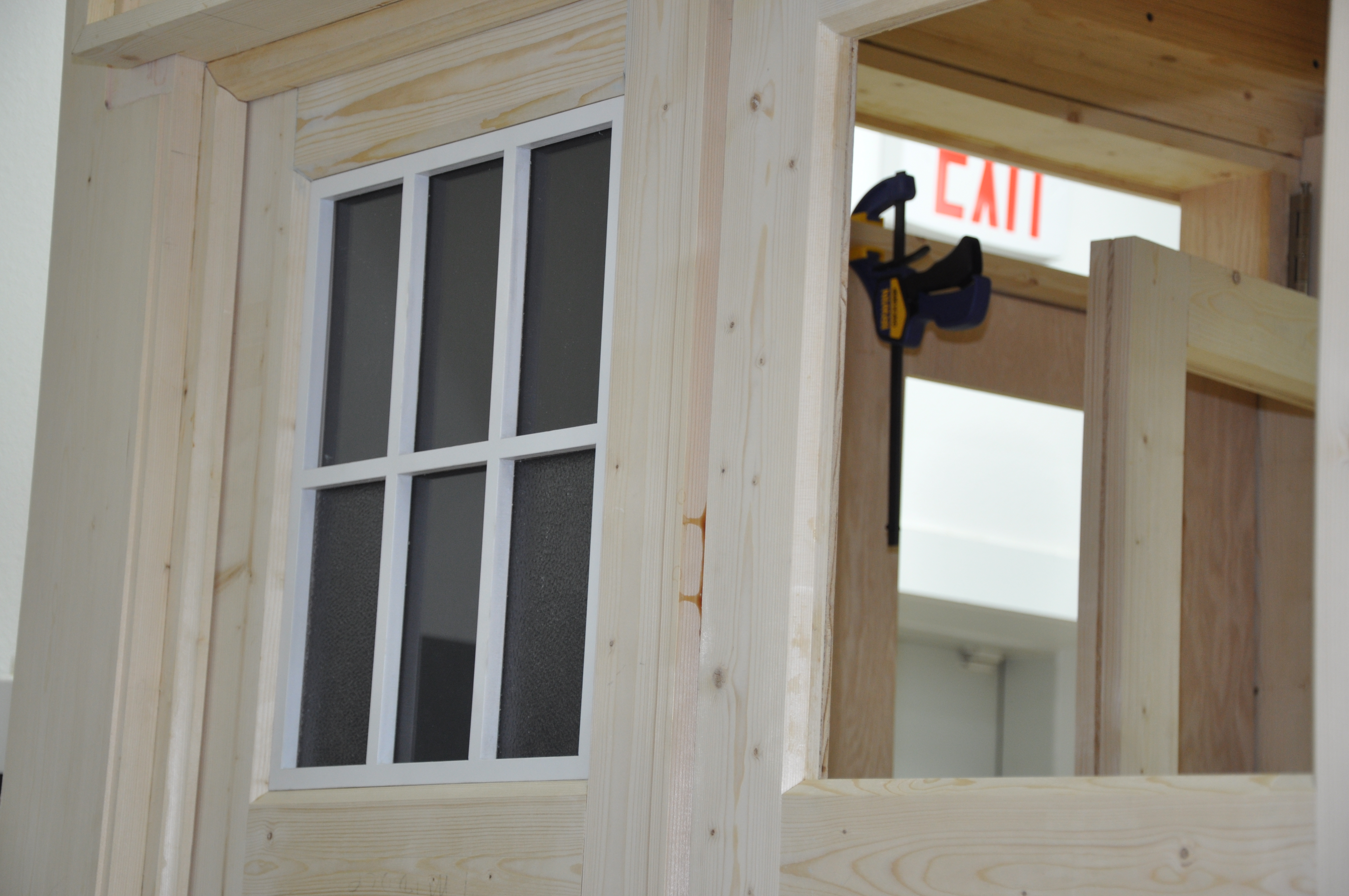

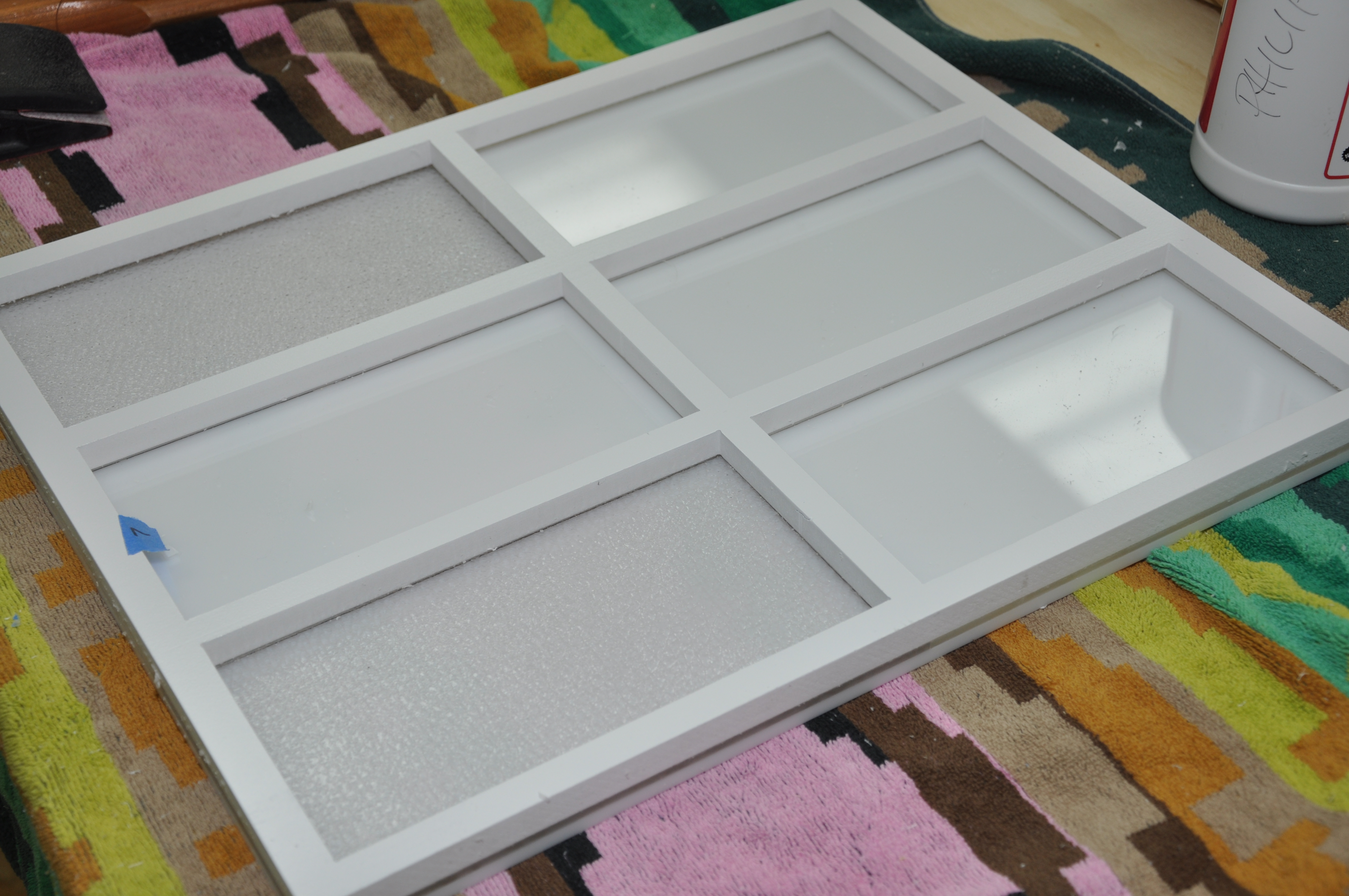

I've been working on the Tardis windows that last couple of days. Tardis version followers likely know that the Matt Smith version I'm building has very evenly backlit windows, and the phone door is lit as well. The windows on the prop are done with EL sheet, but sheets that cover that area are too expensive for my budget on this build.

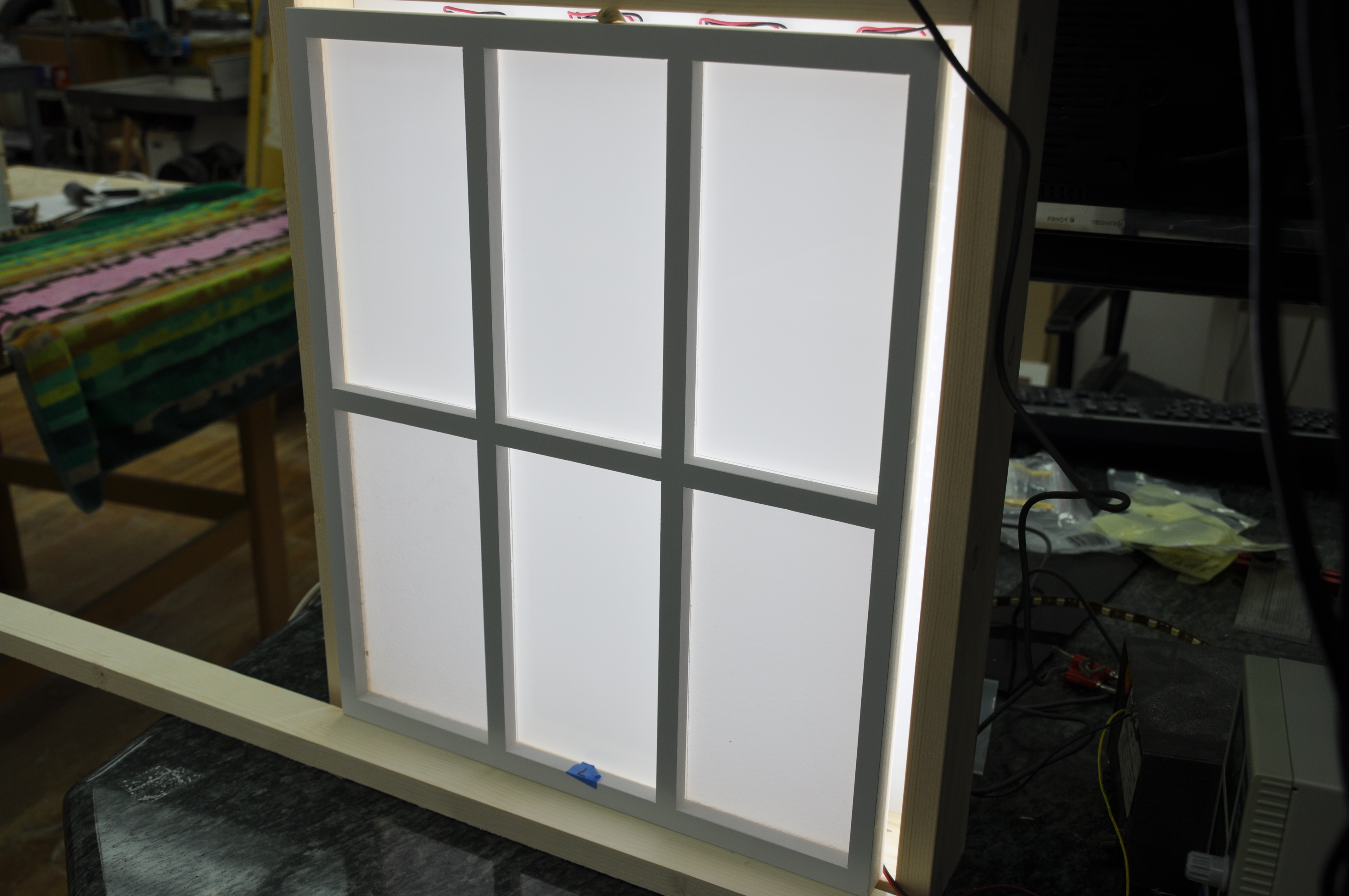

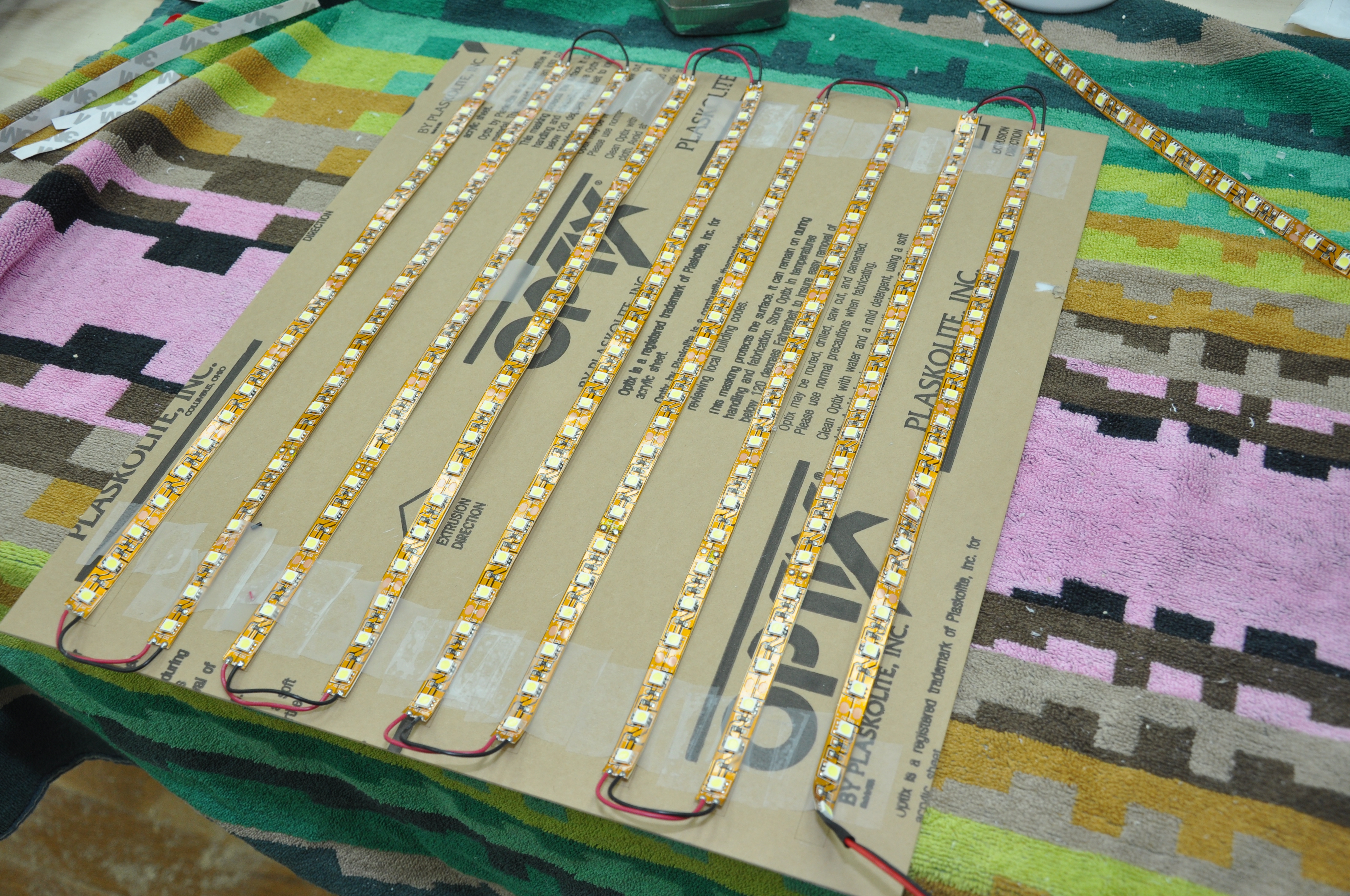

Today I tested using LED Strip Lights, which is a flexible metal strip with flat LEDs on them and 3M double VHB tape on the back. They can be cut every three LEDs and individually connected to 12v power or in my case I cut them every 24 LEDS and soldered them from one to the next. Very handy.
I tested with a couple of rows to determine how close together then needed to be and then how far I had to pull it back from the white acrylic diffuser. I was delighted to see it does work, and I only had to set it back 2.25" from the diffuser.

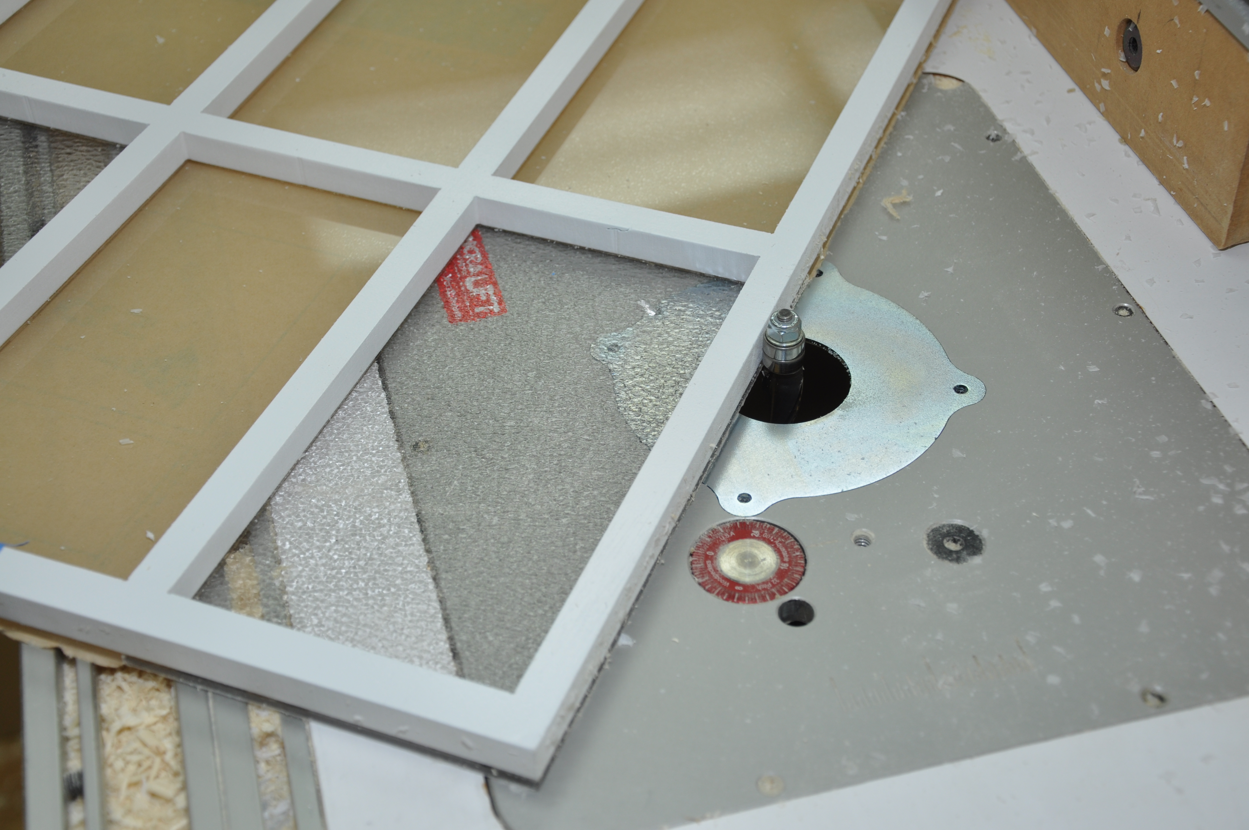

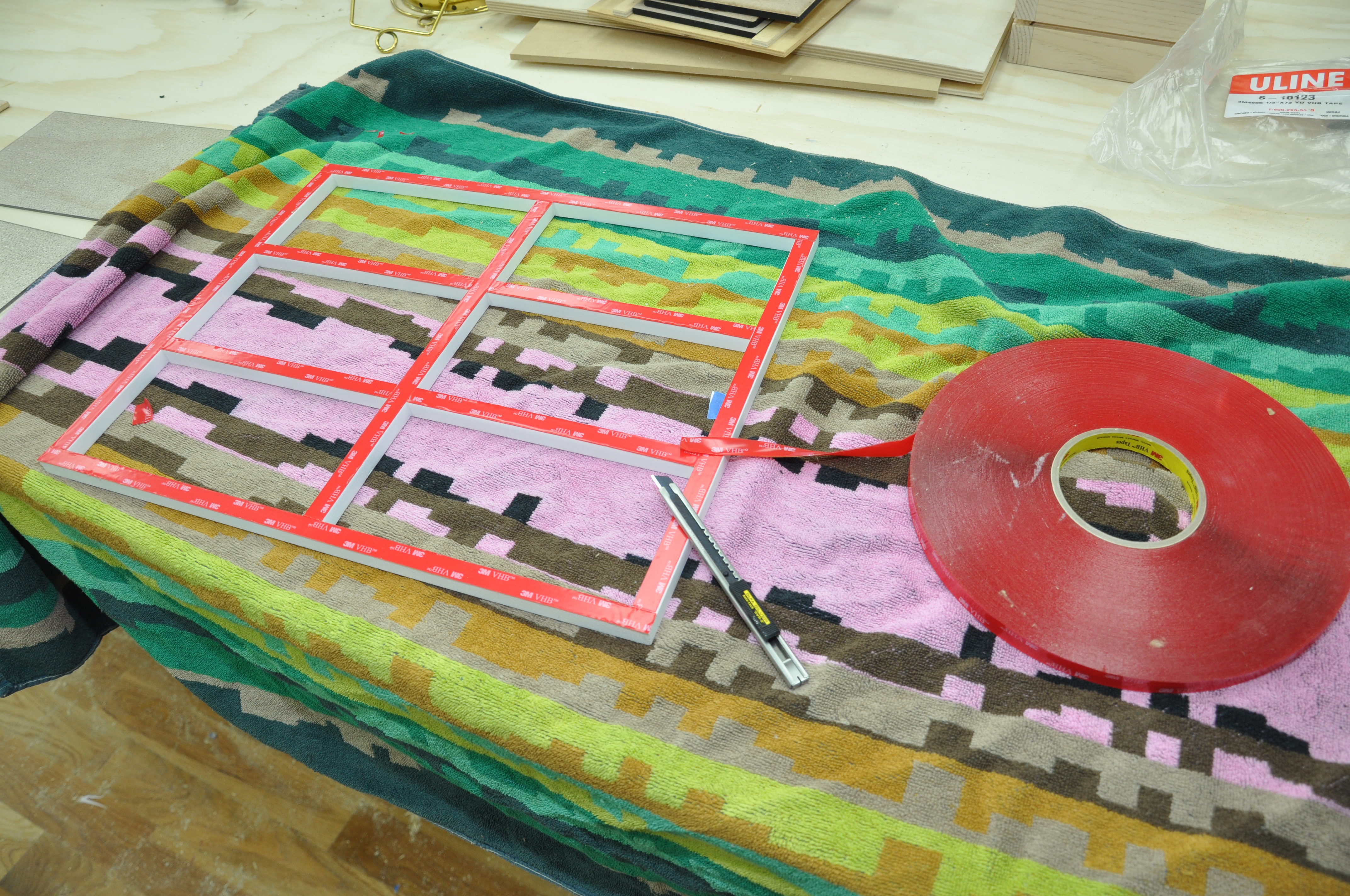

The window assembly is made up of the PVC window frame, onto which I applied 3M VHB tape, and to that a "T" shaped 1/8" clear acrylic for the top three panes and the bottom middle pane. The bottom left and right panes are 1/8" pebbled Lexan.
Onto that, I used the VHB tape again to attach a 1/4" piece of sign white acrylic to serve as the diffuser.
Some build details below.
Illuminated panel
No illumination.

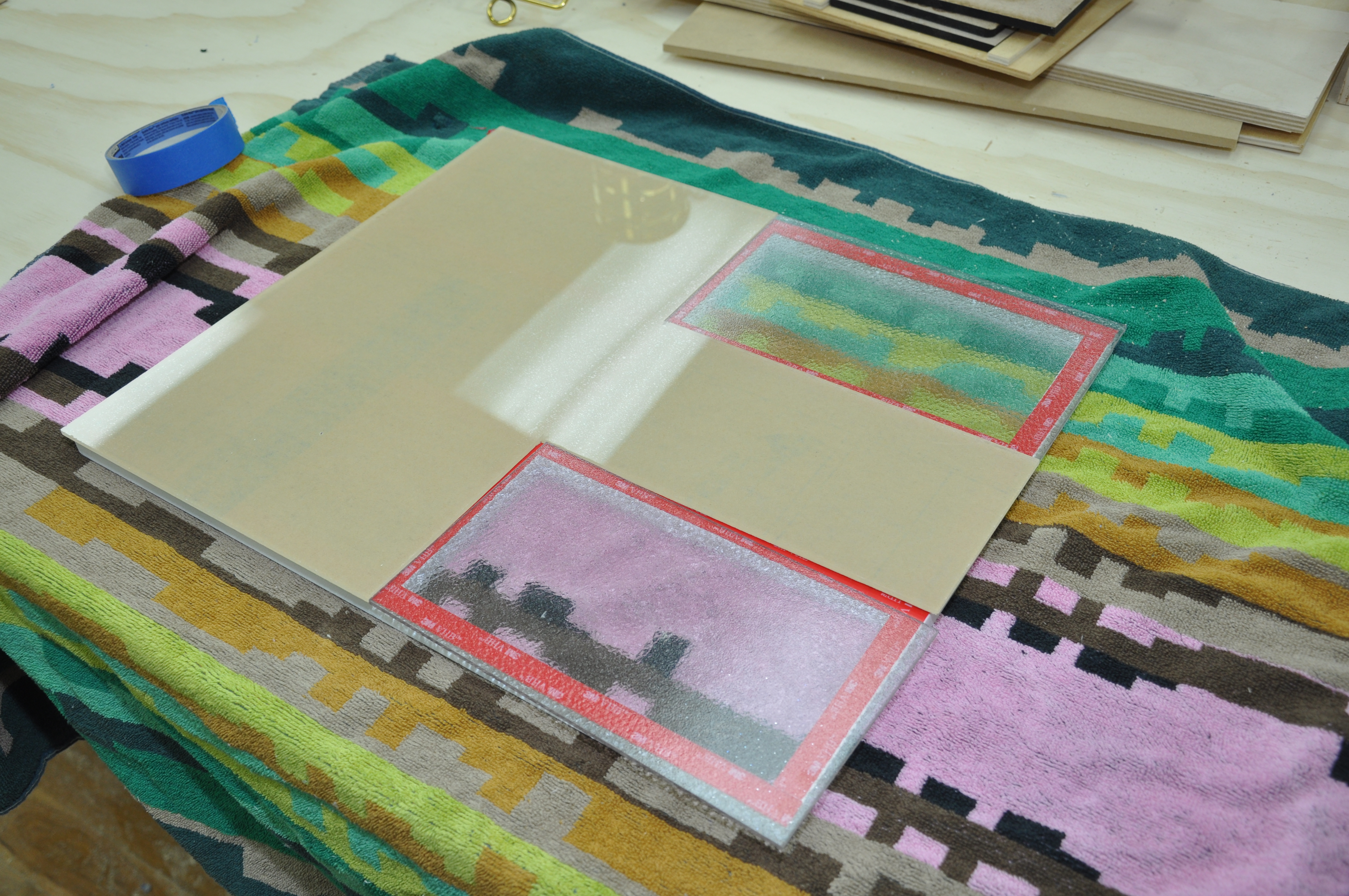

Applying the 3M VHB tape to the back of the PVC frame. This stuff is scary sticky.
Dry run fitting the acrylic and Lexan to the tape, since there's no room for error here.
Using the router bearing guided cutter to trim the acrylic and Lexan flush to the PVC.
Same process for adding the 1/4" sign white diffuser. Stuck with the VHB tape and trimmed flush on the router.
This is test of the LED strip lights. I laid them out on a piece of white acrylic that will be inserted into a 2.25" deep light box that will fit over the back of the window assembly.
This is the light box with the strips now attached to the thin white acrylic in the box. Each window will have one of these that somehow attaches to the back of the windows during setup each time. It's a simple box with a 1/4" backer made from the same plywood the walls are made from. I used the thin white acrylic to mount the light strip to as a cheat so I wouldn't have to paint the inside white.

As a result I decided to go ahead and design my windows so they could receive an insert between the panes and the white diffuser. It's made so I can insert them from the bottom with the backlight boxes in place. I tested it with a piece of plain black matte board, and just a piece of very light grey plastic and photos are below.
The only change to the earlier window build was to create a channel I could use to slip in the background. I did this by clamping a spacer to the back of the panes and sticking two 3/16" thick runners to the back using the same 3M VHB tape as before. I plan to use 1/8" acrylic inserts that should slip up in this slot quick and easy when needed.
This shows the insert spacer and the two 3/16" runners.
With a black insert.
With a very light grey insert.
No insert, not illuminated.

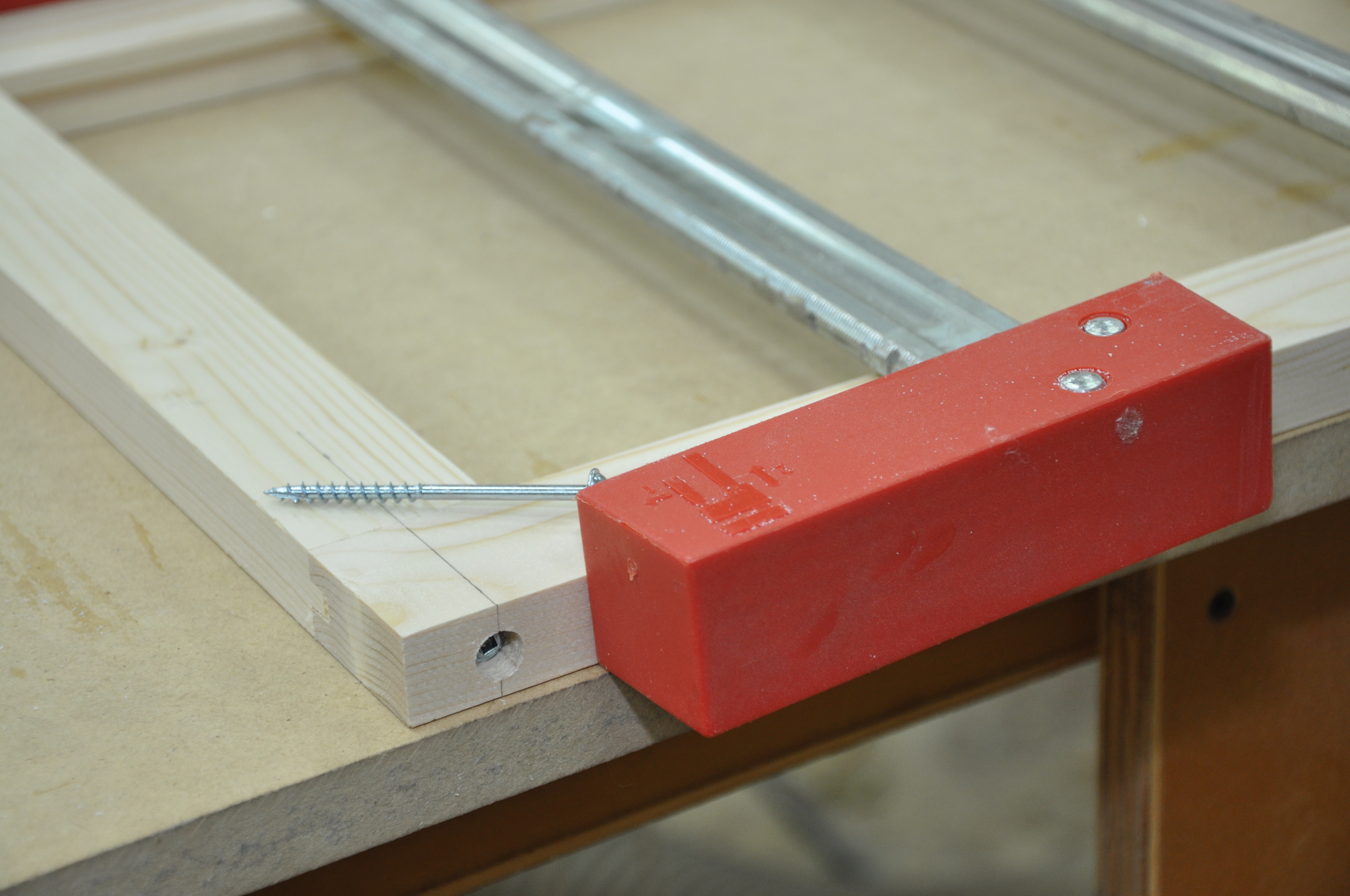

Here's where I used countersunk long pocket joint screws to make the hinged stile removable.

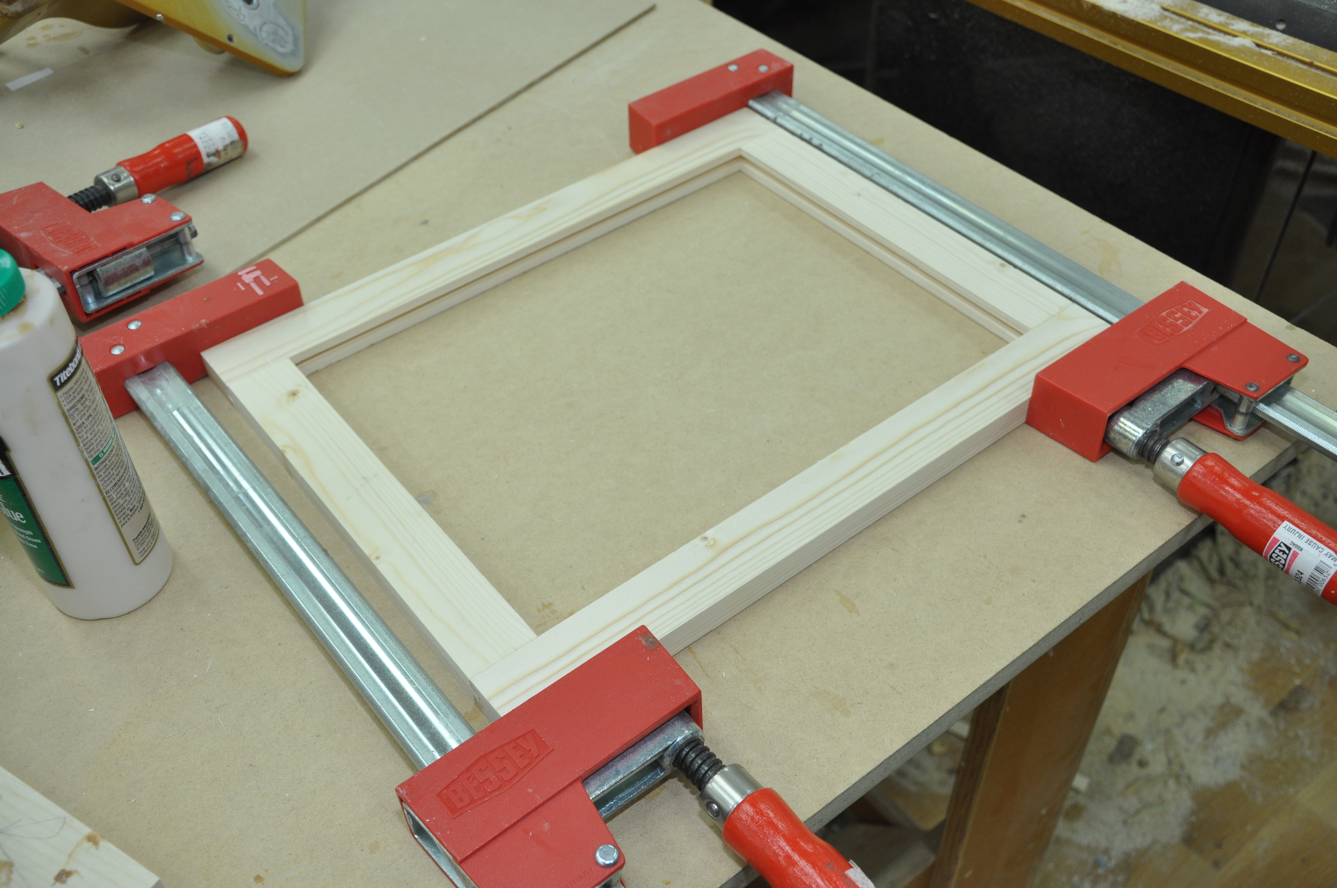

Gluing up the first three parts of the frame.

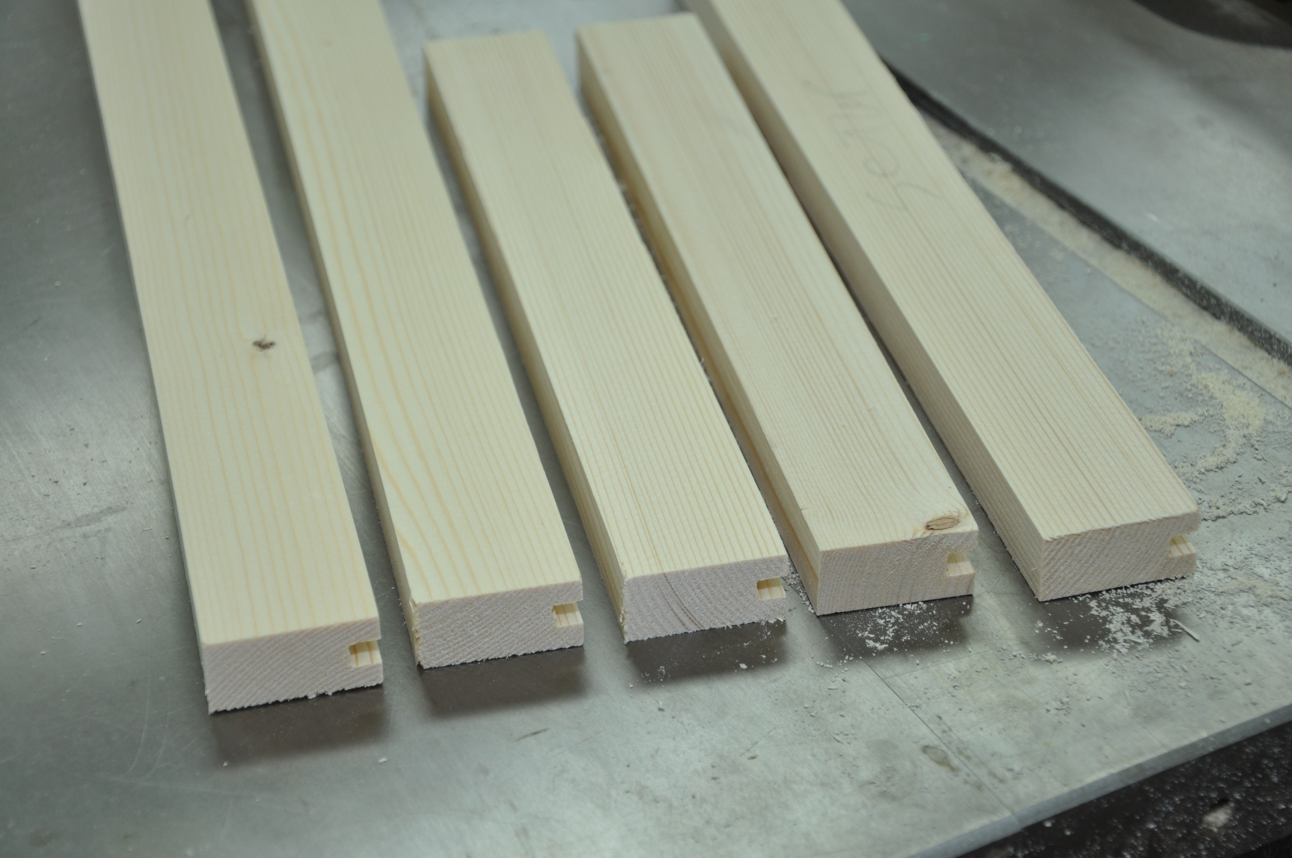

This is the five boards I prepared for the frame. Four for the frame, one to setup with. Unfortunately I didn't take a photo of the ends that were trimmed to make the tongues that fit into the groove of the stiles. The groove is cut by setting the saw just over 1/4" deep and close to the center of the edge of the board. The setup board is run over the blade, flipped around and run again, which puts the groove dead center. The width is checked against the sign acrylic and if too narrow the fence is brought just slightly closer and the two cuts are run again. This is done until it's perfect, then the other boards are run.

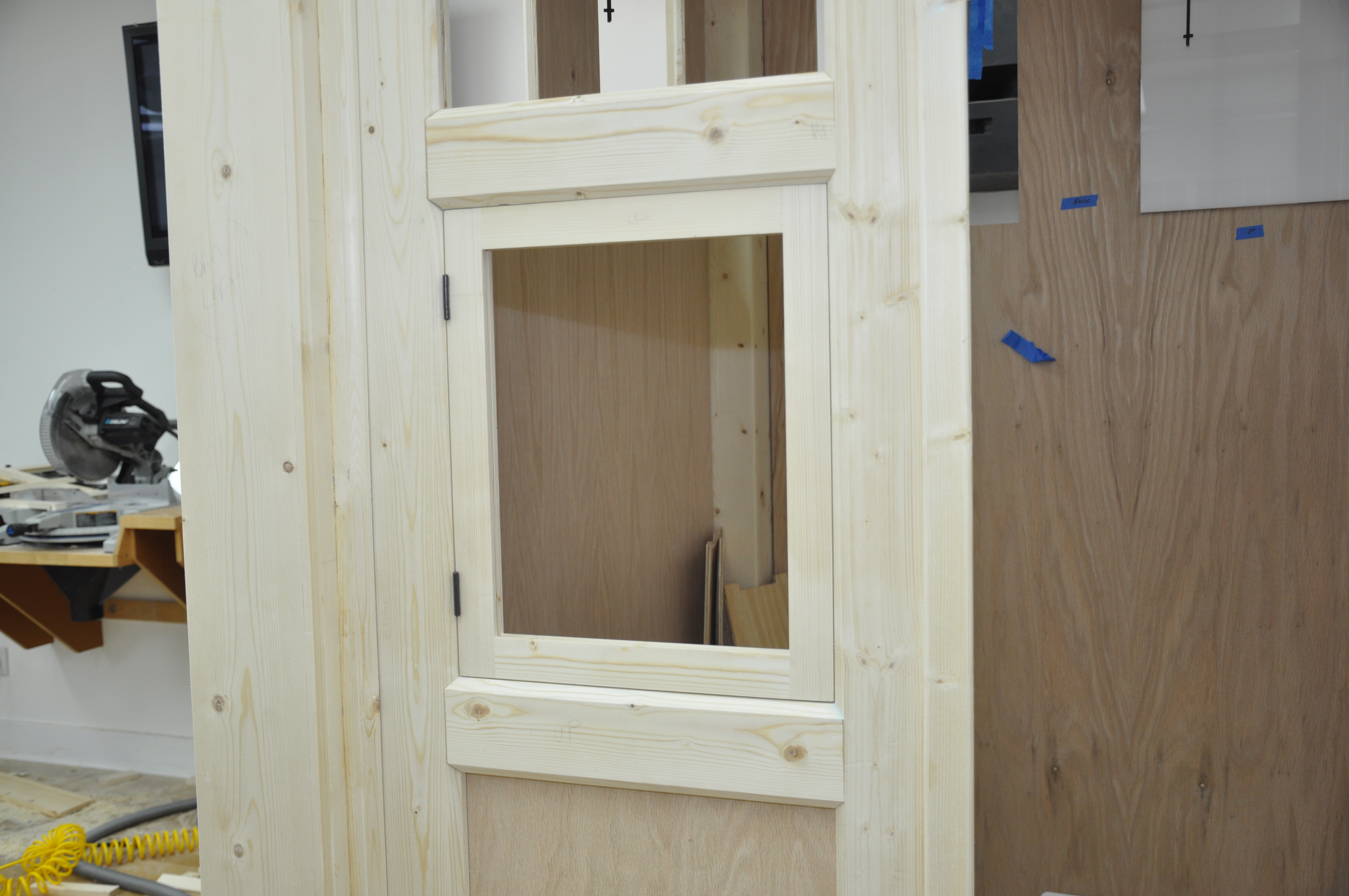

I also managed to make and attach the door top to the left hand door. As both doors are slightly bowed and I was able to remove the bows, I made this piece complementary to the bows, and glued it to the left door.

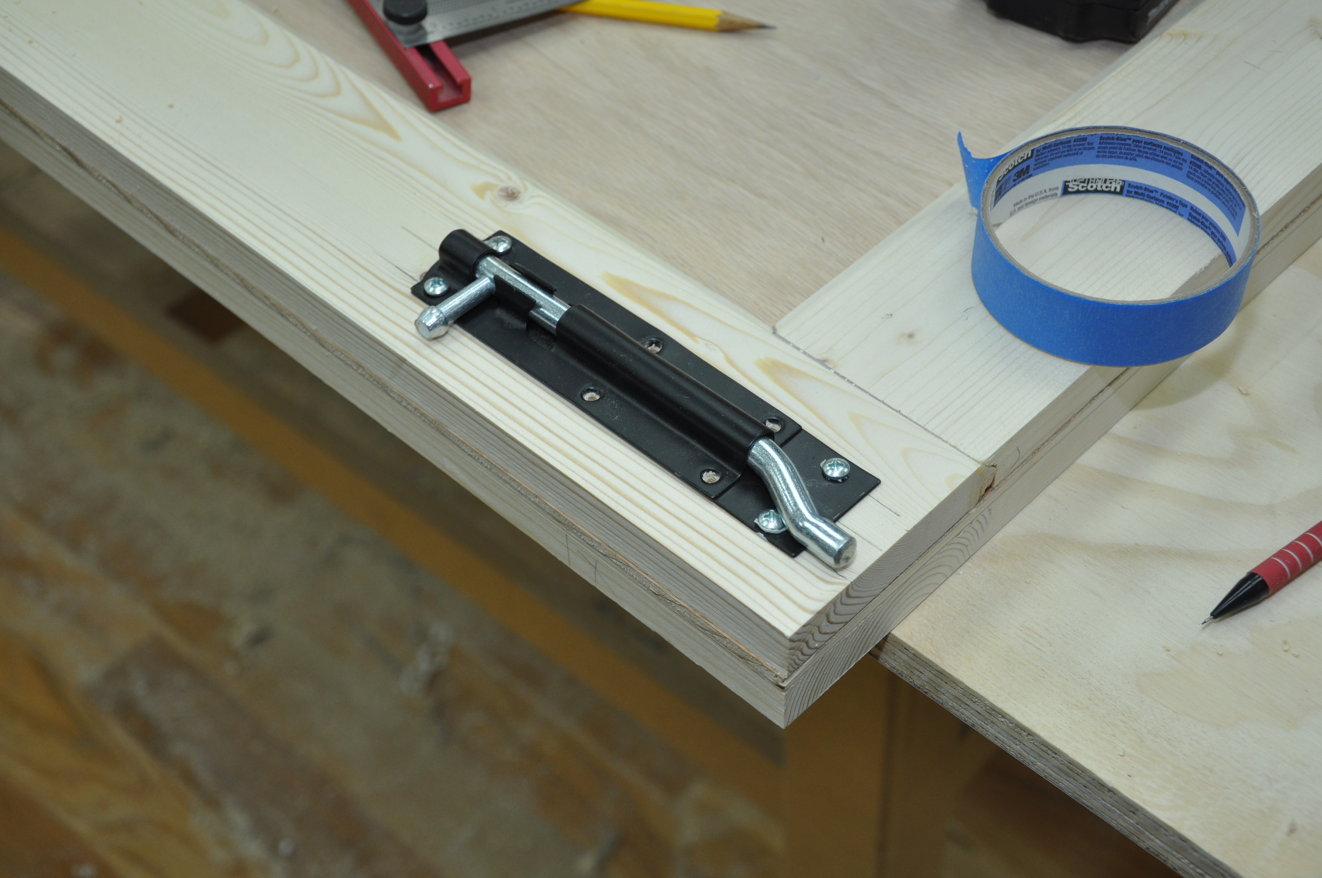

Here's the left hand door bolt that fixes the door in place unless it's raised.

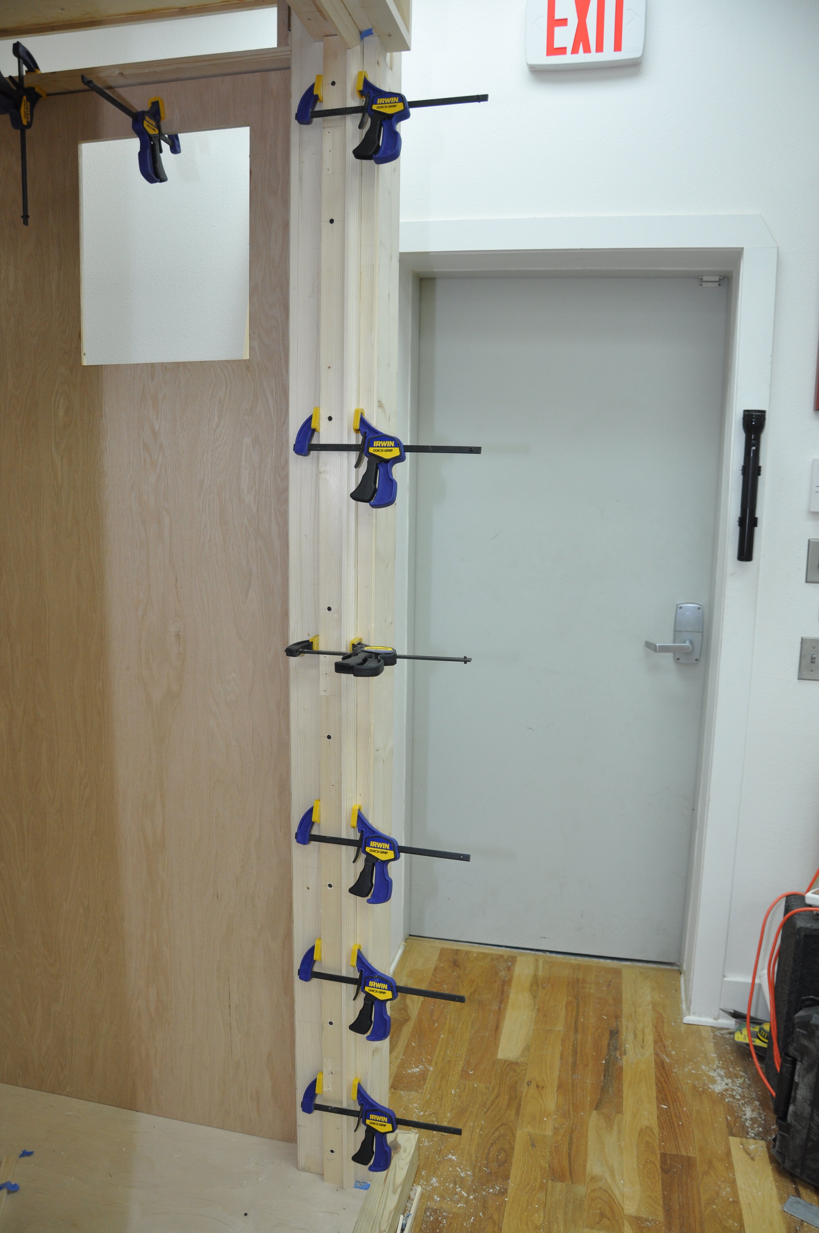

Just a couple photos of progress today. This is the three wall panel divider boards that cover the gap between the wall panels.
Each one is being glued down to the panel using the same gluing caul method as before so I can put pressure in the middle of the panel. This is the first one of the three.
