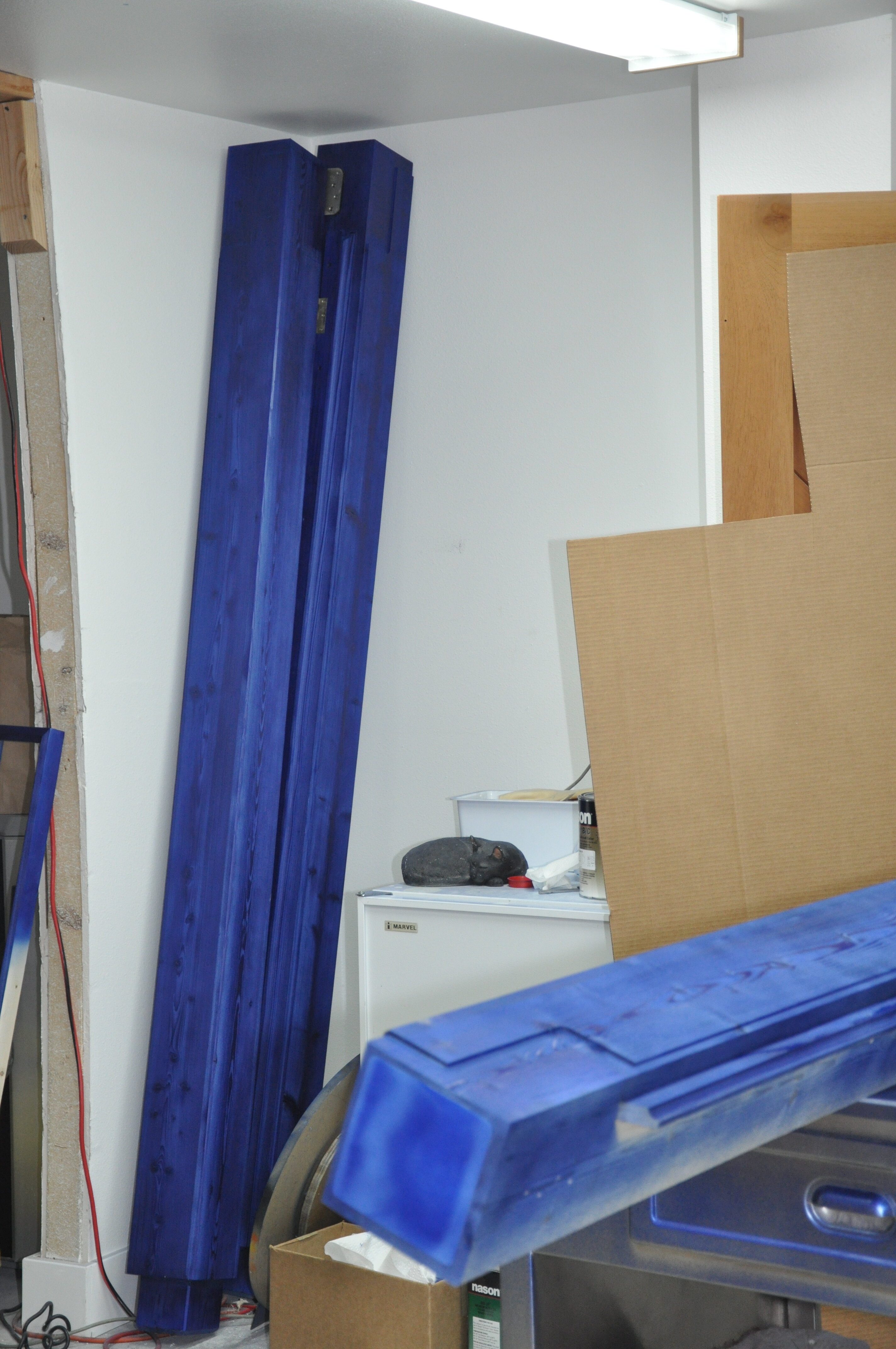

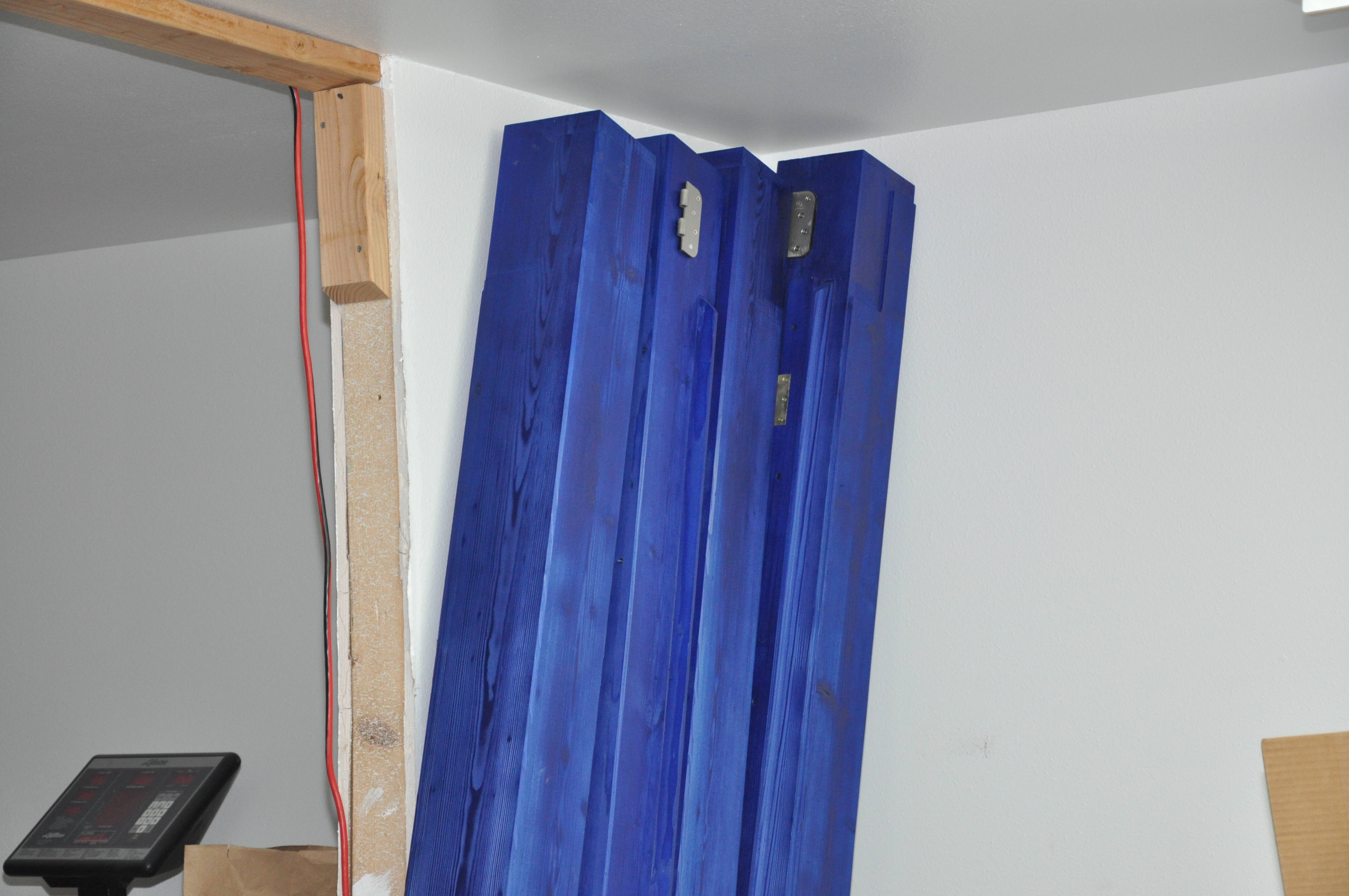

Painting continues. Working on the posts now. The entire post gets painted blue.

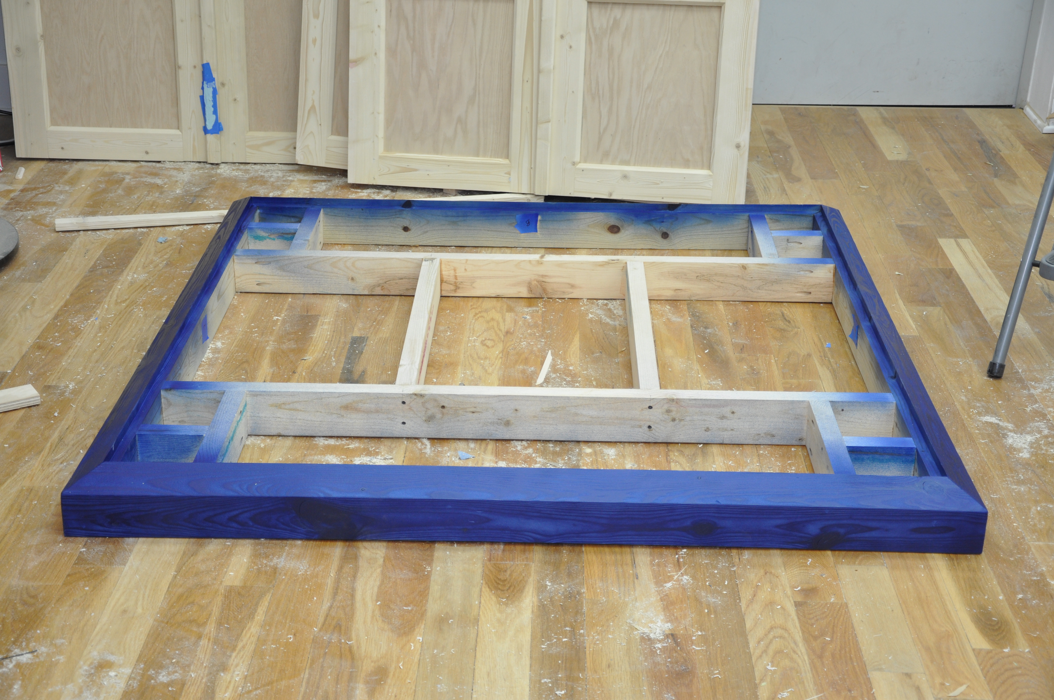

I completed the base frame today. It has four coats of paint on it. I have painted the floor insert black and will be putting a flat clear coat on it for protection as soon as I can get one of my two paint containers empty. I plan to put at least 4 coats of clear on the floor. After the black is done, I'll mask it and paint the blue on the part that's seen outside the walls and doors.

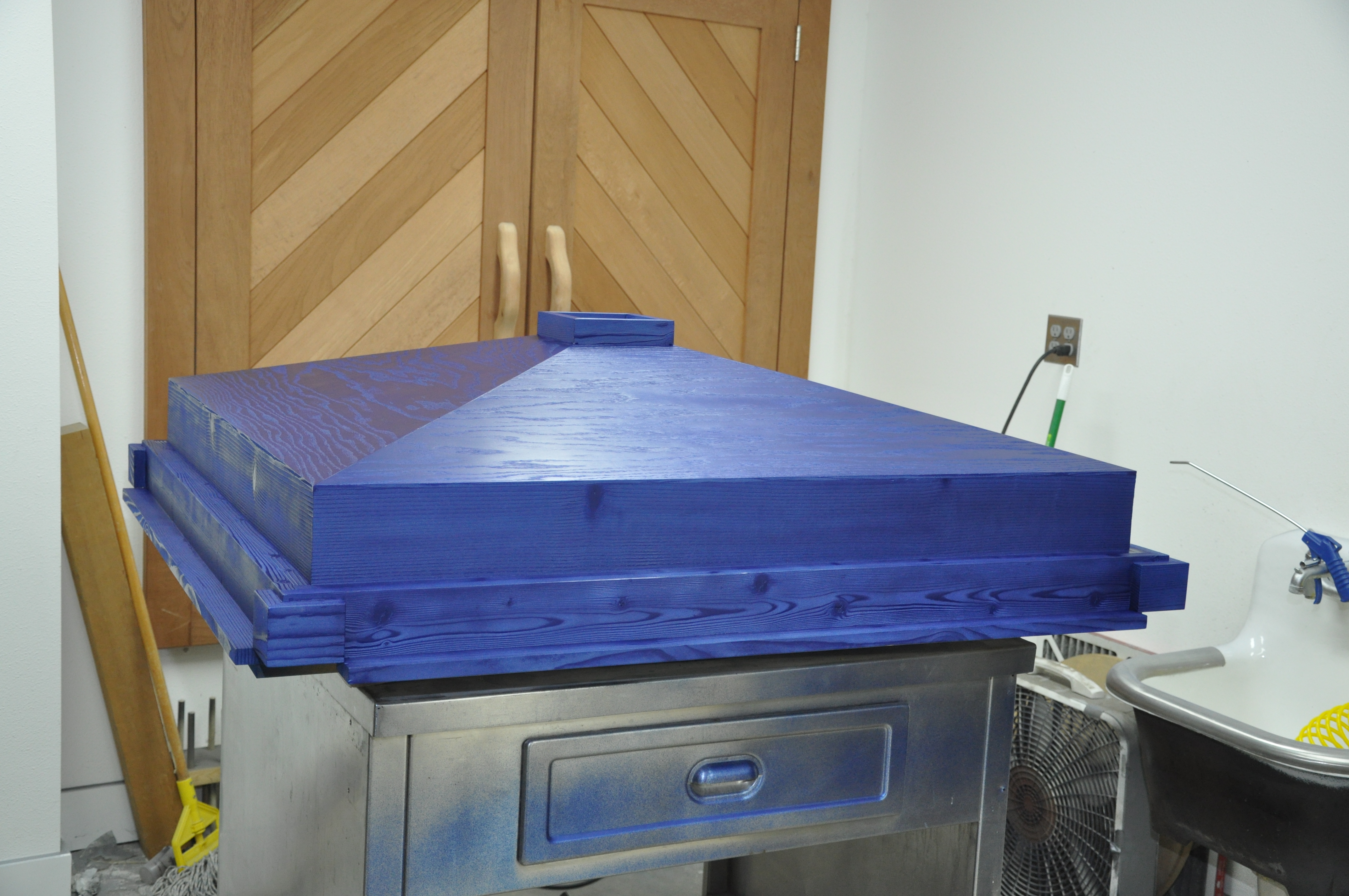

I've gone back to the roof and turned it upside down to paint the inside black, deciding to paint the bottom of the boards that sit on the sign boxes blue first, so back to blue for a bit, then masking tomorrow and painting the inside black.
The posts were completed today as well.

I finished painting the floor today, but when I went to put it on the base, I found the base outside structure boards had moved slightly toward the middle on all sides. It's the kind of frustrating thing wood can do to you when building something and was probably due to painting only the outside of the boards causing it to contract just a little, but since the corners stay fixed, slight bowing happened. So, the only fix was to slightly allow for it by trimming the floor, so tomorrow, I'll get to paint the edges of the floor again.
As I mentioned in planning, I put four coats of clear on the base to protect the black, then masked the black and painted the part that shows blue.

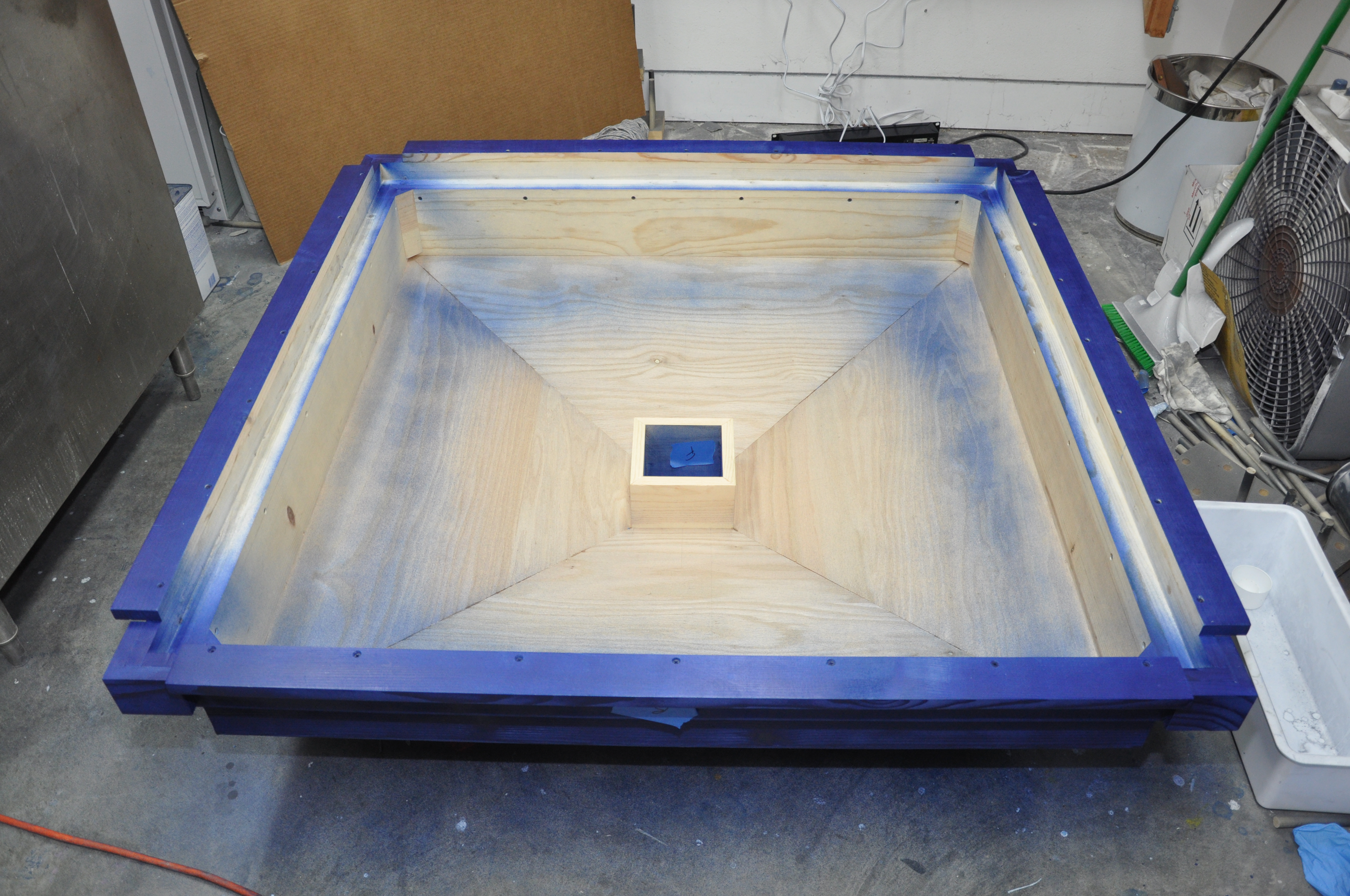

I completed painting the inside of the roof, and with that decided that, and the inside of the walls and doors would not receive clear over the black, which should make it easier to touchup anticipated bruising from transport.

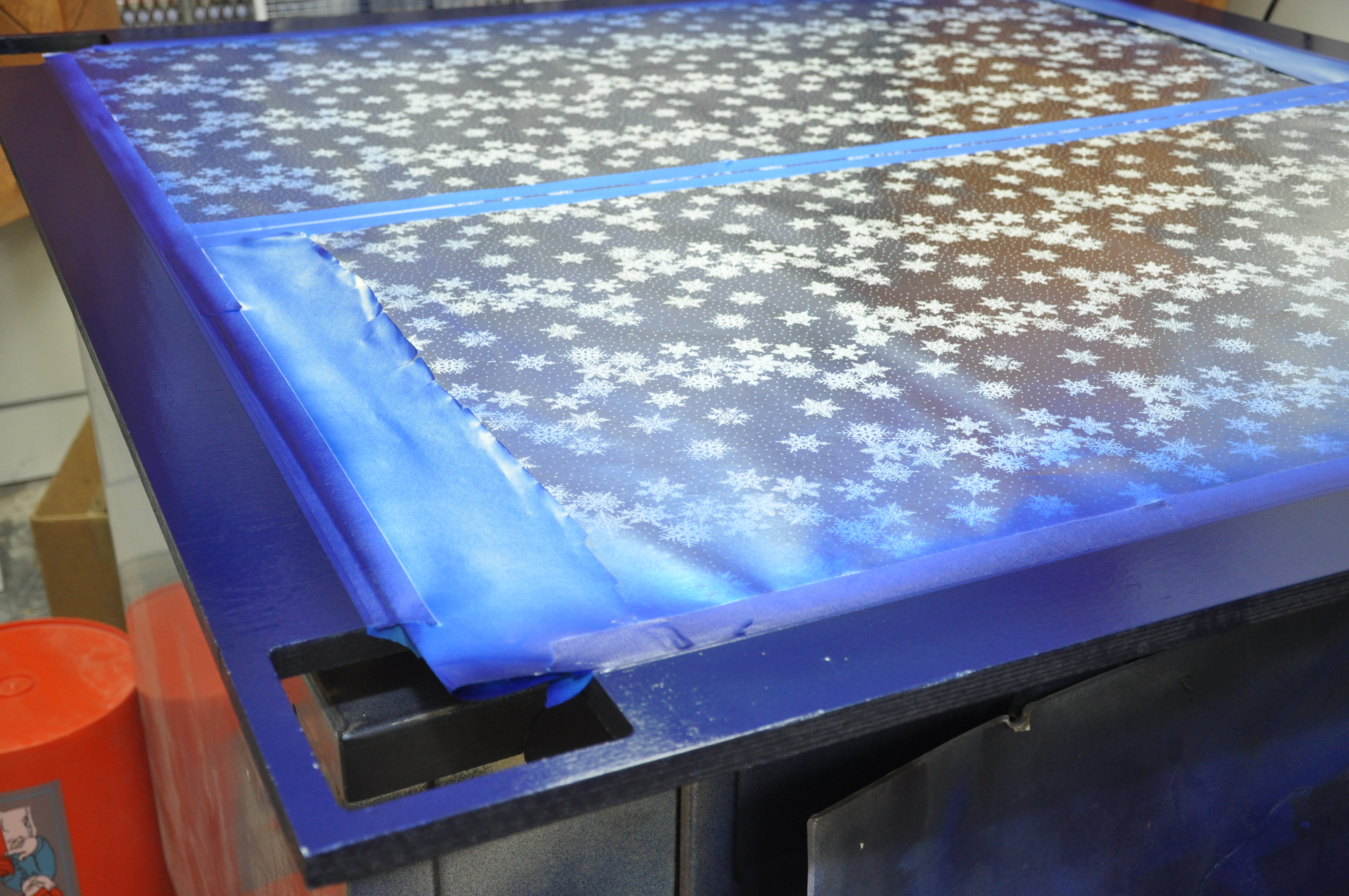

Just one photo today, this is the floor after I masked off the black and painted the edge blue.
