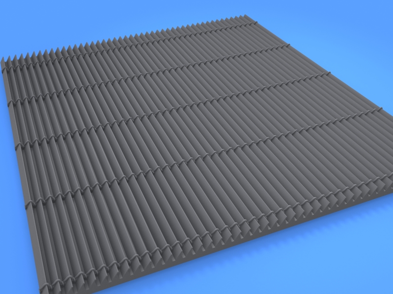

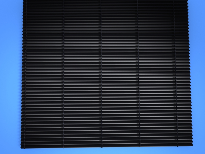

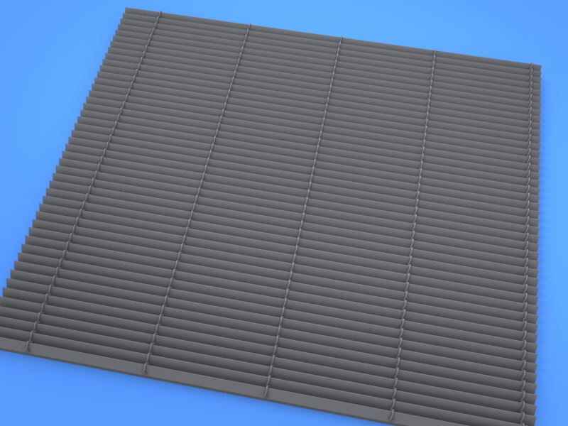

Hey Gene,
How did the Kool Shade look?
Back in 2011 I took the "virtual" Kool shade that I meticulously re-created ( from real 1970s era Kool Shade)
-and made some custom 3D/CAD ( Pro-E format for the Chinese Contractor) files for EFX/Bryan Uno to use on the Studio TIE Project.
As well as providing more accurate patterns for the Wing-Stars ( the early prototypes had "issues")
I provided them with 2 versions of "Virtual" Kool Shade for Chinese Firm; both modified, with no back-fills ... etc.
One that could the Rapid Prototyped with Stereolithography, the other could be created with CNC milling.
The second was more suited for injection molding, manufacture which EFX was considering, at the time, for this project
I am curious which they ended up using.
Great Posts by the way!
The first Render is of accurately modeled 1970s Kool-Shade with the Braided-Wire and Louvers
These were some "renders of the first version of "Virtual" Kool-Shade ( 3D/Cad Kool-Shade)
It has been "back-filled for casting and has Limited Undercuts that can be pulled for silicone rubber.
The second version ( not shown) intended for injection molding processes- has no undercuts including the Braided Wire
Your pictures look like they may have used the latter.
but it's hard to tell from the pics

Ultimately, Bryan chose to go with injection molding the entire wing structure as a single piece -

Nice Pictures!
Thanks for posting them.
I'm glad they made the changes and improvements to the Wings.
I got to examine the CAD files of the "early" version of the wing design.
This is definitely an improvement.
I agree The Kool-shade is a lot better in this version too... the first approach was too simple and all wrong in the shapes and spacing.
It looks as if EFX took "to heart " -- to all the input from you guys; Gene, Steve, John etc.
Thank goodness for your expertise on this subject
