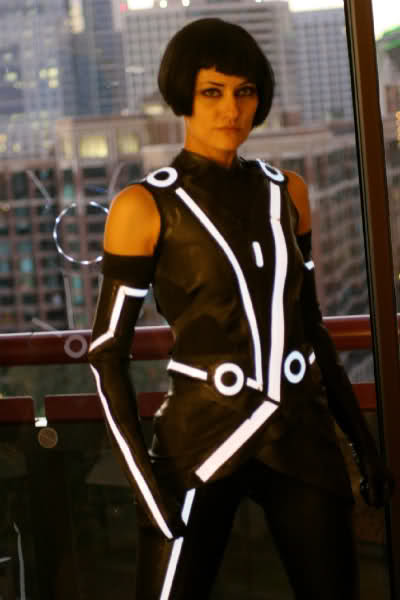

Thank SOOOO MUCH for all your positive feedback on my newly revised lighted Quorra suit :) I am really pleased with it but, it is still pressed with issues.
In regards to using LuminousFilm.com El Panel flat lite tape. Make sure your solder joints from the wire connections to your eyelets or ETCO clips, whichever you decide to use, are solid. I had two breaks from the solder joint to the eyelet and wire. Those wires are so hair thin and with the friction of walking, basically make them snap off. Freaking so annoying and sucks. I had to use electrical tape to hold the now broken off wire back to the eyelet which had my leg shorting out, blinking on and off all night long. This is where my 1st break occurred. Then the other was way later in the evening from my right leg to the boot. At that point there was nothing that could be done. Too tired to deal with it all.
Then the damn plugs. Another annoying aspect. If you don’t get those pins pushed all the way threw and a solid connection in the plug from female to male pin, that can cause more issues. I had one male pin on one end of my plug not matching up to the other end of the plugs female pin connection. I had to electrical tape the plug to hold it tight together so the male and female pins were touching. Then the plugs on my leg were so bad beyond repair with no solder or soldering iron or new pins to install in my hotel room, finally Tom, my fiancée, had to pull the plugs off and hard wire my leg wire to the chest armor where the leg was getting its power from.
Man, what a mess. I was so disgusted and tired from no sleep for days I couldn’t even get upset but, we got the suit to light up.
Now for some reason the right side only of my chest armor the bigger one inch wide light strip side from front to back was shorting out all night, I still haven’t investigated my suit to see where the short is coming from but, again, I bet you it’s a solder point that is about to come loose that's attached to a clump of wires I have soldered together in the back.
Overall despite my suit shorting out in the leg and right chest light. OMG! I got SOOOOOOO many photos taken of me as soon as I hit a dark room in the masquerade overflow viewing room and party area! It was amazing! Everyone was asking, how are you lighting up your suit? And how is it powered? I told some ppl about the RPF when it came to my disc mod that these suits and my disc mod were a group effort from members of the RPF. Not that they’ll remember all the details I am sure it was so crazy that night at SDCC but, I couldn’t leave out all the members that helped make my suit and disc HAPPEN and come to life. It really was a group effort and the RPF is definitely the main source for, I think, the world to come to and figure out how to light up and basically create a Tron light up costume.

Here’s another pic before leaving my hotel room at SDCC. You can kinda see my disc on my back reflection on the glass window. ;)
