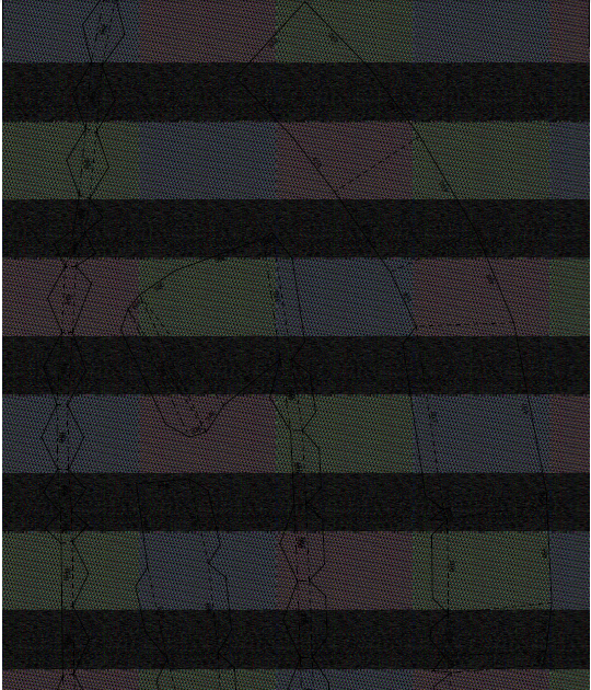

    hello, im semi-experienced in modelling(plastic model kits, legos, ect) but this is the first time ive tried papercraft. ive made three models that im very proud of, but im having trouble printing stuff. ive read 50+ random pages on this thread and i have found a couple posts that have something to do with what im experiencing.
    my first print zoomed through the printer and printed only the page number showed up. tried again, same thing, so i did what a suggestion said and changed the settings to print lines clearly but only the lines printed without textures. the model on the screen has textures which i would like to use, but it prints without them.
    i saw a question and suggestion on yahoo answers, "in the others settings, set the textures to on" and there is no "textures on/off" setting in the others settings menu.
    i was lucky enough that the first models i was doing happened to only be one page per model, and i was able to printscreen and paste to paint to print them that way,
    but im gonna try and do this http://www.mediafire.com/file/ax4ts0...Papermodel.rar which is actually 25 pages and using pepakura to print the pages will be much easier and better.
    i am not and have not had the black page printing problem.

    i would REALLY like to know why im seeing lines but no textures when printing...does ANYONE know or is this thread dead? cmon...if i printscreen and print that way, it wastes ink and the stuff is way darker than it should be and slightly pixelated. HELP ME PLEASE

    Nov 13, 2016, 8:12 PM - Re: The PEPAKURA question thread - PLEASE READ RULES IN FIRST POST! #1933
    imazombie357 said: View Post
    If you can see the textures in Pepakura designer but they are not printing, then it is very likely your printer's software/drivers. If the version of Pepakura you're using allows conversion to PDF, convert it and try printing that way.
    In Pepakura Designer (at least in my version), there is an option to turn textures on or off in the OTHERS tab across the top of the screen. If you check this to off, the textures in the 3d and 3d screens will disappear. My point is, if you can see textures on your screen, they are turned on to go to the printing software.

    Nov 13, 2016, 9:43 PM - Re: The PEPAKURA question thread - PLEASE READ RULES IN FIRST POST! #1934
    HOLY CRAP i really wish someone would have told me that sooner...i tried the print to pdf thing and WOW it prints 5x better than the way i was doing it...
    i just hope that the new prints will fit the current build...id feel bad if i wasnt able to finish it.
    sadly, it got to page 18/25 and stopped printing anything, guess it needs a break from printing all that ink. it did this earlier when i printed a bunch of pages. i waited 20 minutes, printed the new stuff and it prints better than i thought it ever could.
    is there a way to make the prints less dark though? its less dark than printing through paint screenshots but its still mega dark...id be very happy if someone could find me the snow camo version of the mech, would probably look a lot better and save me some ink.

    Nov 13, 2016, 11:15 PM - Re: The PEPAKURA question thread - PLEASE READ RULES IN FIRST POST! #1935
    Adjust your printer settings, they are what was causing the other problems in the first place. You can adjust the properties in your print menus to something with the lowest ink use, like draft. THe settings option will be in that menu, in the manual, and online.

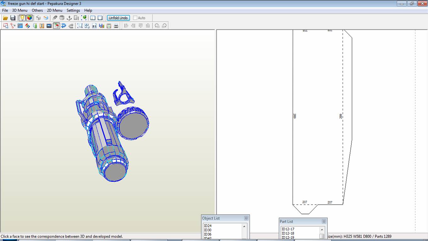

    I currently have a few models I would like to papercraft with decals or logos as separate textures used on a 2D plane floating just about the model itself. Does anyone know how or if it's possible to "merge" these two pieces of geometry in 3DS Max or Blender so that pepakura views them as one and the decal is displayed properly on the model?
  22. RPF Premium Member laellee's Avatar
    Member Since
    Nov 2012
    From
    Minneapolis/St Paul
    Messages
    2,459
    Jan 21, 2017, 4:21 PM - Re: The PEPAKURA question thread - PLEASE READ RULES IN FIRST POST! #1947
    Solidus said: View Post
    If I'm understanding you, it sounds like you're looking to apply those textures (the decals, images, whatever) to the actual pieces so they print in the correct spots in Pepakura? If so, here's a couple of ways to do it.
    First one, you would UV unwrap the model in your modeling software, this will give you a 2d template of the model that you then would use in Inkscape/Photoshop/whatever to add your decals to. That then gets plugged back into the modeling software where you can apply it to get your images on the model, and then you can export the model and materials for Pepakura. If it sounds like a lot of work, it is if you are not familiar with how all of that works. There are other ways to do this right from within the modeling software that could work, but once again it will take a bit of youtubing and tutorials to figure it out if you are new to UV work.
    Second one, and this might work a lot better for you if you are only adding a few decals on flat surfaces, is to do it right in pepakura. Once you have your base model in Pepakura, scaled and unfolded, you can manually import images, rescale them, and place them manually on the unfolded 2d templates. In Pepakura, you go into (if I remember right) 2D MENU>IMPORT IMAGE, that'll let you get your logo/decal/whatever into the program. After that, you can relocate it and orient parts to make it print where you want it on the paper templates. This is a workaround that won't help you too much ion curved and complex surfaces, but it's a fast way to do something like adding a label to a can of beer/whatever.
    These are not the only two ways to do this kind of thing, these are just two that I've personally done.
