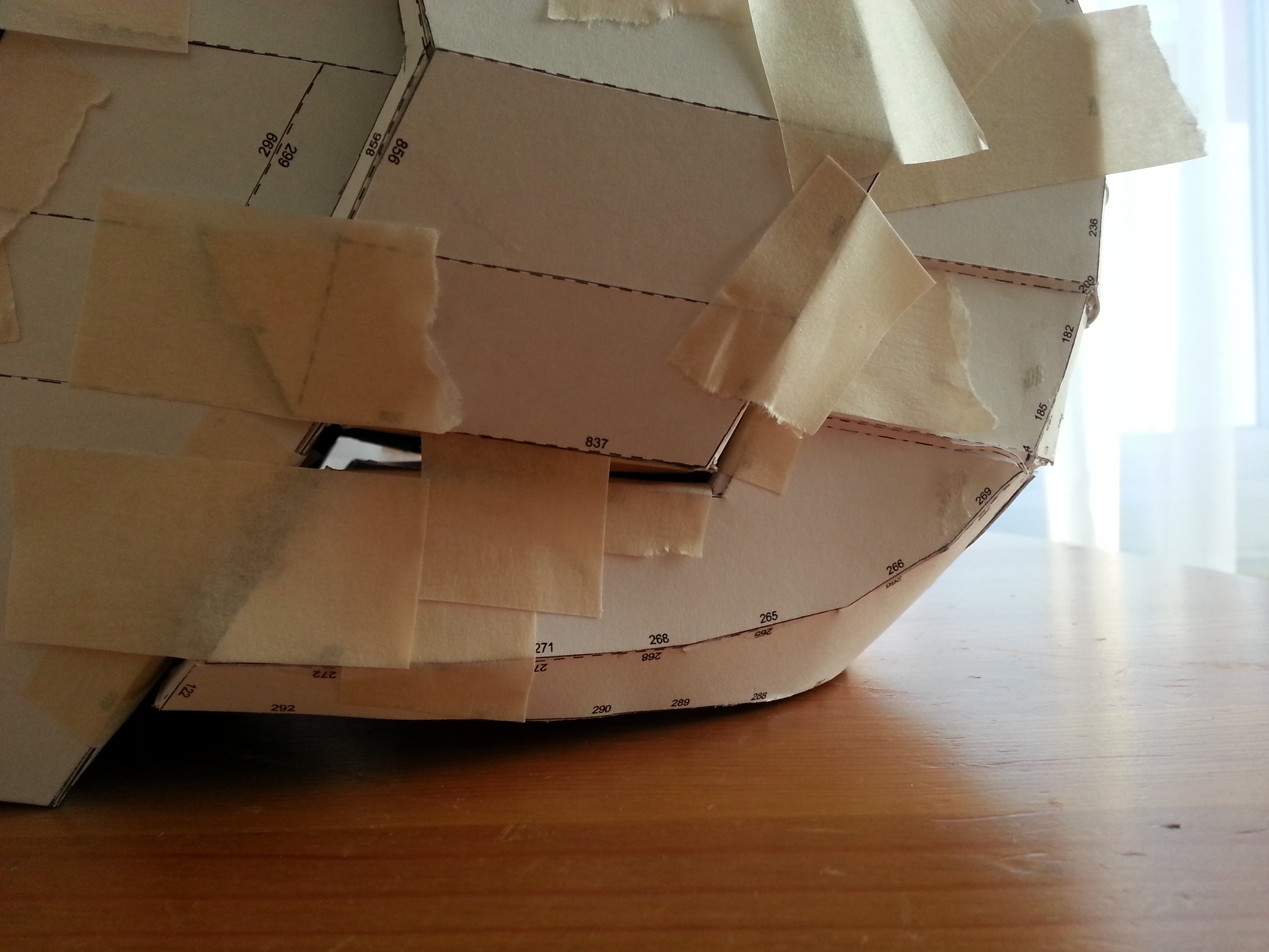

However as I was about to start my resin coat, I noticed this little hiccup that im not entirely sure how it happened, but how would I fix this:
The gap between the 2 sections would need to be filled and shaped.... would I use the body filler for this too?
Was that a REALLY noob-y question
The helmet will be held together by magnets also, if that adds any kind of I dunno :s - #newatthis
That looks like a pretty wide gap, Bondo could be used but I wouldn't for a gap that big. If you can, I would close the gap using a tape on one side, and then 'freeze' it into place with resin on the other side. After it cures, you can pull the tape off and then continue resining. Another option is to resin and fiberglass the entire helmet in one piece, and then dremel it into pieces after you're done. That can be a hassle to get a clean seam cut depending on what you're using, though.
Either way, try and close that gap up first with temporary taped areas or whatever else you have available, then resin it up. I'd be worried that just filling the gap in with filler would also look screwy later, and also cause other problems to have a clean connecting surface between the pieces. You can still use bondo for imperfections and to fine-tune your edges, but the less the better.

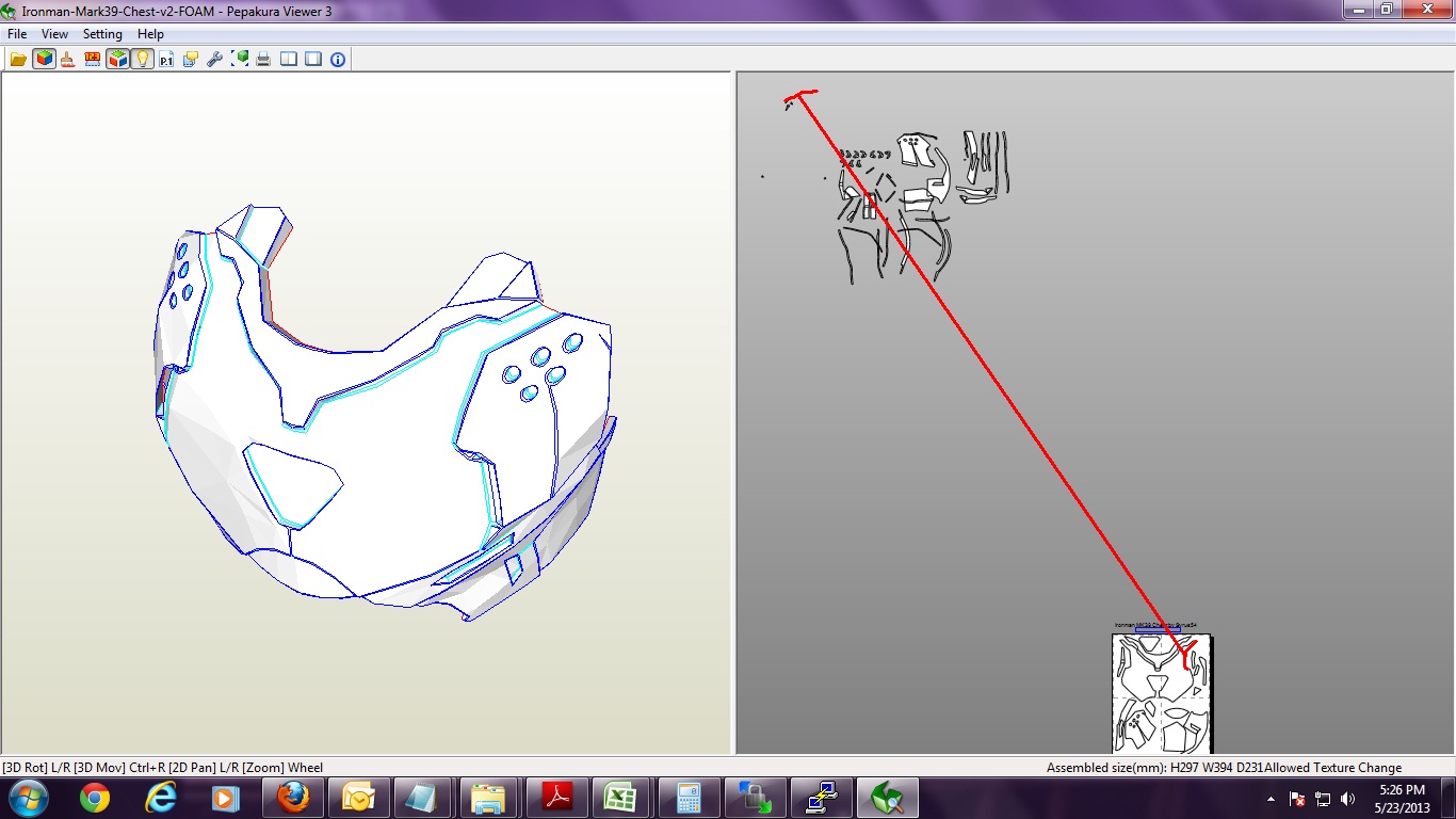

does anyone know why the template. outside the paper? i'm noob in pepakura.
why should i do with this? is it okay if i go straight print the template?
your help will be greatfull. sorry if my english bad :D

Hi Becks, this template was made for building a foam armor, that is why there are some pieces outside the pages.
You only need to print the pages, and transfer them to the foam.

Oww..i see..thanks for your help pola..
