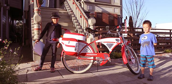

Hey guys. More help please. Looking at getting the spray nozzles that go on the bottom of the saddlebags. Does anybody know where to source them? I thought I saw something posted in this blog. Otherwise I will create them. Thanks in advance! I got my bike together and took it to a bike shop for some alignment help and a more sturdy kickstand. Here is a semi good shot. Pee Wee Outside.jpgpee wee at bike store.jpg
