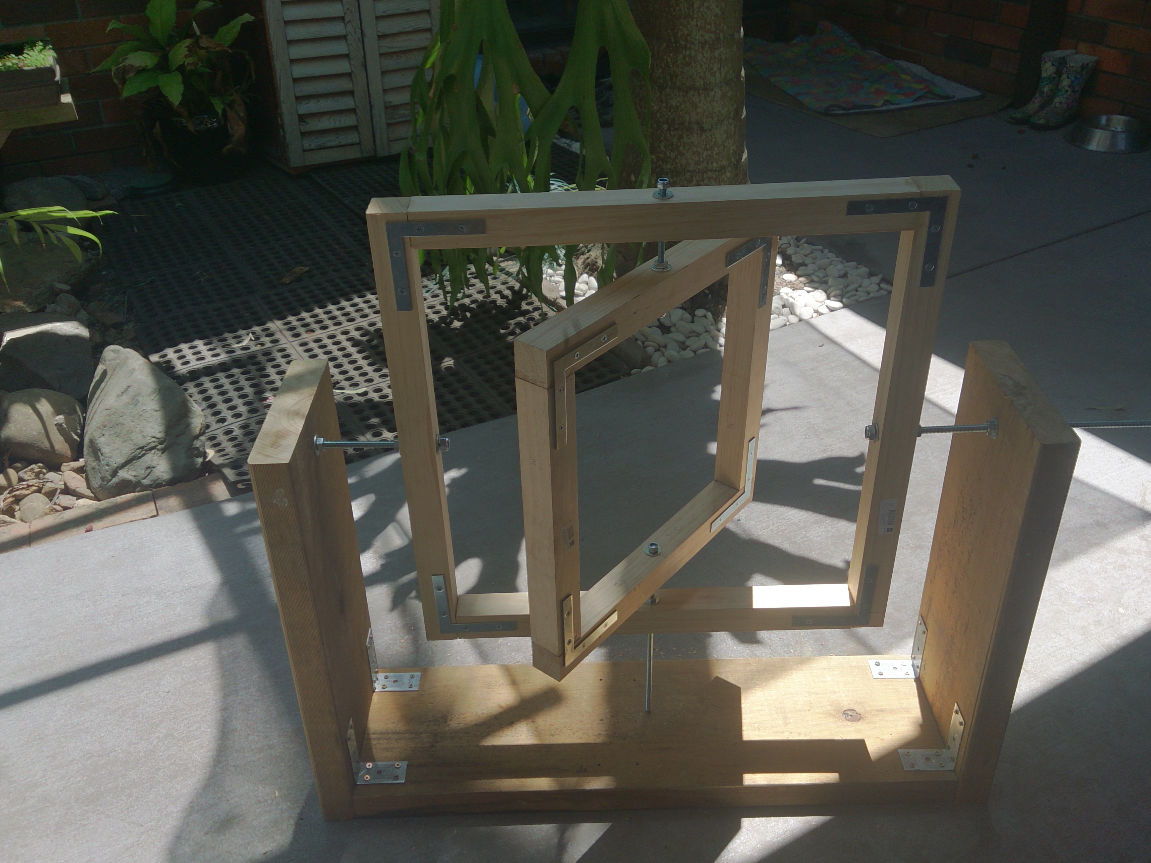

Hello Ive just been building the one from instructibles here Make A Rotational Casting Machine For Under $150
Its nearly done.
Just waiting for my chain wheels.
I altered the pattern to be larger so the mould fitted.
Will post it when its finished & then the casts that come from it of the SS Raider Fuselages
