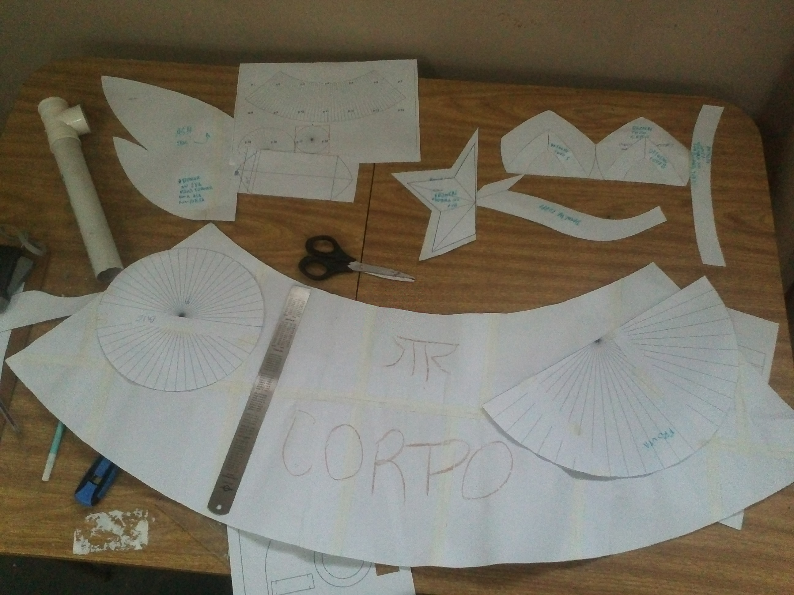

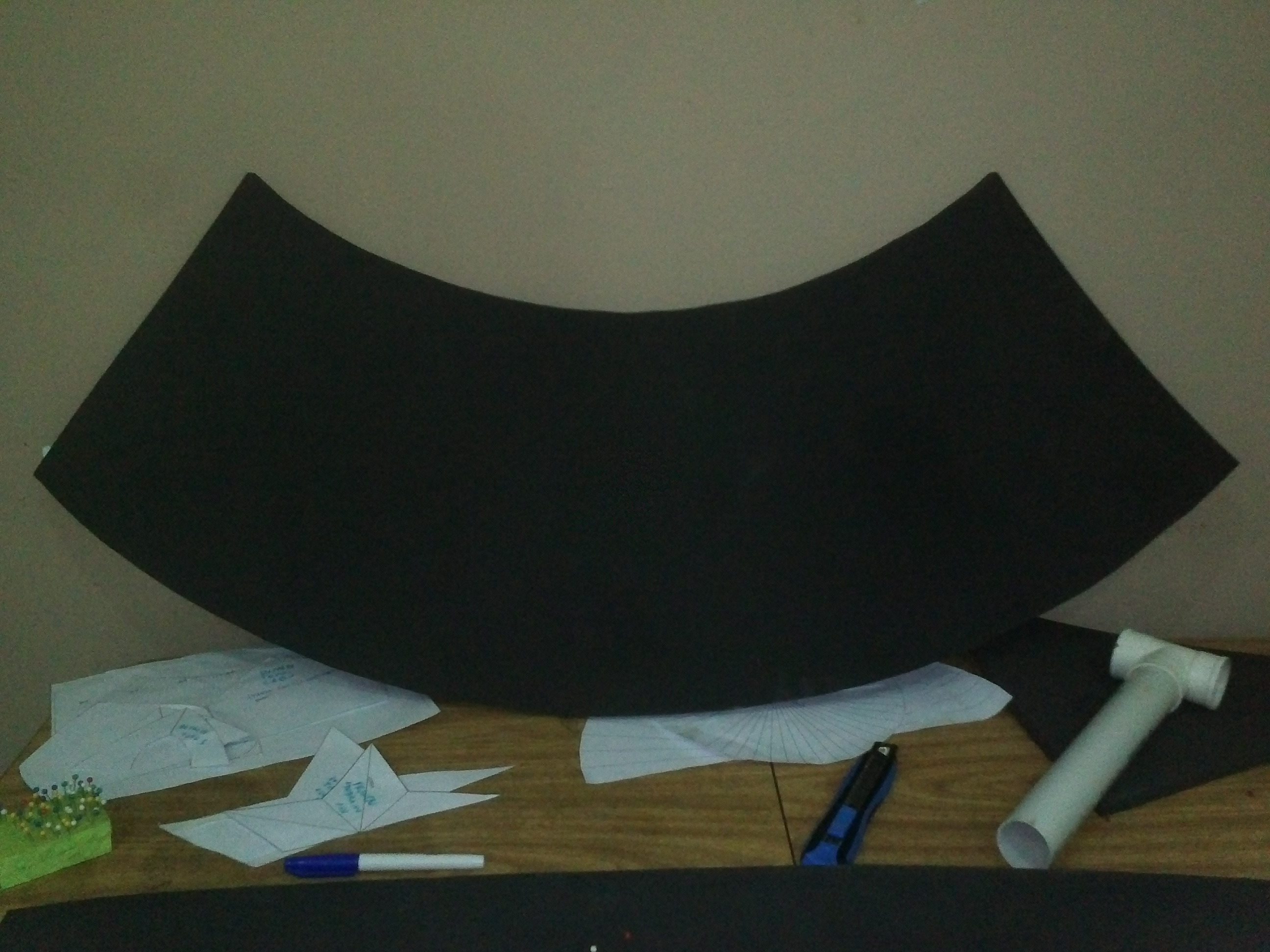

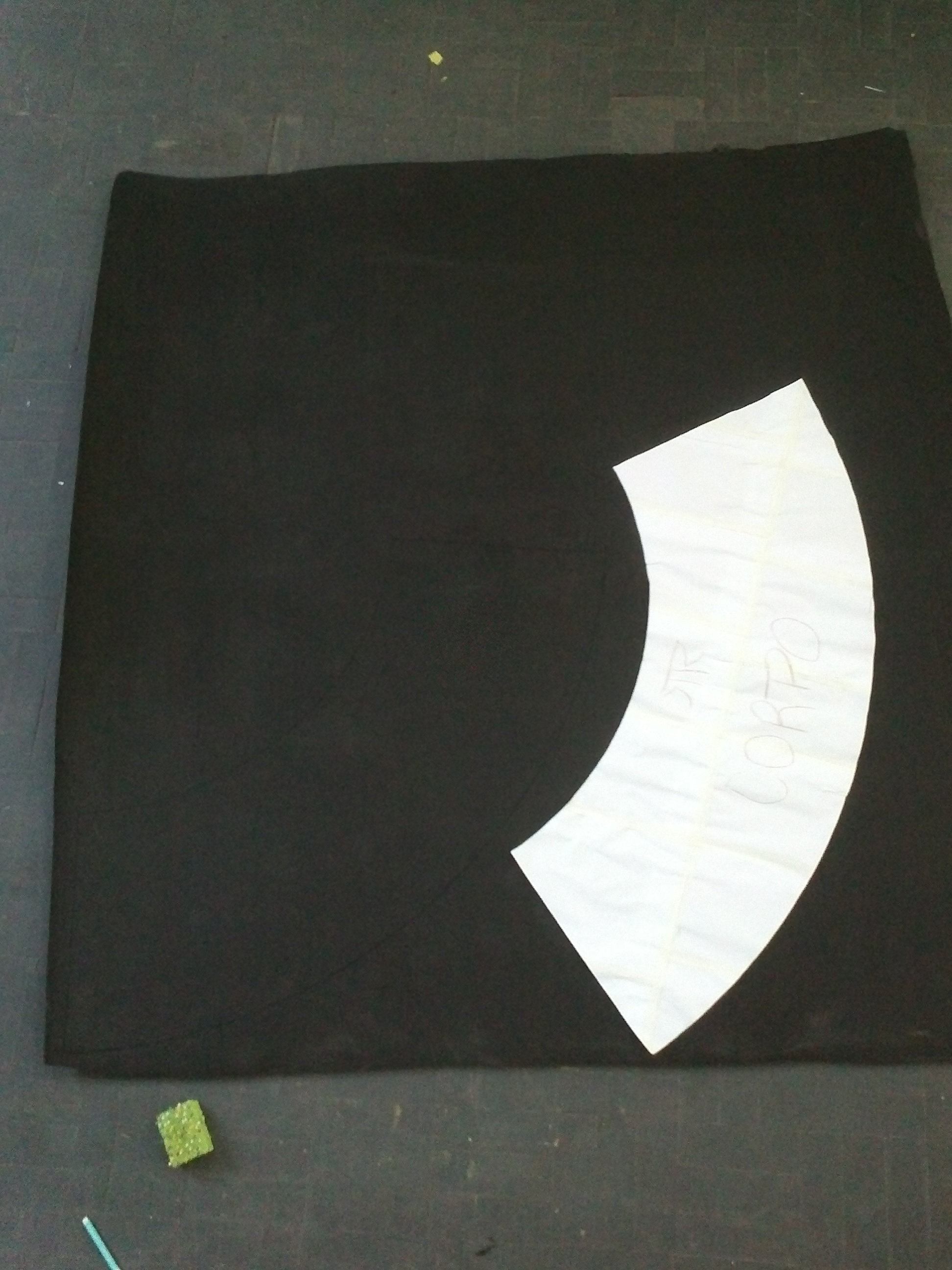

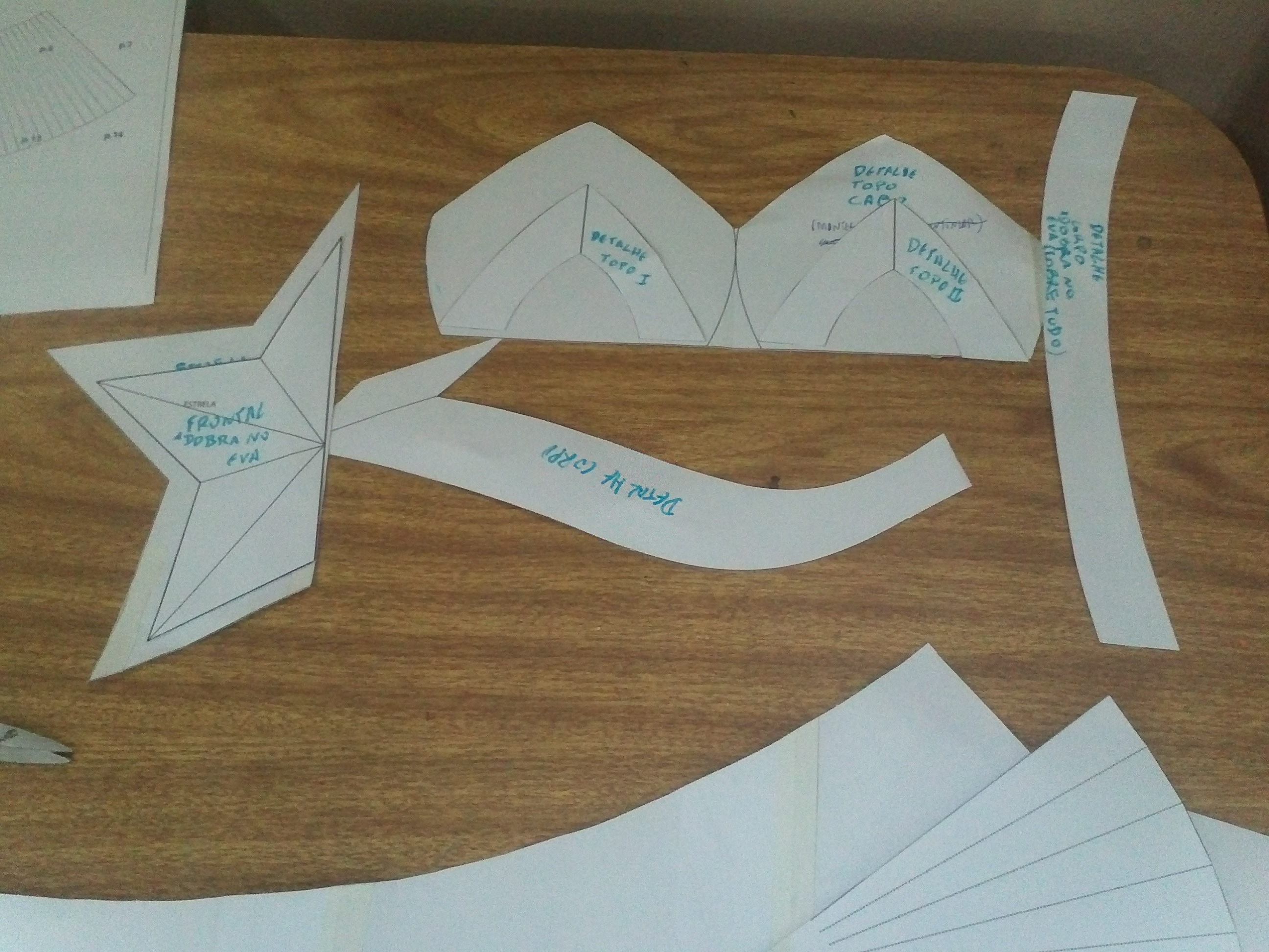

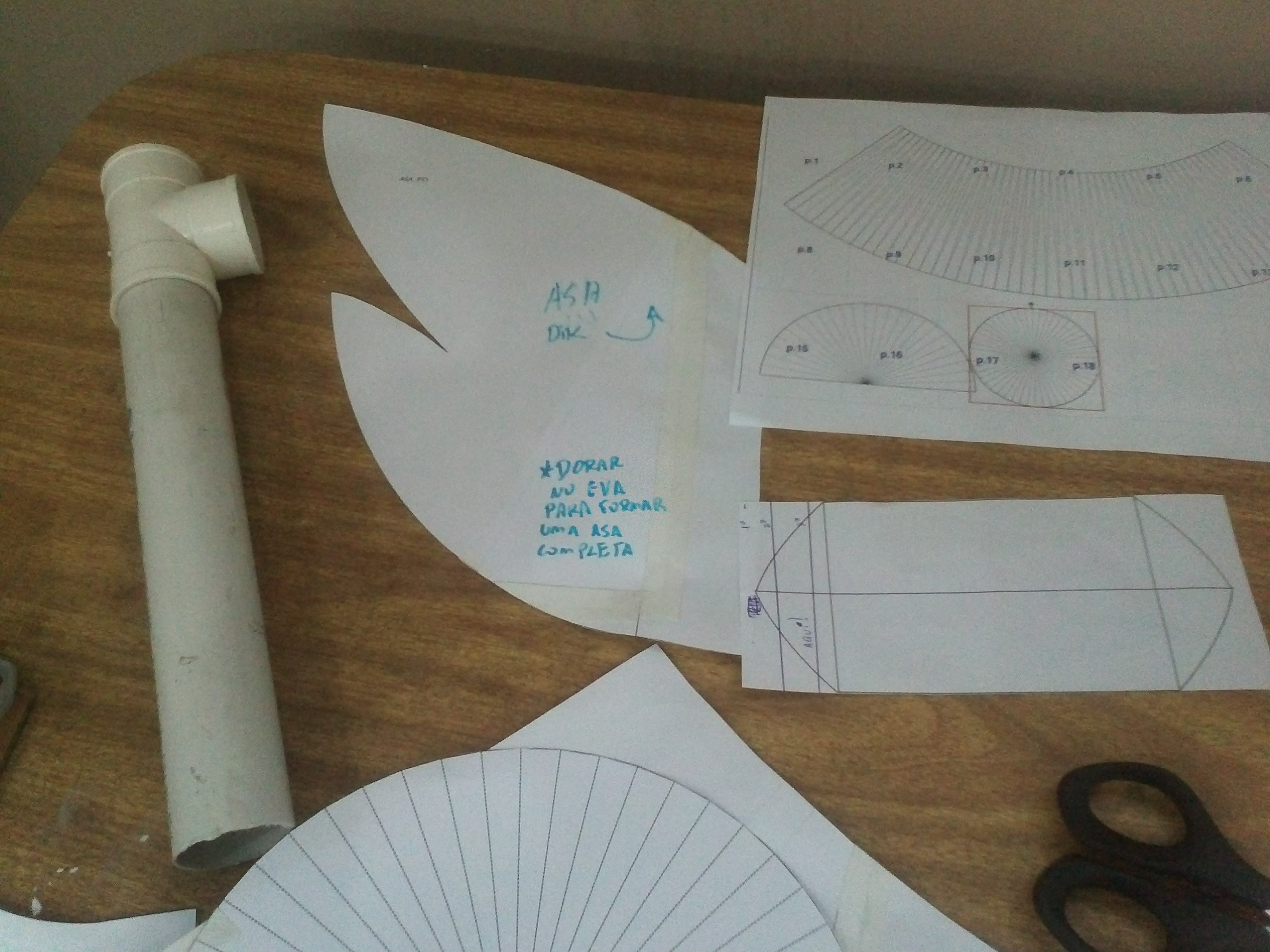

I started doing a main body 3D sketch then sent the .obj file to pepakura just to get the pattern. The other patterns I made using Inkscape, printed all of them and traced to the eva foam.

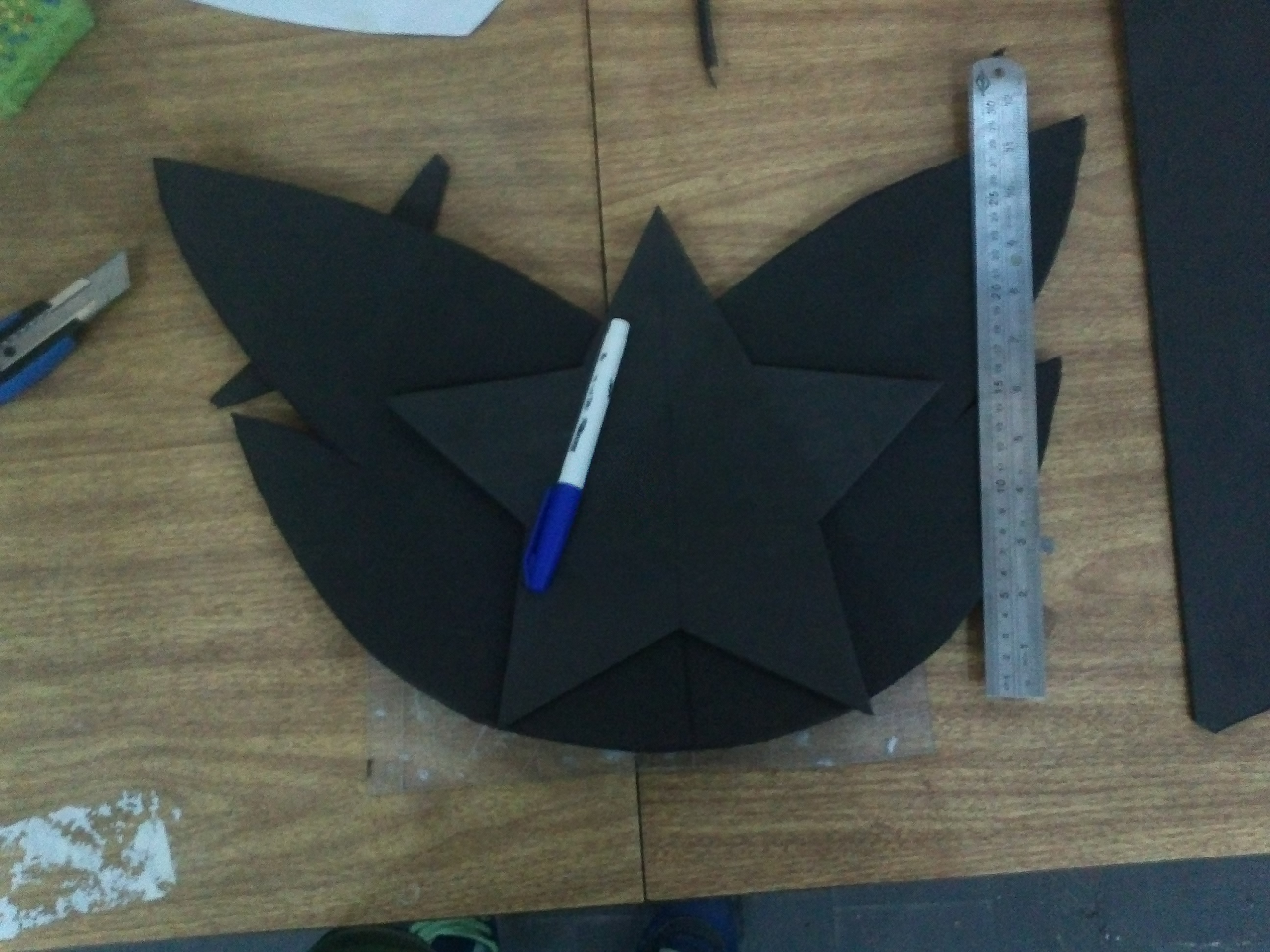

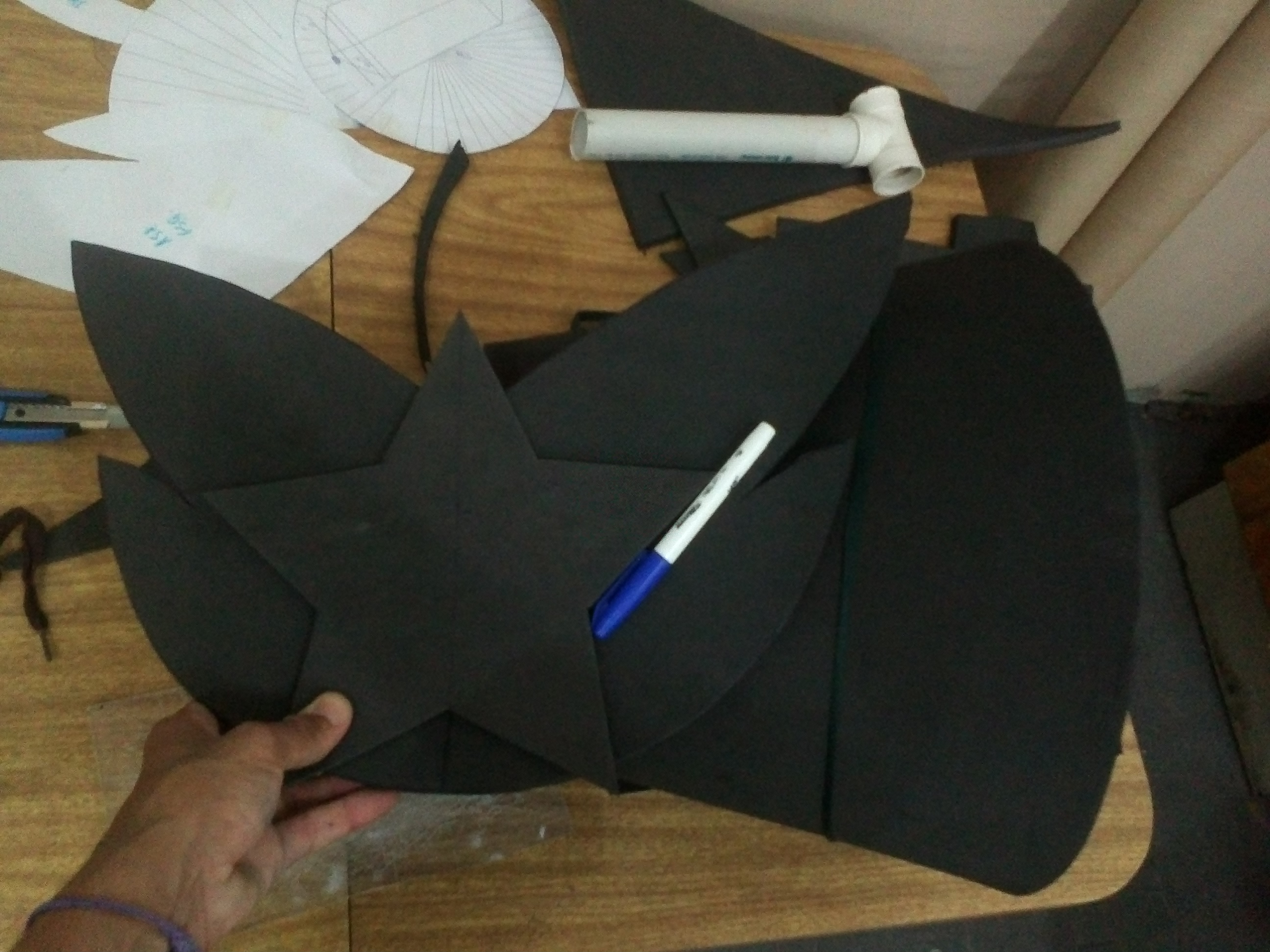

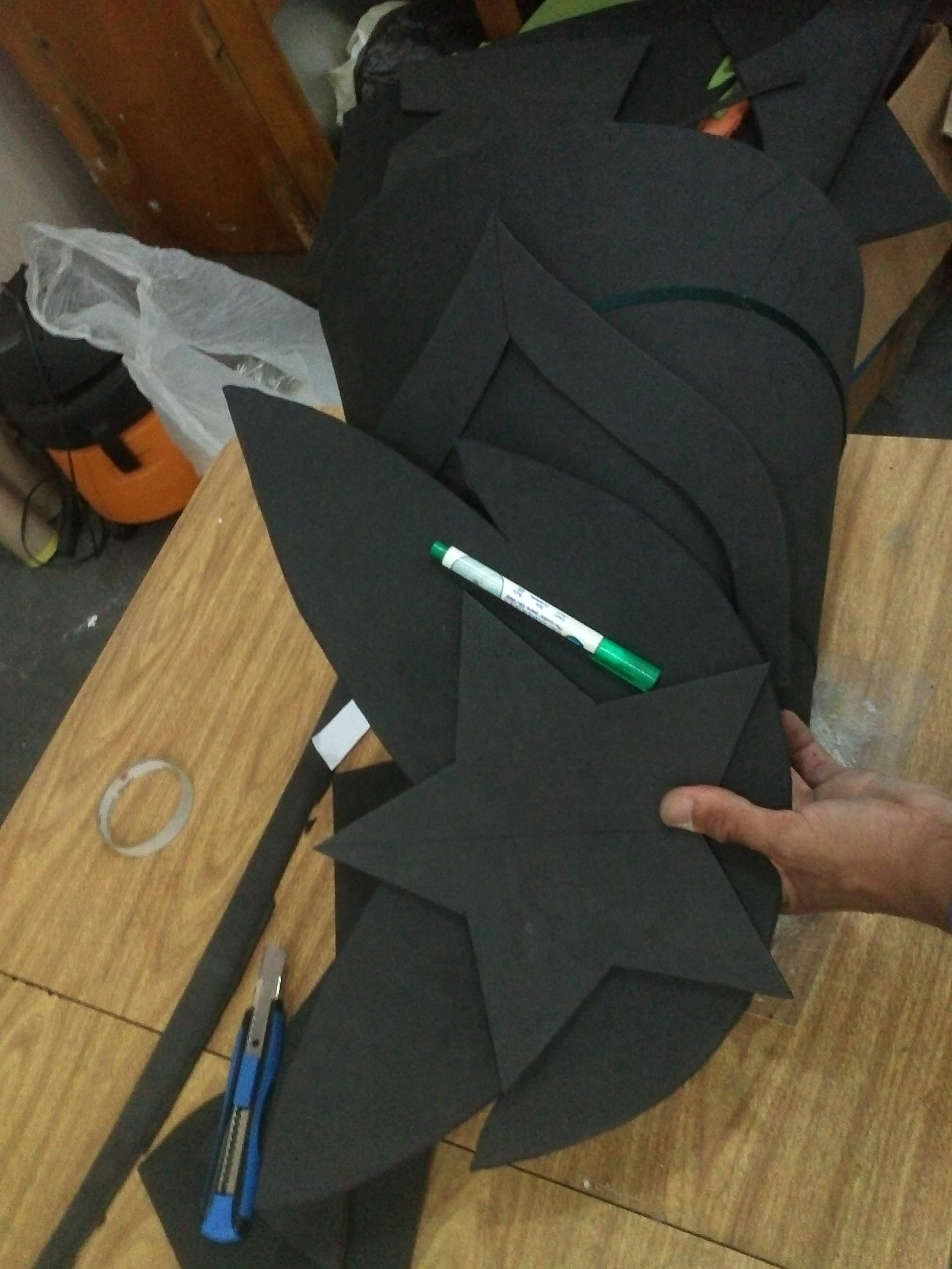

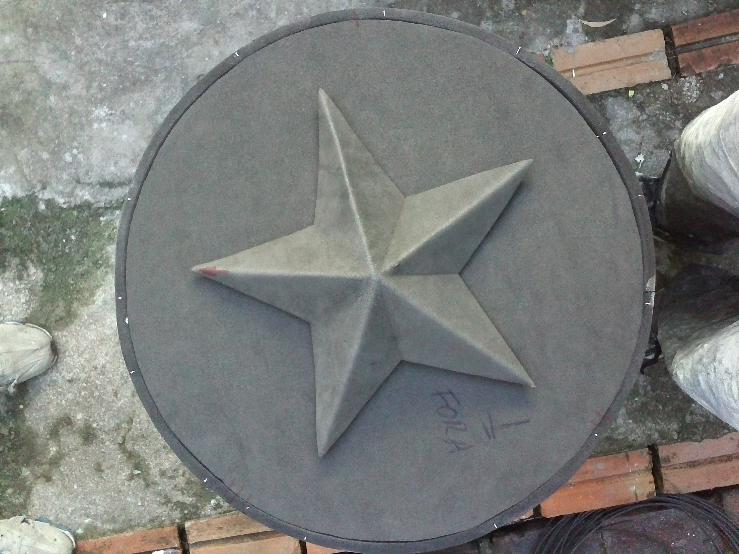

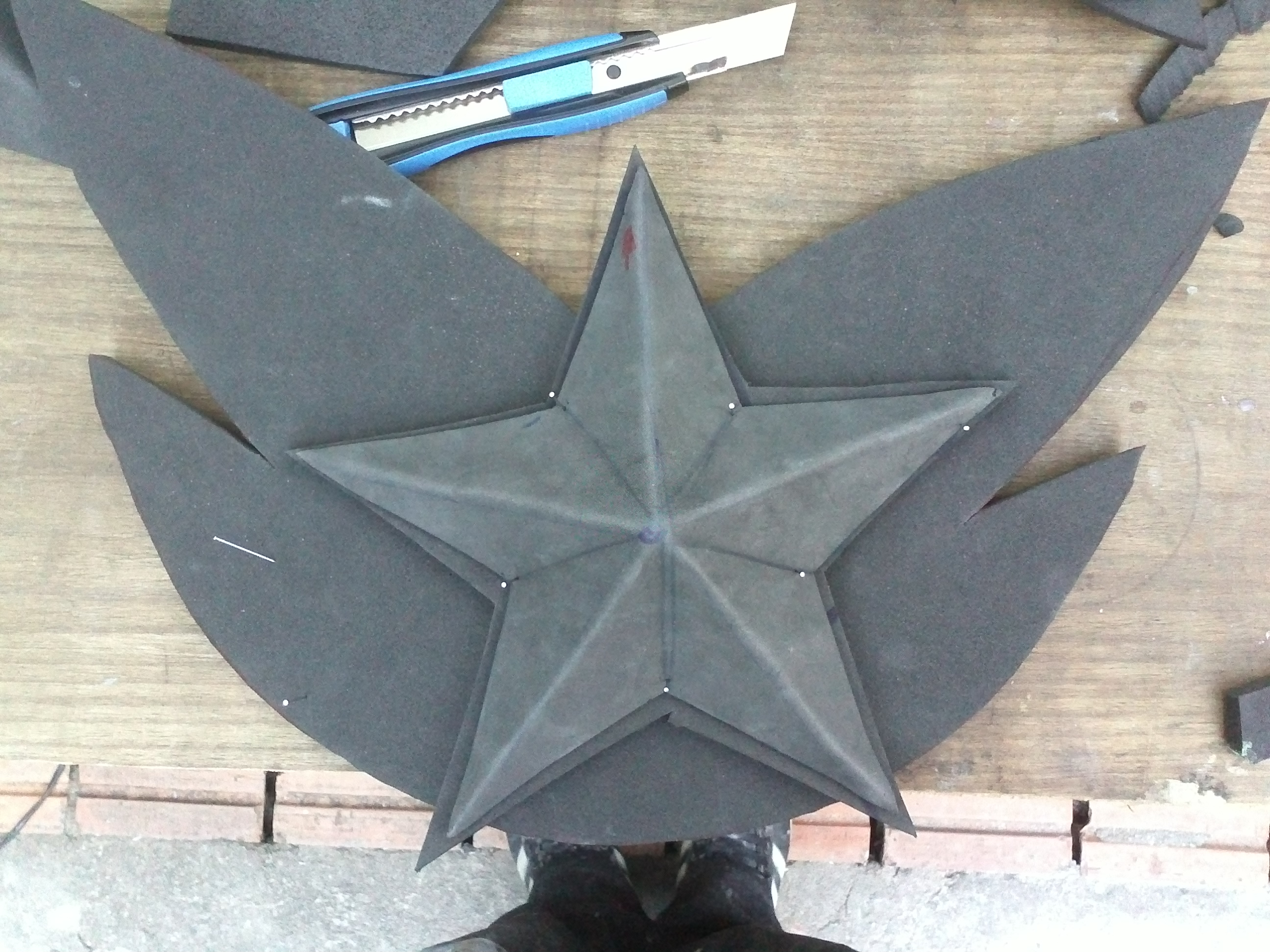

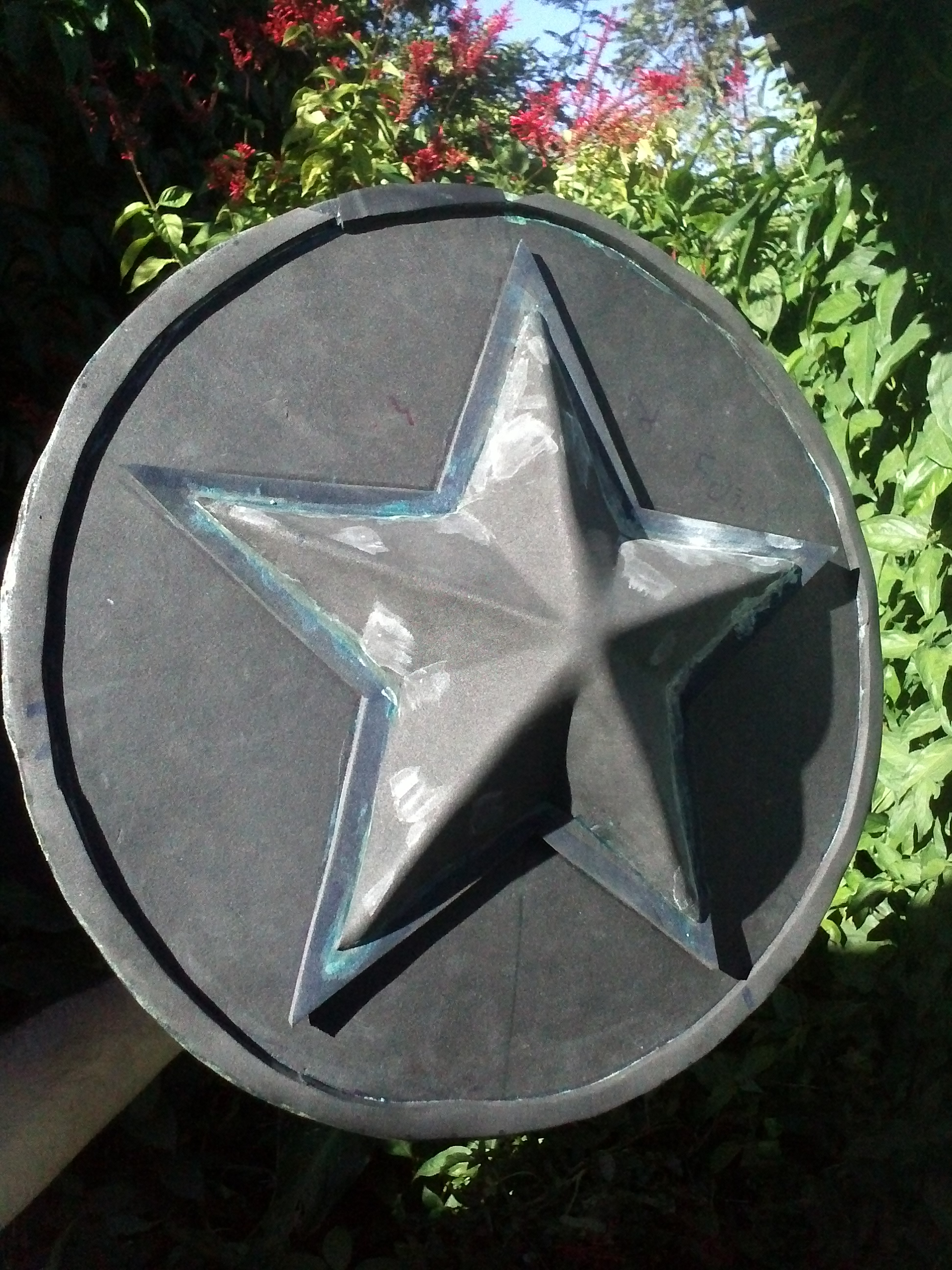

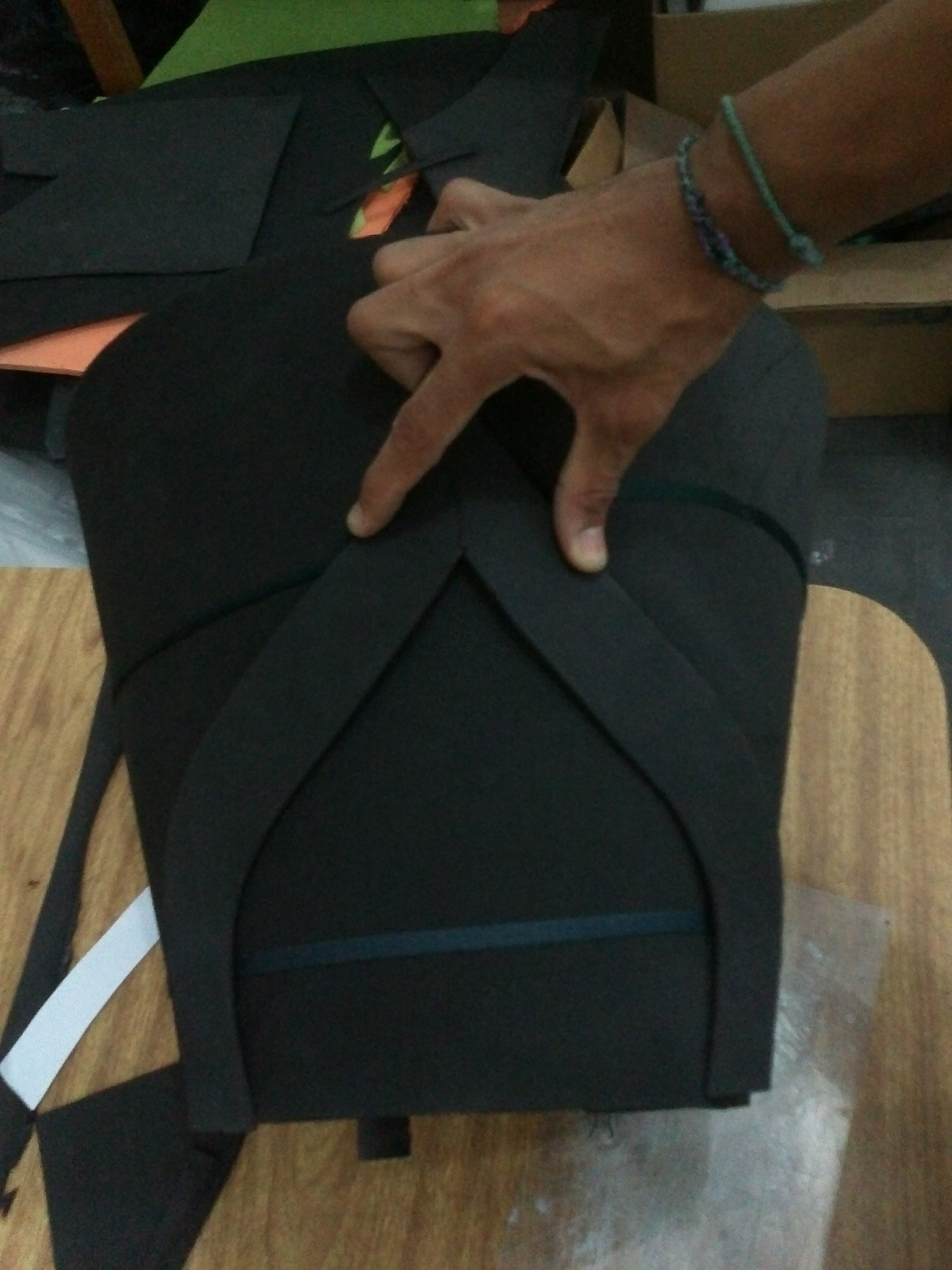

For this build, I used 10mm (main body, wings and star base), 5mm (stars) and 3mm (details) eva foam

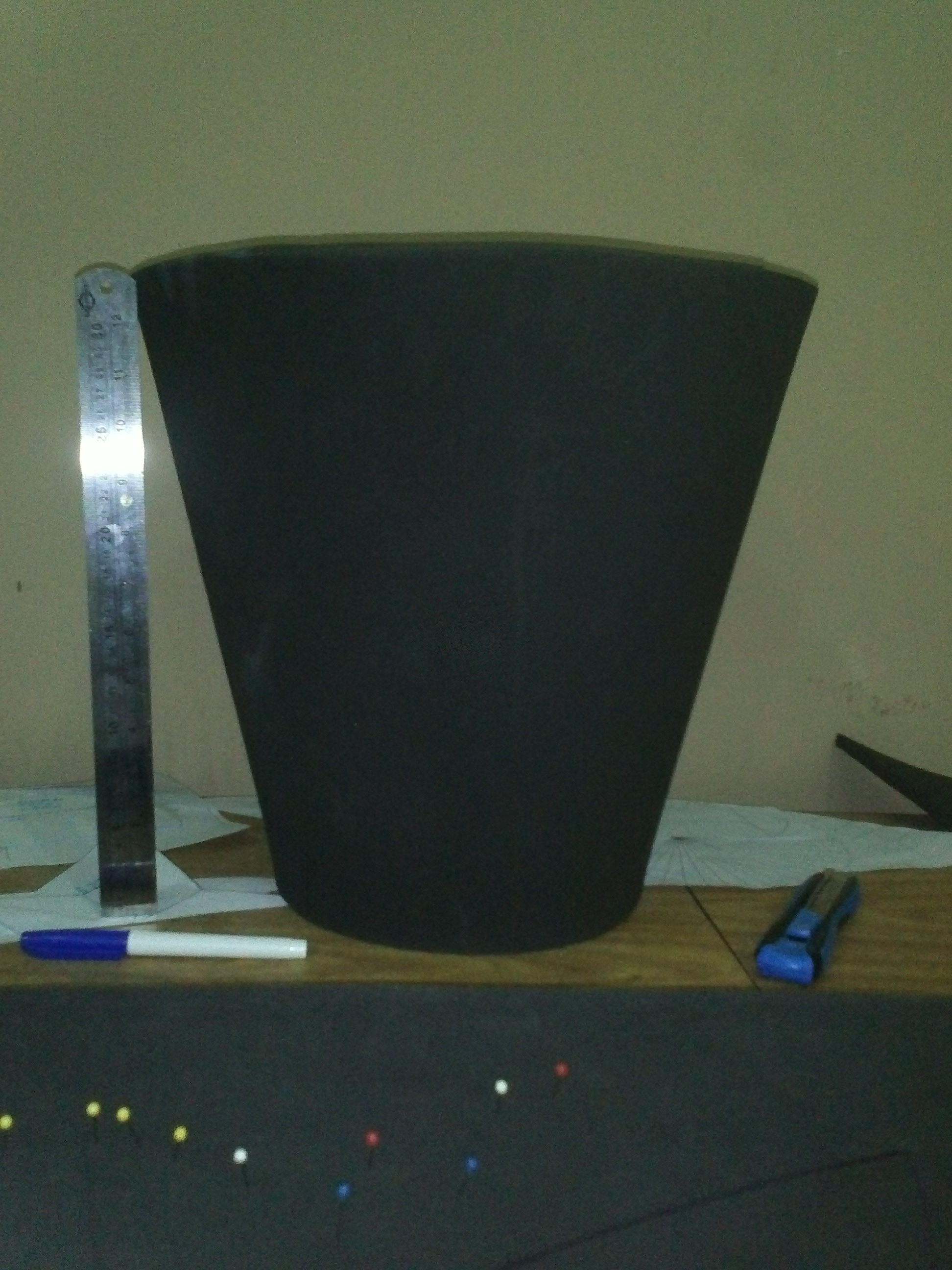

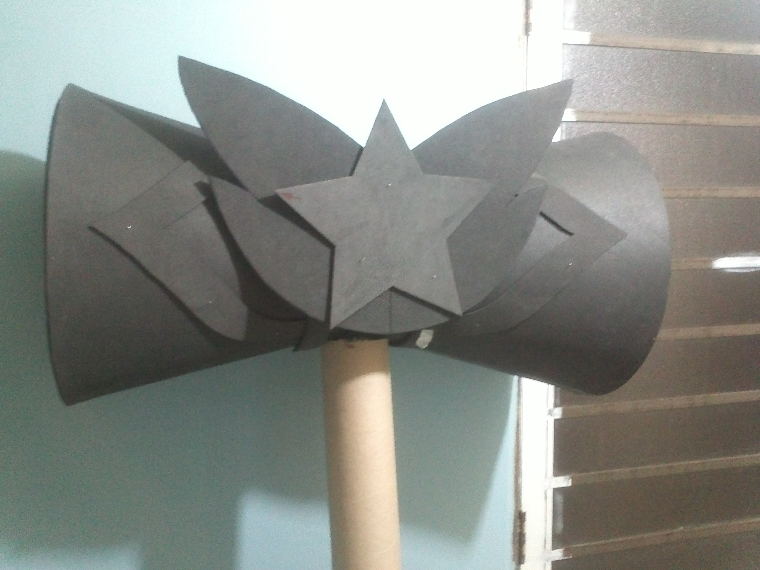

A little test to see the scale.

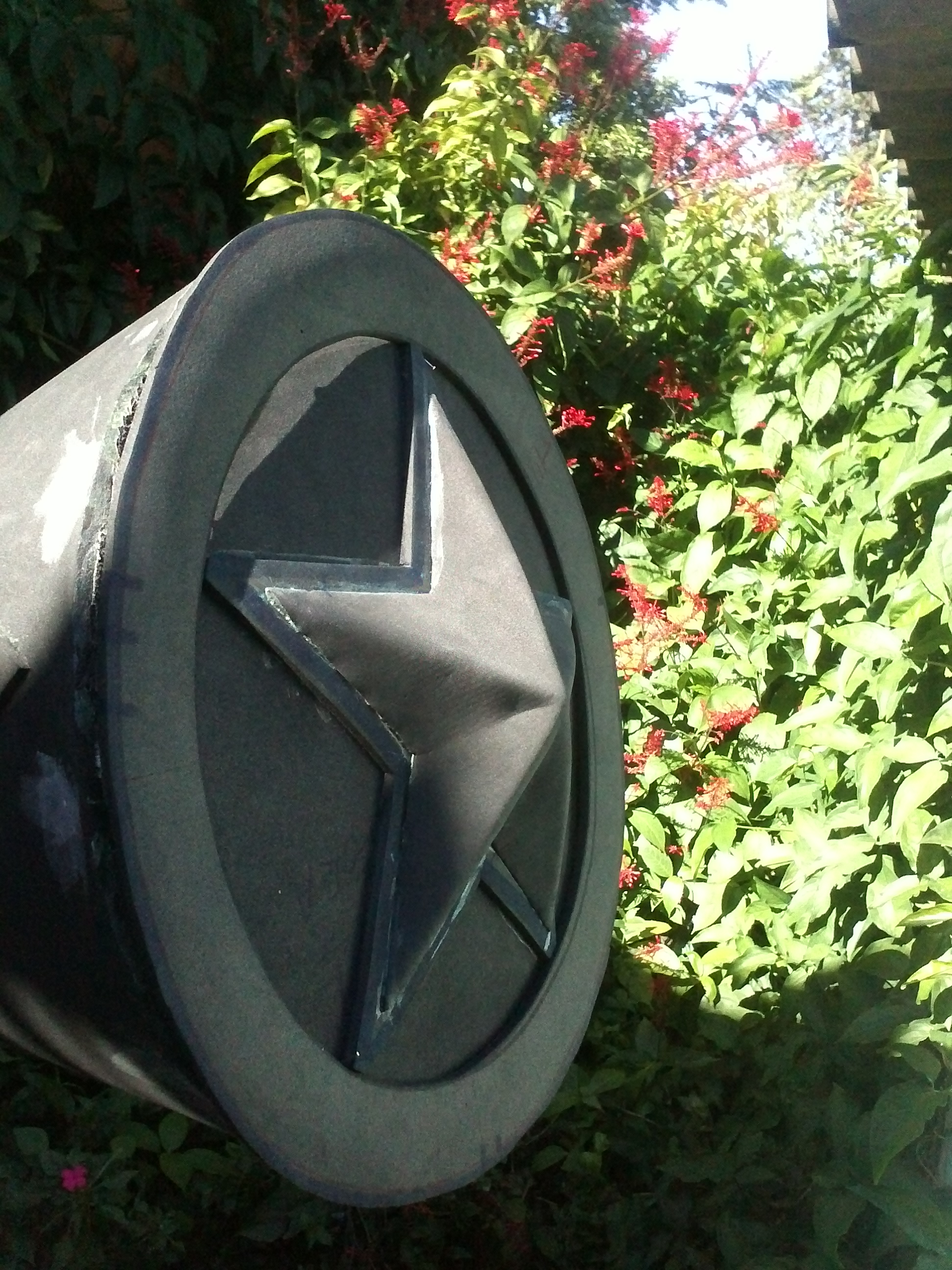

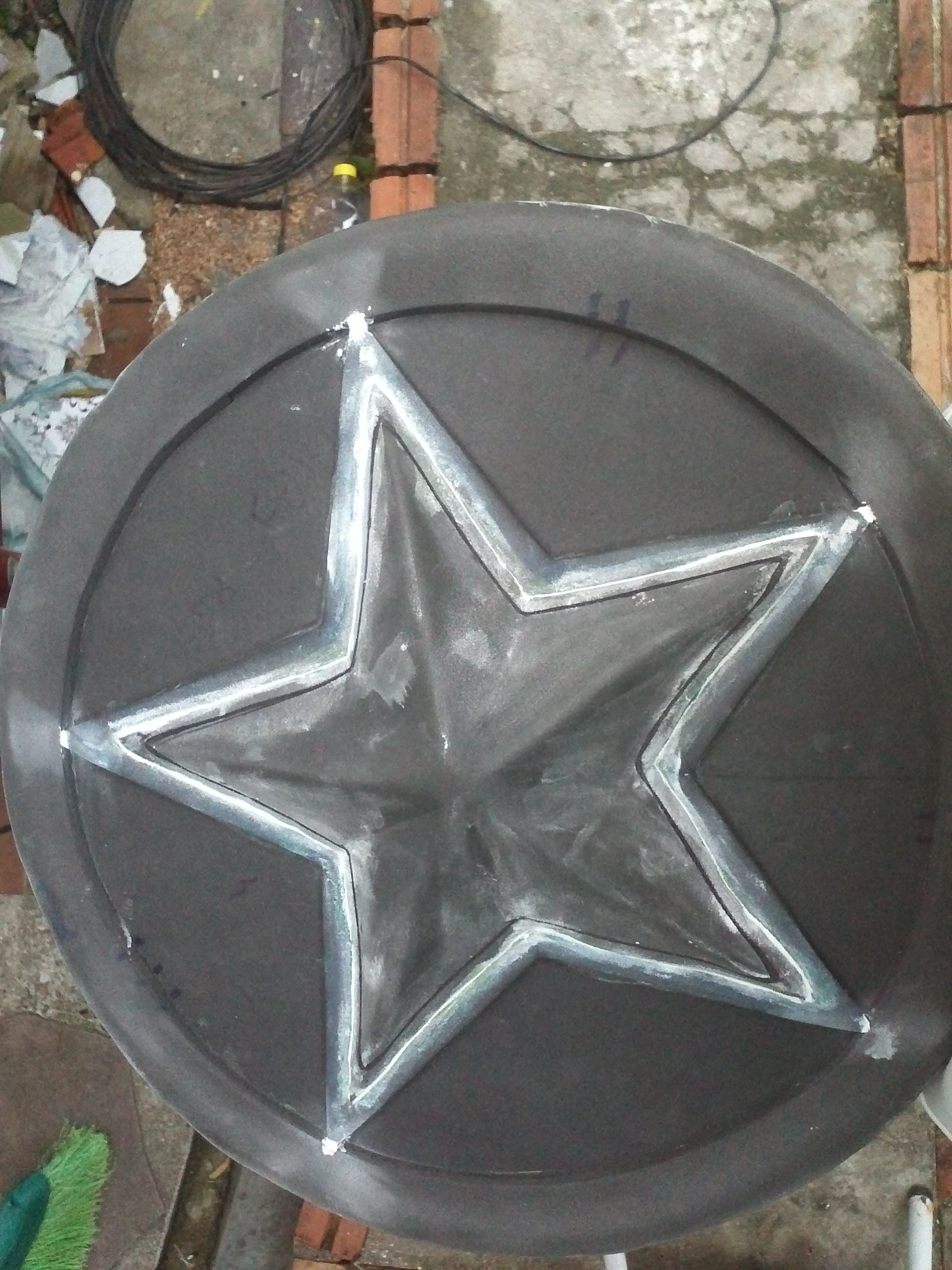

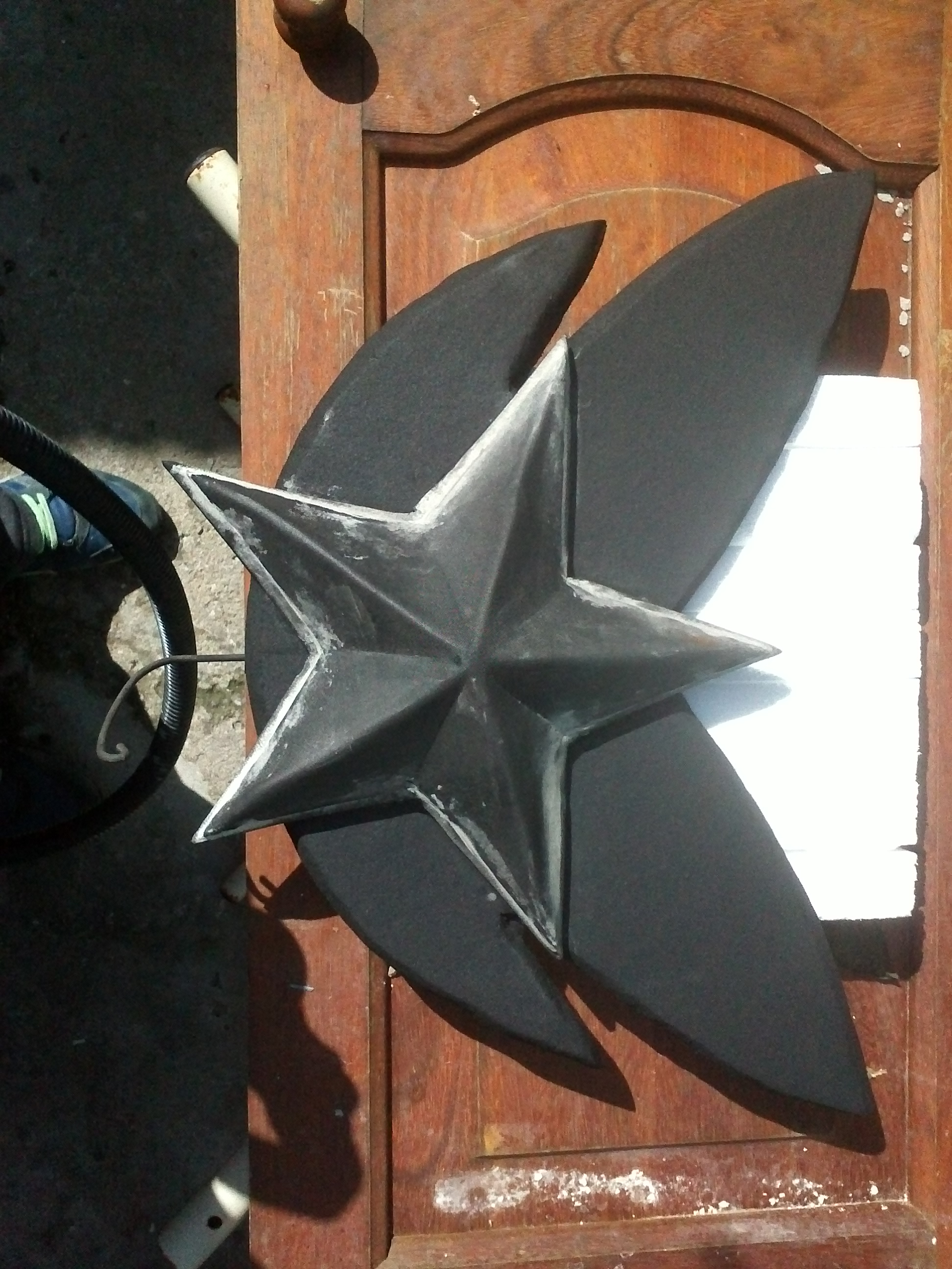

With all parts ok, I started gluing using a contact cement, sanded some edges and used some quick seal to fill the gaps

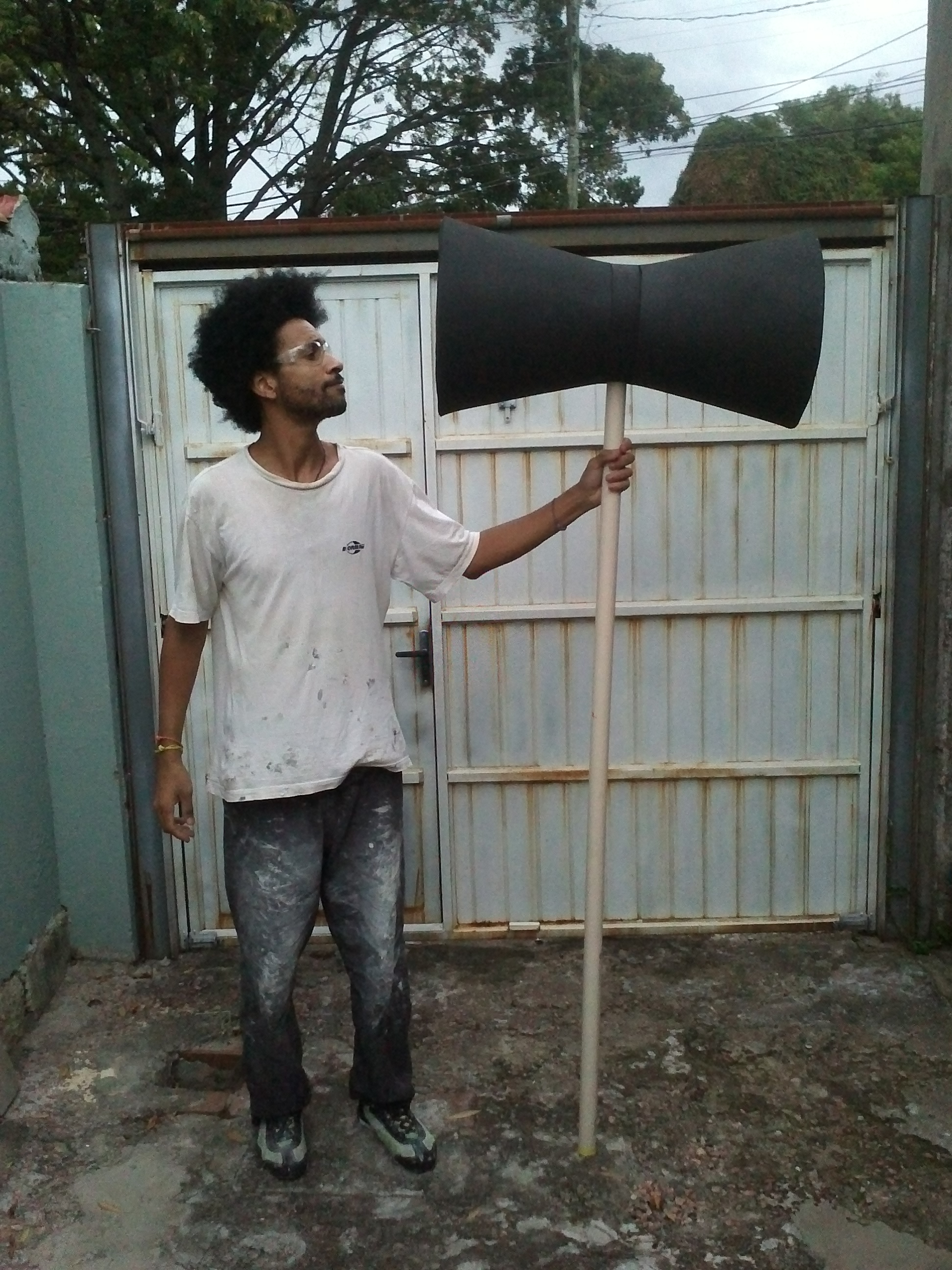

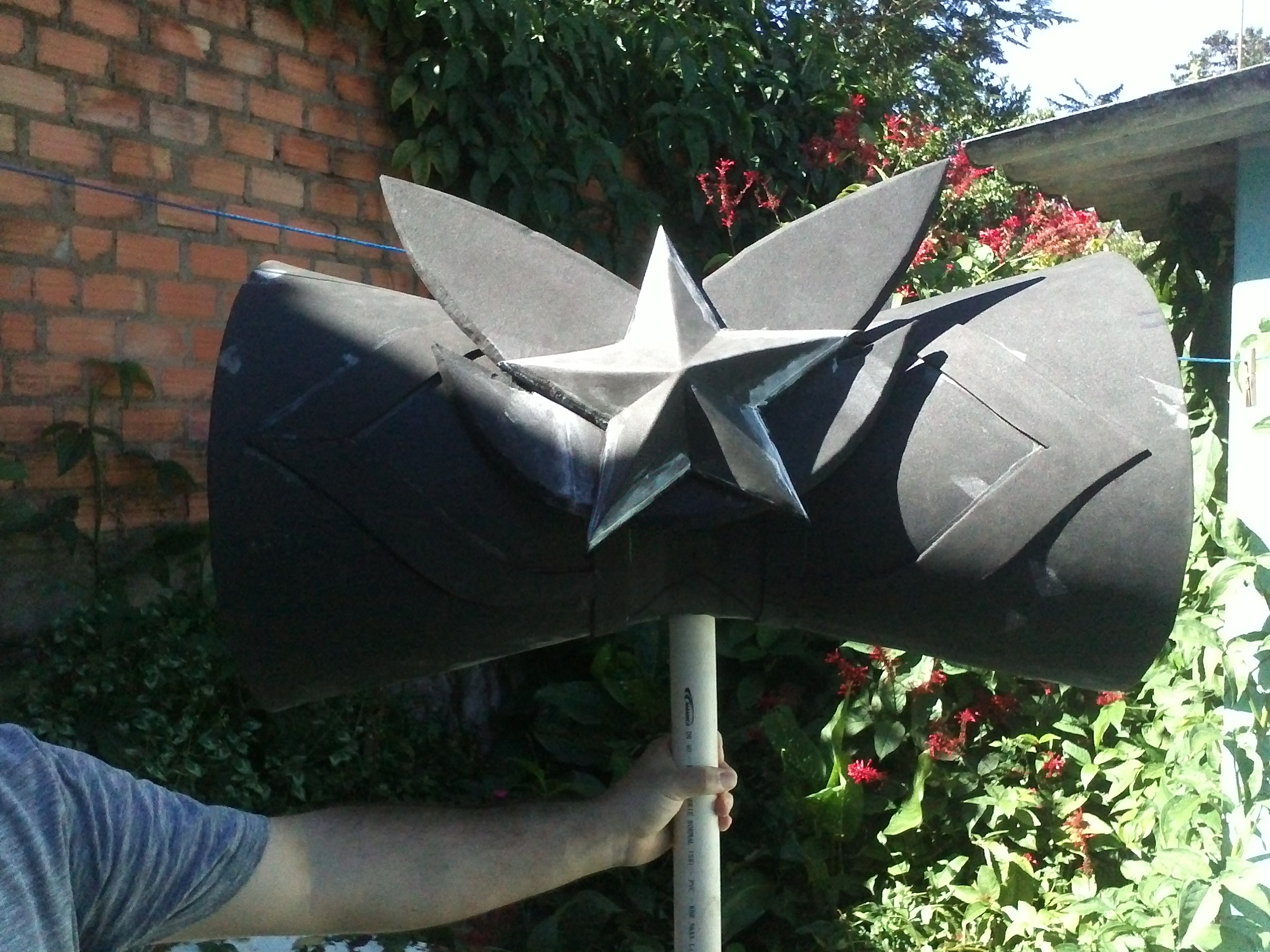

Mounted just to see how it was going on, not bad (i think)

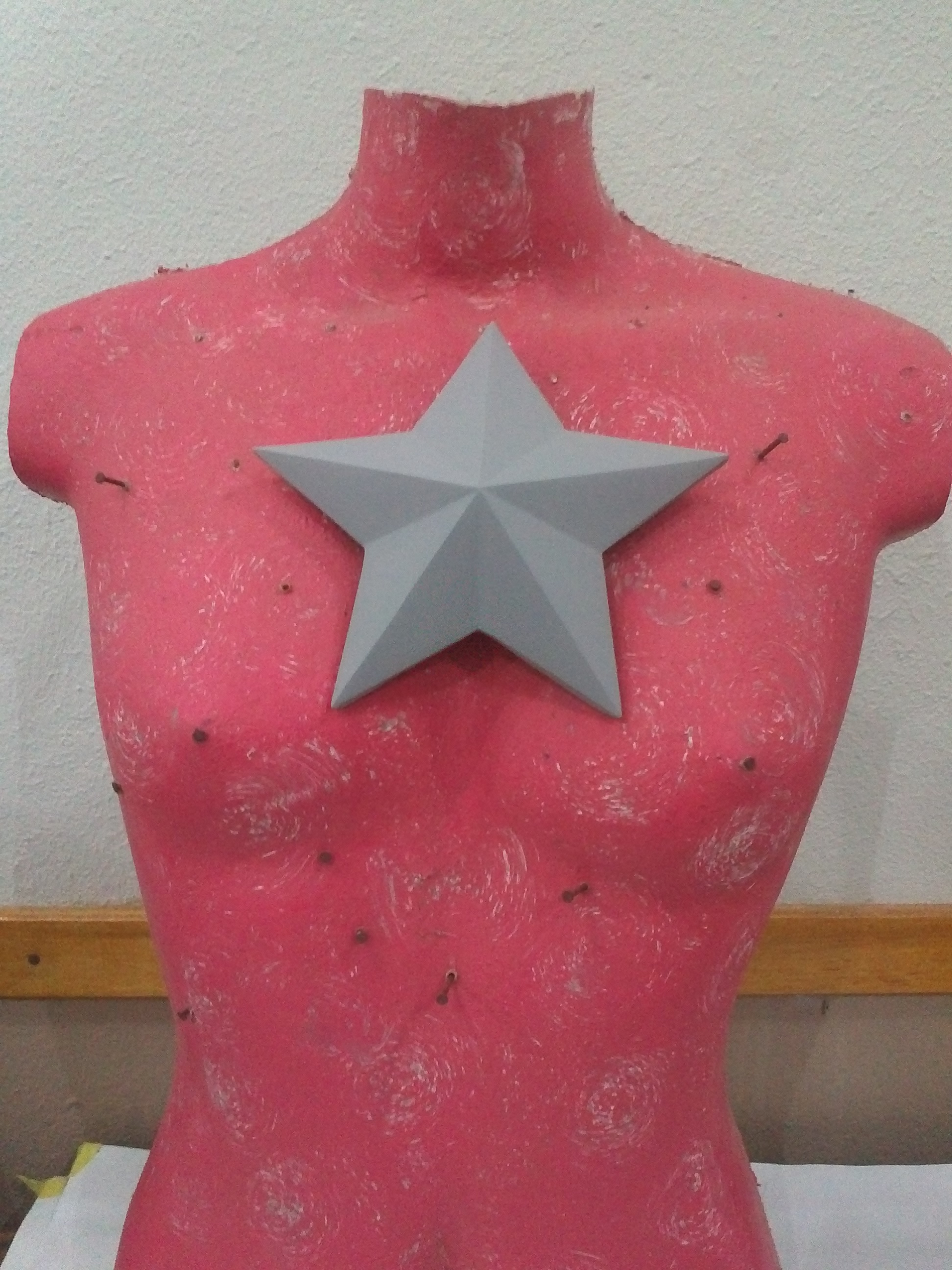

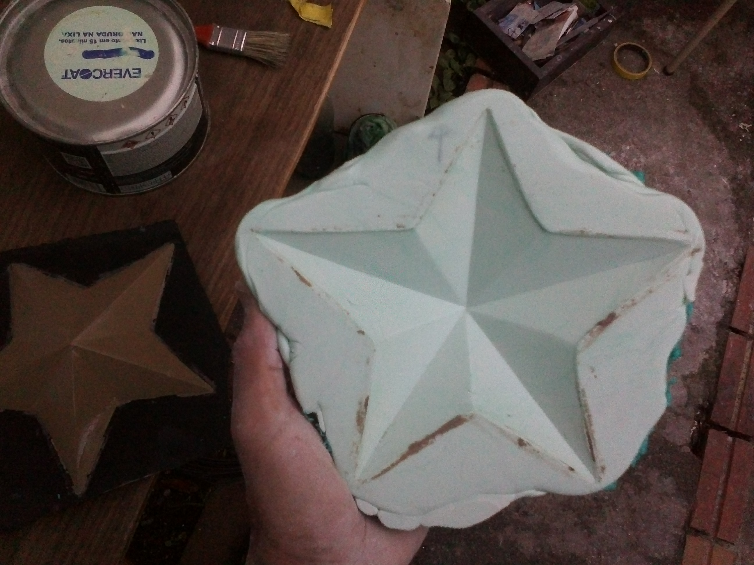

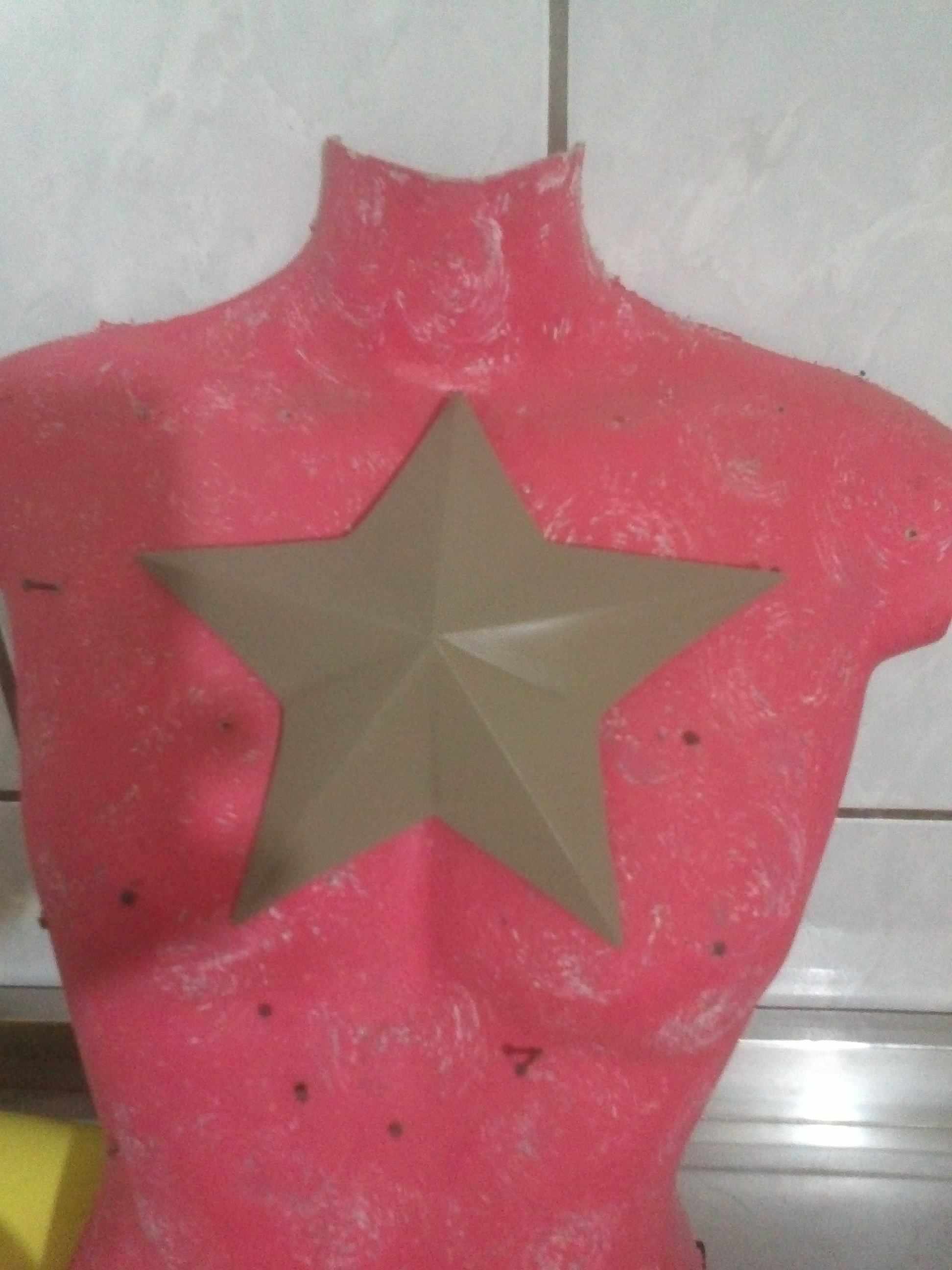

The chestpiece was made out of paper, reinforced with fiberglass and resin, then I used some bodyfiller to get a smooth surface.
I used some primer the a glossy spay paint to make a silicone mold for the chestpiece. The main point is tho get a crystal looking cast using some epoxy resin

Made a little star using epoxy resin with a yellow dye, the girl asked me if I could add some glitter, then I did :)
View attachment 731682Got a good piece, then tried a larger one
This one came out jus fine, got a translucid crystal looking and the glitter gave some nice aspect too

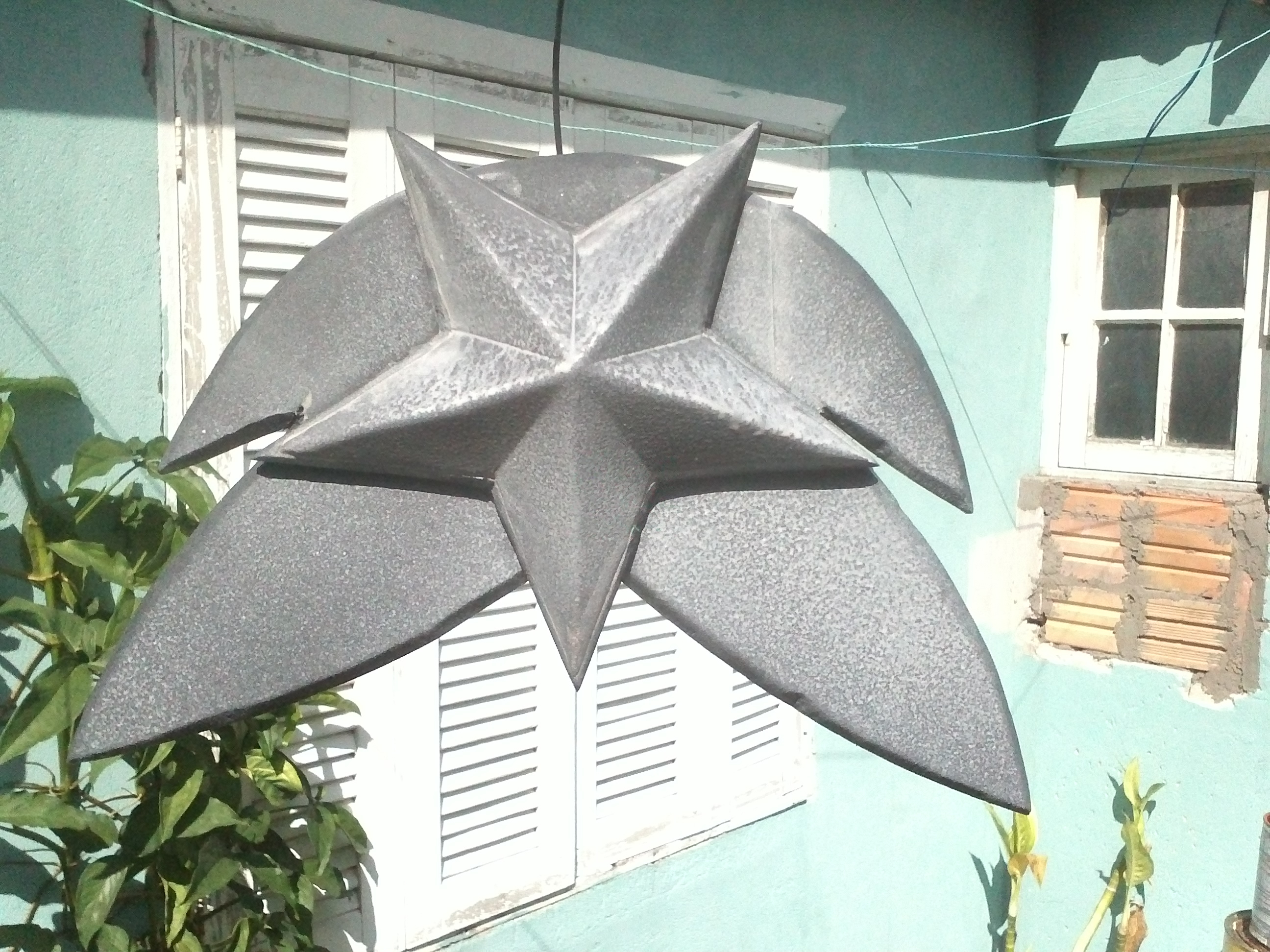

Strated sealing the wings, but before, i added some velcro bands to attach to the main boddy. Made some adjusts too, the girl wanted it with 180cm, so i did.
View attachment 731680View attachment 731681
Sealed the whole thing and started the painting, firt i did some yellow coating then applied a 3 coats of golden acrylic paint
After all paintings went done, i sealled everything using a nice acrylic varnish, here are the hammer finished:
This is me holding the hammer (I'm 187cm):
My girlfriend holding it (She's 165cm):
