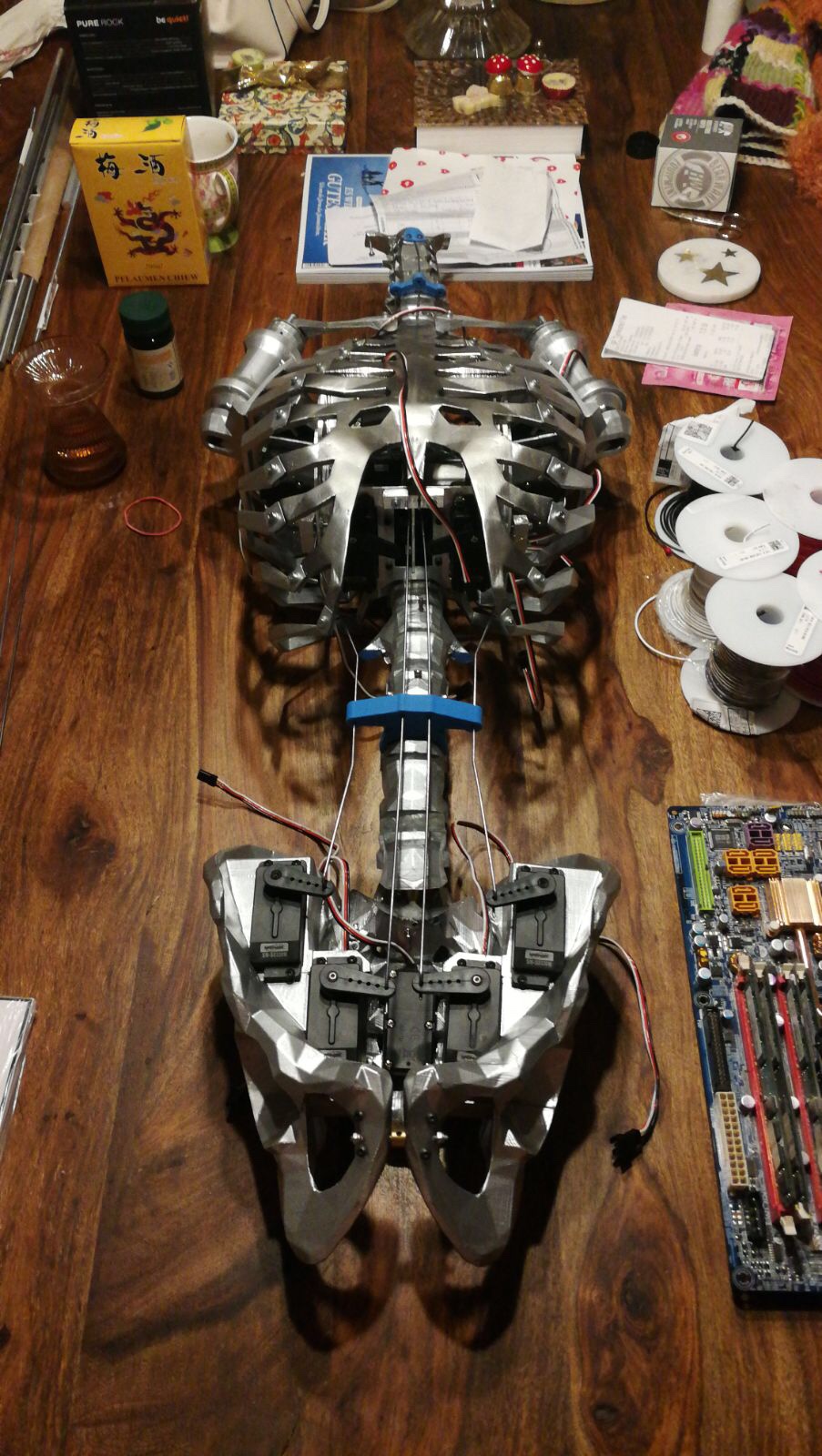

Just a quick update. We are currently working on the upper body. Here a teaser pic of the skeleton.
All parts 3D printed using PLA and PETG on an Original Prusa i3 MK2S, sanded and painted.
The aluminium cage which houses the servos is CNC milled.
The body shell parts are also already finished and we ar working on the assembly.
Can‘t wait to show the full finished animatronic.

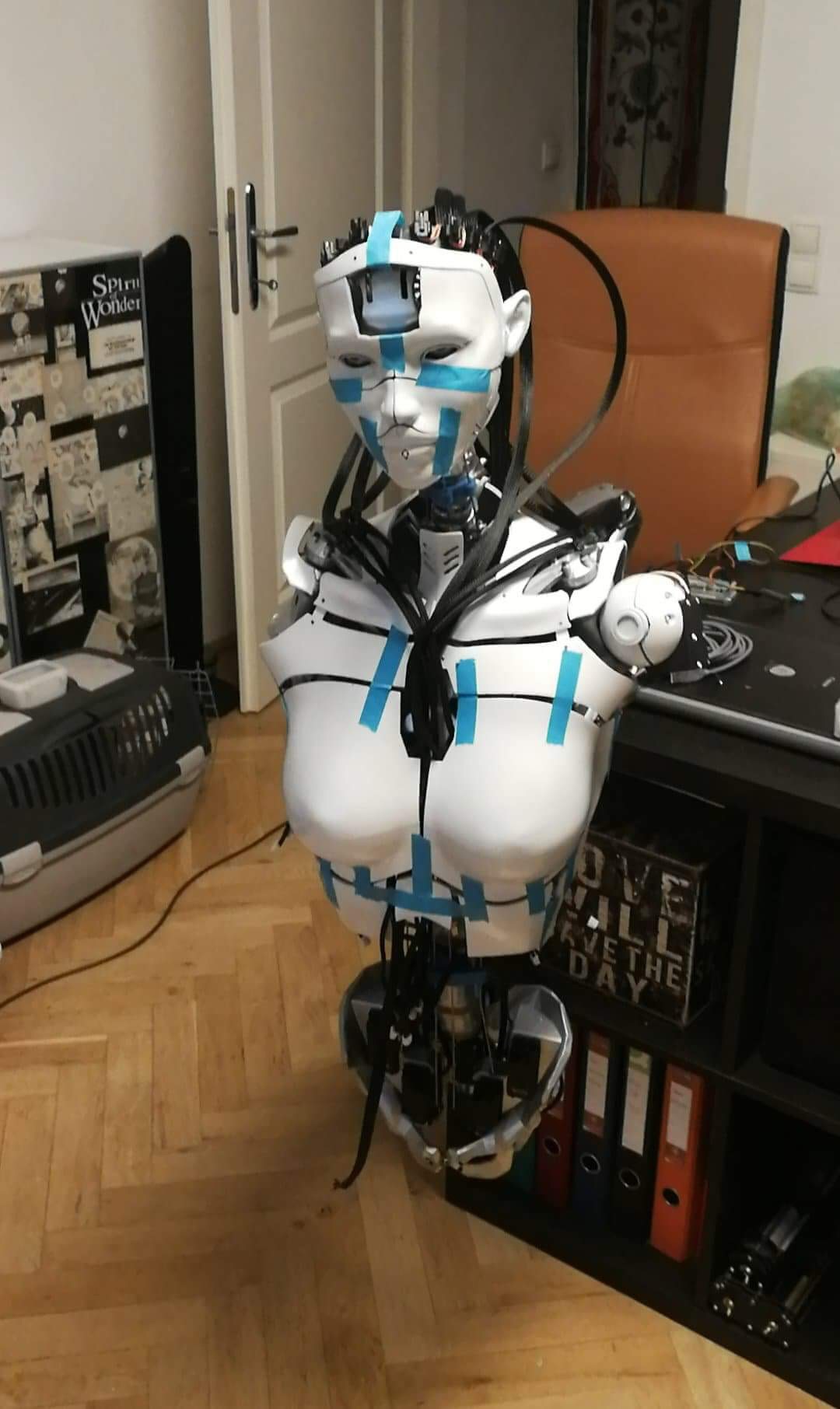

Quick update from the assembly phase... Many sleepless nights at the moment....
