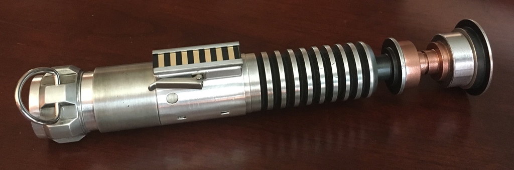

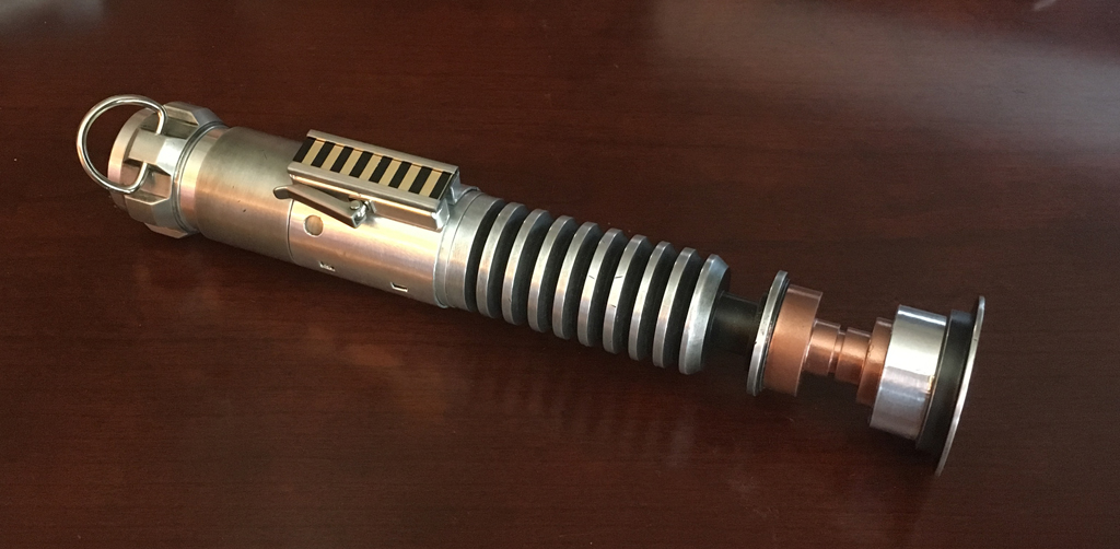

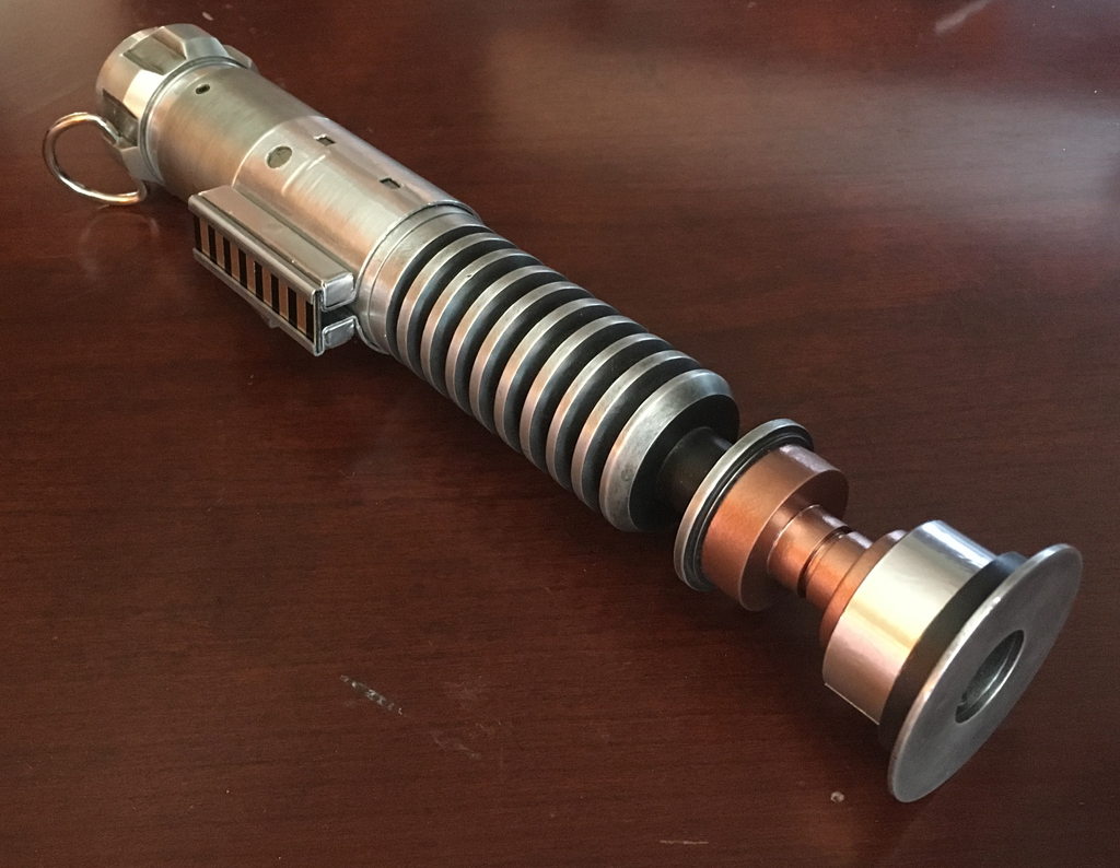

Here's mine so far. Before painting, I soaked everything in oven cleaner and buffed off the corrosion with #0000 steel wool. I did this about 3 times. I put aluminum tape on the upper portion of the "windvane"/bottom of the emitter before priming and painting it copper with Rustoleum bright copper rattlecan. The grip was primed and painted Rustoleum satin black. I faked the seam lines by painting a thin black line on either side of the grip then I chipped some paint off of the rings. I think it creates a decent effect. I also gooped some paint in between the rings to make them more uneven looking.
The pommel, emitter, and clamp (no logo TCSS clamp from a few years back) all had aluminum tape applied in the appropriate places. I also replicated the torn tape on the clamp.
I've still got to make a clamp card, and I'm waiting for my d-ring from wannawanga to arrive.
I plan on installing electronics, too. I've got a pico crumble sound card, an rgb tri cree, and some other components, but I've never done an electronics install before, so I'm waiting to see what other people do before diving in.
