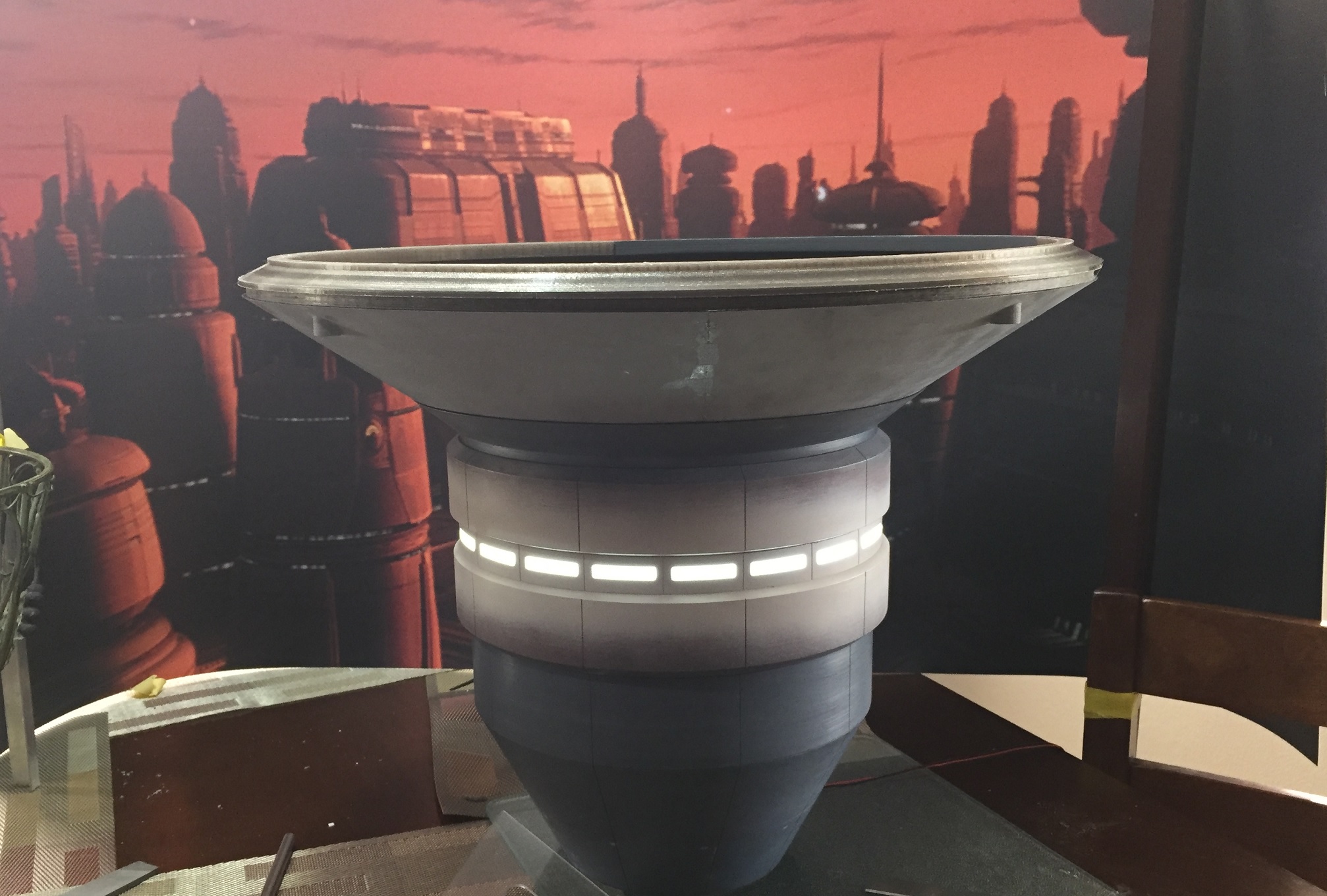

Been a while since any updates. Have been working on the round pad section (lift mechanism cover) and now am working on the walkway section. Found the perfect LED (7014) to install around the inner edge of the band around the landing and walkway pad. Progress is slower than I had anticipated.
I had a 2 foot by 4 foot background printed to use with the Diorama of the scene of the Millennium Falcon take-off. A little bit of cut and paste to get the CG landing pad out of the background.
