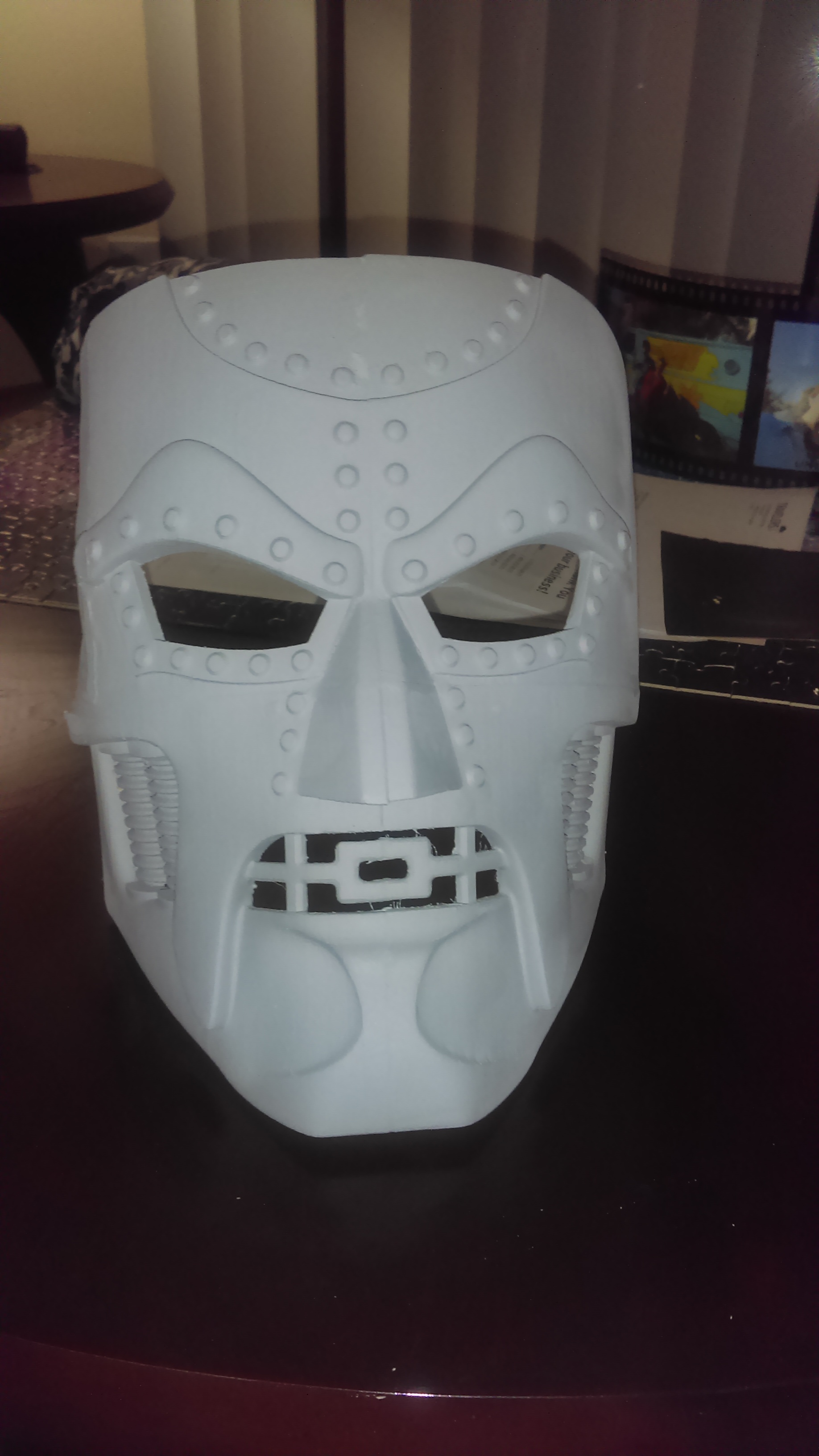

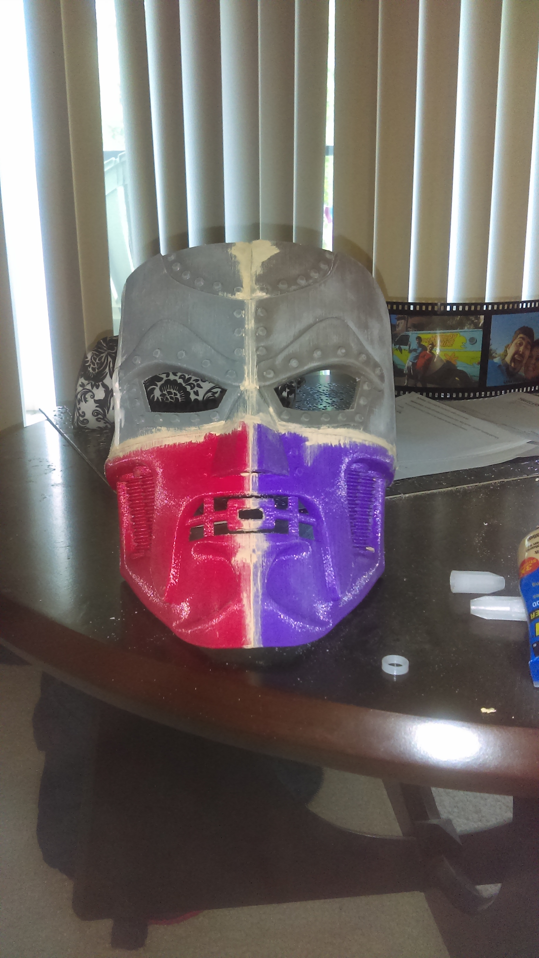

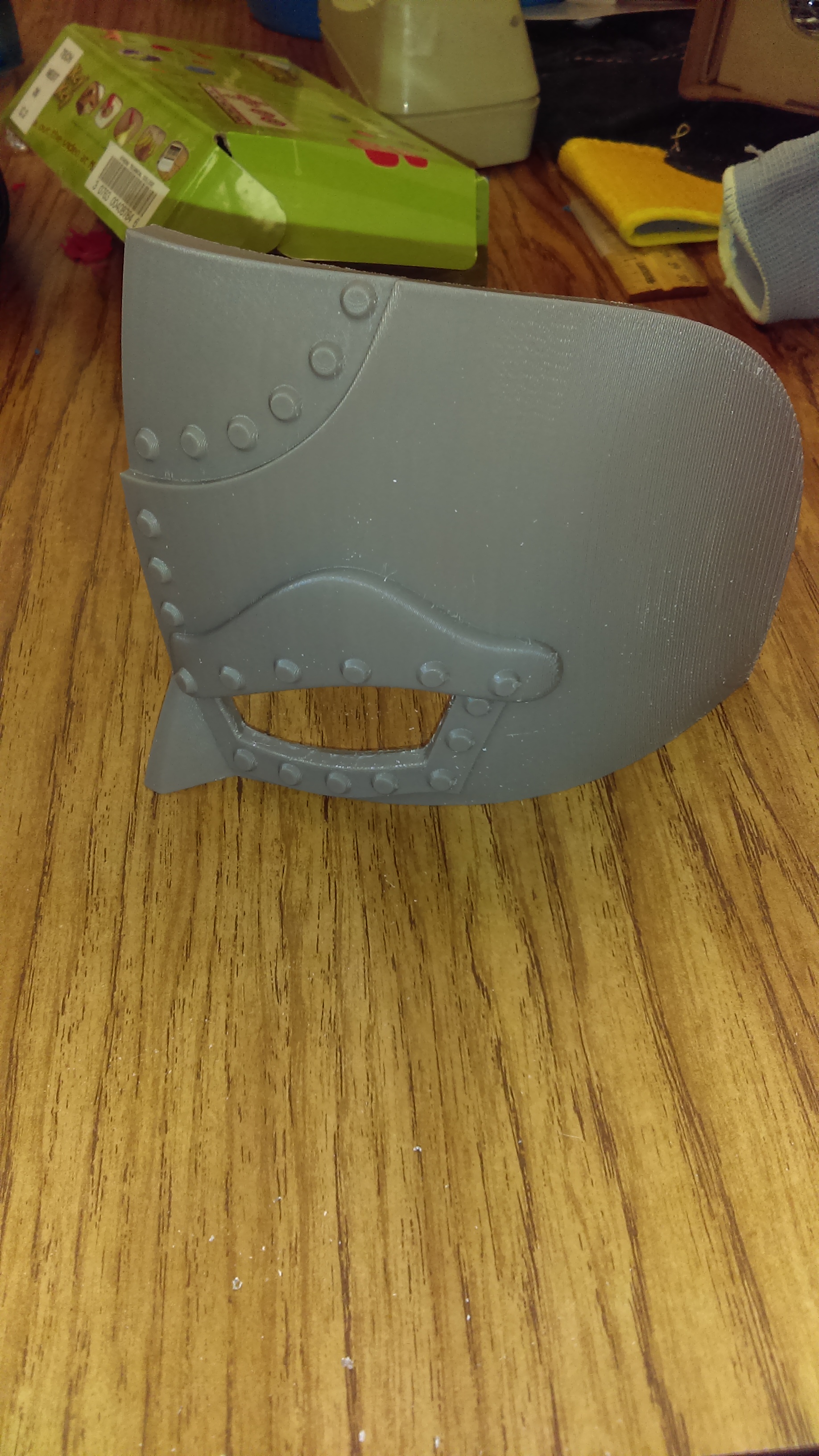

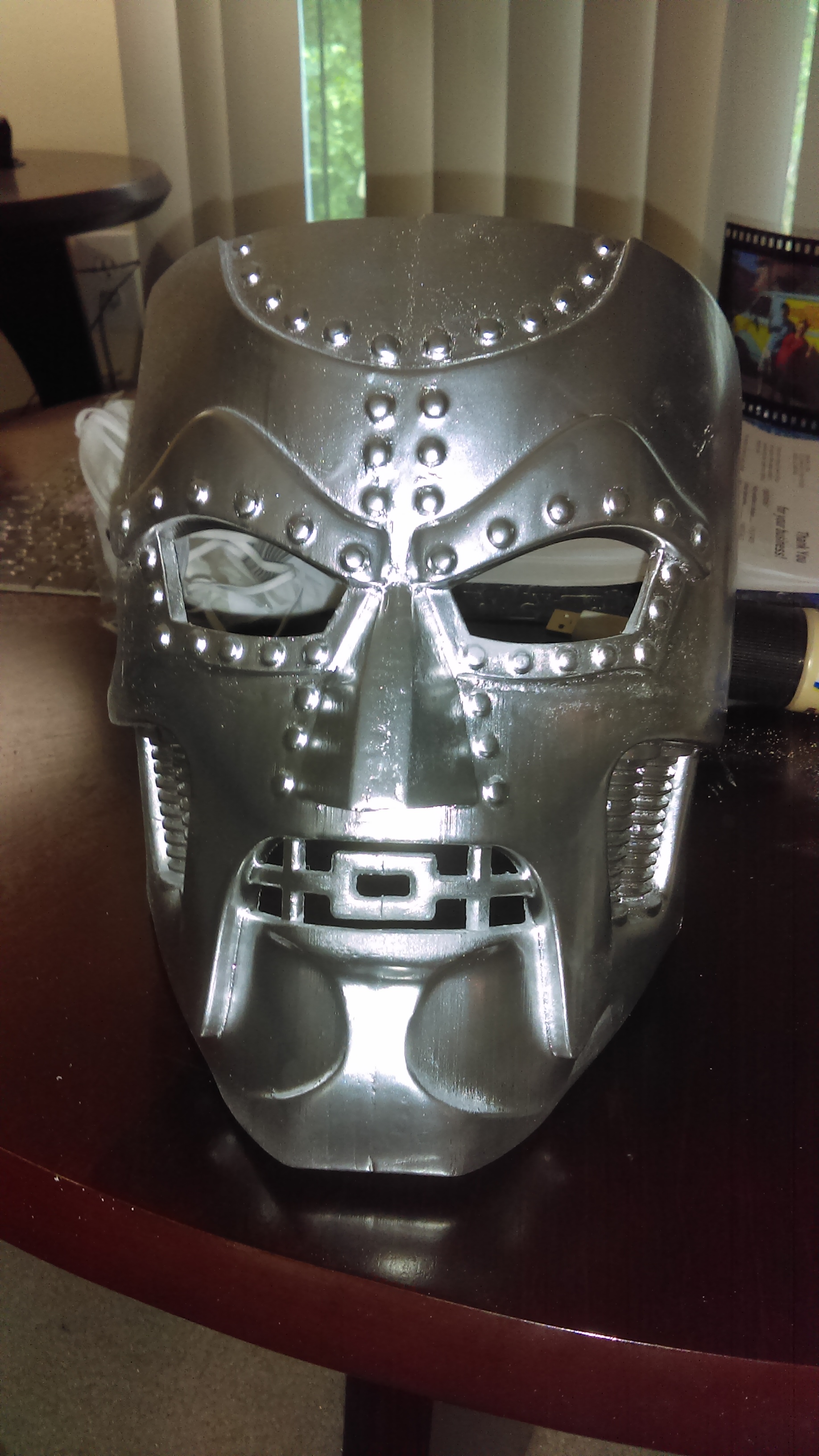

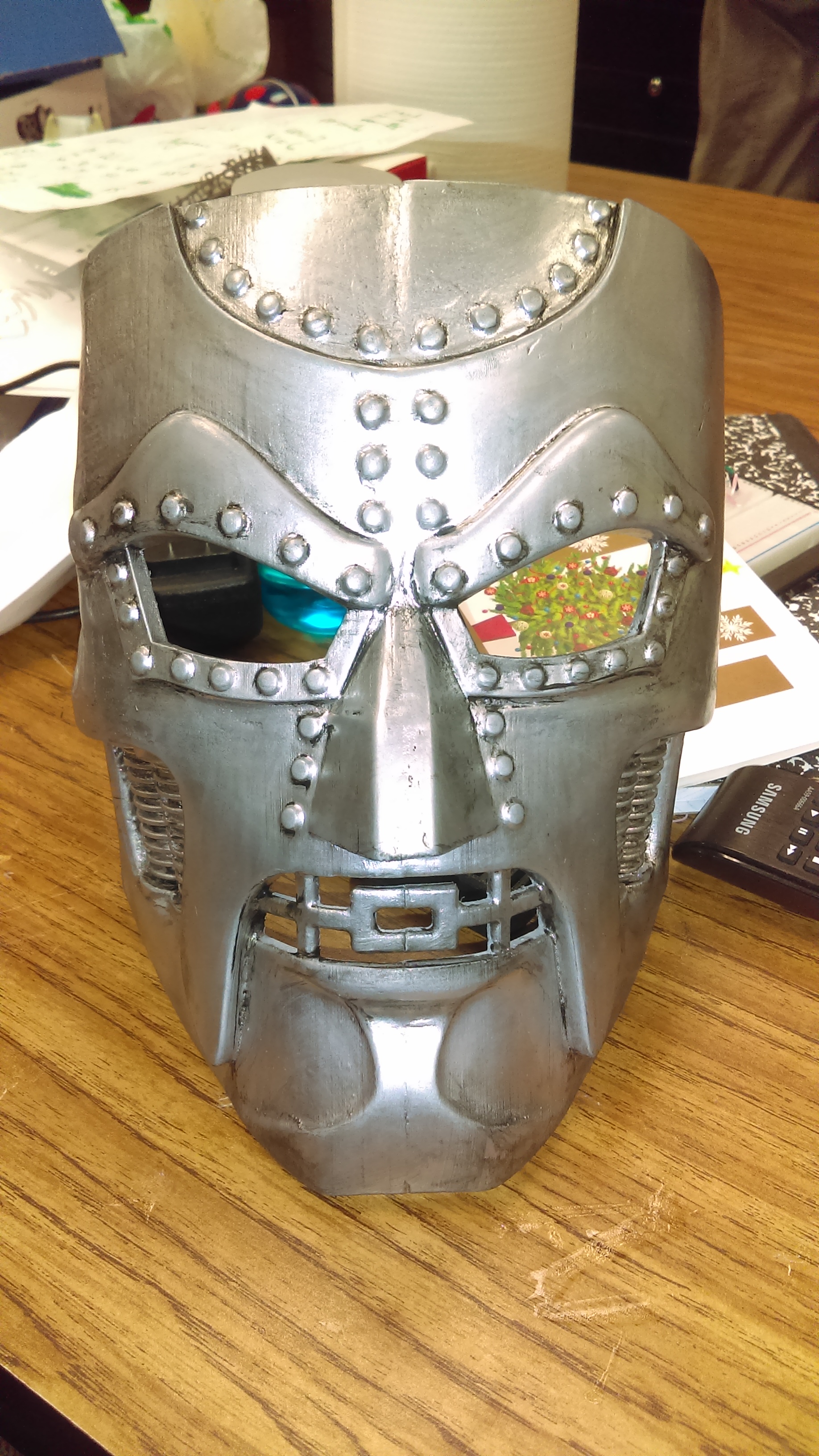

So I am building a Doctor Doom costume for my boyfriend. So far I've 3D printed the mask and its still in the works (needs voice modulator, a way to wear it, and a clear coat)
I'm fairly new to the costume world. I've never shown anyone my work online. So here is the progress pics of the mask:
