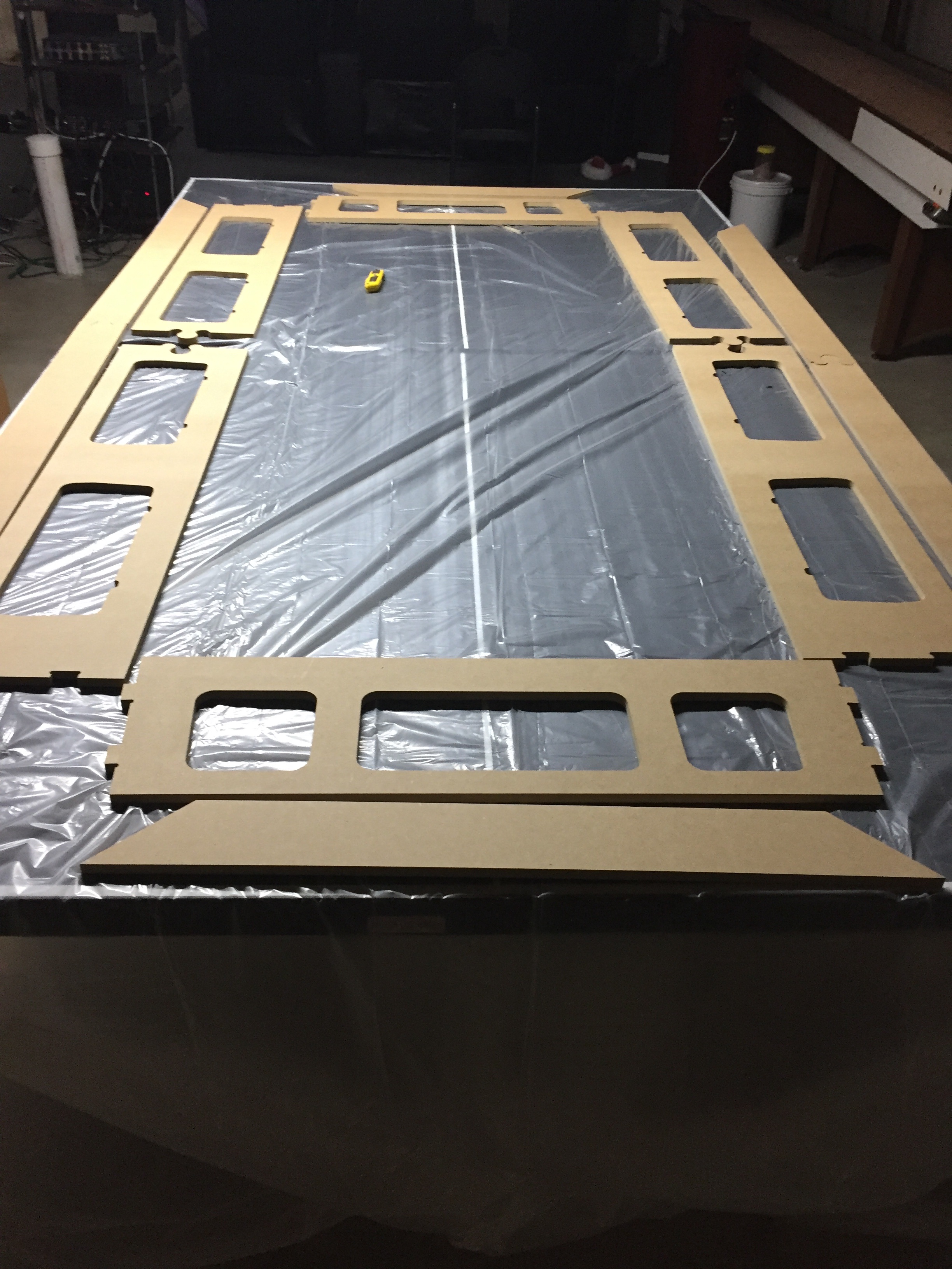

This would be the Zenix CNC cut box. Comes wrapped andpacked very securely. He’s got great instructions in his for sale thread on how to put it together that are pretty good. First thing I did was layout all of the pieces and then dryfit the pieces to see what things were looking like.
While it was a pretty good fit, things weren’t quite flushing up. This is covered in the instructions and is a result of the rounded bit and how it leaves the inside corners during the CNC process. It only took a couple minutes to file them square using a wood file.
After filing everything down I confirmed everything was now flush with another dryfit run and then moved on to gluing the puzzle pieces together. I used Gorilla wood glue on the puzzle pieces and then clamped them together over night.

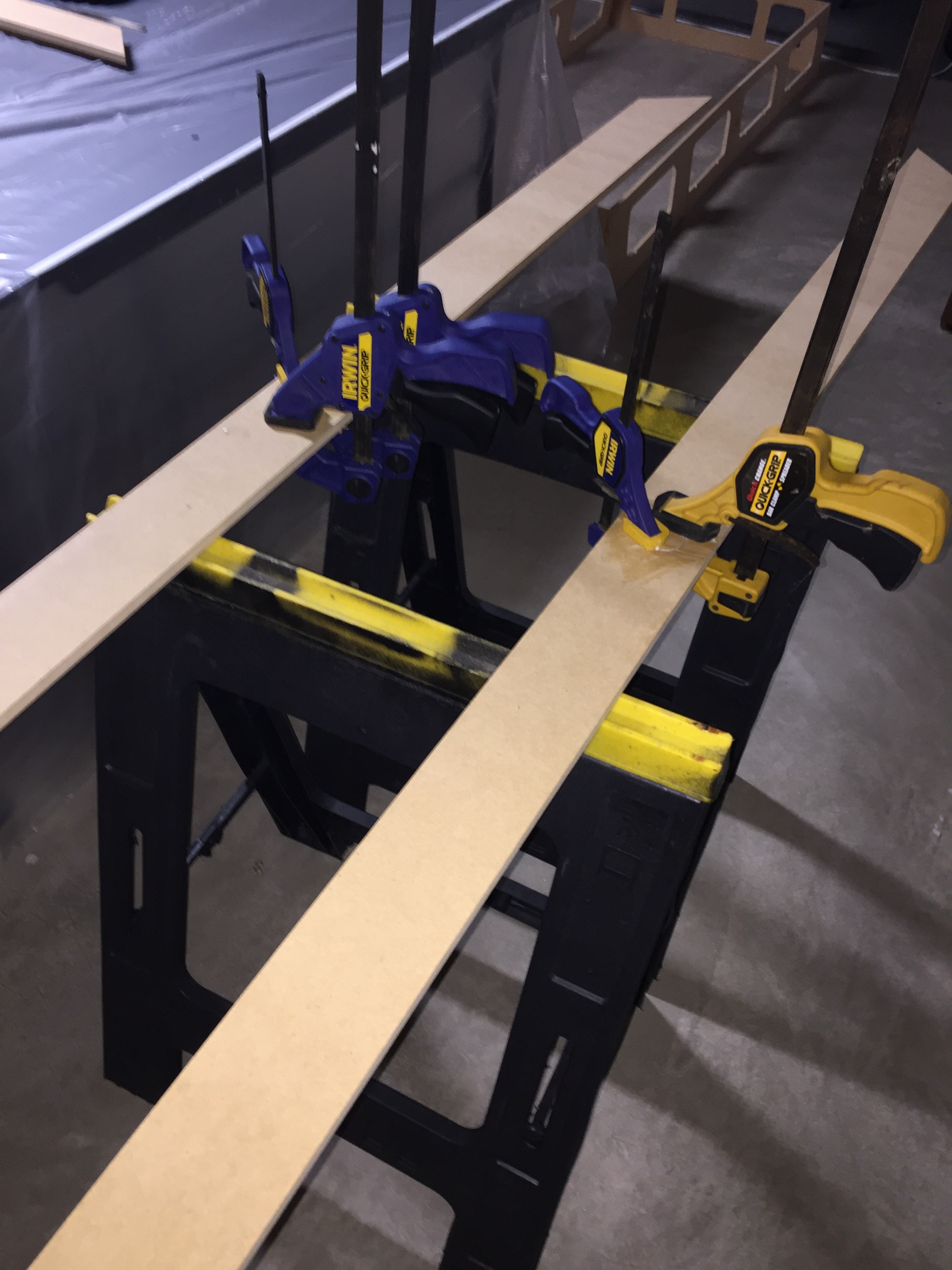

Next step was to start putting the frame together. Used the Gorilla wood glue again, and some 3 foot clamps on each end to help hold it in place while it dried.

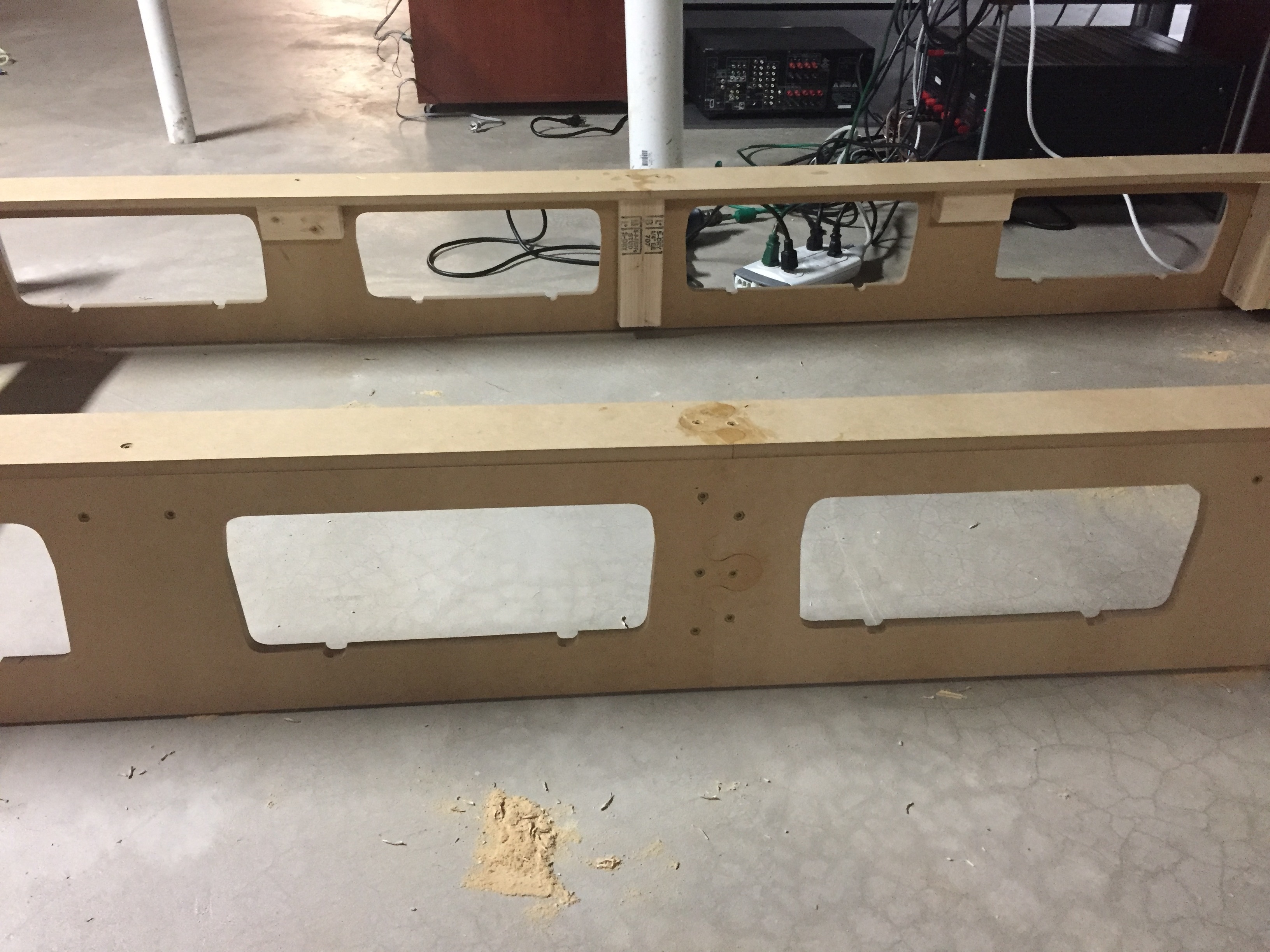

After I let that dry overnight it was time to brace the corners as the whole thing is pretty fragile at this point. I was initially going to use L brackets as I'd see in a few threads, but in each of those threads more wood bracing was eventually used in some fashion. I decided to just go with the 2x3 supports that I'd seen in many of the builds and was originally provided with the early Zenix kits. I ended up using two in each corner and one on the middle of each side to help reinforce where they were glued together.
I knew I was going to want to countersink my screws so I ended up buying a Dewalt countersink drill bit as it made the process go quicker than switching bits in and out. I used some deckmate 1 5/8" wood screws I had left over from another project. They worked well but 1.5 or 1.25 inch would probably have worked just as well.

Next I decided to get the top frame/trim added so that when I cut the plywood I'd be able to get it attached. Picture below is just a random pic of the frame attached. What you can't see and I didn't get a good picture of was that while the frame went on easily, due to the angled sides I did have to shim the corners. This was not hard or a big deal, but was important for the frame to sit level as the corners are all angled. I just bought a pack of cheap builder shims, wedged them in until everything was square and screwed it in. You can see a few of them in the pic below. Once everything was screwed down I just went back around and broke the excess off.
As I was getting ready to add the plywood front, I realized that the sides between the middle and corners had some "give" so I decided to add a few more supports. These were just small pieces of 2x3 I had left and just enough to get screws through the side and then down through the top frame to help lock everything down. you can see them in the pic above and also below. By adding these I had to refit my front piece and cut out new openings so it would fit again.
