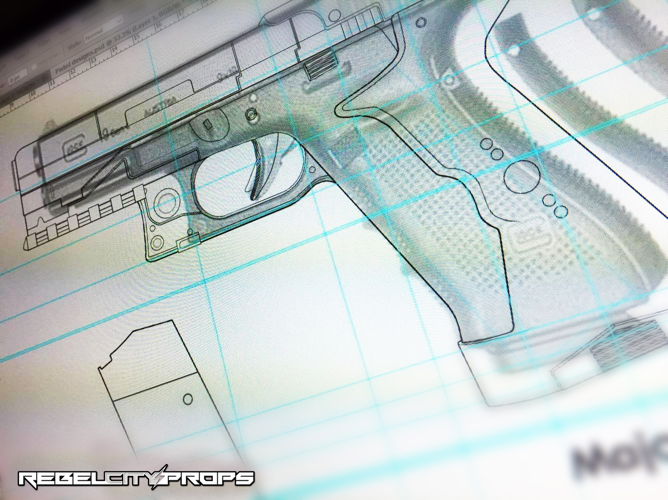

Okay, the first step was to obviously create a set of plans from which I could model the gun in 3DSMax. i used the image shown above from the main details of the side of the gun and i used a 1:1 scale image of a Glock 19 from which to mack sure the gun itself would be correct to scale. There are elements of the gun that certainly differ in size from the Glock 19 but thankfully the trigger well are both the same size so I used this to make sure the rest of the gun would work and not be too large or too small.
Once this was done I imported these plans into my 3D software and began work on the model. I made sure from the beginning to set my units to the correct scale so that every measurement I would enter for height/width etc for things such as the clip would translate to the model and be the correct size.

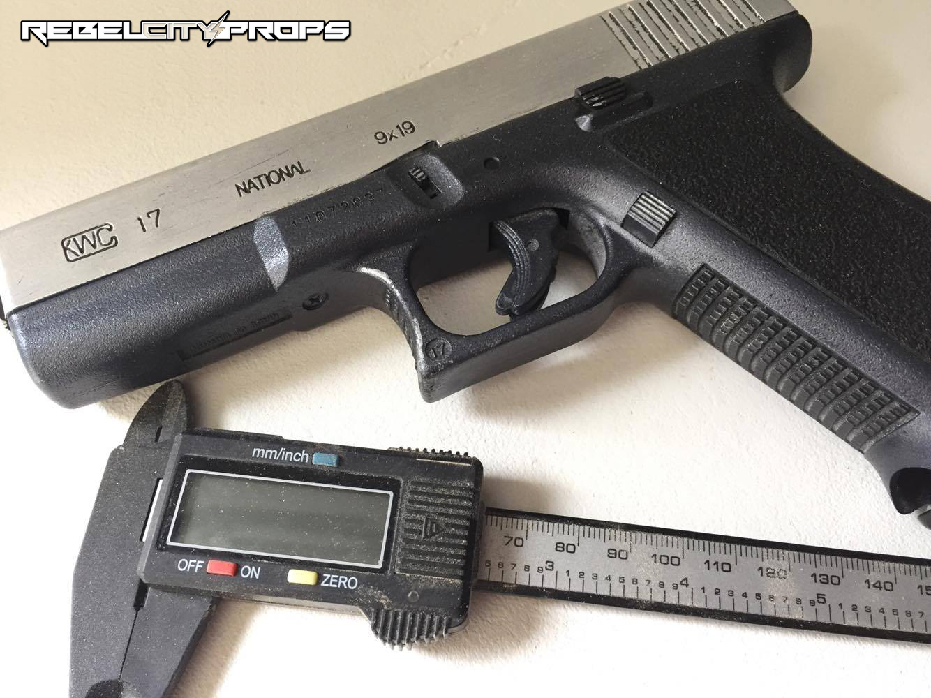

During this time i procured a Glock 17 replica and some digital calipers, I cant tell you how invaluable this turned out being, just having something physical i could use for measurement reference really helped with this project.

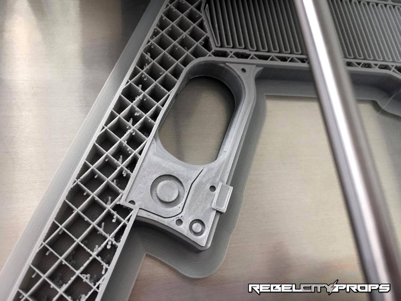

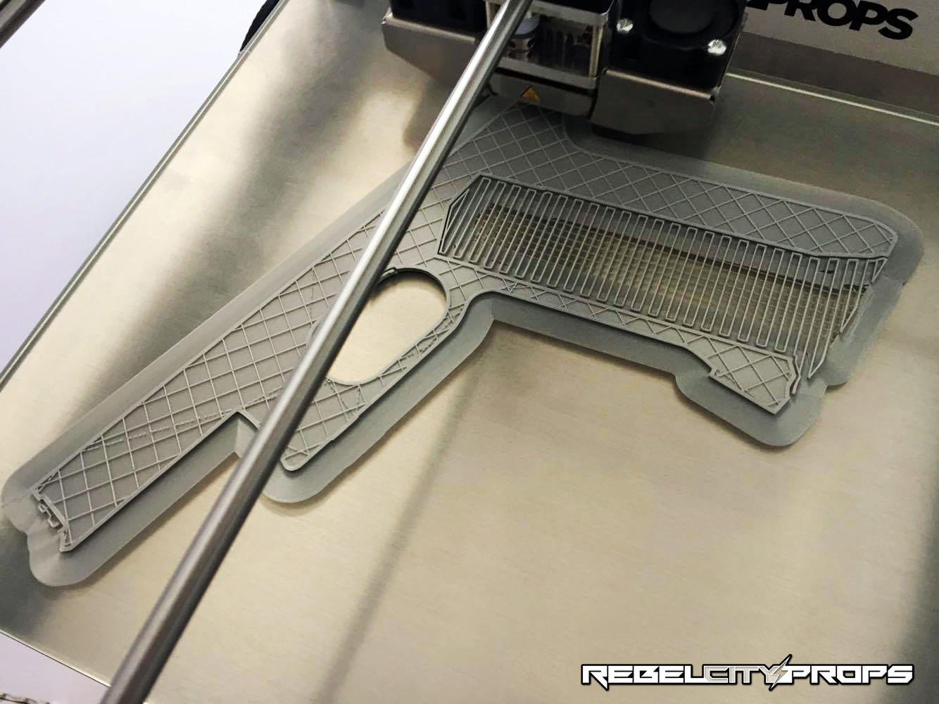

Here's some beauty shots of the gun being printed out on the Ultimaker 2+. again the settings are standard settings (within Cura) for Ultimaker Silver/Metallic PLA with a 15% infill setting and 1mm wall/top/bottom thickness.

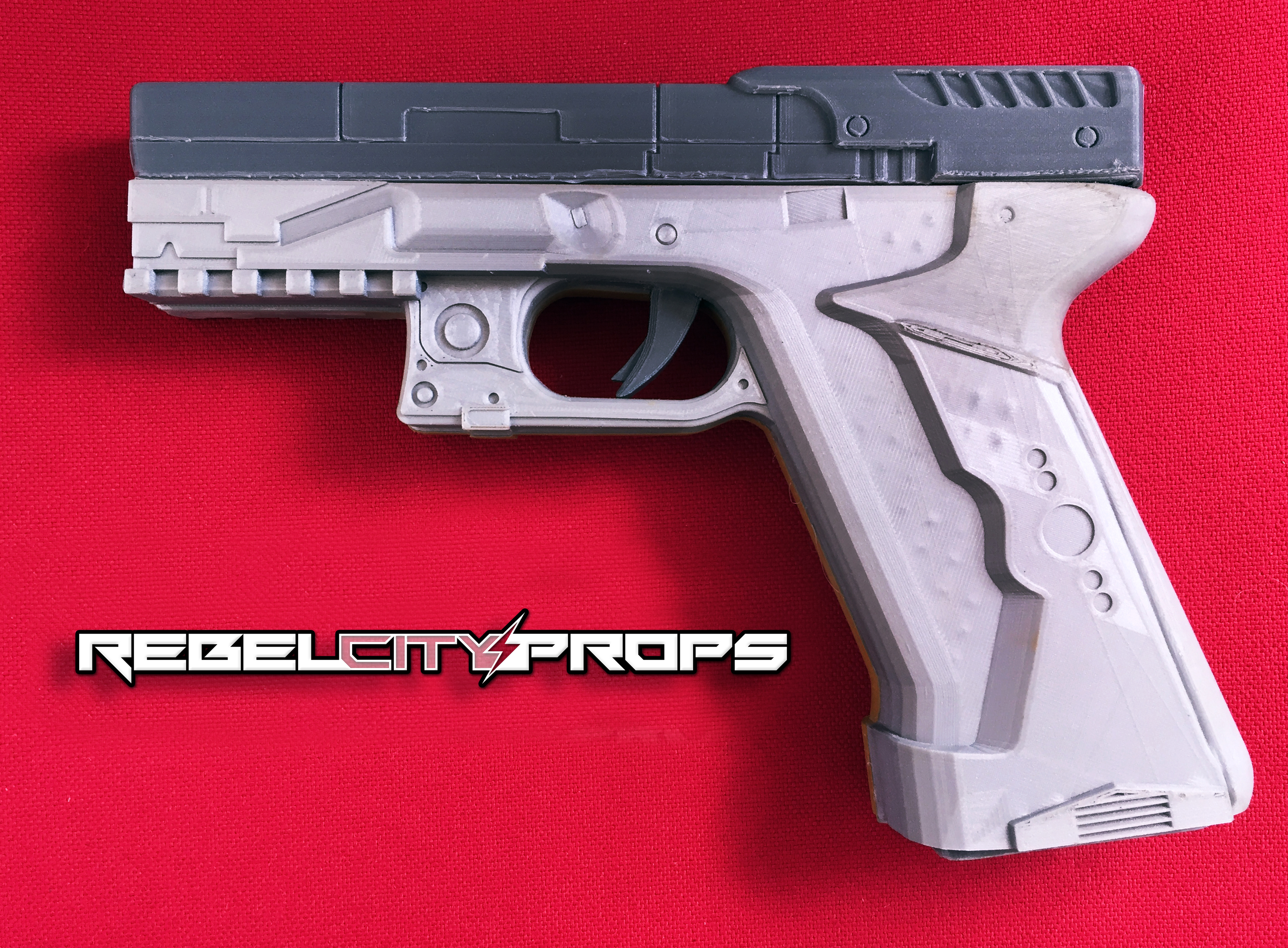

So, all the parts are printed off, I got a bit excited and started sanding before I took a shot of all of the individual pieces that will go into making the framework of the gun.
Here's a shot of the main complainants temporarily hot glued together so you can get an idea of the whole thing assembled. It's certainly rough but a lot of finishing work is about to go into these to make it as clean and crisp as you'd expect from a futuristic firearm.

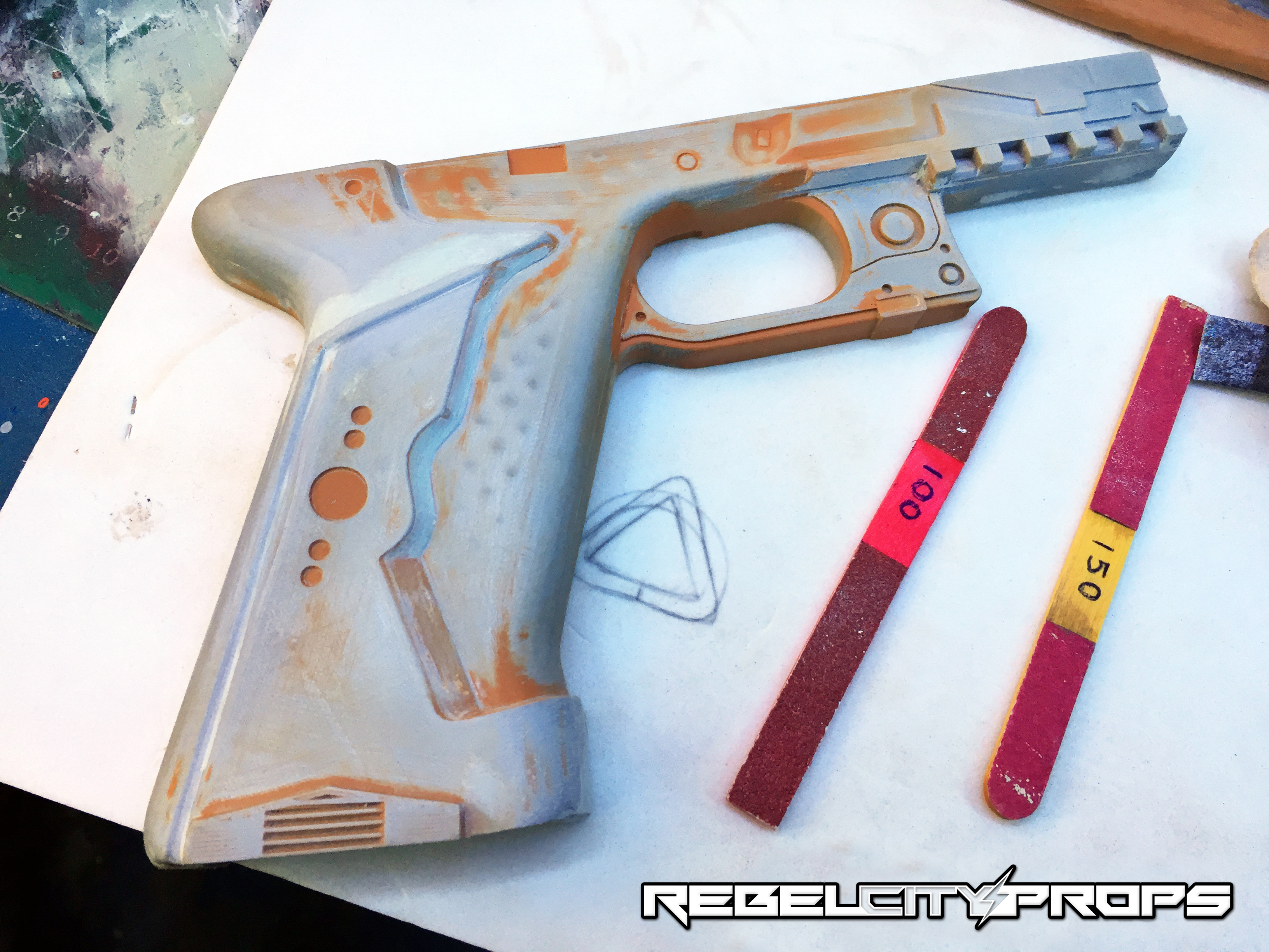

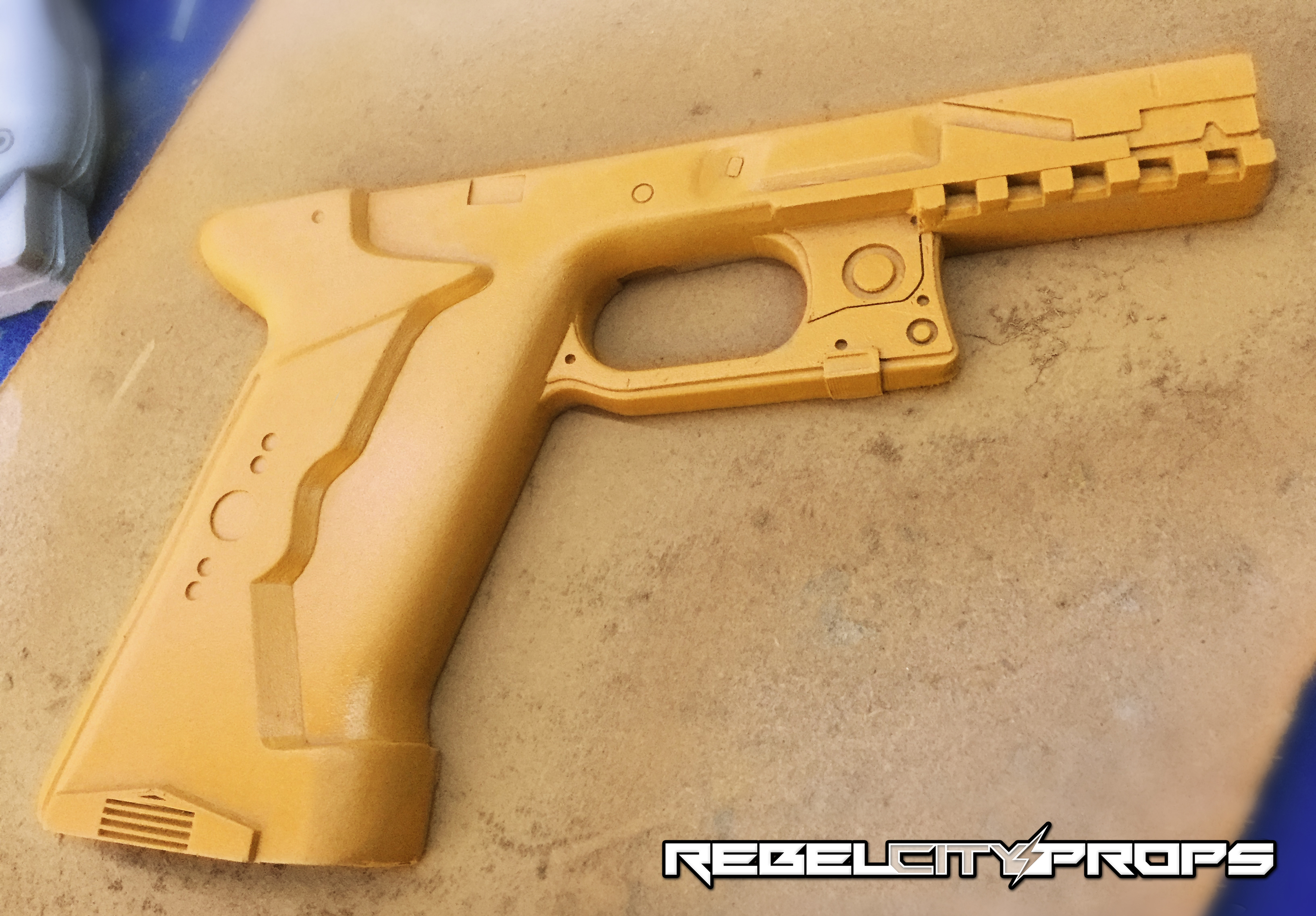

Just a quick update, I'm currently in the loop of laying primer/filler-primer, filler putty, sanding and repeat to get all blemishes corrected and any dips filled in. Making your own custom sanding sticks really comes in handy at this stage for those difficult/tight areas.
